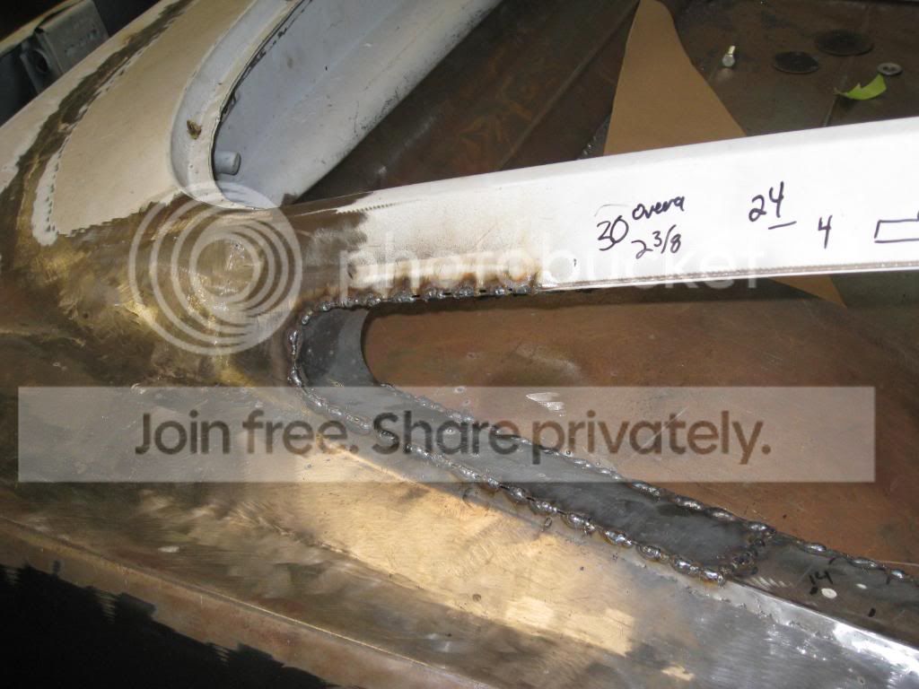

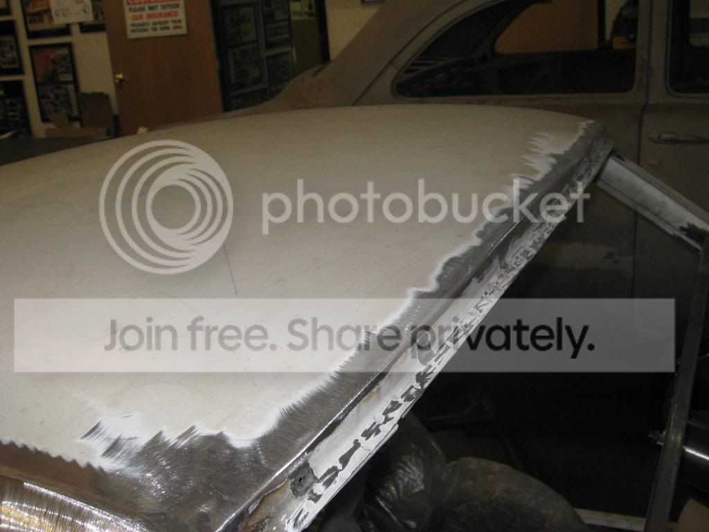

jephs422 04-08-2009 04:20 PM

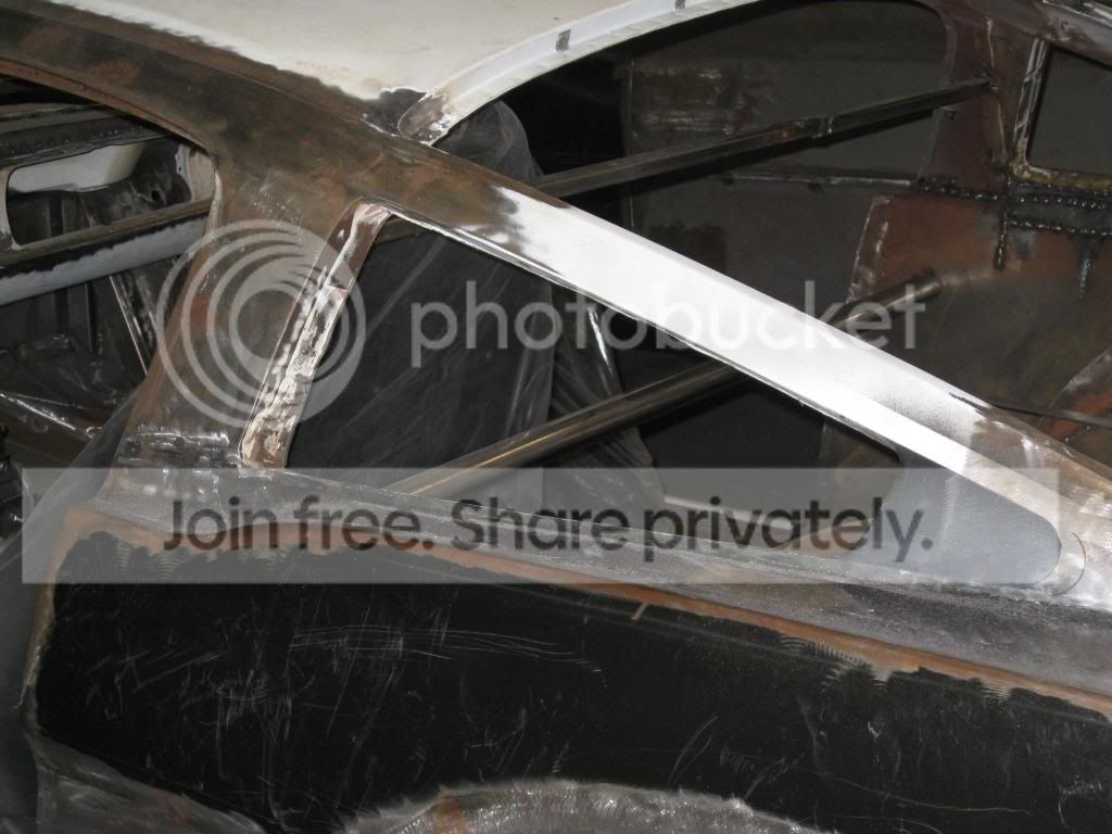

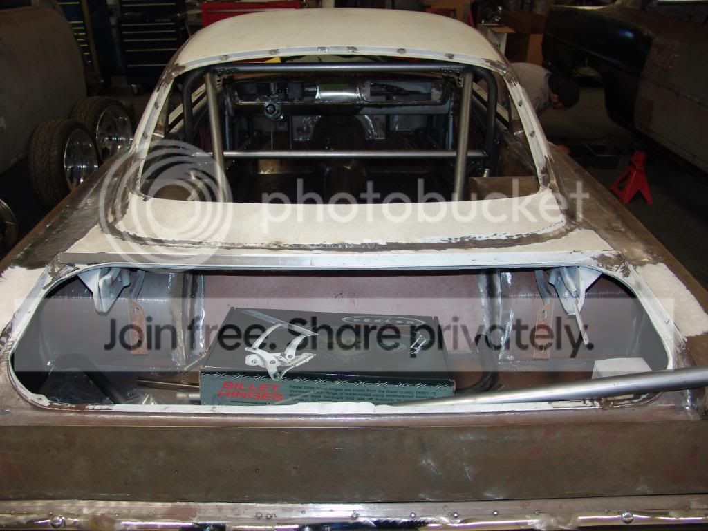

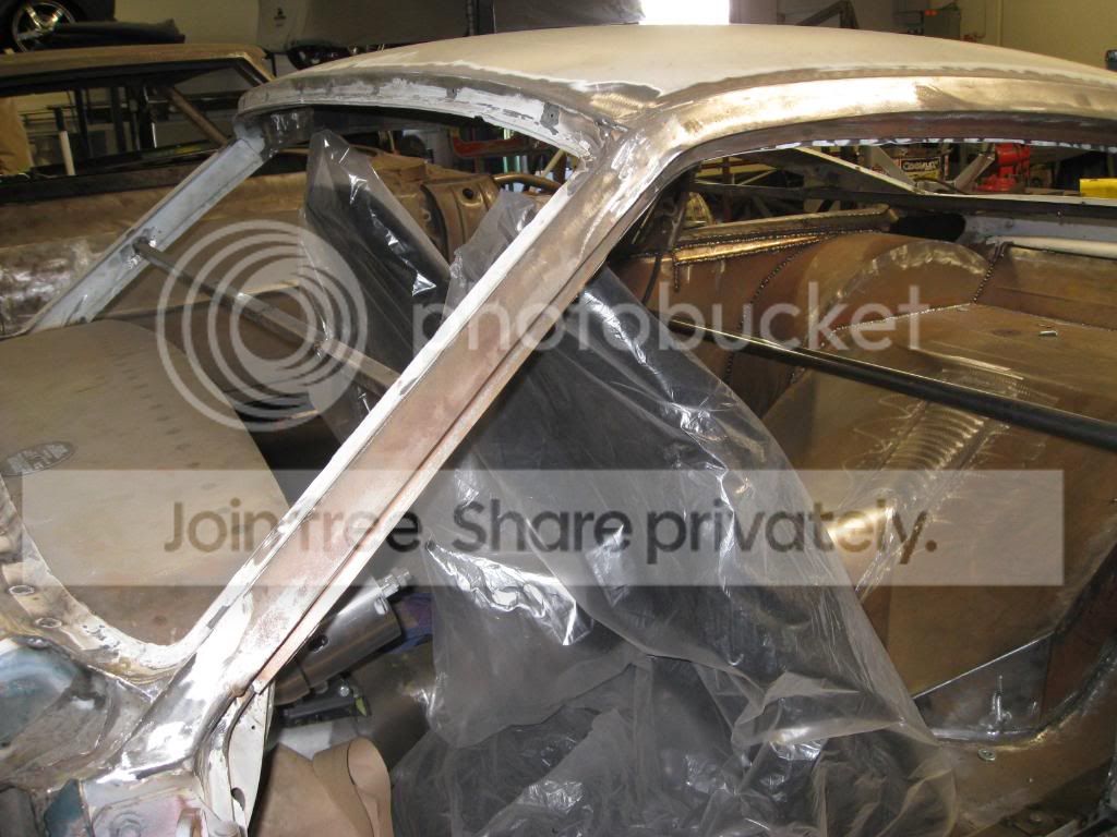

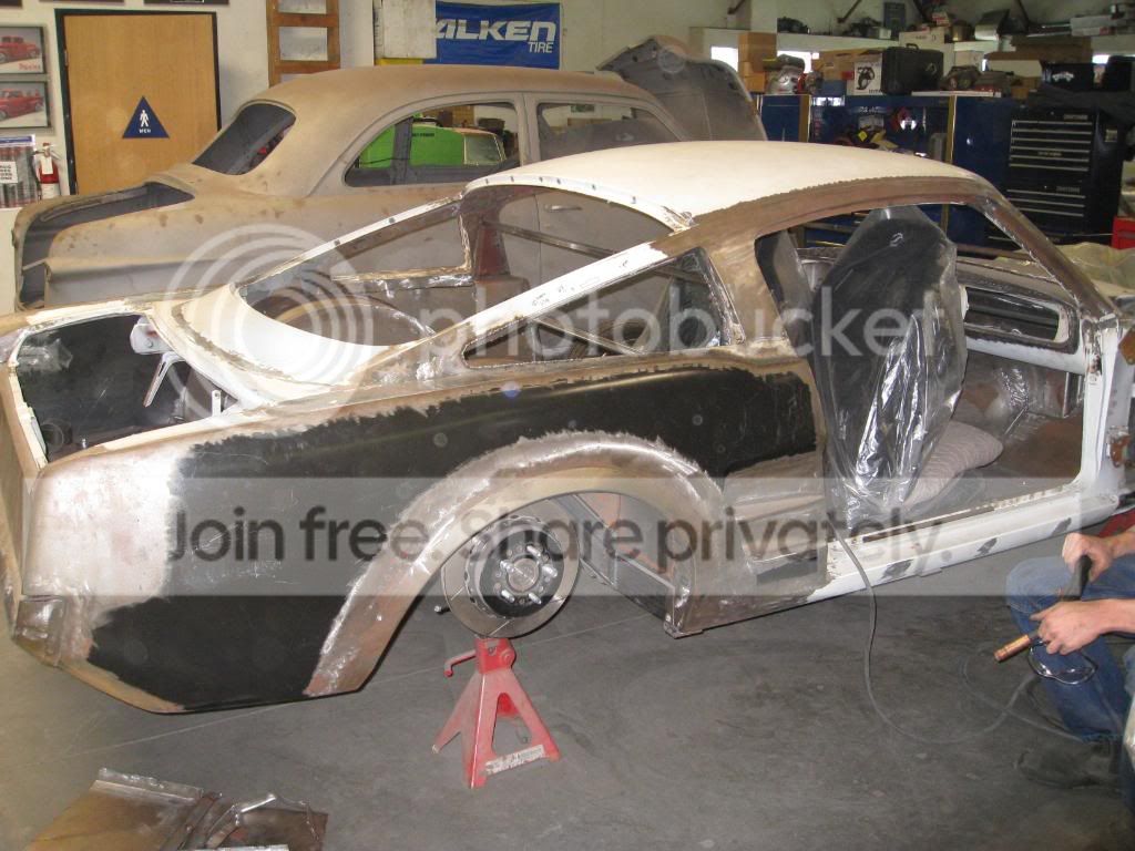

Little bit of an update.
With the hiatus over, we are back to schedule on this project;although this one will unveil at SEMA rather than GG Columbus. We opted to take the other Mustang project to compete and leave this one for next year.

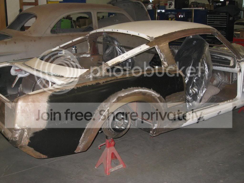

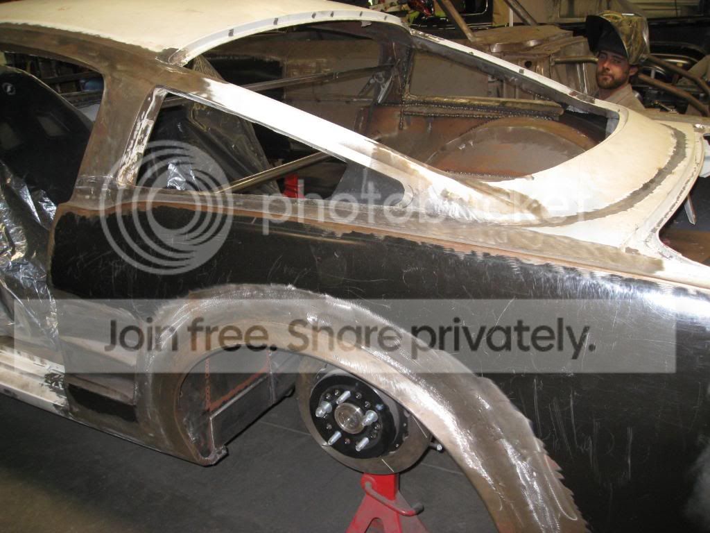

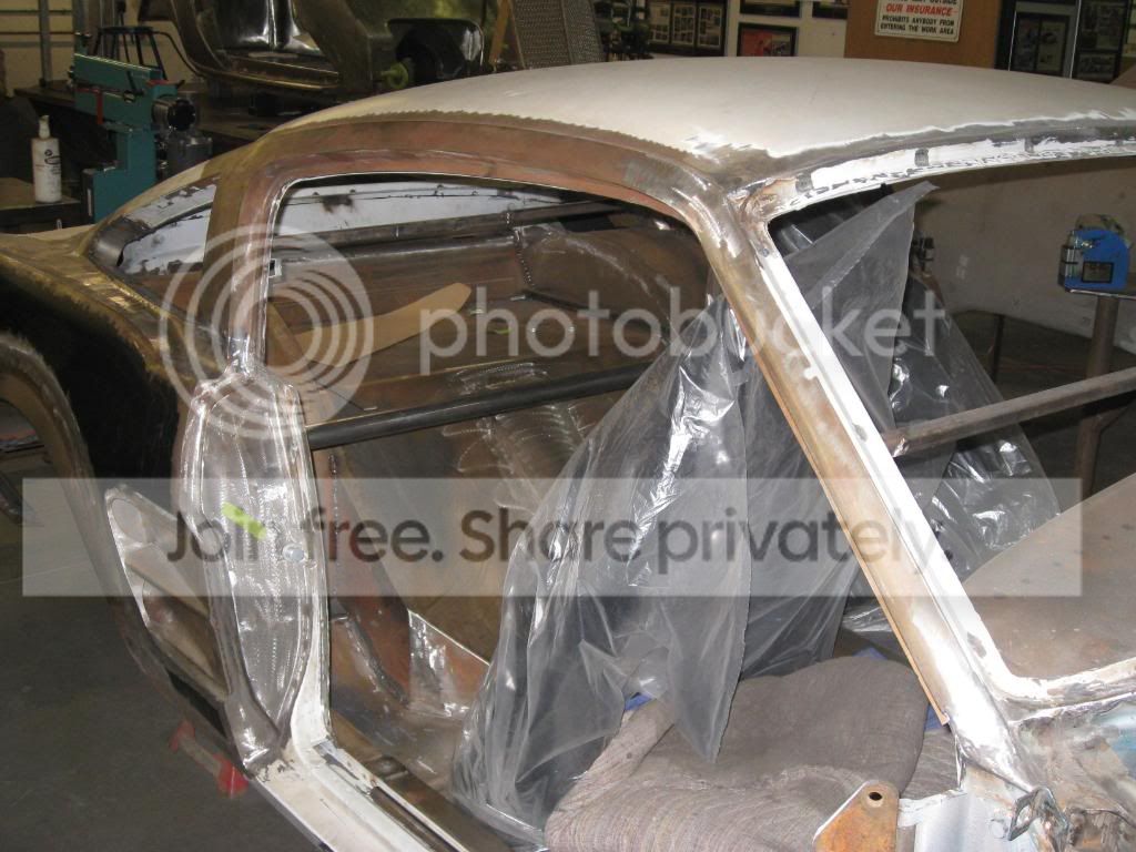

A lot of the big work is done and here is just a few quick snapshots of the roof being chopped.
The windshield was laid back 3/4" and the rear sction was chopped 3/4". Very subtle, but it looks great. As soon as it is in a better location I'll take a few profile shots.
http://i353.photobucket.com/albums/r...g/IMG_0419.jpg
http://i353.photobucket.com/albums/r...g/IMG_0427.jpg
http://i353.photobucket.com/albums/r...g/IMG_0426.jpg
http://i353.photobucket.com/albums/r...g/IMG_0424.jpg
http://i353.photobucket.com/albums/r...g/IMG_0422.jpg
jephs422 04-08-2009 04:22 PM
http://i353.photobucket.com/albums/r...g/IMG_0432.jpg
http://i353.photobucket.com/albums/r...g/IMG_0458.jpg
here's a comparison of the rear "window" section.
http://i353.photobucket.com/albums/r...g/IMG_0457.jpg
http://i353.photobucket.com/albums/r...g/IMG_0456.jpg

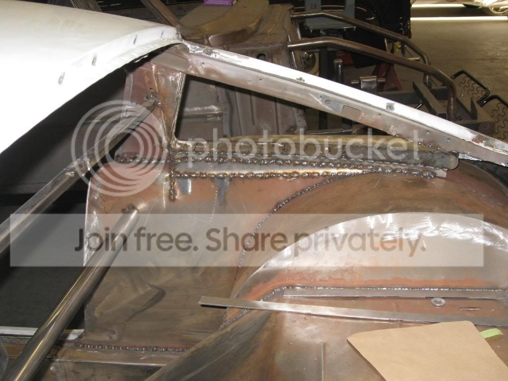

jephs422 04-29-2009 09:54 AM

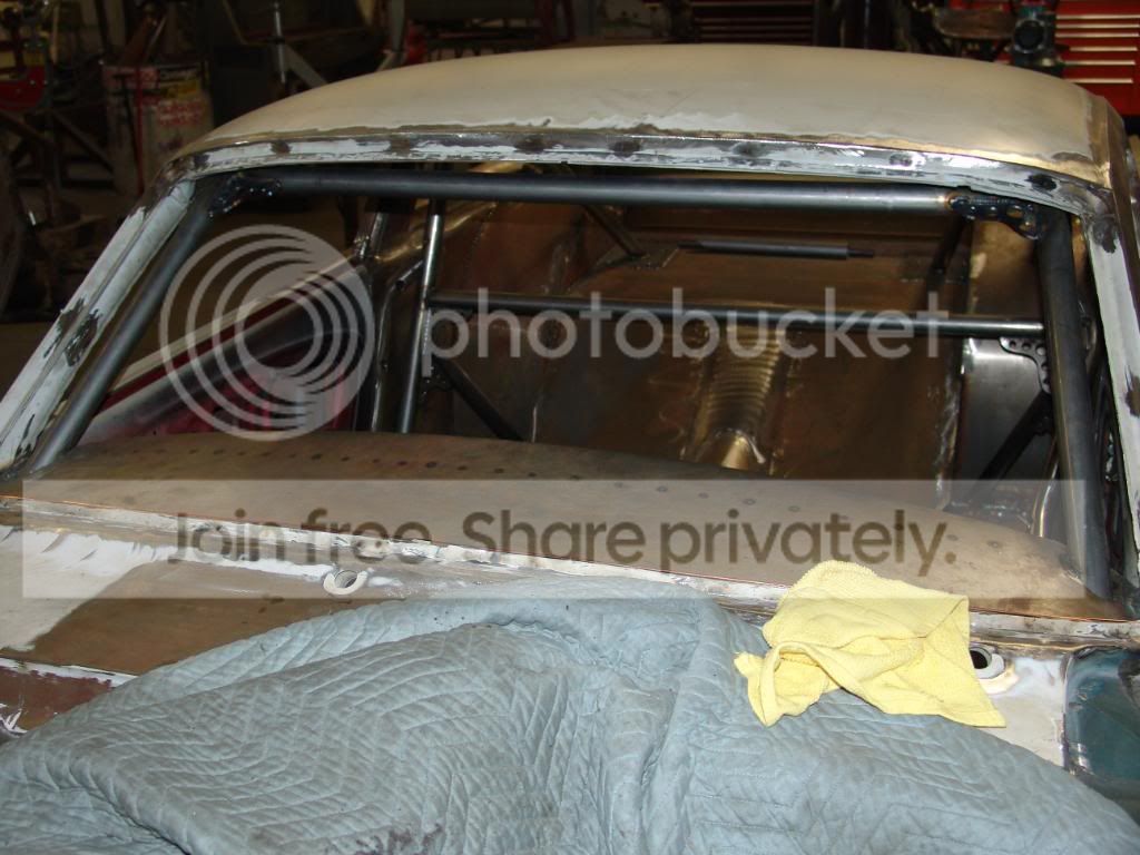

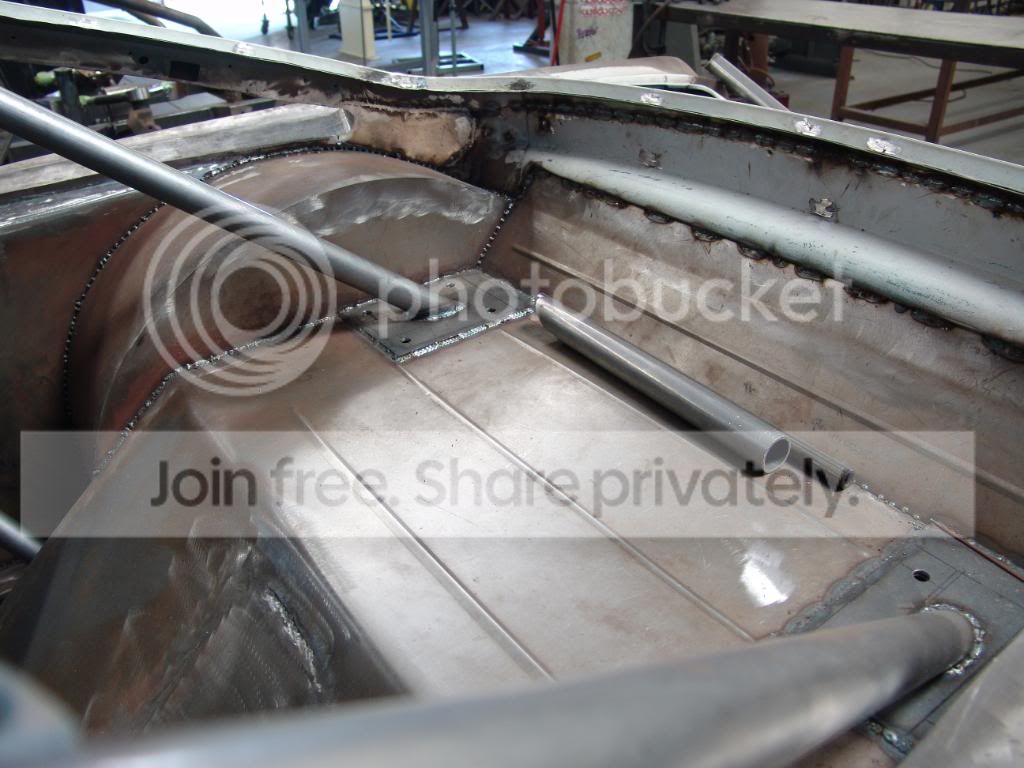

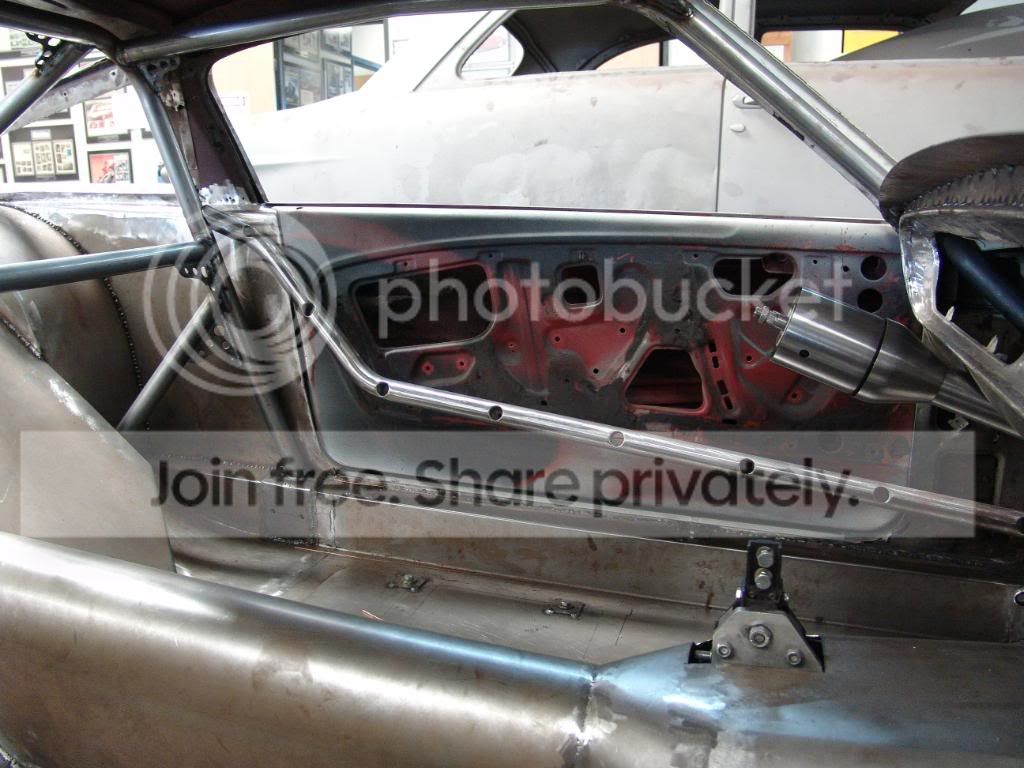

Roll cage is in as of this week.
We opted to do a bolt in (sort of) so the body could be removed for final finish on the chassis. There are plates welded to the frame, and to the body that will bolt together.
The door bars are not in and complete yet, but the rest is.
http://i353.photobucket.com/albums/r...g/DSC07197.jpg
http://i353.photobucket.com/albums/r...g/DSC07195.jpg
http://i353.photobucket.com/albums/r...g/DSC07191.jpg
http://i353.photobucket.com/albums/r...g/DSC07189.jpg
jephs422 04-29-2009 10:00 AM

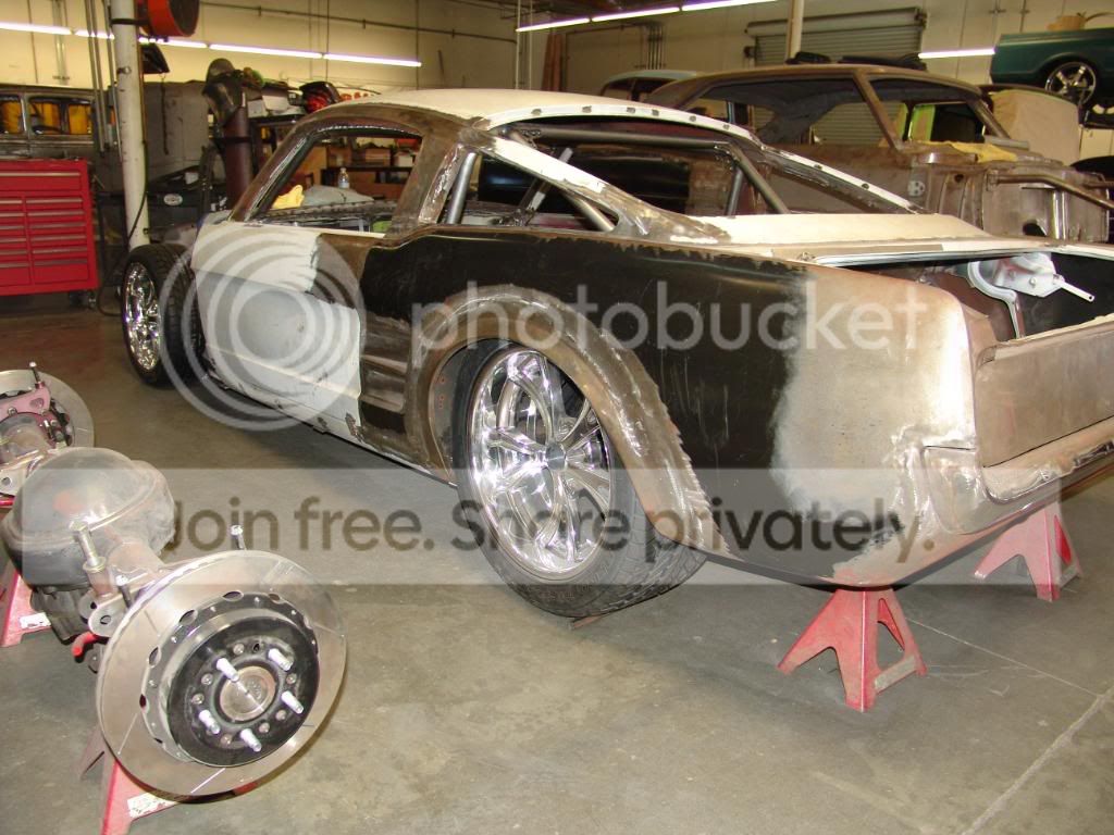

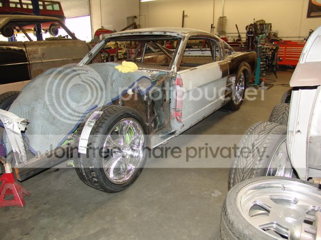

Got the wheels and tires in place too...
The tires are being replaced for a different profile though.
http://i353.photobucket.com/albums/r...g/DSC07202.jpg
http://i353.photobucket.com/albums/r...g/DSC07203.jpg
