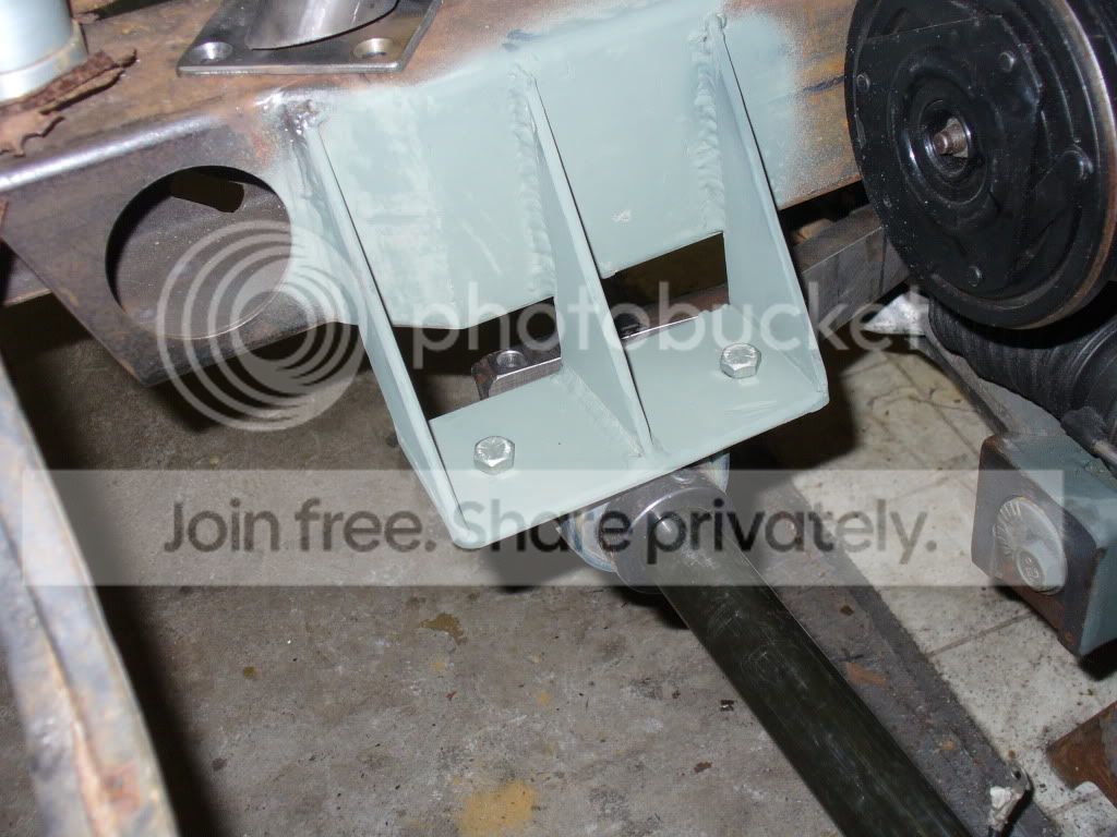

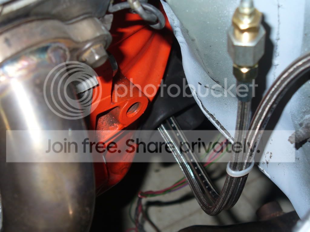

More progress last weekend, finished up the sway bar, and pulled the tranny out so I could get the new hydraulic slave in. Also mounted the clutch and new smaller brake master. Now I have clearance for my front down bar on the drivers side. Just about talked into throwing a cam in it while I have access to the front of the motor and the balancer is off. Any suggestions? Magic Stick 3? TR228r? EPS cam?
http://i539.photobucket.com/albums/f...d/P1030731.jpg
http://i539.photobucket.com/albums/f...d/P1030728.jpg
http://i539.photobucket.com/albums/f...d/P1030729.jpg
http://i539.photobucket.com/albums/f...d/P1030727.jpg
http://i539.photobucket.com/albums/f...d/P1030732.jpg

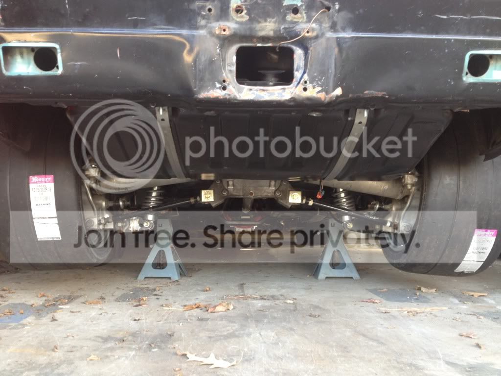

Beach Cruiser 02-18-2012 02:17 PM

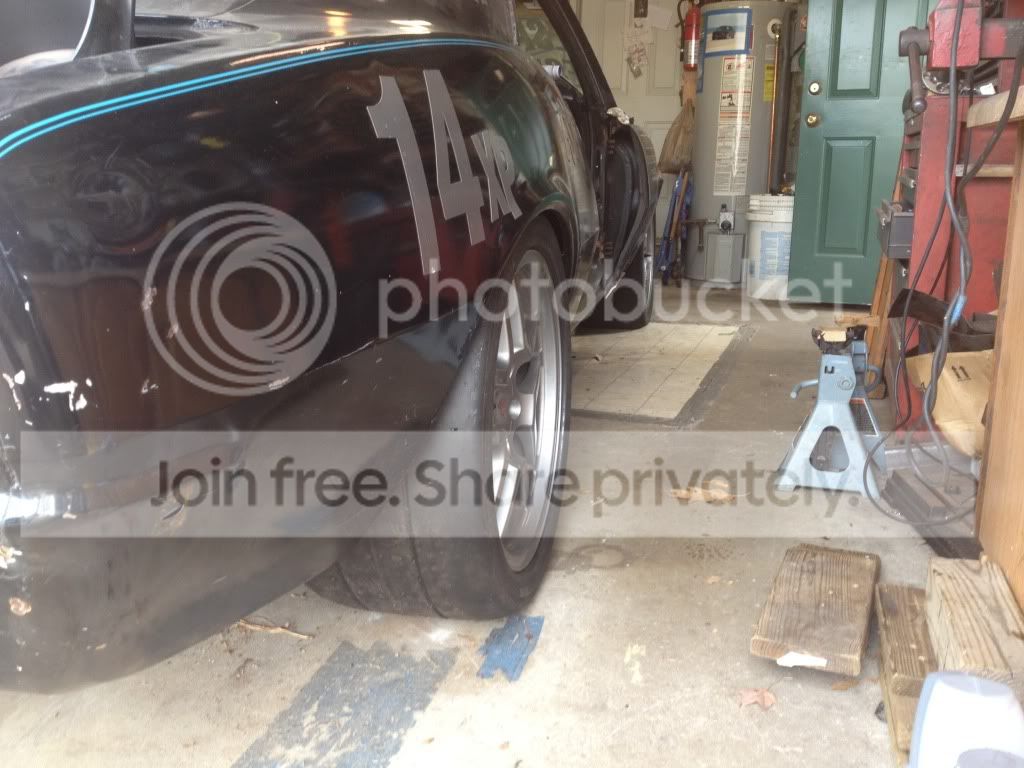

Put her new shoes on today and put her back on the ground!
http://i539.photobucket.com/albums/f.../IMG_00721.jpg
http://i539.photobucket.com/albums/f.../IMG_00771.jpg
http://i539.photobucket.com/albums/f.../IMG_00742.jpg
http://i539.photobucket.com/albums/f.../IMG_00751.jpg
waynieZ 02-18-2012 03:21 PM
It looks good with those big sneakers back there.

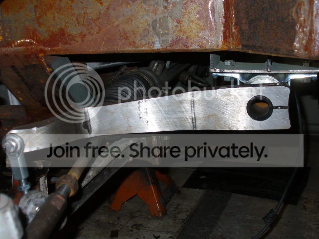

So whose and what rate and size front sway bar did you go with? Also need arm length. Thanks.
Beach Cruiser 04-03-2012 08:25 AM
It's a speedway engineering front splined bar, it's 1-1/4 Dia, and it's the thinest wall they make in that size. Arms are also Speedway Engineering, custom bent to CoolWelders Specs (he bent them for me)
Track Junky 04-03-2012 08:37 AM
Whats the rate and what size arms. Been thinking about a top mount sway bar for more travel and I'm getting rates all over the map from DSE(1529 lb/in), Global West(1259 lb/in), Hotchkis(750 lb/in), Hellwig(720 lb/in). How did you go about choosing what rate to go with? The Speedway 42"x1 1/4" solid bar with a 10" arm is rated at 498 lbs/in so with the rates given above I'm not sure where to start.
Beach Cruiser 04-03-2012 08:43 AM
I leaned on a lot of other people and thier opinions. I chose the softest bar in 1 1/4 to start with. Once it's all put together its pretty easy and not to expensive to swap out the bar if all the other componets are there. I havn't driven it yet, so it's and educated shot in the dark! But you gotta start somewhere. Here's a link to speedways Chart http://www.1speedway.com/swaybar42.htm
When I get home I'll measure the length, I don't remember it off the top of my head.

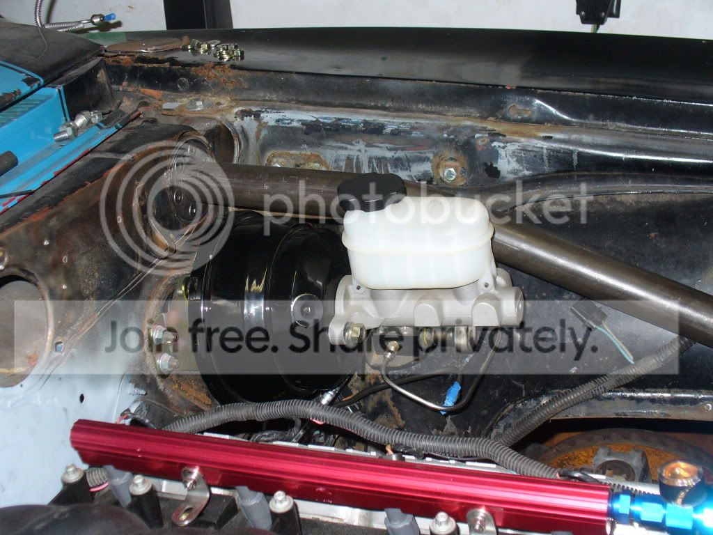

More updates, worked on the fuel tank today, major PIA gotta find 1/4" somewhere to take out the the assembly.
http://i539.photobucket.com/albums/f...g/P1030557.jpg
http://i539.photobucket.com/albums/f...g/P1030558.jpg
http://i539.photobucket.com/albums/f...g/P1030559.jpg
http://i539.photobucket.com/albums/f...g/P1030560.jpg
http://i539.photobucket.com/albums/f...g/P1030566.jpg
Beach Cruiser 04-26-2012 07:35 AM
Fuel pump assembly is from a 99-2002 F-body. Tips? after I welded it all up, I etched the inside and coated it with some sort of resin, but I'm not sure what it is. There are companies that sell a fuel tank restore kit and that's what I used. Coating will seal any pit holes that you missed on the weld. Good Luck! it's tedious cutting down the pump, but it will fit you just have to be clever about it. Get the whole tank so you can cut out the locking ring. Tanks are plastic, so cut it out and then use a wire wheel or something to get down to the metal.

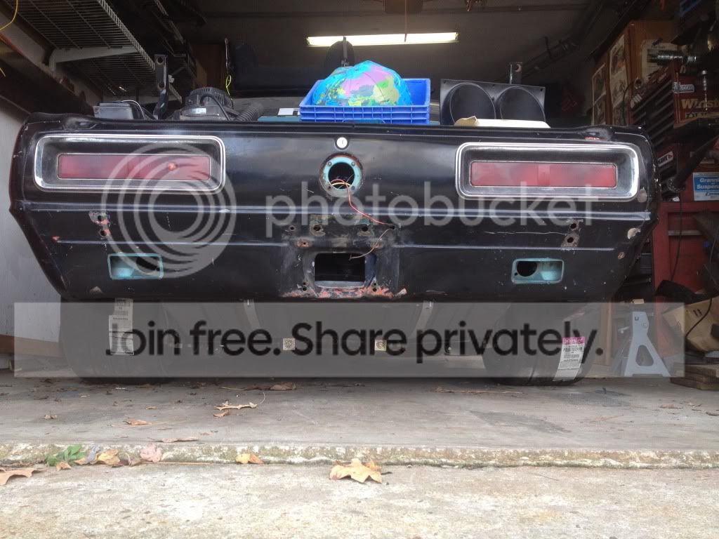

Here's the new fuse panel installed in the car
http://i539.photobucket.com/albums/f...ld/null-20.jpg

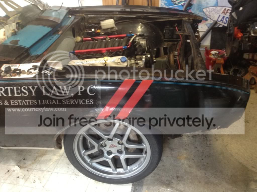

Beach Cruiser 11-12-2012 01:50 PM

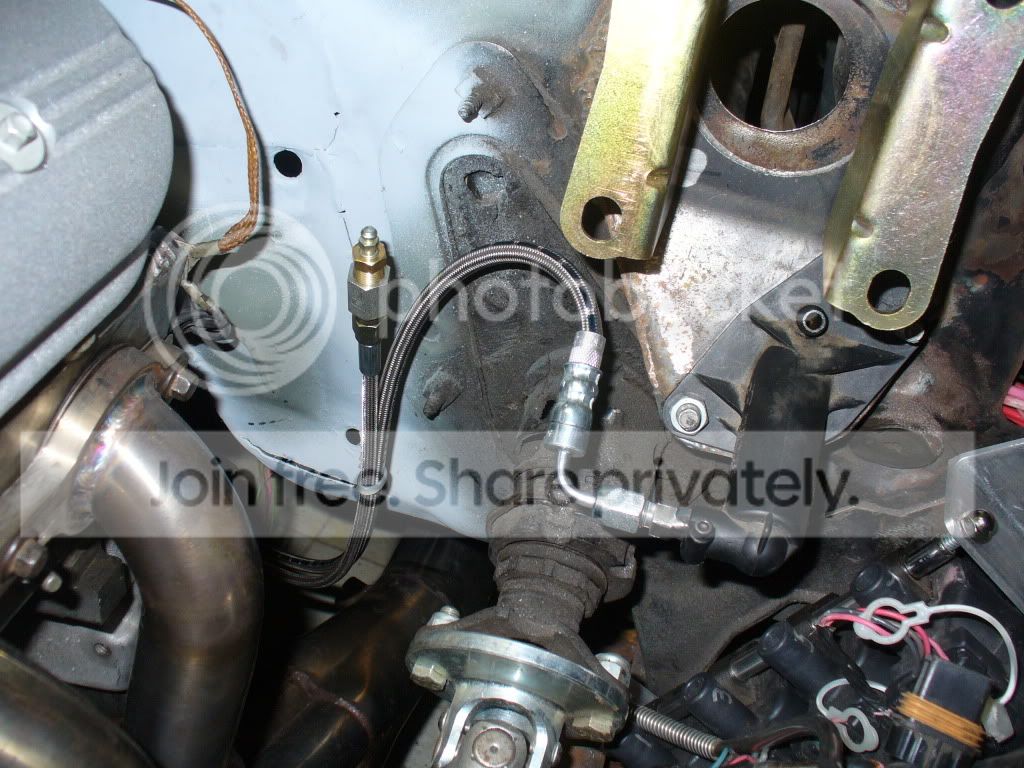

Ok, I'm finishing up the swap in my 67 Camaro and I'm having some trouble keeping it running. Then engine fires right up and the idle attempts to adjust then it dies after 5-7 seconds. Almost like I turned off the key. It will do this over and over again but won't stay running. Could it be the VATS? I pulled all that wiring out of the harness and grounded the yellow/black wire thinking that would bypass it, is that the right approach? Should I have the VATS programmed out of the ECU? Not sure where to start with this one, this is my first LS swap. I'm just glad it fired up on the first attempt! Drinking my beer now waiting for help from you guys! :hail:
http://i539.photobucket.com/albums/f...ld/null-34.jpg
http://i539.photobucket.com/albums/f...ld/null-31.jpg
seancarole 11-13-2012 04:56 PM
Looking good man. Ya need to delete the vats not sure off hand on those wires. WWW.LT1SWAP.COM
