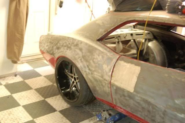

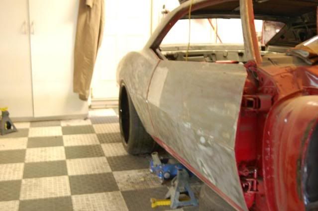

I cut the lip off the wheel wells today. I left 1/4 inch of lip. Im going to weld in a piece of round bar to finish it up.
I placed the rear wheels under the car so I could get a measurement for my rear end. Its 54 1/2 to the center of each pad. Tomorrow I call and order my Morrison rear end! Woo hoo
http://img.photobucket.com/albums/v1...DSC_0062-1.jpg
http://img.photobucket.com/albums/v1...v/DSC_0064.jpg
http://img.photobucket.com/albums/v1...DSC_0066-1.jpg

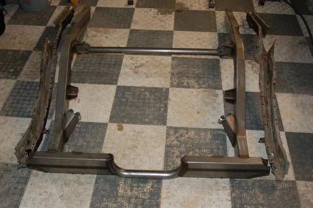

camaro2nv 07-09-2009 05:26 PM
6 Attachment(s)
Well got the call today. The shipping company called and said my "car frame" was ready for pickup. I ran down to the yard and they loaded it up. This baby is nice! Morrison did a heck of a job! A second shipment should follow soon. It will have the axles and gears.

camaro2nv 07-10-2009 11:10 PM

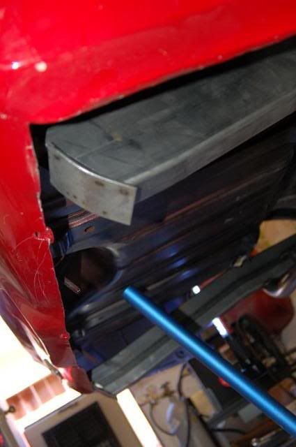

Thanks guys! I got started tonight. I started drilling out the spot welds on the rear frame rails. I got 95% of them drilled out. Man what a pain in the arse! I think the spot weld guy at the factory went nuts on my car,lol. I should have the Morrison in by next week. I hope! Frank, wheres those gears and axles,lol

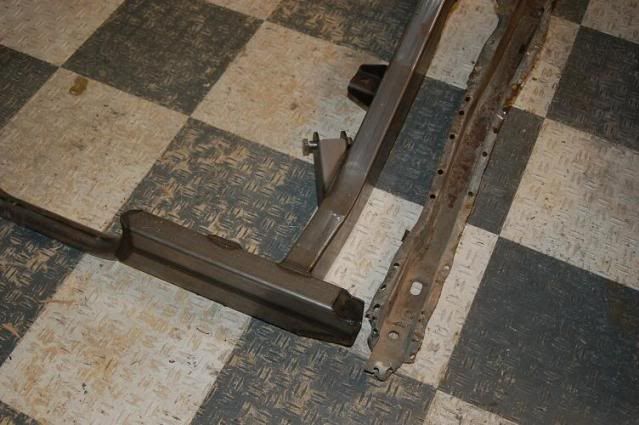

Ok I got the rear frame rails out. They didnt go without a fight! I did notice a few rusted out holes in the rear floor pan. I think Ill just replace it before I put the Morrison in.
Heres a side by side shot
http://img.photobucket.com/albums/v1...v/DSC_0183.jpg
http://img.photobucket.com/albums/v1...v/DSC_0182.jpg
70rs 07-13-2009 06:36 PM
It is amazing looking at the factory vs Morrison rails side by side. Just thinking about the abuse the factory rails put up with in our cars, how did they even hold up?

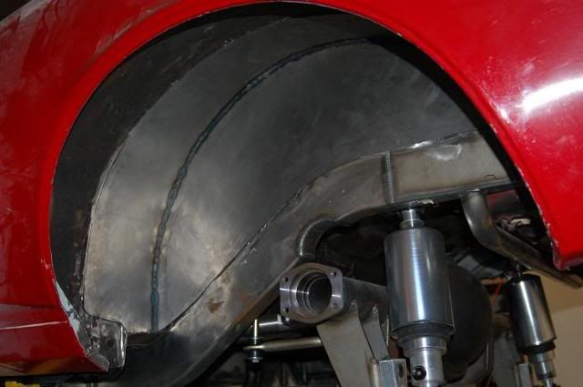

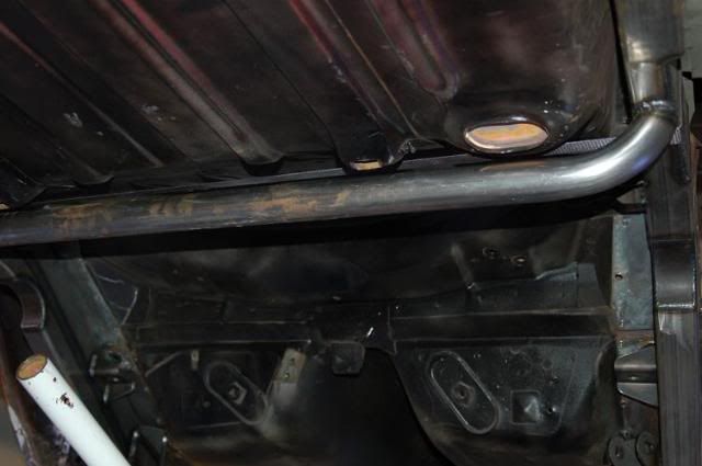

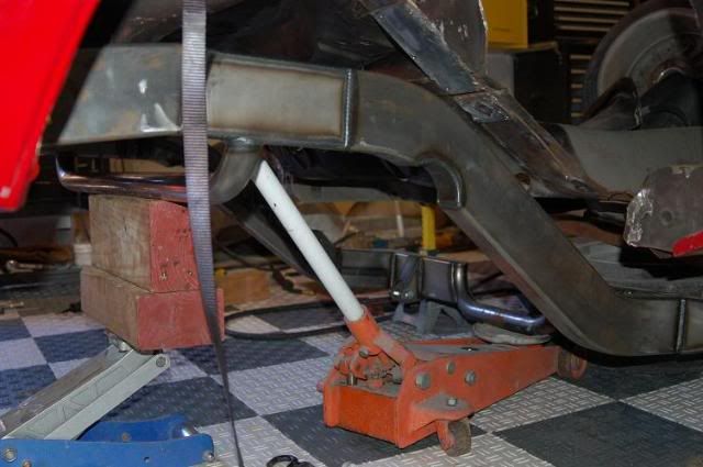

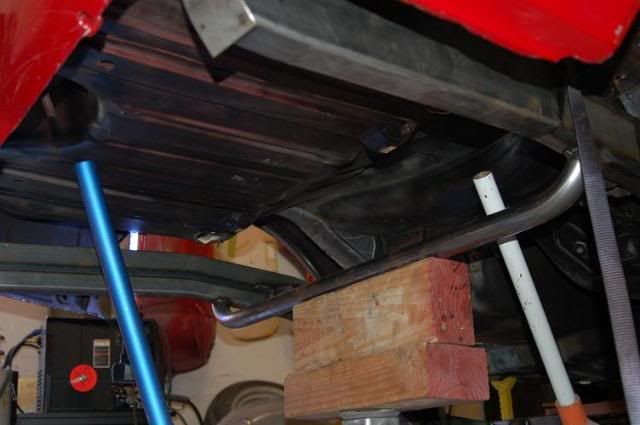

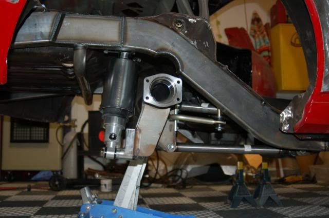

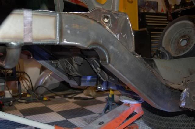

Sunday afternoon, time to put some work in. Boy this Morrison rear clip fits like a glove. It fit so tight I dont know how measurements could be off. I still have to weld it in but I got it in place for now.
Raise the rear first to get it in place.
http://img.photobucket.com/albums/v1...v/DSC_0186.jpg
Little bit from the front and rear jacks now
http://img.photobucket.com/albums/v1...v/DSC_0187.jpg

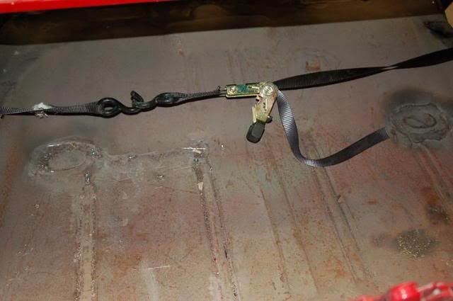

Added a ratchet strap to help with the one man show,lol
http://img.photobucket.com/albums/v1...v/DSC_0189.jpg
3.2.1....
http://img.photobucket.com/albums/v1...v/DSC_0191.jpg
CONTACT!
http://img.photobucket.com/albums/v1...v/DSC_0192.jpg
http://img.photobucket.com/albums/v1...v/DSC_0197.jpg

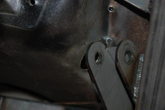

These are the only two holes you need to drill on each side. That way you can get to the nut
http://img.photobucket.com/albums/v1...v/DSC_0202.jpg
Thats it for now. Later on when it cools off in the garage Ill tack it in pace and put the rear axle in place. 105 outside is just too hot, I bet the garage is 120.:cheers:

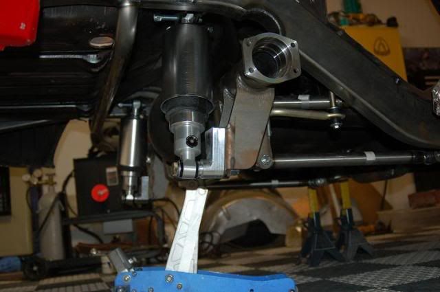

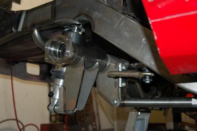

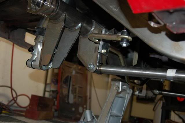

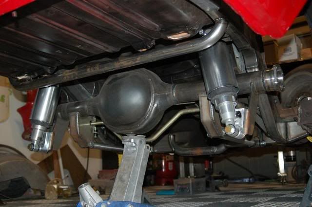

Ok so got the rear end mounted. Man she looks good! Cant wait to get the tru track in!
http://img.photobucket.com/albums/v1...v/DSC_0206.jpg
http://img.photobucket.com/albums/v1...v/DSC_0207.jpg
http://img.photobucket.com/albums/v1...v/DSC_0208.jpg
http://img.photobucket.com/albums/v1...v/DSC_0213.jpg
http://img.photobucket.com/albums/v1...v/DSC_0214.jpg

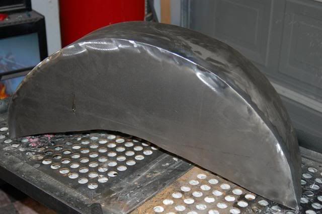

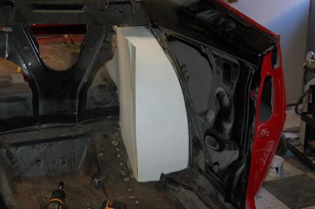

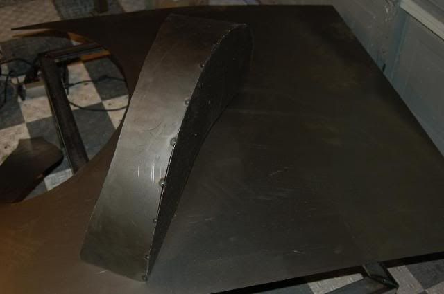

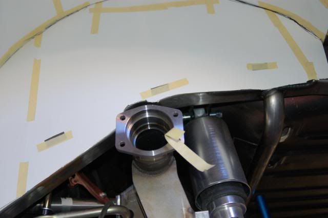

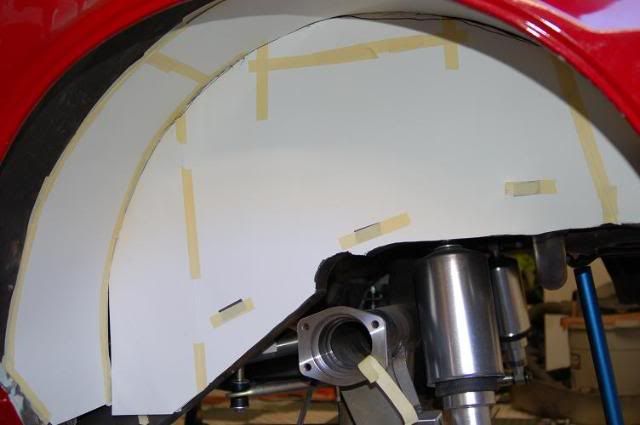

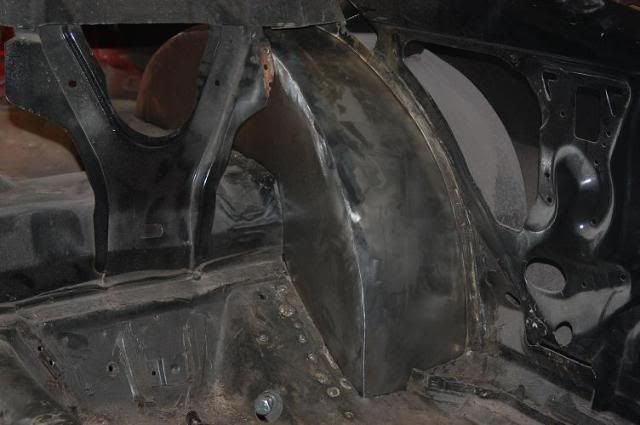

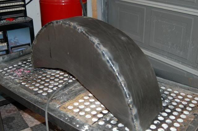

After getting the rear clip tacked in I put the DSE tubs in there locations. I didnt care for the way they hide the Morrison frame rail. I want them to butt up to the rail and not overlap it. Im also running 345mm rear tires. I need all the room I can get. So I pulled out the poster board and started cutting it up. Heres what I came out with. This part has been fun for me because Ive never done fab work like this. Its givin me some time behind the welder. Its not welded in yet, I wanted some feedback first. Thoughts??
http://img.photobucket.com/albums/v1...v/DSC_0218.jpg
http://img.photobucket.com/albums/v1...v/DSC_0217.jpg
http://img.photobucket.com/albums/v1...v/DSC_0220.jpg
http://img.photobucket.com/albums/v1...v/DSC_0223.jpg
http://img.photobucket.com/albums/v1...v/DSC_0225.jpg
http://img.photobucket.com/albums/v1...v/DSC_0227.jpg
http://img.photobucket.com/albums/v1...DSC_0228-2.jpg
http://img.photobucket.com/albums/v1...v/DSC_0230.jpg
http://img.photobucket.com/albums/v1...v/DSC_0235.jpg
