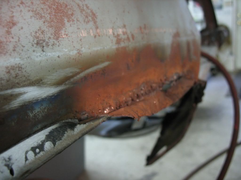

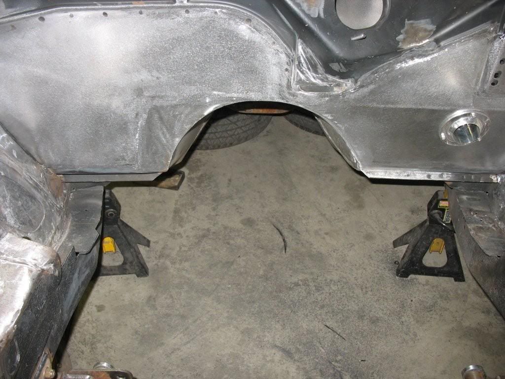

Growing list of issues...
-Wheel tubs were butchered; quarter panels damaged (warped) during the process
-The spoiler and deck lid are beyond repair - new deck lid and spoiler in the works
-All the patch work (door handles, marker lights, etc) were warped to hell - poor fitment, bird poo mig welds, not metal finished.
-Hard stone grinding disc used on the quarter skins, firewall, tubs, so there are tons of thin areas with holes
-Inner fenders had over a ½” of bow to them. Seams are lap welded, pieces scabbed over the suspension mounts, poor fitment at the subrails (filled void areas with weld).
-Cowl patches butchered (previous patches cut out and replaced)
-Firewall warped to hell from various patches that were poorly done (cut out and replaced)
-Front core support wasn’t straightened out before the inner fenders were attached (straightened, ready for new inner fenders)
-The car was bent upwards from the sub rails forward (snow plow effect). The front end relaxed over 1/2" once the inner fenders were cut out.
-The tunnel was butchered. Ned worked on it quiet a bit, and we addressed the opening shape during the firewall fab process (smooth continuous radius).
-The rocker replacement on the driver’s side needs to be replaced – bowed, fitment is terrible, lap welded on the bottom.
-Weld seams at the qtr panel to sail panel flange had to be cut out and replaced. The panels weren't lined up before he went to town with the welder. The seams were then ground down with a hard disc, which created thing areas next to the weld. Impossible to metal work the area because of the over abundance of weld even if the metal wasn't so thin around it.
-Driver's side quarter panel alignment at the deck lid was longer than the passenger side (corner structure wasn't supported correctly during the skin install). The shape didn't match either when looking at the car from the back.

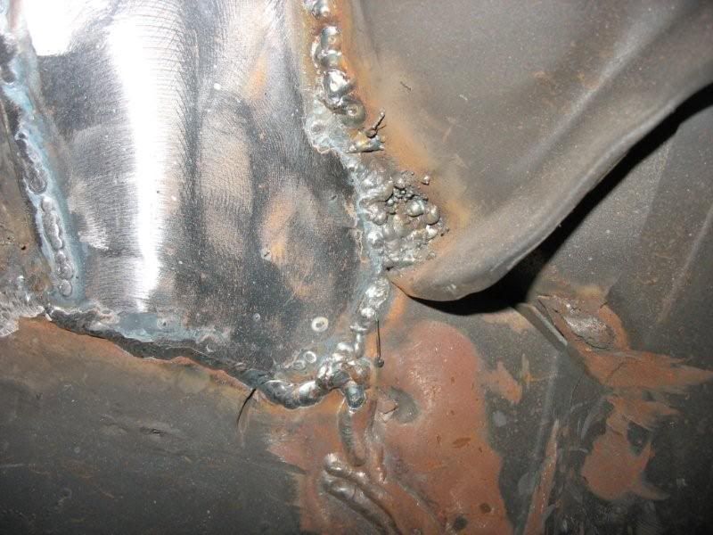

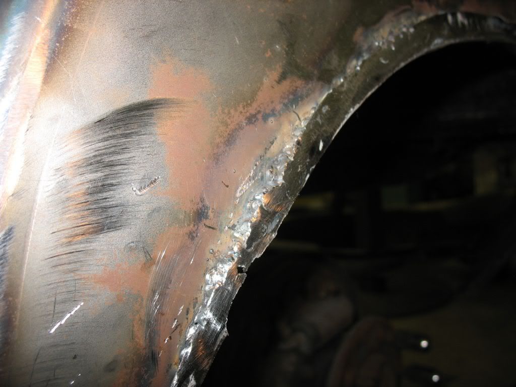

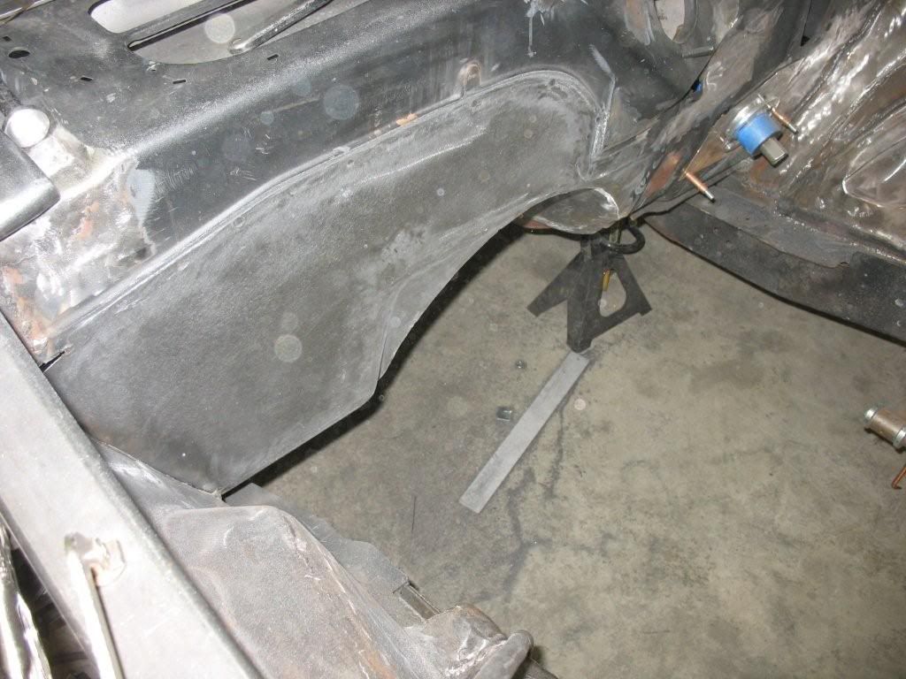

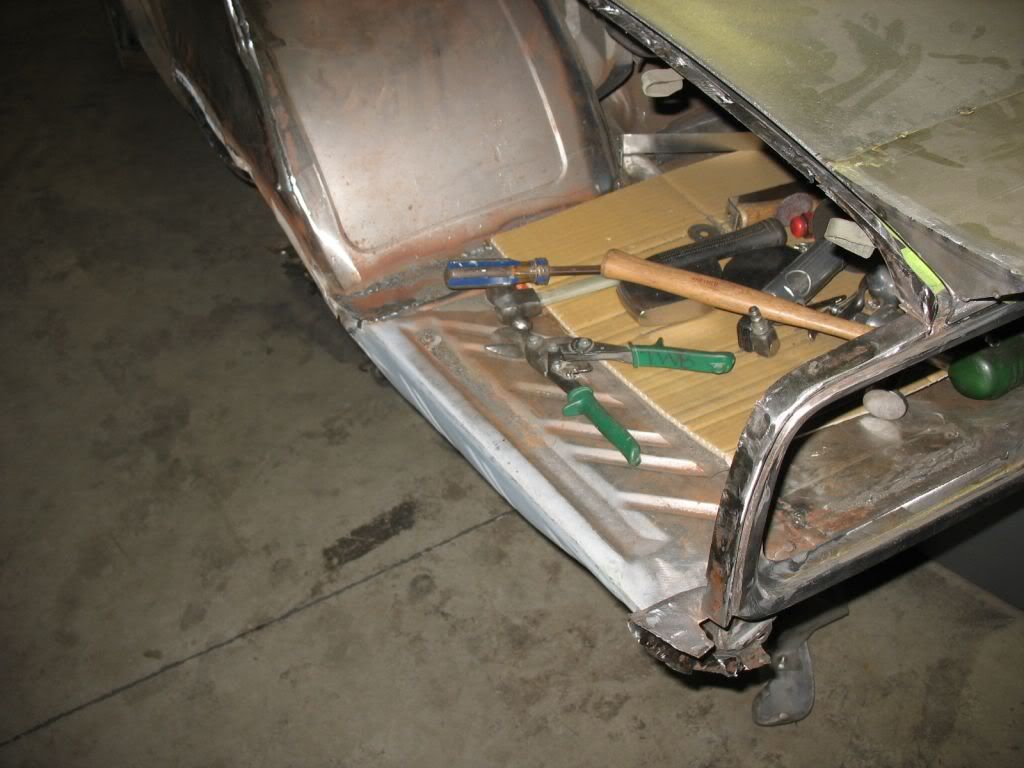

Updates.... Tim has been cutting the car all to hell. Everytime he turns around there is some aspect that Chris butchered... what the hell he was thinking is beyond us all..... I've decided to open my own shop and have my 6 year old son do the welding... it would turn out just as nice...
So ....more carnage.... you may want to have a garbage can near by to catch your vomit...
Anyone like modern art?
http://i229.photobucket.com/albums/e...chescutout.jpg
http://i229.photobucket.com/albums/e...byRaceRodz.jpg
http://i229.photobucket.com/albums/e...cowlpatch3.jpg
http://i229.photobucket.com/albums/e...dersbefore.jpg
http://i229.photobucket.com/albums/e...ersbefore2.jpg
Now that is quality craftsmanship at its finest....

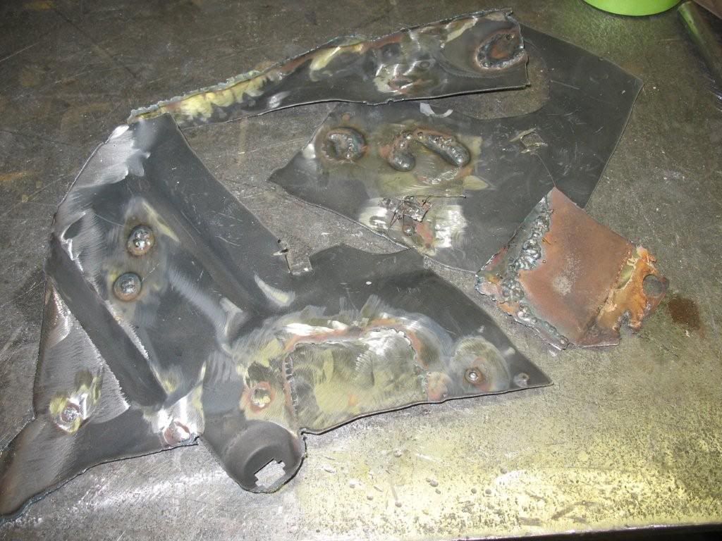

DRJDVM's '69 12-17-2008 04:27 PM
This is the firewall piece after it was cut out.....nice and flat.....did you guys know that metal likes to warp when you heat it up to 1000 degrees with a MIG ? I guess Chris didnt...
http://i229.photobucket.com/albums/e...ewallpiece.jpg
Chris filled the rear seam..welded it when the panels didnt real line up and then ground the hell out of it. The metal was so thin Tim could crack it with his finger.....
http://i229.photobucket.com/albums/e...sengerside.jpg

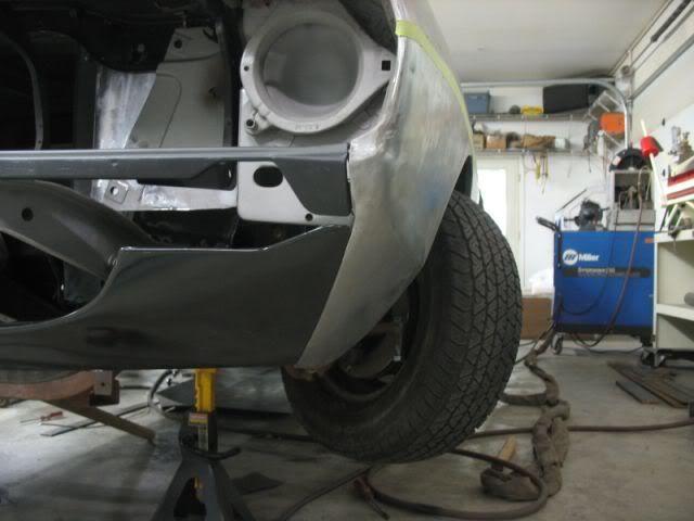

Its gets better...... with all the sheetmetal work and heat he put into the front end with all the overzealous MIG work, the front driver side corner warped upward about half an inch !! When Tim cut all the junk out it actually sprang back down to where it should be.... Tim is gonna get it all lined up right....
http://i229.photobucket.com/albums/e...tmockup017.jpg

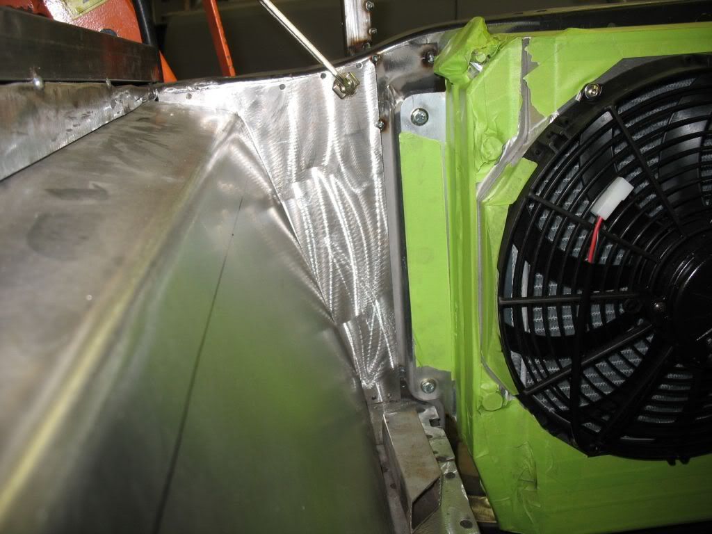

Okay....now the "after" stuff....
New firewall....nice, clean and FLAT.....
http://i229.photobucket.com/albums/e...lupdate001.jpg
http://i229.photobucket.com/albums/e...shapeafter.jpg
Trunk gaps and the seam was cut out and a patch welded in...
http://i229.photobucket.com/albums/e...removed004.jpg
New cowl patches done..
http://i229.photobucket.com/albums/e...ssengersid.jpg

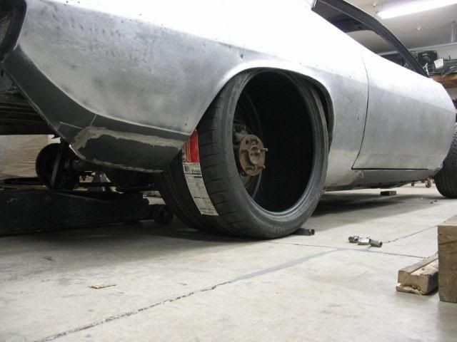

This is the ride height we are shooting for... it looks like with the 20's in the rear we may have to mess with the mounts to get it to sit right..
http://i229.photobucket.com/albums/e...ideheight2.jpg

the only way to metal finish a but welded panel like bruning is tig, its looks like there using reg filler, but silicon bronze works very well and keeps the heat down when welding and metal finishing

Tig. Mig welding has its place (not trying to sound like a tig or bust snob), but not for light gauge sheet metal work.
Tim used silicon bronze filler on some of the thin areas around the quarter skin. The patch was fit and fusion tacked in place. Very little filler rod was needed. The upper section above that patch was also replaced right below the window area.

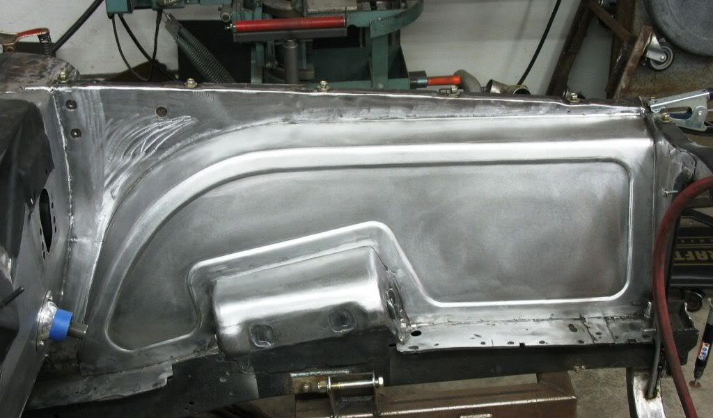

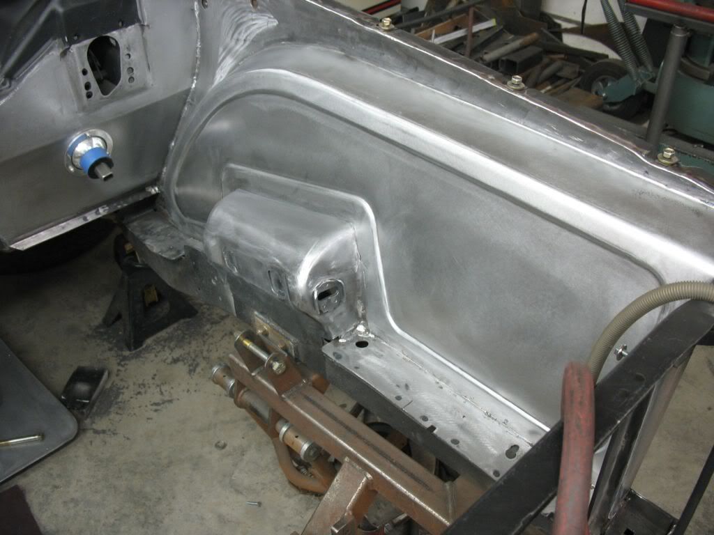

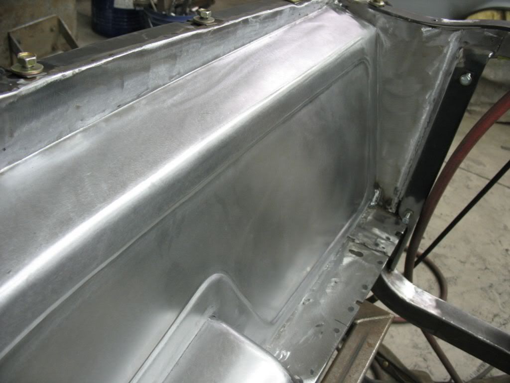

tjbruning 12-18-2008 03:18 PM
How much would it cost a body man to make this panel flat with filler?
inner fender removed
http://img338.imageshack.us/img338/6...ates002cz7.jpg
back side
http://img509.imageshack.us/img509/6...ates004wu6.jpg
or this?
new panel - still in the works... (There is a brace tacked in place supporting the fender mounting flange)
http://img509.imageshack.us/img509/6...fender2xb8.jpg
http://img518.imageshack.us/img518/9...fender4cg4.jpg
back side radius corner
http://img509.imageshack.us/img509/1...erbackswk4.jpg

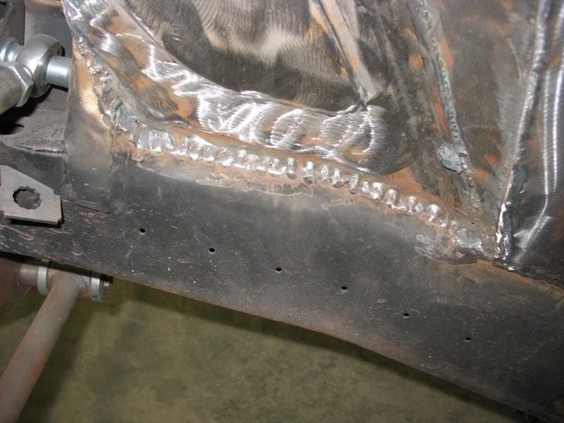

Two pieces fusion tacked (no filler) for perfect fitment - Weld is virtually seamless after it is fully welded and metal finished.
http://img206.imageshack.us/img206/7...ates003rq3.jpg
Backside of radius
http://img254.imageshack.us/img254/8...ates005wb3.jpg

No worries... The initial tacks are fusion tacked together, but Tim used .030 filler rod when final welding. Machine is set at ~50 amps (but modulated with pedal)- Syncrowave 250, water cooled, foot pedal.
reckn8 12-24-2008 07:56 AM
Man I think the MIG welder is getting a little bit of a bad name here. Like any other tool, it is 98% the person running the machine.

The innder fenders are all done and turned out awesome......
http://i229.photobucket.com/albums/e...fenders003.jpg
http://i229.photobucket.com/albums/e...fenders001.jpg
http://i229.photobucket.com/albums/e...fenders007.jpg

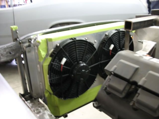

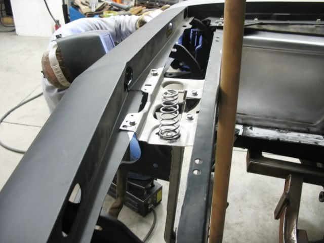

Ron Davis radiator all mounted up...Tim re-did the front rad support and moved the mounts outward so I could get a bigger radiator in there
http://i229.photobucket.com/albums/e...dlayout013.jpg
http://i229.photobucket.com/albums/e...rogress018.jpg

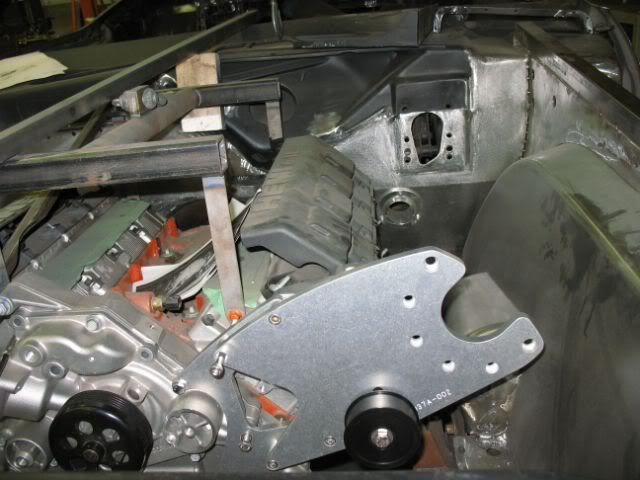

After much back and forth with with Rodger at Ironworks (thanks again) and Procharger, I was able to get a procharger bracket for the 6.1 HEMI, so I could make sure the inner fender design would allow a unit to fit. However it looks like the Procharger might be "off the plan" due to budget issues, but it may still happen and at least I know it will fit.
http://i229.photobucket.com/albums/e...updates011.jpg

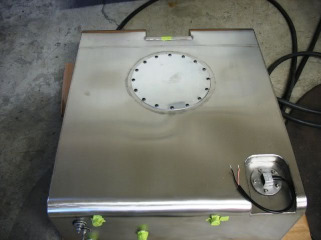

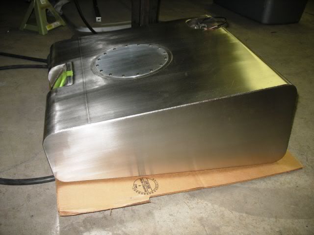

My Ricks tank...thank you Hector.....
http://i229.photobucket.com/albums/e...9RicksTank.jpg
http://i229.photobucket.com/albums/e...rickstank2.jpg
