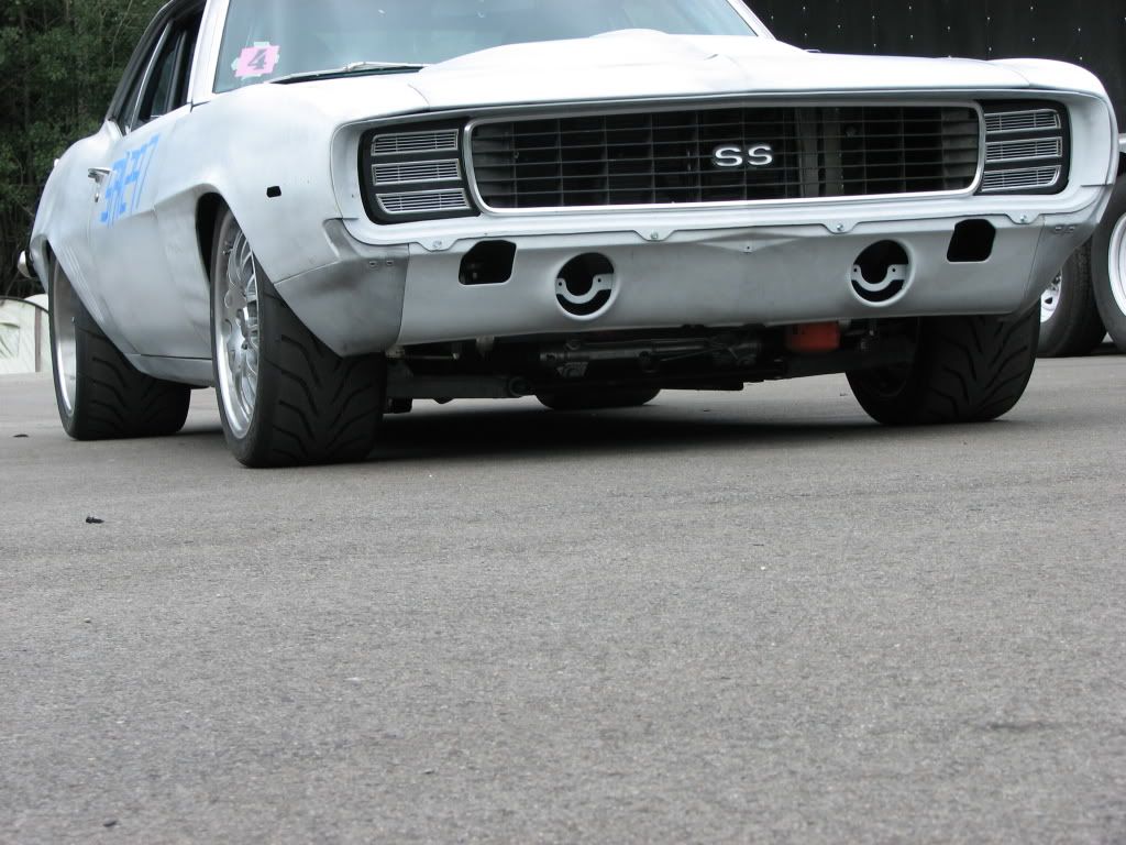

Jake what is the ride height of the bottom of the subframe at ride height? I picked up a Camaro from Tyler a few weeks ago and I want to do a bolt togther project for once. I'm looking at a 26" tall tire.
Rodger
68protouring454 11-29-2008 01:48 PM
At the designed ride height, which is pictured below, the front engine cross member has 5.0625 clearance and the undercar rails have 4.0 ground clearance. With custom headers that stay above the under car rails, the car is a joy to load on and off a trailer at this height.
http://i239.photobucket.com/albums/f...IMG_1657-1.jpg
