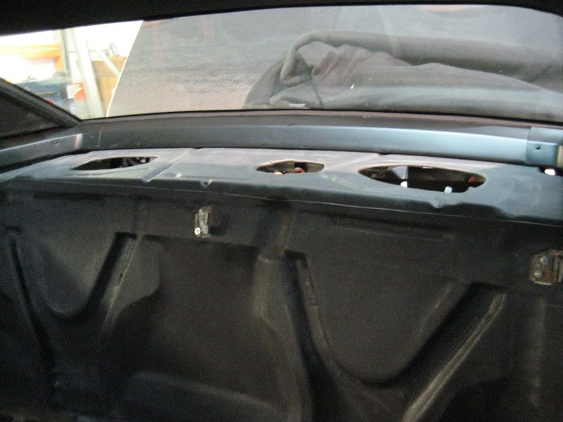

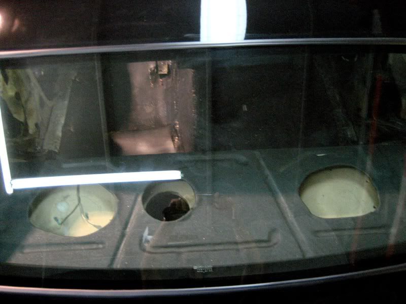

Ok Here is the Package tray and rear seat area
Covererd with sound deadening
http://i700.photobucket.com/albums/w...9/IMG_0998.jpg
http://i700.photobucket.com/albums/w...MG_1000-11.jpg

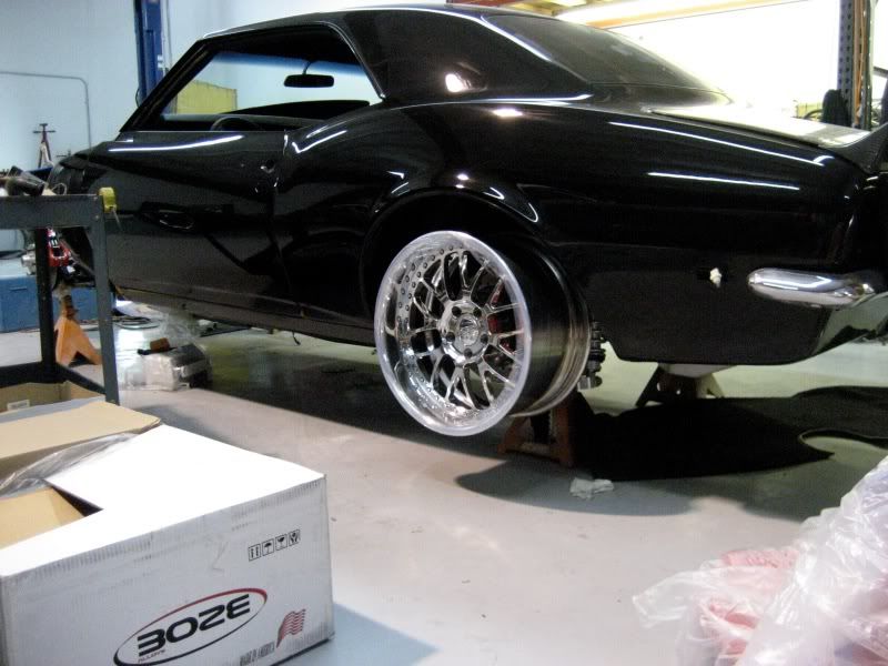

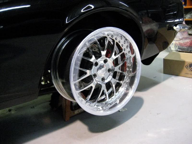

Special thanks to Zak Kingsland @ Boze Alloy's for getting me the rear wheels in (Pro-Touring Mesh) 19 X 10
http://i700.photobucket.com/albums/w...-RearWheel.jpg
http://i700.photobucket.com/albums/w...earWheel-1.jpg

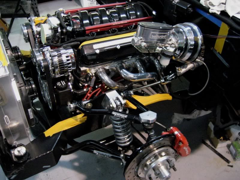

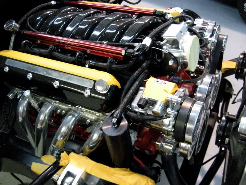

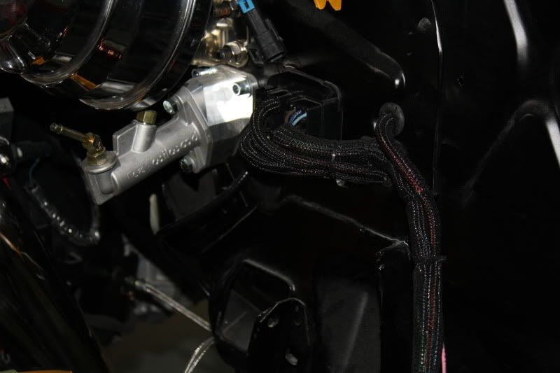

Also Tom is finishing up the wiring harness on the engine special thanks to John @ Speartech! **please note orange tape not incuded LOL
http://i700.photobucket.com/albums/w...s-Engine-2.jpg
http://i700.photobucket.com/albums/w...s-Engine-3.jpg
http://i700.photobucket.com/albums/w.../Ls-Engine.jpg

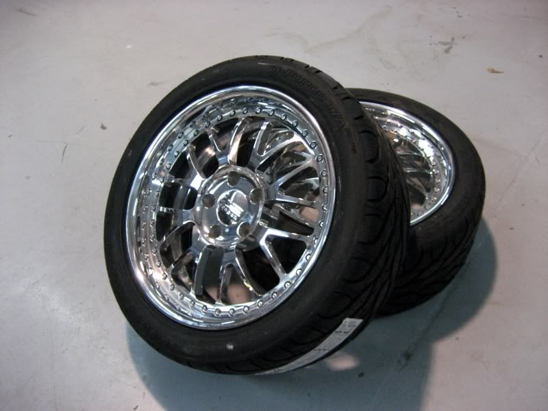

Wheels Mounted

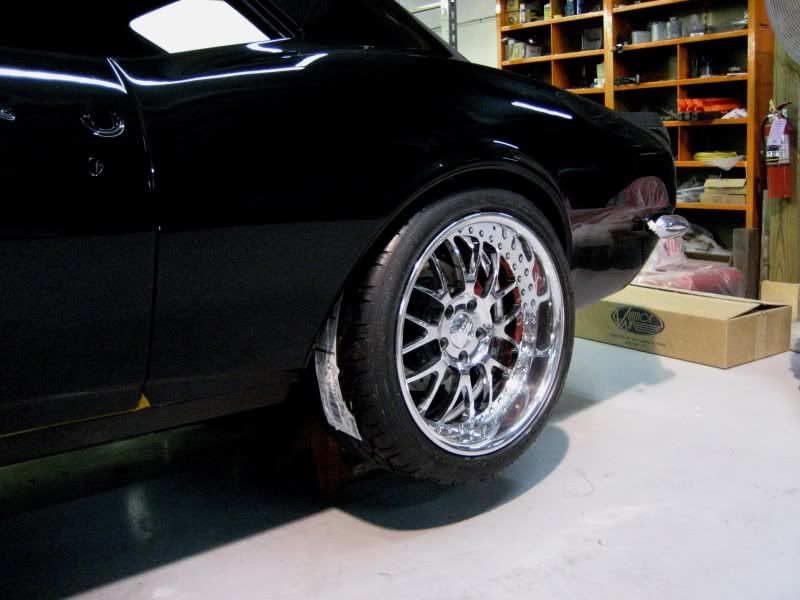

We Mounted the Front and Rear tires today
Rear 19 X 10 with 5.5 Backspacing and the 275/35ZR-19 BFGoodrich g-Force T/A KDW 2
http://i700.photobucket.com/albums/w...-275-35-19.jpg
Here are the fronts 18 X 8 245/40ZR-18 BFGoodrich g-Force T/A KDW 2
http://i700.photobucket.com/albums/w...rontWheels.jpg
skatinjay27 04-02-2009 01:52 AM
those are my faviorate wheels!!!
they were the first set i wanted for the my car and even with all the other wheels I have seen and love everytime someone shows these i forget about all the rest!
are they the pro-touring(2 piece) or the mesh(3 piece)?
btw love the car!

AJ,
Thanks for the Complement!
they are the pro-touring(2 piece) to look like the mesh! Thanks to Zak @ Boze

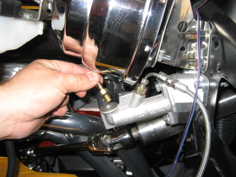

Installing Unisteer complete rack and Steering Shaft w/Column Bearing from Speed Tech Performance
Blake and Roger are Great to work with! The Best customer service bar-none!!

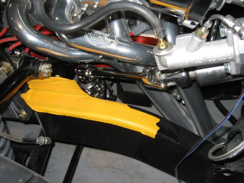

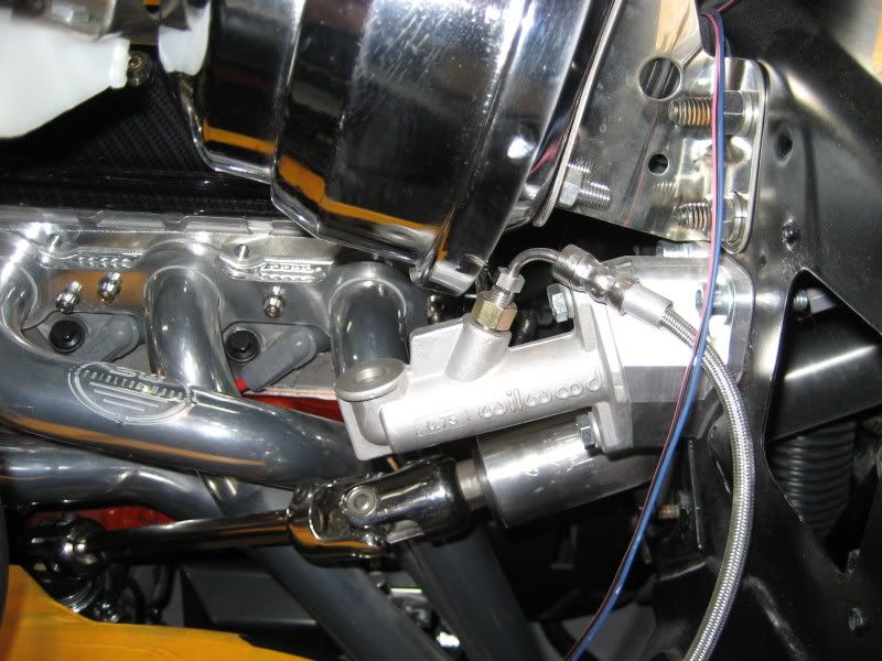

Also Installing Clutch Master Cylinder from Keisler Engineering T-56 TKO-600 Kit
http://i700.photobucket.com/albums/w...Picture014.jpg
http://i700.photobucket.com/albums/w...Picture015.jpg

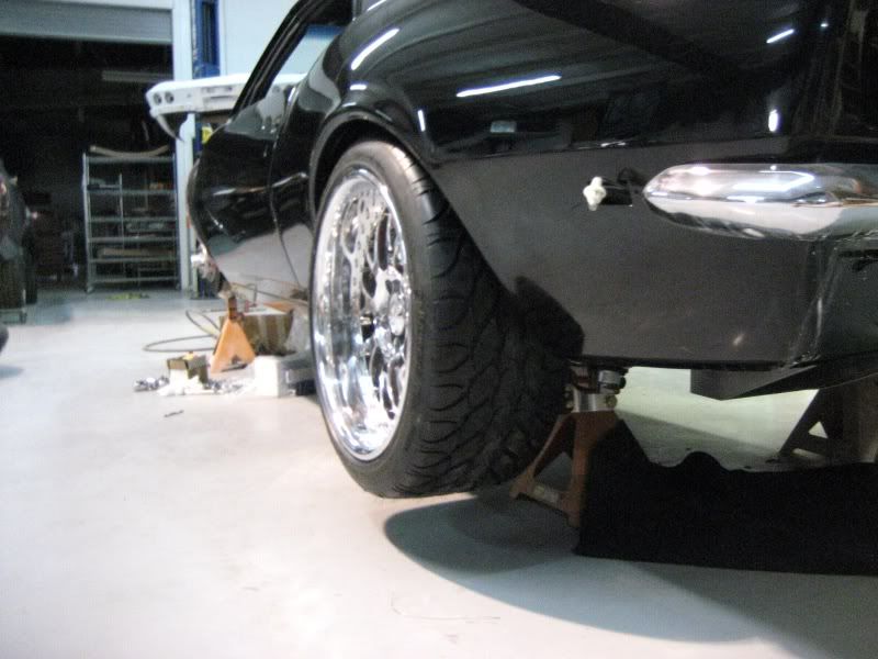

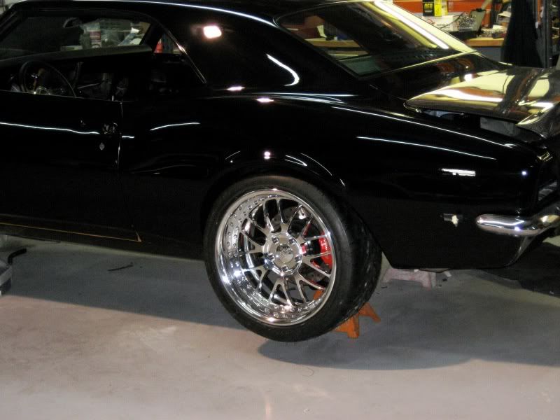

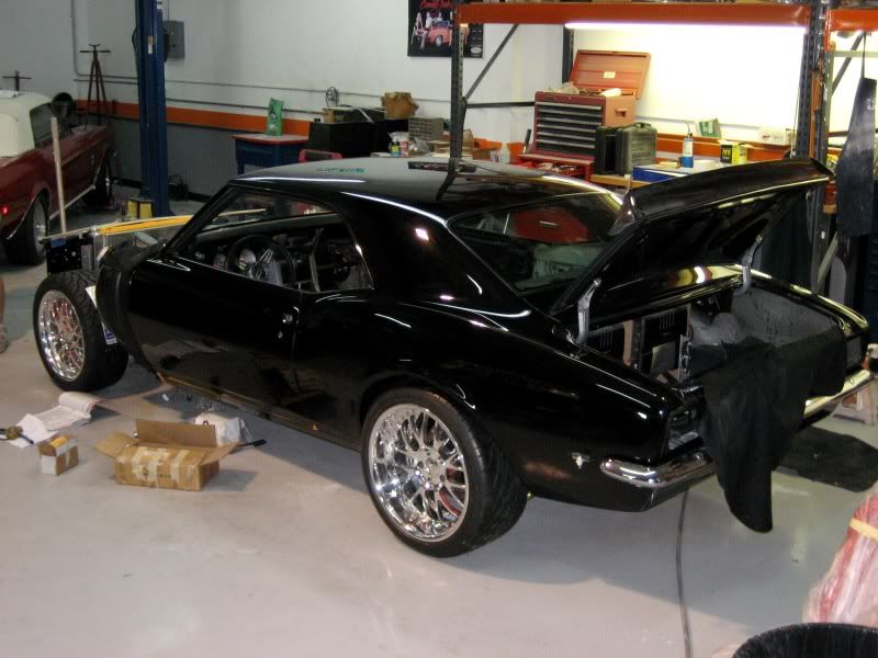

Tires Mounted and balanced check out the stance
http://i700.photobucket.com/albums/w...Picture028.jpg

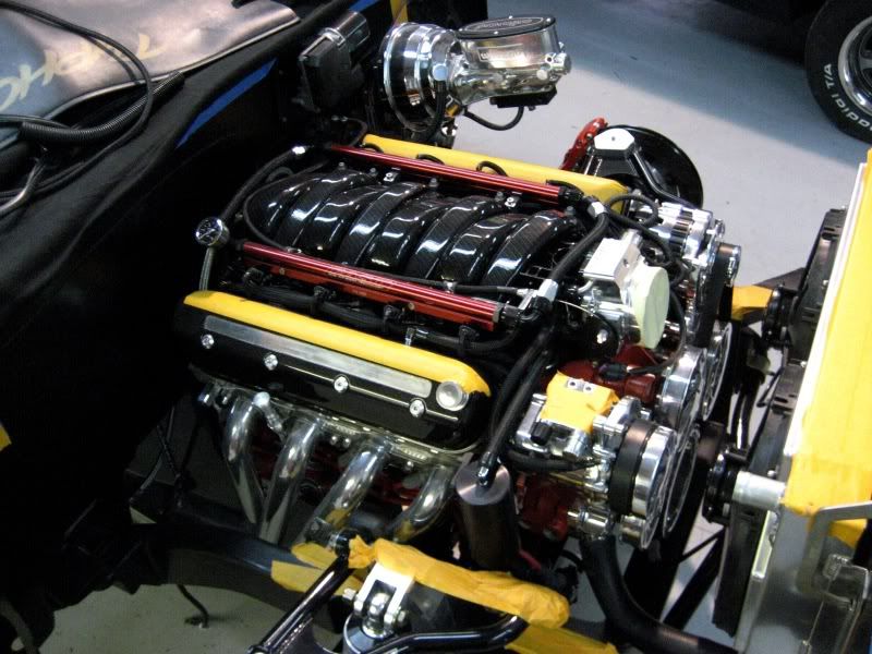

68/Camaro 04-05-2009 11:31 AM
Originally Posted by awr68 (Post 206032)
Looking great!! :thumbsup:
I may have missed it, but are you using an iron block? What's the motor specs?
Anthony,
Lower End Block
LS-2
Bore and stroke: 4.00 x 3.62 in.
Displacement: 364 cu. in. (5.967 liters)
Compression: 10.9:1
Gross Horsepower (SAE net) 400 @ 6000 rpm
Gross Torque (SAE net) 400 lb.-ft. @ 4400 rpm
Block All-new 319-T5 Aluminum
Top Half is
Livernois Heads:
Stage 2 CNC Ported Stage 2 GM LS-Series Cylinder Heads
New GM 243 casting
5 axis CNC machined
220cc Intake Runner
Intake Flow Rate 305 CFM
Exhaust Flow Rate 235 CFM
2.000 intake valves / 1.550 exhaust valves
GM valve seals and locks
Livernois dual coil valve springs good to ~ .690 lift
Livernois titanium retainers.--Jessel 1.7 Rollor rockers
Livernois Motorsports LS-Series Stage 2 Camshaft
Intake Duration 232 @ .050
Exhaust Duration 232 @ .050
Intake Lift .595”
Exhaust Lift .595
LSA 114
Should be right @ 500HP

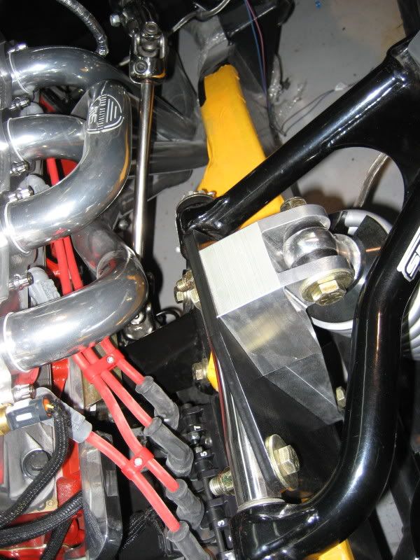

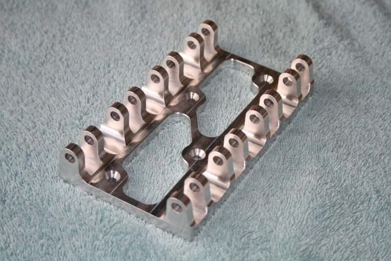

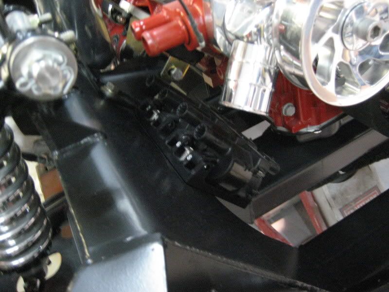

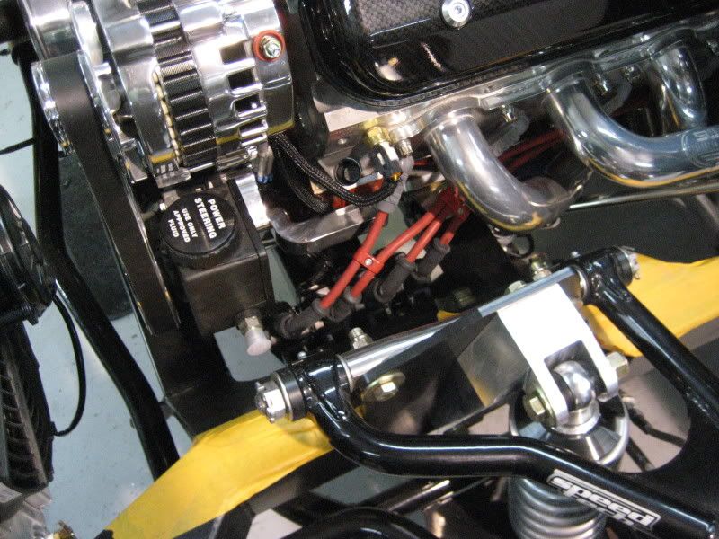

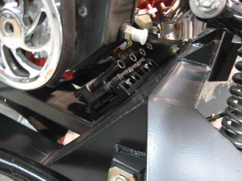

Coil Mounts
Special Thanks to Tyler @ ATS he was able to get me a set of his Coil mounts! We installed them on the inside of the SpeedTech Subframe check out pics!
http://i700.photobucket.com/albums/w...CoilMounts.jpg
Drivers Side
http://i700.photobucket.com/albums/w...eSideCoils.jpg
Pass-Side
http://i700.photobucket.com/albums/w...sSideCoils.jpg
Here it is Wired up!
http://i700.photobucket.com/albums/w...9/IMG_1144.jpg

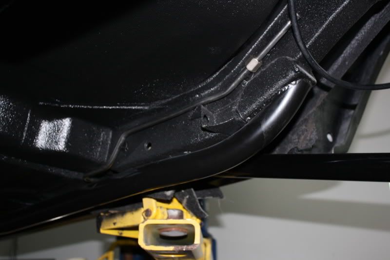

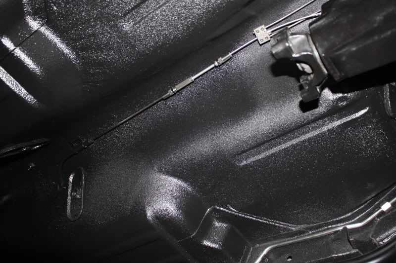

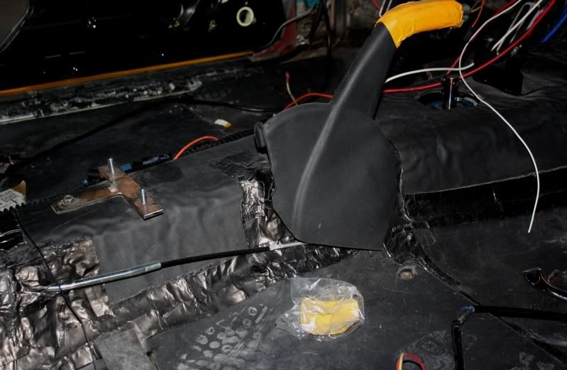

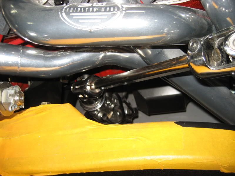

Tom is Installing and relocating Parking brake in the center side console along with cables
http://i700.photobucket.com/albums/w...9/IMG_0127.jpg
http://i700.photobucket.com/albums/w...9/IMG_0084.jpg
http://i700.photobucket.com/albums/w...9/IMG_0087.jpg

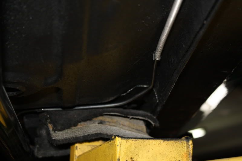

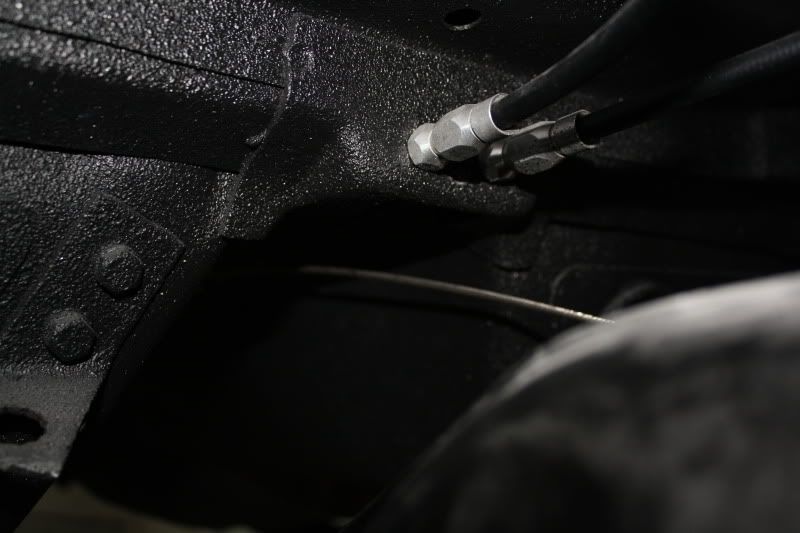

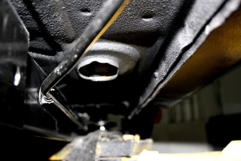

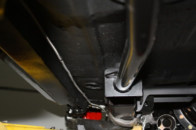

Now Running the Fuel Line with new clips to hold looks like it's Floating along the under carrage
http://i700.photobucket.com/albums/w..._0076JPG-2.jpg
http://i700.photobucket.com/albums/w...9/IMG_0104.jpg

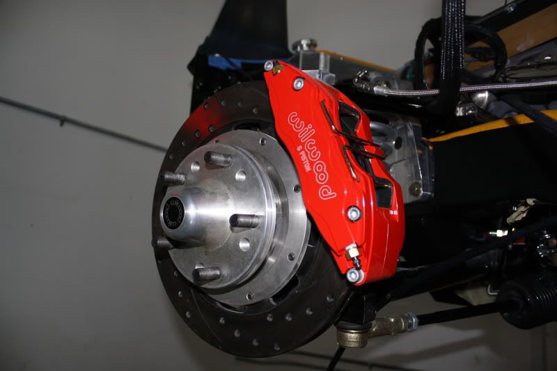

68/Camaro 05-31-2009 09:03 AM
More Updates

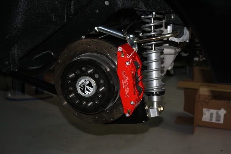

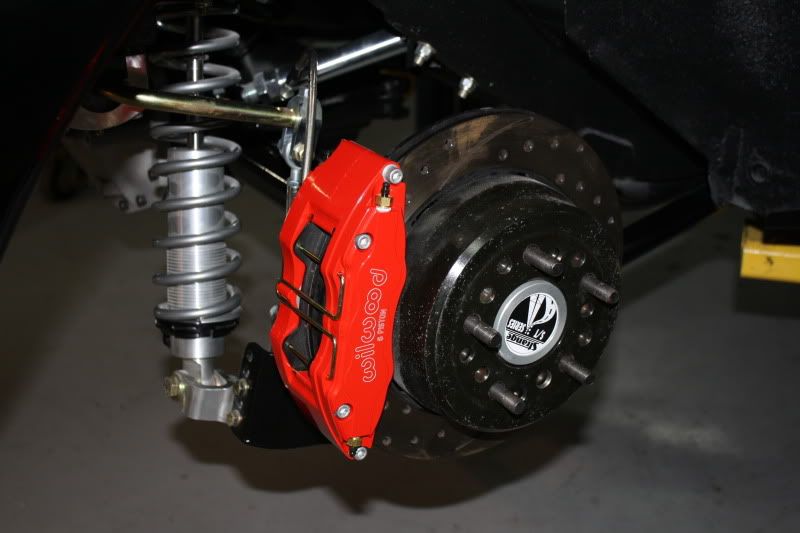

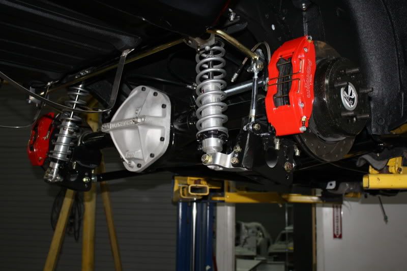

Special Thanks to Justin @ Wilwood was able to help us out to upgrade Calipers to the Six Piston
Rear
http://i700.photobucket.com/albums/w...9/IMG_0102.jpg
http://i700.photobucket.com/albums/w...9/IMG_0122.jpg
http://i700.photobucket.com/albums/w...9/IMG_0121.jpg
Front
http://i700.photobucket.com/albums/w...9/IMG_0099.jpg

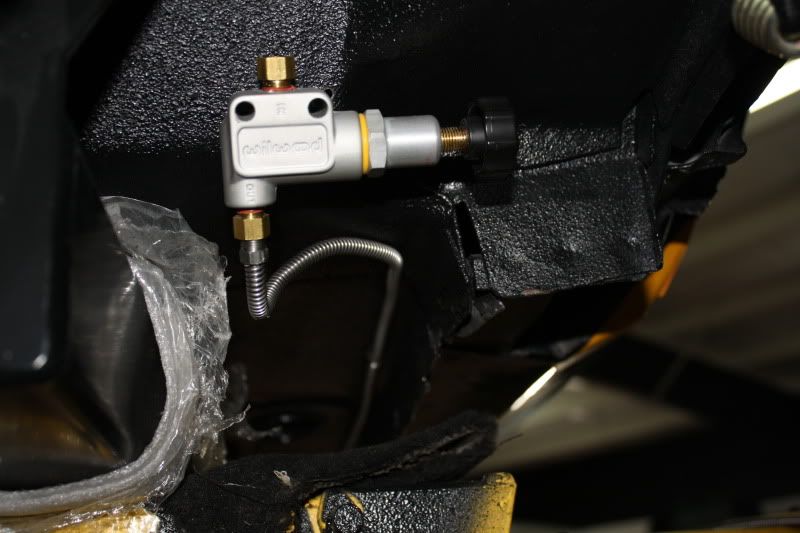

Installing Brake Lines and proportioning valve
http://i700.photobucket.com/albums/w...9/IMG_0080.jpg
http://i700.photobucket.com/albums/w...9/IMG_0105.jpg
http://i700.photobucket.com/albums/w...9/IMG_0082.jpg
Vegas69 05-31-2009 09:04 AM
Nice work as usual. That's not a very good place for the ebracke clevis and cables. It can get pretty tight in the tunnel under hard accel.

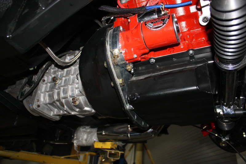

A Sneak peak under the LS-2 Motor and Tremic Trans kit from Keisler Engineering
http://i700.photobucket.com/albums/w...9/IMG_0094.jpg

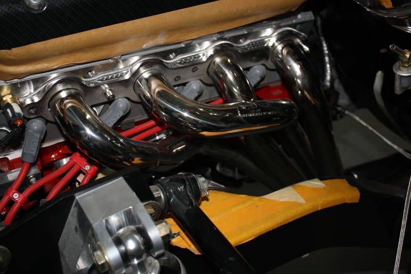

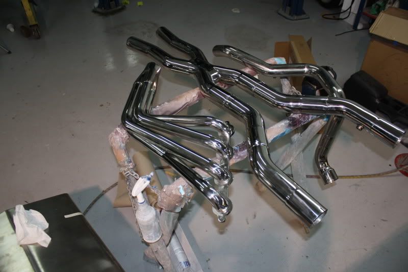

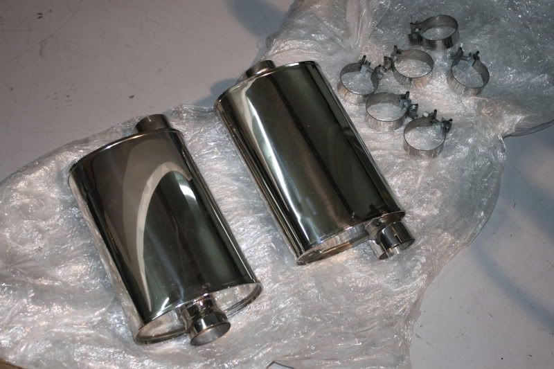

Tom Finishing up Polishing the Speedtech-Stainlessworks Headers and Exhaust 3' X pipe to the mufflers and 2.5 Over the rear axle, Tom Custom cut so it would clear the Chris Alston's Rear link Suspension
http://i700.photobucket.com/albums/w...9/IMG_0116.jpg
http://i700.photobucket.com/albums/w...9/IMG_0110.jpg
http://i700.photobucket.com/albums/w...9/IMG_0125.jpg

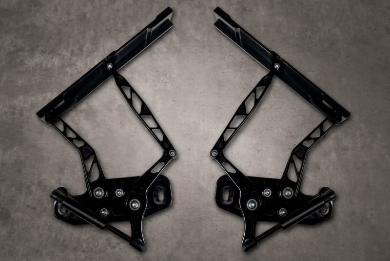

Look what else came in Ring Brothers New Hood Hinges Thanks Jim!
http://i700.photobucket.com/albums/w...Camaro_blk.jpg
syclonetommy 05-31-2009 09:37 AM
The clvis and cables will have a shrould that cover them in the top of the tunnel.

Vegas69 05-31-2009 12:53 PM
Thanks,
Tom Argue
Wouldn't work for me but I have mine fairly low in the back.
