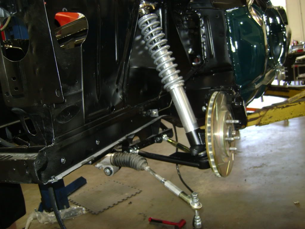

Gotta love those Brembos too. :cool:
The underside is also (re-) finished. The torque arm tube stayed but we redid the rest - one of those days where you just have to admit you made a wrong turn. Now it has a very unique way of cross bracing and providing monster torsional rigidity.

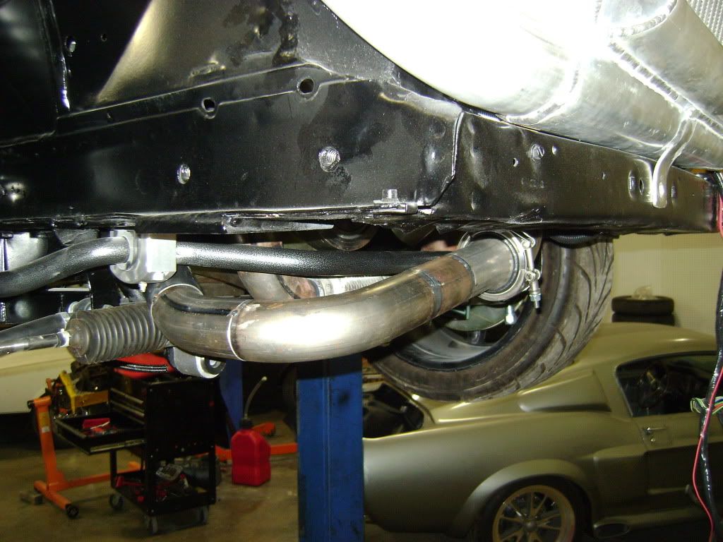

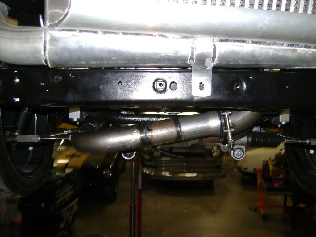

Here some more progress on the DP and cross over.
http://i300.photobucket.com/albums/n...306_061952.jpg http://i300.photobucket.com/albums/n...306_062049.jpg http://i300.photobucket.com/albums/n...306_062221.jpg
The 5" goes into 2x3" and just b4 passing thru the K-member into 2½"

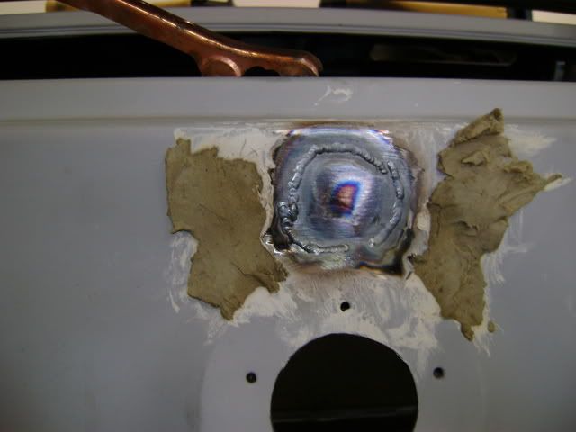

Interesting way of welding. Or did Dustin just fall asleep with the light on?
http://i300.photobucket.com/albums/n...313_050654.jpg

I've always said to be a good welder you have to be a contorsionist!!! Car is looking great one of my favorite builds to watch. :yes:

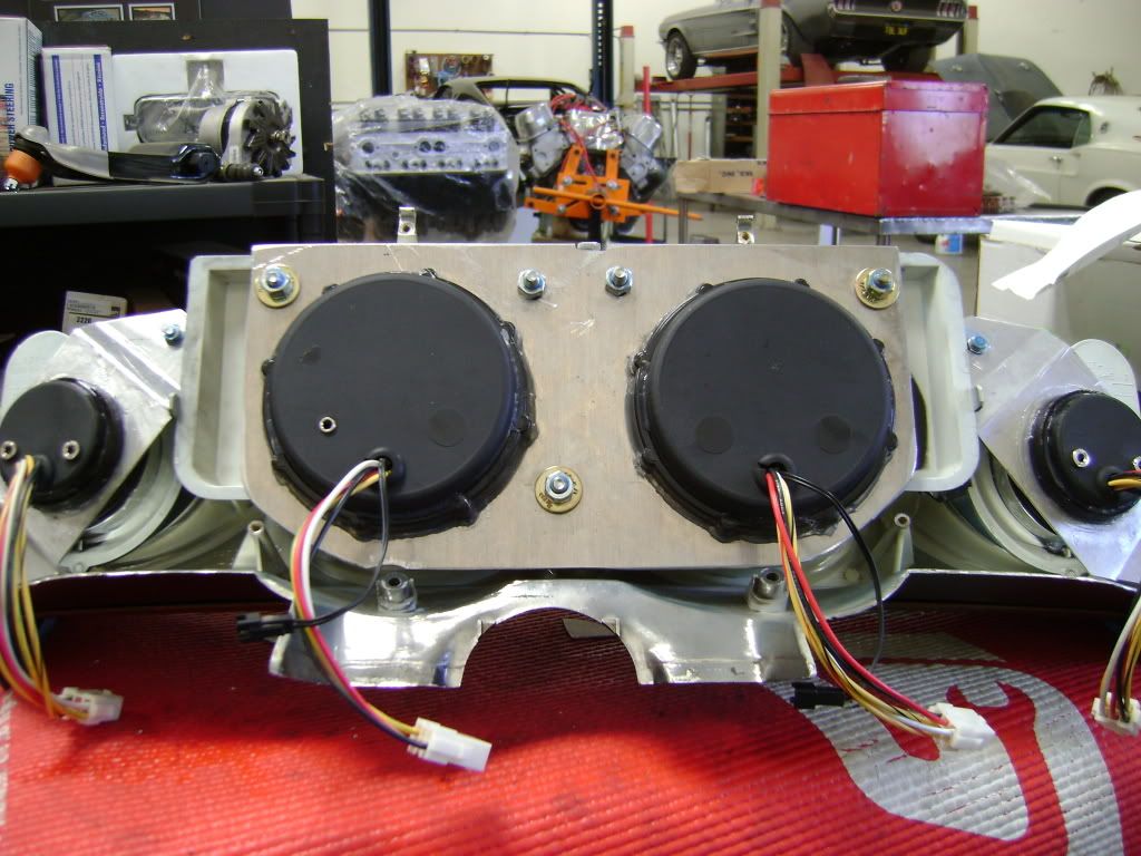

Instrument cluster (gauges from www.speedhut.com):
http://i300.photobucket.com/albums/n...818_193629.jpg http://i300.photobucket.com/albums/n...818_234035.jpg http://i300.photobucket.com/albums/n...819_021554.jpg

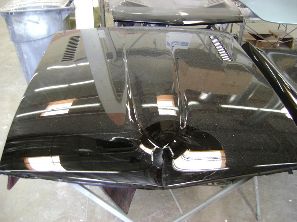

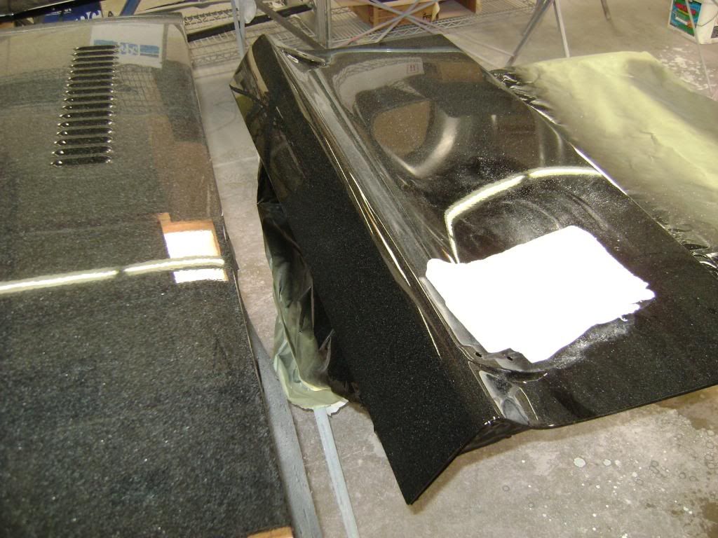

Hood and trunk lid waiting for cut & buff. Hood louvres came out good!
http://i300.photobucket.com/albums/n...814_220843.jpg http://i300.photobucket.com/albums/n...814_220921.jpg

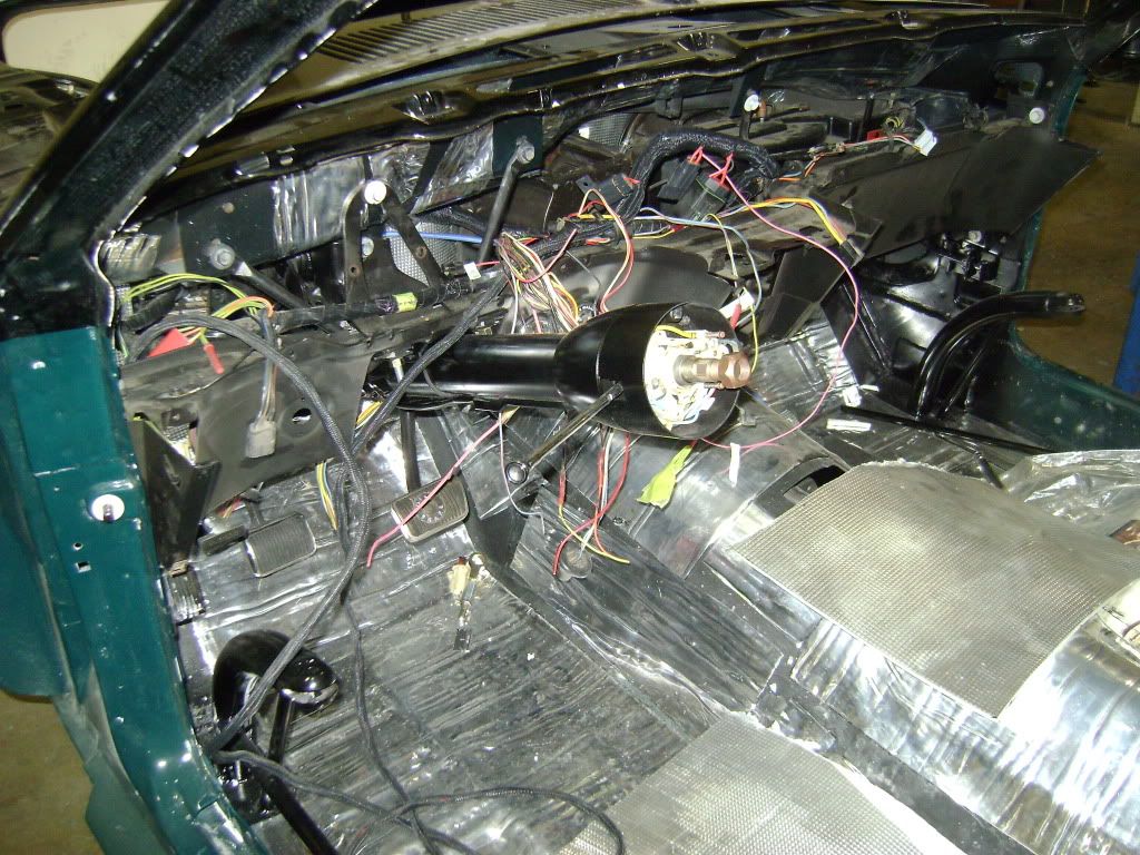

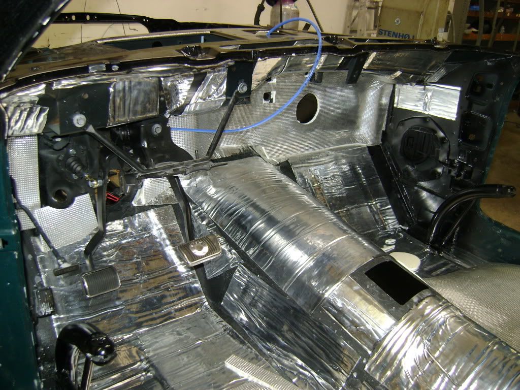

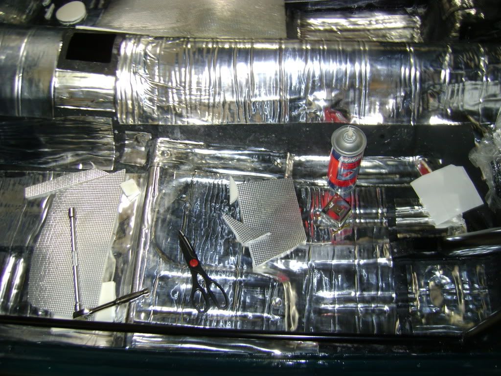

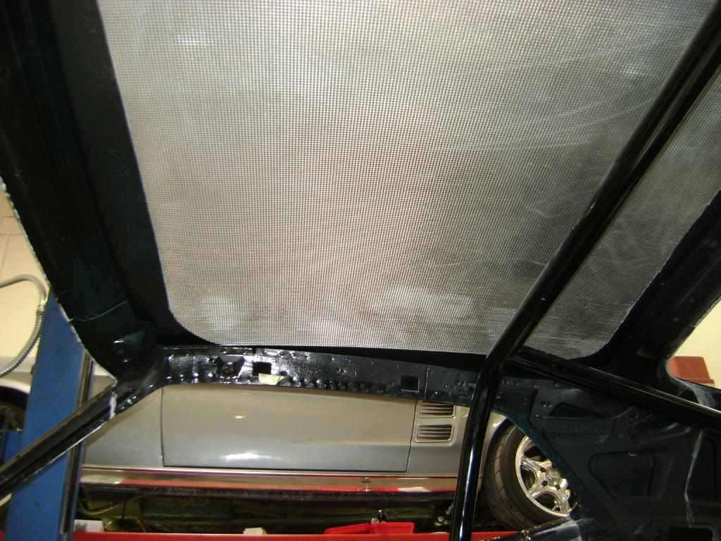

RAAMmat BXT for noise and some trick heat insulation here and there. Trying not to get carried away weight-wise:

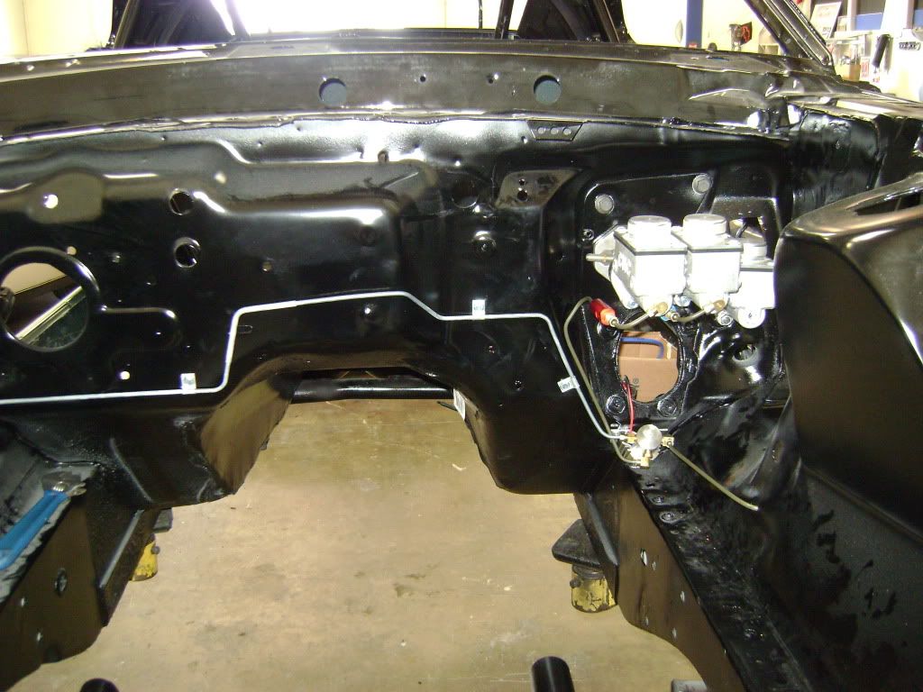

http://i300.photobucket.com/albums/n...814_220625.jpg http://i300.photobucket.com/albums/n...814_040254.jpg http://i300.photobucket.com/albums/n...814_040326.jpg

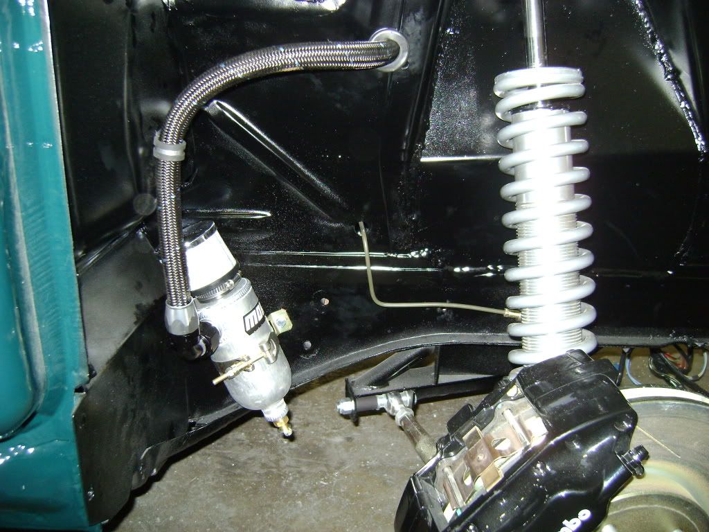

The nice MC's from CNC + brake lines and a line lock (just in case!):
http://i300.photobucket.com/albums/n...812_040842.jpg

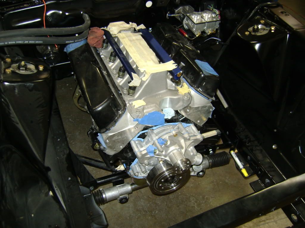

OK, I know this is long overdue so here finally a few updates.

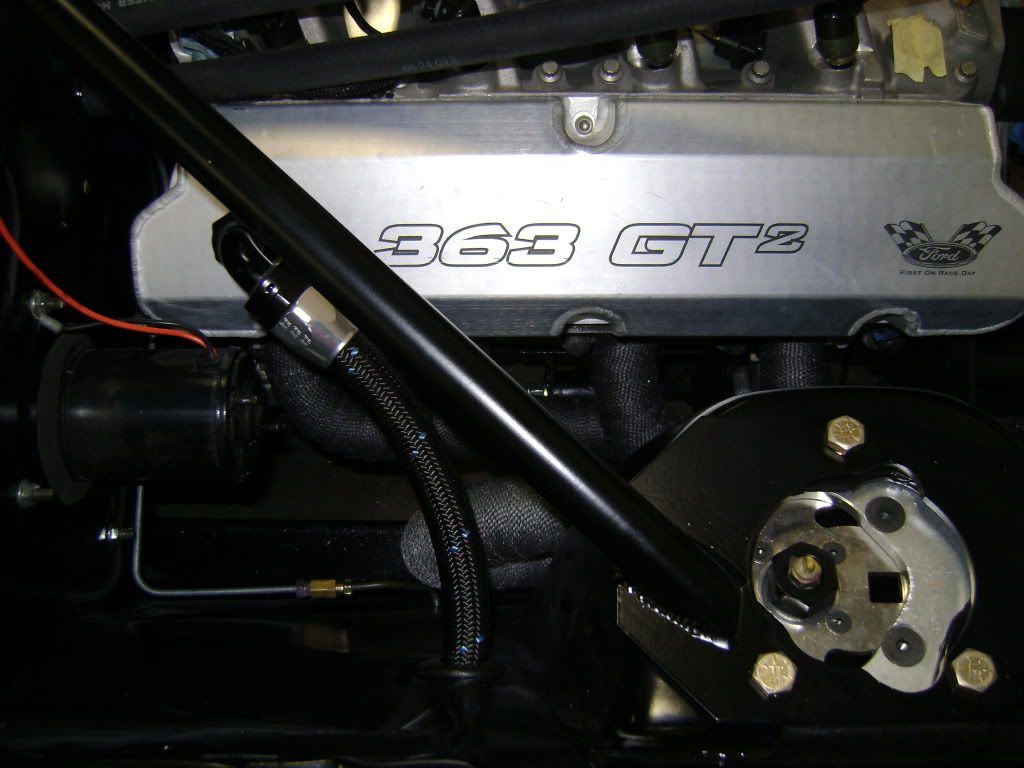

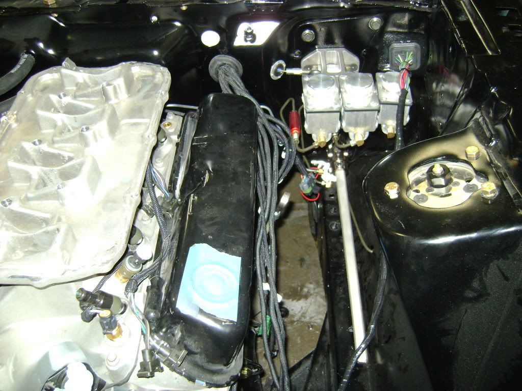

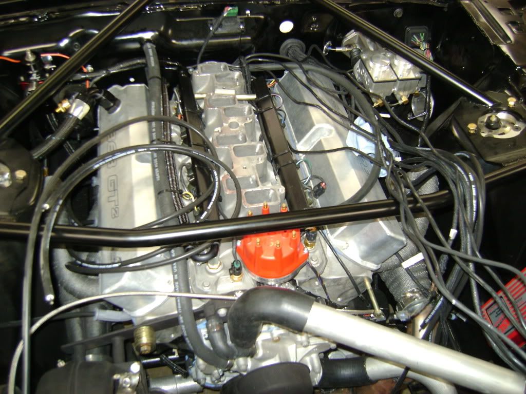

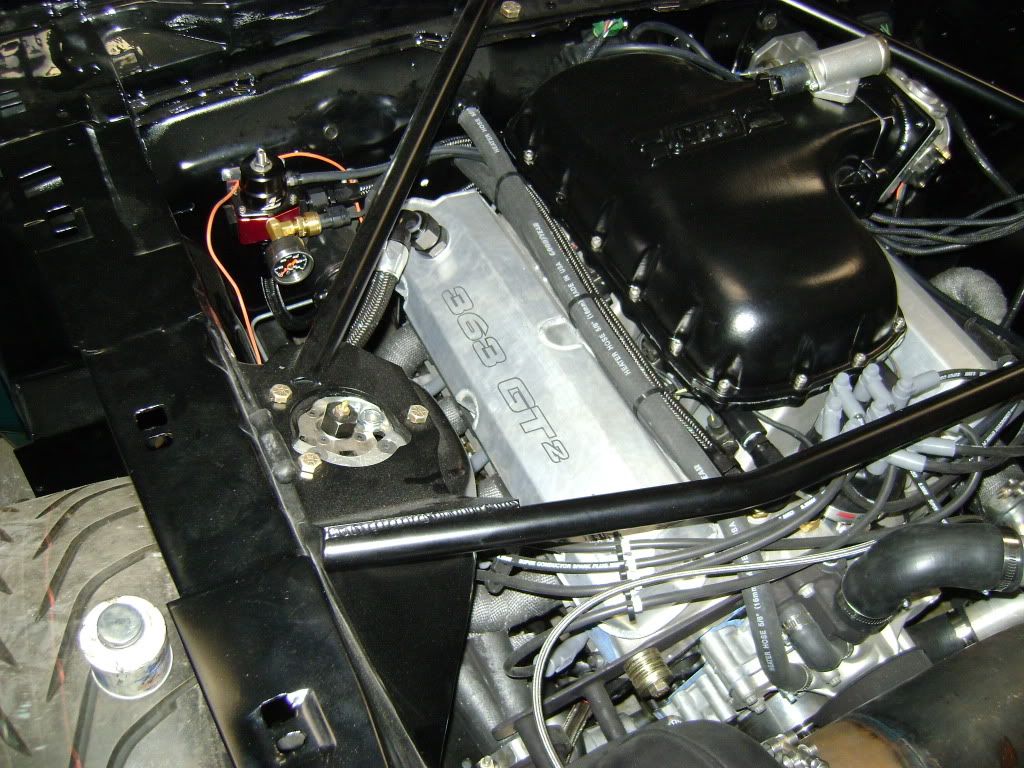

Engine dropped in, looks tiny all by itself down there but just wait until it meets all the turbo piping... :D Also the breather can is in. Right now it's moved "outside" for a cleaner look and easy access but might move back in, let's see.
http://i300.photobucket.com/albums/n...902_042506.jpg http://i300.photobucket.com/albums/n...913_052538.jpg http://i300.photobucket.com/albums/n...913_052559.jpg
A little later room is getting more sparse!
http://i300.photobucket.com/albums/n...929_222439.jpg http://i300.photobucket.com/albums/n...022_184356.jpg http://i300.photobucket.com/albums/n...022_184421.jpg

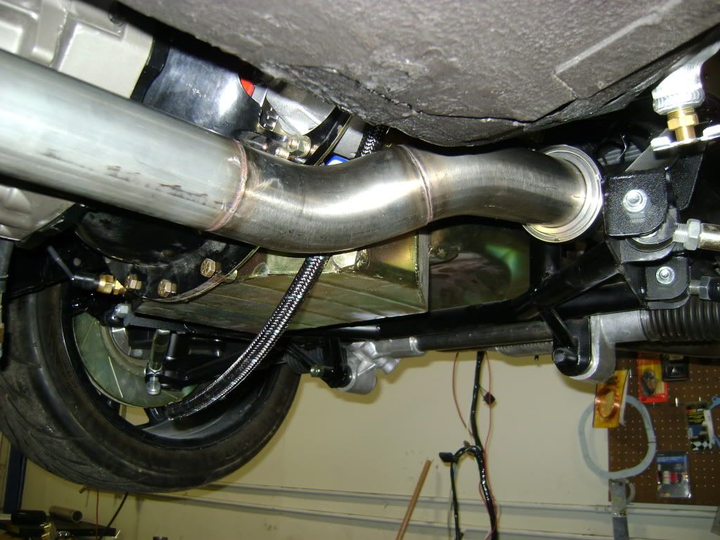

Dustin is not really enjoying exhaust routing. I want it tight and unobtrusive with as much ground clearance as possible. :whistling:
http://i300.photobucket.com/albums/n...015_072323.jpg http://i300.photobucket.com/albums/n...015_072337.jpg http://i300.photobucket.com/albums/n...015_072352.jpg

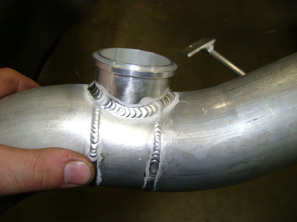

What's not to like about the weld quality? BOV flange.
http://i300.photobucket.com/albums/n...910_072236.jpg
