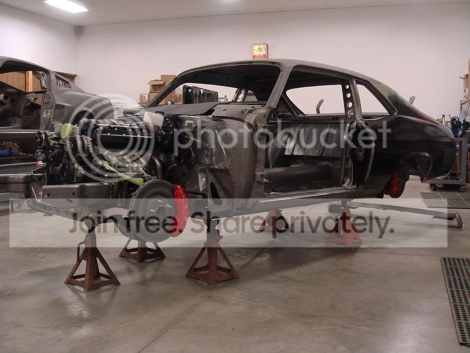

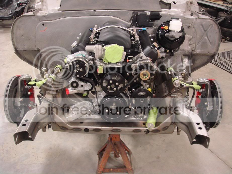

We got the engine and trans in tonight so I can check things out and start the plumbing.
http://i326.photobucket.com/albums/k...ishout1web.jpg
http://i326.photobucket.com/albums/k...ishout2web.jpg
http://i326.photobucket.com/albums/k...deshot1web.jpg
http://i326.photobucket.com/albums/k...engine1web.jpg

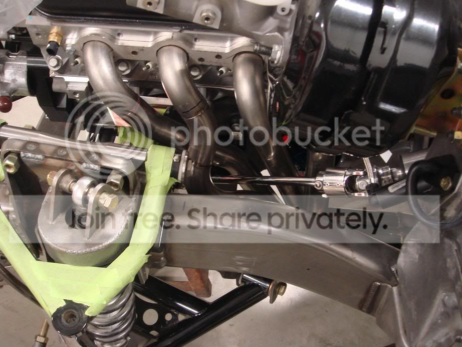

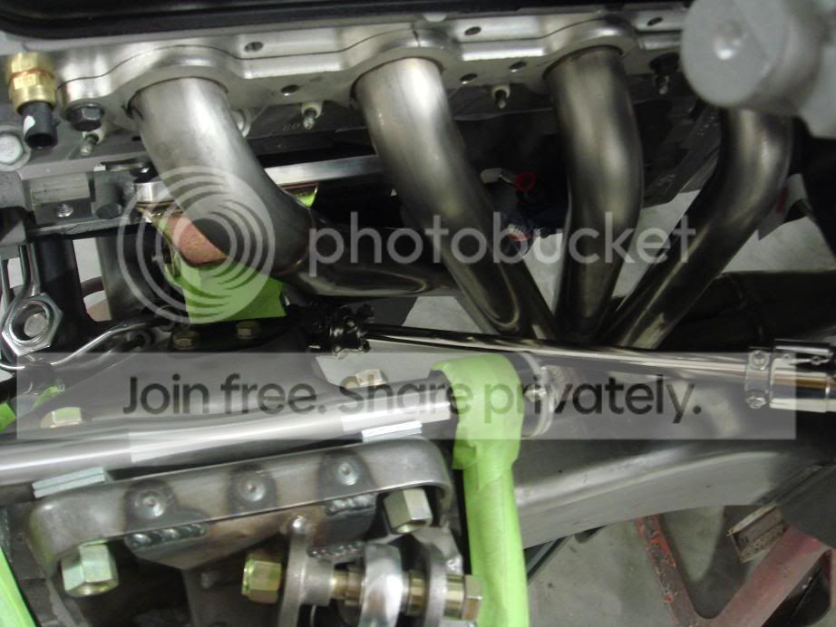

Fitted the steering shaft tonight. It ran right into one of the header tubes. After some cutting and fitting we had an alternate route:fluffy: .
http://i326.photobucket.com/albums/k...dheaderweb.jpg

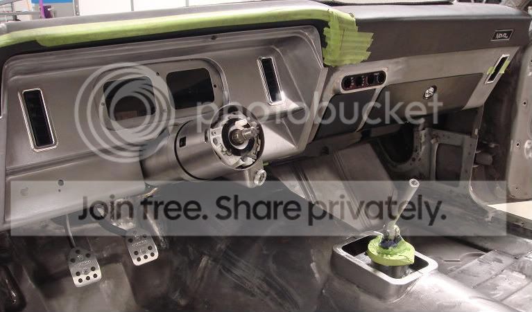

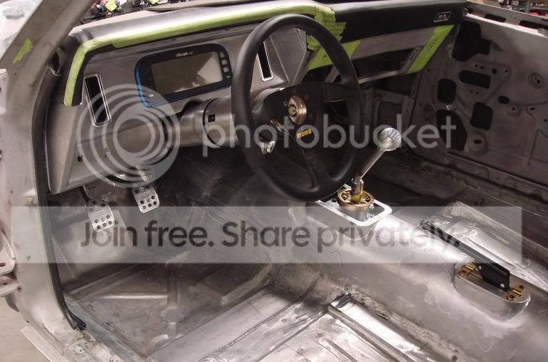

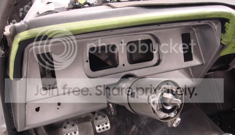

Heres a pic of the dash mocked up.
http://i326.photobucket.com/albums/k...er/dashweb.jpg

Nice Fab work! - as usual. This car is really coming together nicely. Just for curiosity's sake - what headers are you using?

Thanks Brandon, the headers are stainless works ls headers for a 69 camaro with a stock subframe. I figured they wouldn't fit, but for the price I didnt mind doing some alterations.

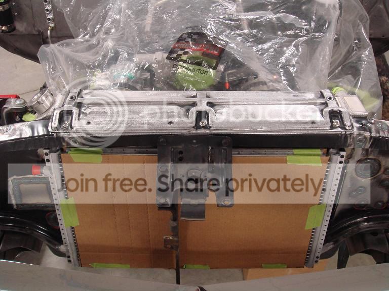

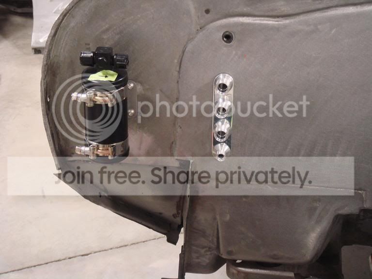

72novadriver 03-30-2009 09:06 PM

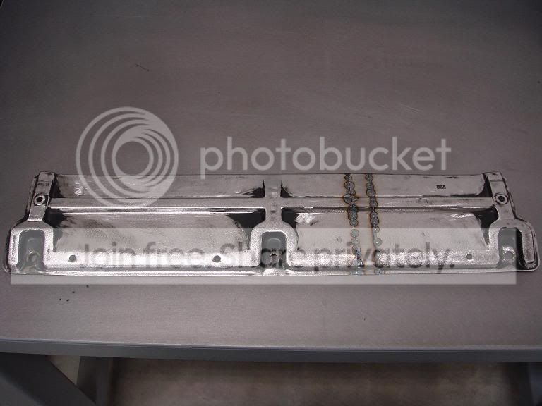

Here are some random pics of this weekends work, and a better dash shot
http://i326.photobucket.com/albums/k...supportweb.jpg
http://i326.photobucket.com/albums/k...radtopweb1.jpg
http://i326.photobucket.com/albums/k...radtopweb2.jpg
http://i326.photobucket.com/albums/k...ndenserweb.jpg
http://i326.photobucket.com/albums/k...r/dryerweb.jpg
http://i326.photobucket.com/albums/k...dash2web-1.jpg

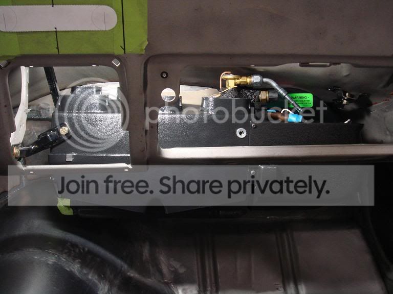

Here are a couple newer random pics. The vintage air is mocked up as well as the controls in the dash, and a new gas pedal bracket is fabbed.
http://i326.photobucket.com/albums/k.../ACBRKTWEB.jpg
http://i326.photobucket.com/albums/k...r/genIIweb.jpg
http://i326.photobucket.com/albums/k...controlweb.jpg

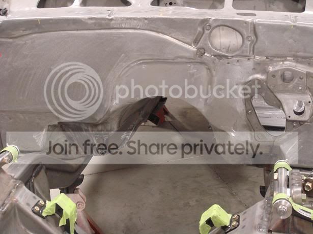

Heres some shots of the driverside fender inner lip reworked to match the passenger side.
http://i326.photobucket.com/albums/k...r/DSC02939.jpg
http://i326.photobucket.com/albums/k...r/DSC02940.jpg

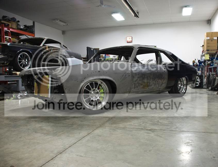

Working on getting the inner fenders to work at ride height. While it was on the ground I thought I would snap a shot.
http://i326.photobucket.com/albums/k...8thweekweb.jpg

Killer stance! :thumbsup:
