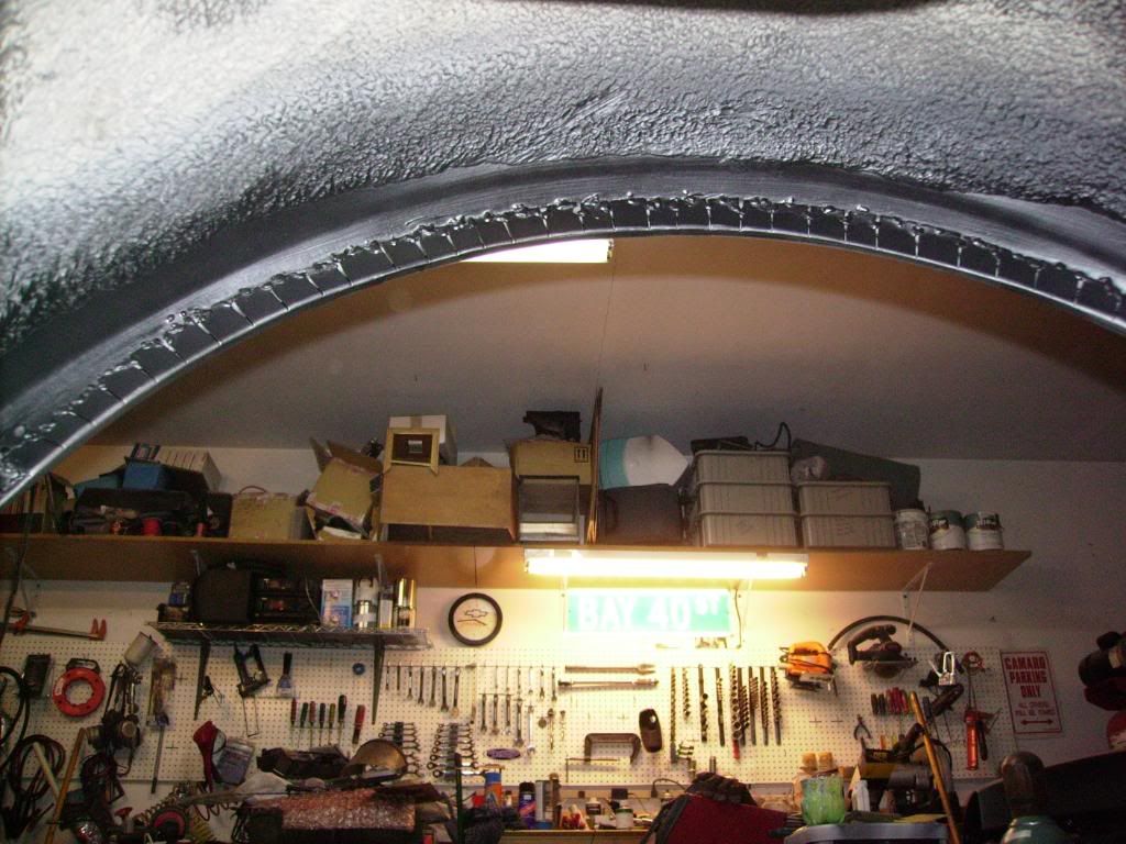

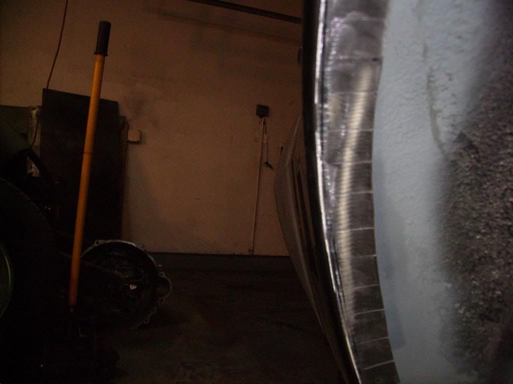

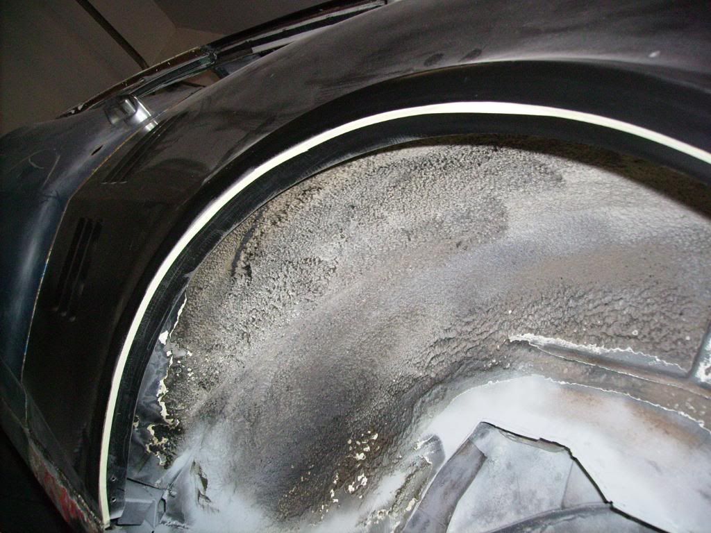

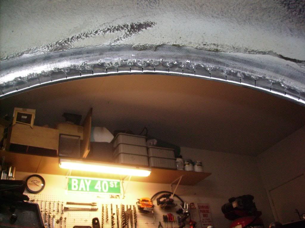

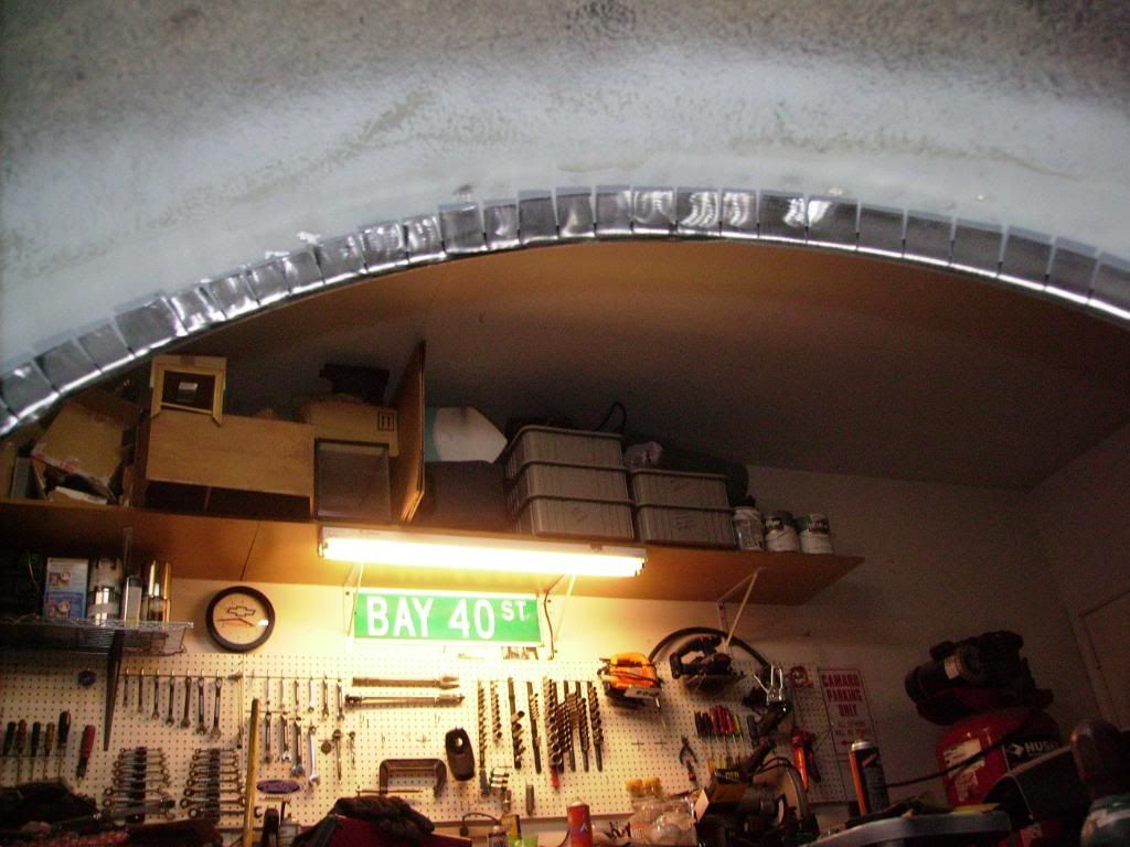

Making a little progress. I decided to cut away the inner edge of the outer wheel houses so that I could cut and tuck the rear quarters in a bit (I did that before I set the quarters on). I'm hoping to stuff some 285's back there.
I started by laying down some thin masking tape to mark a straight line.
http://i223.photobucket.com/albums/d...d/IMGP1058.jpg
Then I cut straight lines with my airsaw every inch or so.
http://i223.photobucket.com/albums/d...d/IMGP1060.jpg
I was able to bend each section by hand and follow up with just a little hammering to get the edge to sit flat.
http://i223.photobucket.com/albums/d...d/IMGP1062.jpg
I then spot welded.
http://i223.photobucket.com/albums/d...d/IMGP1064.jpg

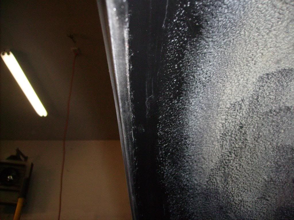

Cleaned up with some sanding discs and sprayed a light coat of Zero Rust.
http://i223.photobucket.com/albums/d...d/IMGP1066.jpg
http://i223.photobucket.com/albums/d...d/IMGP1070.jpg

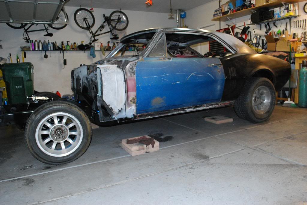

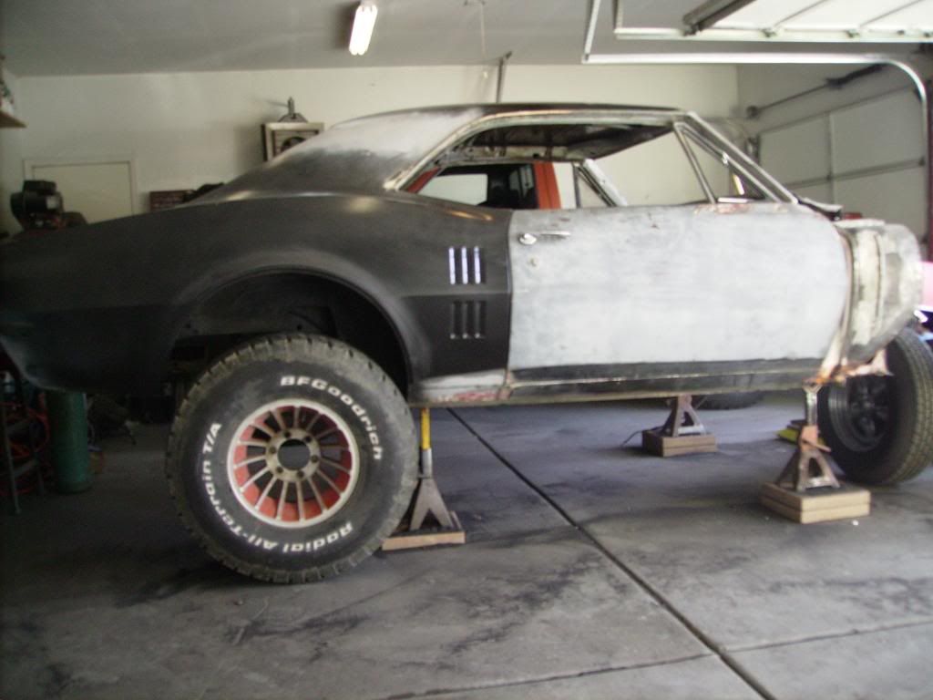

67rstbkt 03-15-2010 08:05 PM
A little further: Thinking I could fit a 33X12.50X15 tire there
http://i223.photobucket.com/albums/d...d/IMGP1110.jpg
Just kidding :lol:

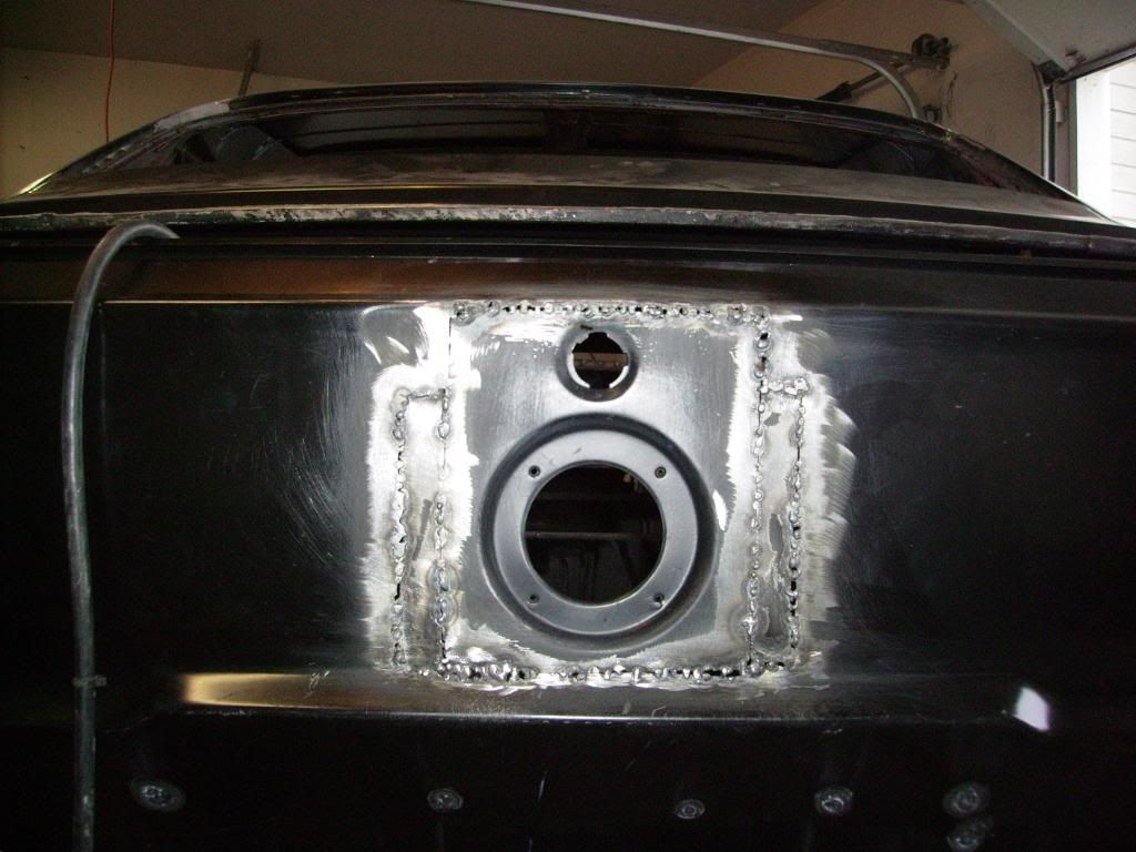

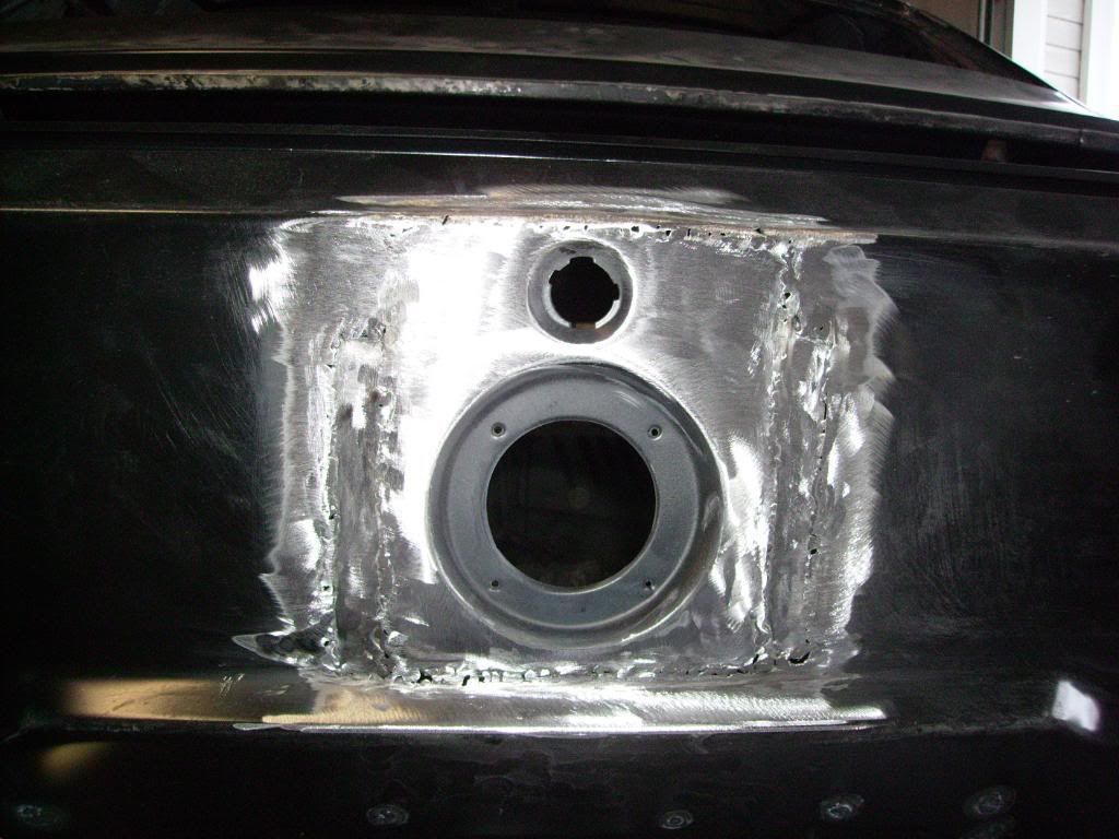

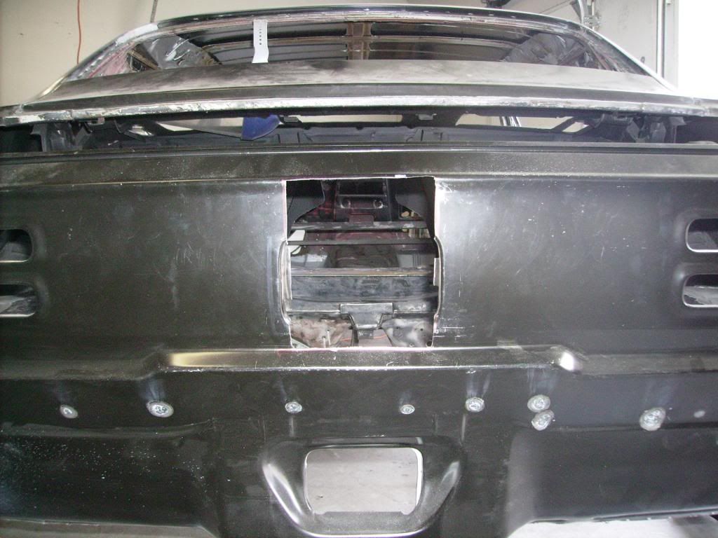

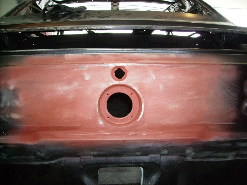

Here's the 67 Camaro section I spliced into my tail panel; Thanks again to ItDoRun for the panel section and Scherp69 for the idea :) I think I inhaled some paint fumes that day because I kind of messed up the cut. Oh well, it's a learning process, right?
http://i223.photobucket.com/albums/d...d/IMGP1096.jpg
http://i223.photobucket.com/albums/d...d/IMGP1097.jpg
http://i223.photobucket.com/albums/d...d/IMGP1098.jpg
http://i223.photobucket.com/albums/d...d/IMGP1100.jpg
I did add more weld to fill the gaps after this shot, just can't find the picture.
http://i223.photobucket.com/albums/d...d/IMGP1106.jpg
I also started cleaning up the underside and prepping for epoxy primer, then Raptor liner. Pics on that soon.

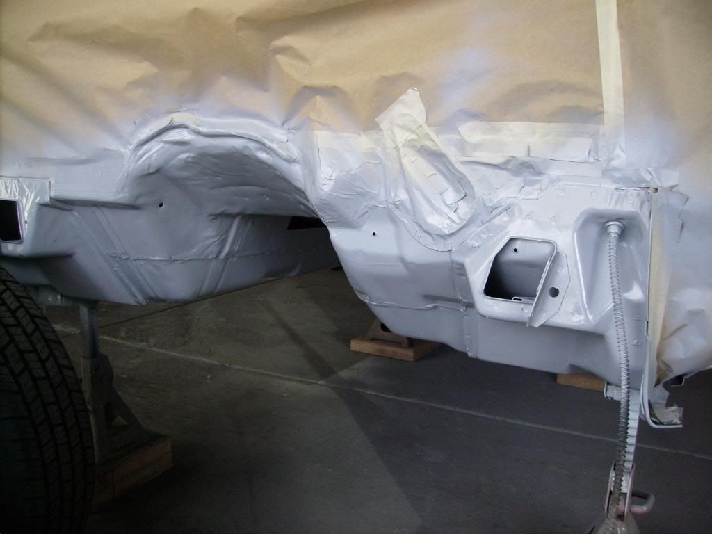

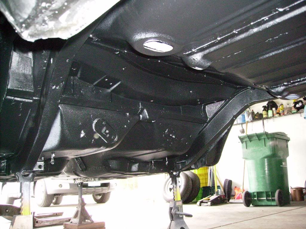

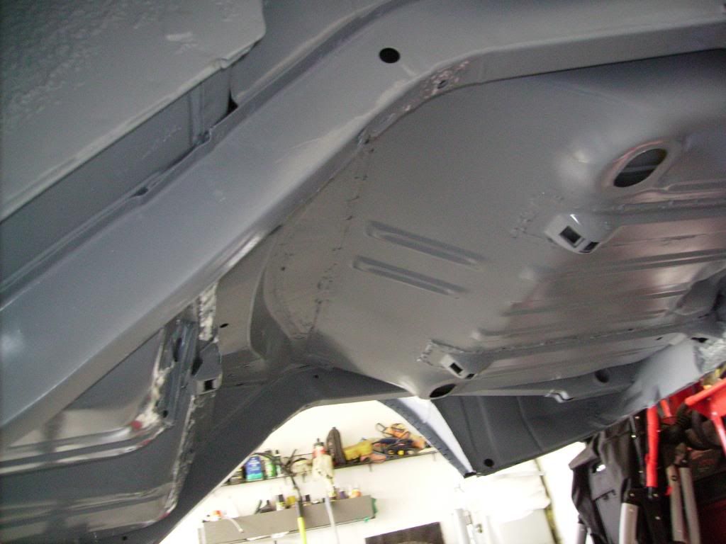

67rstbkt 04-19-2010 09:16 AM

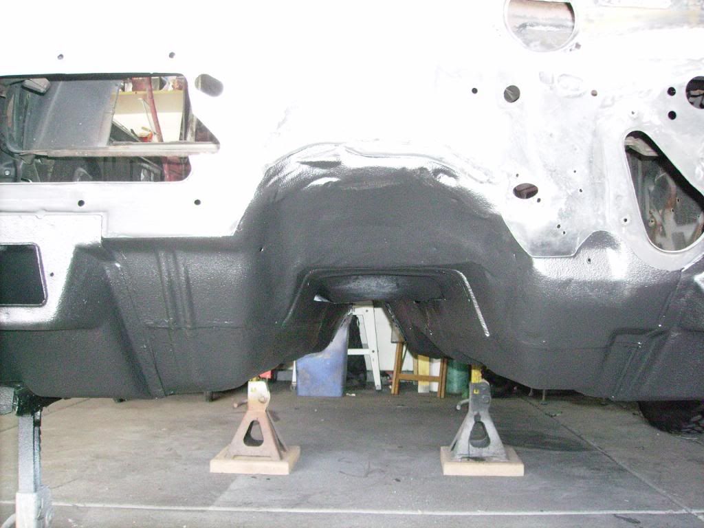

Some updates. I finished cleaning up the underside. I used Dupont epoxy primer and followed up with Raptor truck bed liner. I also got the sub-frame apart, cleaned up, and all seams welded solid. It's at the powdercoaters right now, I should be getting it back today. Here are the pics.....
http://i223.photobucket.com/albums/d...d/IMGP1112.jpg
http://i223.photobucket.com/albums/d...d/IMGP1113.jpg
http://i223.photobucket.com/albums/d...d/IMGP1129.jpg
http://i223.photobucket.com/albums/d...d/IMGP1131.jpg
http://i223.photobucket.com/albums/d...d/IMGP1118.jpg
http://i223.photobucket.com/albums/d...d/IMGP1119.jpg

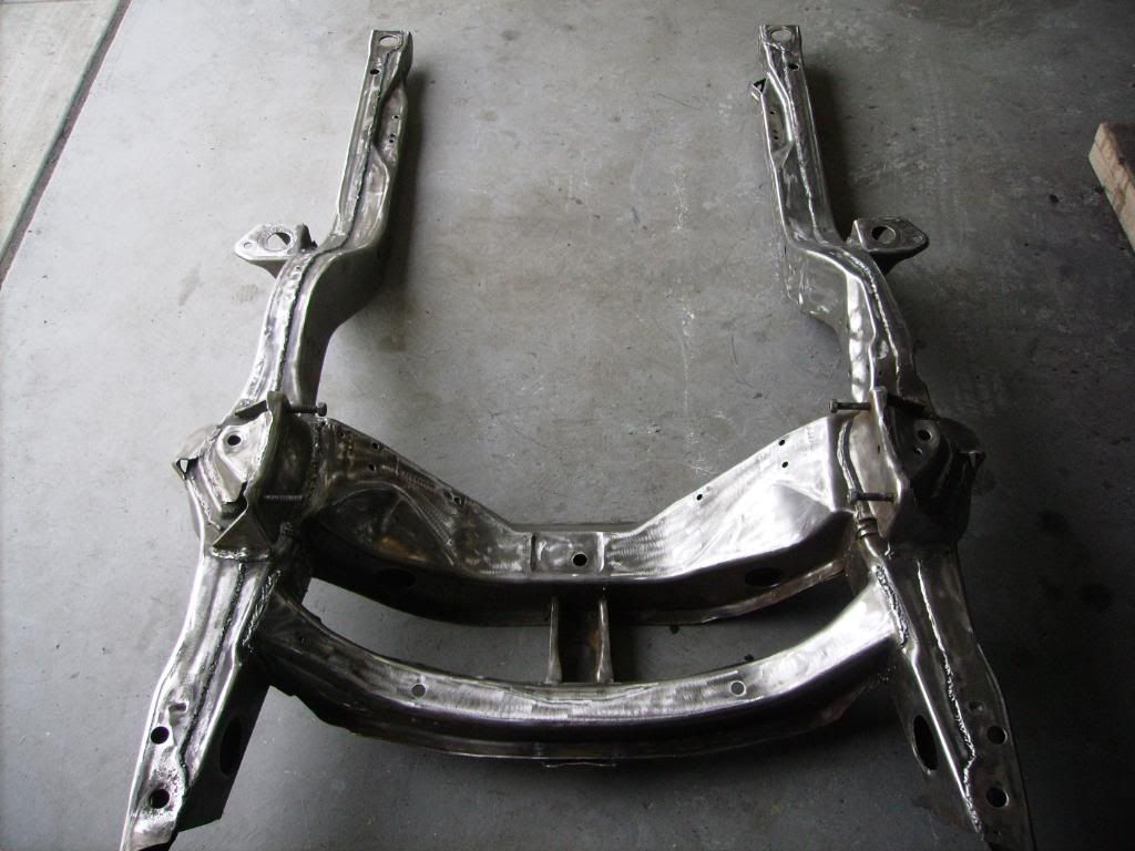

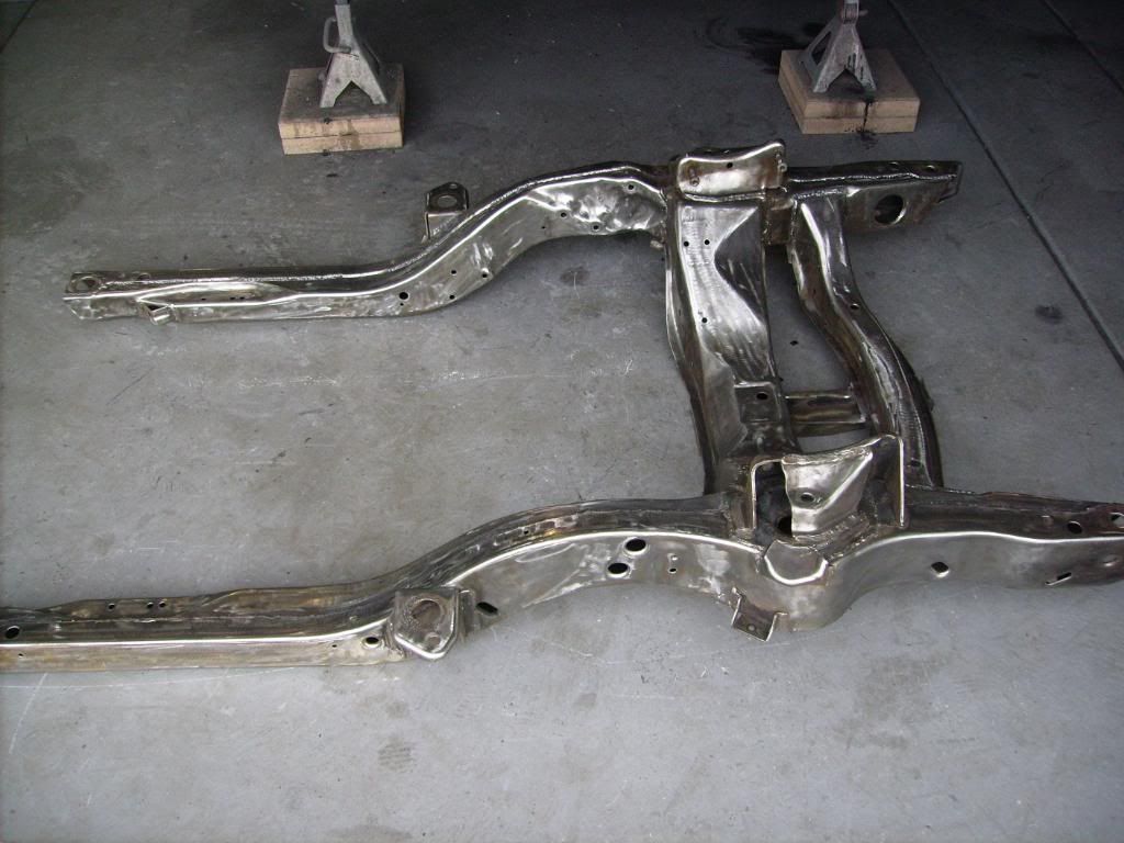

I went and picked up the sub frame from the powdercoaters today
http://i223.photobucket.com/albums/d...d/DSC_0469.jpg
http://i223.photobucket.com/albums/d...d/DSC_0470.jpg

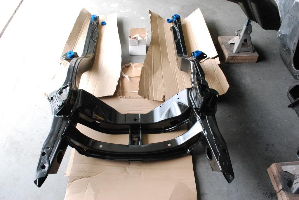

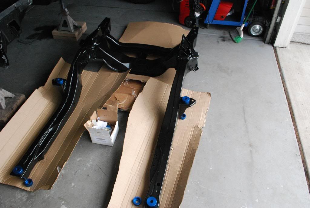

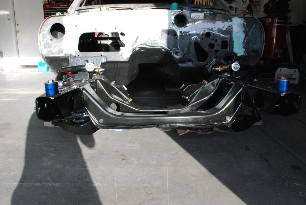

67rstbkt 05-15-2010 12:17 PM

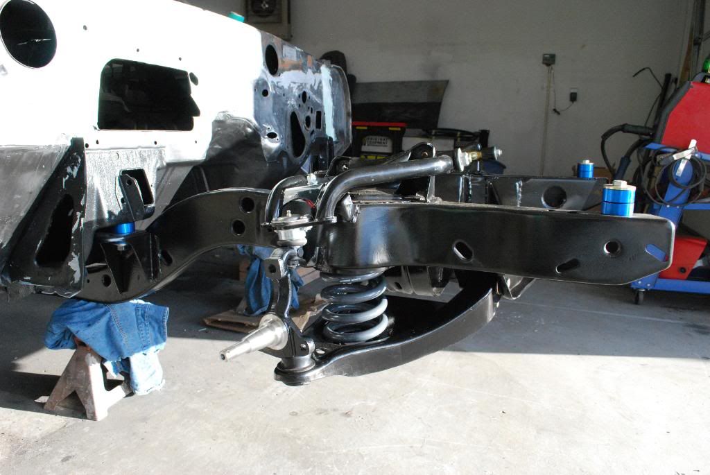

Here's an update.
I mounted the subframe using Global West solid bushings, mounted the GW upper arms, painted the stock lowers. Upper and lower arms have poly bushings. I also mounted the stock rear-end for the time being so that I could get this to roller status. The brakes will be C5; I picked up a set of calipers for a good price, so I guess I'll be giving Kore3 a call for some brackets and hardware.
http://i223.photobucket.com/albums/d...d/DSC_0002.jpg
http://i223.photobucket.com/albums/d...d/DSC_0003.jpg
http://i223.photobucket.com/albums/d...d/DSC_0005.jpg
http://i223.photobucket.com/albums/d...d/DSC_0007.jpg
Tuske427 05-16-2010 10:13 PM
Did you make the Guildstrand mod to the stock frame?
67rstbkt 05-17-2010 07:35 AM
Yes, that's the stock subframe. I did not need to trim away the control arm mount and original holes because I'm using tubular arms. That way I can always go back if I need to.

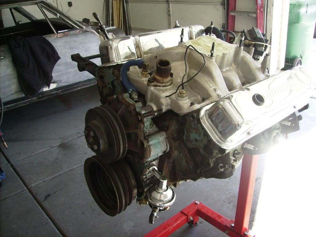

67rstbkt 06-06-2010 02:00 PM

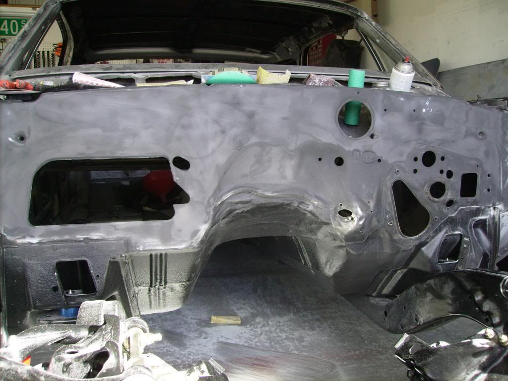

I got some more work done on the firewall and started motor dis assembly. I also fit the mega brace lifter valley brace on my 400. I'll be dropping the block off at the machinist this week.
http://i223.photobucket.com/albums/d...8/IMGP1147.jpg
http://i223.photobucket.com/albums/d...8/IMGP1137.jpg
http://i223.photobucket.com/albums/d...8/IMGP1141.jpg
http://i223.photobucket.com/albums/d...8/IMGP1142.jpg
http://i223.photobucket.com/albums/d...8/IMGP1146.jpg

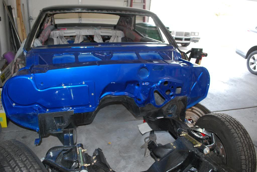

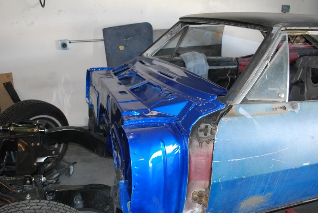

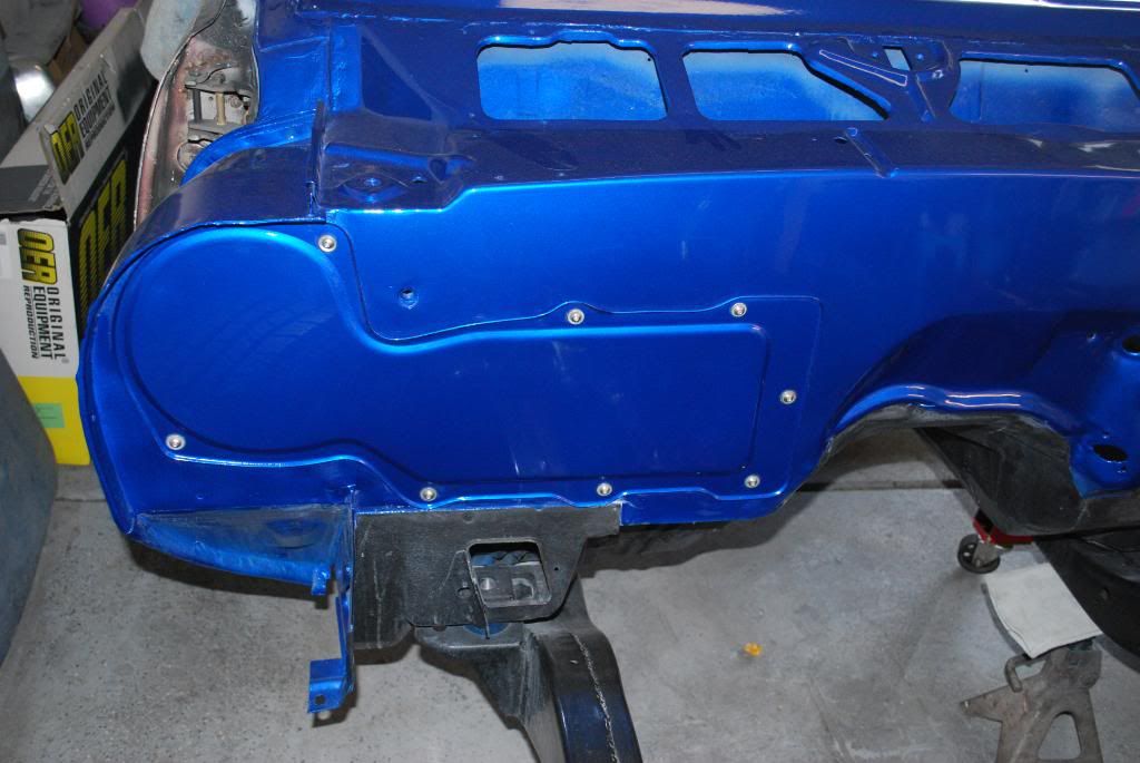

67rstbkt 10-31-2010 01:54 PM

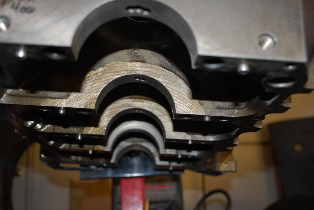

Been awhile since an update, so here you go. My block is still at the machine shop, so I'm sort of on a hold for a little while. I painted the firewall and dash in preparation for the motor. I picked up a set of Edelbrock aluminum heads, a Hayes flywheel and a Mcleod clutch.
http://i223.photobucket.com/albums/d...8/DSC_0043.jpg
http://i223.photobucket.com/albums/d...8/DSC_0044.jpg
http://i223.photobucket.com/albums/d...8/DSC_0045.jpg

Jimmy Sean 11-01-2010 09:29 AM

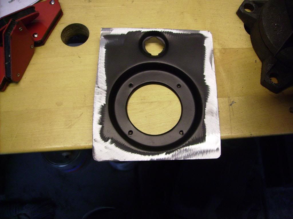

Where did you get the heater block off piece? BTW the car is looking great.
67rstbkt 11-01-2010 10:56 AM
Thanks :bow: I got the plate from DSE, it was around $70
waynieZ 11-01-2010 11:18 AM
The firewall looks great, I like the color. Nice job.

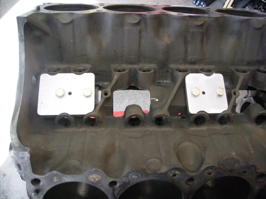

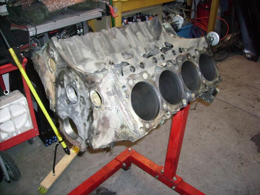

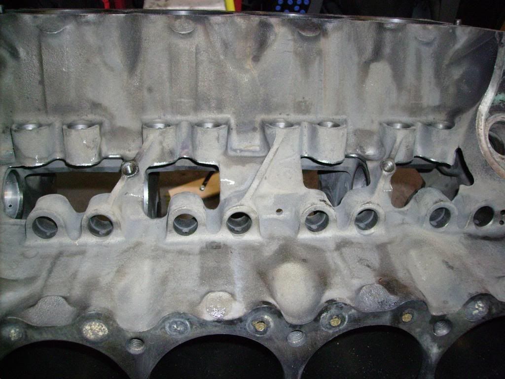

Minor update: I'm still waiting on the machine shop; I stopped by yesterday and they are working on it, so it should not be too long now.
I snapped a few pics while I was there:
67rstbkt 01-19-2011 08:16 AM
67rstbkt 01-26-2011 10:08 AM
3 Attachment(s)
Few more pics of the block at the machine shop, should have it back real soon :D

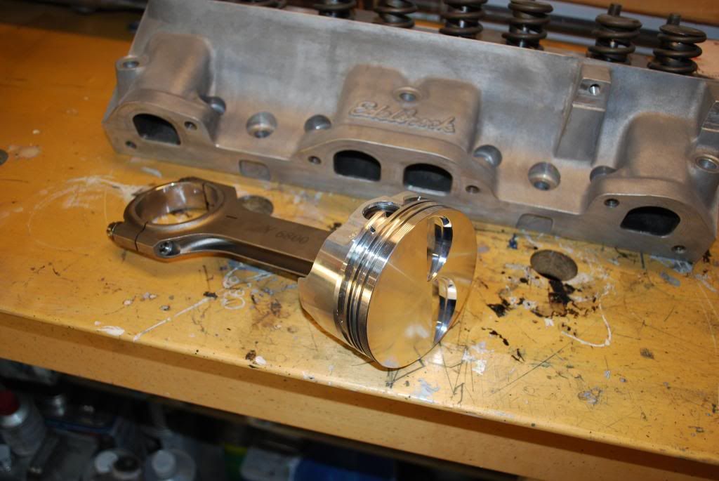

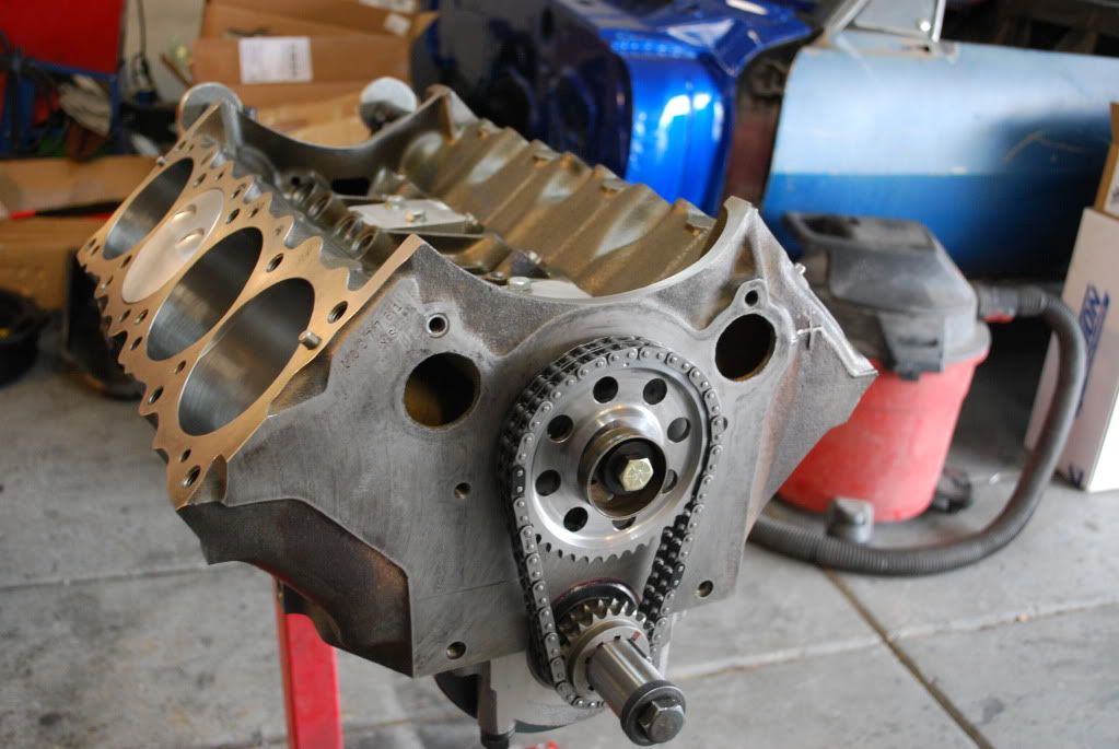

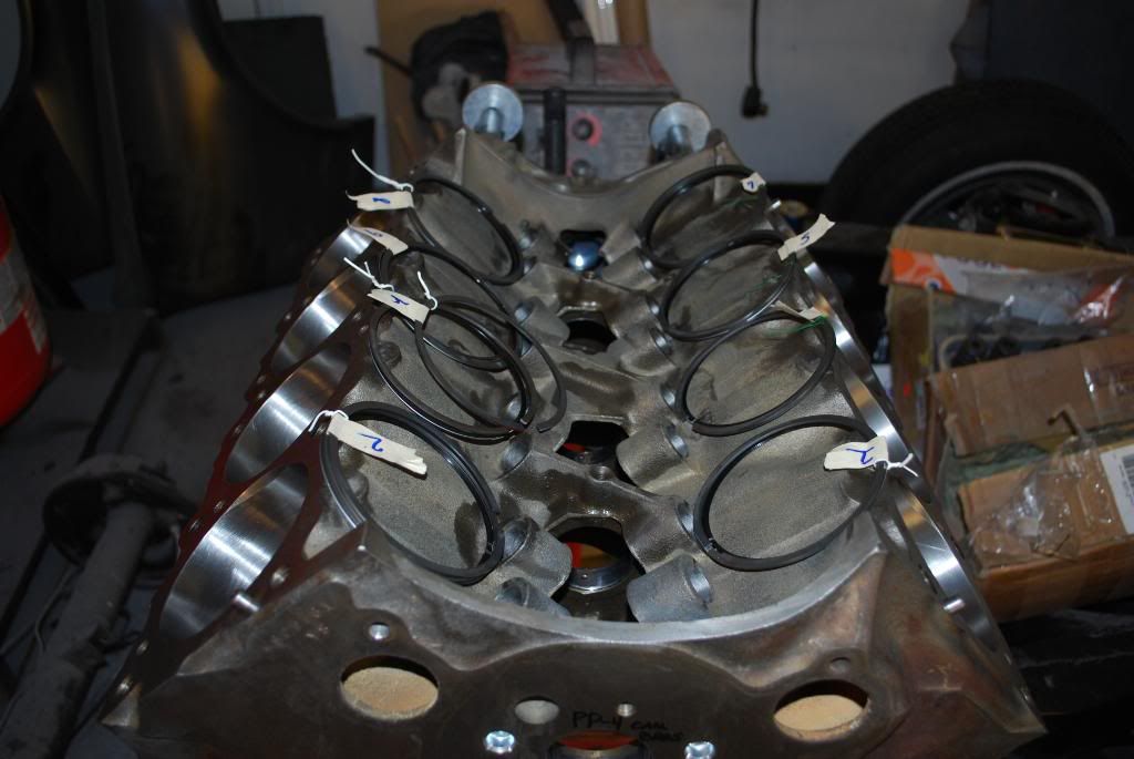

I picked up my parts this past Friday; now the fun begins. I filed the rings to fit and should hopefully get the shortblock assembled this week. Here are the pics:
http://i223.photobucket.com/albums/d...azy28/FB11.jpg
http://i223.photobucket.com/albums/d...azy28/FB12.jpg
http://i223.photobucket.com/albums/d...azy28/FB14.jpg
http://i223.photobucket.com/albums/d...azy28/FB16.jpg
http://i223.photobucket.com/albums/d...azy28/FB17.jpg

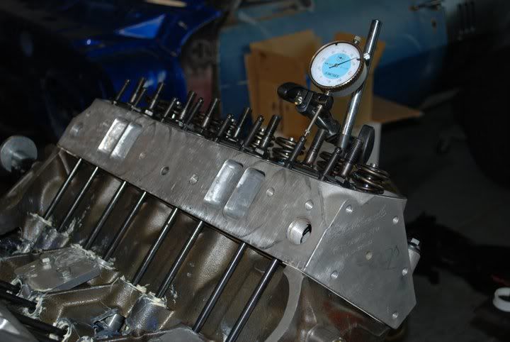

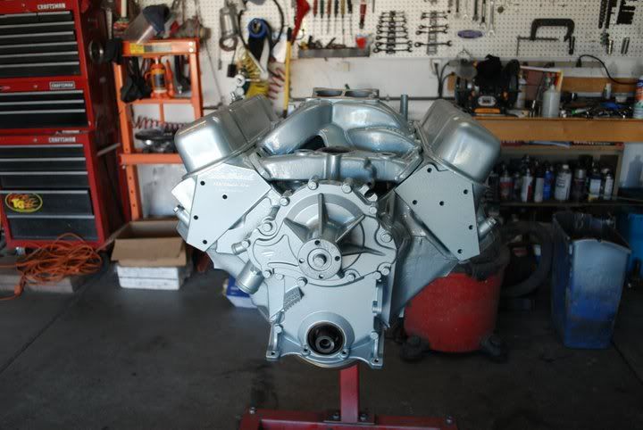

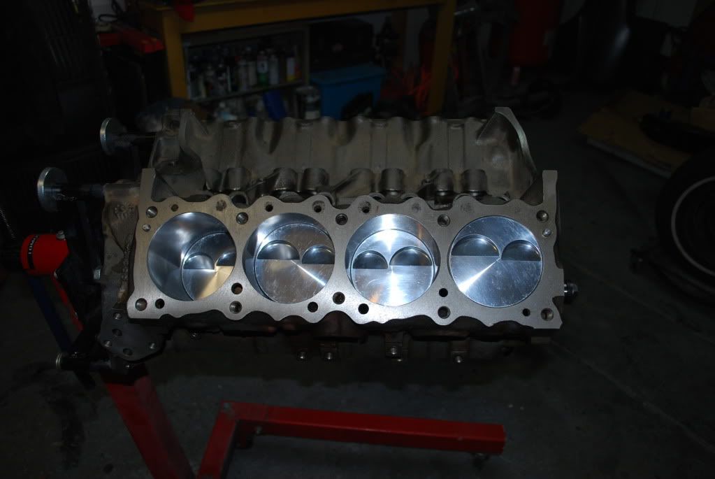

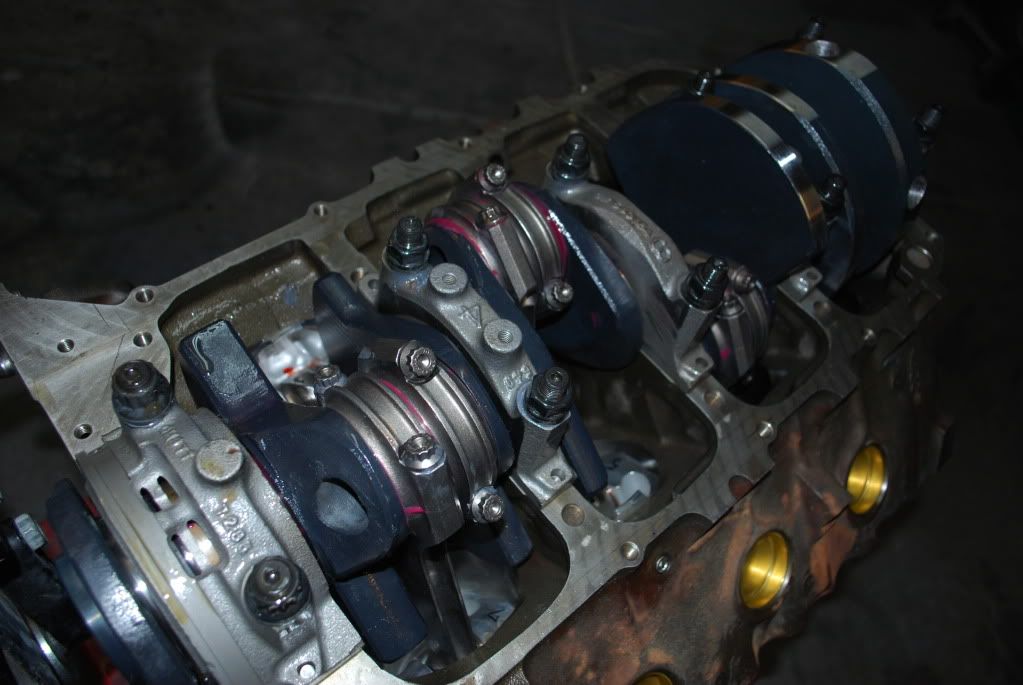

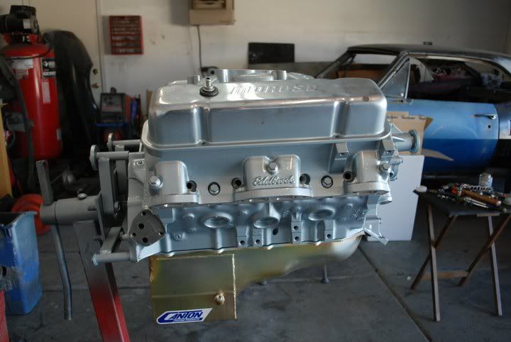

67rstbkt 10-03-2011 10:41 AM

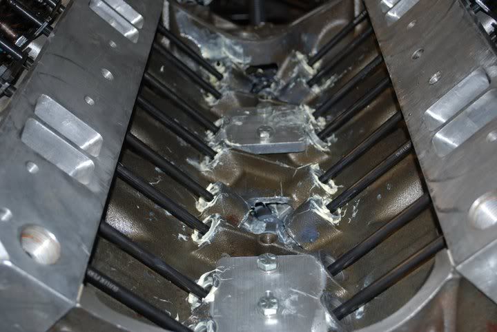

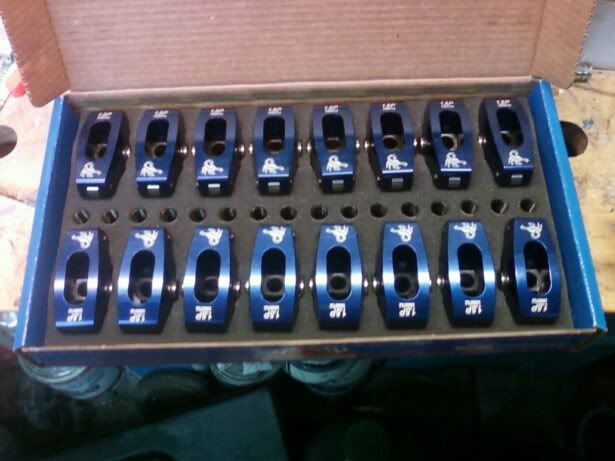

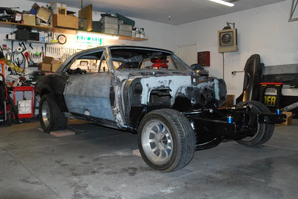

I guess I'm long over due for an update. Progress has been slow, I sort of got sidetracked on another deal. The block is mostly together and painted. I'm just waiting on the manifold, it's at the machine shop. It needs some material removed to fit due to the block decking and head resurfacing. The heads got a little more work than I originally intended. In addition to resurfacing, the ports and chambers were cleaned up, new springs installed, and the vlave job was touched up.
Here are some pics:
http://i223.photobucket.com/albums/d...ebird/p9-1.jpg
http://i223.photobucket.com/albums/d...ebird/p8-1.jpg
http://i223.photobucket.com/albums/d...ebird/p7-1.jpg
http://i223.photobucket.com/albums/d...ebird/p2-1.jpg
http://i223.photobucket.com/albums/d...ebird/p4-1.jpg

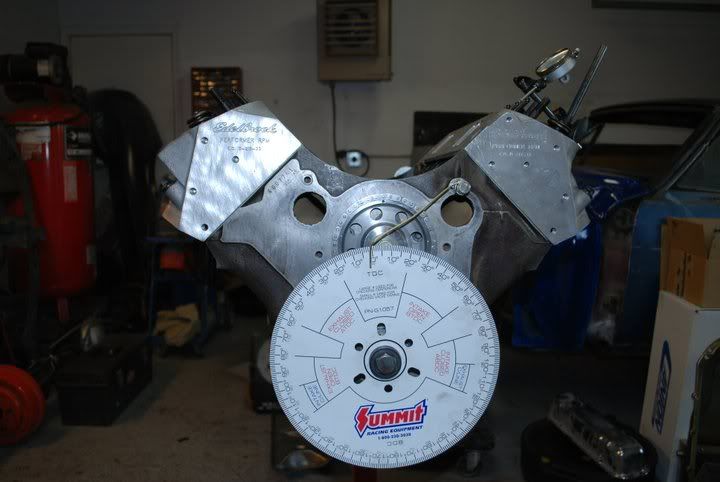

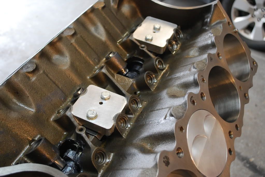

67rstbkt 10-03-2011 10:49 AM

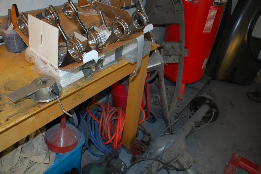

A few more:
http://i223.photobucket.com/albums/d...rd/degree2.jpg
http://i223.photobucket.com/albums/d.../assemble1.jpg
http://i223.photobucket.com/albums/d...lockdegree.jpg
http://i223.photobucket.com/albums/d...ckpainted2.jpg
http://i223.photobucket.com/albums/d...ckpainted3.jpg
