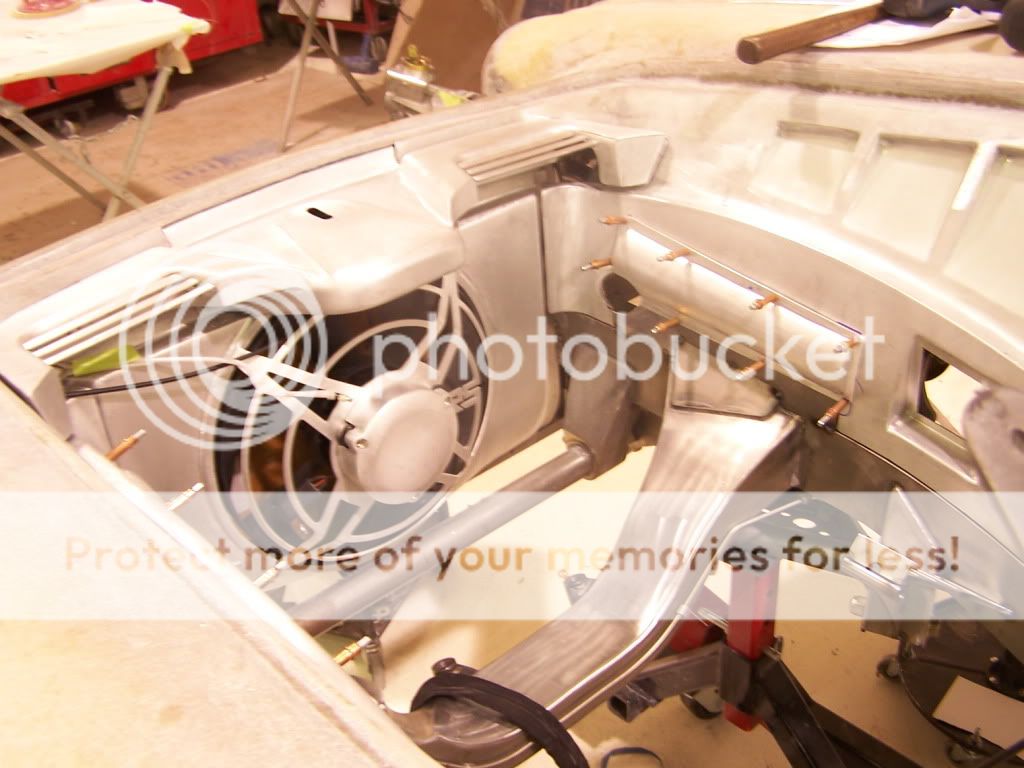

Roadster Shop 06-16-2009 03:23 PM

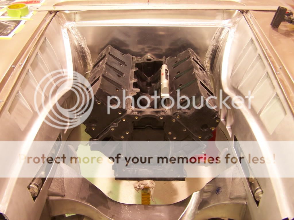

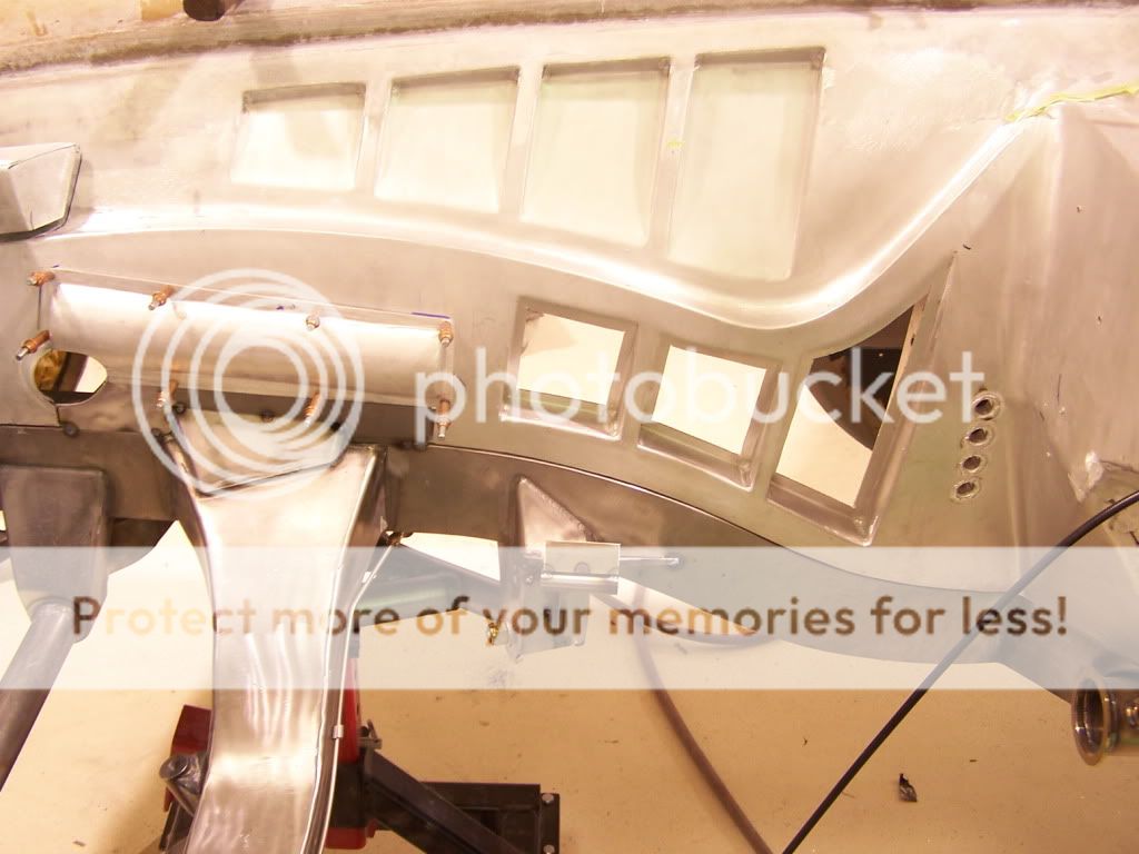

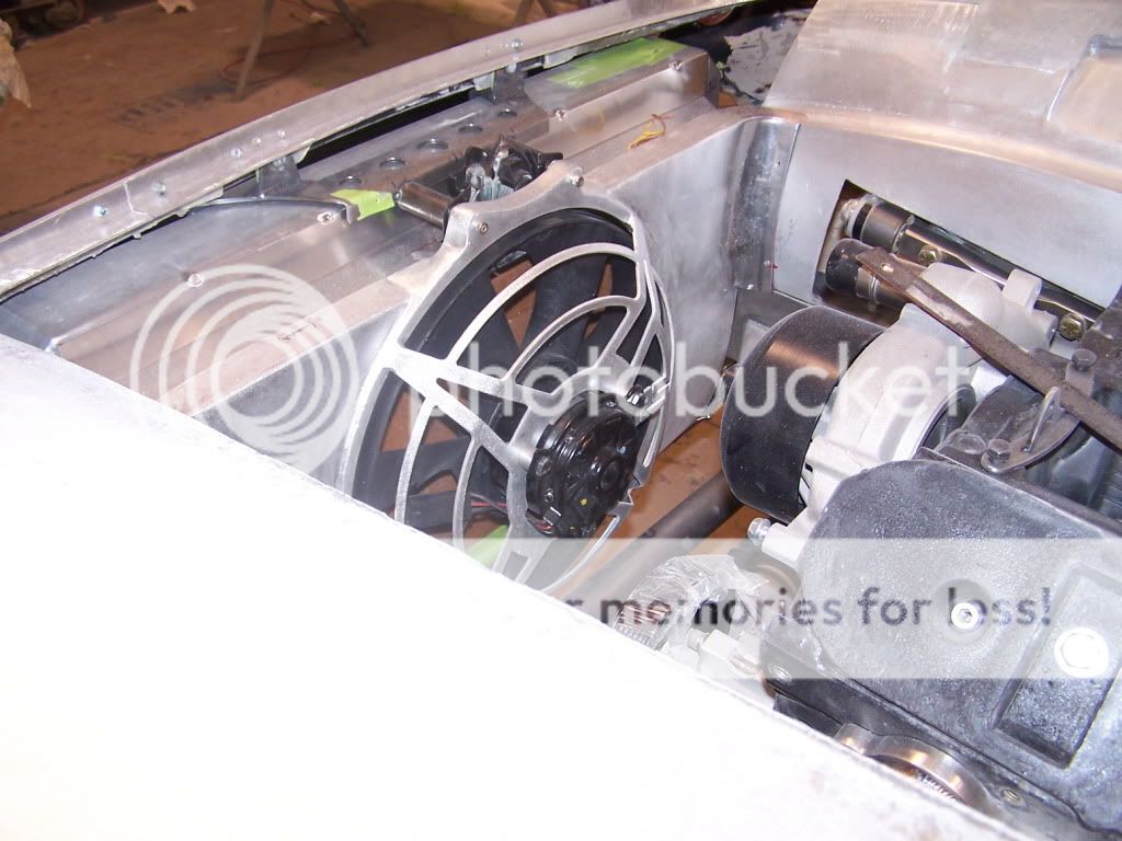

Sorry for the delay..... Here are a few shots fo the aluminum work under the hood.
http://i563.photobucket.com/albums/ss79/RS-Perf/37.jpg
The entire inner fender/firewall panel removed from the body for final welding before the final installation into the body.
http://i563.photobucket.com/albums/ss79/RS-Perf/39.jpg
Close up of some of the detail work.
http://i563.photobucket.com/albums/ss79/RS-Perf/38.jpg
Aluminum fan shroud taking shape
http://i563.photobucket.com/albums/ss79/RS-Perf/40.jpg

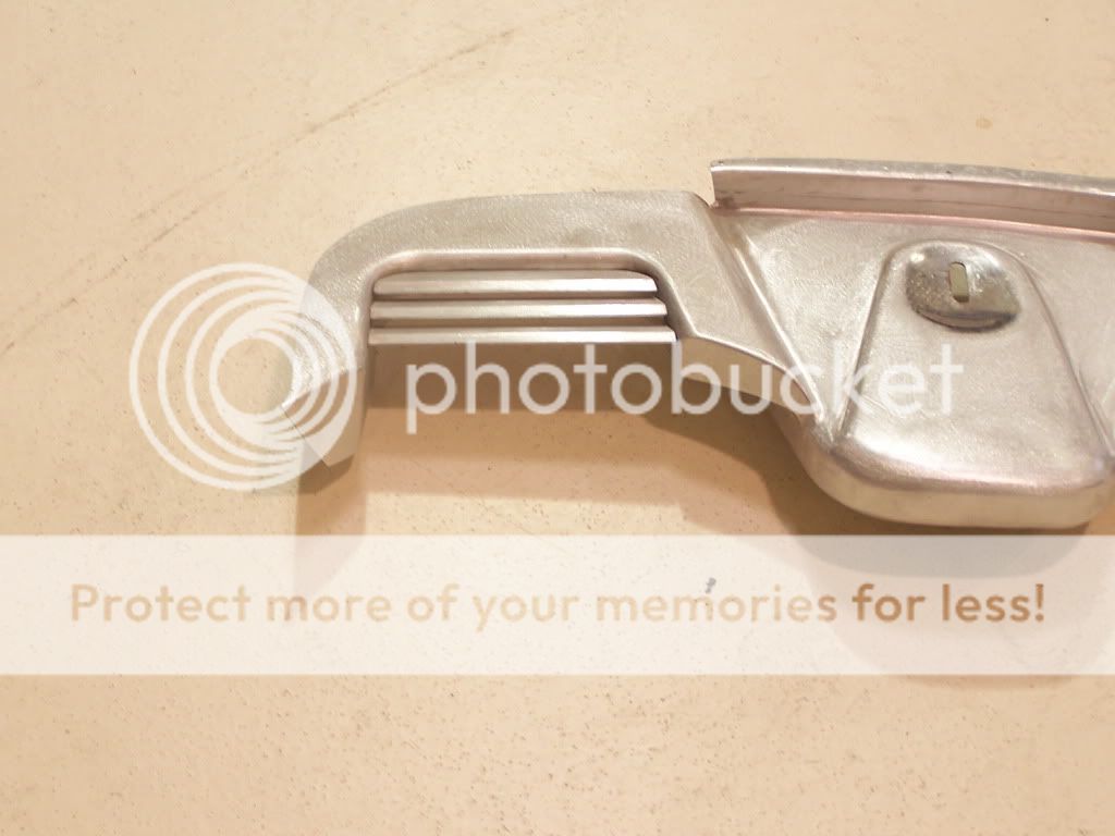

Roadster Shop 06-16-2009 03:28 PM

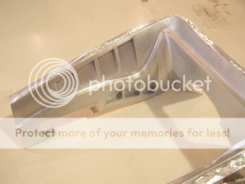

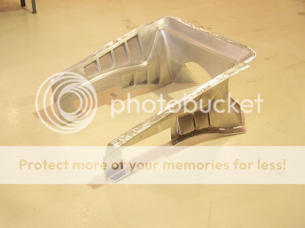

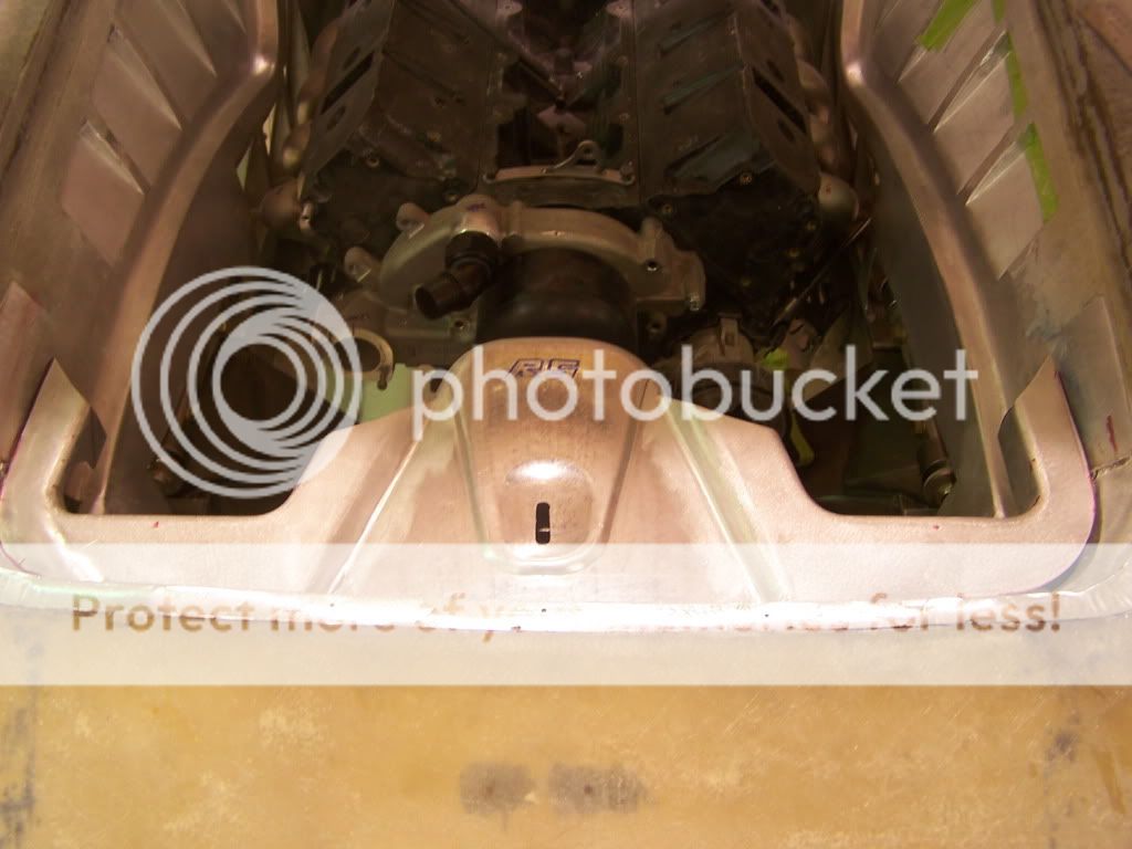

Cover for the upper control arm and the lower recess have been cut out to get header heat out of the engine compartment.
http://i563.photobucket.com/albums/ss79/RS-Perf/47.jpg

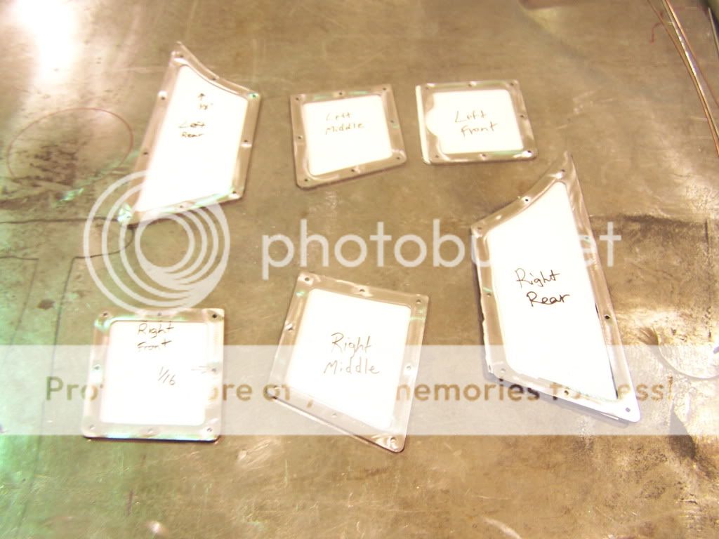

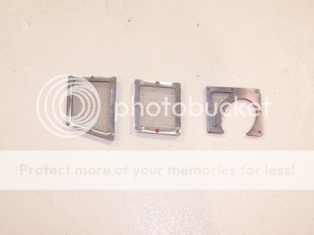

Templates for inserts
http://i563.photobucket.com/albums/ss79/RS-Perf/48.jpg
Inserts and bezels assembled for driver's side. The circle is cut out for the steering to go through.
http://i563.photobucket.com/albums/ss79/RS-Perf/49.jpg

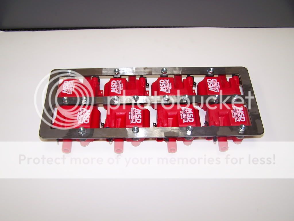

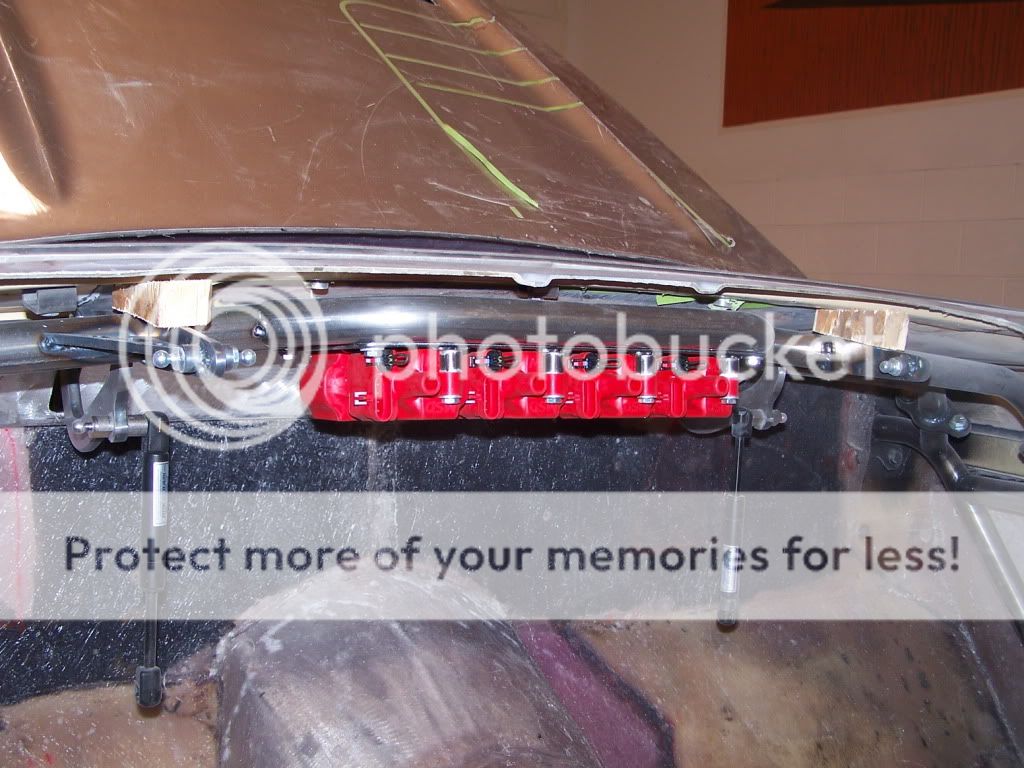

Roadster Shop 06-16-2009 03:34 PM
Coil pack mount
http://i563.photobucket.com/albums/ss79/RS-Perf/84.jpg
Installed under the dash
http://i563.photobucket.com/albums/ss79/RS-Perf/85.jpg

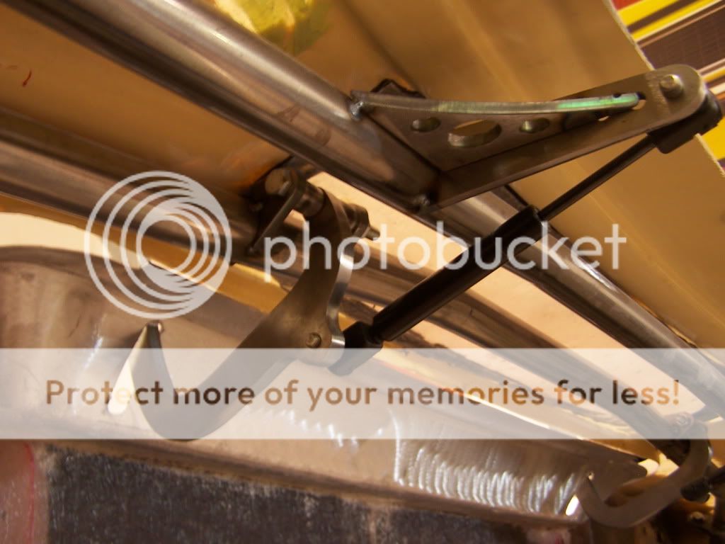

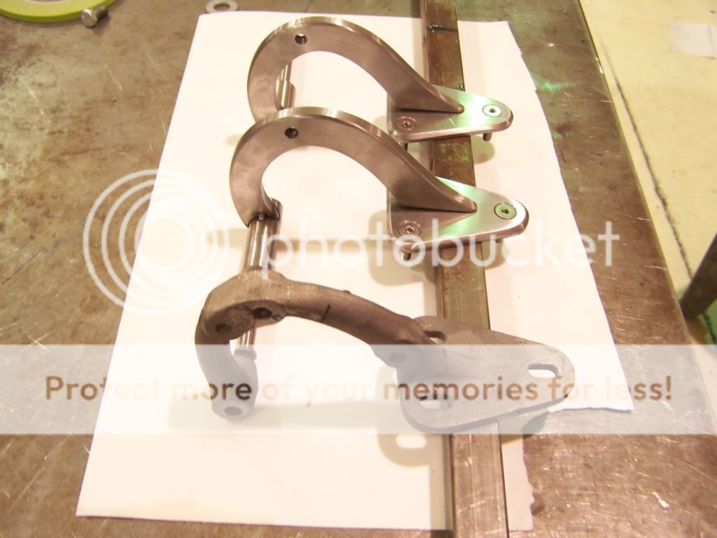

Designed new hood hinged so the hood hinges at the rear. Hinges and shocks go under the dash for a clean under hood appearance
http://i563.photobucket.com/albums/ss79/RS-Perf/51.jpg
Fabbed new trunk hinges as a clean version of the original.
http://i563.photobucket.com/albums/ss79/RS-Perf/50.jpg

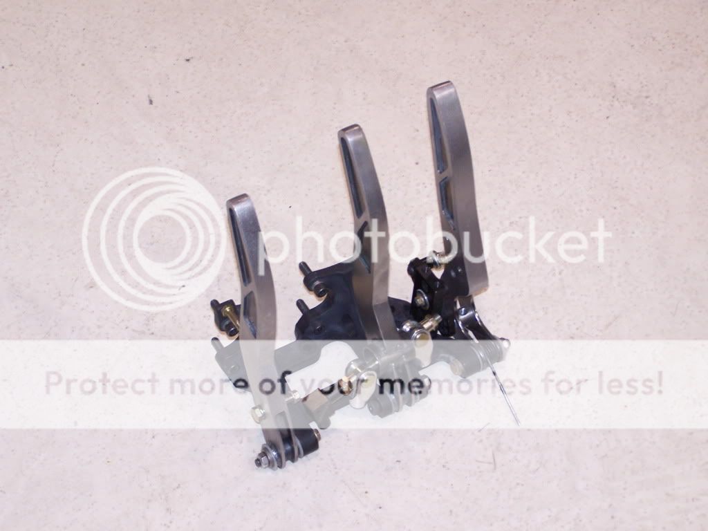

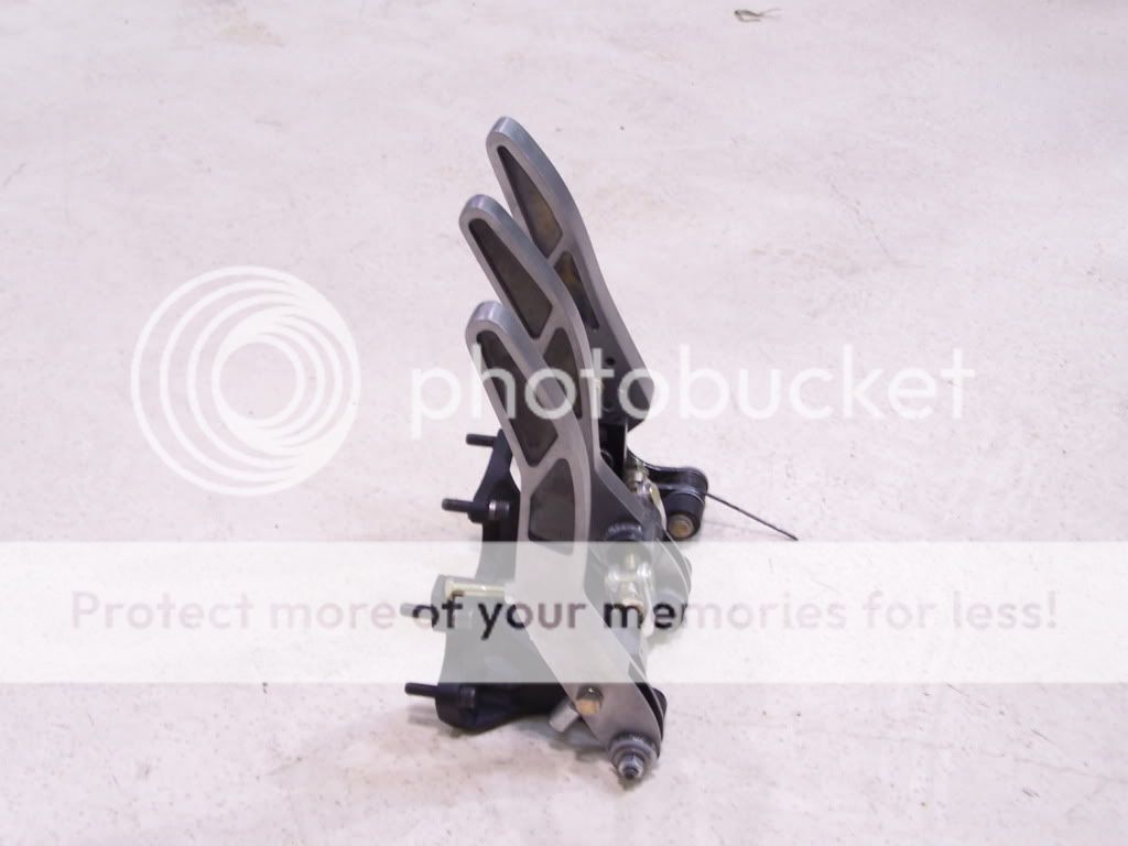

Roadster Shop 06-16-2009 03:37 PM

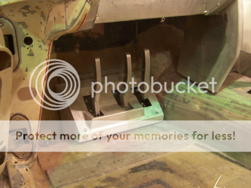

Pedal assembly
http://i563.photobucket.com/albums/ss79/RS-Perf/81.jpg
http://i563.photobucket.com/albums/ss79/RS-Perf/82.jpg
Installed in car with aluminum pedal box cover (Actual pedal pads still to be installed)
http://i563.photobucket.com/albums/ss79/RS-Perf/83.jpg

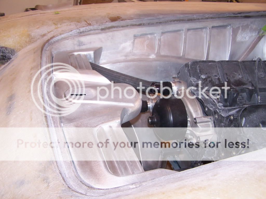

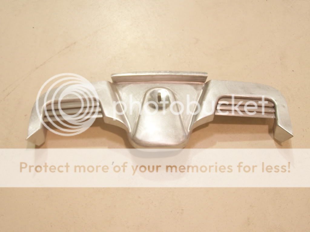

More under hood pics.
Aluminum upper radiator cover
http://i563.photobucket.com/albums/ss79/RS-Perf/41.jpg
http://i563.photobucket.com/albums/ss79/RS-Perf/42.jpg
http://i563.photobucket.com/albums/ss79/RS-Perf/43.jpg
http://i563.photobucket.com/albums/ss79/RS-Perf/44.jpg
Aluminum fab shroud completed and all aluminum panels fit to car.
http://i563.photobucket.com/albums/ss79/RS-Perf/46.jpg

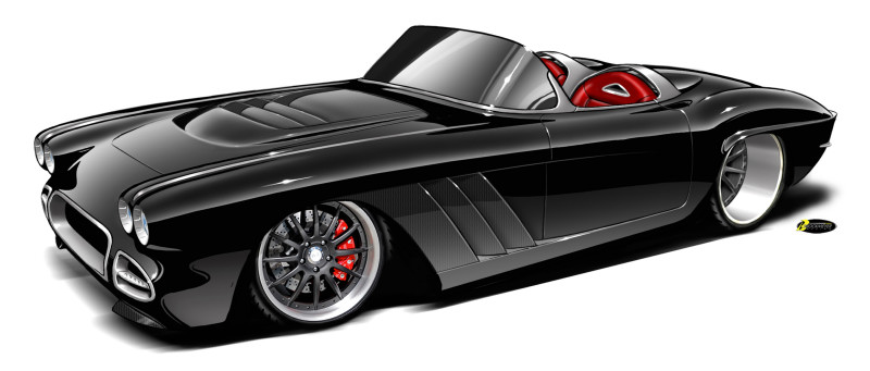

awr68 06-21-2009 10:26 AM
You guys hit it right out of the park!! Congrats!! Got a rendering to share? :thumbsup: :bow:
Al Moreno 06-21-2009 10:32 AM
1 Attachment(s)
Attachment 18044
Off the Good Guys website. Can't wait to see it in Columbus.

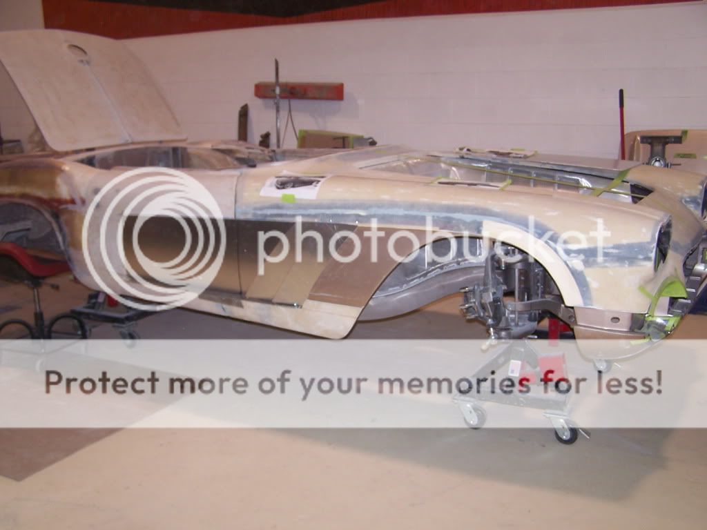

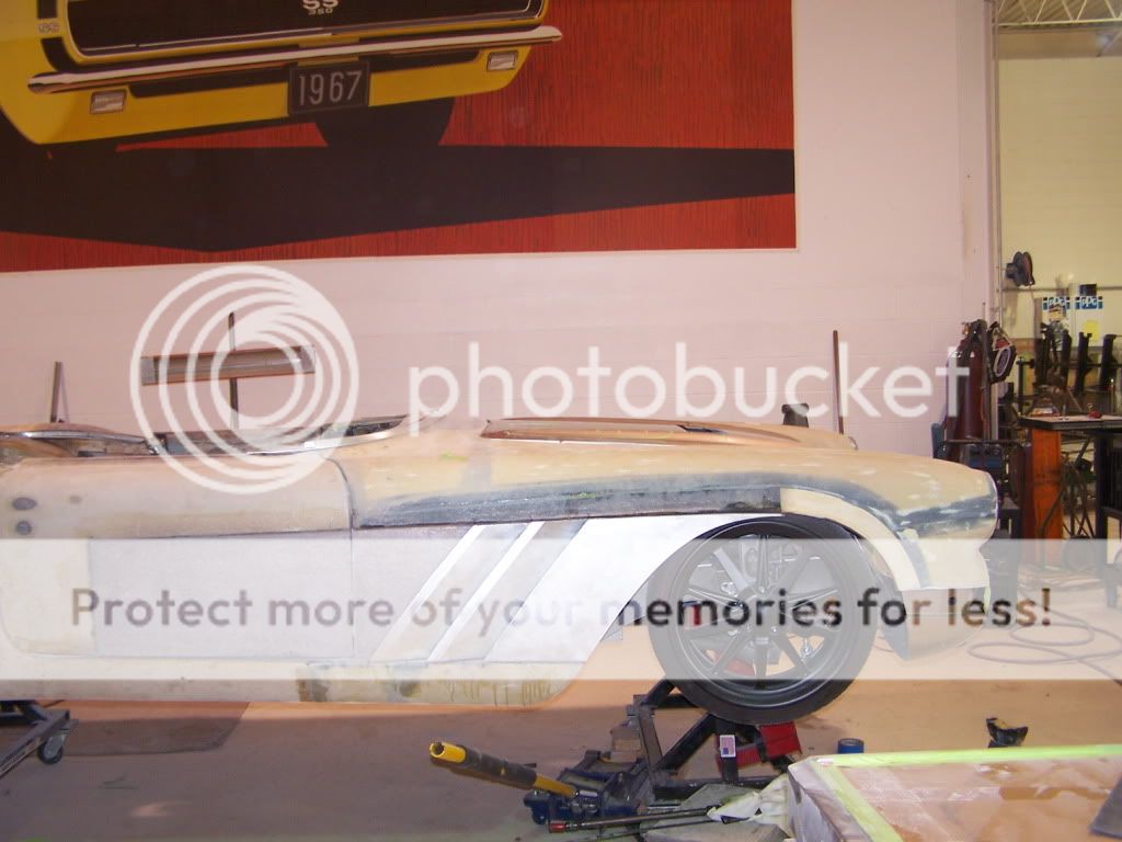

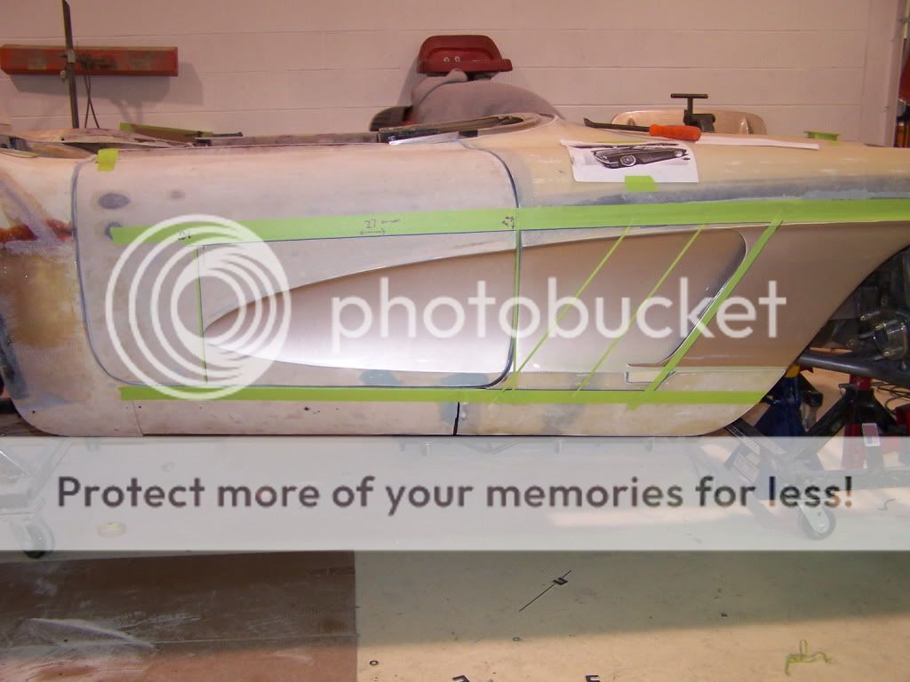

Roadster Shop 06-22-2009 10:46 AM

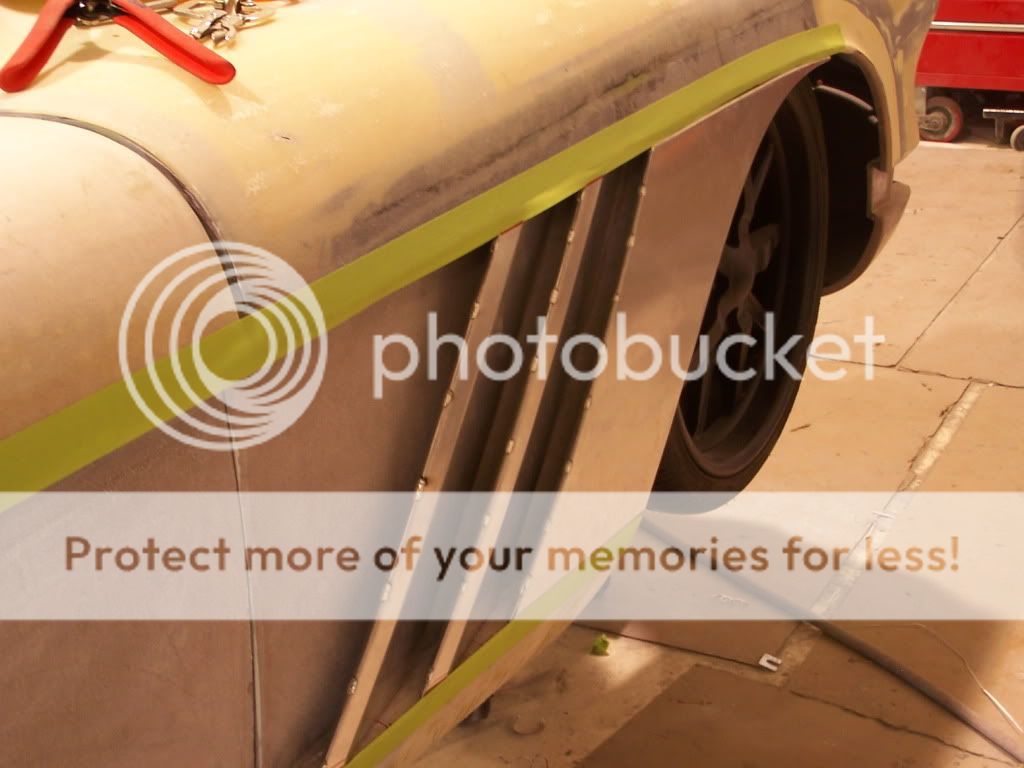

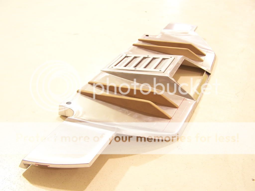

Side body modification. Eliminated the stock "cove" in the door and fender. Made a deeper recess that housed 3 carbon fiber louvers.
Laying out the new body lines
http://i563.photobucket.com/albums/ss79/RS-Perf/52.jpg
Door and rear of fender recesses cut in and mocking up louver design.
http://i563.photobucket.com/albums/ss79/RS-Perf/53.jpg
Louvers first fabricated out of aluminum. These will be used as bucks for the carbon fiber panels.
http://i563.photobucket.com/albums/ss79/RS-Perf/54.jpg
Completed aluminum work w/ recess glassed into the body.
http://i563.photobucket.com/albums/ss79/RS-Perf/55.jpg

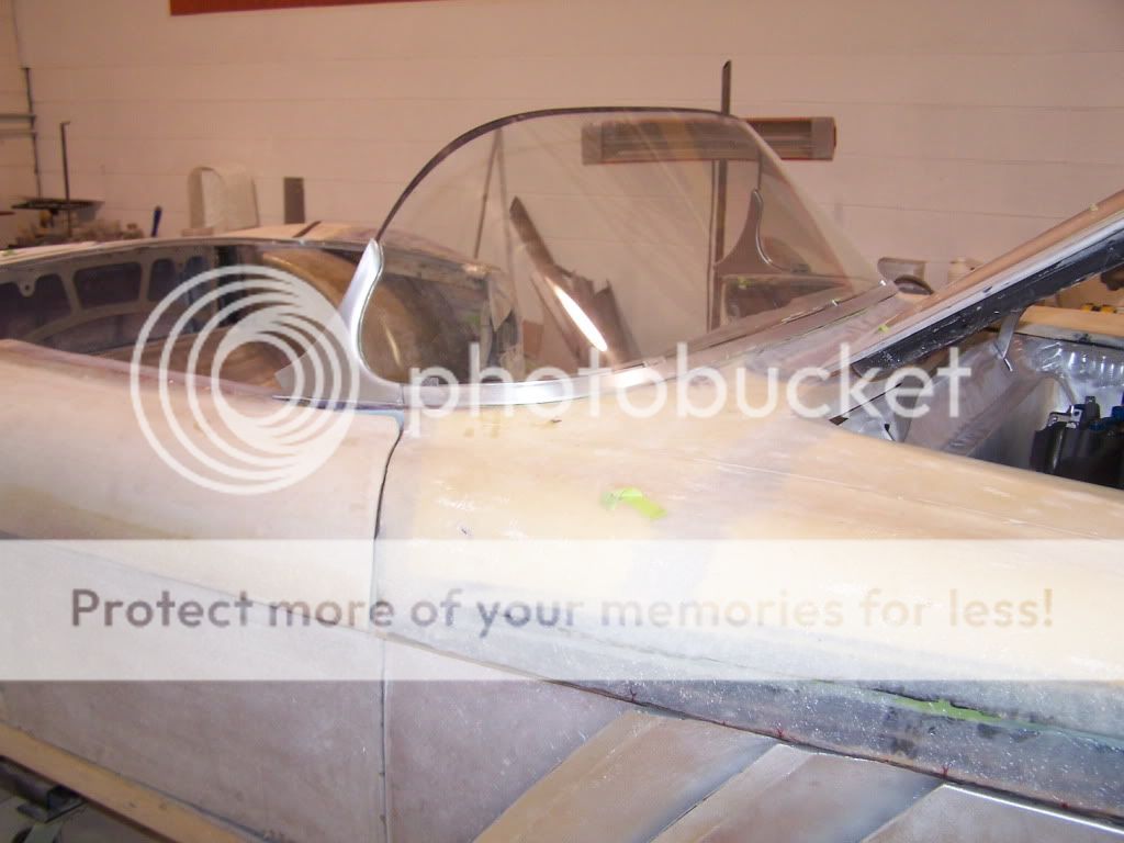

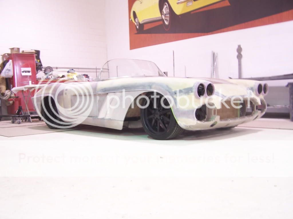

Roadster Shop 06-22-2009 10:50 AM

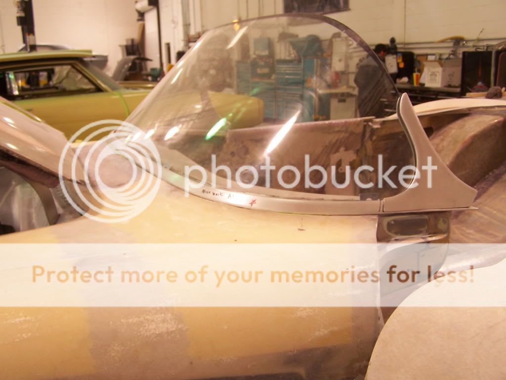

eliminated the stock windshield trim and fabricated a complete new design. The top of the cowl was changed for a smoother transition. The windshield was also trimmed down and leaned back for a mroe aggressive profile.
http://i563.photobucket.com/albums/ss79/RS-Perf/56.jpg
http://i563.photobucket.com/albums/ss79/RS-Perf/57.jpg
Assembled and set on the ground for the first time!
http://i563.photobucket.com/albums/ss79/RS-Perf/58.jpg

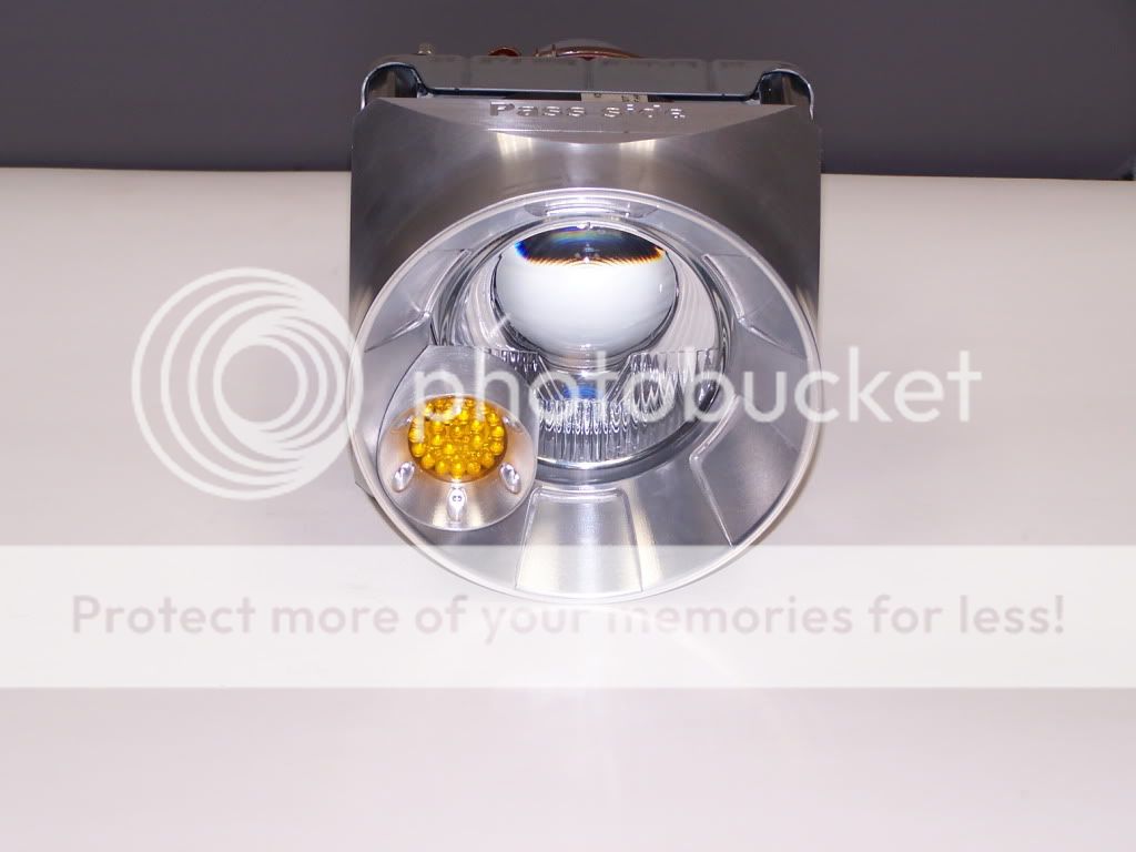

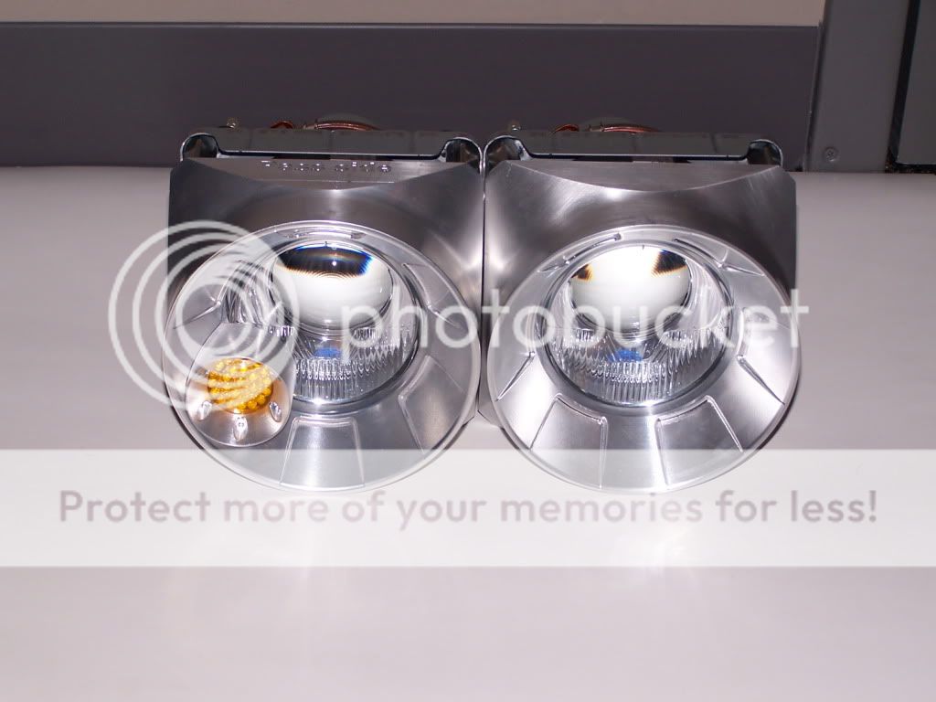

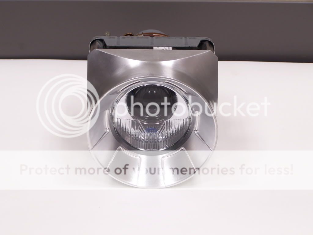

1-off headlights w/projection lenses, HID's and Hella balast. Billet bezels and mounts with integrated turn signals.
http://i563.photobucket.com/albums/ss79/RS-Perf/131.jpg
http://i563.photobucket.com/albums/ss79/RS-Perf/133.jpg
http://i563.photobucket.com/albums/ss79/RS-Perf/132.jpg

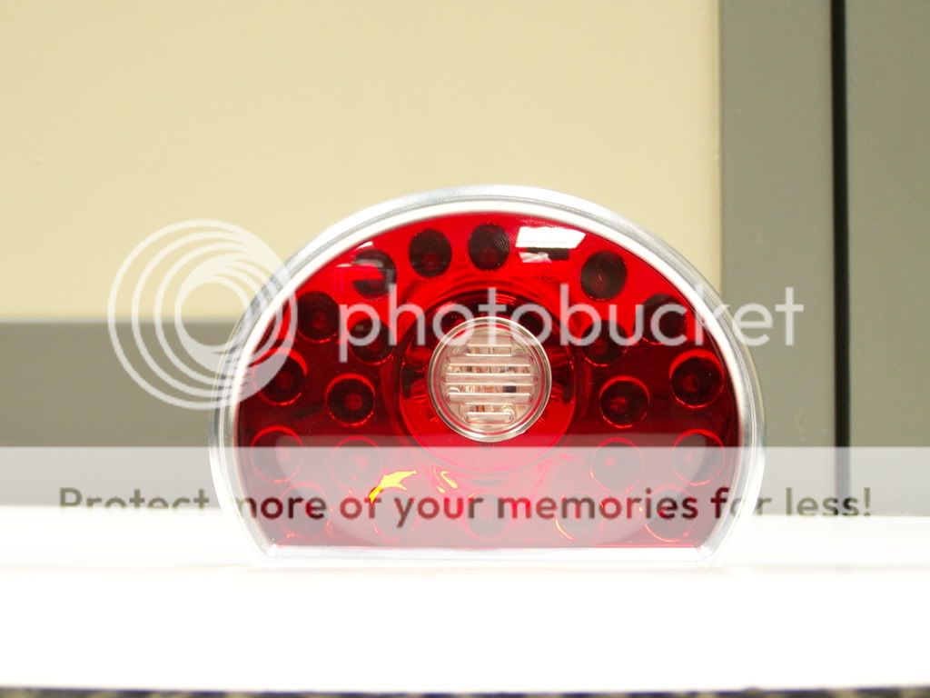

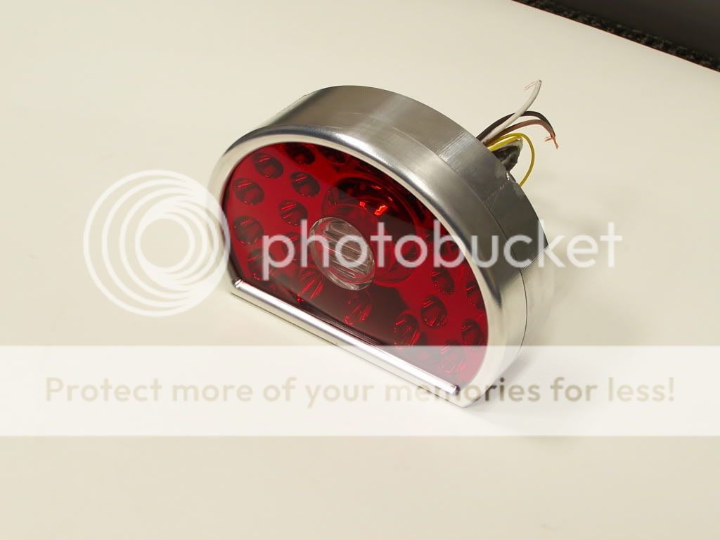

Roadster Shop 06-23-2009 10:55 AM
1-off billet, LED tail lights
http://i563.photobucket.com/albums/ss79/RS-Perf/134.jpg
http://i563.photobucket.com/albums/ss79/RS-Perf/135.jpg
