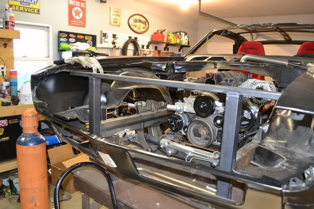

I decided to change the core support and go to a mustang style engine bay with the fixed inner wheel wells. It looks alot better than what GM came up with. Here is the start of it.
http://i238.photobucket.com/albums/f...4/DSC_0312.jpg

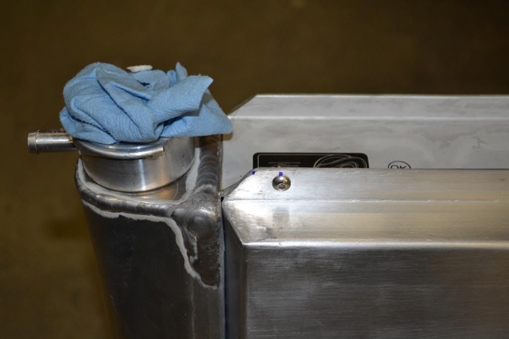

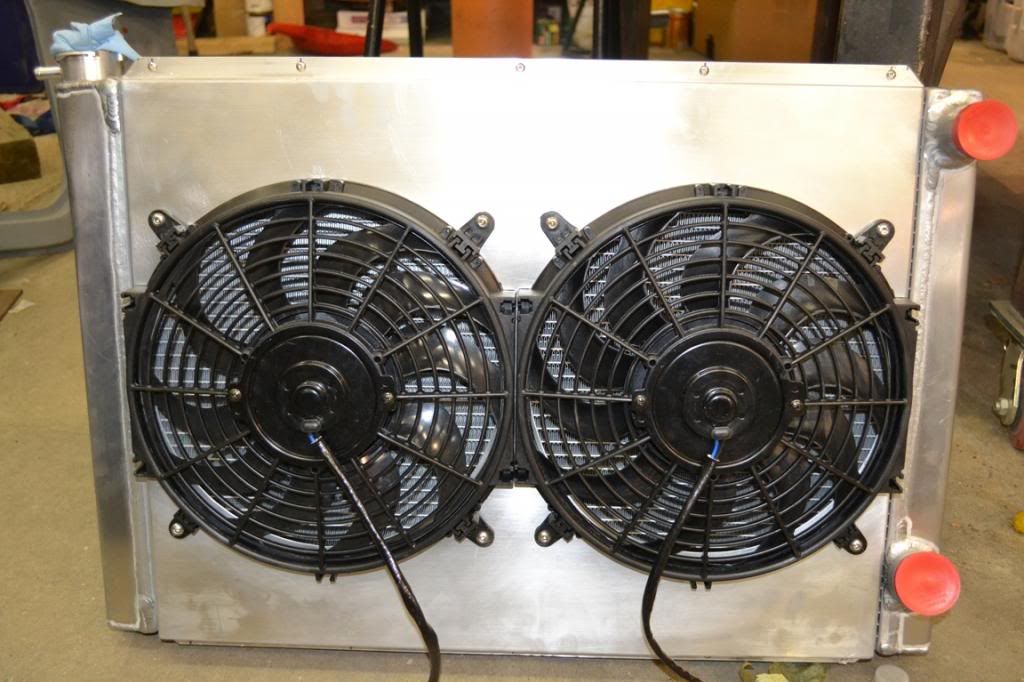

I chose a wider radiator than what a stock Camaro to get more cooling capacity and I had room to widen it. I found some nice 12" fans that fit perfectly behind the radiator. I made a shroud for it instead of trying to buy one. It was alot cheaper and easier to make my own
http://i238.photobucket.com/albums/f...4/DSC_0334.jpg
http://i238.photobucket.com/albums/f...4/DSC_0333.jpg

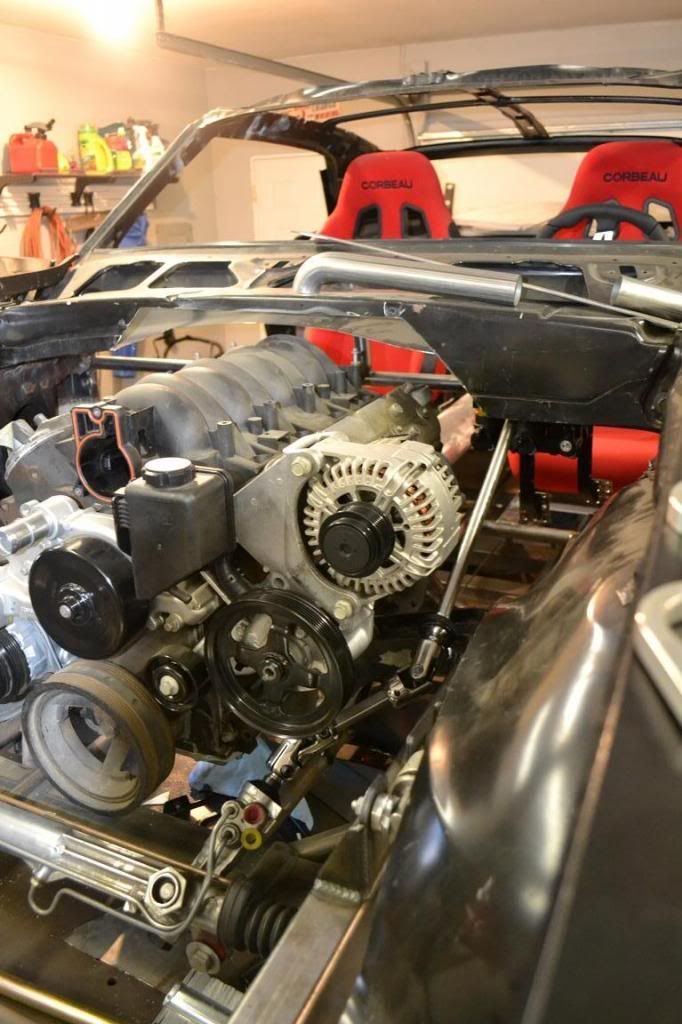

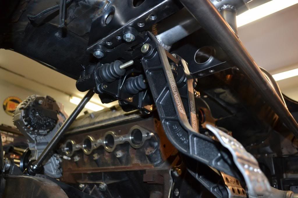

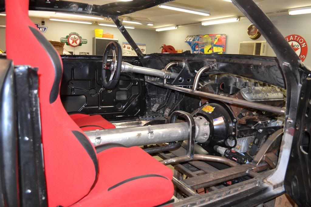

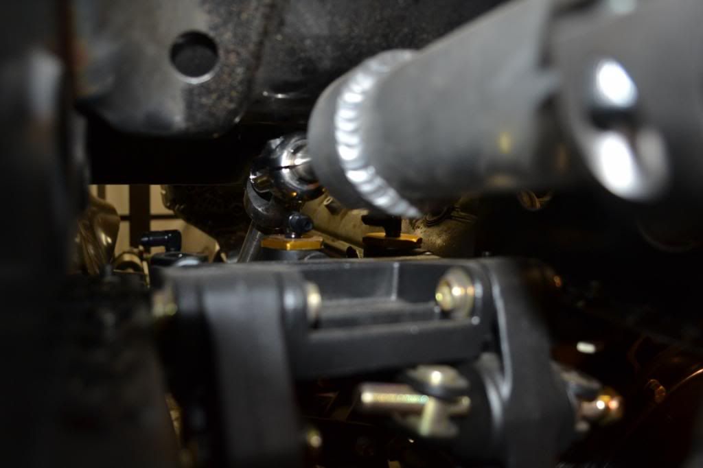

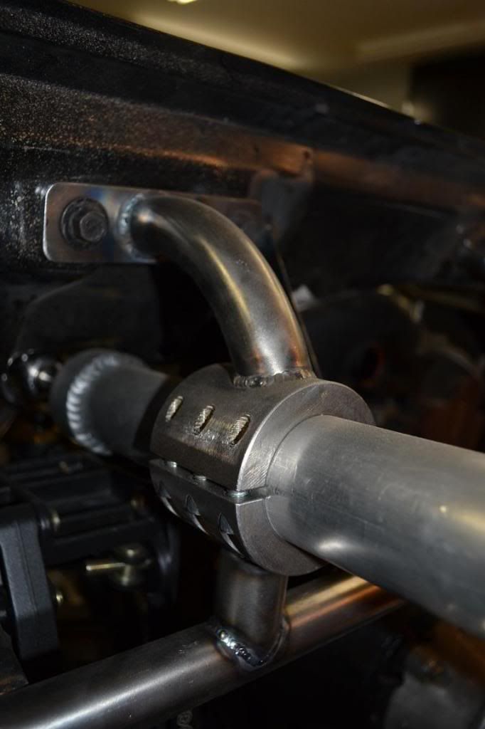

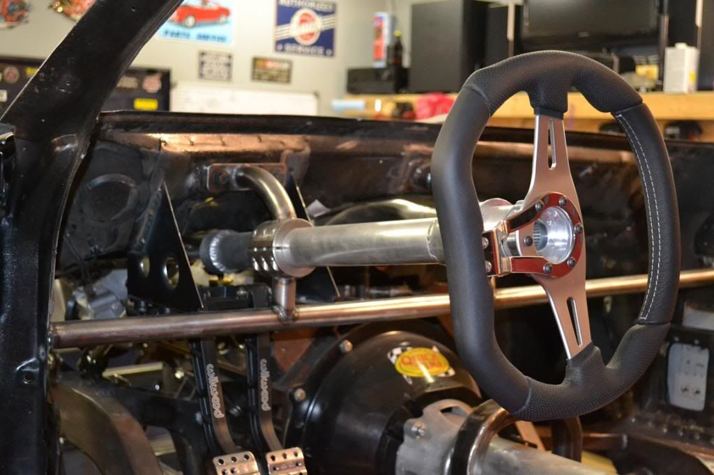

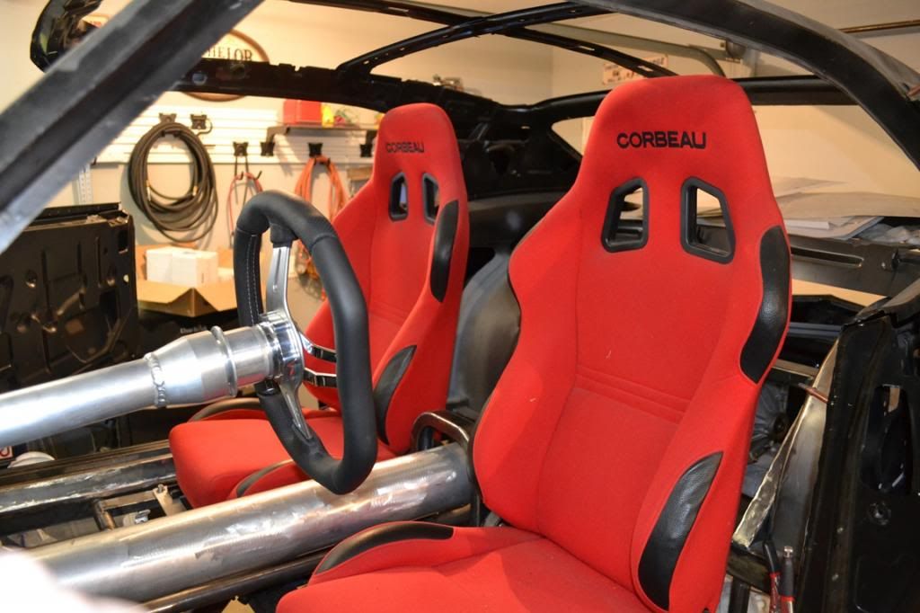

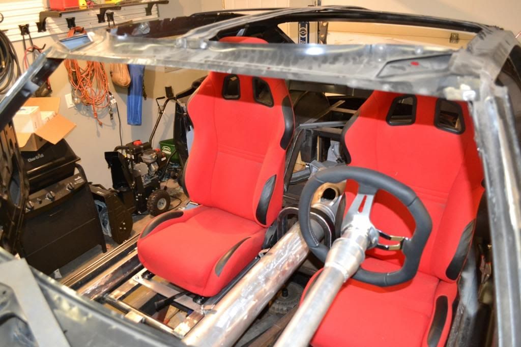

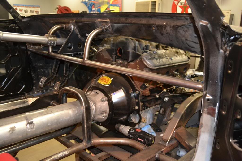

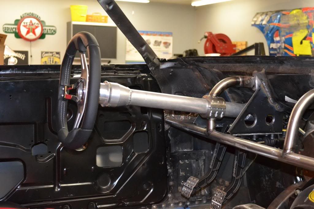

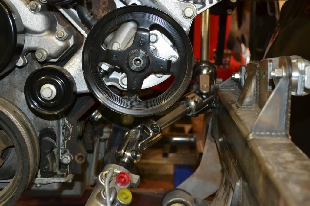

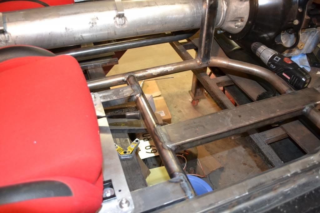

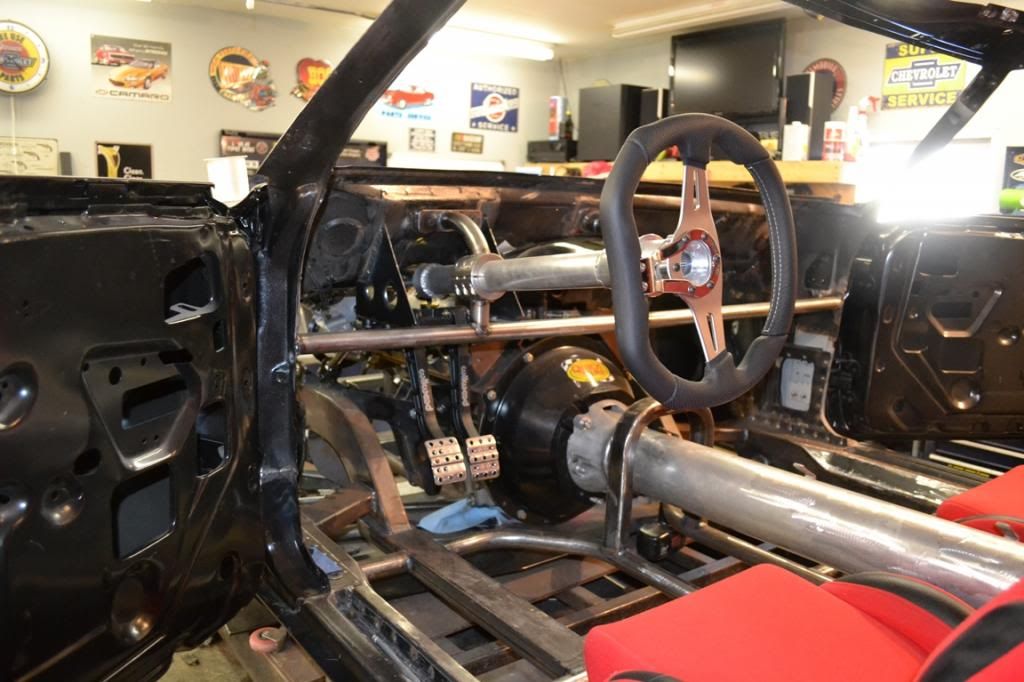

Also been working on the steering column mounting and placement in the car. Also worked on the Pedal mounts, seat mounts welded in and the steering shaft completed! So Ill quit talking and get the pictures up!
http://i238.photobucket.com/albums/f...4/DSC_0308.jpg
http://i238.photobucket.com/albums/f...4/DSC_0307.jpg
http://i238.photobucket.com/albums/f...4/DSC_0309.jpg
http://i238.photobucket.com/albums/f...4/DSC_0328.jpg
http://i238.photobucket.com/albums/f...4/DSC_0332.jpg
http://i238.photobucket.com/albums/f...4/DSC_0330.jpg
http://i238.photobucket.com/albums/f...4/DSC_0329.jpg

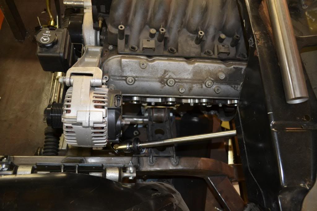

Just a suggestion - I see your using the c5 accessory drive.
The bolt that holds the power steering reservoir tank and bolts into the head - make sure you notch that bolt hole.
It makes it a lot easier having to service/remove that in the future.
I just experienced that pain working on my c6!
