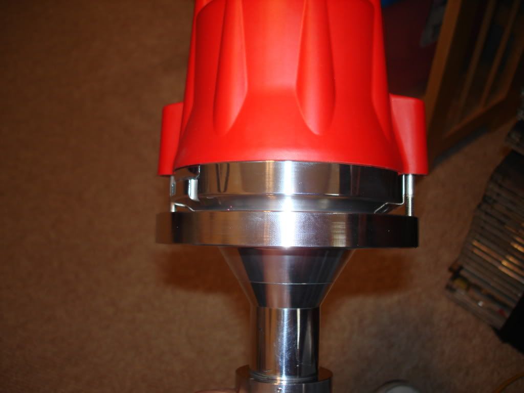

Re-check the MSD cap to see how well it fits "snug" to the distributor vs the FAST unit. Also make sure you don't see it "walking" on the distributor base when running/revving the engine. I've seen this happen with MSD/FAST when used together.
67ragtp 10-15-2009 04:31 PM
Thanks Dennis- As a matter of fact I wasn't happy with the fit , the cap is keyed but the spring loaded hooks on the msd cap that hold the cap down felt a bit weak. I could see how its possible for it to pop up and walk. Its no where near the clamping force of the original cap.
Any suggestions on how to secure it better? Any mods that can be done?
Rich
64duece 10-16-2009 09:13 AM
The MSD isn't a snug fit. We didn't mod anything but, decided the FAST cap was better and replaced it with another one of theirs.

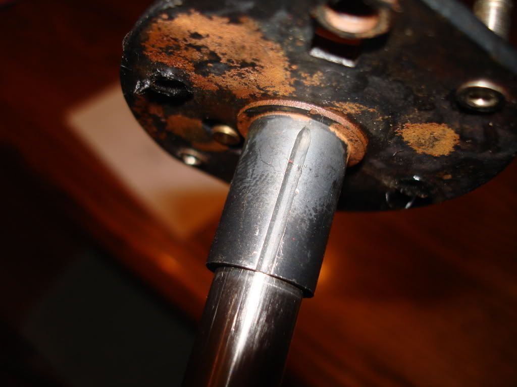

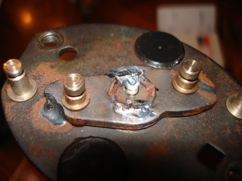

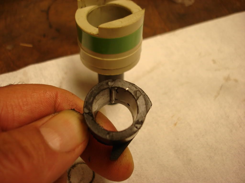

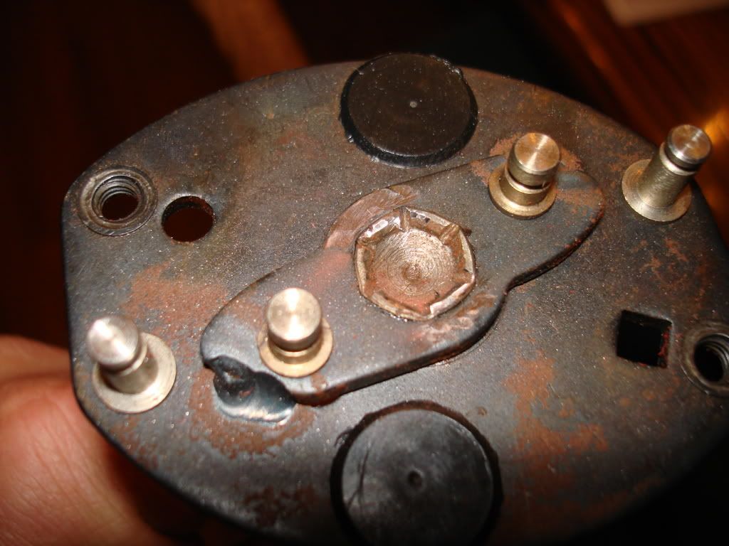

67ragtp 12-05-2009 11:51 AM
I got a chance to pull the distributor out of the engine, to break it down. Thought I would share my findings and some mods I did to make it more reliable.
First thing I did was press out the drift pin that retains the distributor drive gear and pul the shaft out.
http://i168.photobucket.com/albums/u...Picture074.jpg
I found the crimp at the top of the distributor shaft that holds the rotor mounting plate was able to spin back and forth about 5 degrees, not good!
So A few tig tacks did the job

After removing the magnet holder and its indexing key, I relized this plastic key can easily strip out of the key way in the shaft. Since mine was a decent fit I simply cleaned it and added som armstrong A-12 epoxy to insure its not going anywhere
http://i168.photobucket.com/albums/u...cture073-1.jpg

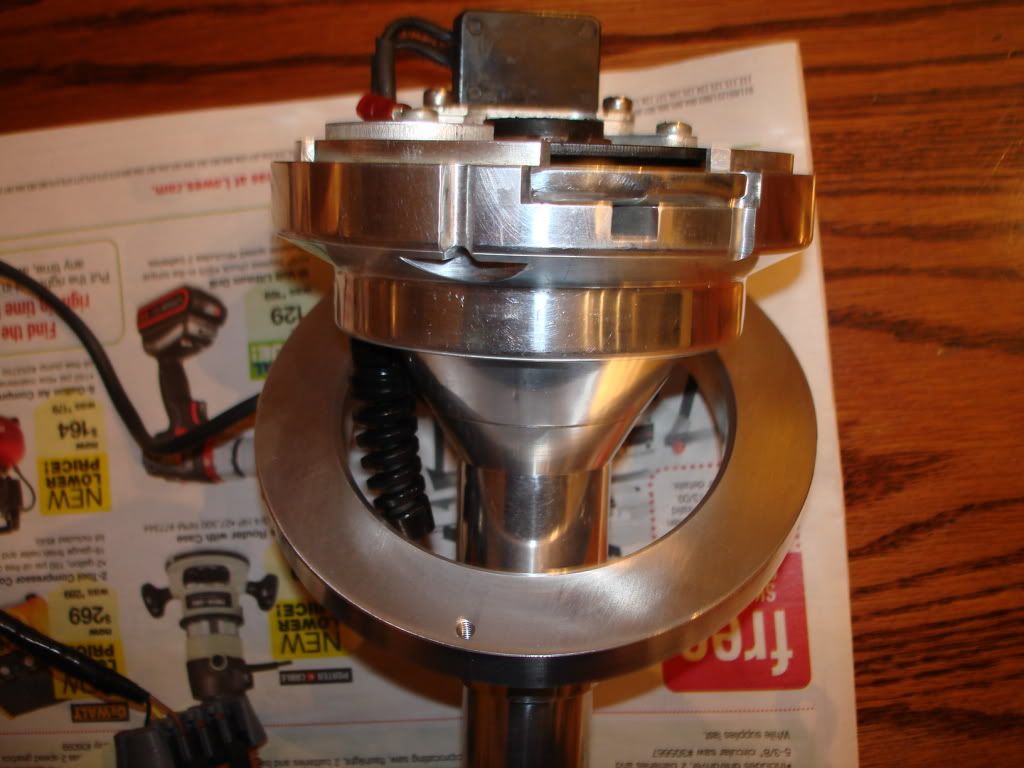

I cleaned up all the rust and re painted. The loose fitting msd cap was the final step. I machined an alluminum ring to fit over a step on the outside of the housing, drilled a tapped it for 8-32 and dropped some cap screws down to squeeze it up tight. It fit real nice. And the cap is super tight now.
http://i168.photobucket.com/albums/u...Picture093.jpg
http://i168.photobucket.com/albums/u...Picture099.jpg
Dropped it back in to the engine, unfortunatly its snowing out so I cant test it but I think it should be more reliable now.

Nice fix Rich. I just recently bought a small mill and I've been wanting to get a rotary table which may be just what I need since I do not think I can bore a hole large enough for the ring.
Pay particular attention to your third picture. That is the key that sheared off of my distributor and caused all kinds of grief. Our fix was to slide the collar over a short piece of 1/2" dia. aluminum rod. Chuck it into the vise and then drill it. We centered the drill on the joint between the collar and shaft then drilled through the length of the collar. I do not remember the size of the drill bit but it's diameter equaled the diameter of the key slot on the dist shaft. We then installed the collar on the shaft and used a piece of stainless wire of the correct size to locate the collar properly and epoxied it in place.
