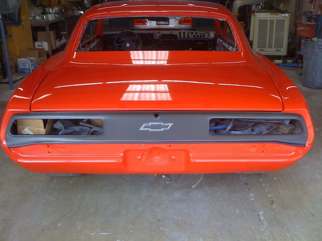

round two was completely worth it.. almost no texture.. im sure it will shrink a tad in the sun, but its not a show car so it will be fine..

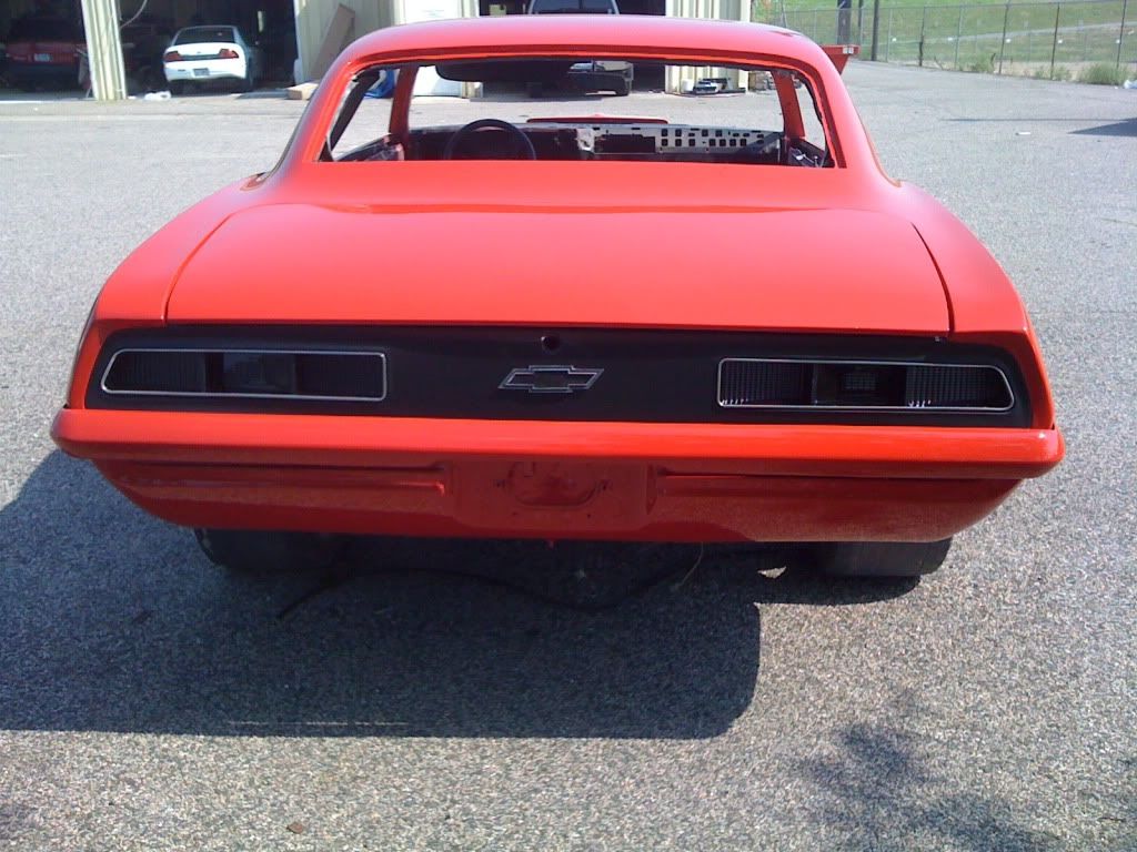

GM Muscle 08-25-2010 11:06 AM

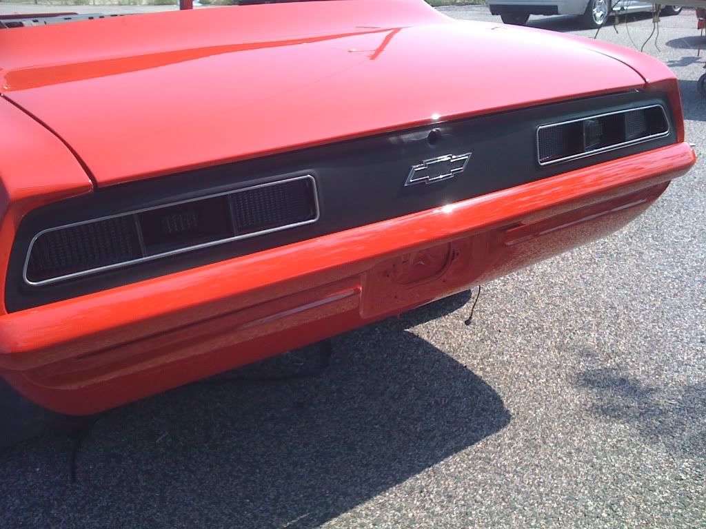

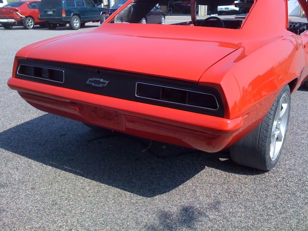

yesterday i managed to get the tail panel painted and smoked the tail lenses. i will post pics of them after i reassemble them. i need to get the bumpers hung up and the glass man i supposed to come through this weekend.
http://img.photobucket.com/albums/v3...b/2fc3b12c.jpg
syborg tt 08-25-2010 12:19 PM
car looks awesome - so what is the color of the back panel

GM Muscle 08-26-2010 09:34 AM
thanks. its SEM trim black. it come in an aerosol can.

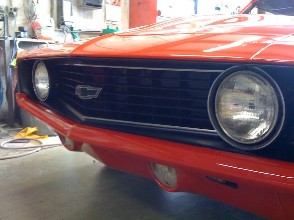

i managed to get the front and rear bumpers, grille and tail lights in. hopefully this weekend the glass guy will pull through and ill get the front and rear glass in. i also need to make a trip and pick up a paint seal kit and weatherstrip. anyways. heres some more pics..

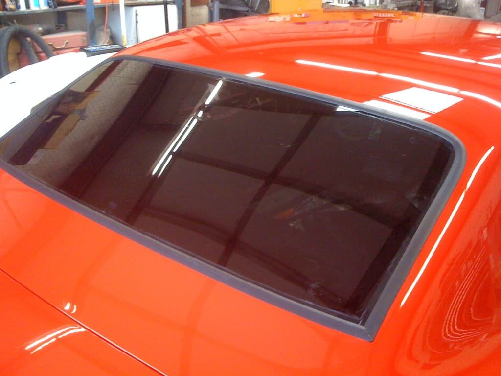

managed to get the windshield and back glass installed. also saw a good photo up and took it..
http://img.photobucket.com/albums/v3...h_1351a78f.jpghttp://img.photobucket.com/albums/v3...h_4ca39cca.jpghttp://img.photobucket.com/albums/v3...h_c7361eab.jpg

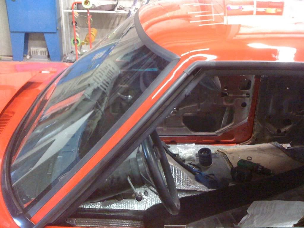

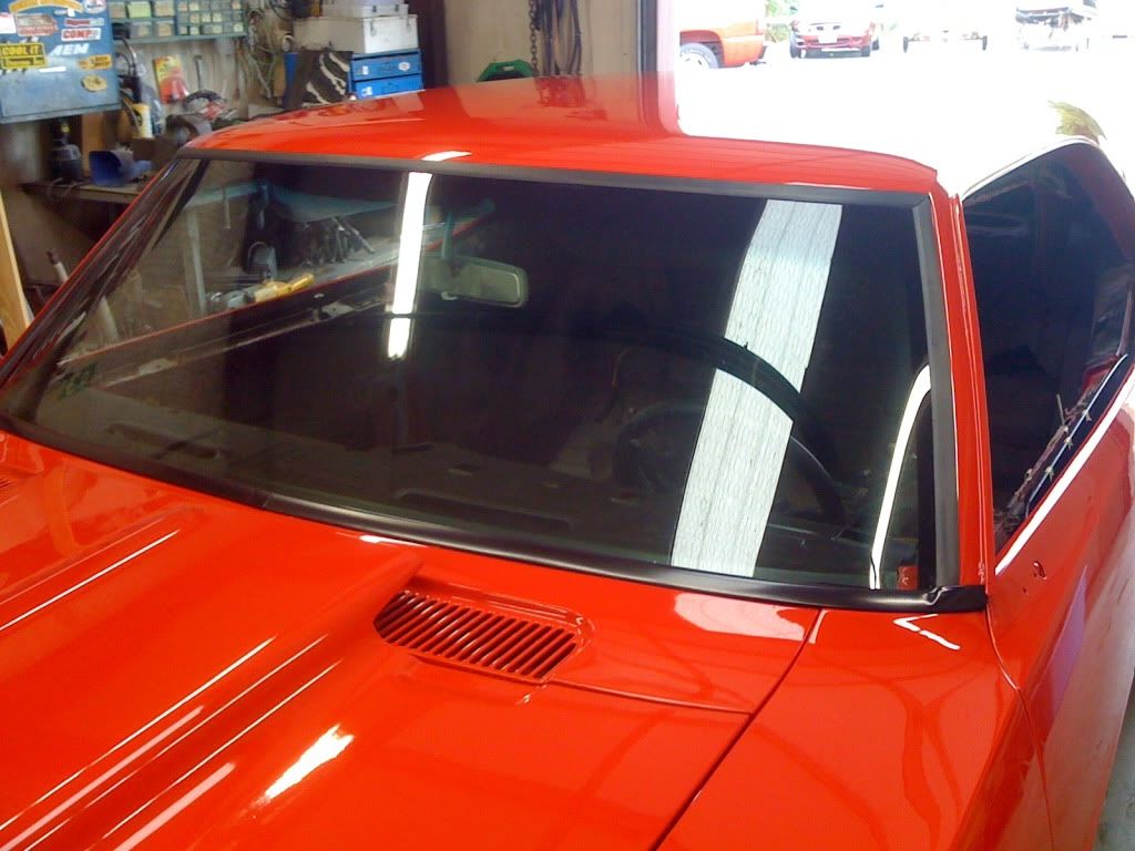

The cowl and cowl moulding are in. very tight squeeze. cant wait to get the belt mouldings and drip rail mouldings on.. if it will ever quit raining so i can black out the inner window channel. it think once the rims go on its going look awesome! i also cant wait to get the clevises and heims in for the spoiler

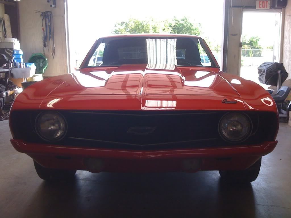

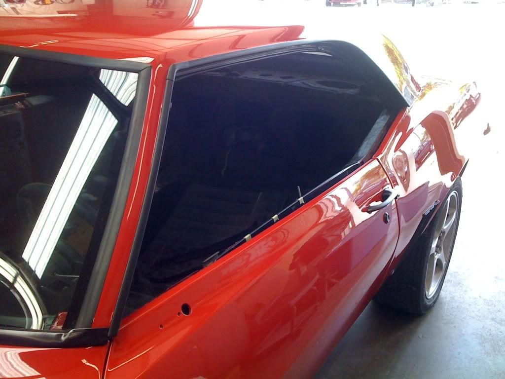

GM Muscle 09-08-2010 07:48 AM
well i finally got all the weatherstrip and and door handles and trim on the car. im about to pull the door glass out to tint it and install the window felts. the small list of stuff that still needs to be done is:
-Interior
-Engine plumbing(fuel line, water, and p/s)
-Rear suspension
-Rear spoiler(which is almost done)
-Cut and buff
this list is damn short looking back at the beginning but im tired and out of money! FOR SALE! lol

several friends and family memebers have seen the car and agree that pictures dont do the car justice. im very satisfied with how its turning out!
syborg tt 09-08-2010 09:30 AM
So am i and I don't even own the car
Gandalf 09-08-2010 09:36 AM
Great job! nice to see a car on here that looks great and dosn't have every PT widget you can buy bolted to it. Keep us posted.

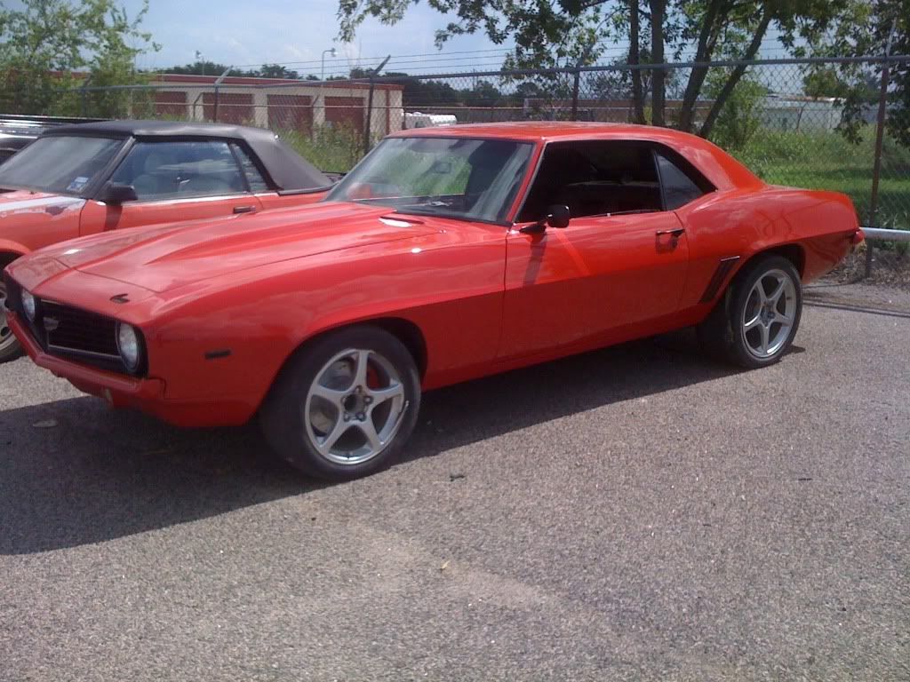

GM Muscle 09-21-2010 12:29 PM

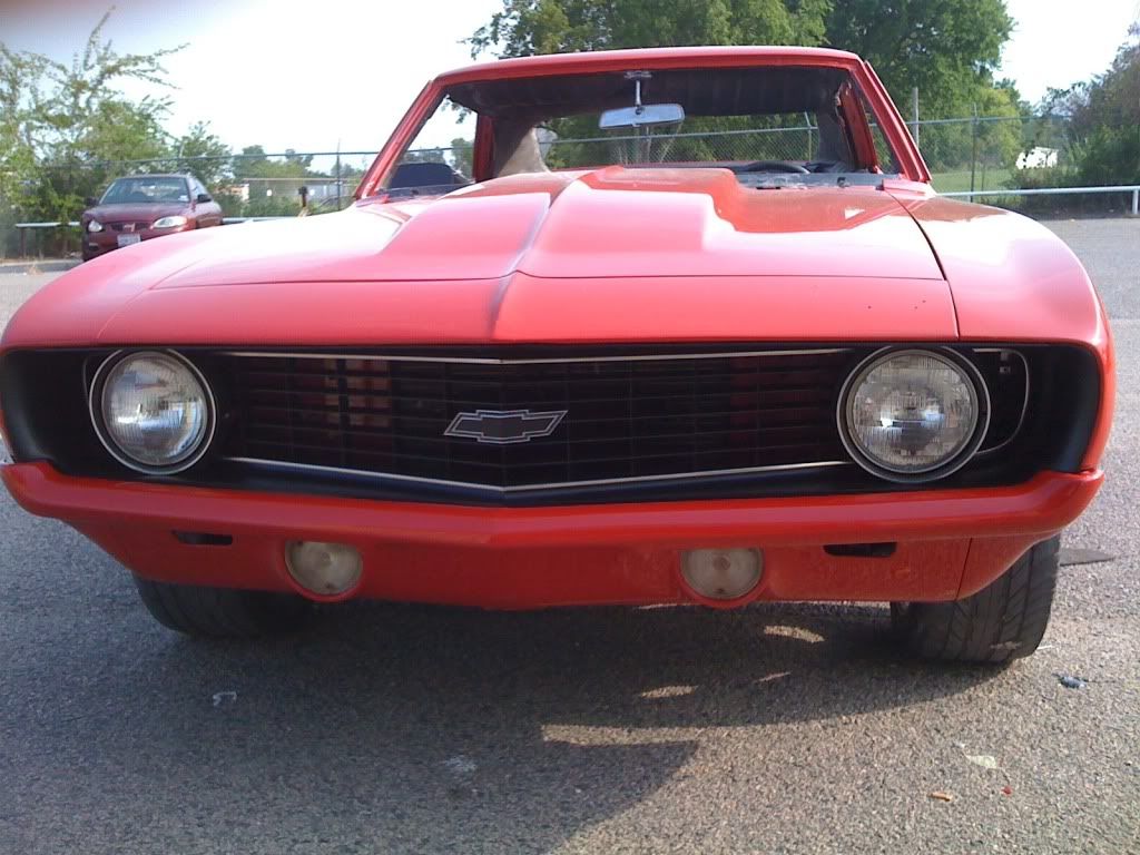

Well I've decided I'm going to Go back with a factory spoiler for now. I think I'm also going to go ahead and tackle raising the trunk floor a little so can use the caprice gas tank I have. The car is still for sale and i've gotten alot of calls and emails but no one has actually came to see the car yet. I'm thinking I might take the car to goodguys ft worth with a price tag on it and if there's no buyers I might see what it does on eBay. I just wanted to offer I on pro touring And lateral g first.
heres a pic with all the trim and mirrors installed.
http://img.photobucket.com/albums/v3...b/89c8a0ca.jpg

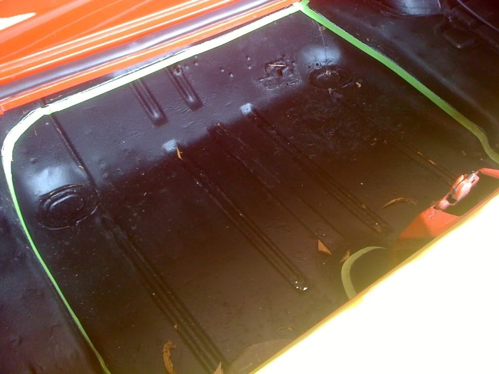

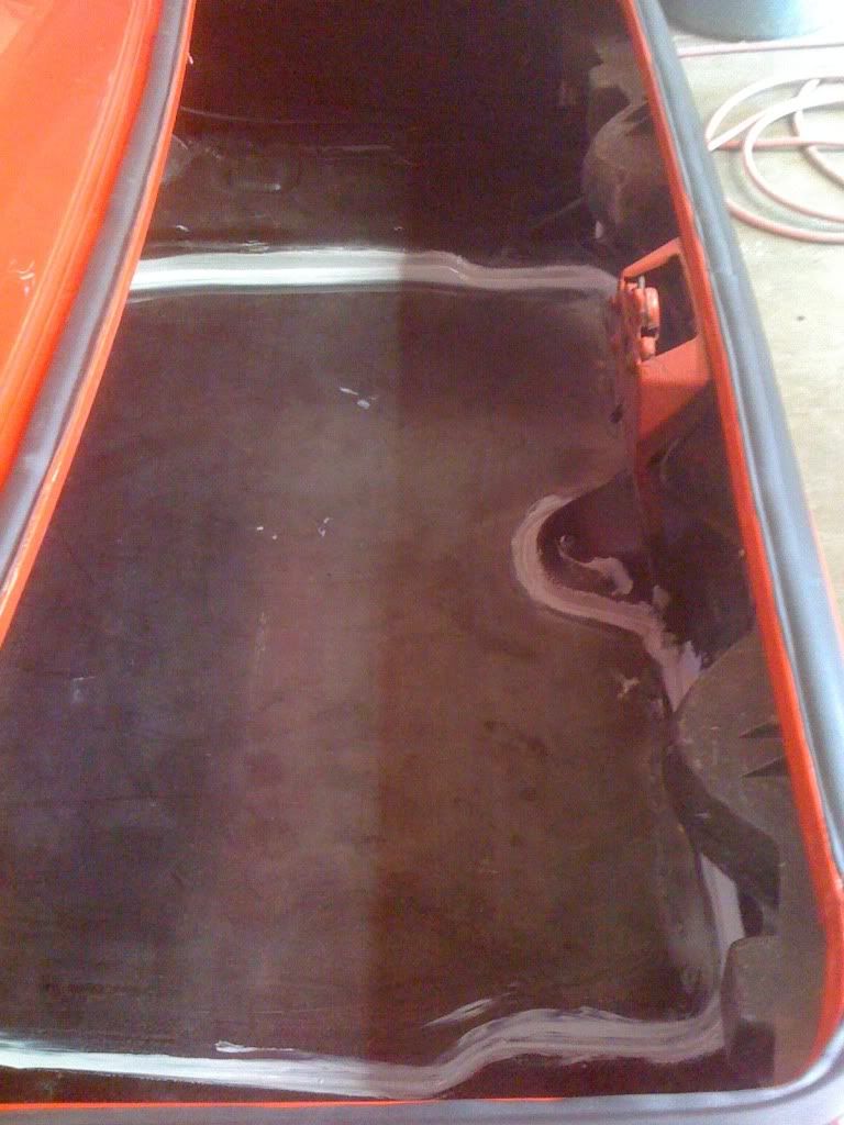

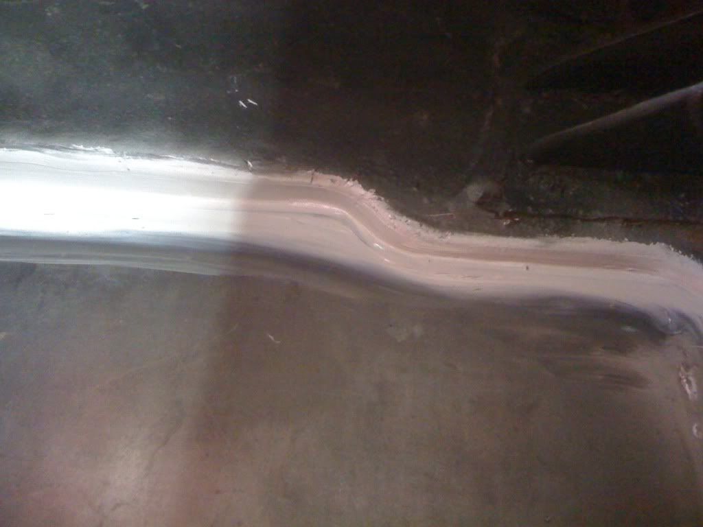

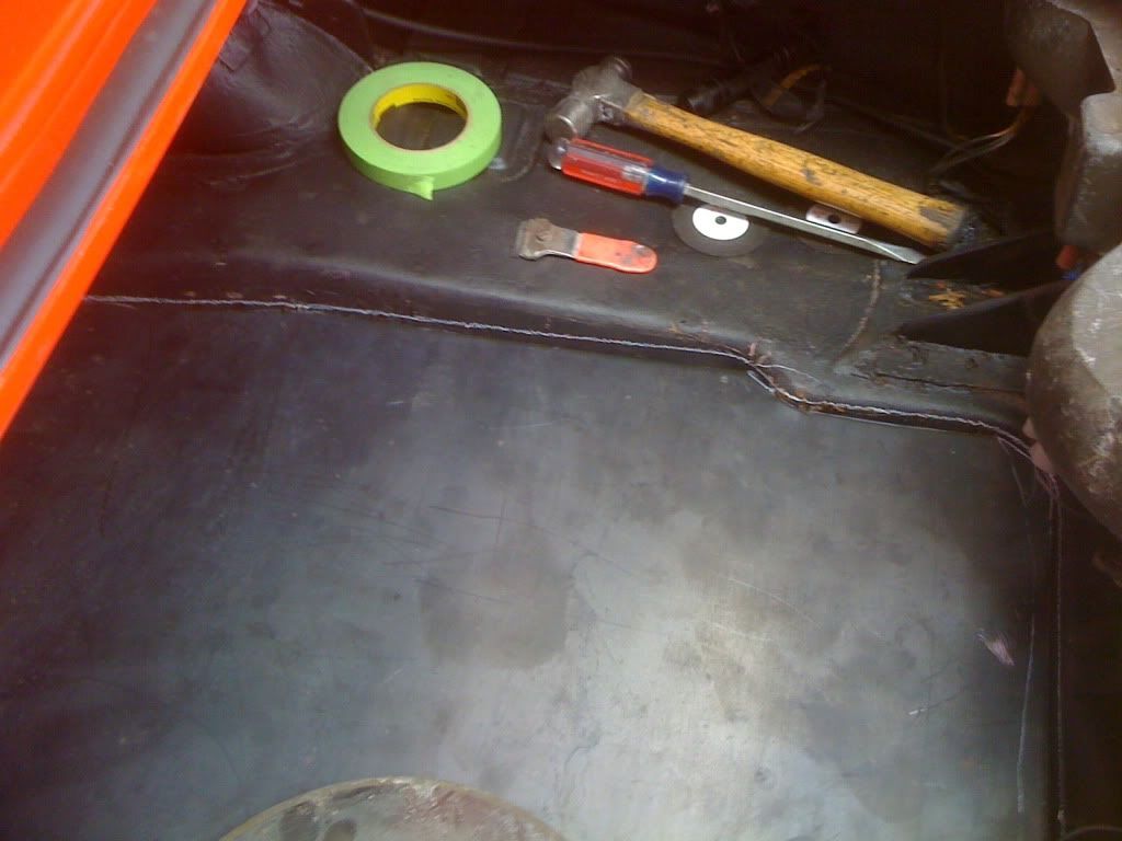

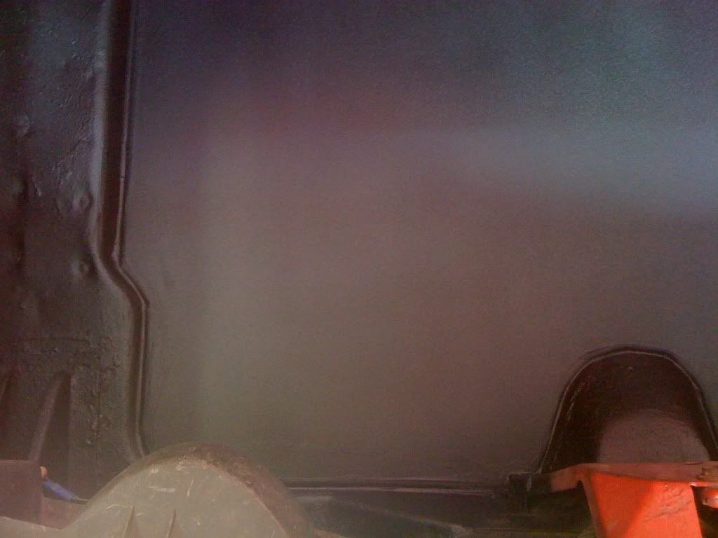

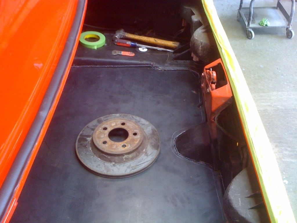

thanks guys.. so i went ahead and tackled the trunk. i think it turned out great. from the bottom i made a pinch weld on the sides then turned the floor edge up horizontally on the front and rear. that way i have plug welds from the side then an overlap buttweld on the front and rear edges. after i got it all welded up i used some seam sealer then some rubberized under coating. im thinking about going ahead and "finishing" out the truck with some nice carpeted or vinyled panels and carpeted floor. i will post up some pics here in a few..
GM Muscle 09-23-2010 12:52 PM
Originally Posted by Smitty67 (Post 307062)
I've been wanting to come up and take a look at your car. I'm just down the road from you in the Decatur area. If I didn't have a garage full of 67 Camaro, I would jump on it. So tempting.
feel free to stop by any time..

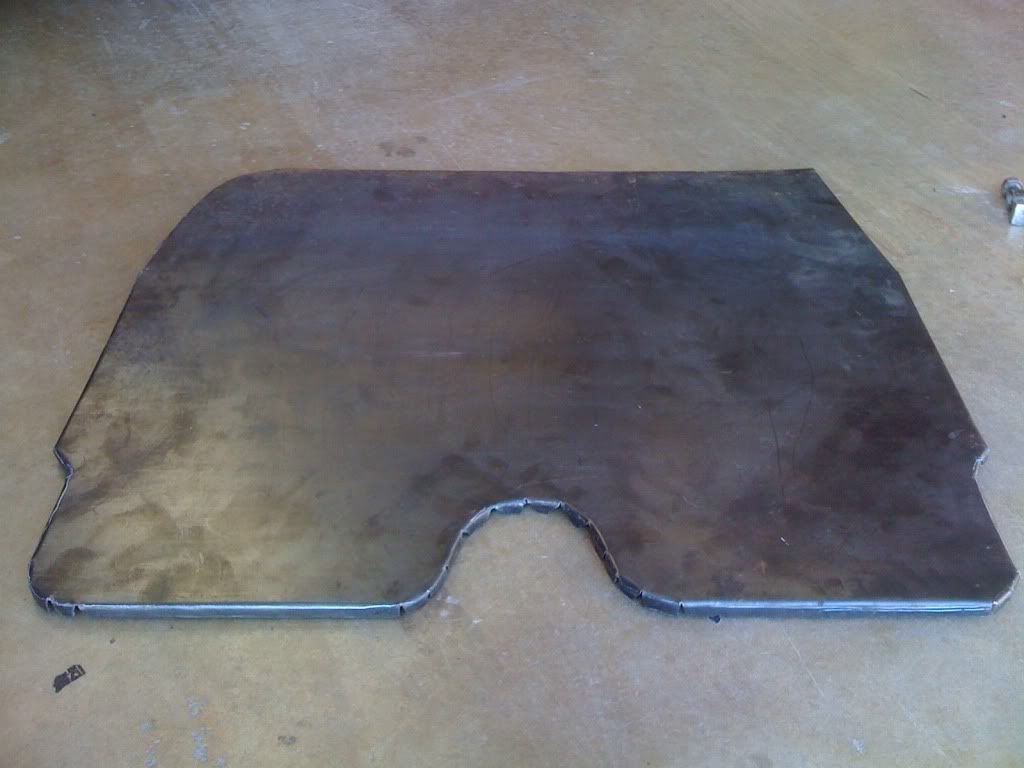

GM Muscle 09-23-2010 06:44 PM
so i made a cardboard template then cut it out of metal and rolled all the edges. i trimmed the front and rear tabs for a flush fit
http://img.photobucket.com/albums/v3...b/eecd2f97.jpg
then i marked the trunk and brought the mark down 3/4" for a pinchweld on the sides
http://img.photobucket.com/albums/v3...b/75ac0330.jpg
http://img.photobucket.com/albums/v3...b/5c3a530f.jpg
test fit
http://img.photobucket.com/albums/v3...b/def43cdc.jpg
http://img.photobucket.com/albums/v3...b/6a204fda.jpg

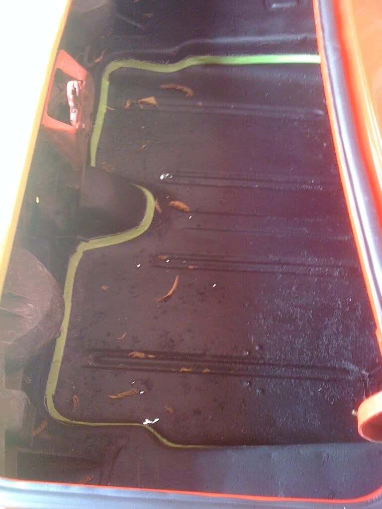

welded in
http://img.photobucket.com/albums/v3...b/d729d748.jpg

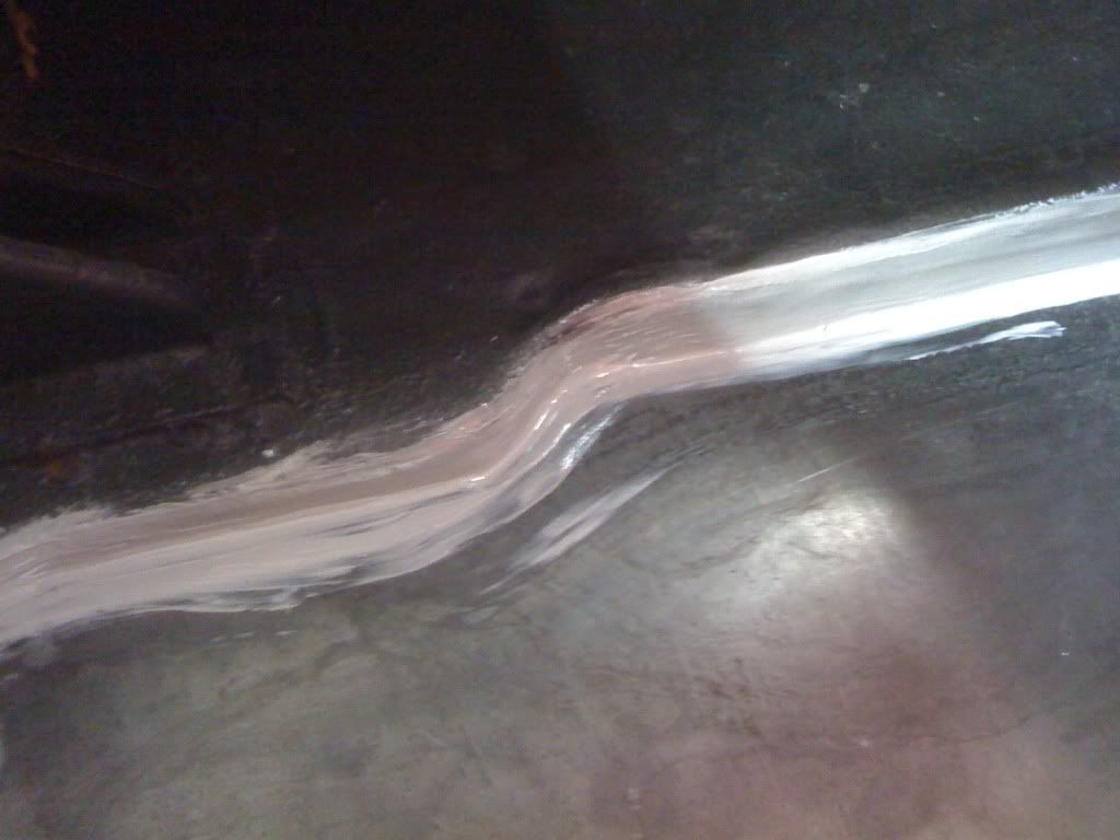

seam sealed
http://img.photobucket.com/albums/v3...b/1c4768ca.jpg
http://img.photobucket.com/albums/v3...b/732a7bea.jpg
http://img.photobucket.com/albums/v3...b/f6441ffc.jpg

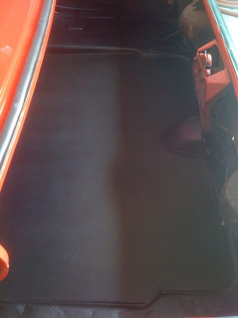

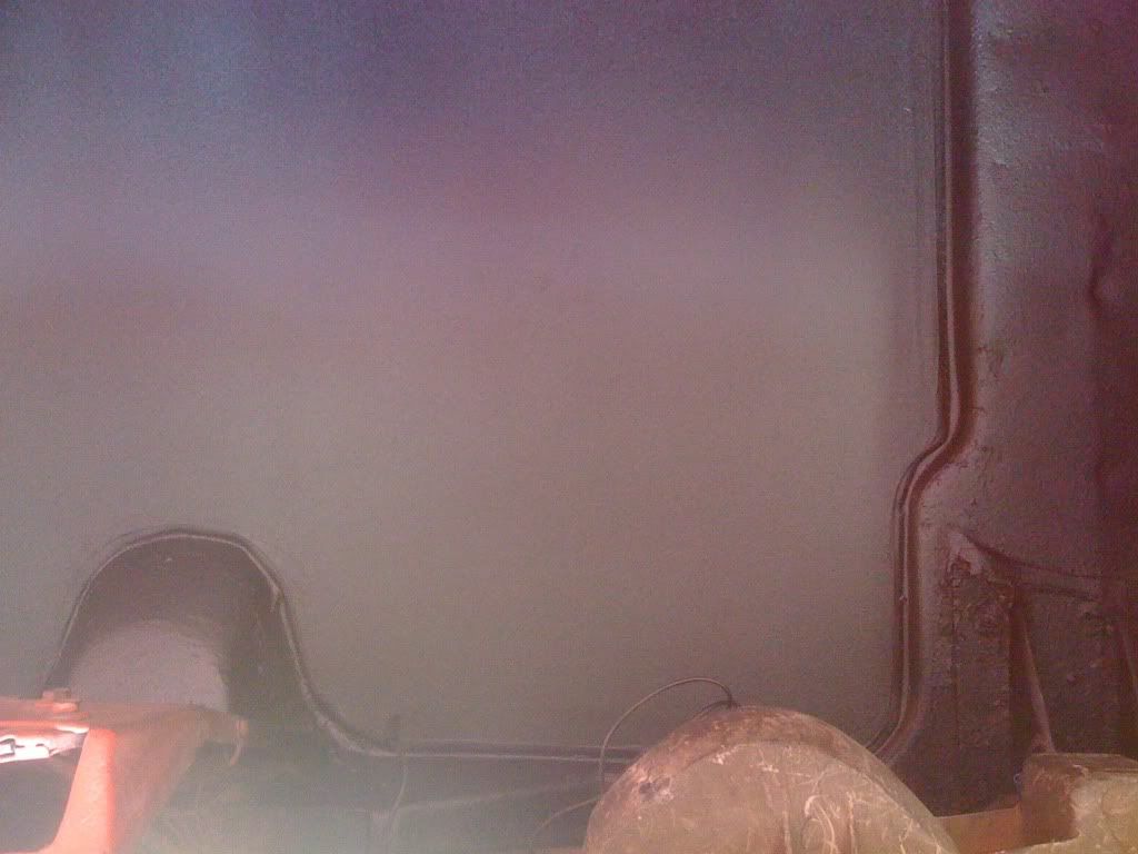

GM Muscle 09-23-2010 06:45 PM

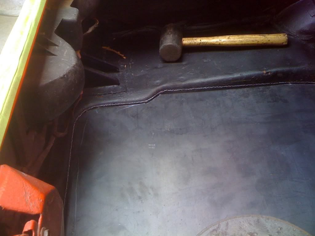

then etch primed and undercoated
http://img.photobucket.com/albums/v3...b/493c5481.jpg
http://img.photobucket.com/albums/v3...b/88c1940e.jpg
http://img.photobucket.com/albums/v3...b/c50c4cbc.jpg
GM Muscle 09-23-2010 06:48 PM
the rust in the trunk floor was actually my fault.. word of advice: never keep any cardboard in your trunk.. it will hold water and wrot your floor in no time flat!! i knew better and just overlooked it..:willy:

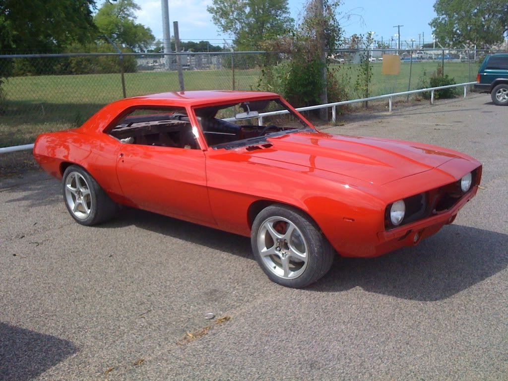

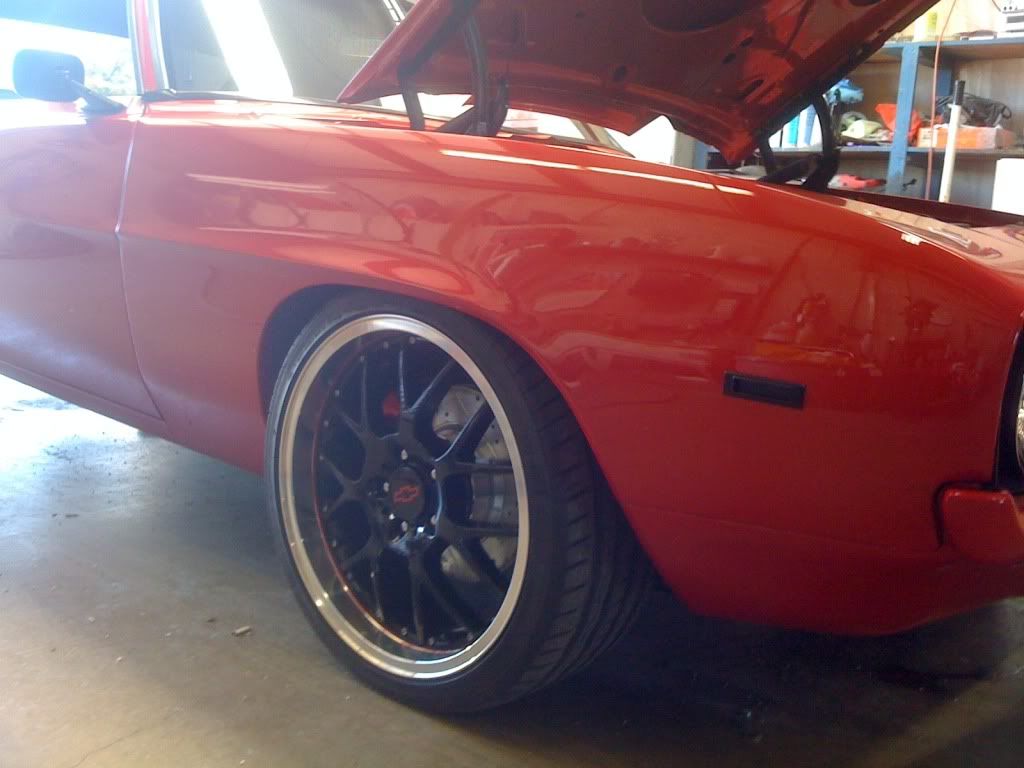

got the wheels on today. I threw the new rear end under there just quick enough to bolt the wheels on and be able to roll it in and out of the shop. Im going to need to order some longer studs but if I put a 1/2" spacer on each side it looks like the 285/35/19's are going to fit perfect! They fit now with 1/4" spacers but articulation will be a problem.
I dont want to go too fancy with the rear suspension yet because there are too many options.
Anyways, here are some pics. Tomorrow Im going to crank the front adjusters down and block the rear end to see what stance i want. Im thinking I will probably drop it 2" all the way around.
http://img.photobucket.com/albums/v3...h_aa5a02b9.jpghttp://img.photobucket.com/albums/v3...h_cf0ba648.jpghttp://img.photobucket.com/albums/v3...h_667a0a46.jpghttp://img.photobucket.com/albums/v3...h_56c5d134.jpghttp://img.photobucket.com/albums/v3...h_16eec31c.jpg

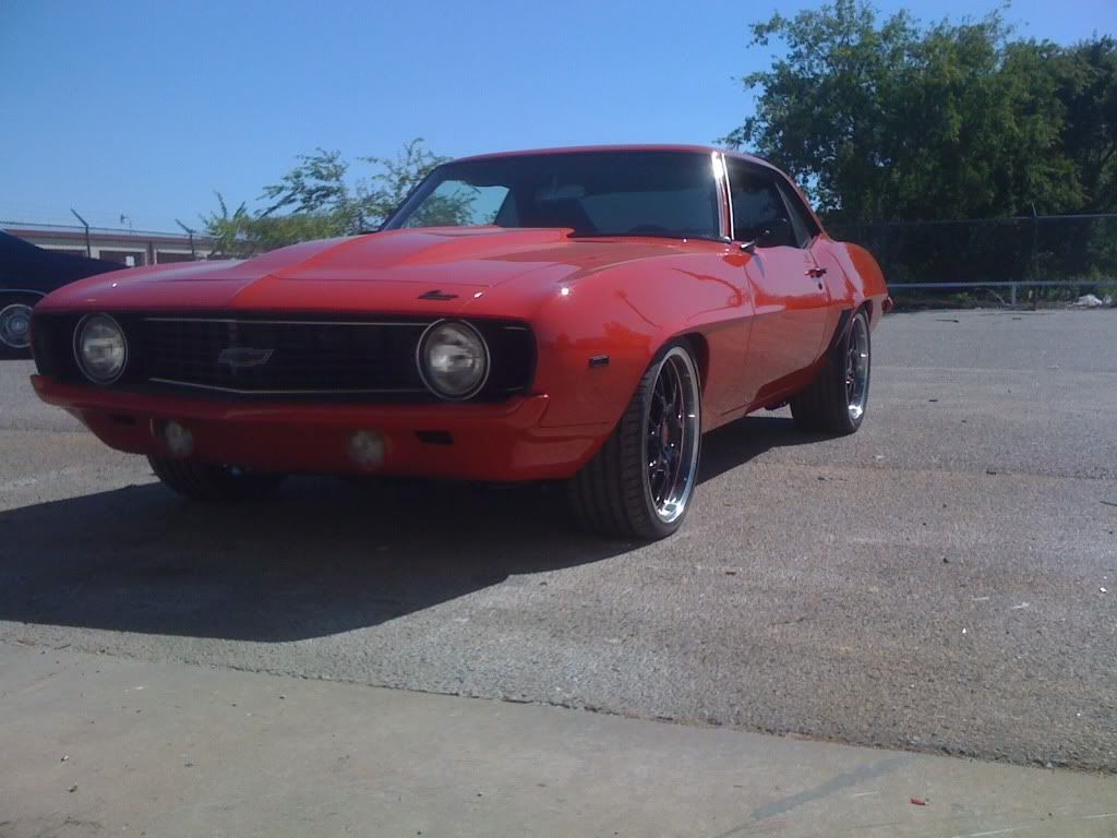

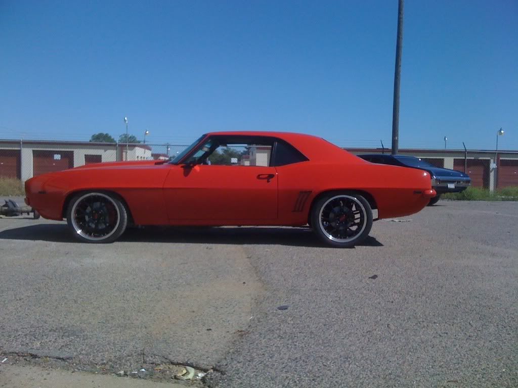

GM Muscle 10-01-2010 01:20 PM
thanks! well i put it down about 2" all the way around. car looks completely different now! i had it slammed out like 4" but i'm no D-FRESH! lol. I cant wait to hit up good guys tomorrow and pick up a front and rear spoilers. should really tie up the exterior of the car..
http://img.photobucket.com/albums/v3...b/f87fbac6.jpg
http://img.photobucket.com/albums/v3...b/94e33e21.jpg
http://img.photobucket.com/albums/v3...b/c2a6ecf9.jpg
http://img.photobucket.com/albums/v3...b/05b0db03.jpg
