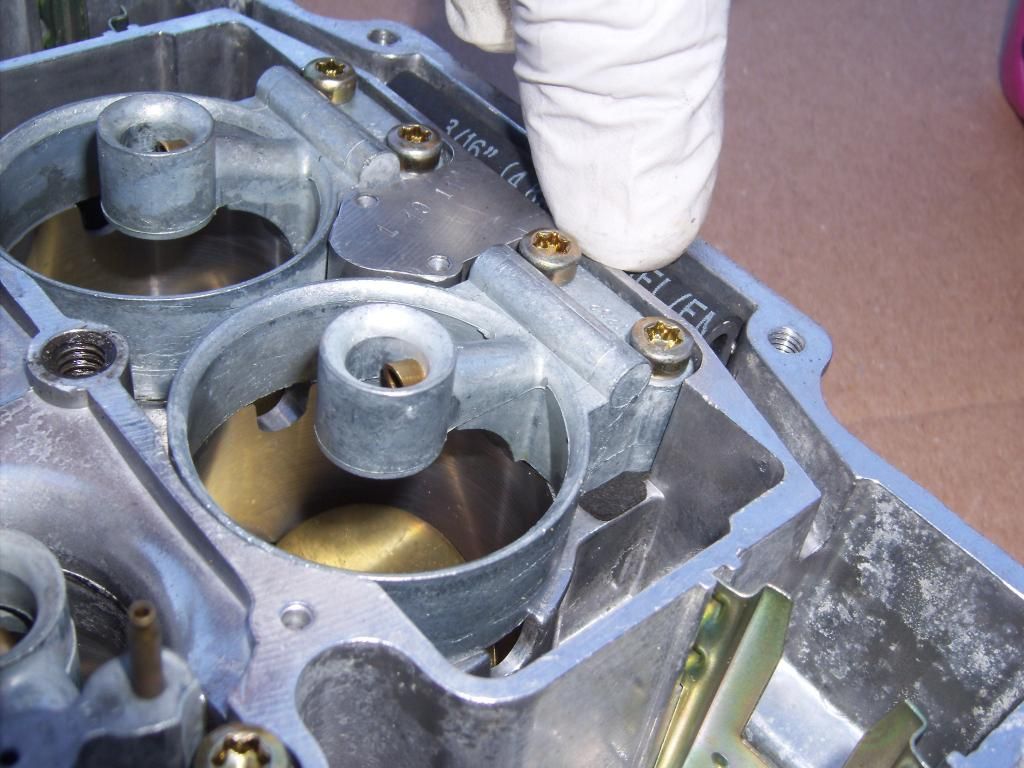

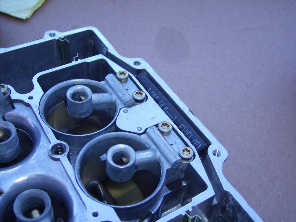

Edelbrock Carb trick
heres a simple trick to help your edelbrock Carb keep from stumbling around turns on the autocross or even if you use an eddy offroading, not everyone has this problem, I had it one time on an eddy a few years back and I blocked the channel and never had the problem again and now this is one of the tricks I do to every eddy I work on for friends, I have been asked many times about the little things I do to my car to race, so I thought I would leak a simple trick
pop the top on your carb and in the back is a balance channel
http://i752.photobucket.com/albums/x...ps0a28b544.jpg
its simple you just need piece of 3/16 fuel hose
http://i752.photobucket.com/albums/x...ps39aea779.jpg
cut it to the length that sits in the channel
http://i752.photobucket.com/albums/x...psc6e78a39.jpg
press it in the channel
http://i752.photobucket.com/albums/x...ps2d969c0d.jpg
simple fix right
http://i752.photobucket.com/albums/x...psc4cb12a9.jpg
and now the fuel stays in the bowls better and doesn't slosh around and there still a small opening if one bowl over flows and needs balance
http://i752.photobucket.com/albums/x...psd9b136de.jpg

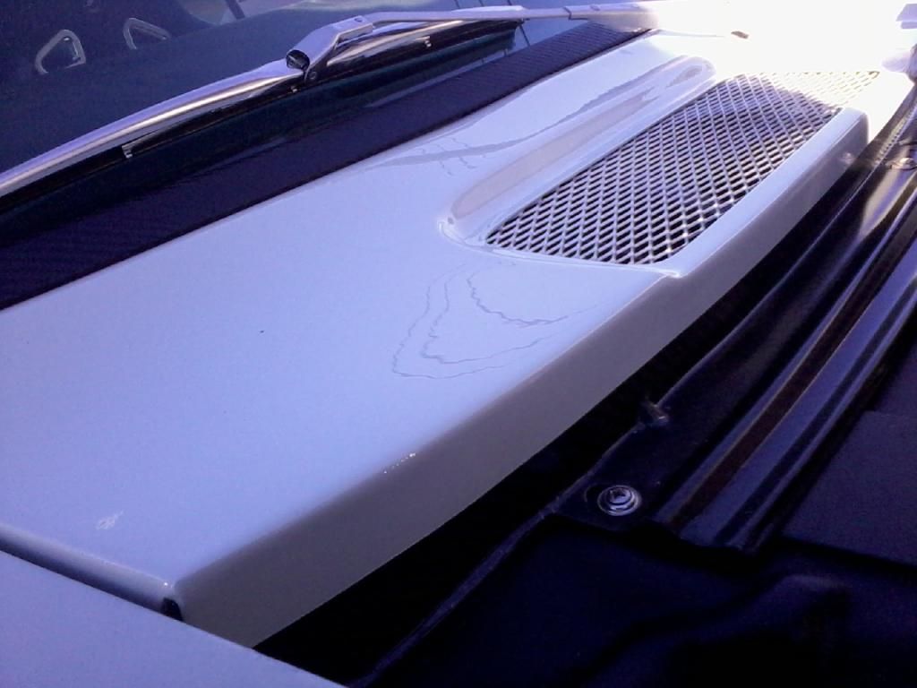

Installed a new carbon fiber anvil cowl panel, these Anvil panels are very nice looking I almost hate to cover up the Carbon
first I sanded the panel with 1200 paper, and then masked the panel off
http://i752.photobucket.com/albums/x...pse782a642.jpg
mixed up some white and clear and shot the panel
http://i752.photobucket.com/albums/x...psf386252d.jpg
unmasked the panel
http://i752.photobucket.com/albums/x...psc0fd6d00.jpg
and did the quick install
http://i752.photobucket.com/albums/x...ps3ad9a37e.jpg

So you left no CF showing at all? You sneaky man you.
Rod P 09-27-2013 03:24 PM
the header panel is carbon fiber also and I painted over that also, looks like stock sheet metal

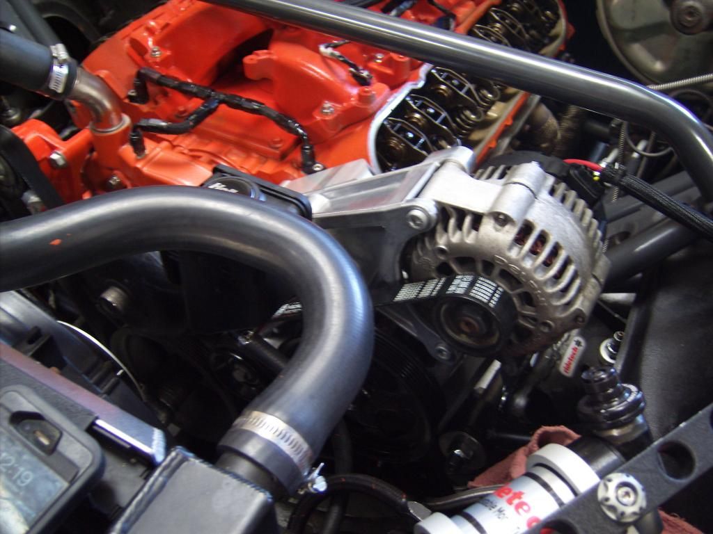

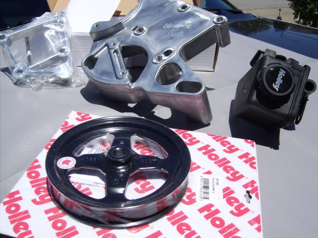

some last minute updates to Jane, the new alternator bracket and power steering bracket upgrade, with this bracket from Holley I have upped the charging to 130amps,and the power steering is now a corvette unit
http://i752.photobucket.com/albums/x...ps929b1ca9.jpg
http://i752.photobucket.com/albums/x...psbef8811d.jpg
http://i752.photobucket.com/albums/x...psfcfd70a5.jpg
