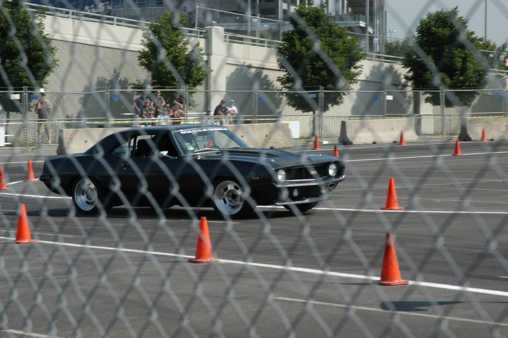

radrambler 05-20-2011 08:35 PM
couple of pics
http://i907.photobucket.com/albums/a...y/DSC_0037.jpg
in action today in Nashville :thumbsup:
http://i907.photobucket.com/albums/a...y/DSC_0040.jpg
Tom
tones2SS 05-23-2011 05:01 PM
Very, very nice Tom. Car looks lean and mean. Love that stance.
I'm also digging that wheel and tire set up.:thumbsup:
