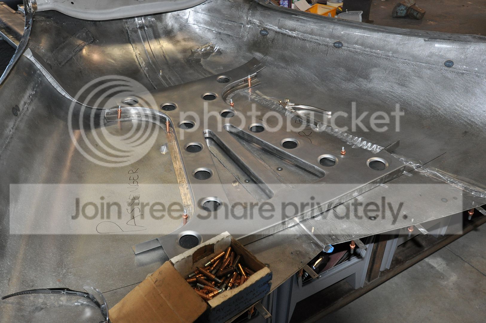

We have been working pretty fast on Franks 48 truck. Most of the major sheetmetal work has been done on the cab, the chop, section and lengthening of the cab. The Hagan Hinges have all been installed. We are working on fitting the door structure and installing power windows and latches before we roll new door skins. The chassis has Engine and trans mounts, Exhaust over the rear axle, the frame kick ups for the desired ride height all installed. We are waiting for the Schott wheels. Our plan to have this as a metal finished Truck at NSRA Bakersfield is still the plan. We were thinking Del Mar might happen and it might but we will see.

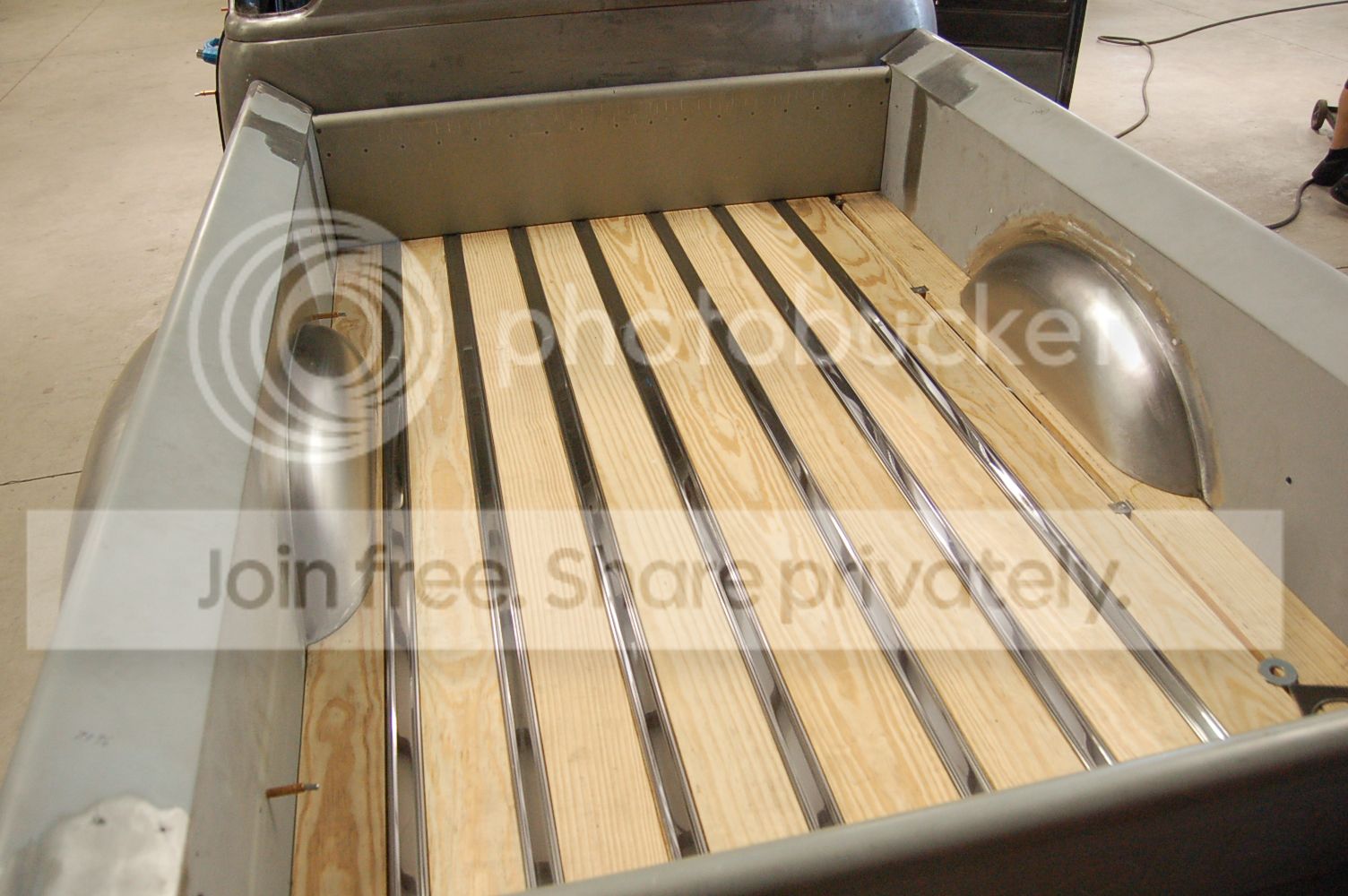

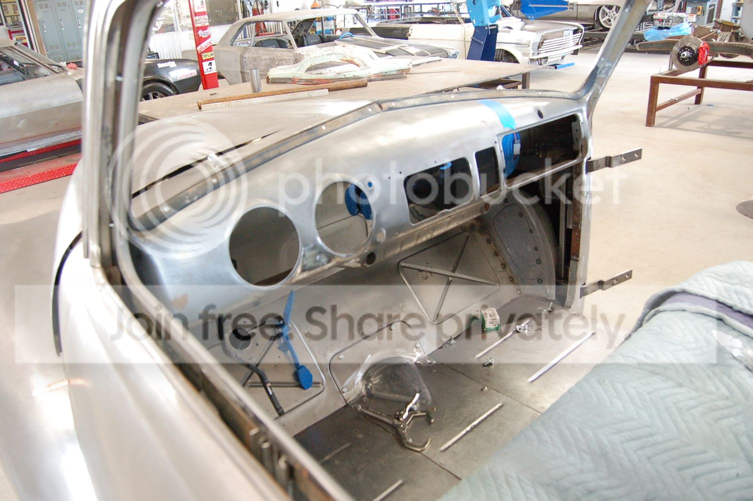

ironworks 04-17-2010 12:02 PM
Progress on the truck
http://i616.photobucket.com/albums/t...ril2010081.jpg
http://i616.photobucket.com/albums/t...ril2010080.jpg
http://i616.photobucket.com/albums/t...ril2010078.jpg
http://i616.photobucket.com/albums/t...ril2010084.jpg

ironworks 04-17-2010 12:14 PM
Originally Posted by MtotheIKEo (Post 282708)
I wish I would have thought about cutting the exterior door skin off to put my power windows in. Looks like you have a lot more room to work with!
Well when the doors are sectioned and lengthened, and you have to reskin the doors anyways, you might as well put the power windows in before you reskin the door. Work smarter not harder.

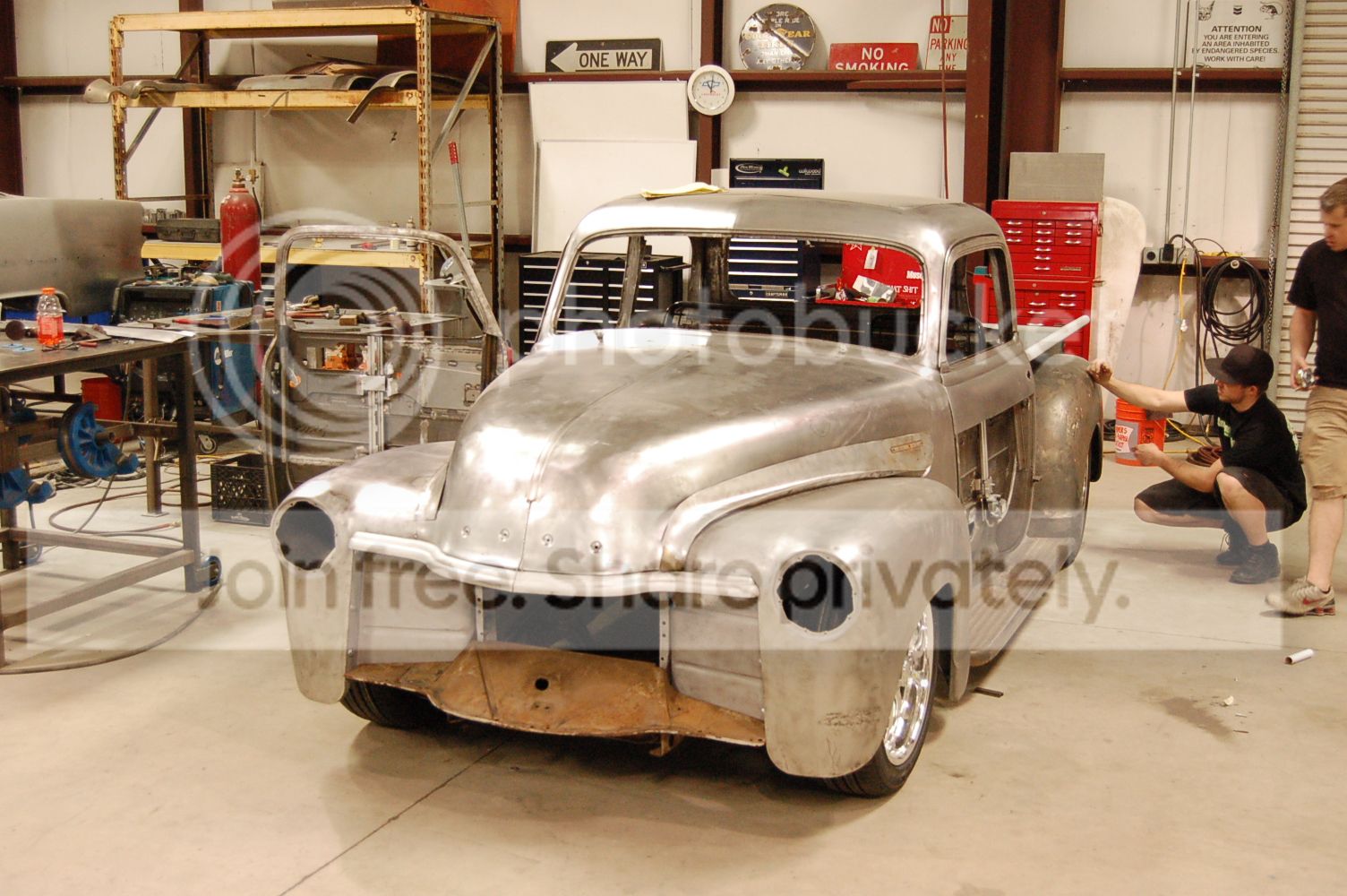

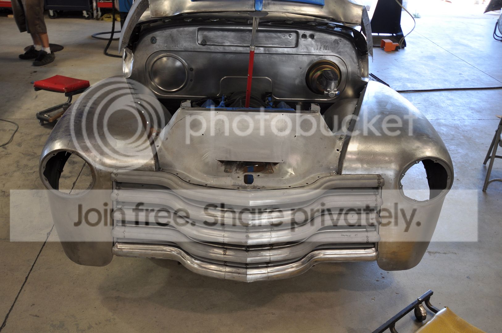

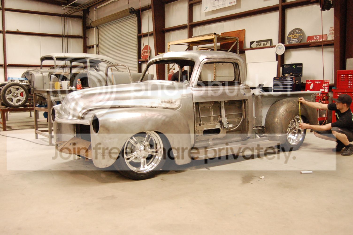

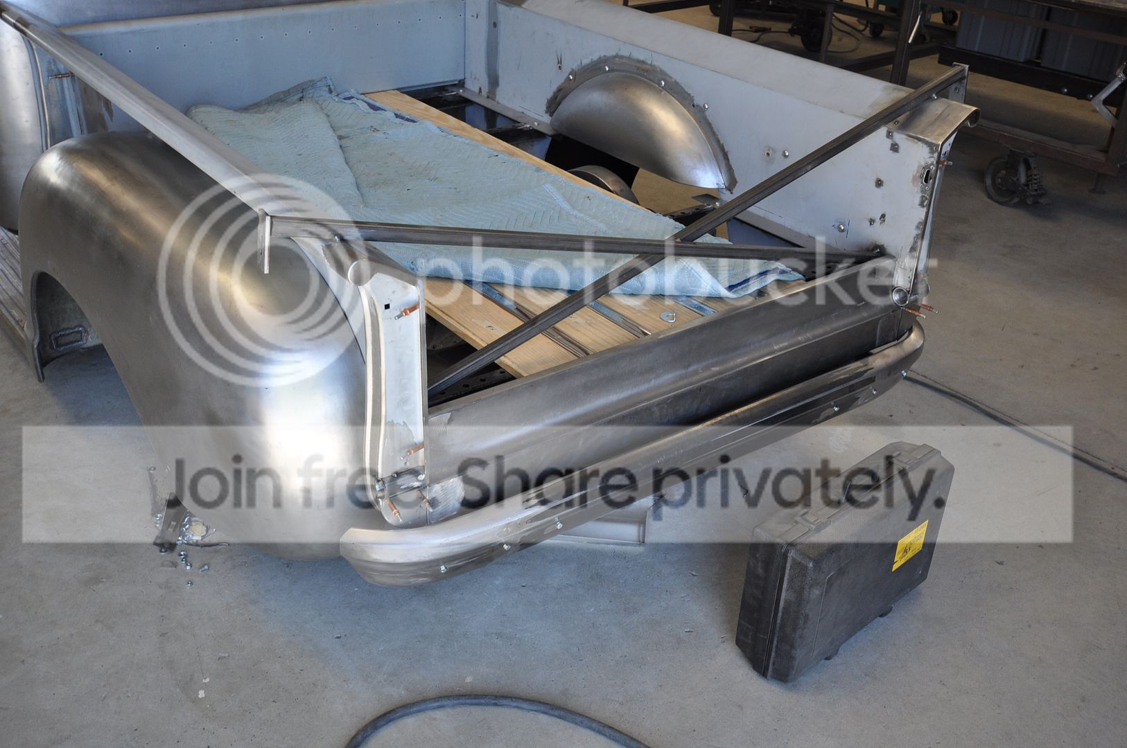

ironworks 07-02-2010 07:29 AM

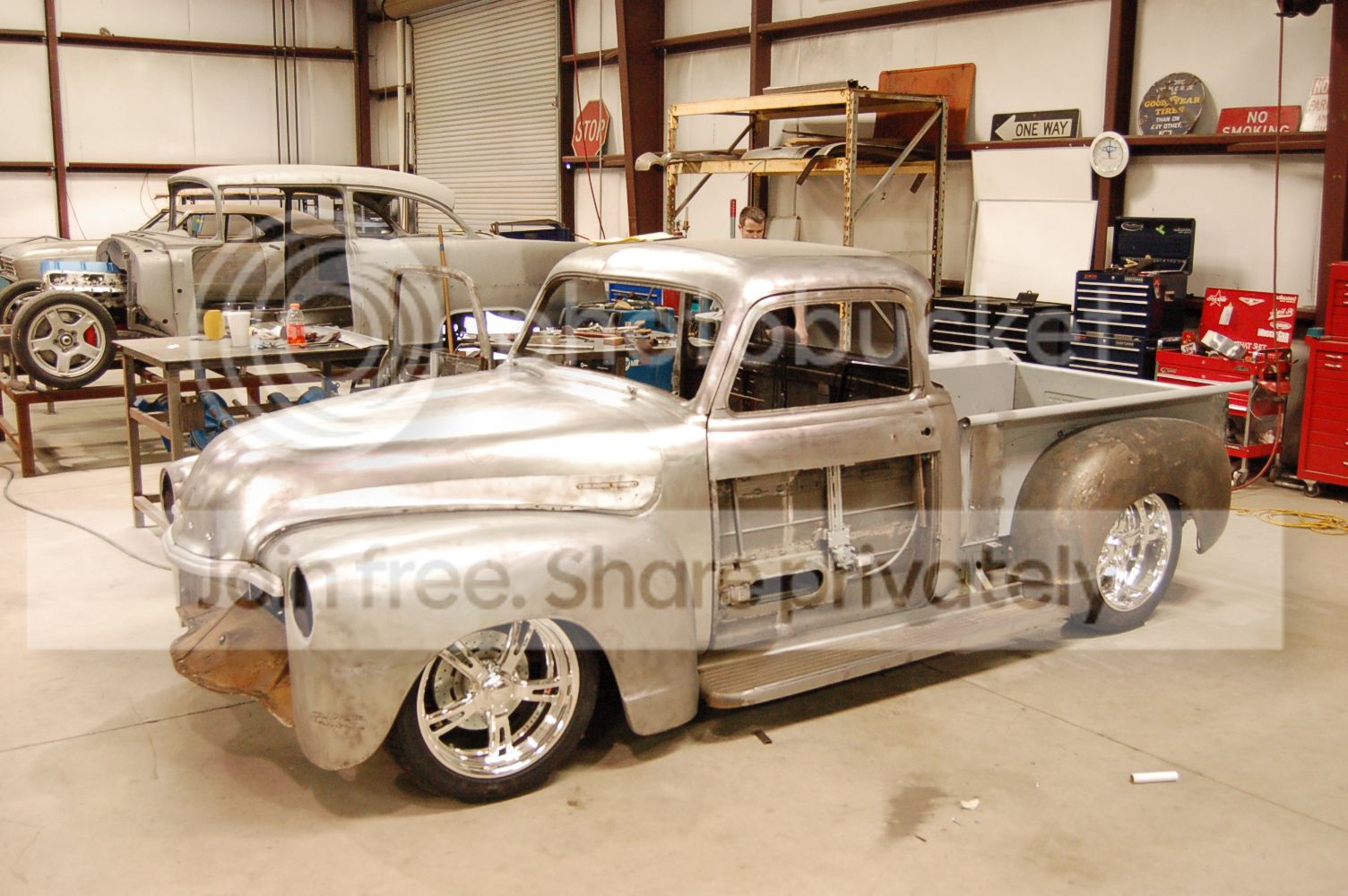

Well I thought I might post up some pics of the 48 truck we have been working on. It is just about ready to go to paint. You can see in the pics some of the body mods we have been working on.
http://i616.photobucket.com/albums/t...une2010076.jpg

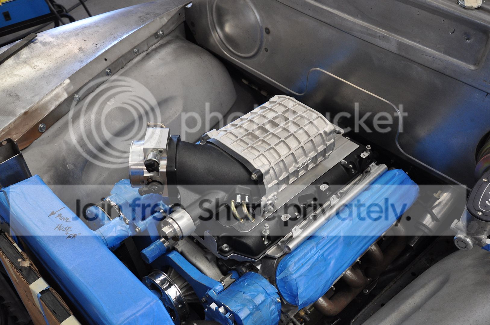

Nothing like a blower from Magnuson to fill that empty space above the engine. We are adapting it to work with the Vintage Air Frontrunner.
http://i616.photobucket.com/albums/t...uly2010012.jpg
http://i616.photobucket.com/albums/t...uly2010011.jpg
A shot of the heavily modified grille, we took 1" off each side of the grille to narrow it up. You would not believe how much work that is.
http://i616.photobucket.com/albums/t...e2010105-1.jpg

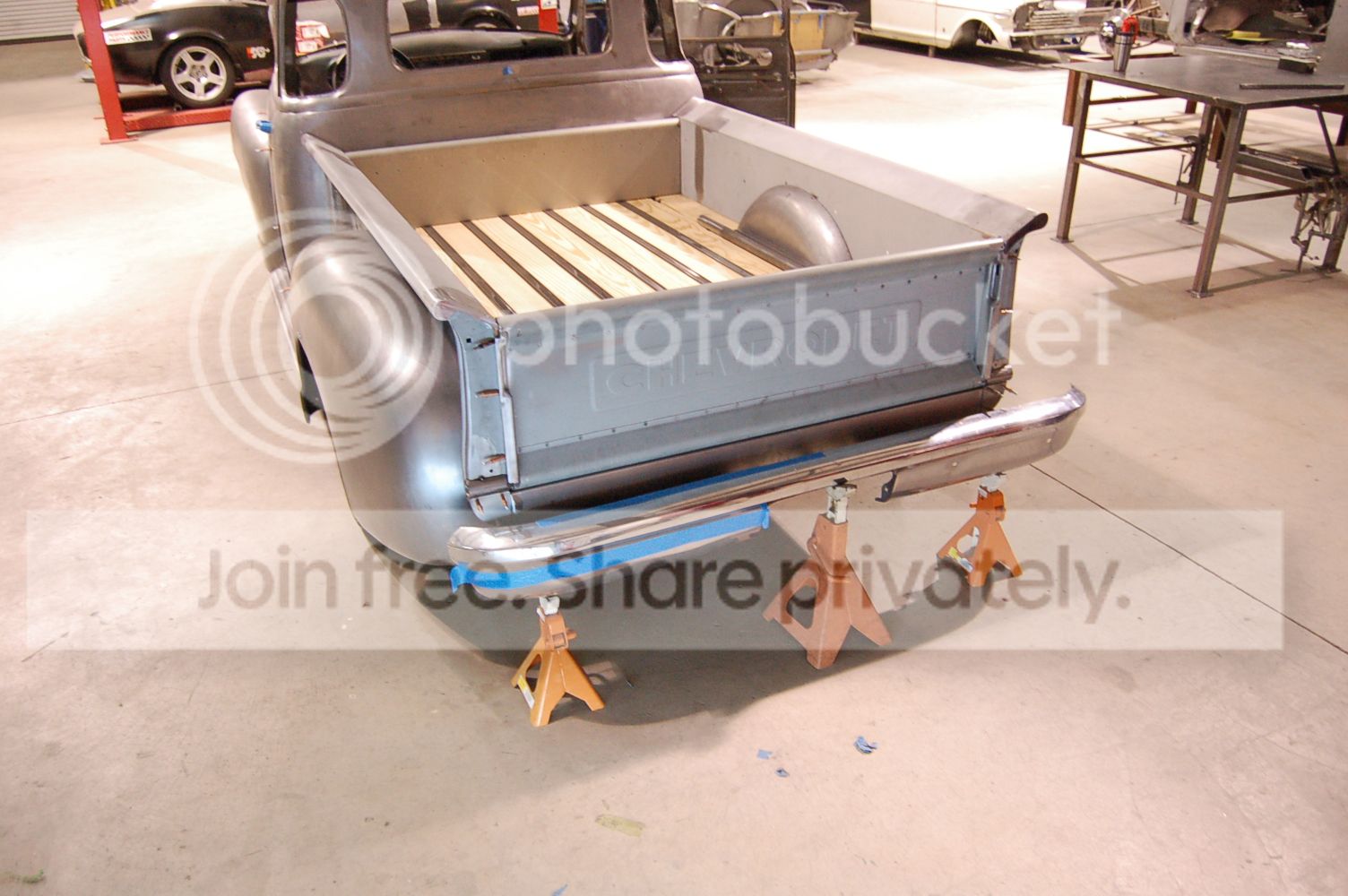

A shot of the rear bumper. It is a sectioned and narrowed 67 chevy truck bumper. It looks really nice on the back. We are starting on the tailgate mods currently.
http://i616.photobucket.com/albums/t...uly2010015.jpg
Here is a shot of the under dash AC vents we made to hang under the dash. We do plan to change the vents, to something more period correct.
http://i616.photobucket.com/albums/t...une2010031.jpg
I just want to thank Frank for allowing us to build a pretty crazy truck to the best of our ability. I can say there is not one thing I would change on this truck. Frank and I have had such similar taste on design you would think he wore gray Dickies everyday to work....:D
