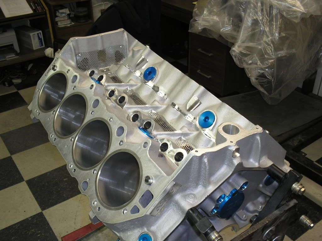

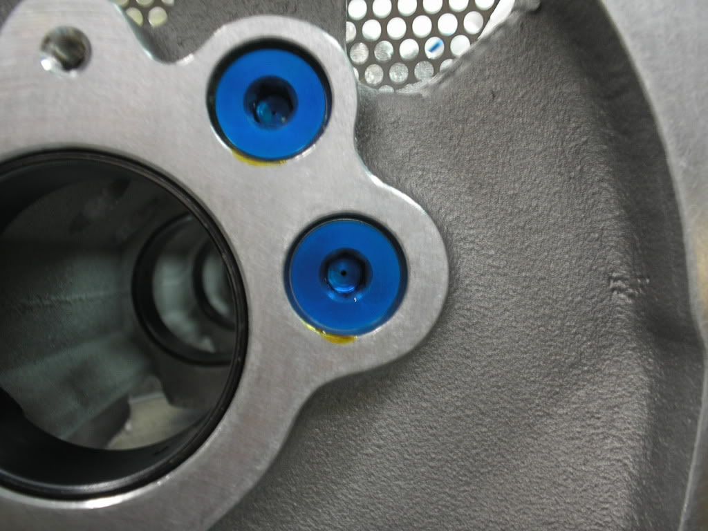

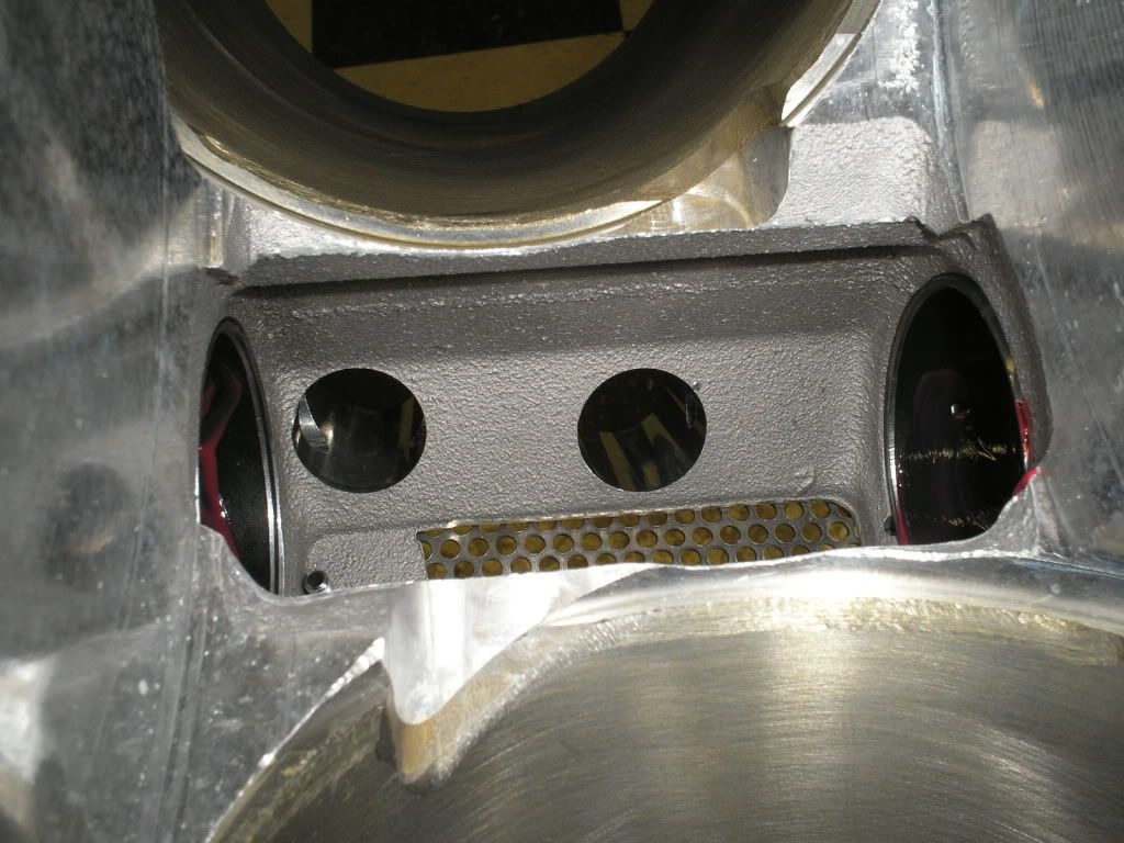

This photo shows the removed factory cam retainer bosses and custom valley screens.
http://i200.photobucket.com/albums/a...9/P2020004.jpg

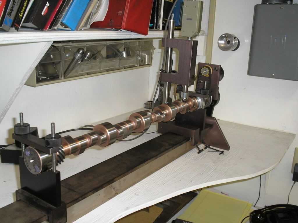

Jason is checking the comp custom grind for accuracy.

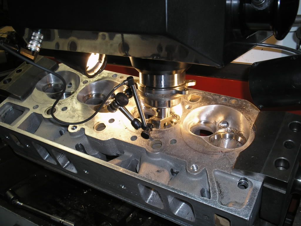

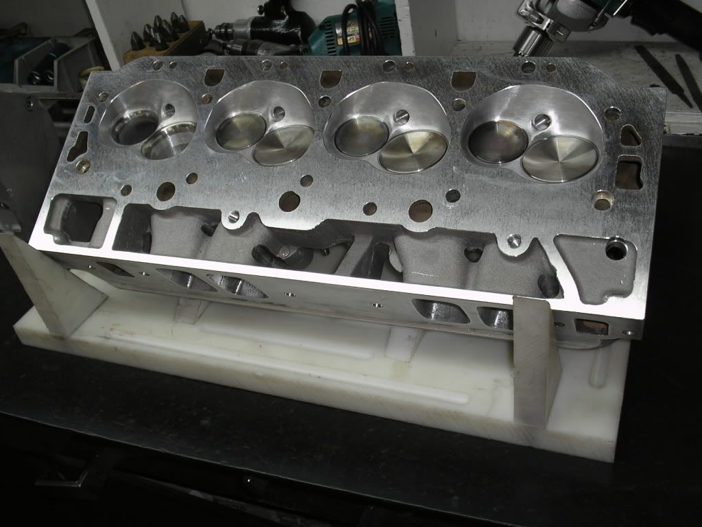

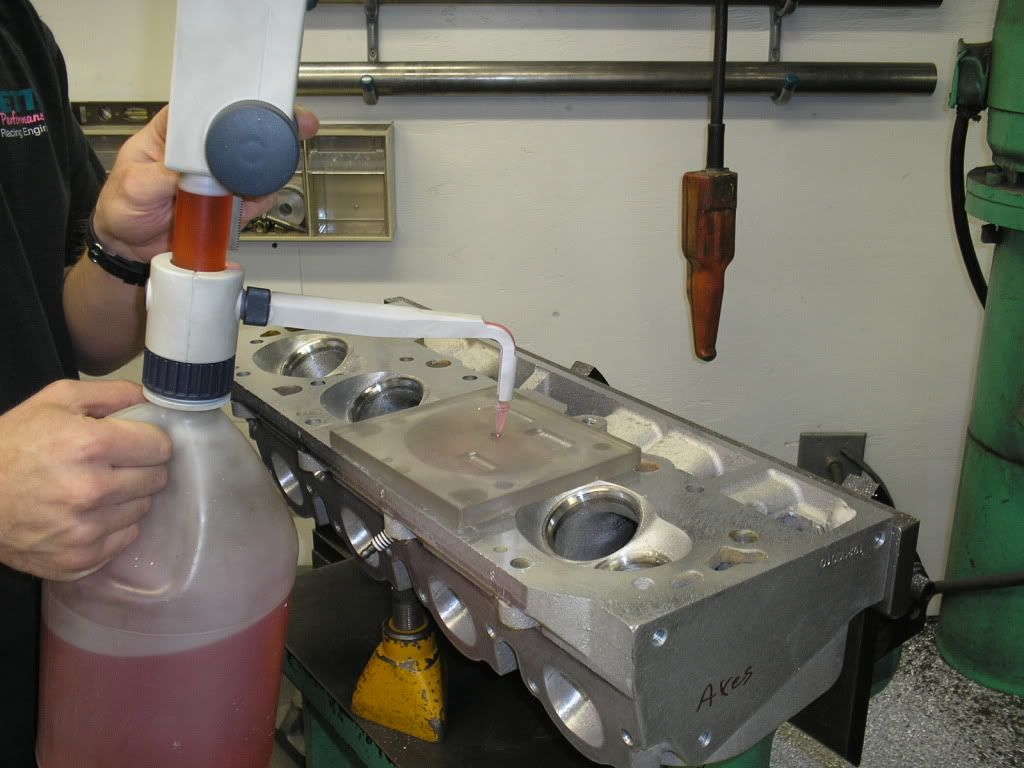

Here he is checking chamber volume since he ported and cut the head for a valve job. It needed a significant shave to get the compression to 10.23:1.
http://i200.photobucket.com/albums/a...umemeasure.jpg
This photo shows the lathe work he performed to clear the Manley H beams. It also shows the preparation of the lifter bores.

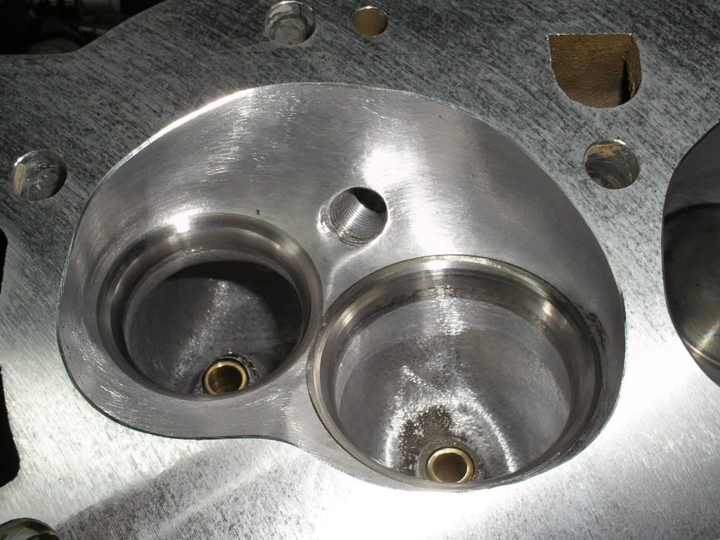

This sequence of photos shows him cutting the 5 angle valve job, finished chamber, and assembly.
http://i200.photobucket.com/albums/a...ishedhead2.jpg
http://i200.photobucket.com/albums/a...dassembly2.jpg
http://i200.photobucket.com/albums/a...alveseats1.jpg

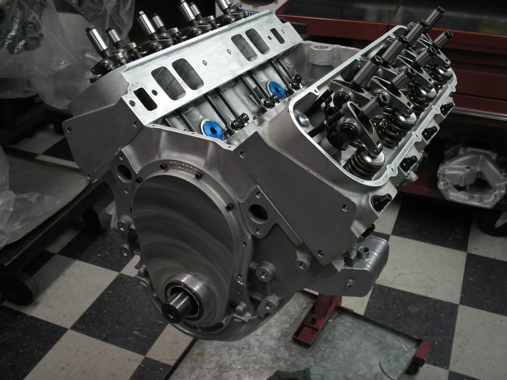

The first photo shows the valves in action and the .660 lift.
http://i200.photobucket.com/albums/a...llongblock.jpg

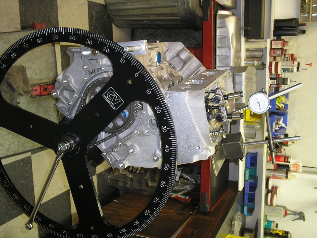

Jason checking piston to valve clearance.

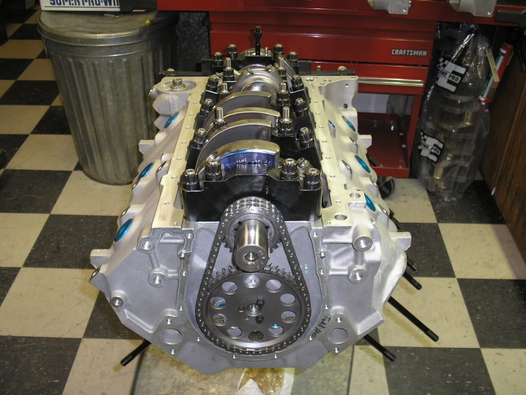

Cool photo of the splayed main caps, callies crank , and manleys.
http://i200.photobucket.com/albums/a...hortblock4.jpg
Little trick, tiny ports in the oil gallies to cool the timing chain. With downard drivetrain slope and acceleration, think it's a great idea.
http://i200.photobucket.com/albums/a...chainoiler.jpg

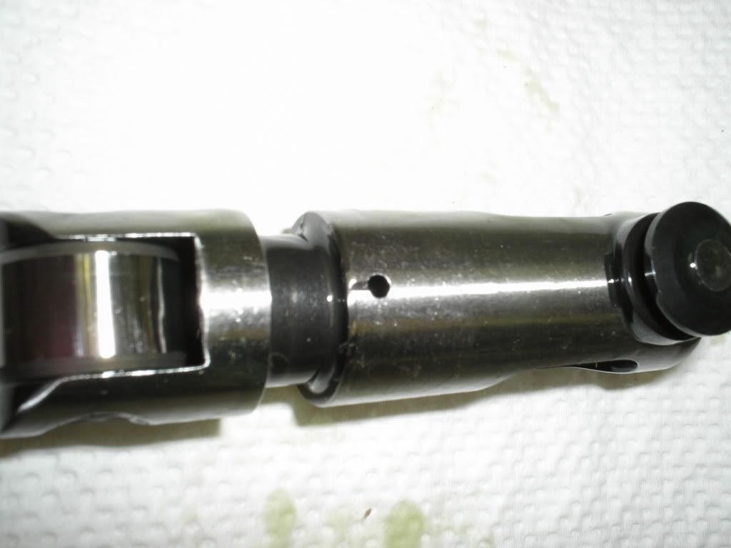

Jason modifying my Isky Red Zones! My guess is more oil to cool the valve springs.
http://i200.photobucket.com/albums/a...rainoilmod.jpg
