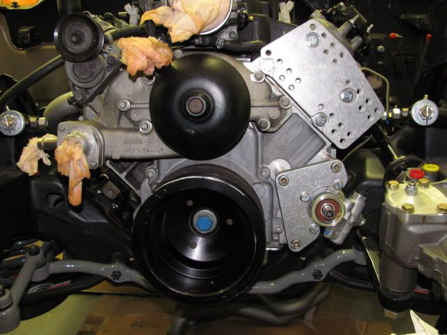

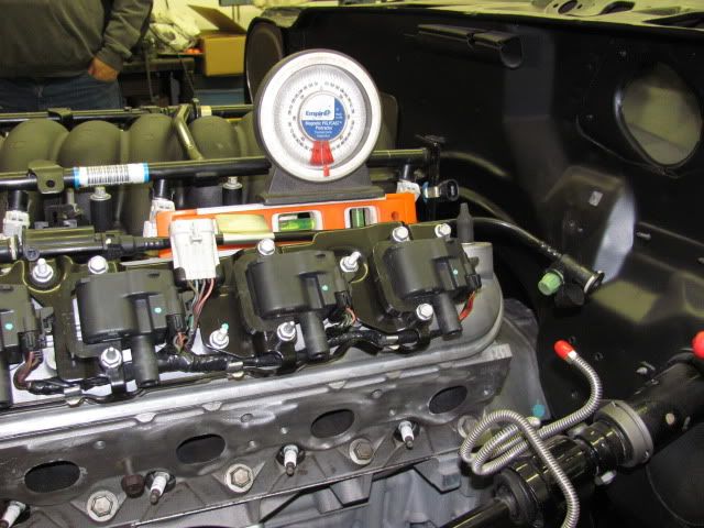

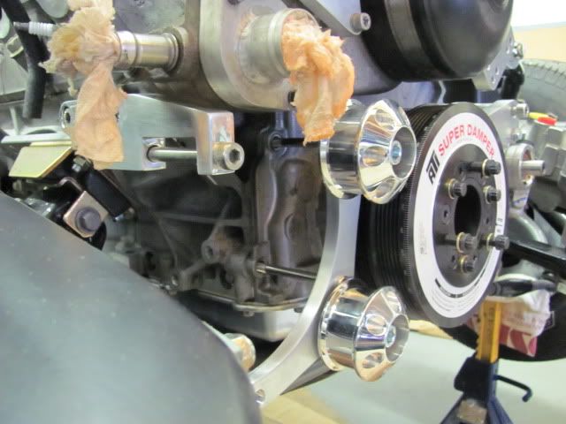

Got somethings done tonight. Measured the front of the motor and found that it's 5/8th offset to the passenger side, so I have the tranny at center now. I have to cut the floor a little bit more, so that will be my plan for tomorrow night to get the tranny and motor at both 5/8th offset. Then I can weld the cross member. On a good note the headers almost fit now that the tranny is at center, so I'm hoping when it's in correct position that I will not have to notch a thing:woot: Here are some pics of the measuring
http://i14.photobucket.com/albums/a3...7/IMG_0101.jpg
http://i14.photobucket.com/albums/a3...7/IMG_0100.jpg

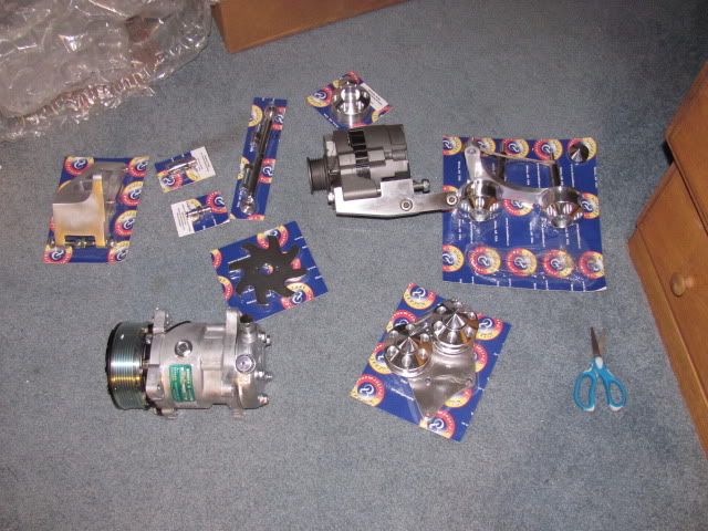

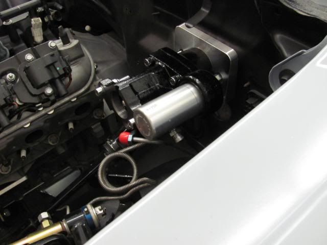

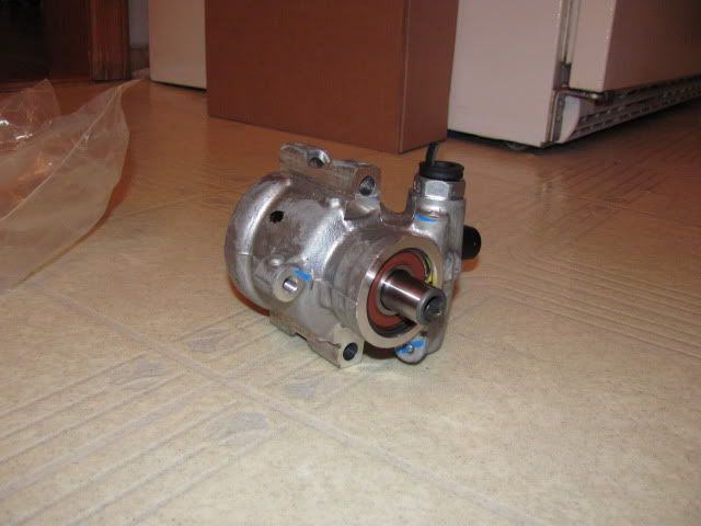

tuff57 03-25-2010 06:19 PM

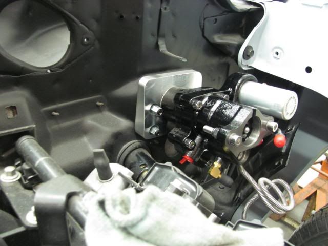

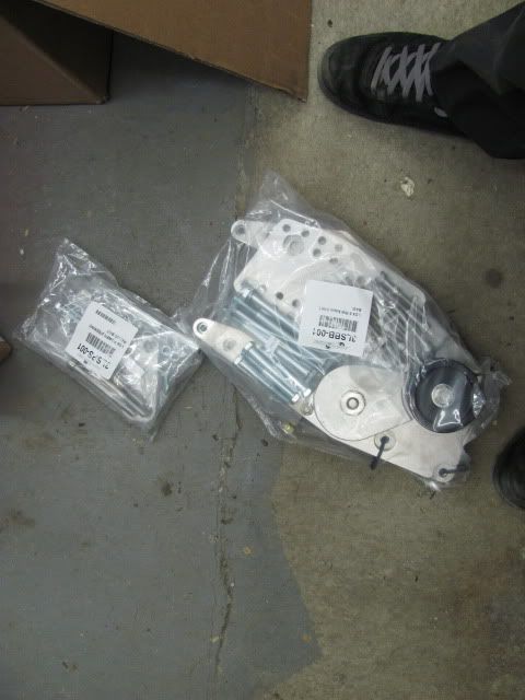

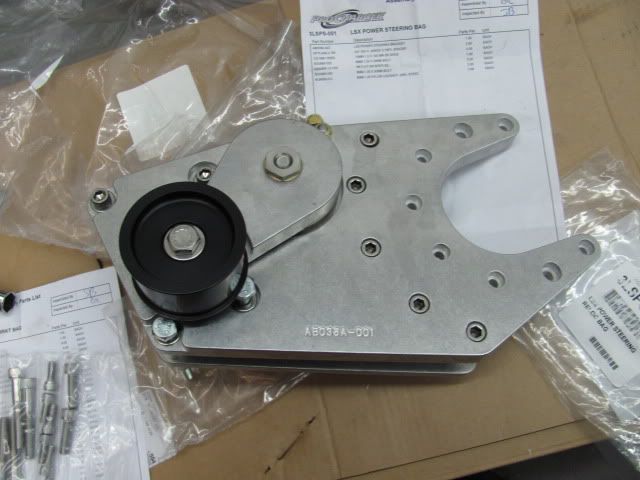

Got the power steering pump today! Still waiting on the brackets. Ordering a bunch of stuff from street and perfomance ( A/C brackets, compressor, idler pulleys, alternator pulley and all that). Got the crossmember done and it's all primed up. Will have pics of it up tomorrow.
http://i14.photobucket.com/albums/a3...7/IMG_0102.jpg

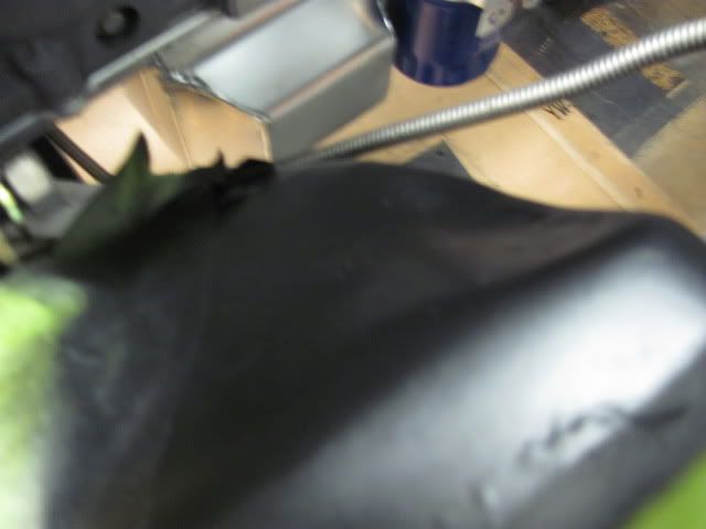

tuff57 03-28-2010 08:38 PM

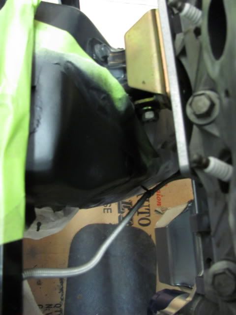

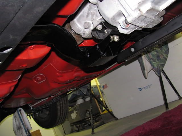

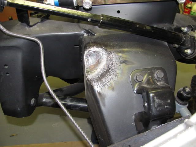

Had to do some massaging to the frame to get the headers in today. Had the motor in and out about three times to get it perfect. Just going to throw them in once more to mark where the o2 sensors will go, weld emm up, and then send em for coating. Hoping my Street and Performance package comes sometime this week:thumbsup:
http://i14.photobucket.com/albums/a3...7/IMG_0112.jpg
http://i14.photobucket.com/albums/a3...7/IMG_0111.jpg
http://i14.photobucket.com/albums/a3...7/IMG_0110.jpg

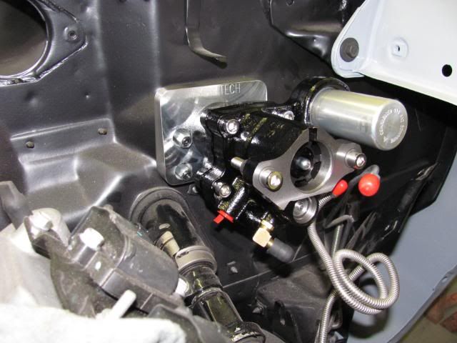

tuff57 04-04-2010 08:43 AM
I was off from school this week. Worked 65 hours:D and bought myself this beautiful piece of art

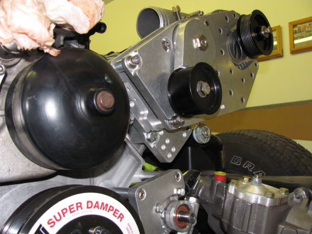

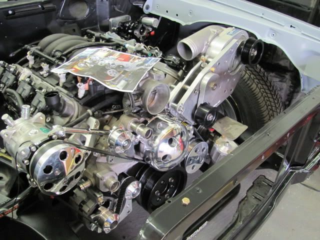

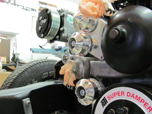

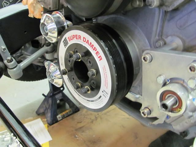

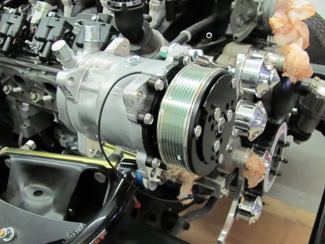

tuff57 04-18-2010 12:27 PM

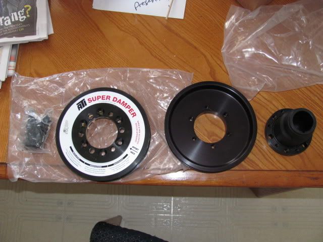

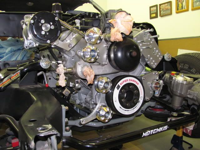

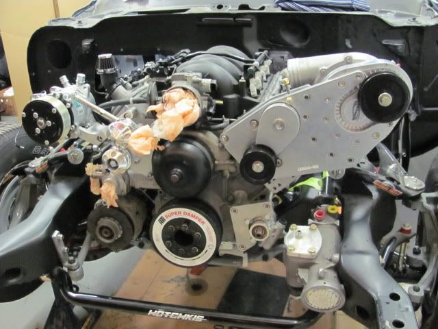

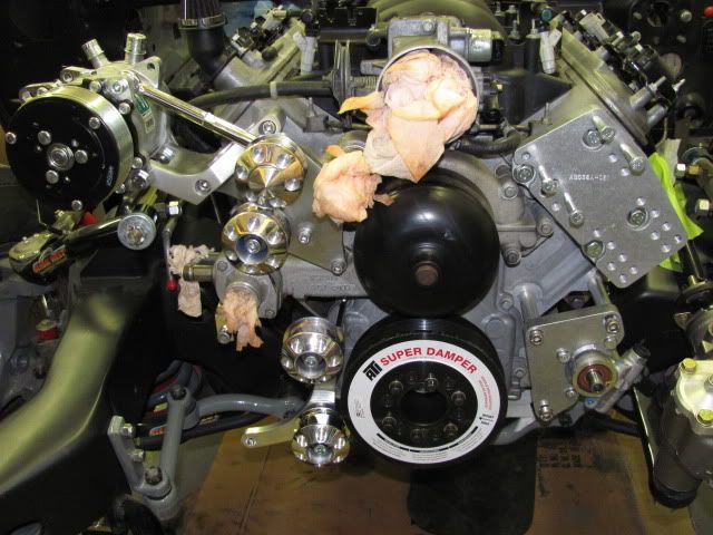

Got a ton of work done today! A/C compressor's all mocked in place with the idler pulleys. The harmonic balancer is on. For the 3rd time I have the wrong alternator:faint: so hopefully this week I can get the right one. Street and Performance did some great work on all my brackets and they all seem to line up perfectly. They gave ,e the wrong P/S pulley so this week I'm hoping to recieve the right one. My Procharger comes back this week as well as the crank pulley so I'm hoping to mock those items up and then the front of the motor will be done. Ordered my tank from Rick's Thursday as well:). So that should be here in a month or so.
http://i14.photobucket.com/albums/a3...7/IMG_0136.jpg
http://i14.photobucket.com/albums/a3...7/IMG_0142.jpg
http://i14.photobucket.com/albums/a3...7/IMG_0141.jpg
http://i14.photobucket.com/albums/a3...7/IMG_0144.jpg
http://i14.photobucket.com/albums/a3...7/IMG_0143.jpg
http://i14.photobucket.com/albums/a3...7/IMG_0145.jpg
http://i14.photobucket.com/albums/a3...7/IMG_0146.jpg

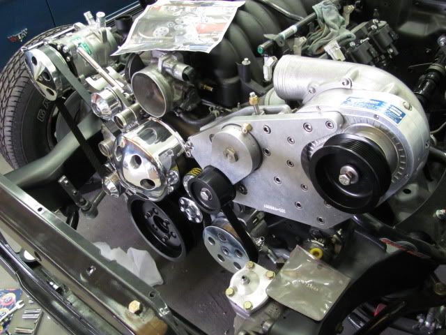

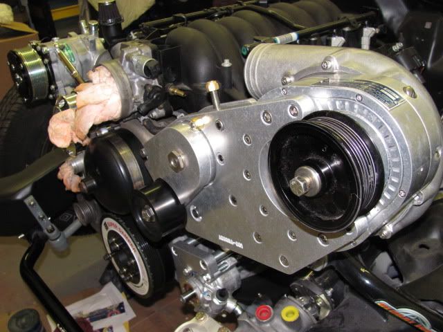

tuff57 04-25-2010 04:27 PM

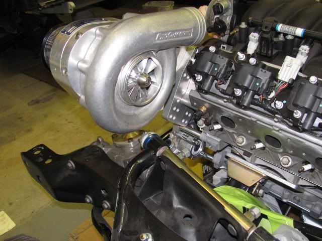

Got my Procharger back this week. Been kinda busy, haven't really had time to do anything. Managed to throw the blower on today.
http://i14.photobucket.com/albums/a3...7/IMG_0155.jpg
http://i14.photobucket.com/albums/a3...7/IMG_0157.jpg
http://i14.photobucket.com/albums/a3...7/IMG_0156.jpg
http://i14.photobucket.com/albums/a3...7/IMG_0158.jpg

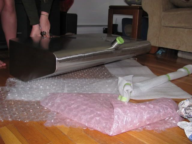

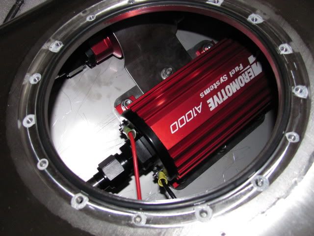

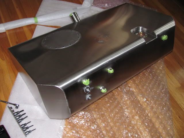

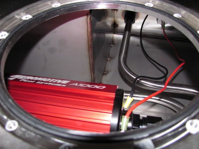

Got my tank from Rick's this week:D
http://i14.photobucket.com/albums/a3...7/IMG_0192.jpg
http://i14.photobucket.com/albums/a3...7/IMG_0193.jpg
http://i14.photobucket.com/albums/a3...7/IMG_0190.jpg
http://i14.photobucket.com/albums/a3...7/IMG_0191.jpg

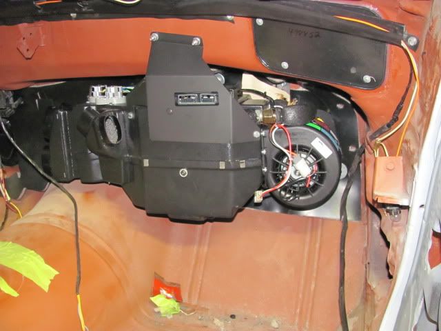

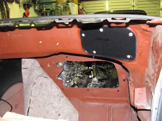

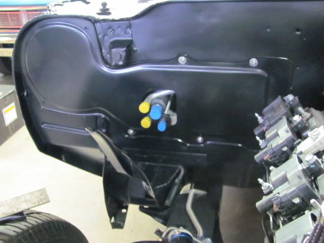

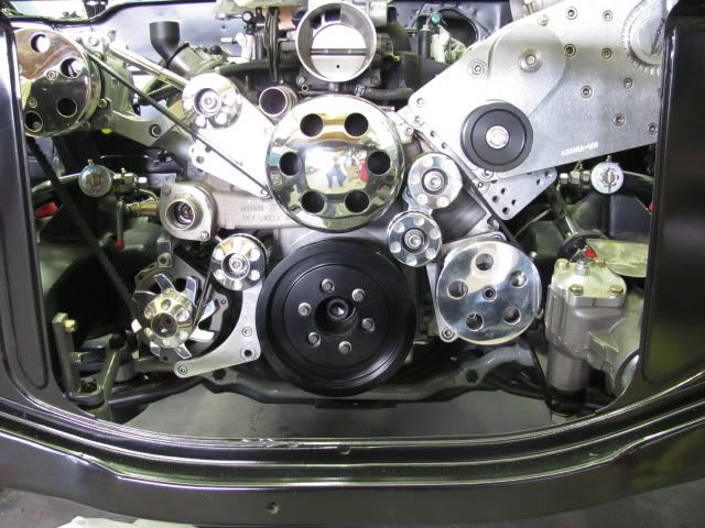

Rich I have run into so many problems with the front of the motor trying to get a good belt wrap on the water pump and crank pulley, so I sent a lot of my Procharger stuff to Street and Performance today to see if they can work something out. I'm waiting on my Wilwood master to be off backorder, and this week I'm going to try and clean the dimples I had to put in my headers so I can send them out for coating. I've been working like 70 hours a week trying to get some cash for the car saved so within the next few weeks I should be ordering the engine harness, the fans and radiator, my ATS spindles, hopefully maybe some brakes, and the rest of the filters and rails and odds and ends for the fuel system and gauges to fire this thing up. I got my hydraboost this week and threw the booster in. We started putting the A/C in so hopefully after this is done and the dash, rear seat and nose is on it can go for the cage!
P.S. we did a lot more on the A/C we're just waiting for the firewall plate to be back from painting to put in:)
http://i14.photobucket.com/albums/a3...7/IMG_0233.jpg
http://i14.photobucket.com/albums/a3...7/IMG_0230.jpg
http://i14.photobucket.com/albums/a3...7/IMG_0229.jpg
http://i14.photobucket.com/albums/a3...7/IMG_0232.jpg

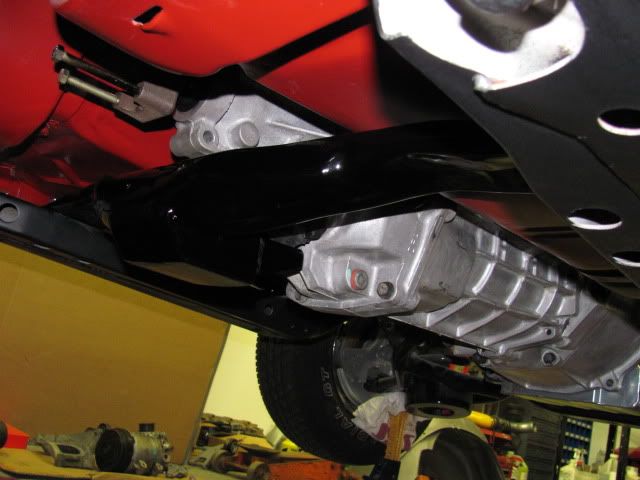

tuff57 09-05-2010 10:36 PM

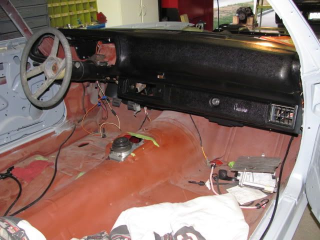

Hey guys, been really busy all summer working like 70 hours a week, now I started school so between work and homework I don't have any time to breathe. I got a chance to work on the car today and got a lot done. Street and Performance sent me they're newest update to my front accessory set-up. This one looks like it's going to work, they just sent me one pulley wrong, and I have to figure out how to get the god damn belt on. I got the a/c box in, put the dash in for mock up when I bring it for the cage. I'm 75% sure I can put the computer under the dash, just have to try a few more things then I can order the harness. Also measured the spacing for the radiator so I can order that and started mocking up in my head the intercooler piping. So hopefully I'll be able to find some time and get some more progress for you guys:D
http://i14.photobucket.com/albums/a3...7/IMG_0243.jpg
http://i14.photobucket.com/albums/a3...7/IMG_0250.jpg
http://i14.photobucket.com/albums/a3...7/IMG_0251.jpg
http://i14.photobucket.com/albums/a3...7/IMG_0249.jpg
http://i14.photobucket.com/albums/a3...7/IMG_0252.jpg
http://i14.photobucket.com/albums/a3...7/IMG_0244.jpg
