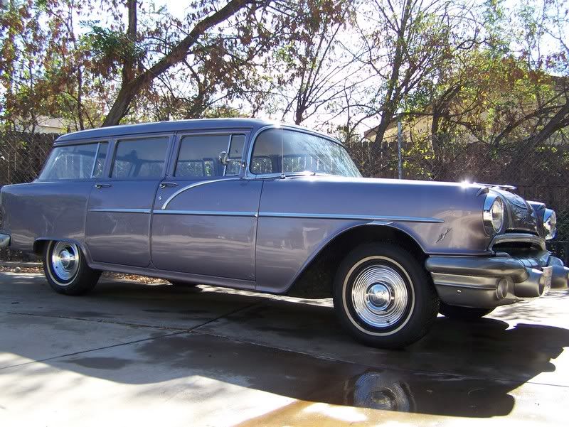

slow4dr 03-21-2010 07:13 PM
Hey Rodger,
I've been thinking about doing something like this at work but this would certainly save me a ton of time. Anyone know if the mounting locations are the same between the Chev and the Pontiac?
-J
Unmolested :thumbsup:
http://i41.photobucket.com/albums/e2...n/100_1292.jpg

brings up a good question Rodger. Which body is the frame setup for? sedan, ht, wagon, vert? Most bodies share most all same mounting points except for a couple locations either added or moved depending on which body is being installed.
ironworks 03-21-2010 10:11 PM
We have checked hard top and sedan and will be doing a Convertible very soon. I have not done a wagon yet, but that is the one I have been told is just a bit different. I guess that would be a good point in selecting a my testers. I have had an over whelming response from people wanting to try these frames out.

slow4dr 03-22-2010 01:36 PM
I was more curious about the differences between the Chev and Pontiac than the difference in body styles. The front suspension for the Chev is completely different than for the Pontiac but the rear is the same so I am hopeful the body mounting points are the same.
-J
FYI: I read the thread at Tri-5 and I thought I would throw this out there since I saw something mentioned about it. TCI uses two fixtures to build a chassis, one fixture for the rail itself and one fixture for the frame once the rails are built to spec. If the rails or chassis are more than 1/16" out front to back the rails are scrapped.
