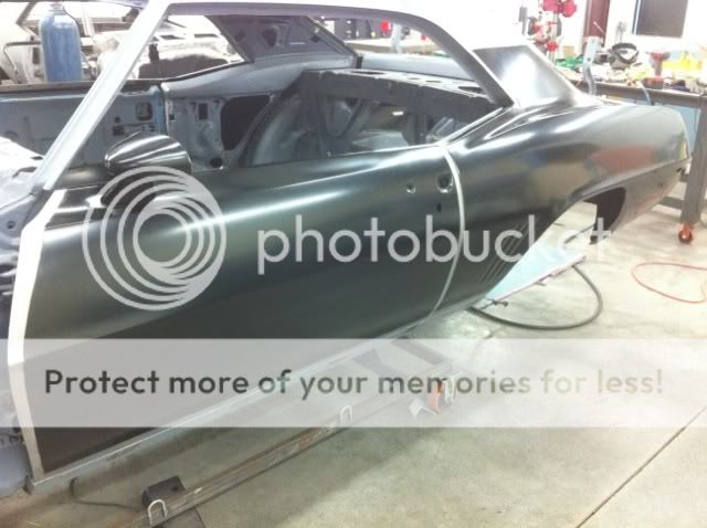

update from Holohans Hot Rod shop
I dropped the wife's car off with Dan Holohan at his shop in Mooresville a couple weeks ago. He has started on it and sent some pics.
Fixing backglass area
http://i416.photobucket.com/albums/p...t/DSCN0443.jpg

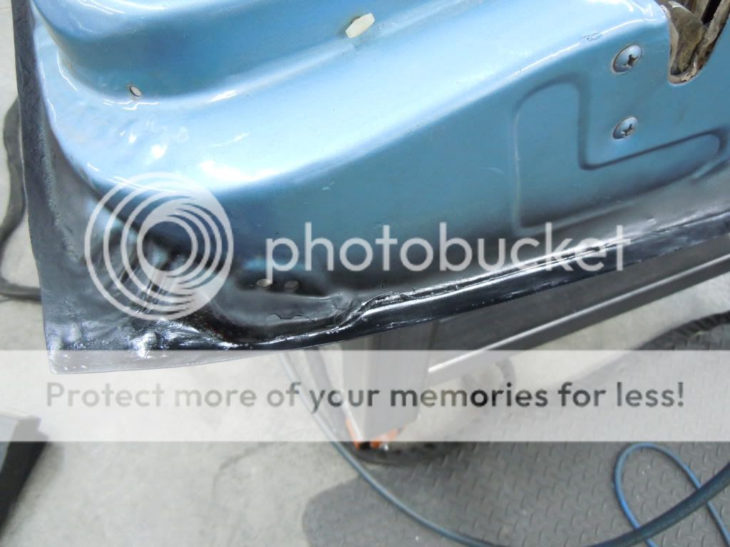

Had to add some metal to PS door for skin to fit to.
http://i416.photobucket.com/albums/p...t/DSCN0474.jpg
http://i416.photobucket.com/albums/p...t/DSCN0476.jpg
http://i416.photobucket.com/albums/p...t/DSCN0478.jpg

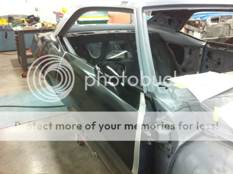

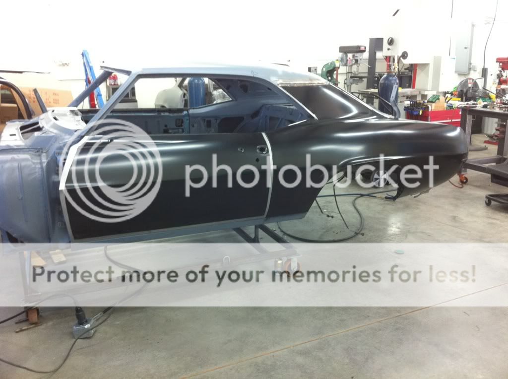

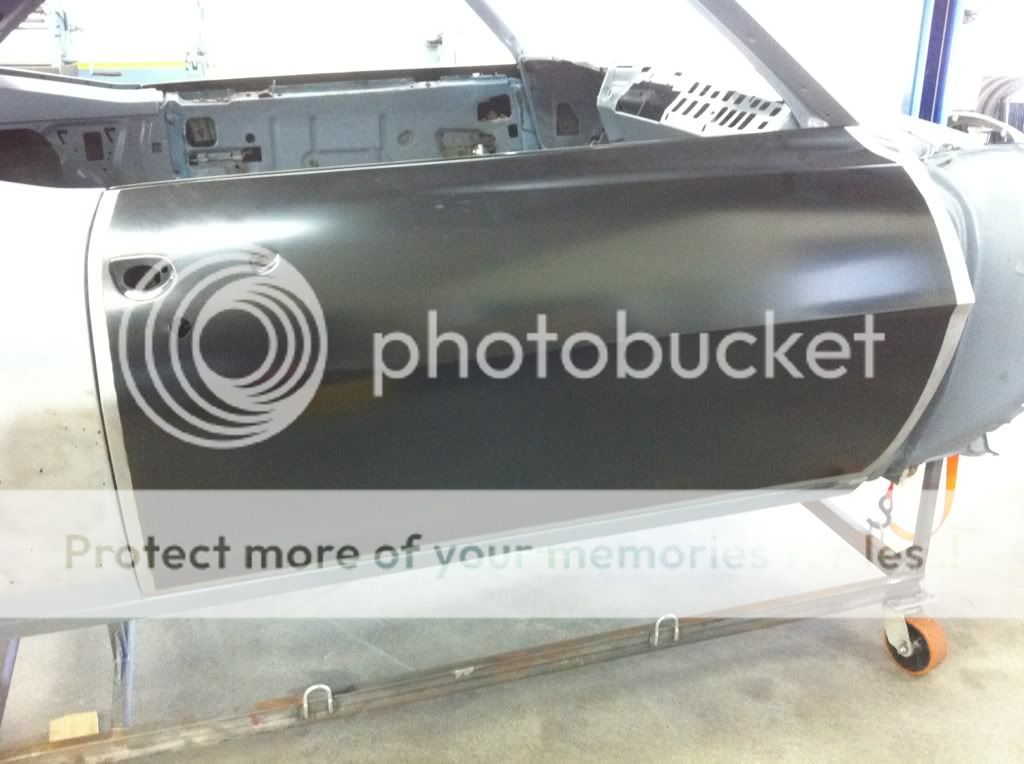

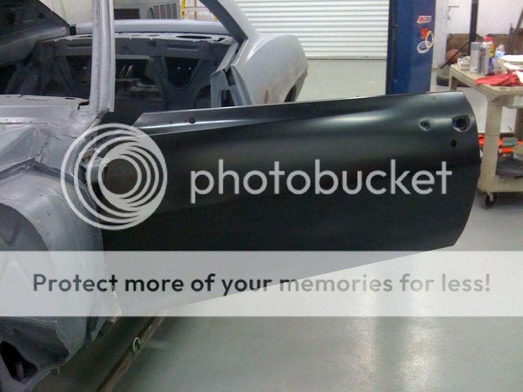

Passenger door skin on and hung. Gaps look good
http://i416.photobucket.com/albums/p...t/IMG_0233.jpg

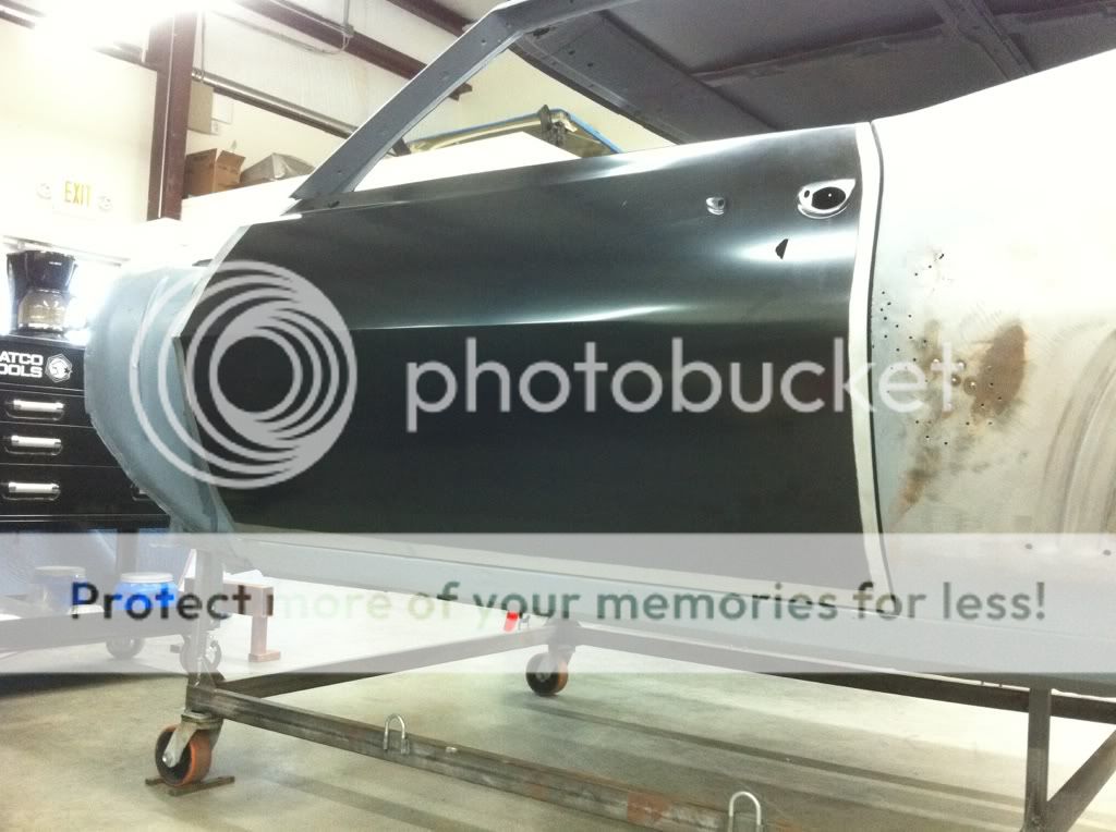

Driver door gaps...making progress
http://i416.photobucket.com/albums/p...t/IMG_0237.jpg

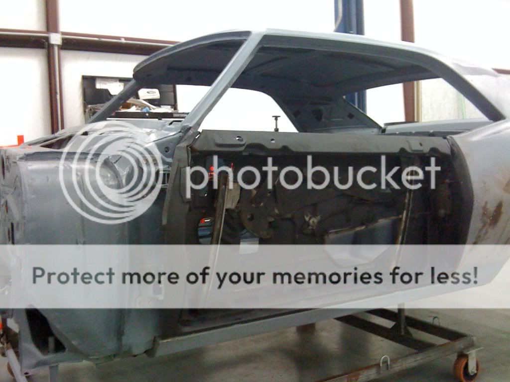

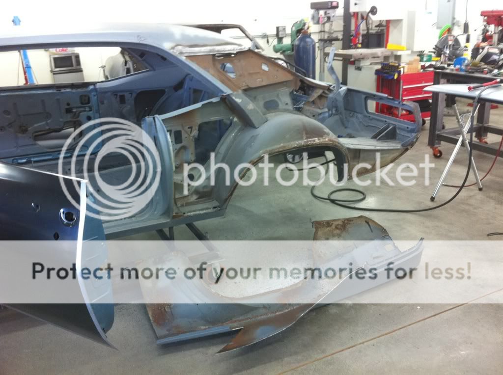

Removing quarter panel
http://i416.photobucket.com/albums/p...t/IMG_0240.jpg

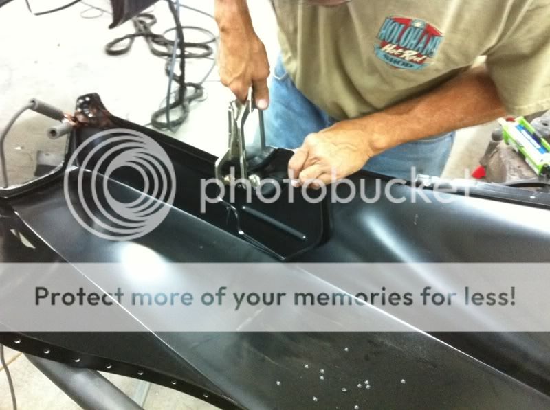

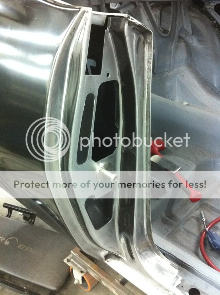

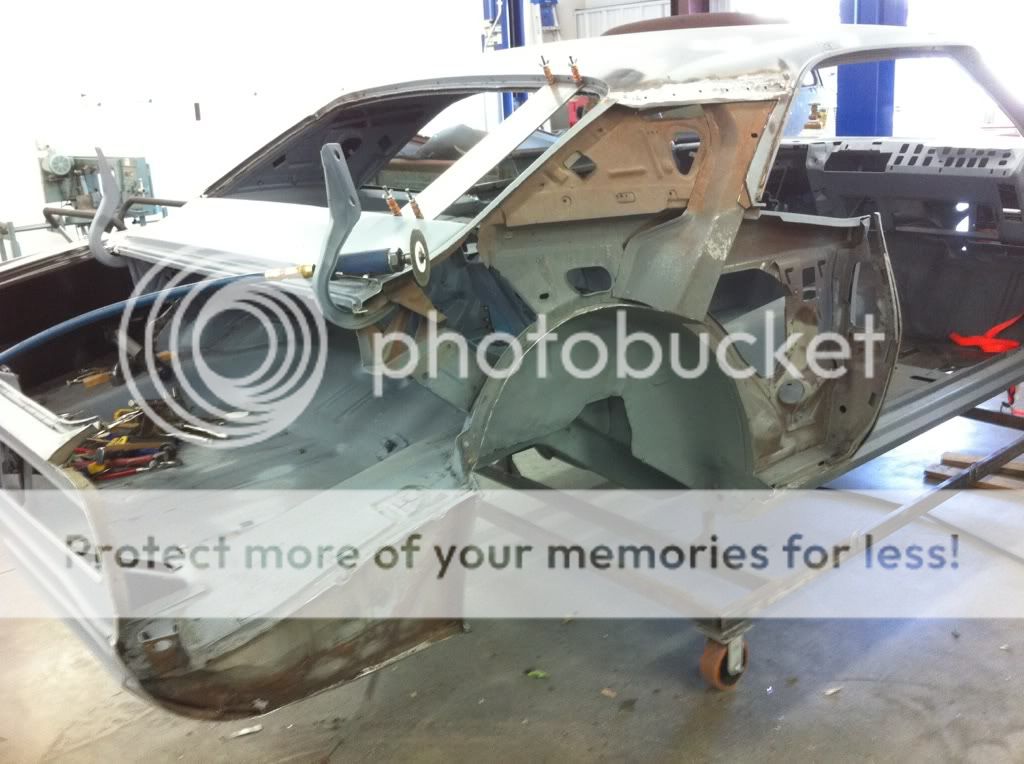

Jay Hilliard 10-01-2010 06:41 AM
Here are some more pics. Dan is doing an awesome job. I could not ask for better work, attention to detail and all work done correctly as if it was his car.
He catches the small things, like the RR had been replaced before, but the qtr panel re-enforcement panel was not there. Alot of shops would have not said a word,, taken the time to add this peice in and just installed the quarter anyway.
http://i416.photobucket.com/albums/p...IMG_0261-1.jpg
http://i416.photobucket.com/albums/p...IMG_0267-1.jpg
http://i416.photobucket.com/albums/p...t/IMG_0269.jpg
http://i416.photobucket.com/albums/p...t/IMG_0272.jpg
http://i416.photobucket.com/albums/p...t/IMG_0274.jpg
http://i416.photobucket.com/albums/p...t/IMG_0276.jpg

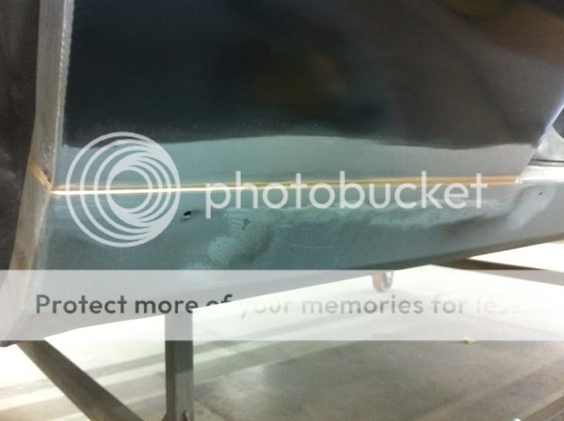

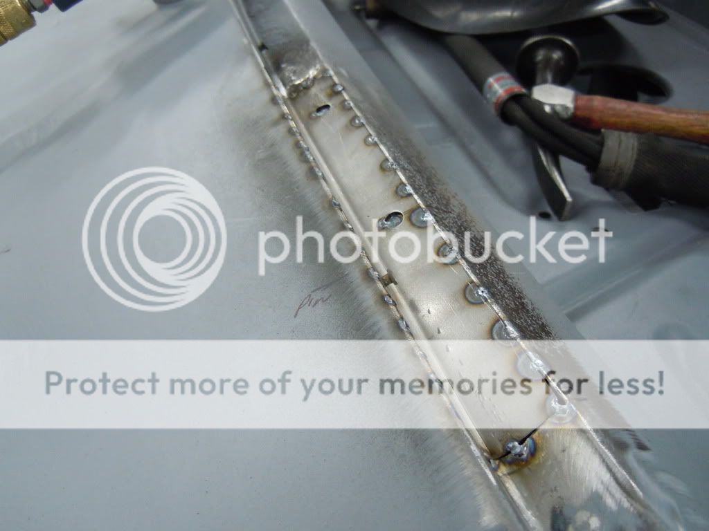

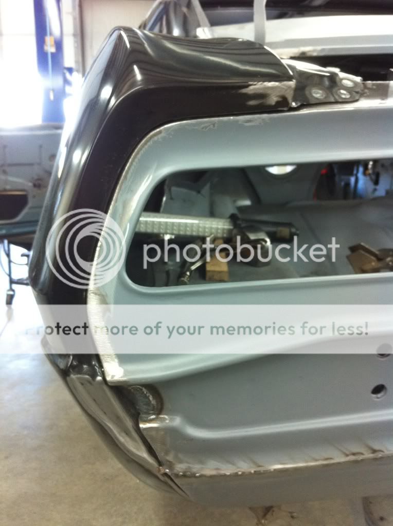

Dan is definitely gifted and makes it look very easy. Here are some more pics:

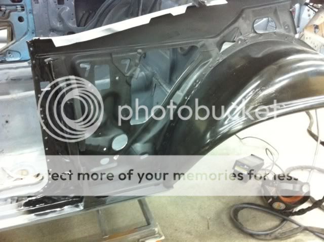

Left quarter plug welded
http://i416.photobucket.com/albums/p...t/IMG_0283.jpg

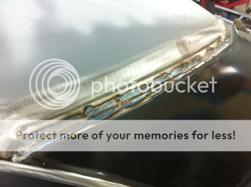

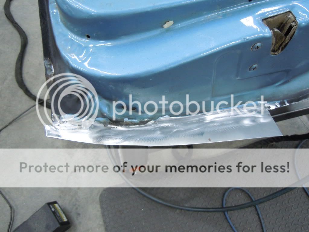

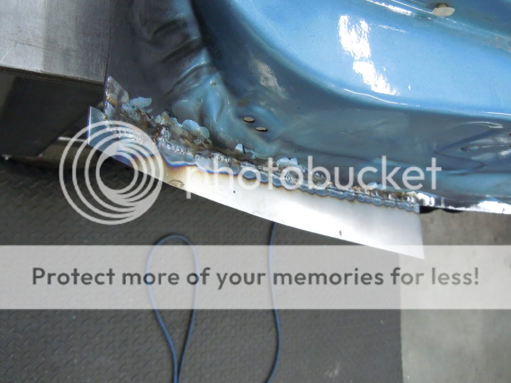

top of quarter plug welded and silicon brazed
http://i416.photobucket.com/albums/p...t/IMG_0288.jpg

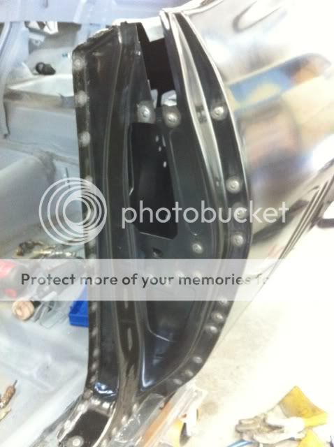

Took some work but very nice fit to tail pan
http://i416.photobucket.com/albums/p...t/IMG_0292.jpg
http://i416.photobucket.com/albums/p...t/IMG_0293.jpg

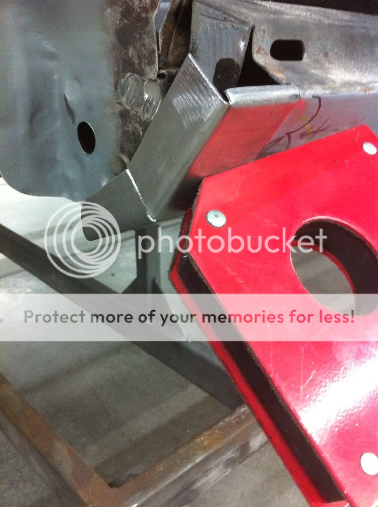

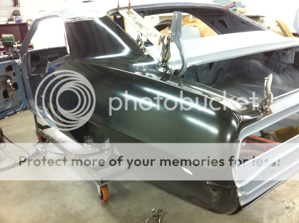

Started on RR qtr
http://i416.photobucket.com/albums/p...t/IMG_0299.jpg

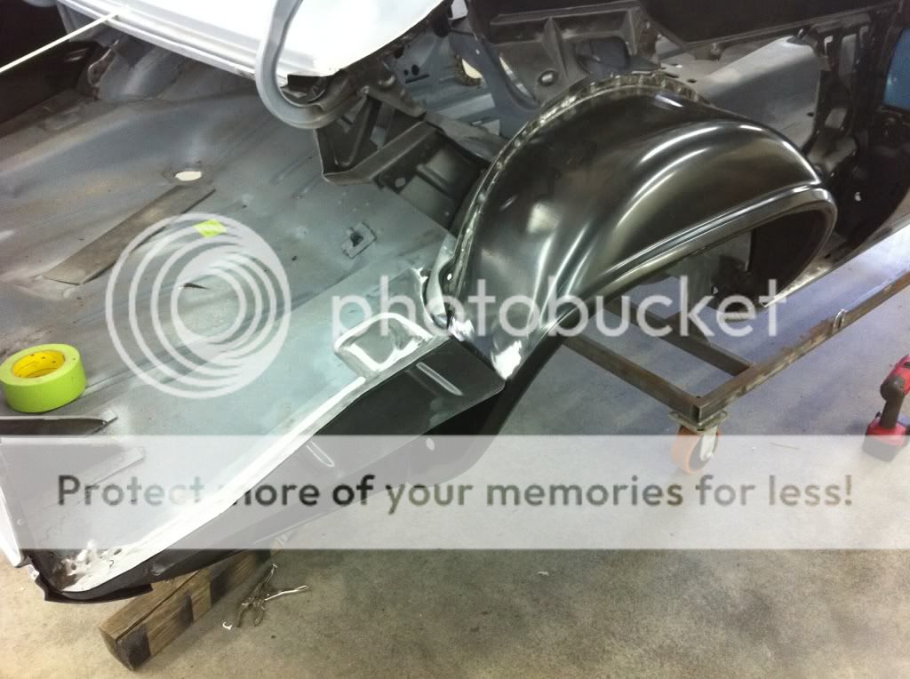

Jay Hilliard 11-03-2010 05:30 PM
Here are some more pics!!!
rocker repair
http://i416.photobucket.com/albums/p...ckerrepair.jpg
http://i416.photobucket.com/albums/p...kerrepair1.jpg
http://i416.photobucket.com/albums/p...kerrepair2.jpg
http://i416.photobucket.com/albums/p...kerrepair5.jpg
inner tub repair
http://i416.photobucket.com/albums/p.../tubrepair.jpg
http://i416.photobucket.com/albums/p...tubrepair1.jpg
http://i416.photobucket.com/albums/p...tubrepair2.jpg
http://i416.photobucket.com/albums/p...tubrepair5.jpg
http://i416.photobucket.com/albums/p...tubrepair6.jpg
http://i416.photobucket.com/albums/p...tubrepair7.jpg

silicon brazing qtr seams
http://i416.photobucket.com/albums/p...t/IMG_0402.jpg
http://i416.photobucket.com/albums/p...t/IMG_0400.jpg
http://i416.photobucket.com/albums/p...t/IMG_0397.jpg
http://i416.photobucket.com/albums/p...t/IMG_0375.jpg
http://i416.photobucket.com/albums/p...t/IMG_0379.jpg

Sandbagger 11-03-2010 06:01 PM
Where did you get the silicon brazing rod ? Tig ? Oxy acetalene ??
waynieZ 11-03-2010 08:13 PM
That work is amazing. Beautiful !
Frankenstine 11-03-2010 09:04 PM
Hey Jay, Nice car, nice work,? on your replacement metal did you use AMD on all of it? I have heard nice things about AMD. I will be moveing back to NC after the first of the year, and will begin working on my 69, I am planning to do most of the tear down myself to save some clam$, I am impressed on the workmanship of Holohan's Shop, will definatly look him up, Thanks and keep the picks comming.
Jay Hilliard 11-04-2010 04:43 AM
Dan uses Tig for 99% with everything he does. You can get the rods from most welding supply places.

Sandbagger 11-04-2010 06:39 AM
I used AMD for everything. Its alot nicer than others and heavier gauge. I have a NOS trunk lid and bought an AMD and the AMD is heavier by a few lbs. Go check out Dan and his shop. Excellent work, sends pics constantly, great communication.
I have been in collision shops for 20 years . Never seen it used . Kinda sad really . I have cut parts off that use it good stuff .
Less heat ? I know it grinds easier than mig welding .
Jay Hilliard 11-04-2010 06:50 AM
You are correct. Per Dan, it does use less heat and is easier to grind. I am not very familiar with it myself.
