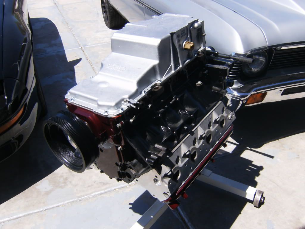

70TWO NOVA 05-29-2010 06:15 PM

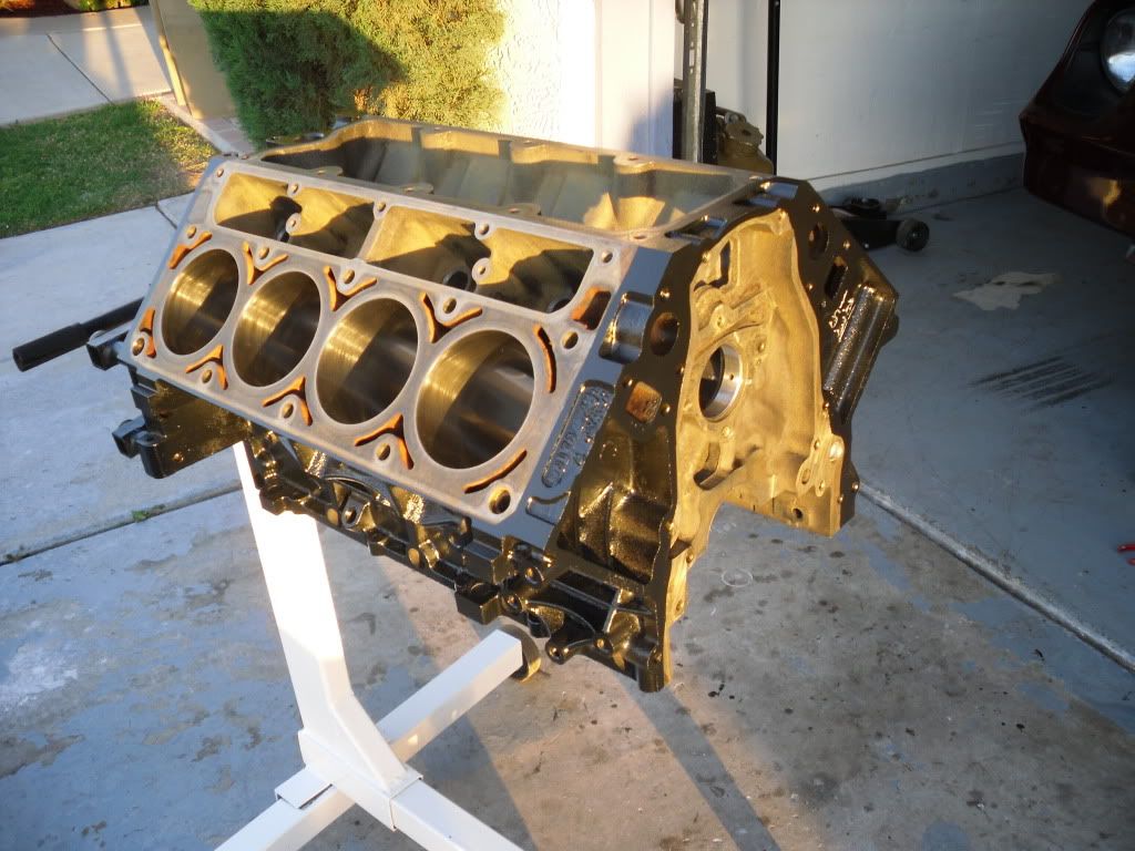

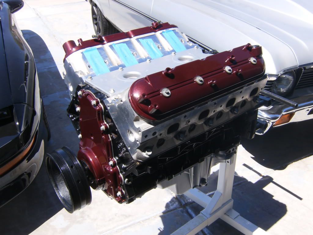

Some more updates. Installed the lifters (out of the old LQ4) LS2 MLS head gaskets, the heads and lifter valley cover.
Also ordered the front and rear cover gaskets, oil pan, windage trey, pickup tube, valve cover and oil pan gaskets as well as the sbc motor mounts and LSx adapter plates.
and some pics....
http://i270.photobucket.com/albums/j...May2920104.jpg
http://i270.photobucket.com/albums/j...May2920107.jpg
http://i270.photobucket.com/albums/j...May2920108.jpg
http://i270.photobucket.com/albums/j.../May292010.jpg
http://i270.photobucket.com/albums/j...May2920105.jpg

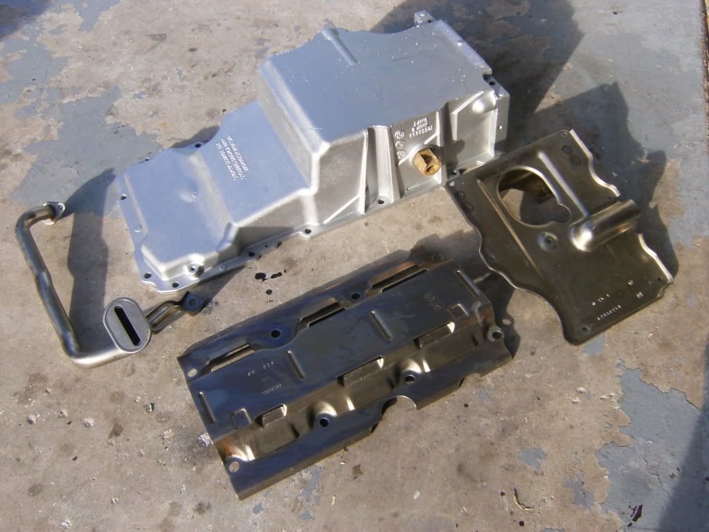

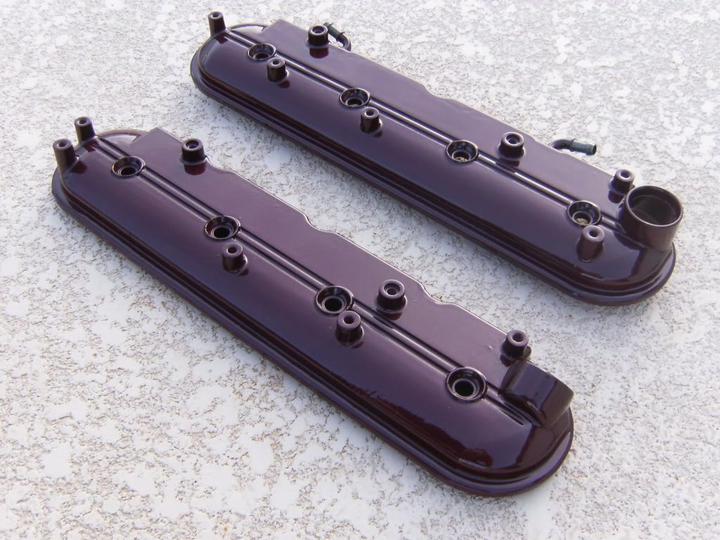

Some progress today; I primered the valve covers and timing cover (paint tomorrow), the oil pan, pickup and windage trey also arrived today so I started the cleanup on that. Hopefully Ill have the whole thing closed up by the end of the week.
http://i270.photobucket.com/albums/j.../June12010.jpg
http://i270.photobucket.com/albums/j...June120103.jpg
http://i270.photobucket.com/albums/j...June120102.jpg

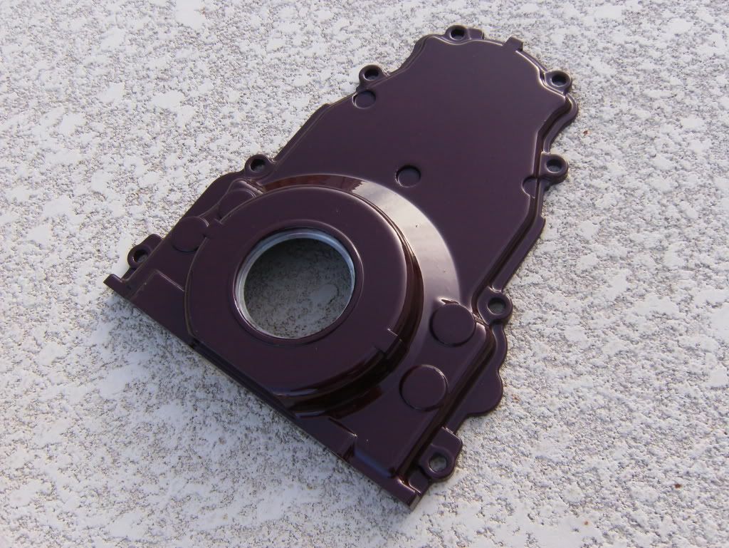

70TWO NOVA 06-02-2010 07:16 PM
some body color paint on the valve and timing covers...
http://i270.photobucket.com/albums/j.../June22010.jpg
http://i270.photobucket.com/albums/j...June220104.jpg

cleaned up the pan, pickup and windage trey...
http://i270.photobucket.com/albums/j.../June32010.jpg

98ssnova 06-05-2010 01:52 PM
Motor looks great like the black blocke and color match covers cool idea
70TWO NOVA 06-05-2010 03:46 PM
Originally Posted by 98ssnova (Post 290601)
Motor looks great like the black block and color match covers cool idea
Thanks, I painted my buddies LS engine covers body color and liked the way it looked.

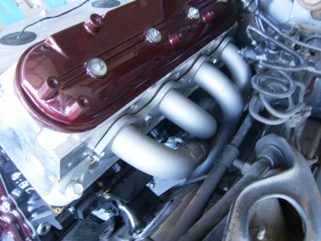

Edelbrock LS swap header arrived today.
http://i270.photobucket.com/albums/j...ockHeaders.jpg

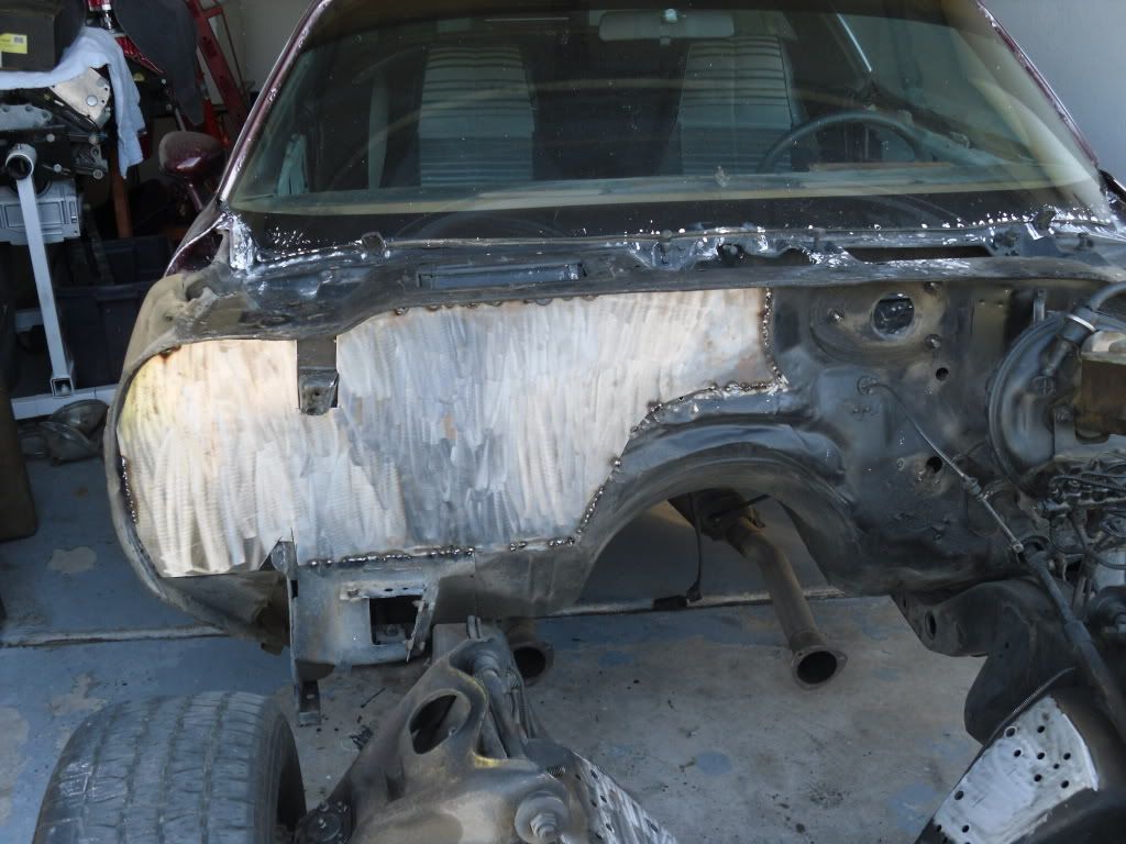

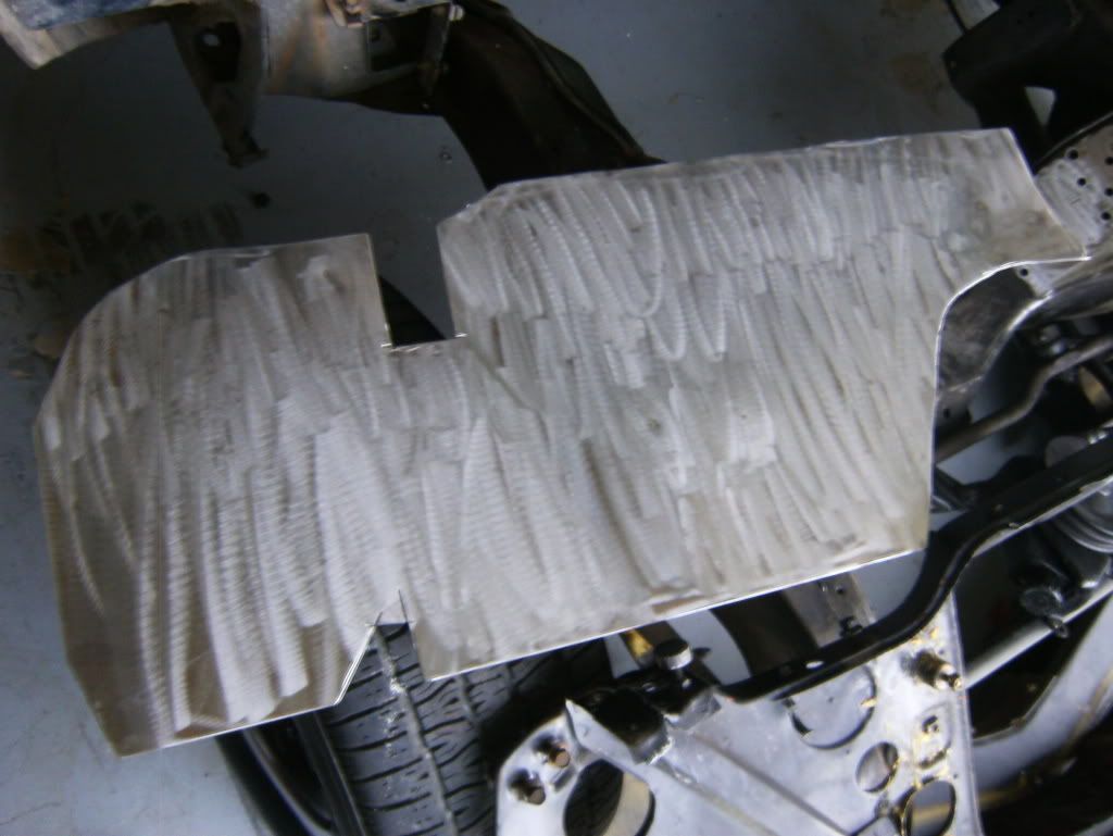

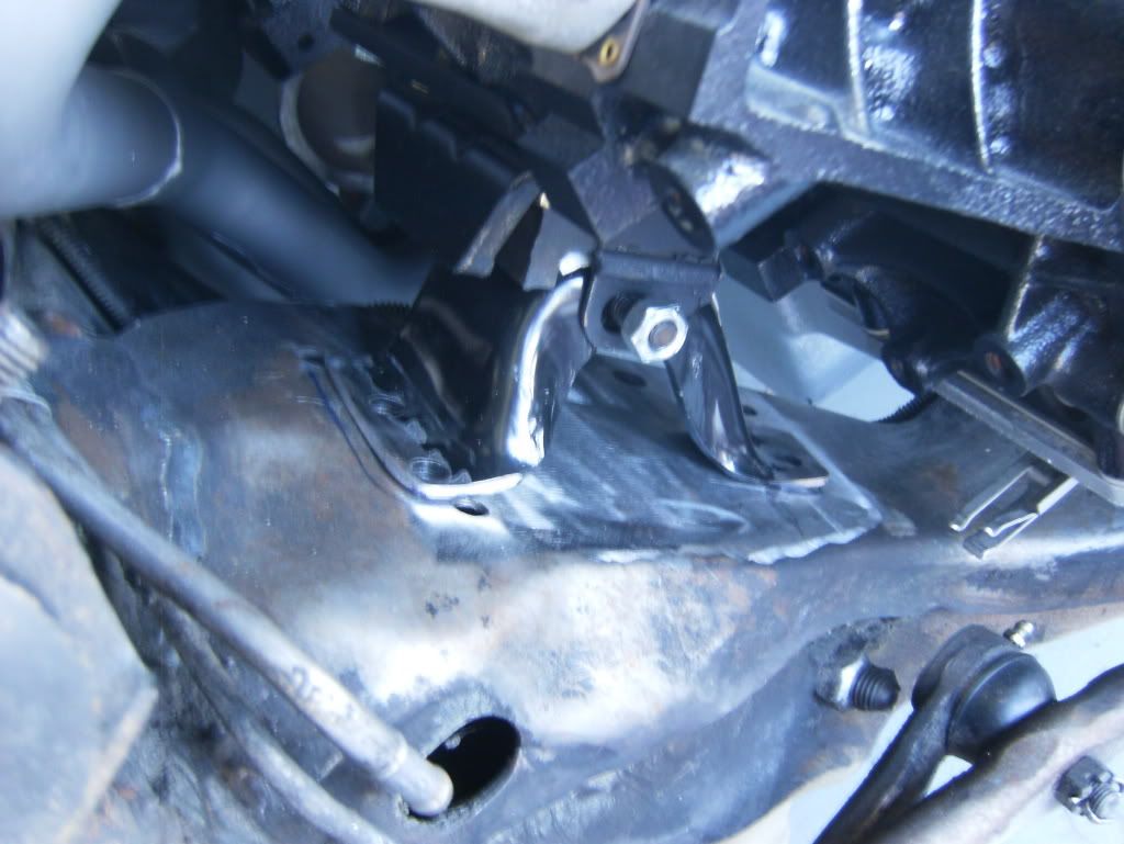

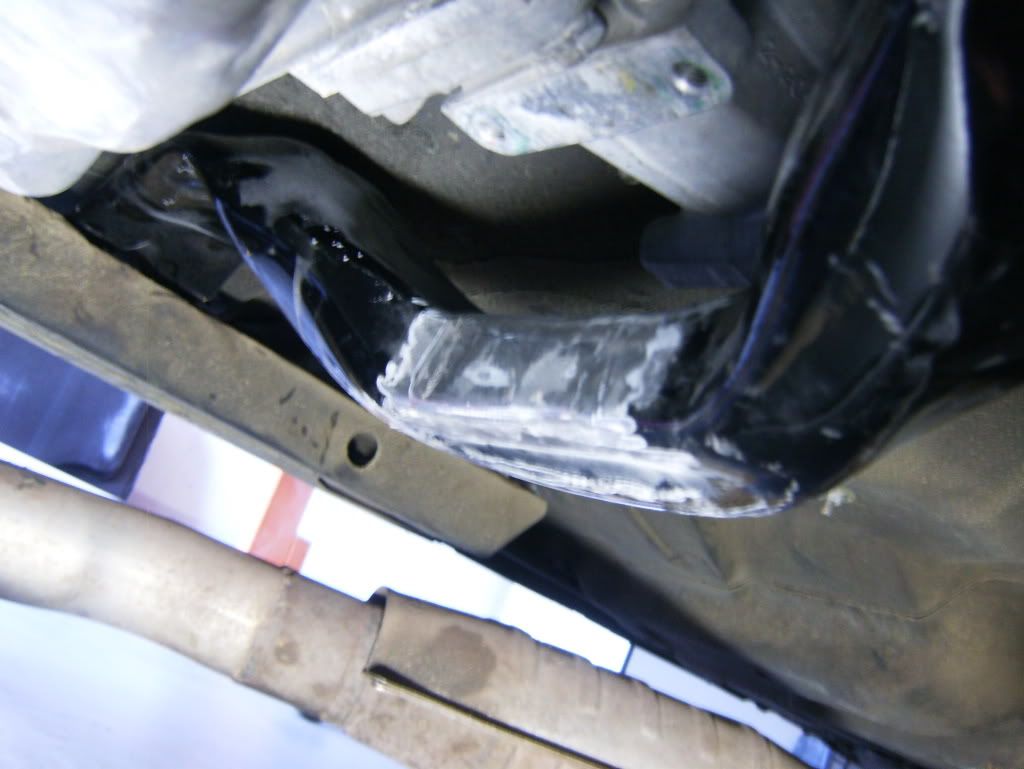

Made a template and cut out some sheet metal to shave the firewall.
http://i270.photobucket.com/albums/j.../Oct420102.jpg
http://i270.photobucket.com/albums/j...8/Oct42010.jpg
70TWO NOVA 10-07-2010 04:33 PM
tacked in the sheet metal today.
http://i270.photobucket.com/albums/j...8/Oct72010.jpg

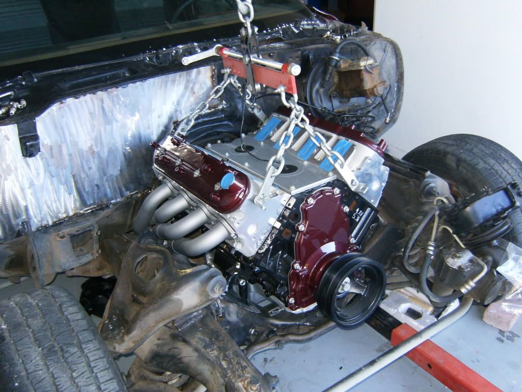

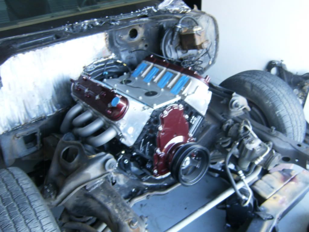

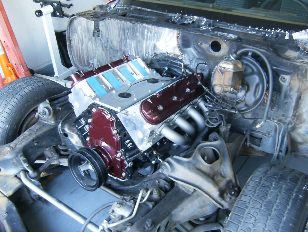

70TWO NOVA 10-11-2010 05:28 PM
We stabbed the engine and transmission today. The oil pan, headers and everything fits great!
http://i270.photobucket.com/albums/j...Oct1120105.jpg
http://i270.photobucket.com/albums/j...Oct1120107.jpg
http://i270.photobucket.com/albums/j...Oct1120109.jpg
http://i270.photobucket.com/albums/j...Oct1120104.jpg

chunger 10-11-2010 07:47 PM
I take it this was just for a fitting?
70TWO NOVA 10-11-2010 08:43 PM
Oh yeah, just to get it all fine tuned and the mounts welded in the correct place. Now we are gonna blow it all apart again and clean and paint everything up nice.

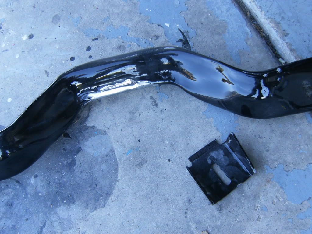

70TWO NOVA 10-12-2010 05:37 PM
some alterations to the trans cross member are in order now...
http://i270.photobucket.com/albums/j.../Oct132010.jpg
http://i270.photobucket.com/albums/j...Oct1320103.jpg
http://i270.photobucket.com/albums/j...Oct1320104.jpg

vannatta20 10-19-2010 07:58 AM
Dont forget to measure your drivetrain angle. I think the tranny needs to be at -1 to -3. Do you need a poly tranny mount? My dad has an extra. Remember all the issues I had using rubbers. My stock LS1 ripped them in half. You should really change them.
