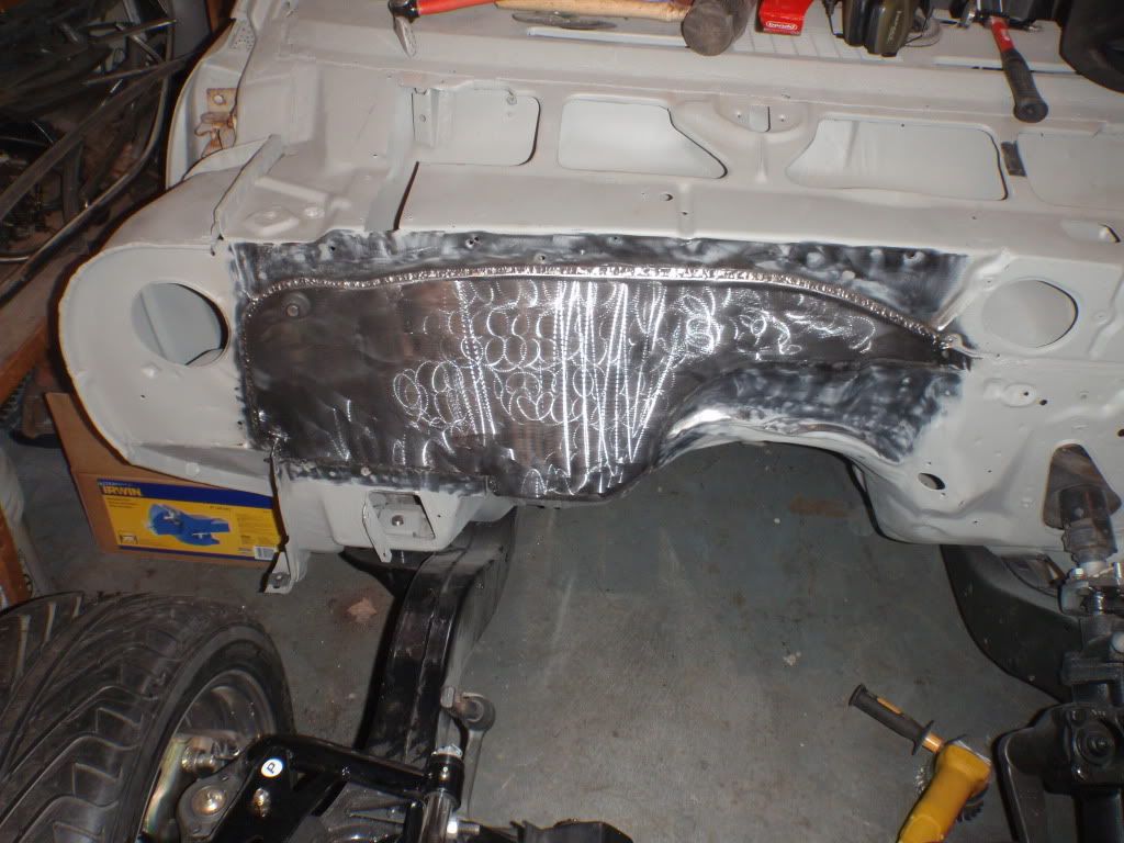

johnnymac46 04-23-2011 08:41 PM
http://i987.photobucket.com/albums/a...6/a3b9d685.jpg
http://i987.photobucket.com/albums/a...6/cd3a6527.jpg
http://i987.photobucket.com/albums/a...6/e3fa0cb3.jpg
http://i987.photobucket.com/albums/a...6/788c0dd4.jpg
The little progress I made today
Sorry about the iPhone pics

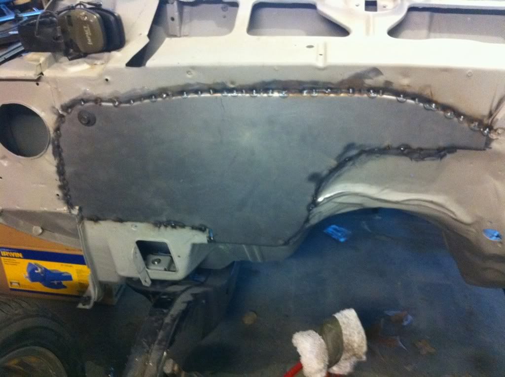

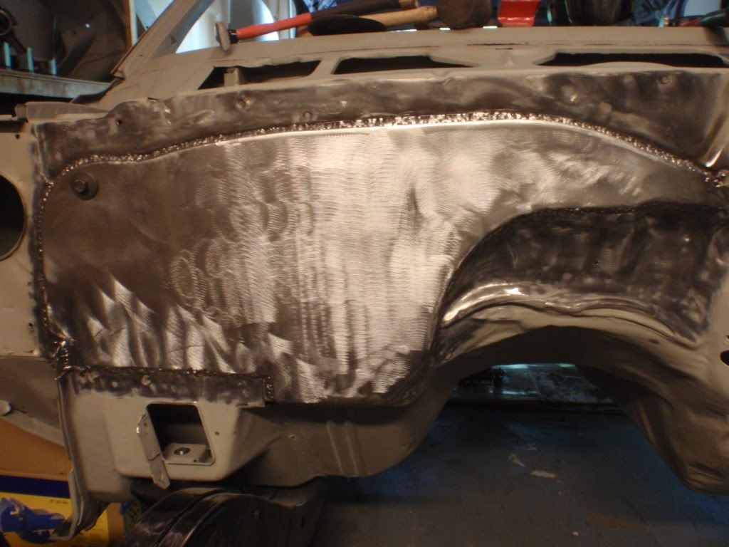

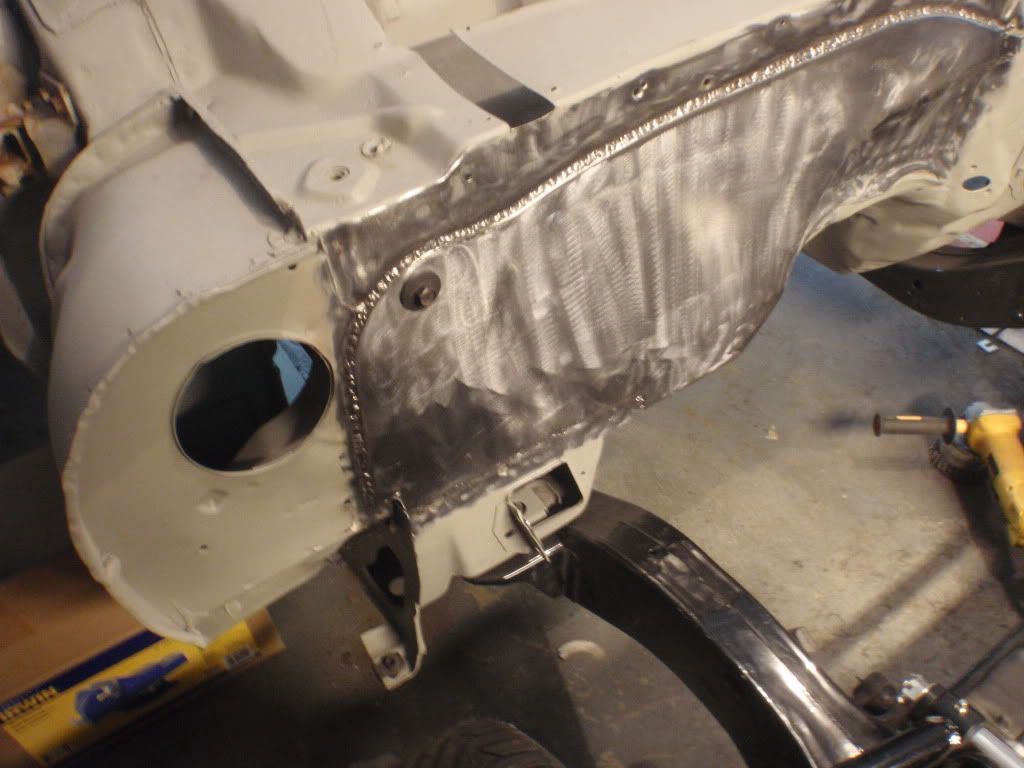

I finished welding the DSE plate yesterday and got a coat of primer.
I havent ground the welds down yet due to my lack of tools. Im having 2-220V outlets installed on Tuesday and some additional lighting in the garage.
I had my surgery this morning so I'm using my down time to collect parts and hopefully buy an air compressor.
here's a few pics of the plate before primer... :woot:
http://i987.photobucket.com/albums/a...-Camaro185.jpg
http://i987.photobucket.com/albums/a...-Camaro183.jpg
http://i987.photobucket.com/albums/a...-Camaro181.jpg

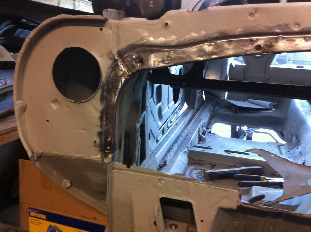

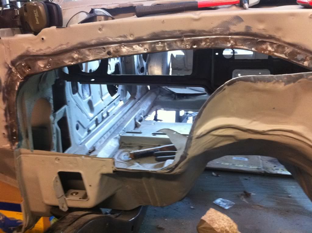

johnnymac46 05-26-2011 04:45 PM
No new progress on the car...
I am however able to get out of my sling when I'm sitting around or typing on the computer which makes life much easier.

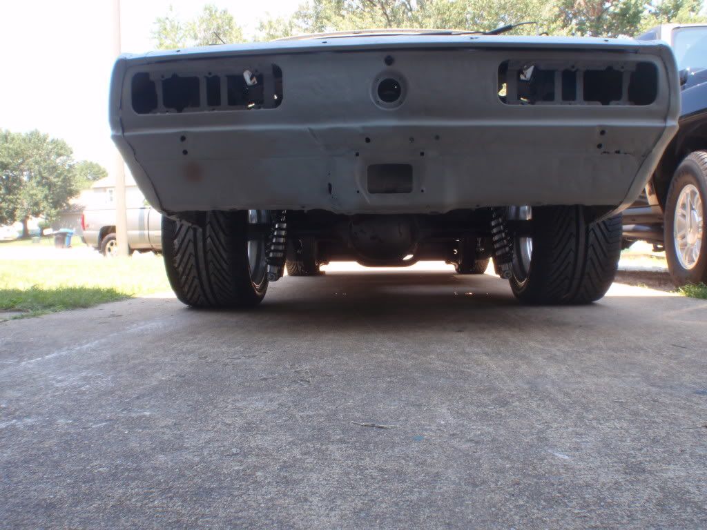

Here are some better pics of the rear clip
Everything inside me wants to slam my vendor for not getting my axles and third member to me yet, but I'm not going to hopefully that person reads this and realizes he's only losing business for the future. It’s only been 7 months since I ordered maybe I'm being impatient.
http://i987.photobucket.com/albums/a...o/P5090003.jpg
http://i987.photobucket.com/albums/a...o/P5090005.jpg
http://i987.photobucket.com/albums/a...o/P5090006.jpg
just for fun
http://i987.photobucket.com/albums/a...o/P5090007.jpg
http://i987.photobucket.com/albums/a...o/P5090008.jpg
http://i987.photobucket.com/albums/a...o/P5090009.jpg

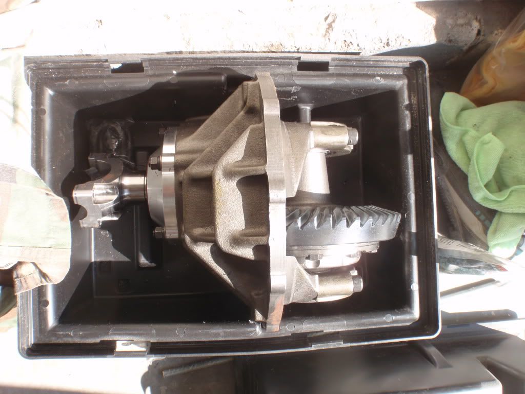

The axles and center section have arrived Im waiting on a few small pieces now. I hope to have it assembled this weekend.

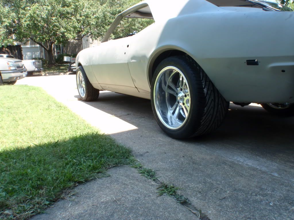

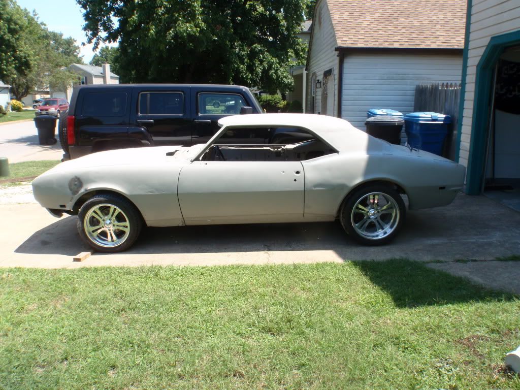

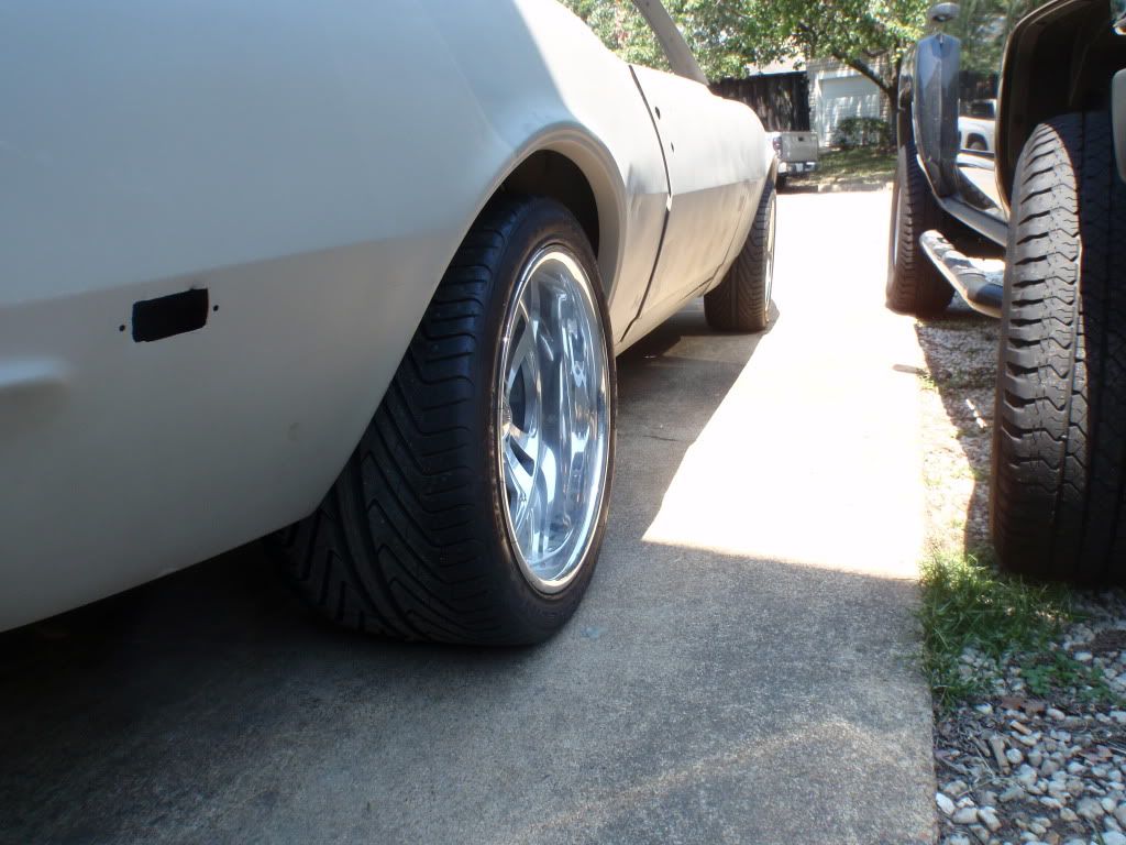

Here is how the car sits.
Before I get yelled at for not having the clip welded in I know It should be before its on the ground. but I need to move my car and dont have a cart anymore. Im replacing the Floor pans soon then Ill be finishing the install.
http://i987.photobucket.com/albums/a...o/P7010369.jpg
http://i987.photobucket.com/albums/a...o/P7010370.jpg
http://i987.photobucket.com/albums/a...o/P7010371.jpg
http://i987.photobucket.com/albums/a...o/P7010372.jpg
http://i987.photobucket.com/albums/a...o/P7010374.jpg
http://i987.photobucket.com/albums/a...o/P7010375.jpg

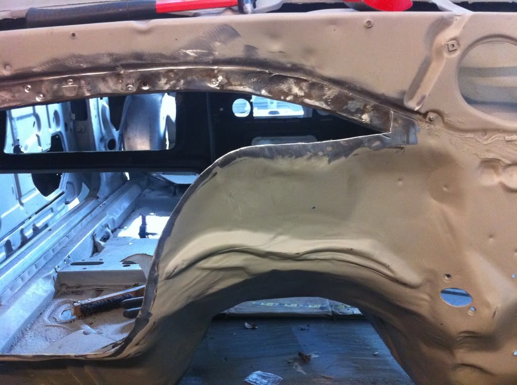

I got the metal around the rear glass patched up, needs a little filler but other than that its alright. the right side has a slight curve that shouldnt be there. I may rework that spot.
Im not sure when it was acceptable to put fiberglass and body filler over every blemish or hole in a car but whoever owned my car before me sure loved it.
Are the studs that look like a nail head used to hold on the chrome only? if so Im not going to re install them, however if they are more important im going to have to get creative.
I started hammering out my poor excuse for fenders as well, it looks like someone tried to remove them with a jack hammer and a bolt cutter. its a good place to learn how to use a hammer and dolly.
Heres some pics. enjoy
http://i987.photobucket.com/albums/a...o/P7110377.jpg
http://i987.photobucket.com/albums/a...o/P7110378.jpg

Originally Posted by TheJDMan (Post 358965)
What gear ratio did you settle on for the rear?
3.73 I'm not set on a tranny yet...I figured that would be the best bet for me...
