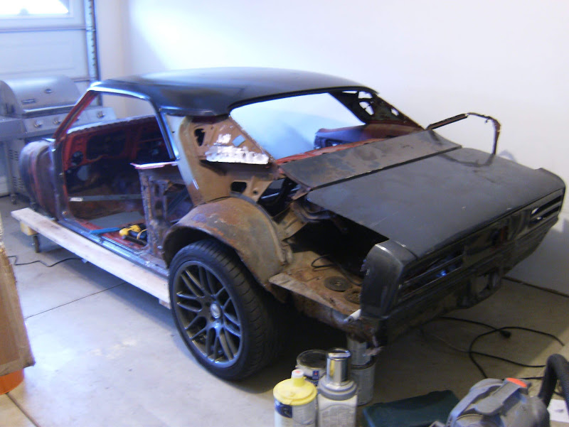

Progress! In between preparing the nursery for our first baby and watching the Bruins there hasn't been much time for the Bird. But today I was able to put in a few hours and got the old inner cowl completely out and fitted the new one. I need to make a few adjustments but it is almost ready to weld!

bdahlg68 06-18-2011 02:13 PM
Lots of plug welding and sanding later, the cowl is in and so is the DSE fill plate. Still some plug welds to do and some places to weld on the fill plate.
Question! Do I really need to tack every single spot, ors every half inch ok???
https://lh6.googleusercontent.com/-4...0618-00015.jpg

GregWeld 06-18-2011 08:51 PM
I TIG welded the one I just did with Silicone Bronze rod -- it's low heat makes it ideal for NON structural --- but since you cut the old one out - you need to have some structure - I'd weld it solid - just watch your heat. You're going to have to bodywork that big flat area one way or the other if you want it to look good.
GregWeld 06-18-2011 08:54 PM
I went back to look after posting -- and I see that you're probably asking about the DSE panel -- again - I welded the one I just did solid as I stated above...
I thought maybe you were asking about the cowl to firewall....
Either way -- solid is good - probably overkill -- but I don't want to go back to fix a cracked paint job!! :unibrow:

bdahlg68 06-19-2011 05:22 AM
Thanks for the input. I'm going to weld it up solid. A stitch in time saves nine, right?

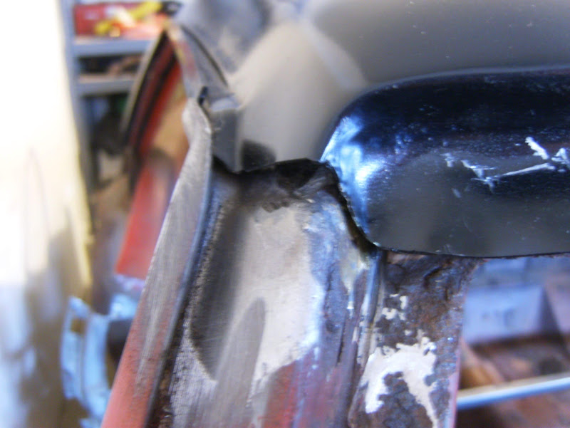

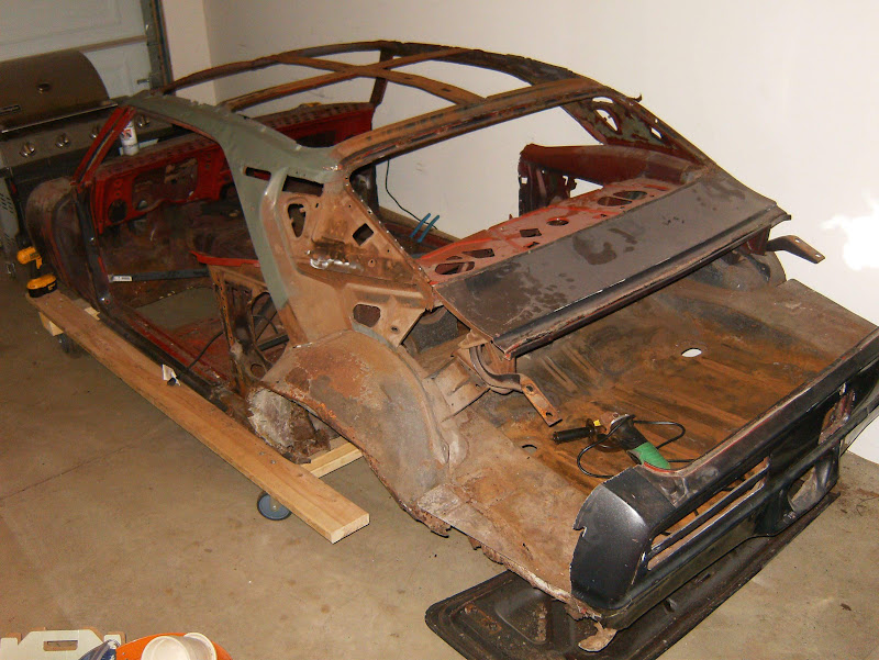

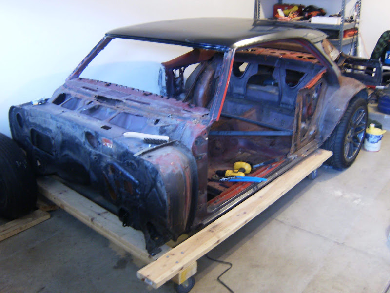

bdahlg68 06-21-2011 06:25 PM
Baby steps. Drivers side drip rail is welded in and quarter and roof test fitted.
https://lh6.googleusercontent.com/-d...0621-00022.jpg
Passenger side is next!

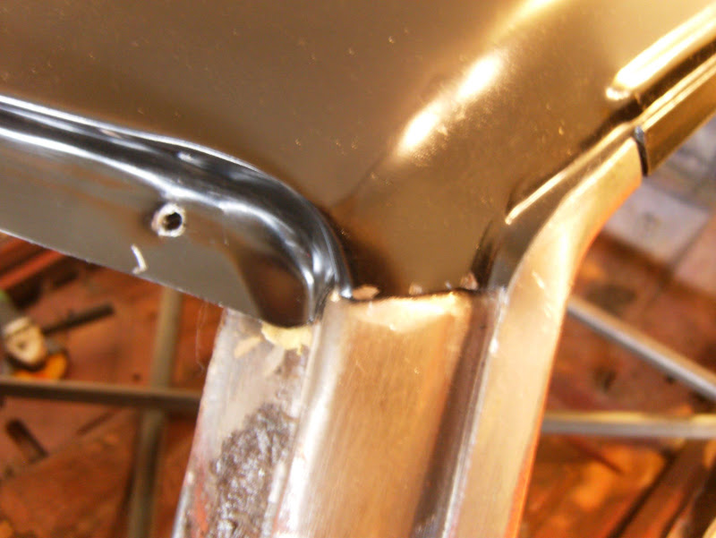

bdahlg68 08-05-2011 06:44 PM
A small update....
Passenger side drip rail is welded in. Panels were test fitted and I'm happy so far.

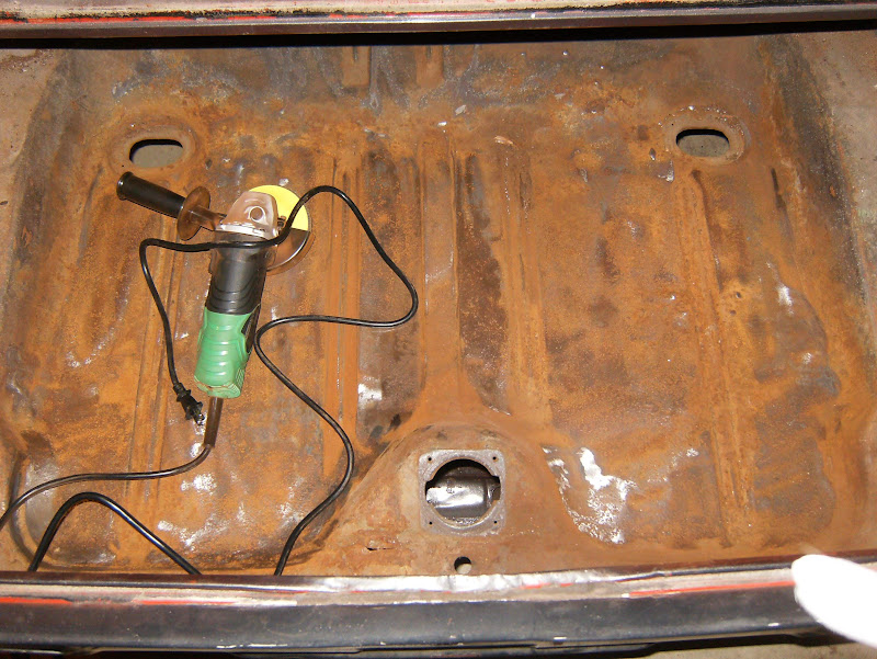

Trunk pan removal has started
DSE tubs are here
JRS front suspension is ordered and should ship next week!

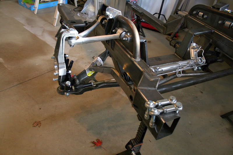

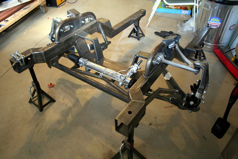

bdahlg68 10-01-2011 02:24 PM
JRS Apex C6 Front Suspension is in... took a bit longer than planned to get it here, but it's here. Still missing a few bits and pieces, but I test assembled most of it this weekend. Once I get the missing pieces, the frame will go for e-coat and final assembly will be done. Overall the quality seems pretty damn good, especially on the frame. Some long and impressive welds.
https://lh3.googleusercontent.com/-3...0/IMG_6089.JPG
https://lh5.googleusercontent.com/-z...0/IMG_6090.JPG
https://lh4.googleusercontent.com/-v...0/IMG_6093.JPG

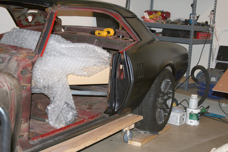

bdahlg68 11-30-2011 07:02 PM
Sorry for the über-crappy Crackberry picture, but front suspension is mock-fitted to car using Global West solid mounts. Bumper is mocked up to subframe more to get it out of the way than anything....
https://lh4.googleusercontent.com/-p...1130-00189.jpg
rear suspension direction has changed... development under way. hope to make some progress by spring...:wow:
