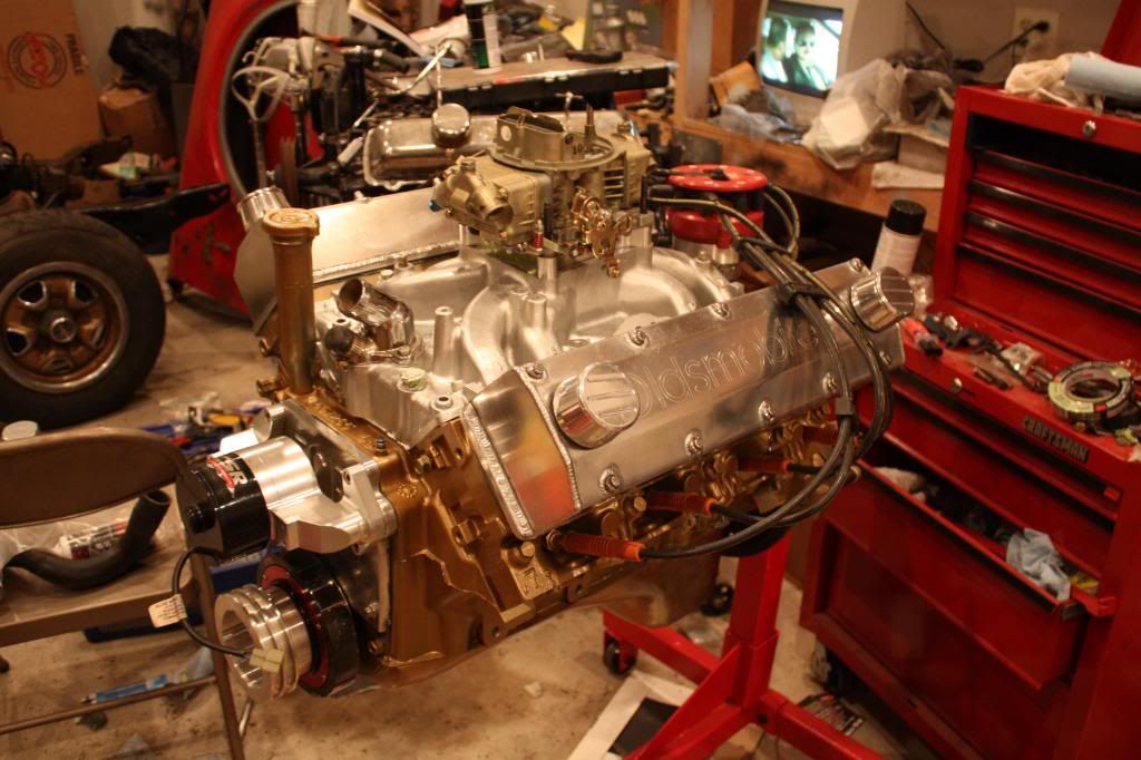

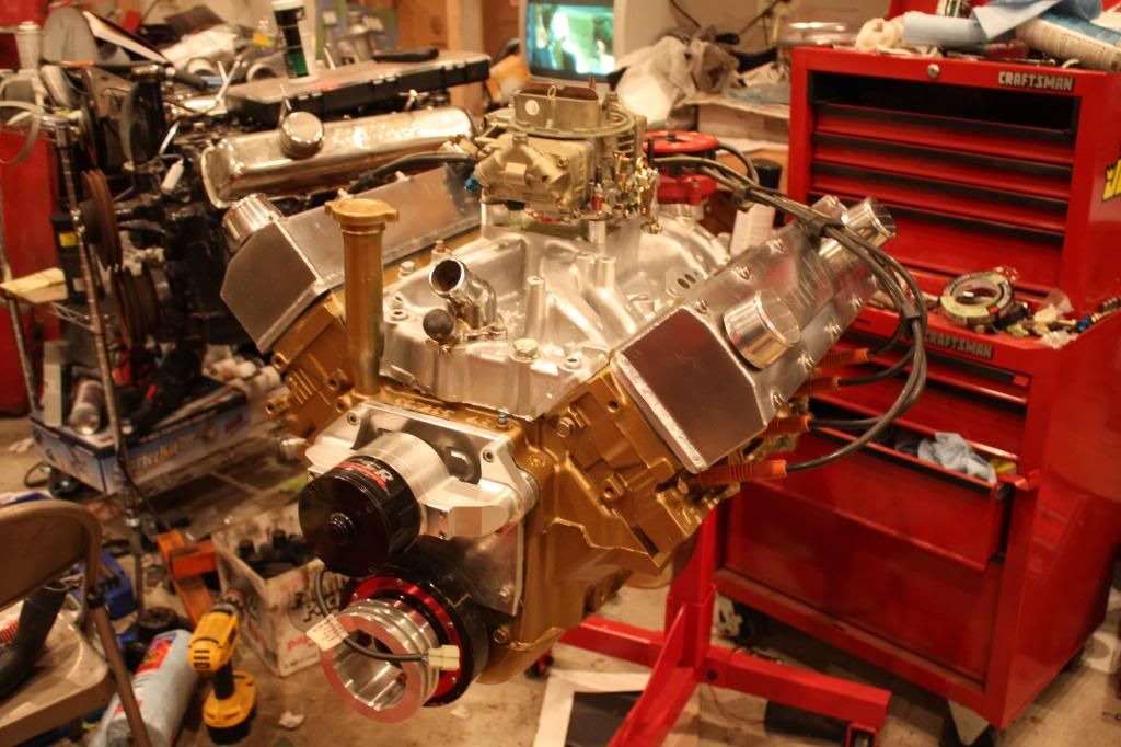

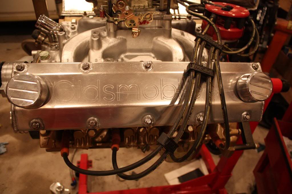

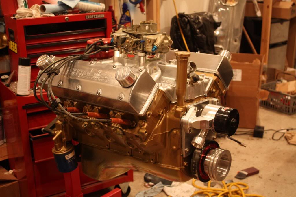

Progress has been slow because I am planning for the wedding but also trying to continue to clean out the garage. Starting to get some of the ancillary tasks done in the mean time. Also trying to figure out how to swing buying the valvetrain and oil pump/pan. All in due time it would seem.
Anyways, today is I painted the short block I scored right near my house. LY6 with fly cuts already done. I am throwing stock L92s on her (assuming USPS ever delivers them!!! :mad: :mad: :mad: ) but nevertheless, she is looking nice!
Olds W-30 Bronze! Enjoy!
http://i908.photobucket.com/albums/a...1/IMG_6150.jpg
http://i908.photobucket.com/albums/a...1/IMG_6151.jpg

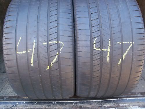

Here's a little taste:
http://i908.photobucket.com/albums/a...31/3253019.jpg
Just a little something for mock-up to shove under her. :thumbsup: 325 30-19s for $20...not bad. :cheers:

:thumbsup: I am really liking this build! Can't wait to see it completed! What were your plans for interior modifications?
Keep up the progress! :cheers:
Because I opted for the large by huge wheel/tire combo, I will need to tweak the wheelwells a bit. Since I am going to be jacking with that anyway, I have a set of '04 - '06 GTO seats (front and back) that will be recovered to more appropriately display its new mark. I can play with the positioning of the rear seat a bit and modify as necessary. I am changing it to a Lokar floor shifter to more closely mimic a 4-speed stick car with no console. I want a clean look for the floor...just rug and shift boot. I may move on to an upgraded door panels but for now, cleaned up stockers are just fine.
My goal for this whole build is that I want subtle changes that may even go unnoticed. I am even considering running adapters on the L92 heads so I can run SBC valve covers and make them look like Olds valve covers.

http://i908.photobucket.com/albums/a...1/IMG_8958.jpg
http://i908.photobucket.com/albums/a...1/IMG_8959.jpg
http://i908.photobucket.com/albums/a...1/IMG_8960.jpg
http://i908.photobucket.com/albums/a...1/IMG_8961.jpg
