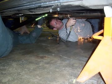

I love the jackstands and being under the car shot---I'm not alone----
Keep it going brother---love this stuff.
Doug

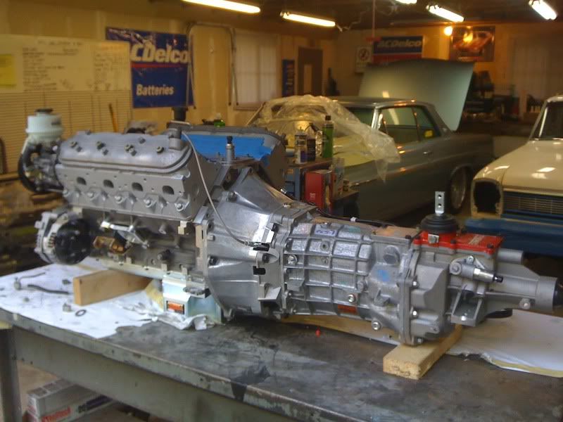

Check out the clean little removable cover Jared Hancock made for the 6 speed. There's a 67 Camaro console to go over it but it needs a little love and restoration so I'll be rocking it this summer just covered in carpet.
http://i256.photobucket.com/albums/h...s/100_1619.jpg
http://i256.photobucket.com/albums/h...s/100_1620.jpg

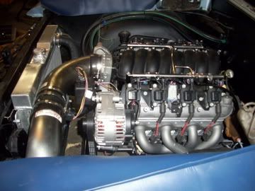

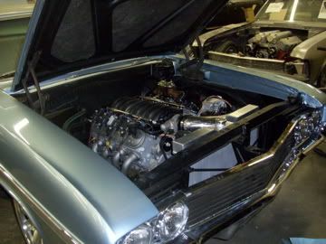

Since stance is an emphasis on this project and the LS2 makes enough HP to put the BF/G KDWs up in smoke at will, I bought Edelbrock shorty headers to keep the collectors way up off the ground and route the exhaust as clean as possible.
http://i256.photobucket.com/albums/h...s/100_1621.jpg
The only rub is that the o2 sensor bung aims right at the crossmember. Well, even an allen bolt plug stuck out too far, so I took a cut off wheel to it and gooped up the threads with exhaust adhesive that becomes cement when heated up. We'll put the actual bungs in just a couple inches downstream out of the way.
http://i256.photobucket.com/albums/h...s/100_1756.jpg

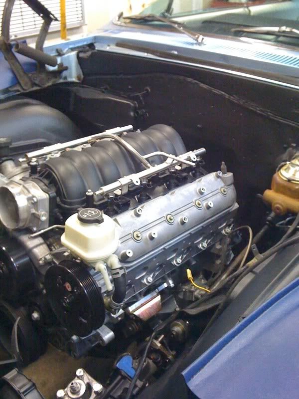

For fuel delivery, I decided to go clean and simple. This was a real relief to find because it's a bone stock factory spec galvanized tank with a built in electric pump straight from Spectra.
http://i256.photobucket.com/albums/h...s/100_1629.jpg
Speaking of clean and simple, my friend Brett has a complete Dorman DIY fuel line kit that makes perfect factory style pressure fittings and we were able to do all of the fuel lines for under $50, and an obligatory pizza.
http://i256.photobucket.com/albums/h...s/100_1627.jpg
Look at this guy just sitting in the engine compartment with a 6' long wiring harness that would make most men tremble. If not for Chris, I'd be going carbed!
http://i256.photobucket.com/albums/h...s/100_1631.jpg

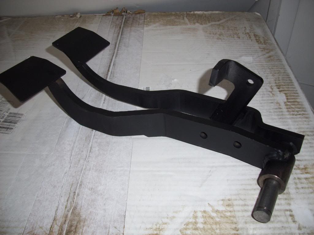

Remember when I said the Keisler kit was COMPLETE? It even came with a brake and clutch pedal that just slid right into the original brake pedal location and even had rubber o.e. style pads which were way too mundane for the interior of this car so they were used for radiator cushions! win-win!
http://i256.photobucket.com/albums/h...s/100_1555.jpg

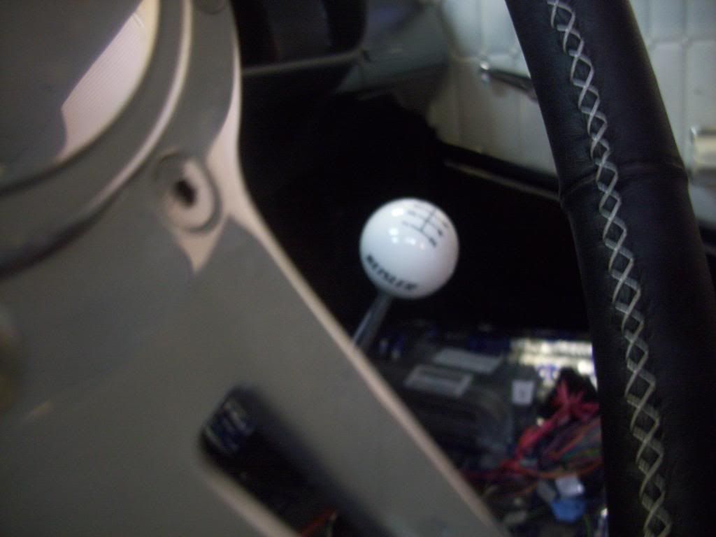

Keisler shifter ball that goes perfect with the Buick's white guts.
http://i256.photobucket.com/albums/h...s/100_1764.jpg

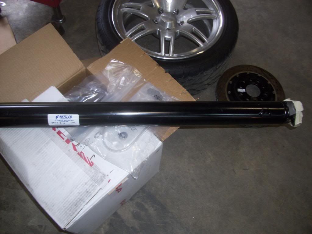

And the coolest thing is the balanced driveshaft custom made to my exact specs after installing the motor and trans and calling them with the measurements. Delivered to my door the same week!
http://i256.photobucket.com/albums/h...100_1757-1.jpg

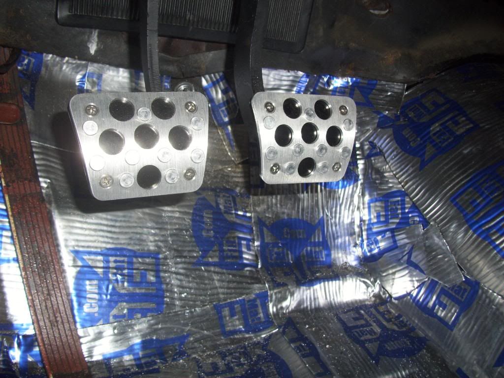

Like I said about the o.e. looking rubber pedal covers, they were just too o.e. for a relatively stock interior in a car that probably belonged to a dentist or the like so I'm specifically trying to add some attitude to the abundant style and did so with a set of MODO Innovations pedal covers.
http://i256.photobucket.com/albums/h...s/100_1761.jpg
I gave Shannon the dimensions of the Corvette DBW pedal and he picked out a cover that was just right but the pedal has a cool curve to it and the cover is flat so I put it in the press with a round dye and it curled up just right.
http://i256.photobucket.com/albums/h...s/100_1613.jpg

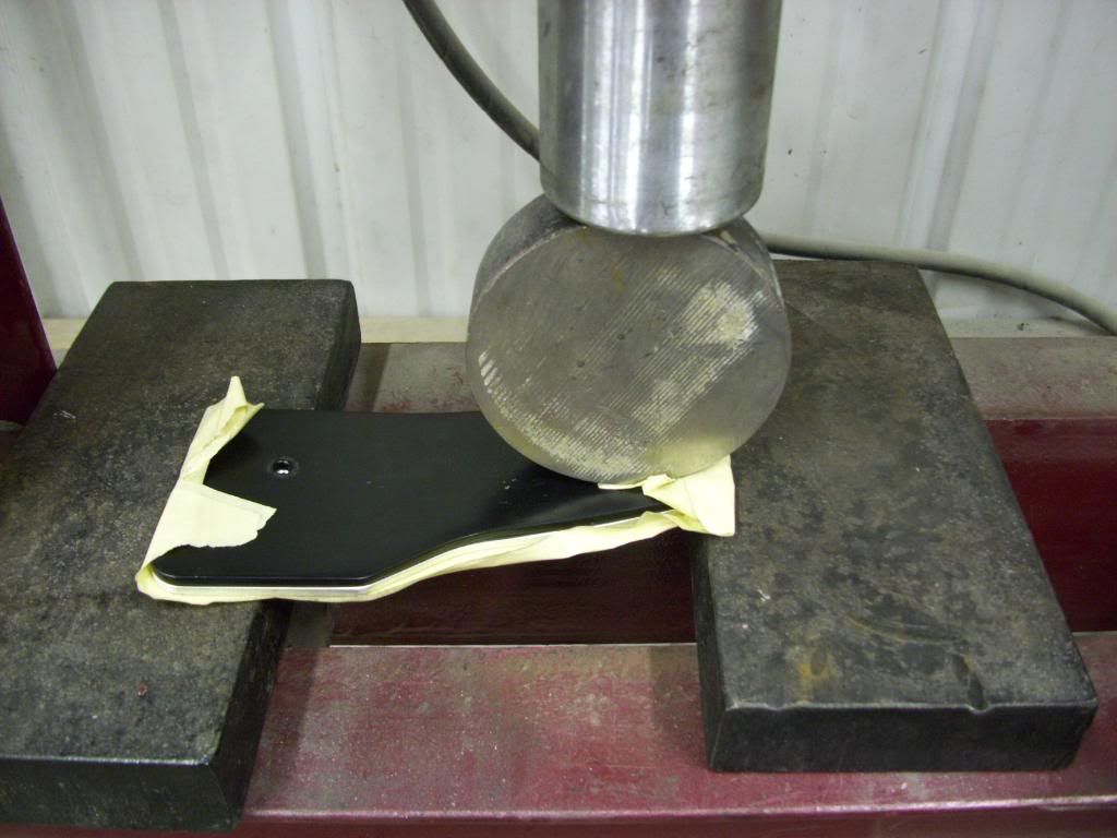

Check it out with the killer pedal bracket Jared Hancock of J-Rod and Custom made for me which is now bolted to the firewall.
http://i256.photobucket.com/albums/h...s/100_1769.jpg

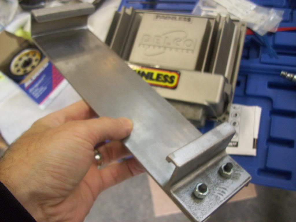

He also fabbed this slick little bracket for the giant-ass ECM
http://i256.photobucket.com/albums/h...s/100_1770.jpg

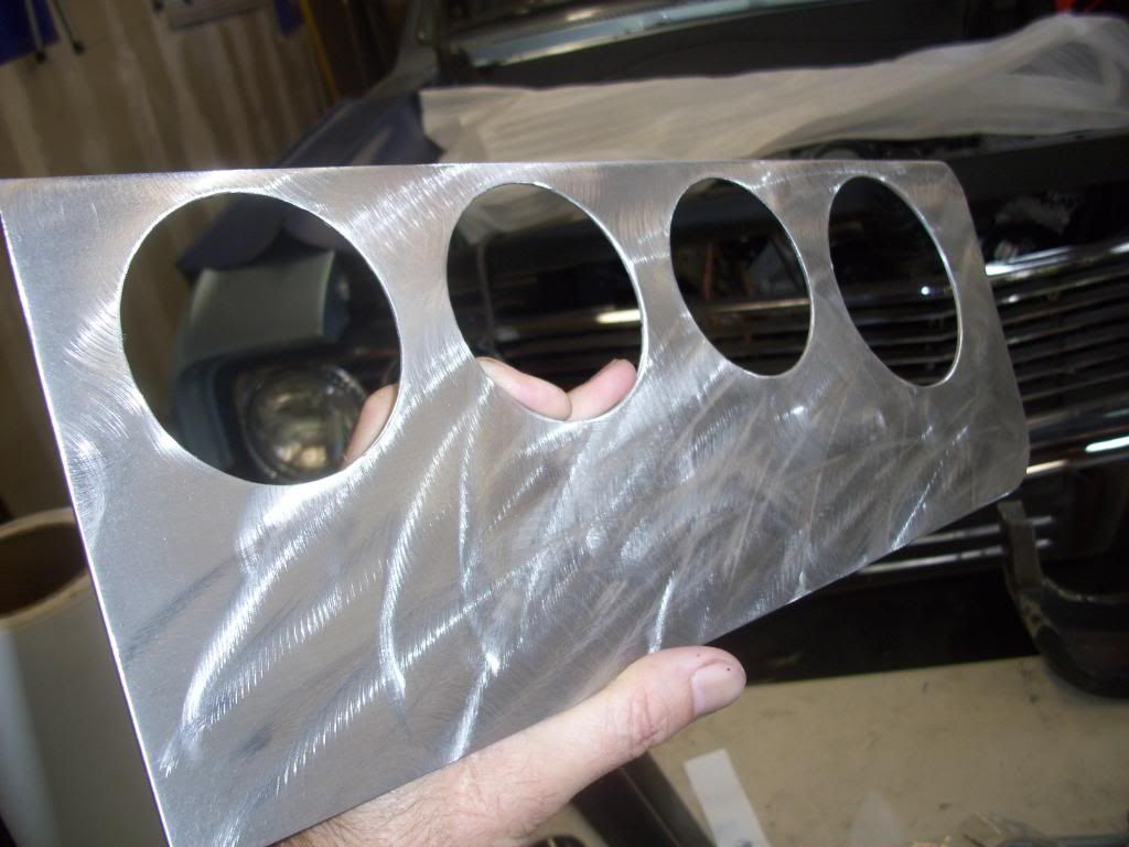

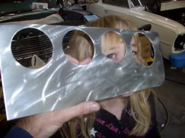

and the slick little gauge panel Justin at J-Rod and Custom made that I personalized with a grinder to help add some attitude.
http://i256.photobucket.com/albums/h...s/100_1786.jpg

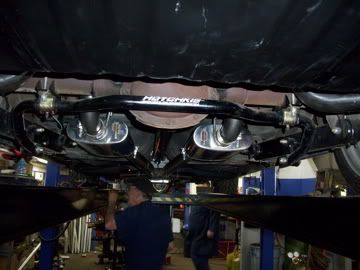

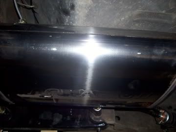

Check out the complete all-stainless Magnaflow system completely pre-bent for the car from collectors to tailpipes getting installed by our friend Mike Sader the day before the show. This guy is a street machine Obi-Wan to me and Chris and as young guys and was the only guy we knew who had built himself a car and a truck that were both on magazine
covers in the 80s and even when we were snot-nosed teenagers, he always made time to help us, give advice and suggestions and even took Chris to a street machine show in CA with the first car Chris built 20 years ago in Mike's still bitchin' slammed crew cab dually.
http://i256.photobucket.com/albums/h...s/100_1792.jpg
These are almost too pretty to put under the car and let them get all funked up but you don't have to worry about them rotting out like the old days.
http://i256.photobucket.com/albums/h...s/100_1794.jpg
