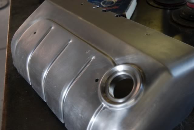

Gas tank built from scratch with all of the evap stuff from the original tank. We decided to keep everything GM put in the car, that way it's as close to "stock" as possible. We even re-used all of the plastic lines by heating them slightly, bending them and letting them rest in their new form. If you have a lot of patients, it isn't that difficult to do.
http://i55.photobucket.com/albums/g1...alismall73.jpg
http://i55.photobucket.com/albums/g1...alismall74.jpg
http://i55.photobucket.com/albums/g1...alismall75.jpg

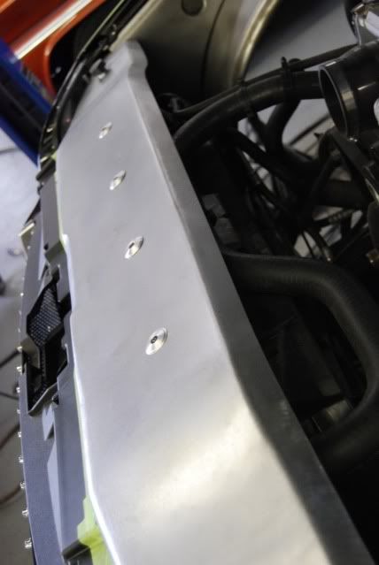

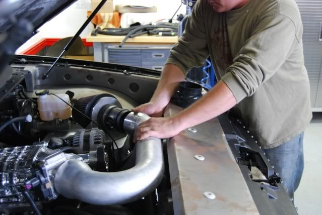

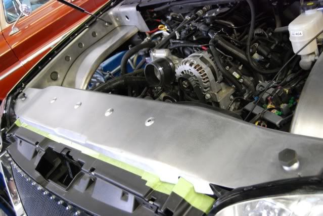

We fabricated a piece to go across the front to cover up all the ugly in the front of these things.
http://i55.photobucket.com/albums/g1.../DSC_00103.jpg
http://i55.photobucket.com/albums/g1.../DSC_00084.jpg

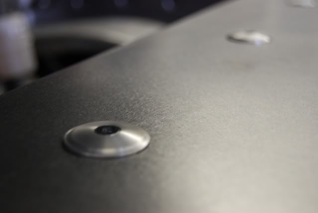

Machined our own hardware to hold it down. We wanted something really streamline as there isn't much hood clearance in the area.
http://i55.photobucket.com/albums/g1.../DSC_00064.jpg

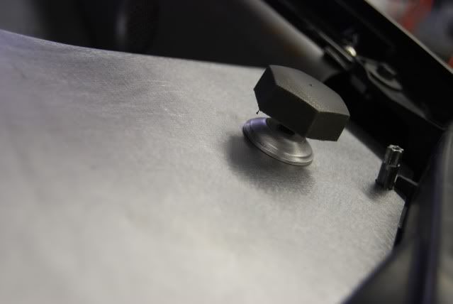

Made matching pieces for the hood adjusters
http://i55.photobucket.com/albums/g1.../DSC_00043.jpg

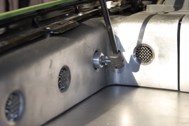

pacificustoms 10-21-2010 04:04 PM
Thanks for the compliments guys! We don't usually work on these newer vehicles, but we're doing what we can to take it over-the-top.

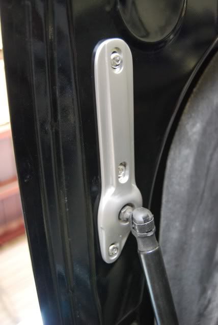

We machined these mounts for some hood struts so you don't have to carry a hood prop around with you. The hood from the factory had two springs and one shock holding it up, so we're using two of the stock shocks and it worked out great!
http://i55.photobucket.com/albums/g1.../DSC_00032.jpg
We incorporated the mount on the inner fender to one of the dimpled holes we have running the perimeter of the engine compartment.
http://i55.photobucket.com/albums/g1.../DSC_00102.jpg
You can also see the small mesh inserts we made. We machined dies to stamp the stainless mesh to match all of the dimple dies we have.

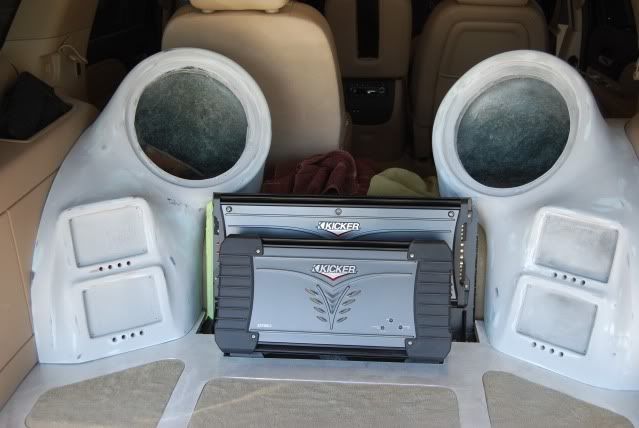

I think we're going to leave the bumper mostly stock. We are going to get rid of the portion that housed the trailer hitch and do have a little something planned for it, but it will still have the bumper.
As far as the inside, these boxes wrap all the way around the portion that was trimmed out. The actually run all the way down the front of the wheel well right up to the door opening. We also made the aluminum floor piece in the back with the flush mount carpet pieces. The speaker boxes have been color matched and are currently having some "artwork" applied to them (not airbrushing).
http://i55.photobucket.com/albums/g1.../DSC_00014.jpg

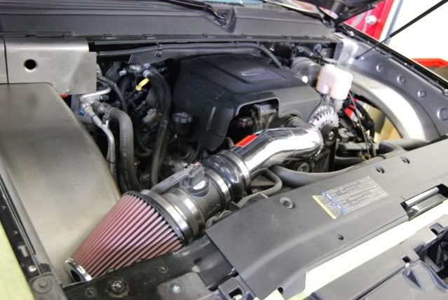

pacificustoms 10-25-2010 08:45 AM

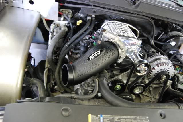

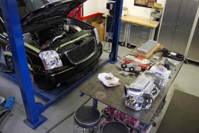

This was a fun part of the project. Getting to add looks and a punch of power is never a bad thing!
http://i55.photobucket.com/albums/g1...s/DSC_0004.jpg
This is what we started with (we put some of the stock pieces back on for the picture)
http://i55.photobucket.com/albums/g1...s/DSC_0012.jpg
And where we ended.
http://i55.photobucket.com/albums/g1...s/DSC_0370.jpg
You can check out the full installation in an upcoming issue of Street Trucks Magazine. We're also going to fabricate our own intake tube to put the filter on the drivers side.

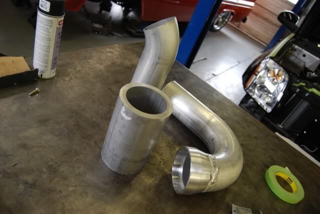

Working on a new intake tube. We wanted to reduce the couplers in it to give it a clean look, so we machined a piece that fits over the throttle body and we're going to use an o-ring seal and a few set screws to hold it tight. There's also a bracket that bolts to the front of the accessory drive to hold it firmly in place as well.
http://i55.photobucket.com/albums/g1...s/DSC_0020.jpg
http://i55.photobucket.com/albums/g1...DSC_0014-1.jpg
We also machined an end for the opposite side that the rubber coupler slides over, but the aluminum is flush with the outside of the rubber and the clamp. Kind of hard to see in this picture.
http://i55.photobucket.com/albums/g1...DSC_0041-1.jpg

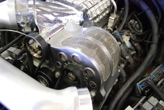

pacificustoms 10-28-2010 10:30 AM

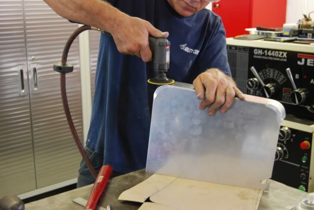

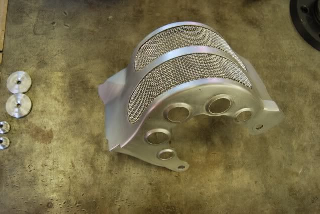

Built this do-dad to cover up the alternator. We were just going to have it polished or chromed and put it back on, but we wanted something that might have a more factory look to it and be different then everyone else.
http://i55.photobucket.com/albums/g1...s/DSC_0162.jpg
Here it is in place:
http://i55.photobucket.com/albums/g1...s/DSC_0166.jpg

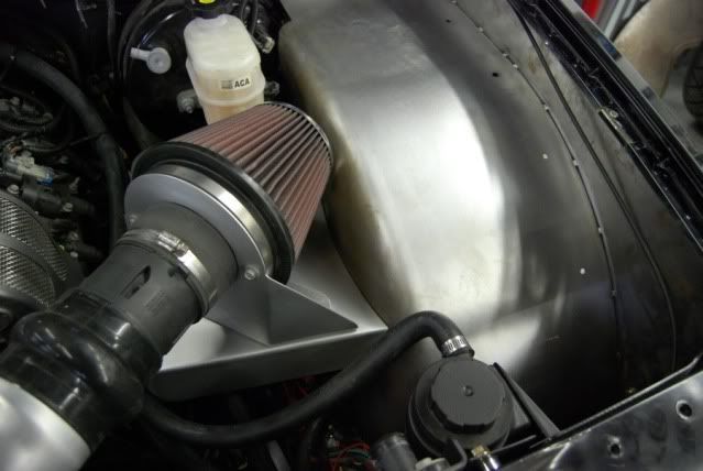

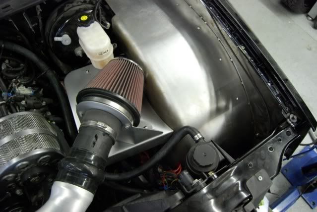

And we also finished up the drivers side inner fender and fuse box cover and air filter mount.
http://i55.photobucket.com/albums/g1..._0174small.jpg
http://i55.photobucket.com/albums/g1..._0173small.jpg

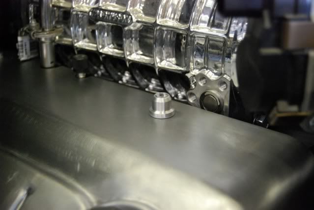

We also machined our own hardware to hold it on.
http://i55.photobucket.com/albums/g1..._0140small.jpg
http://i55.photobucket.com/albums/g1..._0137small.jpg

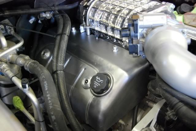

pacificustoms 11-08-2010 04:56 PM

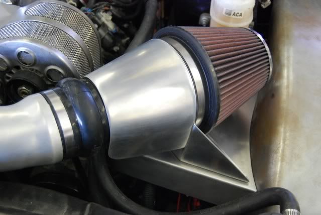

The air flow meter stood out quite a bit and needed something, so we built this. We still had to make it easy to remove as you have to remove the filter and air flow meter to access the fuse panel, so we have to where you remove one clamp and two screws and your in! Not quite a easy as stock but I guess that's the sacrifice you make.
http://i55.photobucket.com/albums/g1...s/DSC_0308.jpg

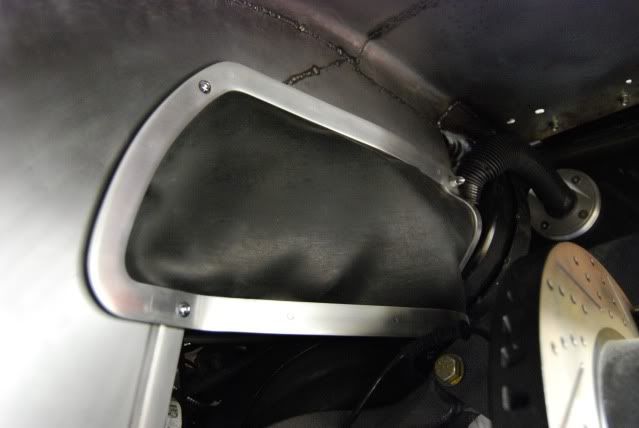

We had some space restraints under the fenderwell between the inner fender, the wheel/tire and the suspension. We wanted to make sure the fuse box was sealed good from moisture and debris so we built an aluminum trim ring that holds a thin sheet of rubber to seal things up pretty well and follow all of the weird curves going on where the fuse box is.
http://i55.photobucket.com/albums/g1...s/DSC_0275.jpg

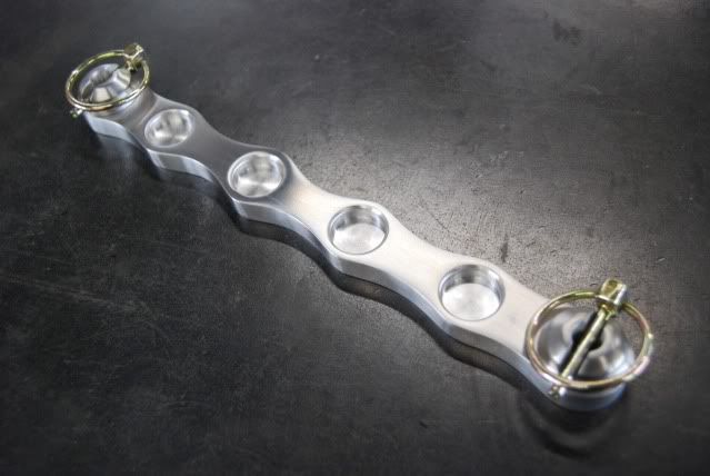

pacificustoms 11-11-2010 04:30 PM
Machined some battery mounts.
http://i55.photobucket.com/albums/g1...s/DSC_0113.jpg

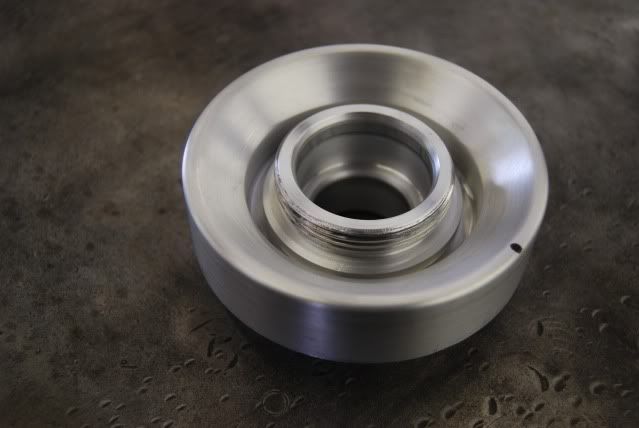

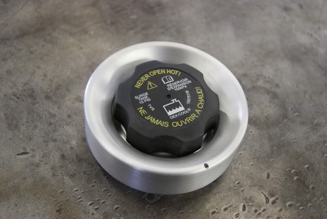

Been happily machining more pieces around here. We machined up this bung to use to make a coolant bottle using the stock cap.
http://i55.photobucket.com/albums/g1...s/DSC_0001.jpg
http://i55.photobucket.com/albums/g1...DSC_0004-1.jpg

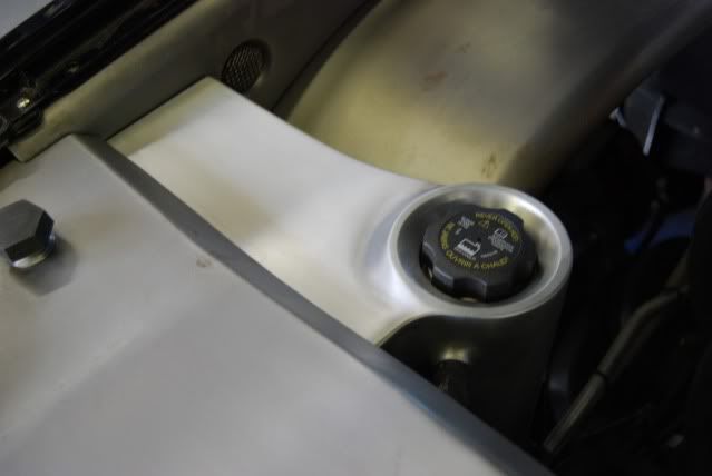

Built a coolant bottle.
http://i55.photobucket.com/albums/g1...SC_00012-1.jpg
http://i55.photobucket.com/albums/g1...s/DSC_0007.jpg
