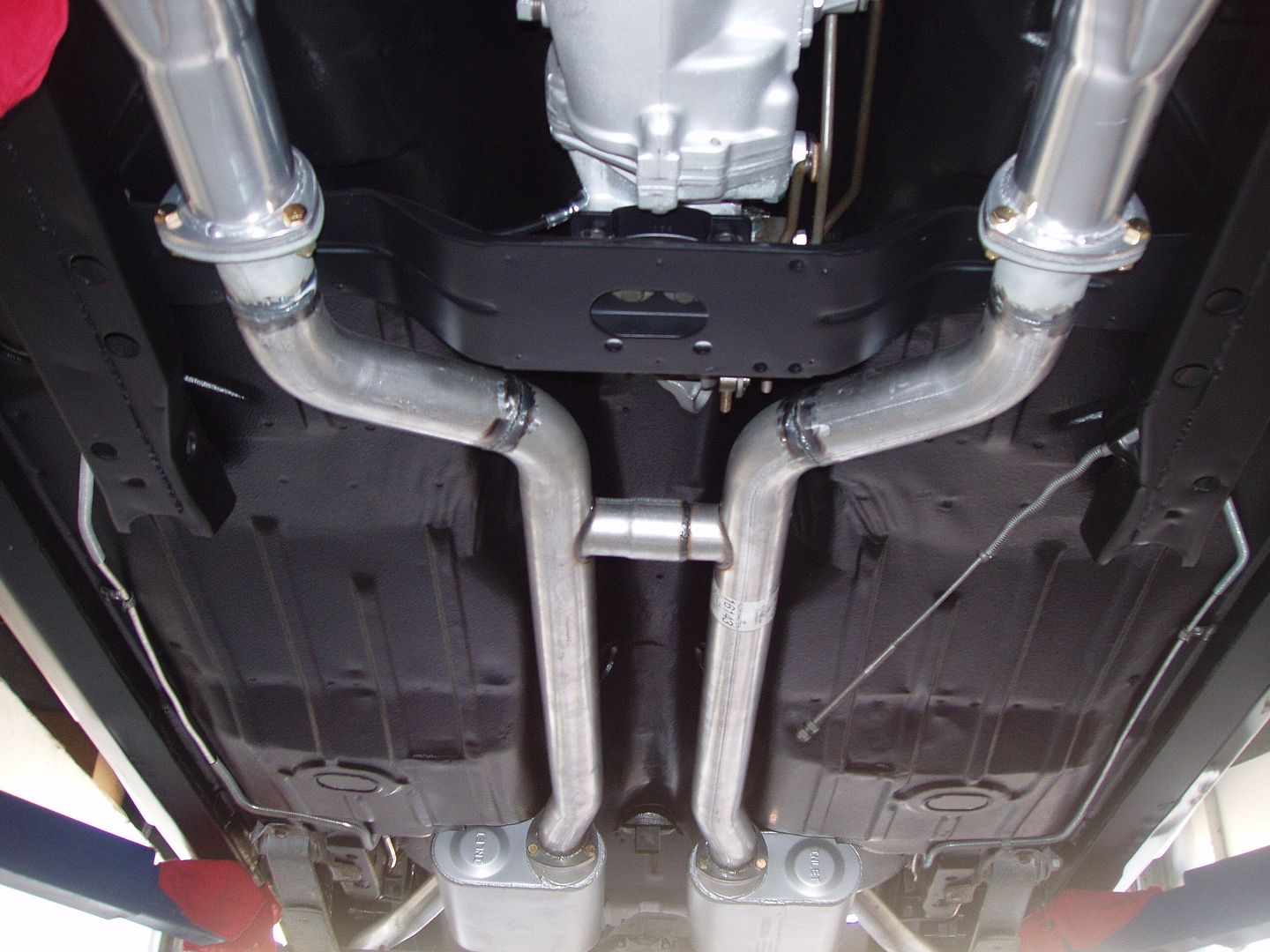

Here is a pic of a stock floor with no sub-connectors.. one of the weakness of a first gen Camaro is that the center of the floor has no bracing to really help body flex.. They corrected this problem on the 2nd gens..

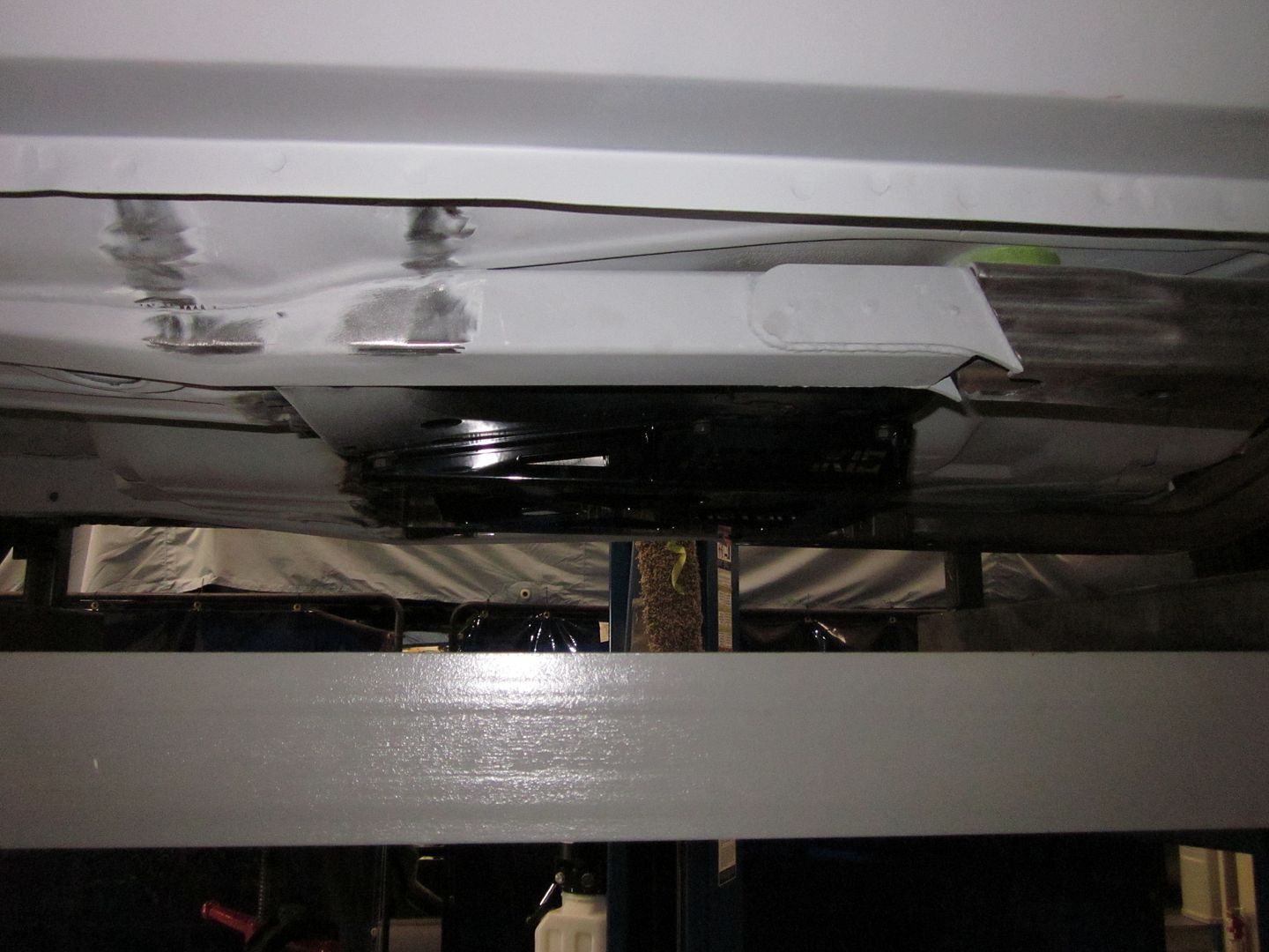

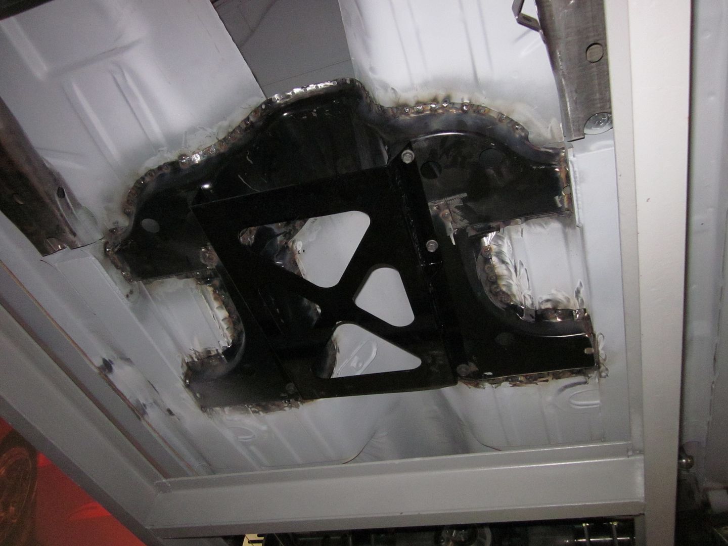

Here is something that I am doing to help add stiffness to the center of the car.. This 68 already had DSE sub-frame connectors on it when it arrived @ the shop... so I added a convertible OE factory center stiffening brace that goes from rocker to rocker tied in to the sub-frame connector & a Hotckis bolt on brace.. We still need to finish adding the pcs to the sub-frame connector to rocker.. but I think you guys get the idea.. when done it should give it a triangulated effect on the center of the floor.. I remember this feature on convertibles from my days of restoring first gen Camaros..

fleet 08-11-2010 09:19 AM
This is what you used Cris?
http://www.hotchkis.net/6769_camarof...e_support.html
Cris@JCG 08-11-2010 09:26 AM
Correct.. I bought the reproduction bracing from National parts Depot.. it is stamped out of 14 gage.. i will help alot on adding strength to center floor section.. IMO!!

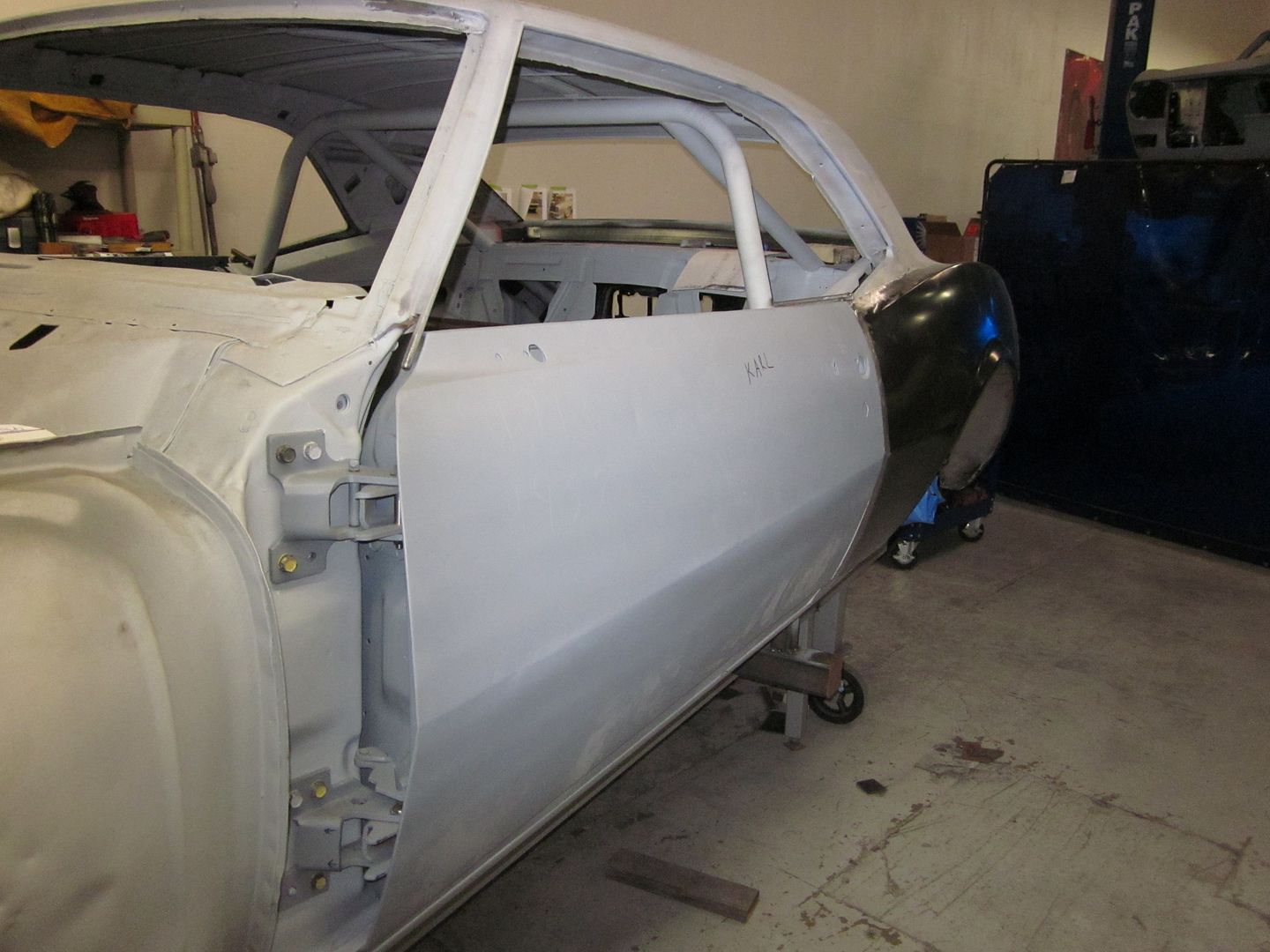

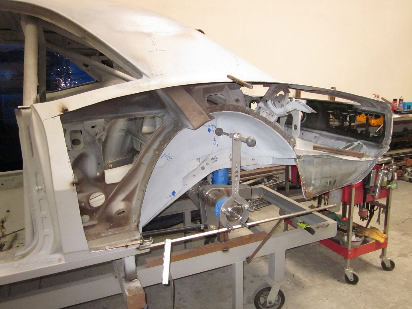

Cris@JCG 08-17-2010 12:21 PM

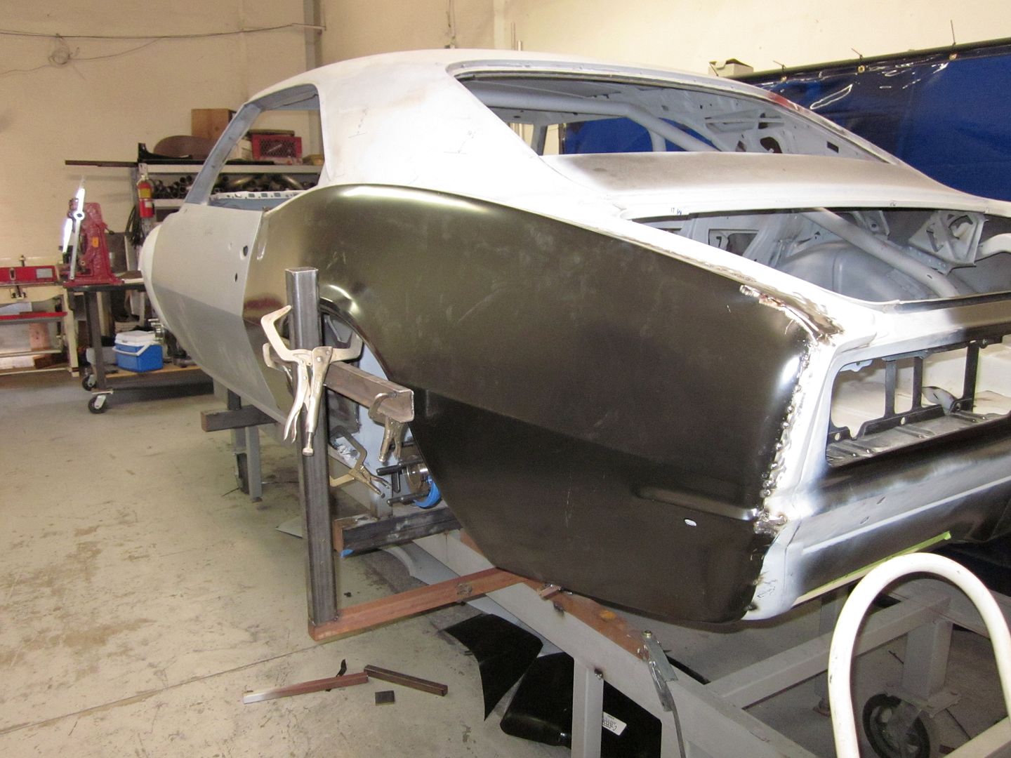

Started the qtr Stretch!
Taking a different approach to the rear qtr stretch..
http://i1015.photobucket.com/albums/...n/IMG_0320.jpg

Cris@JCG 09-06-2010 07:48 AM

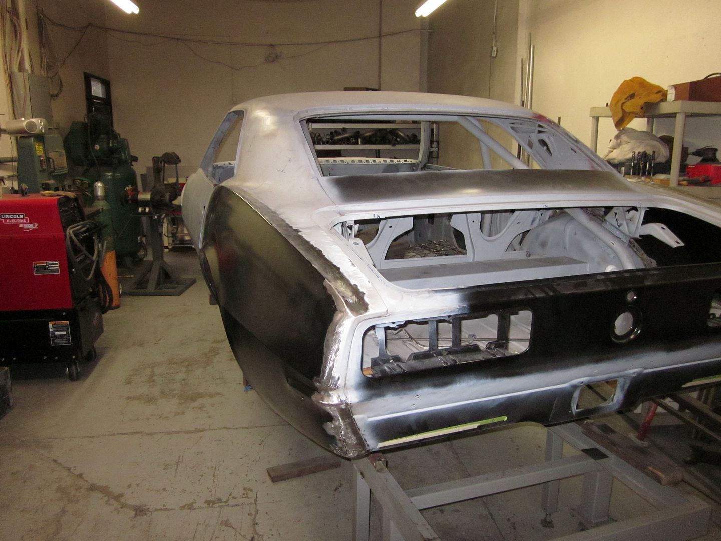

rear qtr stretch update
Here is the latest update on the rear qtrs... We are finishing up all the small details.. We will be starting the front fenders this week..
http://i1015.photobucket.com/albums/...n/IMG_0328.jpg
http://i1015.photobucket.com/albums/...n/IMG_0379.jpg
http://i1015.photobucket.com/albums/...n/IMG_0380.jpg
Roadbuster 09-06-2010 07:55 AM
Looking good! That quarter looks factory. It will cause a lot of head scratching as people will look at it and say its different but how? And how did you fit those tires?

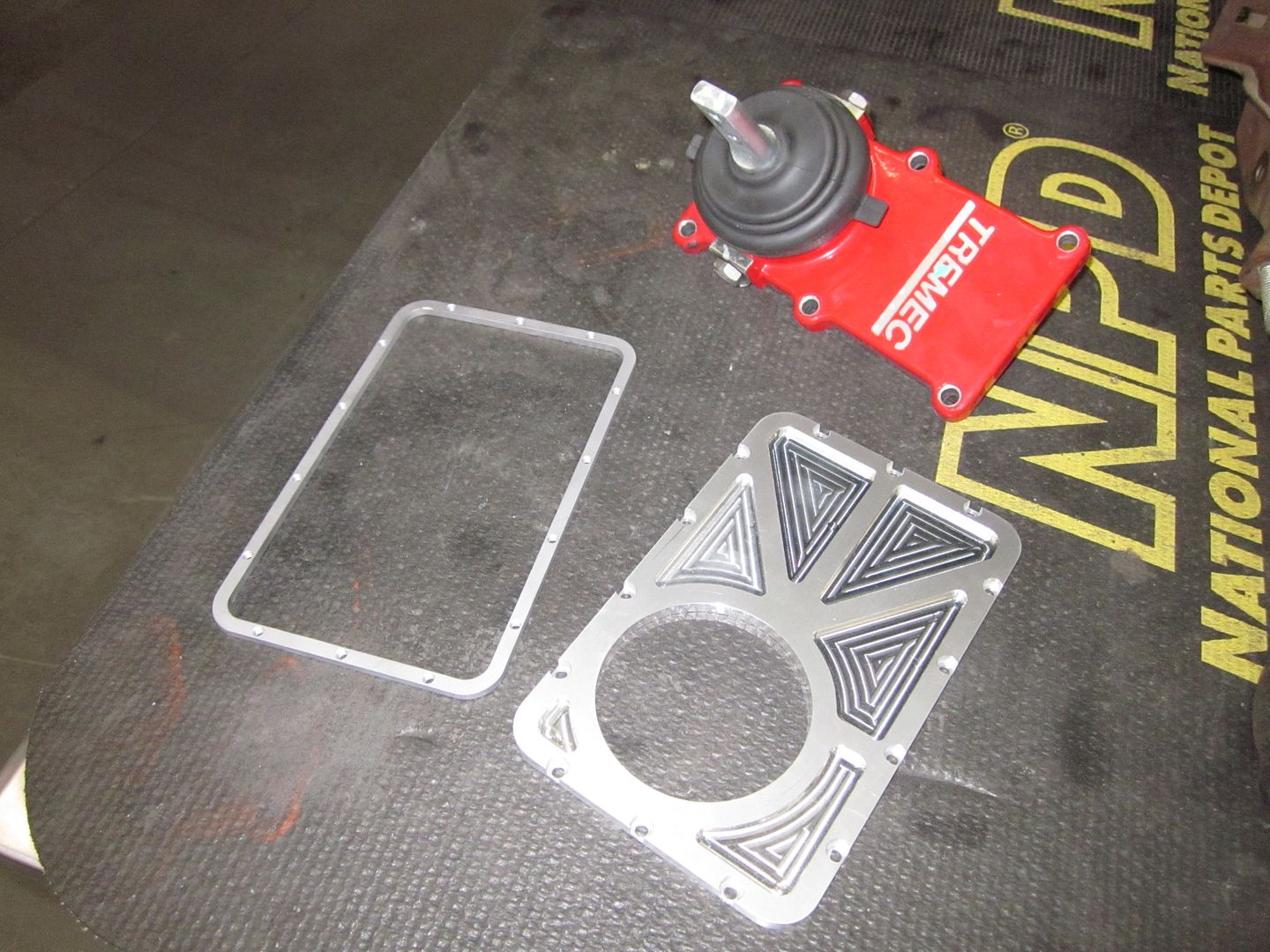

Shifter tunnel plates
Here are some plates that we machined last week for the shifter.. The transmission tunnel is almost done.. but need these pcs to complete it..
The thin steel ring will be welded to the tunnel & the aluminum plate will give it access thru the top to remove the shifter when tranny needs to removed...

Cris, Was the fender strech this way vs. the way it was on TrackRat a better way to go? It almost seems ashame to cut up and toss out good factory qtrs :_paranoid .
Travis
Cris@JCG 09-08-2010 07:25 AM
This stretch is totally different from what we did to Track Rat... One of the things I did not like from when we started doing this body modifcation was that it was rasing the body line & the wheel well opening... The way it is done on this car it less noticable that the qtr was widen up..
This car needed both qtrs replaced.. plus one of the reason I got the project was because the customer wanted all four corners blown out..
Travis

Cris@JCG 09-13-2010 10:50 AM
Front Fenders!
The front fender stetch is coming along pretty good.. We are holding lines & gaining lots of room... Those are 285-35-19 in the front .. Gonna try to run 295-35-18 :D :D :D
http://i1015.photobucket.com/albums/...n/IMG_0418.jpg
http://i1015.photobucket.com/albums/...n/IMG_0421.jpg

GM Muscle 09-16-2010 04:06 PM
so who is karl... he seems to be autographing all your body panels..:rolleyes:
Hdesign 09-16-2010 04:22 PM
Originally Posted by Flash68 (Post 305856)
:lol: :lol: HAHA -- Ben, you're FIRED!!!!!!!!!! :lol: :lol:
Next time I will say "exquisite". Is that better? :D
Akshilly, 'round heeyah we say Yohr Fi-yid! I only understand Mass-hole speak. Get it straight will ya!:D
Cris@JCG 09-16-2010 06:59 PM
A buddy of mine came in the shop & wanted all the parts & tagged them with his name ..
