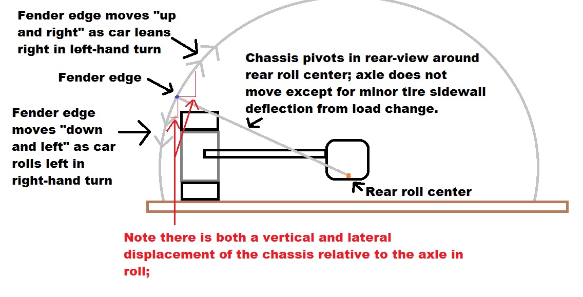

GregWeld 09-15-2013 07:15 AM
First thing I'd do is go back and watch the video of your test and tune ---- and fix the side to side movement of the rear axle! OMG! I've never seen that much movement --- probably well over an inch side to side!
If you didn't have open wheel wells -- your tires and fender would be a mess.

j-rho 09-15-2013 08:31 AM
Greg, not sure that's the case. I think it's an artifact of how the car rolls about the watts center pivot. In the previous blog post I included a video with the camera under the gas tank, showing the rear axle where the watts connects on the driver side. It is fairly well controlled laterally. Torque reaction, not so much... :-)

At present it only has leaf springs for fore/aft and torque reaction control. They are composite of decent rate (250lbs.) for the rear corner sprung weights (<500lbs.), but aren't enough to keep things under good control.
Greg, the motion you are talking about is axle lateral movement through pure vertical travel - the watts link eliminates this movement. As the car rolls about its rear roll center, on the outside rear corner, the outer fender lip tends to move "away" from the tire (since it is well above the roll center height), and the inboard top of the tire gets closer to the inner fenderwell.

j-rho 09-15-2013 09:27 PM
Slapped this together in mspaint, perhaps it will help visualize the chassis/axle interactions a bit-
http://www.rhoadescamaro.com/build/w...ll_diagram.jpg
