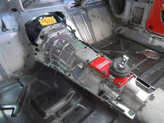

The T56 Magnum has been installed to begin the tunnel work. Well... there used to be a tunnel there :D

I'm glad I sprung for the nicer Speedtech crossmember. A really nice piece and fits nicely.

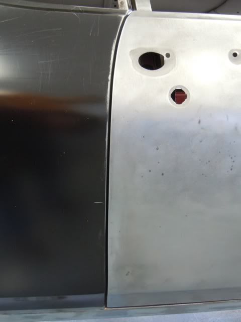

Got a few update pics to share. Gaps are all complete now and looking good. DSE hydraulic clutch bracket installed. G-link bracketry has all been welded in.
I believe the quarter/sail seams are getting leaded soon and the tunnel fab completed and then she's coming home to 'Bama :yes: . Then me and the D/A are going to get used to each other for a bit so I can get some primer on it HA!
BTW, those trunk and floor pan welds aren't ground because I specifically asked Dan to not worry about wasting time grinding those pan welds. I can do that and save some money. Didn't want you guys to think that was normal Holohan work. I'm guessing that's obvious though from the other pics :cool:

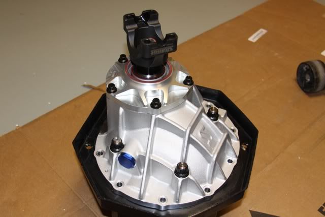

Spec'd out and ordered up a set of Strange 35 spline axles with the Timken Set20 tapered bearings. Got the seals and bearings pressed on no problem. The wedding rings... no dice with my "little" 20 ton H-frame press. Just doesn't have the nuts I guess. I'll find a shop to do it. In hindsight I should've just ordered up the axles with the housing and been done with it. I just wasn't sure then on which diff I was running.
Went with the small 11" 4 piston Wilwood rear brake kit with the integral parking brake. Matches the fronts I had but nothing "pro-touring" cool with just plain rotors. I'm running manual brakes so I went with their aluminum master cylinder with 7/8" bore. Picked this stuff up from Justin@Scott's Hot Rods who was great. Stuff shipped right out.

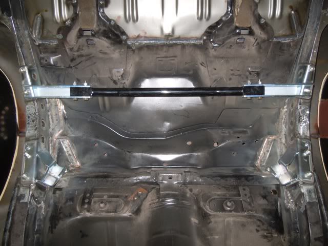

I got a few hours over the holidays to unbox all the G-link parts and get it mocked up. It went pretty smooth and easy since the bracketry was already installed. The kit ships with 12" 200lb springs which I don't think are gonna work. They would require 2-3" of preload and even then I'm afraid it will ride too high. I'm gonna go with a 10" Hyperco I think. It looks like with the shocks within the manufacturer stated 13-14" minimum length at ride height and utilizing all the G-Link adjustments to lower the car, a 15" wheel lip is even with the fender lip. That's a pretty good height I think. When I get the 18" wheels they'll tuck some and that's what I'm after.
So the bad news... I was hoping to defer the cost of the center section for a while for cost reasons. Well after getting the rear mocked up I'm a little afraid the center might come too close to the rear tunnel. I'd rather know this now than later so I guess that'll be my next purchase. When that happened I stopped on the rear mockup since I'll just have to take it all back apart once the center arrives.
The other maybe bad news... exhaust clearance. I've always wanted 3" out the back. Thinking that just ain't gonna happen with the G-Link crossmember without going up and over requiring trunk pan mods. We'll see.

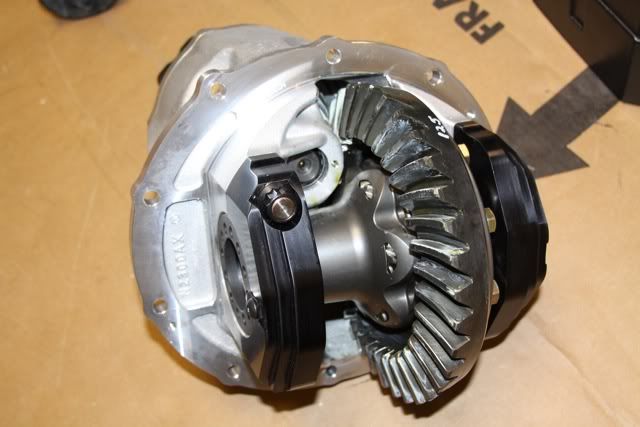

-Changed my mind on the WaveTrac and went with the new Strange 35 spline S-Trac and their new aluminum thru-bolted Pro-HD gear case instead. Nice piece and worth the backorder delays. Chose the 3.89 gear set. Due to the difference in spline engagement depth in the diff I did have to swap one of my axles for a different length. Something to keep in mind. Lesson learned: just save yourself some headache and order a complete rear all at once. I ordered everything separately at different times and it was a little stressful with all the measuring, etc but it turned out good.

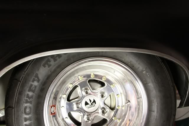

-Mounted up the 325/50-15 MT Drag Radials on 15"X10" wheels and they fit good. Tight fit but for occasional drag strip outing they'll be fine. No rubbing except the passenger's side very lightly rubs against the outer wheelhouse at full compression. Rear could stand to be 1/8" narrower each side but overall it's about as good as I could hope for.

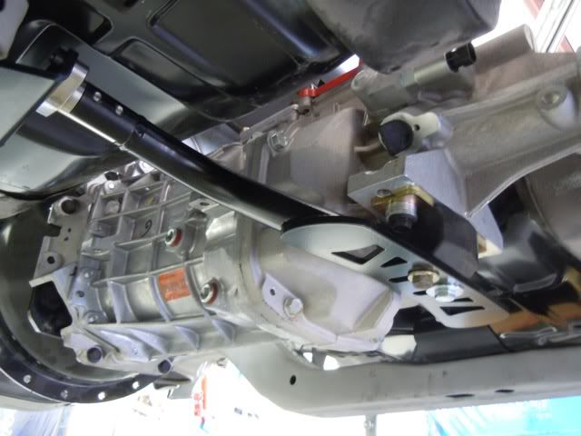

-I've now got the trans and a mockup block installed. I need to modify the frame mount on the passengers side so the bolt will go through. This has been a huge pita. Should take just a few minutes to drop the engine in but not my luck. I'm in it for a few hours already. I guess all the repop/aftermarket mounts are to blame. I also had to open up the shifter opening from where the tunnel was replaced at the fab shop. The shifters are tilted to the driver a little but the hole that was fab'ed in was centered.

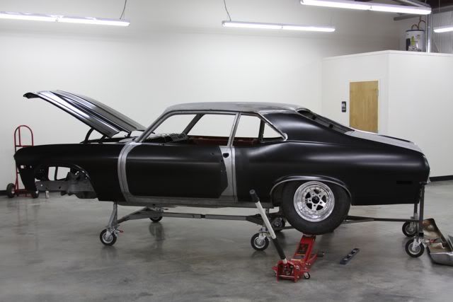

BBC71Nova 05-06-2012 06:58 PM
These wheels I had are only 15". This is at ride height with the shocks at the minimum acceptable ride height of 13.5" eye to eye. This is using all adjust-ability available in the G-link setup. That is, tilted all the way in on the shock crossmember and the lower mounts in the lowest holes. This is a little lower than some I've seen so I assume it is due to the Fab-9 shock mounts having holes lower maybe.
I'm planning to run 18" wheels in the back so I should get a little tuck at ride height I think.
At ride height. Roughly 1" from rim lip to wheel lip.

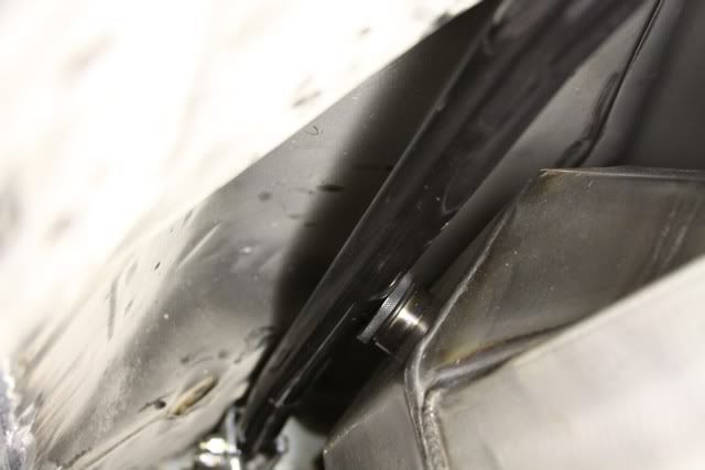

Here is a shot of the fill tube on the Fab-9 hitting the crossmember. It is just hitting at full compression but enough that it must be addressed. Probably end up bending another crossmember that goes up a little closer to the floor or change the route it takes. I spoke to Chassisworks about it and they are aware of it but it seems to only be an issue with Fab-9 setups.
Notice the non-existent exhaust clearance. Might have to talk to the guys down the street at Goolsby Customs about raising the trunk floor or something :unibrow: .

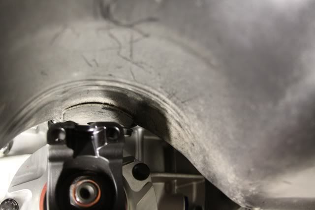

BBC71Nova 05-06-2012 07:14 PM
Here are some pics showing clearance in some other areas at full compression.

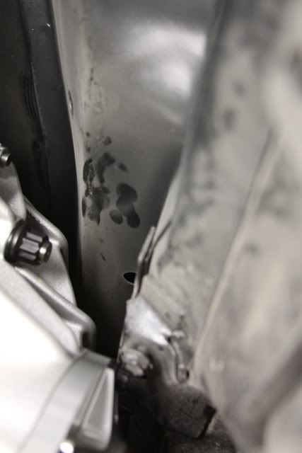

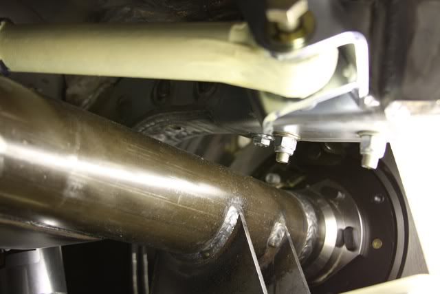

There is over 1" of clearance at the frame rail.
http://i33.photobucket.com/albums/d6...eClearance.jpg
This picture is a little misleading but there is a little less than 1" of clearance at the tunnel where the pinion is. The G-Link is basically allowing as much of a drop as possible really unless you want to mod the tunnel.
http://i33.photobucket.com/albums/d6...lClearance.jpg
Here is a shot showing the clearance between the gear case and the body/floor structure above it. When I put in a little pinion angle and I remove the old pinion snubber mount there'll be enough clearance. However, again, IMHO this is as low as you could go without committing to modifying more sheetmetal for clearance. At least with a 9" setup like this. I suppose this case is a little beefier so maybe that is taking up a lot of the space.
BBC71Nova 05-06-2012 07:34 PM
Here are a couple pics of the center section. Car part pron :)
http://i33.photobucket.com/albums/d6.../gearCase3.jpg
http://i33.photobucket.com/albums/d6.../gearCase2.jpg
