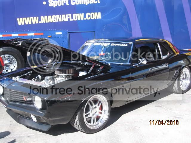

Originally Posted by lhkustoms (Post 340185)
Ron The Marquez bumper is awesome. It was on the black 69 I painted last year and it fit perfectly and looks killer. And we need more pics this thread is blowing up bud. Tell those guys to get crackin! :lol:
I hear you Luke. I studied that car @ SEMA. Here's how nice you guys made that bumper fit :thumbsup:
http://i885.photobucket.com/albums/a...d/IMG_1377.jpg
http://i885.photobucket.com/albums/a...d/IMG_1382.jpg

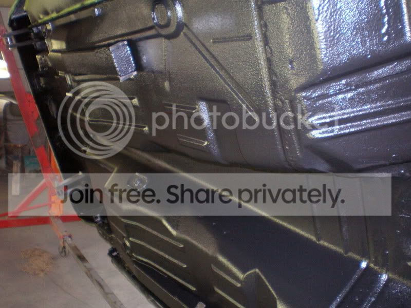

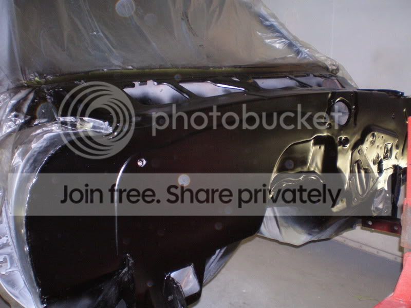

Originally Posted by Ron in SoCal (Post 339955)
Months later I found a 69 in Denver that had some pretty good parts to go along with it. It was a painted roller and very straight so after going out there and inspecting it I had it shipped to the body shop.
http://i885.photobucket.com/albums/a...d/P1250004.jpg
http://i885.photobucket.com/albums/a...d/P1250003.jpg
http://i885.photobucket.com/albums/a...d/P1250002.jpg
The plan was to fab in the suspension/subframe connectors/mini-tubs, cut and buff and get her back home. Well during transport the truck had an airbag failure and small fire (!) and my car ended up on top of a mid-year ‘vette. Also in the trailer was a Lambo, a beautifully show restored Caddy, along w the ‘vette. Of course, I had the most damage! My beautifully gapped factory sheetmetal/NOS black painted car was now a whole new ball game. Every single body panel was dented or scratched!
http://i885.photobucket.com/albums/a...Thread/091.jpg
http://i885.photobucket.com/albums/a...Thread/110.jpg
http://i885.photobucket.com/albums/a...Thread/111.jpg
http://i885.photobucket.com/albums/a...Thread/106.jpg
http://i885.photobucket.com/albums/a...ash911/094.jpg
http://i885.photobucket.com/albums/a...ash911/117.jpg
It took about six weeks and I got every insurance penny I could for the repair without totaling the car (I didn’t want a salvage titled Camaro) and the work commenced. It’s been a long road, and very soon the car will come home as a fabbed, freshly painted roller.
Nice start to a build/thread right guys? Poor Ron! My heart sank when the driver opened the door and I was able to get a look at the car! Although it wasnt my car, I think I felt just as bad as if it were mine. This is something I hope I never see again! Bad enough Rons car was destroyed....on top of that seeing that 62 corvette survivor car paint /rear body destroyed. YES... Original paint survivor corvette! Never will be original paint again! I can only imagine how this owner felt as well. On its way for a semi extended stay at the corvette museum. The museum had heard of the accident and rejected the car.....did not want it even dropped off there. For the most part, the rest of the cars/bikes just had smoke damage....The Caddy was right by the wheel that caught the trailer on fire and had a lot of fire retardent dust on it as well.
This is the story straight from the drivers mouth... " Driving along about 65-70 mph and a lady pulled up beside me motioning frantkly. Rolled my window down and she was screaming "FIRE, FIRE" I Looked in the mirror and saw smoke. Slammed on the brakes, jerked the rig off to the shoulder.
(Rons car was on the top in the very back of the trailer, All the straps tieing it down were broke. This is how the straps broke Im sure....his jerking the rig off the road and slamming on the brakes.... The Trailer has a air ride system that you can release the air from and it drops the trailer down to the ground lower to make loading/unlodaing the cars much easier. This system failed and allowed the trailer to drop down and rub on the tire until the friction caught the trailer on fire! Also when it failed....I guess it had something to do with the doors being able to be opened, driver could not open the doors to get inside the trailer for a few days.)
So he could only put the fire out from the outside of the trailer..... The hole burnt in the trailer floor was pretty big! So at this point..I get a phone call from the driver, with the above story. He cant get in the trailer to tell me whats going on with the car. So I had to call Ron and pass on the news....Not a phone call I wanted to make!! So we were left waiting for a few days until the air ride was fixed and the doors could be opened. Finally a phone call from the driver...saying " The car is not that bad, looks pretty good!" So with releif I call Ron and tell him. We both rest a little easier, but still wanting to see the car!
When he gets here and drops the door.... First thing I do was climb up on top and look the car over.... I was shocked at what I saw! Being very careful not to touch it! I knew right off there was going to be a BIG claim on the car.....on several cars!
Spent several weeks with the insurance adjuster here 3 or 4 times(nice guy, and gave Ron every penny he could up to the point of totaling the car) I didnt even touch the car once during this time....left every speck of dust, fire retardant etc. right where it was.
So...Yeah, Very rough start! Ron is a trooper though, always has a positive attitude and stays up beat.:bow:
Originally....I was suppose to install the DSE mini tubs, Quad link, and AME front clip, L92/TKO 600 Buff the car and send it back. The accident caused the car to go to a local Resto shop for more extensive metal work, as Ron described. Been a rough road for everyone on this one! Should have the car back in my posession soon and install motor/trans. Dial in the suspension a little better and get her home where she belongs! The plan has changed on the motor/trans, actually the plan changed on a lot of things. Ron keeps getting more ideas from the all you guys sweet cars! I think he is incorparating a little something from all of them..LOL!

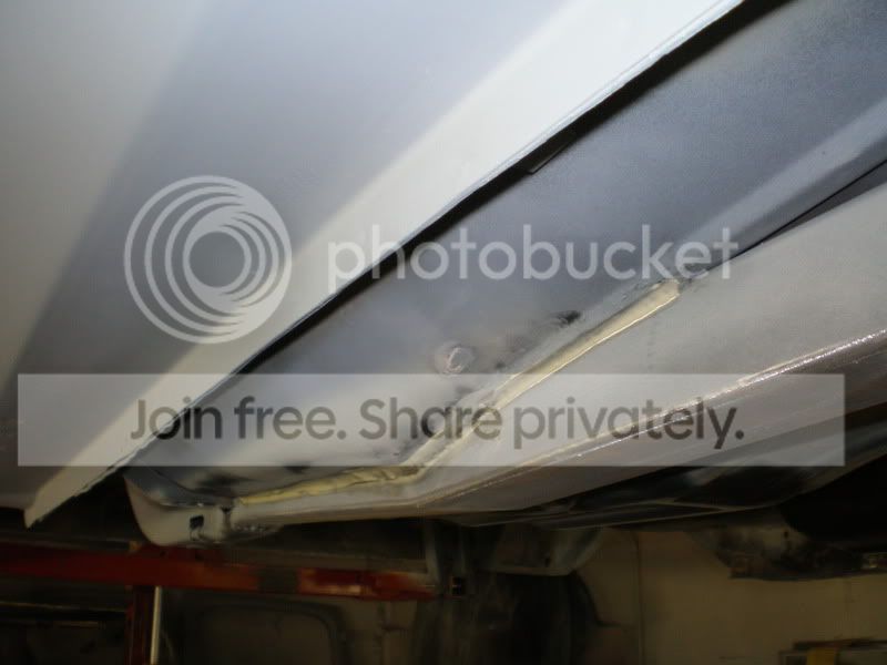

CamaroAJ 04-07-2011 07:24 PM
my floors were fiberglassed in a few places as well. they did a really good job at hiding the rust and i wasn't too happy when i found it.
No kidding AJ. Who does that, hack body shops?

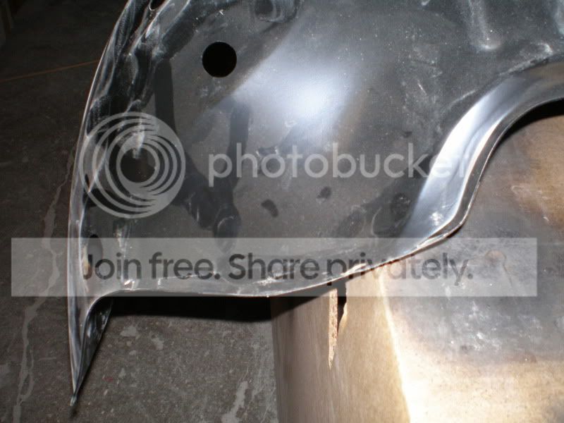

Clearanced the inner fenders

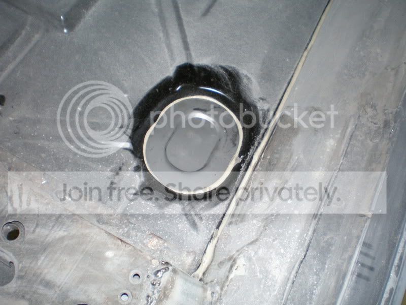

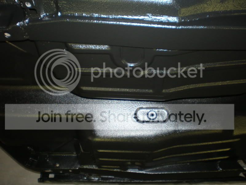

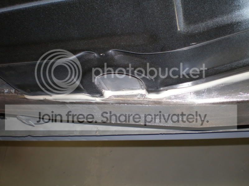

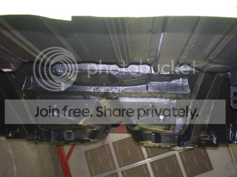

Drain plug cut/weld install and seam sealer where possible…
http://i885.photobucket.com/albums/a...d/P3310009.jpg
http://i885.photobucket.com/albums/a...d/P3310010.jpg
http://i885.photobucket.com/albums/a...d/P3310012.jpg
http://i885.photobucket.com/albums/a...d/P3310014.jpg
http://i885.photobucket.com/albums/a...d/P3310015.jpg

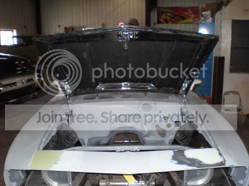

We decided to shoot the engine bay first…
http://i885.photobucket.com/albums/a...dercoat018.jpg
http://i885.photobucket.com/albums/a...dercoat016.jpg
http://i885.photobucket.com/albums/a...dercoat017.jpg
http://i885.photobucket.com/albums/a...dercoat010.jpg

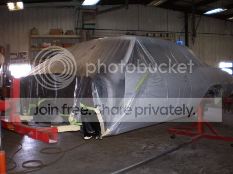

And masked off a clean line at the bottom of the firewall for UPol. We reduced the UPol 15% to get a little smoother finish
http://i885.photobucket.com/albums/a...dercoat007.jpg
http://i885.photobucket.com/albums/a...dercoat001.jpg
http://i885.photobucket.com/albums/a...dercoat004.jpg
http://i885.photobucket.com/albums/a...dercoat005.jpg
http://i885.photobucket.com/albums/a...dercoat006.jpg
We’re at the point where the body gets final checks for highs/lows and into the paint booth in a few days. I cannot wait…
