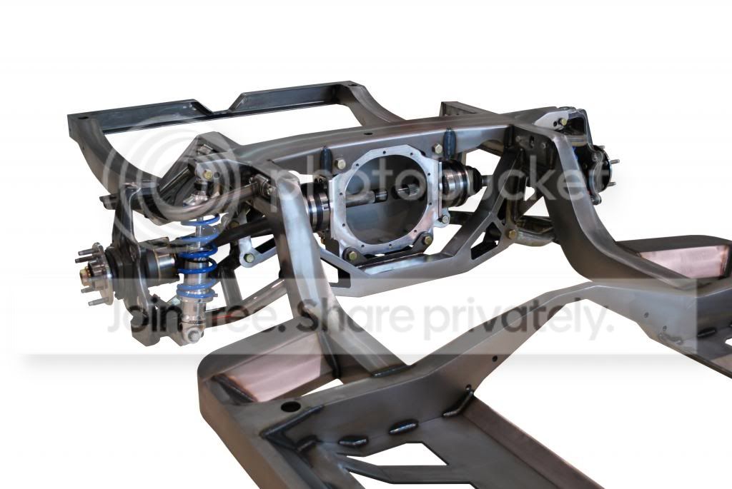

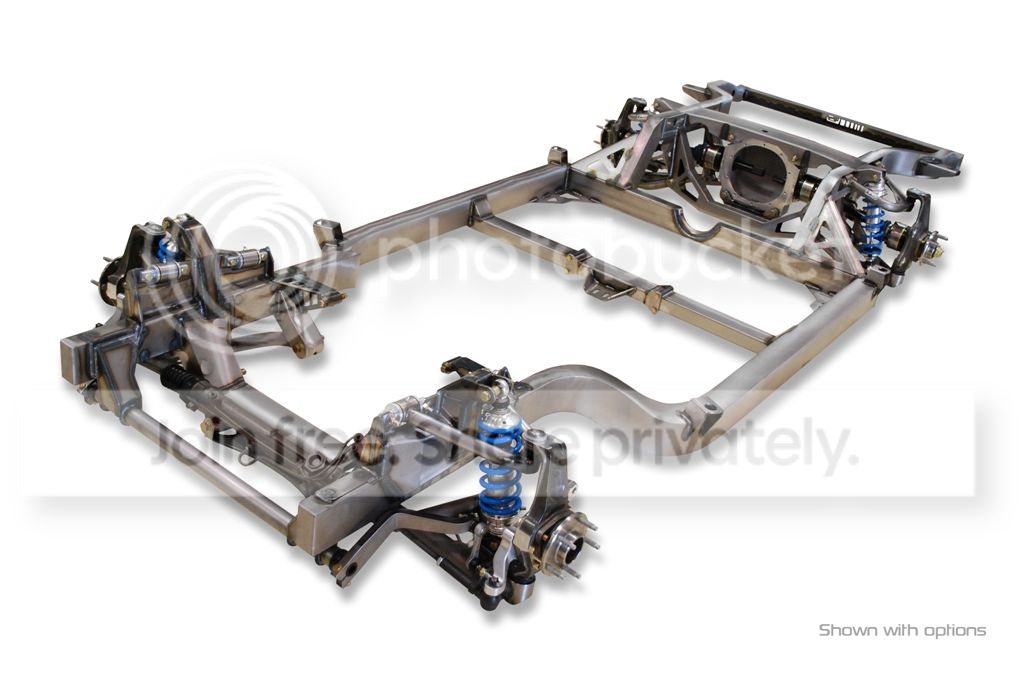

Here is a little teaser shot of things to come. C1 Vette IRS chassis and 1st and 2nd Gen Camaro IRS chassis. Waiting on parts from the machine shop to fab the control arms and then completed pics will be posted.

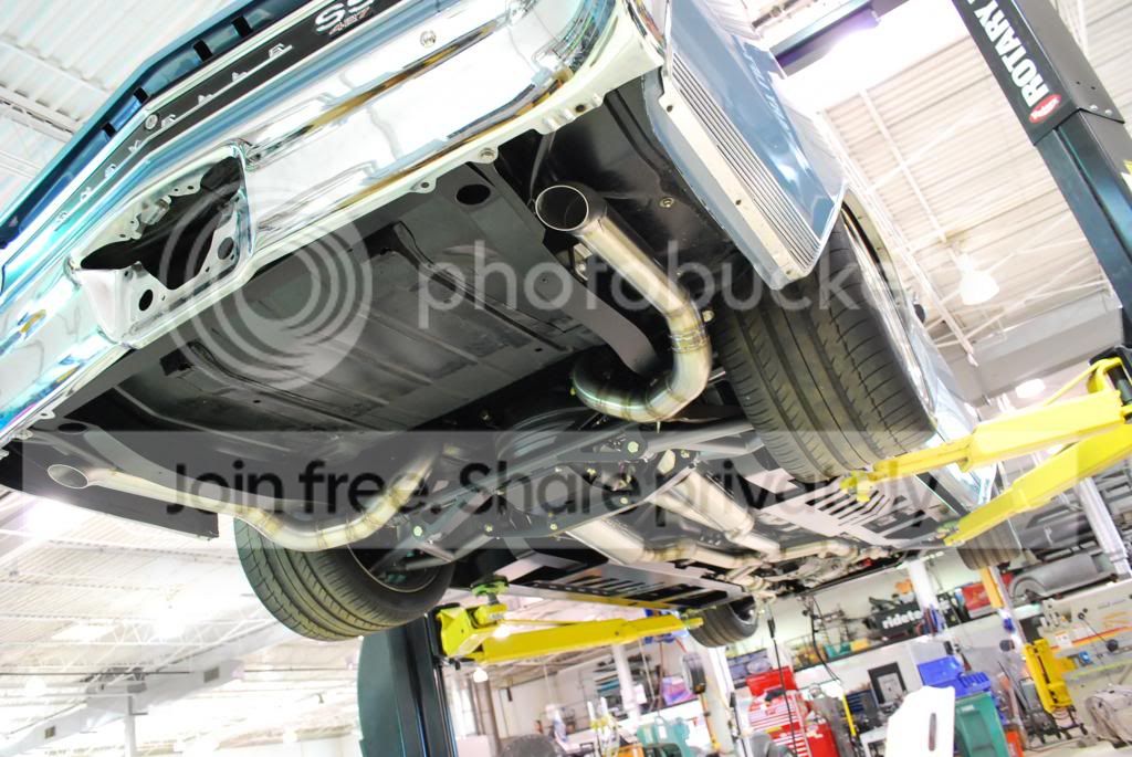

When running the IRS on a 1st gen camaro, you can no longer run the stock tank. (you can run the stock tank with the solid axle 9" rear suspension) A custom tank would have to be built. Rick's Tanks or Rock Valley can both provide you with that end of the build for $1,000 - $1,500 depending on your motor's fuel pump requirements.
Here are a few good shots of the exhaust and fuel tank on a 66 Chevelle with the IRS. It is a different car, but similar idea on the tank and exhaust. The customer wanted the exhaust run on the outside of the frame rails on this car. You could also run the exhaust inside the frame rails and make a narrower tank.

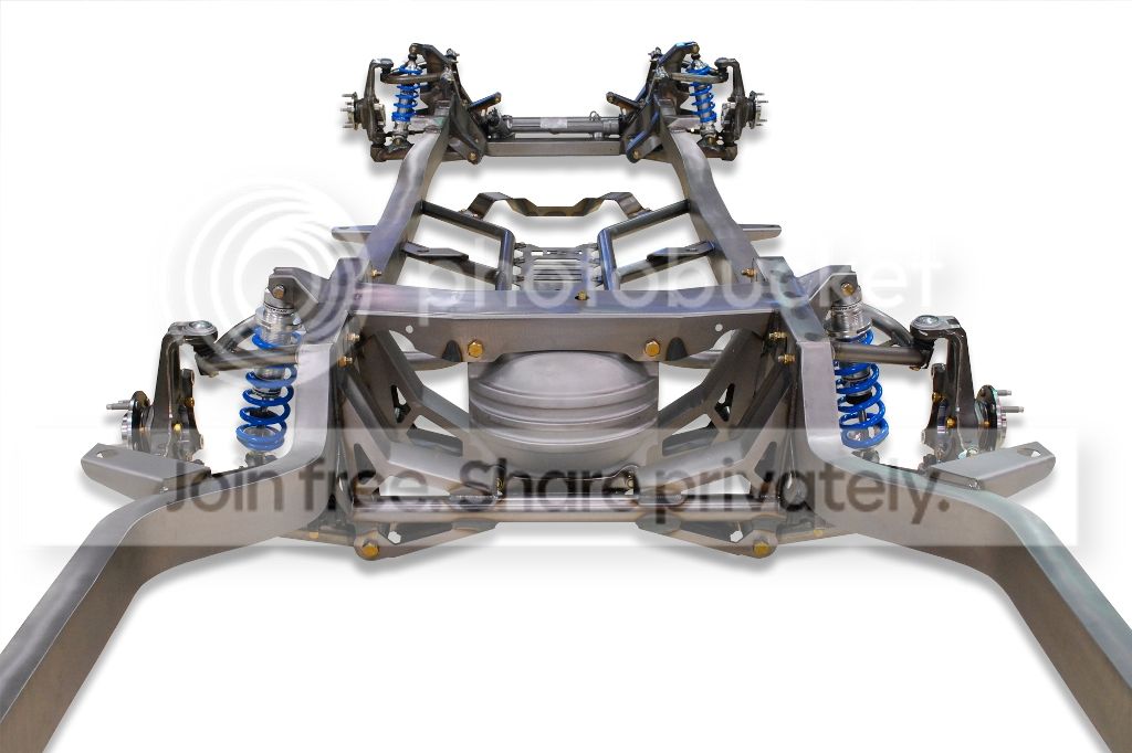

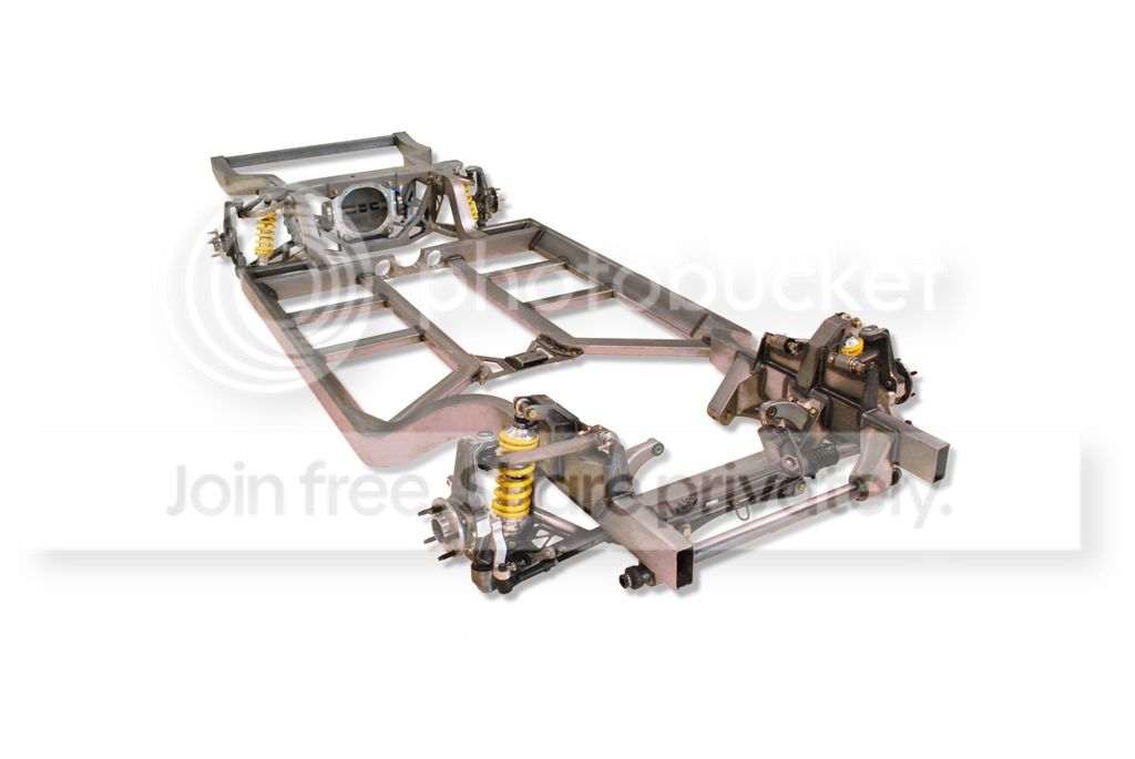

It has been a while since we updated this thread. We have been addind the Fast Track IRS to just about every chassis in our line up as well as going quite a few custom 1-off builds as well. Below are some pictures of the Fast Track IRS installed in various production chassis.
