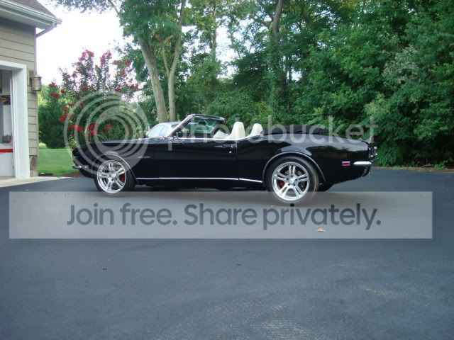

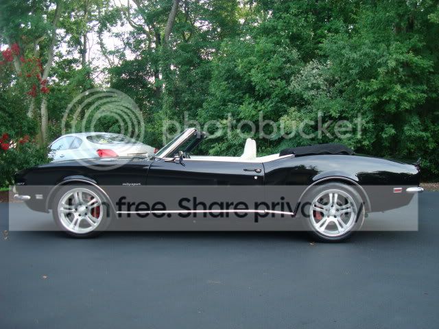

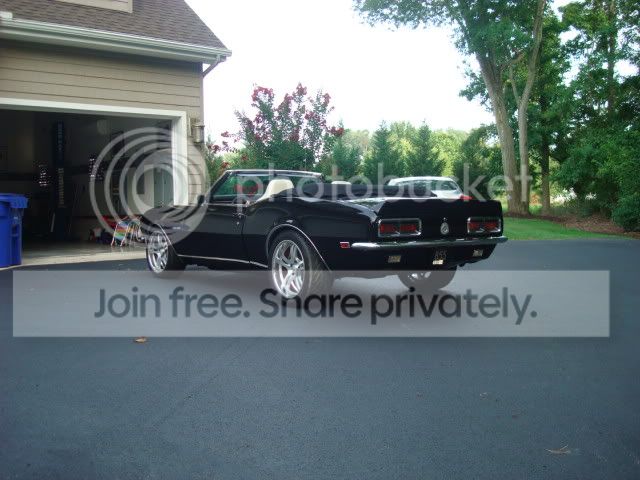

SUCCESS! I got everything bolted back together and torqued so we loaded up and headed out for a cruise and no RUB!! I hit a variety of bumps and now have no issues. The ride is a little firmer but I like it.
Here are a few after pics.
http://i563.photobucket.com/albums/s...DSC01678-1.jpg
http://i563.photobucket.com/albums/s...9/DSC01679.jpg
http://i563.photobucket.com/albums/s...9/DSC01677.jpg
Thanks for all the help and advice!!

Looks good. I thought the shackles would rise it more than that, but that looks just right.
