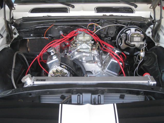

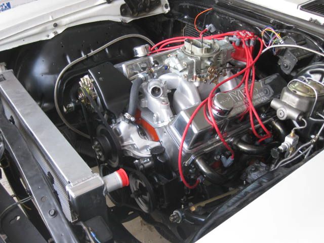

A little more progress today. Installed driver side header, mounted the radiator, power steering pump, and belts. Installed distributror, spark plugs and wires.
Still waiting on Autometer gauges that I ordered before I fire it up. Also need to mount coil and MSD box and then pick up some pretty wire looms and an air cleaner.
http://i851.photobucket.com/albums/a...nepics3004.jpg
http://i851.photobucket.com/albums/a...nepics3003.jpg
http://i851.photobucket.com/albums/a...nepics3002.jpg
http://i851.photobucket.com/albums/a...nepics3001.jpg
intocarss 09-25-2011 01:32 AM
Looken good :thumbsup: Is that a NYES eng? I hear they build some good stuff!!
Track Junky 09-25-2011 09:04 AM
Yeah it is. How'd you guess? I'm also running an NYES aluminum small block in my Orange '69.
intocarss 09-25-2011 09:50 AM
Made out the letters on the VC

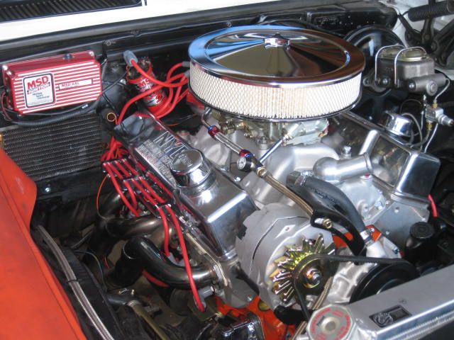

http://i851.photobucket.com/albums/a...inePic4001.jpg
Thanks bro, more to come soon.
I mounted and wired the MSD 6AL box and Blaster 2 coil yesterday. Also wired up the one wire alternator and ran new battery cably to trunk area. Going to pick up wire looms and air cleaner today.
Made a phone call and my Autometer Sport Comp gauges should be showing up tomorrow. If my day work doesn't get in the way I should be firing the motor up this week.

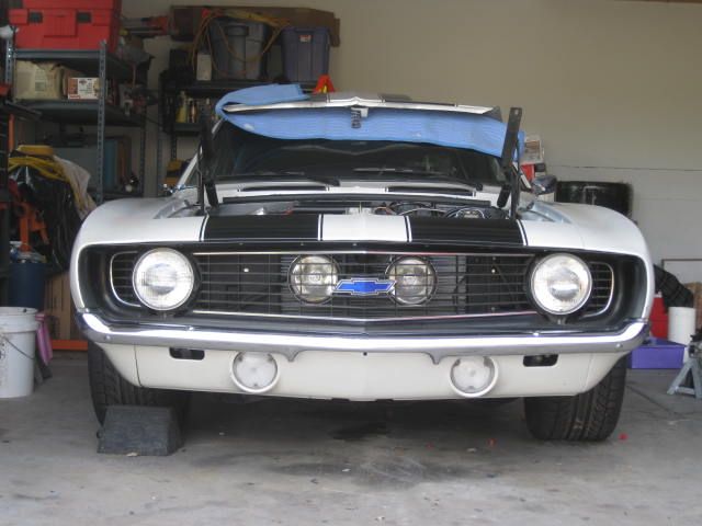

Track Junky 10-08-2011 07:03 PM
Been a busy couple days but she's almost done. Center console and gauge pod wired and complete, bolted the new Corbeau A4 seats in and replaced the carberator from the 850 to a 750. The mouse that was living in the trunk snacked on some tail light wiring so I did a little work there.
Still need to install shocks, swap rear tires after borrowing wheels for Buttonwillow, get a trunk pan put in, and then give her a bath.
http://i851.photobucket.com/albums/a...ostdone007.jpg
http://i851.photobucket.com/albums/a...ostdone006.jpg
http://i851.photobucket.com/albums/a...ostdone005.jpg
http://i851.photobucket.com/albums/a...ostdone004.jpg
http://i851.photobucket.com/albums/a...ostdone003.jpg
http://i851.photobucket.com/albums/a...ostdone002.jpg
http://i851.photobucket.com/albums/a...ostdone001.jpg

Looks good, nice stance

Front springs actually feel great but I cut to much and have a bit of rubbing when leaning into to the corners so I will be raising the car an inch.
Thanks for the props.
