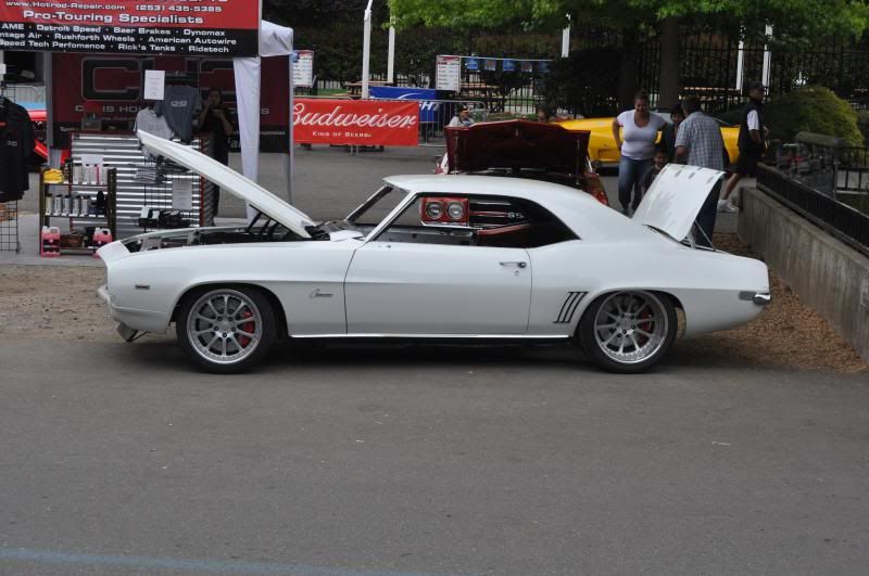

Musclerodz 02-25-2012 03:05 PM
http://i250.photobucket.com/albums/g...OPO/Feb22a.jpg
Are those shocks hooked up? They look to be below the scrub line which would not be good if you have a flat. They don't look to be but can't tell for sure.
youthpastor 02-25-2012 04:44 PM
no, we just unhooked them to set up some mock up height

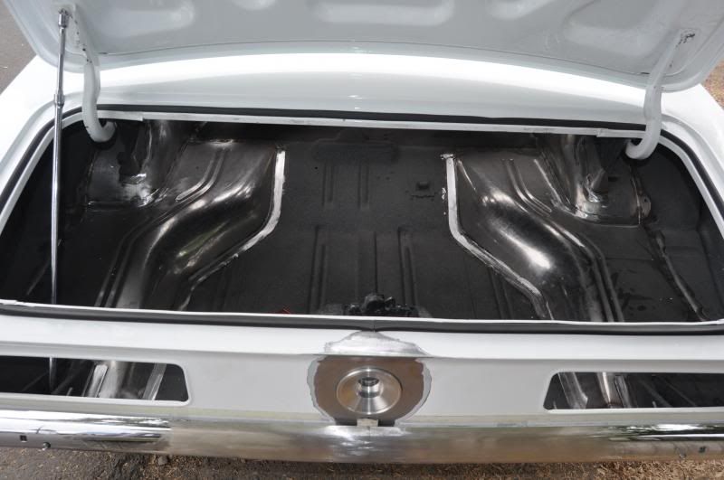

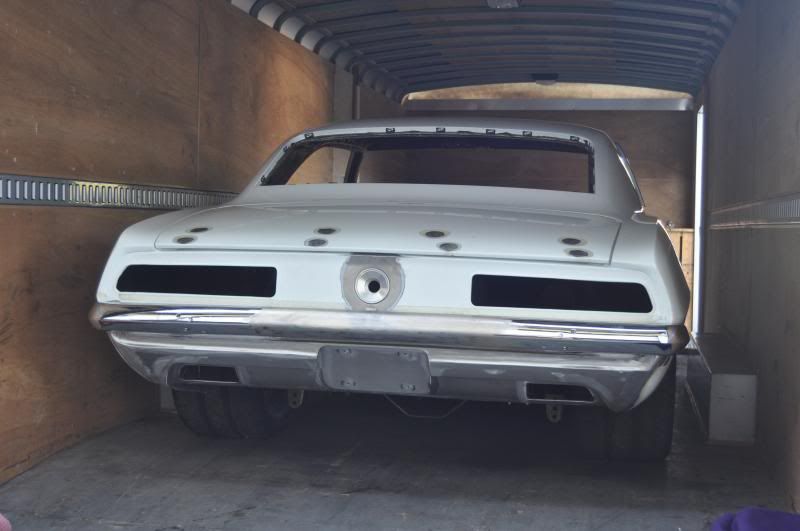

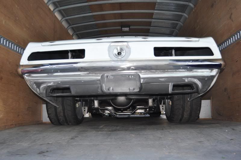

We went with some rear tail-pan updates. The filler is moved up between the taillight. The rear exhaust tips will mimic the taillight angles. Which meant we cut out the Art Morrison frame rails and made custom pieces that hug the quarterpanels to free up room for the exhaust. Make sense? And standard fare was sectioning the rear bumper to bring it in a bit.

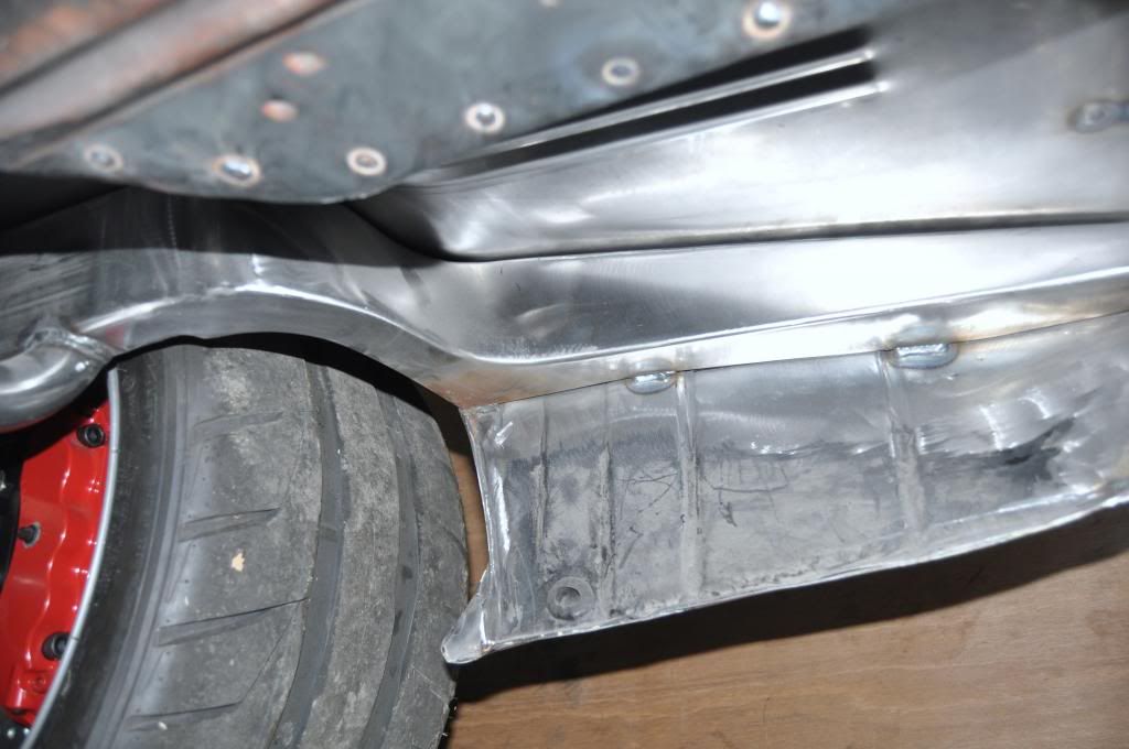

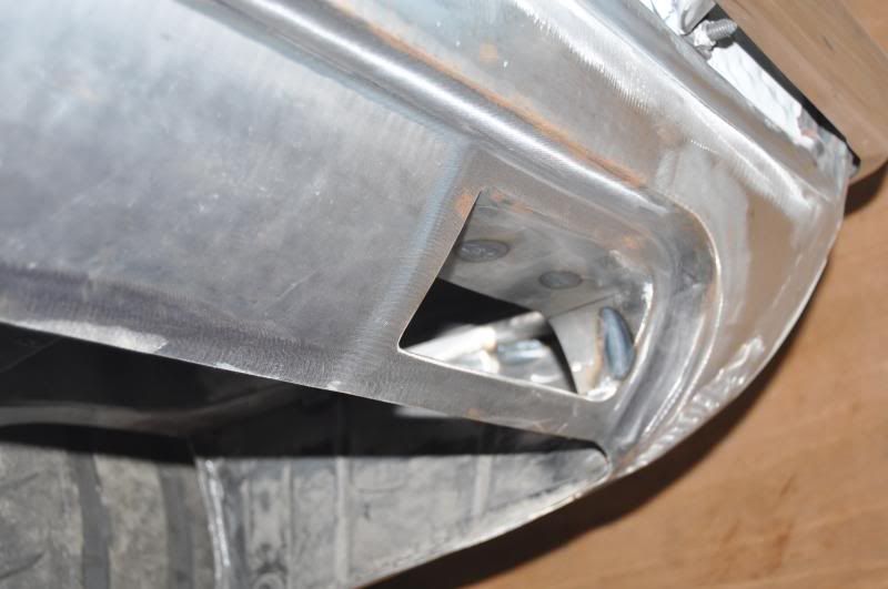

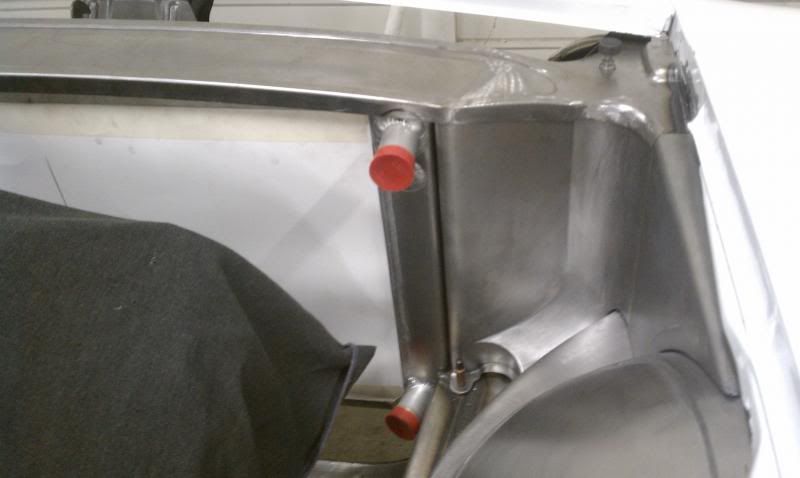

Probably the coolest part about the rear end work is the way the rear frame rails kick out to the quarter panels to open up room for the 3" exhaust and Rick's Tanks

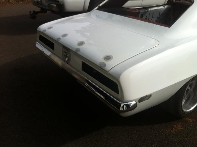

We removed the rear spoiler...'cause everybody know's first gen Camaros look better without it:poke:

hi chris, great fab work. your guys are good.
can you give us details on that filler tube please?
youthpastor 08-04-2013 02:11 PM
That is made on the lathe and will have a spring loaded center to push and release-

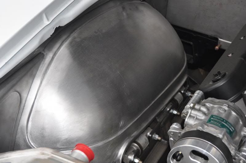

I must be asleep or something...First time I have seen this thread. Amazing metal work Chris! The inner wheel wells looks great, amongst everything else! More pics please!!
