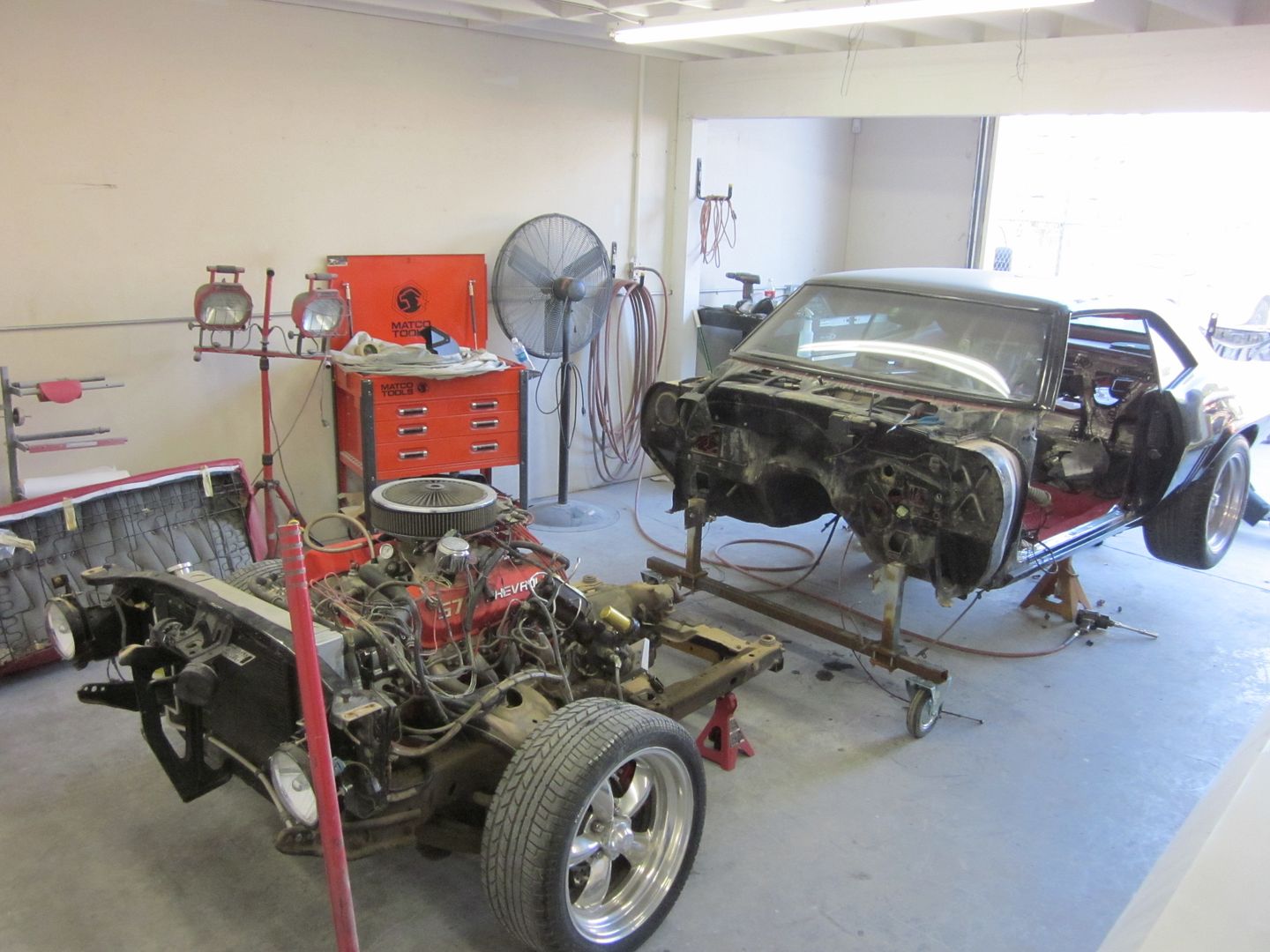

We have all the car disassembled! The shell & all removable sheet metal was picked up Friday for media blasting.. I sold the 572 already! The rest of the parts will be listed here pretty soon..

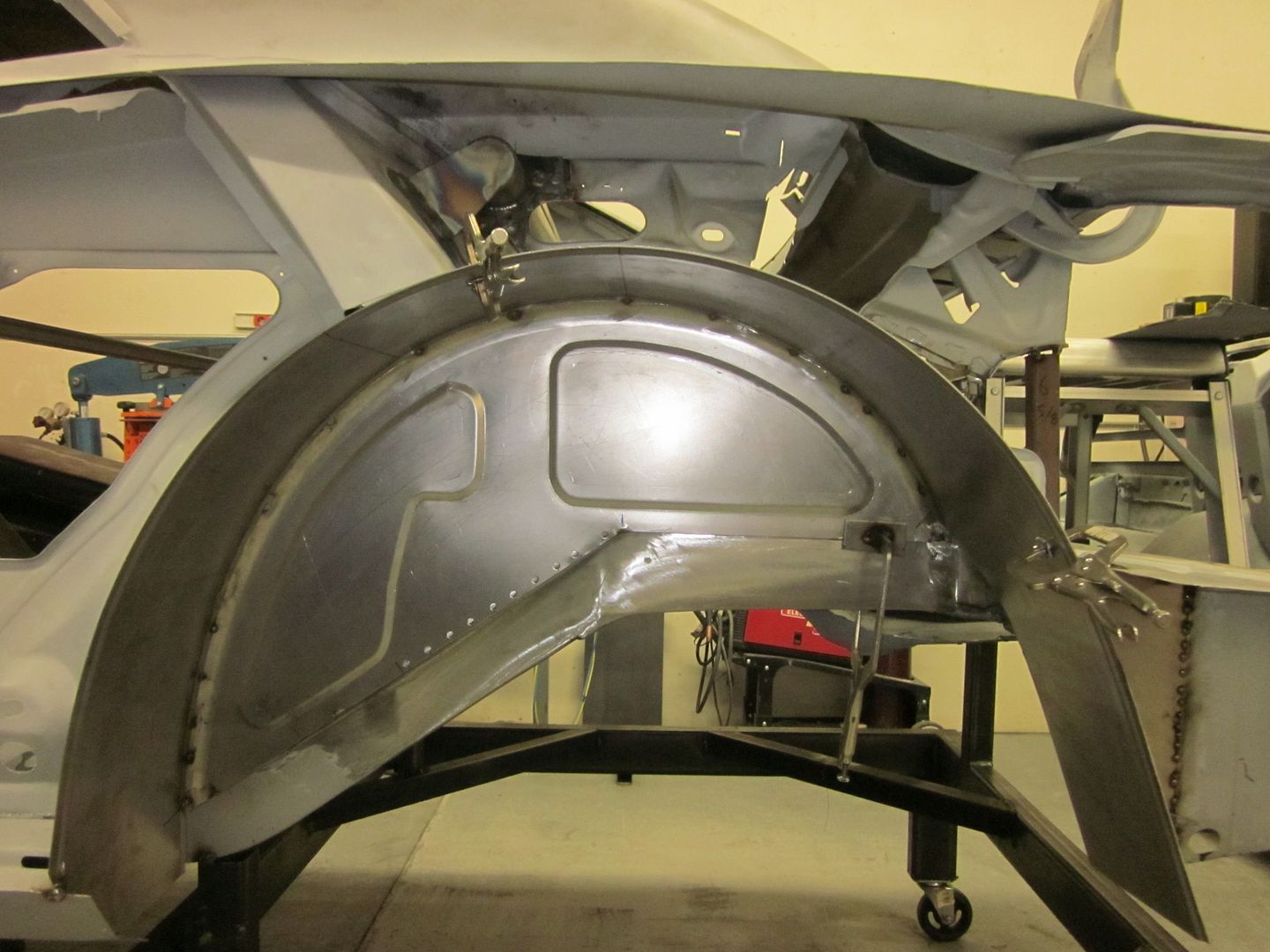

Here are a few updates.. We have been working on making room for the
345-30-20... We built new frame rails out of .120 thk material so that we have good mounting & welding point for the pannard bar & just making a few things more strong for the Mast Motor.. Cut out the package tray & welded a tube in place that ties into the pillars... First time we make our own tubs..
Got more coming in the next couple of weeks ..Talked to Mast today.. Looking like I will have a motor mid Feb...
http://i1015.photobucket.com/albums/...n/IMG_1967.jpg
http://i1015.photobucket.com/albums/...n/IMG_1968.jpg
settintrendz 01-20-2012 10:09 PM
Looks sweet Cris. Are you extending the rear of the tubs down to the rockers? Appears so. I like it.

Cris@JCG 01-23-2012 07:16 AM
Adam- The new tubs are made to weld to stock points.. They extend to the rocker panels & we are doing them in two pcs... the outer tub will be done when we get the face of the qtr panel back on..

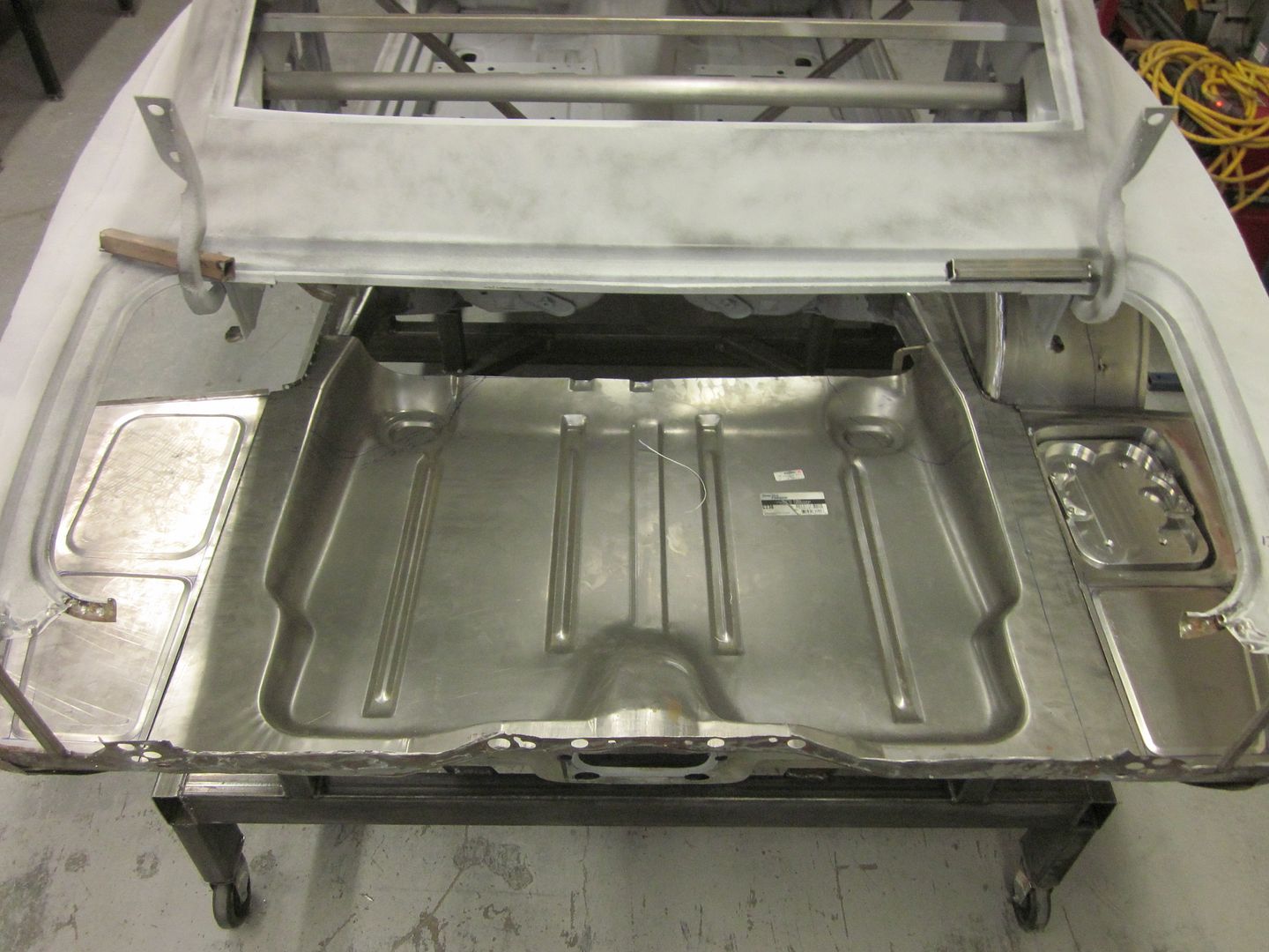

Cris@JCG 01-26-2012 06:35 PM

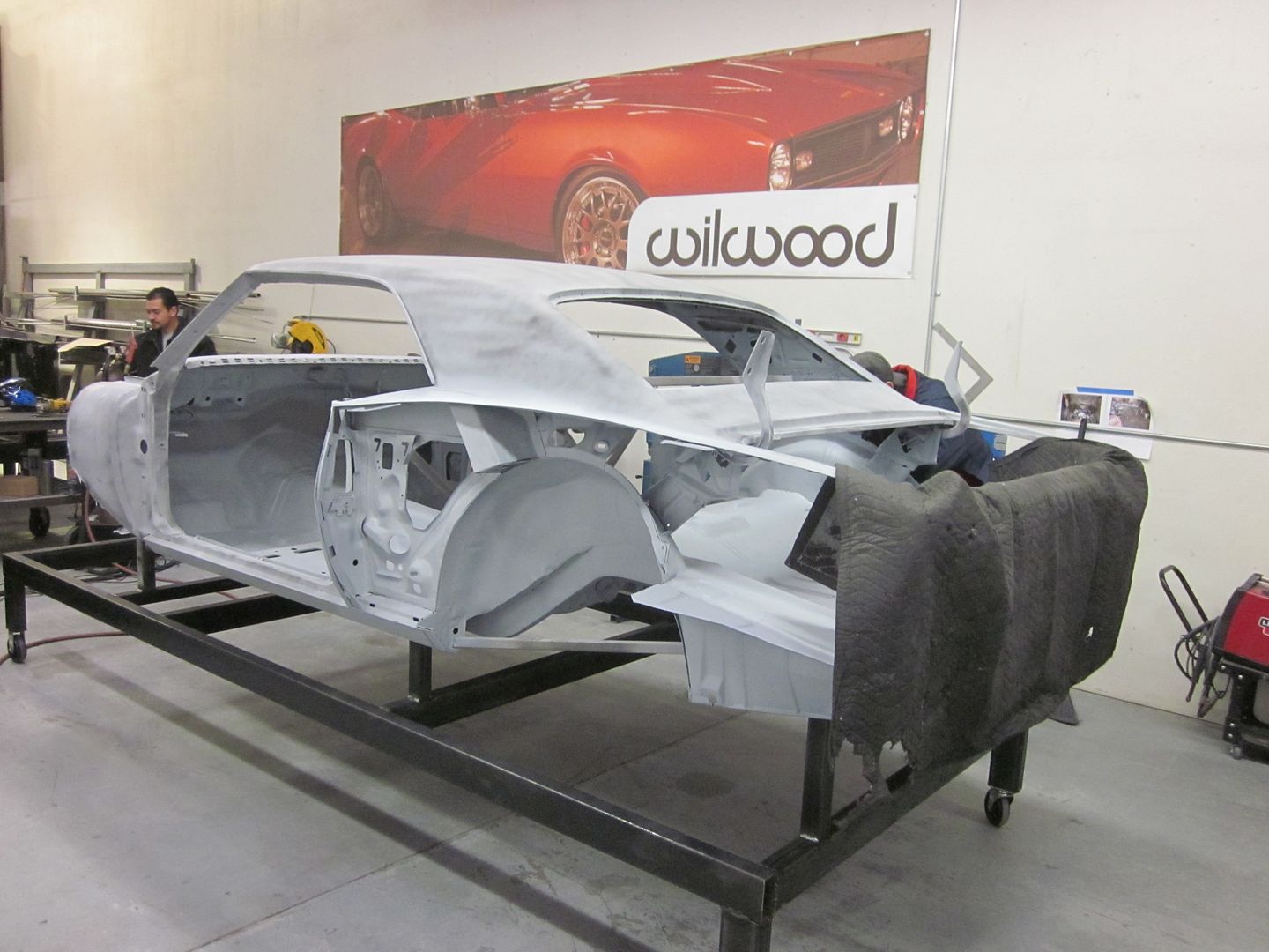

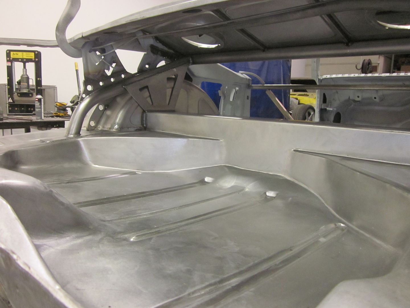

The nice thing about when you open a car this far up.. It makes it easier to fabricate & weld.. The tubs are done & ready to be welded in place but we need to finish up the trunk first...
WE were gonna fab a cool new trunk pan but drew the line sonewhere.. Using the stock one with new trunk fillers.. Thought we would try something new with our Optima billet battery tray.. I think it looks ok.. :D
Tomorrow we weld it up all together.. next week we start the four point cage..
http://i1015.photobucket.com/albums/...n/IMG_1989.jpg

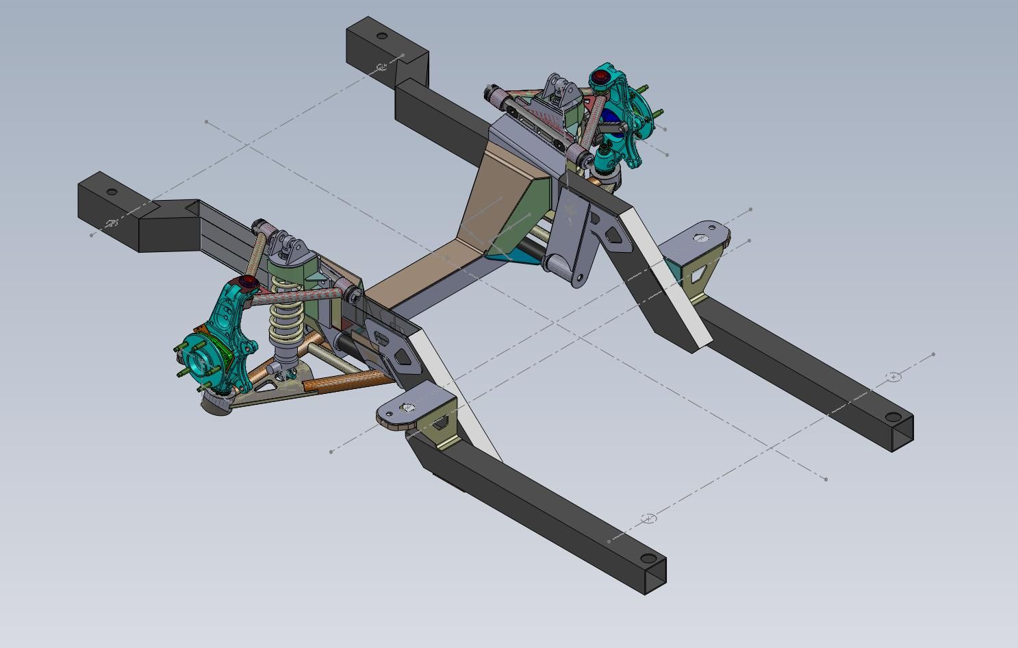

Bryce 01-31-2012 08:36 AM
Cris are going to share your suspension geometry characteristics?
Did you lose any weight with your design?
Nice detailed CAD work.
Cris@JCG 01-31-2012 09:31 AM
Bryce- The suspension geometry characteristics will be kept under wraps for now.. When we build the first prototype.. I will need to take the sub-frame over to friend of mine that will proof the suspension geometry before we move on to build final chassis.. Then the prototype will be put underneath my 68 Camaro to test & proof fit & function.. I will daily drive the car to ensure that we have meet our goals on design & function..
Two reason that drove me to build our own suspension.. 1st: build the car off the wheels.. 2nd :build the car to desired ride height without losing suspension travel.. Another thing that have become a big thing around the shop is weight.. The design on the sub with suspension has been designed to keep weight down.. I am a big fan of inter locking pcs. together & plug welding with stitch welding.. Our chassis is not designed to look pretty & smooth.. but the number one priority is strength .. Cost is another factor on the sub.. Look @ the upper control arm.. It is a mirrored from left to right.. so we build one arm that is used left & right.. The lower control arm is mirrored on components.. The control arms are using 4130 chromemoly tubes with 4140 upper bushing shafts.. We will be using all ARP fasteners.. We have tested the tensile strength on their fasteners.. & it is what they claim! We FEA tested the control arms with a 8000 pound load on them.. Plenty of strength!
The design on the spring buckets is just like GM would do on their trucks but with a coil over.. Shock angles is another key factor.. & the list keeps going on.. We have put a lot of thought into the design..
Please note that I am not doing this to produce & sell to the public.. Just to support the builds we have in house.. The suspension & chassis market is statured with vendors that produce excellent products..

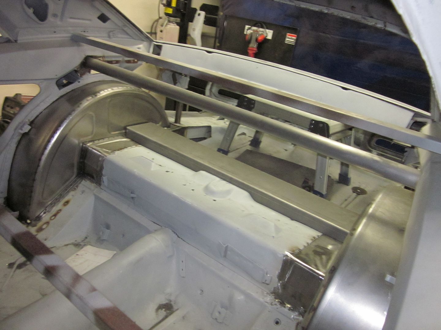

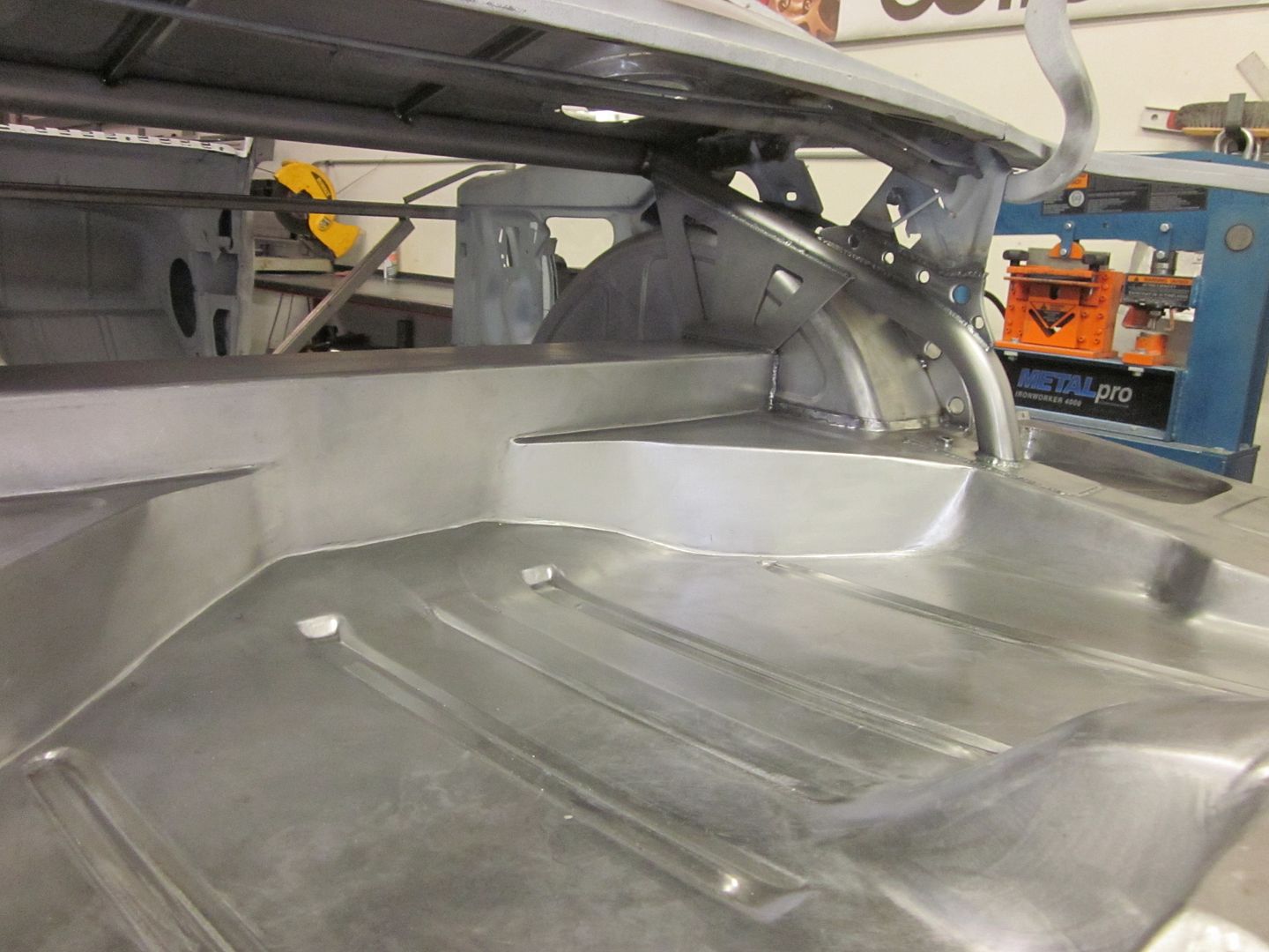

Cris@JCG 02-11-2012 05:26 PM
I finally got around to running our new CNC plasma cutter for a job here @ the shop.. My Uncle has been brushing up on his AutoCad skills..
It took us longer to measure & design on AutoCad than to burn it out..

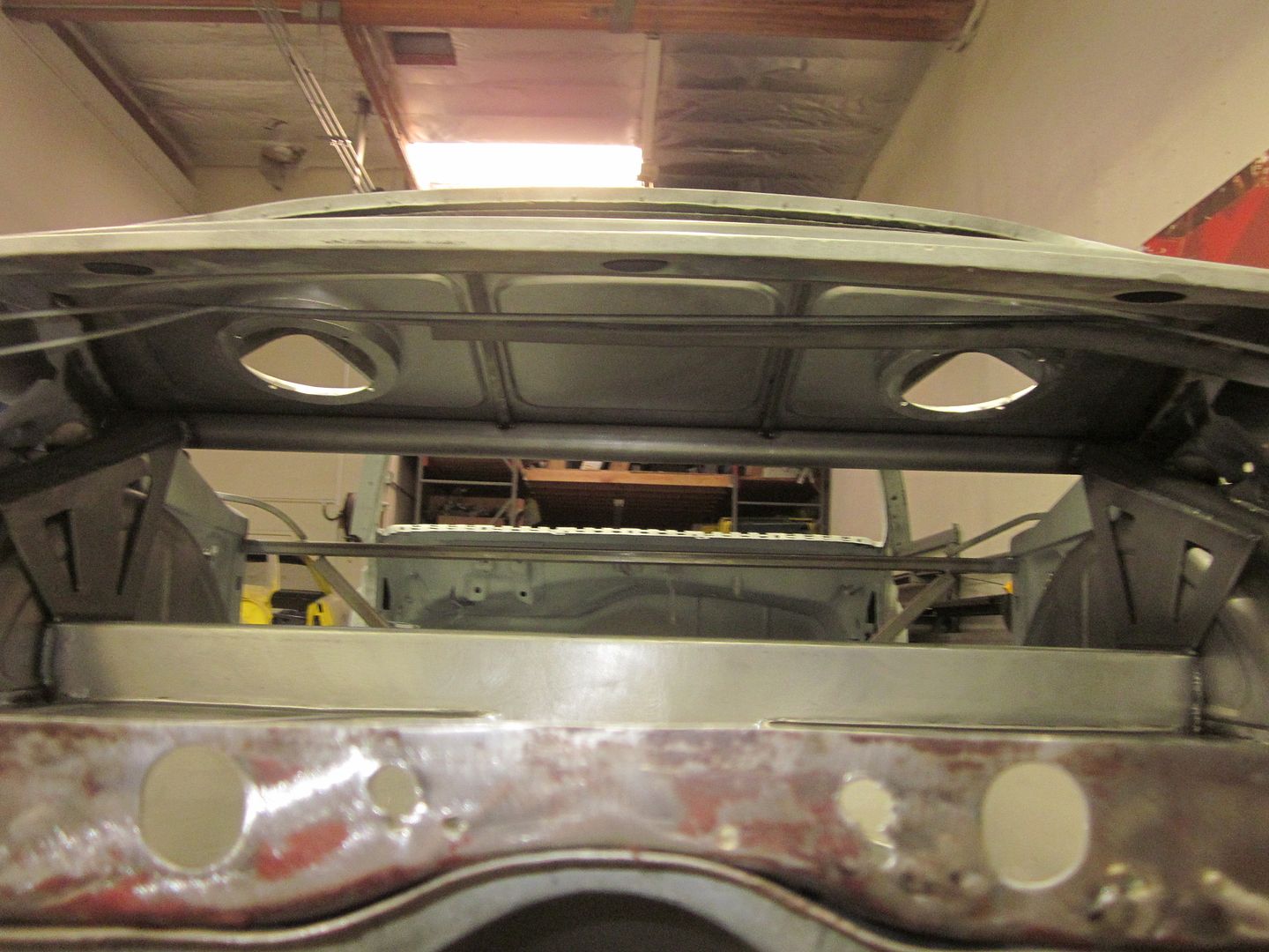

Here is a update on some of the rear inner structure work.. The package tray is almost done.. Post pics of that later..
http://i1015.photobucket.com/albums/...n/IMG_2038.jpg
http://i1015.photobucket.com/albums/...n/IMG_2039.jpg
http://i1015.photobucket.com/albums/...n/IMG_2037.jpg
http://i1015.photobucket.com/albums/...n/IMG_2040.jpg
