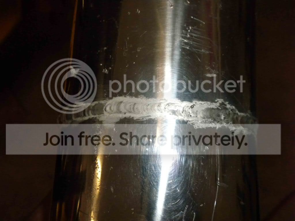

OK... made some huge progress in the last two weeks since I checked in... Got my red tungsten, got my fine wheel on the grinder and what a world of difference!! Much more stable arc and much better puddle control- less contamination issues since I can pull back a little further from the puddle.

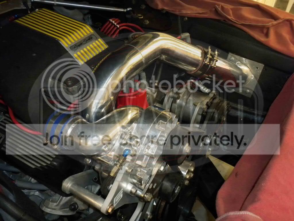

This weekend I built an air intake system out of the previously mentioned Vibrant polished tubing and it turned out nice. I didn't scrub down the tubing this time as suggested and had no contamination issues with the polish... (I did verify that TIG doesn't like Sharpie marks though!! :lol:) I had an AH-HAH! moment and most of it was done without filler rod. It was so beautiful!! On these cars I grind the welds flush and the tubing gets painted so I need to be careful not to sink the weld too much- its better for me to have a little material to take off.
http://i696.photobucket.com/albums/v...S020/Weld2.jpg
http://i696.photobucket.com/albums/v...eAirIntake.jpg

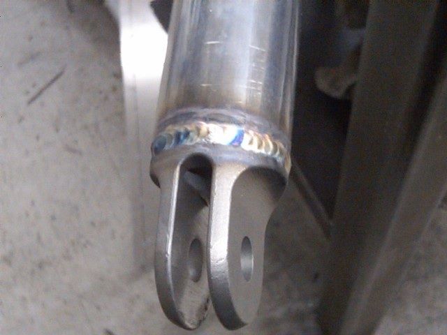

i tig welded these with a miller 250, on the ss tank and roll bar mount I used 3/32 red tungsten sharpened on a used 120 grit belt sander spinning in a drill. I always sharpen parallel to the centerline, but have only used a dedicated tungsten sharpener when I worked at Eaton Aeroquip. I might be able to help some of you with questions, but like Greg I am far from an expert. I do have some experience with rare metals, so I might be able to help there a little more. I have welded several alloys of inconel and titanium.
http://img.photobucket.com/albums/v4...00308-1136.jpg
http://img.photobucket.com/albums/v4...00310-1356.jpg
http://img.photobucket.com/albums/v4...ps3d1f388b.jpg
