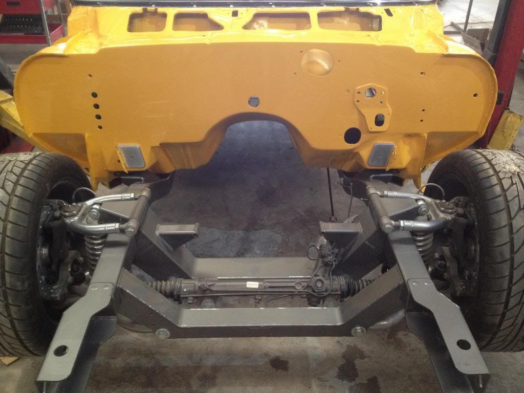

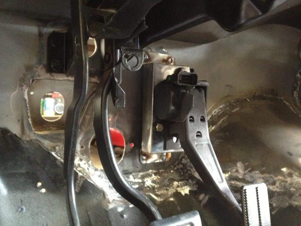

Time to bring back to top with another update with where I left off. accelerator pedal was mocked up and installed and studs were welded to firewall to mount vintage air unit
http://i1309.photobucket.com/albums/...ps136b0b73.jpg

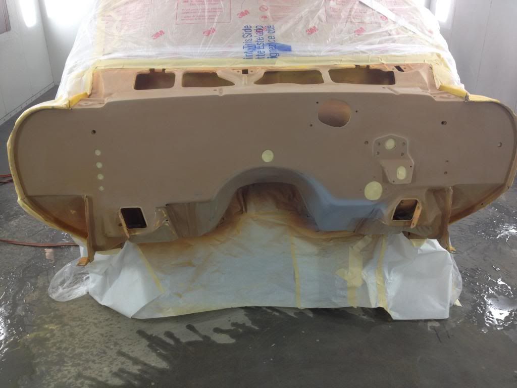

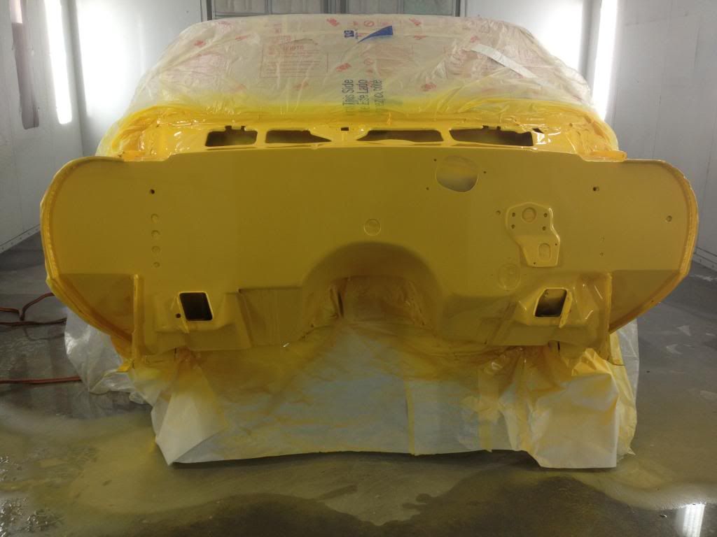

firewall was then prepped and painted
http://i1309.photobucket.com/albums/...ps4cd38446.jpg
http://i1309.photobucket.com/albums/...psee7acad2.jpg

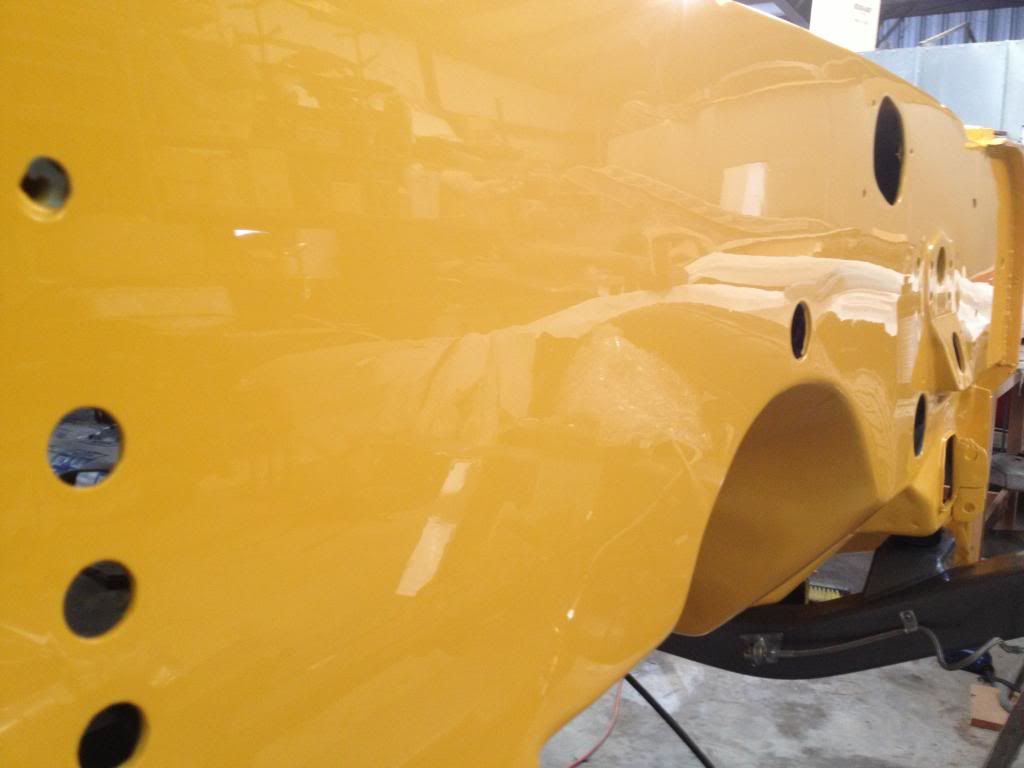

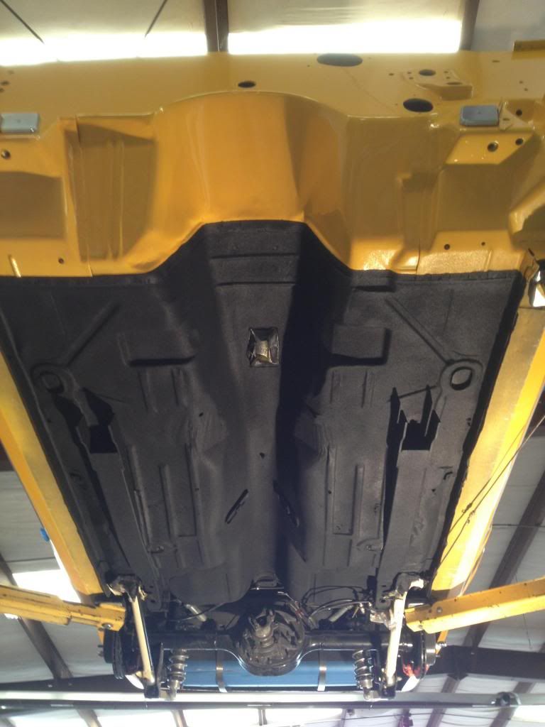

quicky color sand and reundercoat floor to cover previous overspray and touchup where sub frame connectors were added.
http://i1309.photobucket.com/albums/...ps00d20387.jpg
http://i1309.photobucket.com/albums/...ps736dd90c.jpg
http://i1309.photobucket.com/albums/...psf745de21.jpg

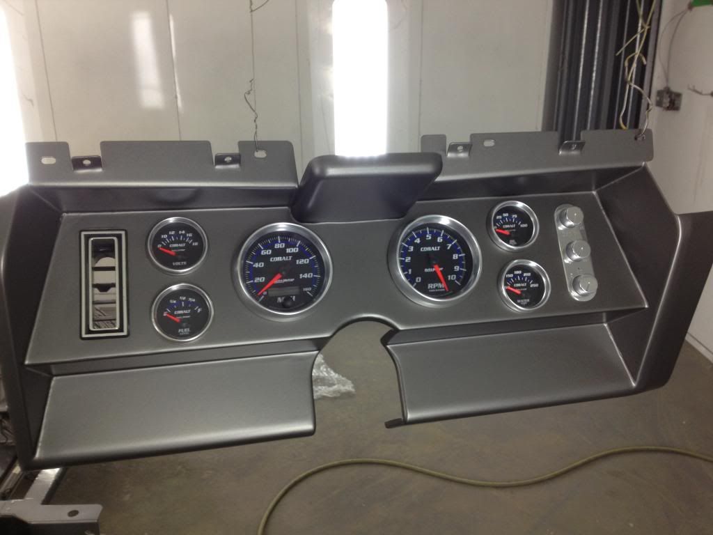

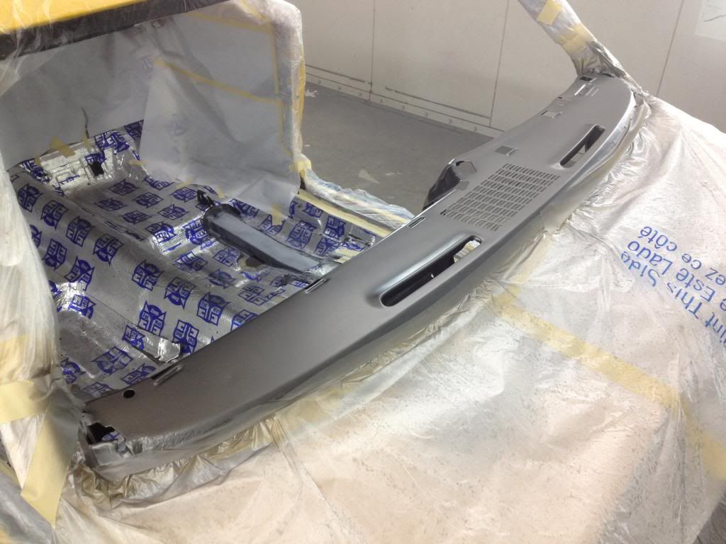

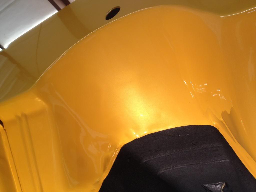

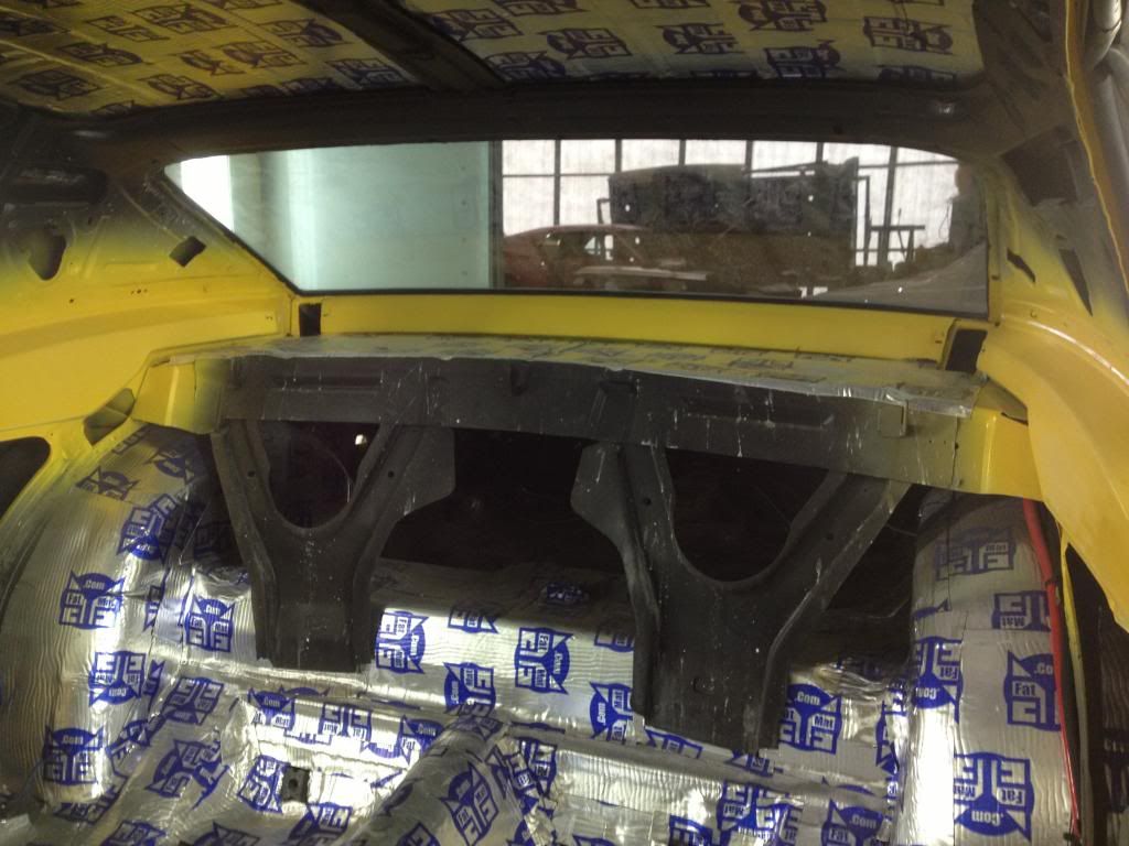

with outside fixed moved to interior. rear package tray area was yellow and really need to be gray so we rehot the gloss dash matte and fixed the rear.
http://i1309.photobucket.com/albums/...ps5279f794.jpg
http://i1309.photobucket.com/albums/...psdfb0542d.jpg
http://i1309.photobucket.com/albums/...psb2900d14.jpg
http://i1309.photobucket.com/albums/...pse661a91e.jpg

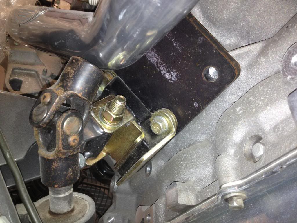

This is how the mount was installed when it showed up. Mind you Tony PAID to have all this work completed and final installed before it came to my shop. See anything wrong?????:headscratch:
http://i1309.photobucket.com/albums/...ps90bc1ddd.jpg

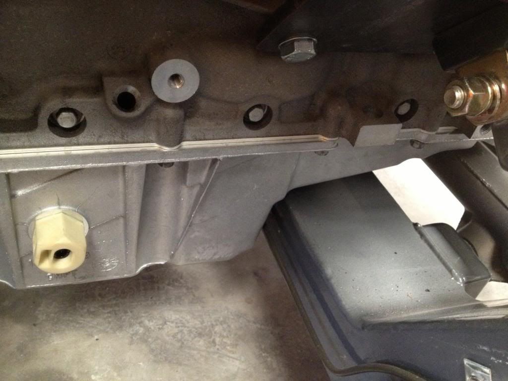

Progress continues. Got the engine mounts flipped back over where they belong, all high strength hardware installed, only to find out now the Autokraft pan won't clear the rack. Call Heidt's and say to use 4th gen pan. Those dont exist used anymore so a new one ordered up, installed, and we now have the clearance we need again.

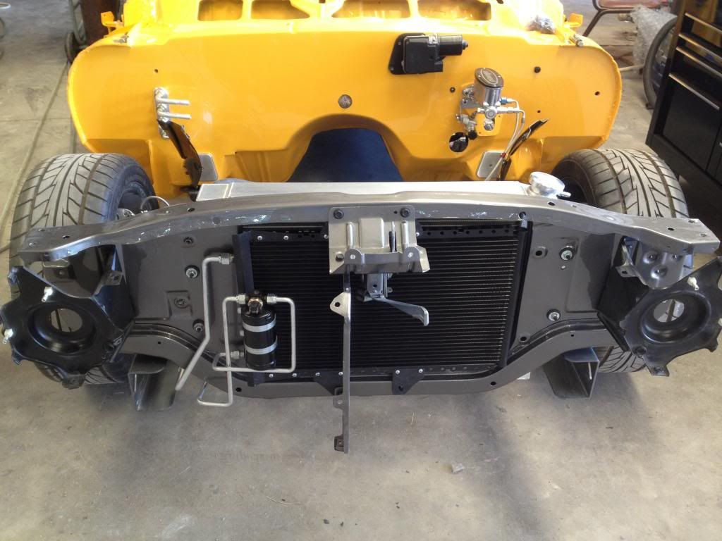

While waiting on the pan to come in, started assembling the core support after it was repainted charcoal to match the car.
http://i1309.photobucket.com/albums/...psdeafa4fb.jpg

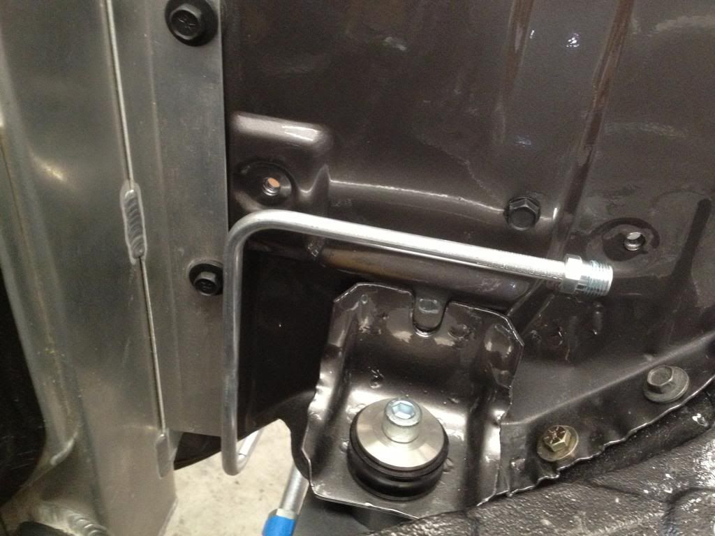

Using the factory hardline kit, I rebent the high pressure line to reroute behind fender.
http://i1309.photobucket.com/albums/...ps0229c62d.jpg

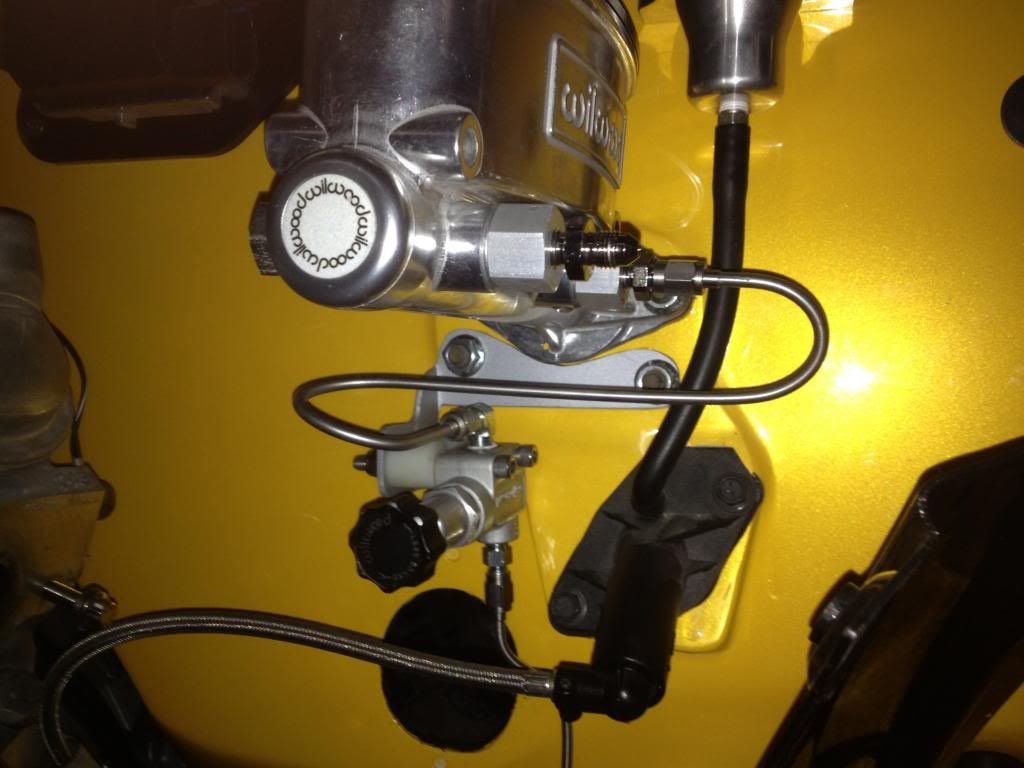

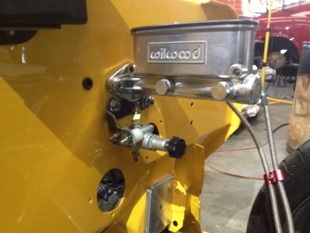

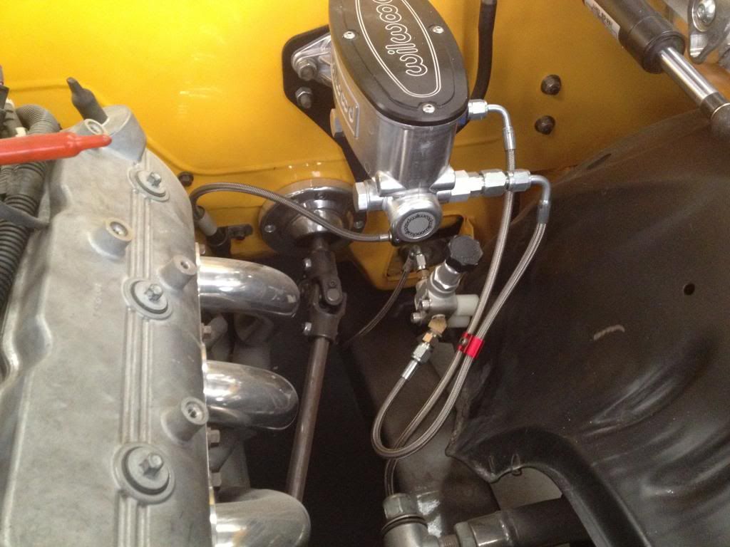

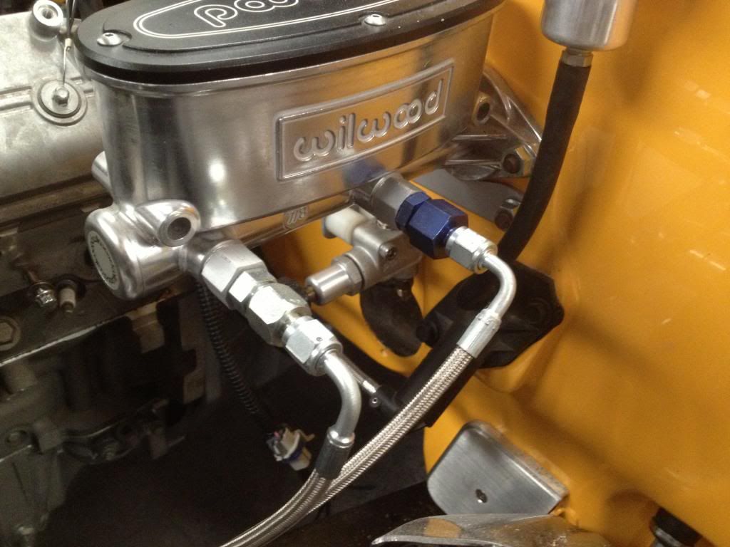

Time for next installment. Referring back to the last pic I posted, all the flex line was not going to cut it for the brakes. After removing all the flex, I relocated the wilwood prop valve to a more suitable location and fabricated a new bracket to hold it.
http://i1309.photobucket.com/albums/...pse38ded21.jpg
This unsightly mess of fittings was removed, proper fittings installed for a cleaner look for the new hard lines to attach to.
http://i1309.photobucket.com/albums/...ps65522174.jpg

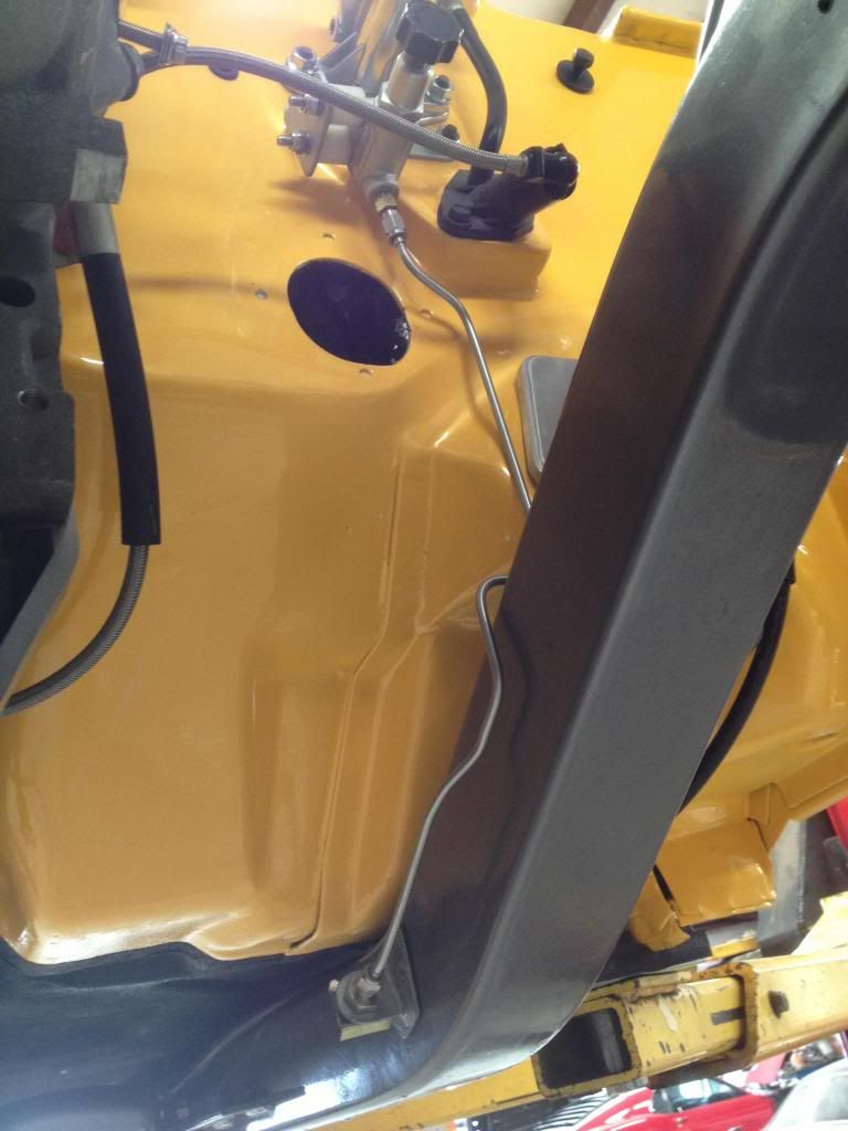

new rear lines were fabbed to tie into the existing hardline
http://i1309.photobucket.com/albums/...psd1c813c7.jpg
http://i1309.photobucket.com/albums/...psb46897e4.jpg

finished the front brakes lines and a/c lines, still have to secure the brake lines
http://i1309.photobucket.com/albums/...psabce67df.jpg
http://i1309.photobucket.com/albums/...ps3e1aab93.jpg
http://i1309.photobucket.com/albums/...psa0abd0ec.jpg
http://i1309.photobucket.com/albums/...ps09caaf0f.jpg
