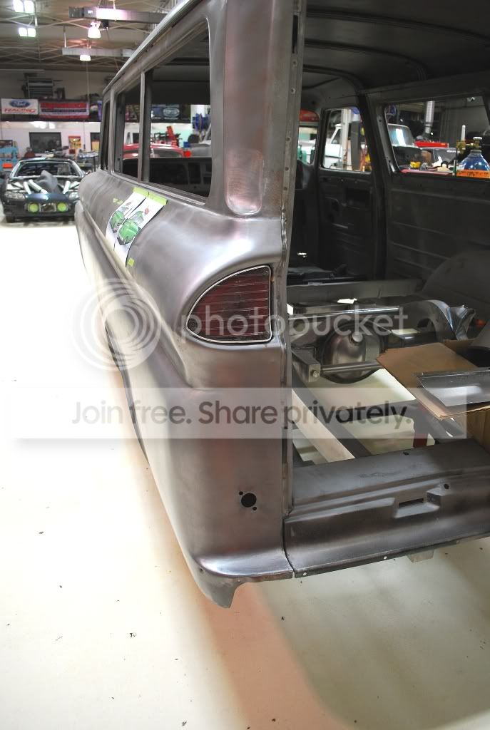

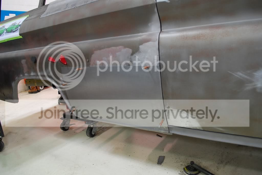

We have been making great progress on the metal work on this truck as well.
Before: large dent in the lower section and the tail light surround was distorted and rolled in from a collision:
http://i563.photobucket.com/albums/s...ture220886.jpg
After: like it never even happened.
http://i563.photobucket.com/albums/s...ture221430.jpg

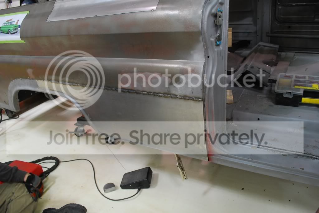

Roadster Shop 02-10-2012 03:00 PM

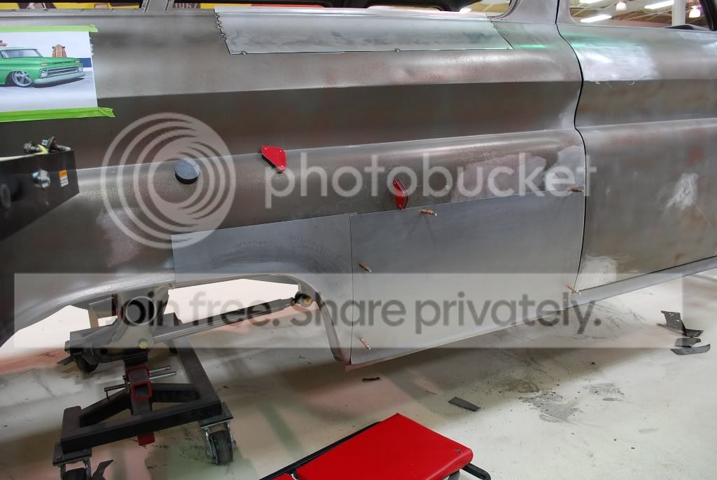

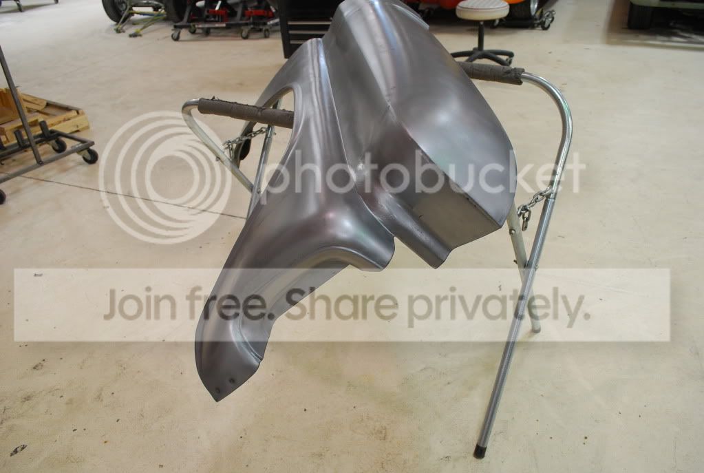

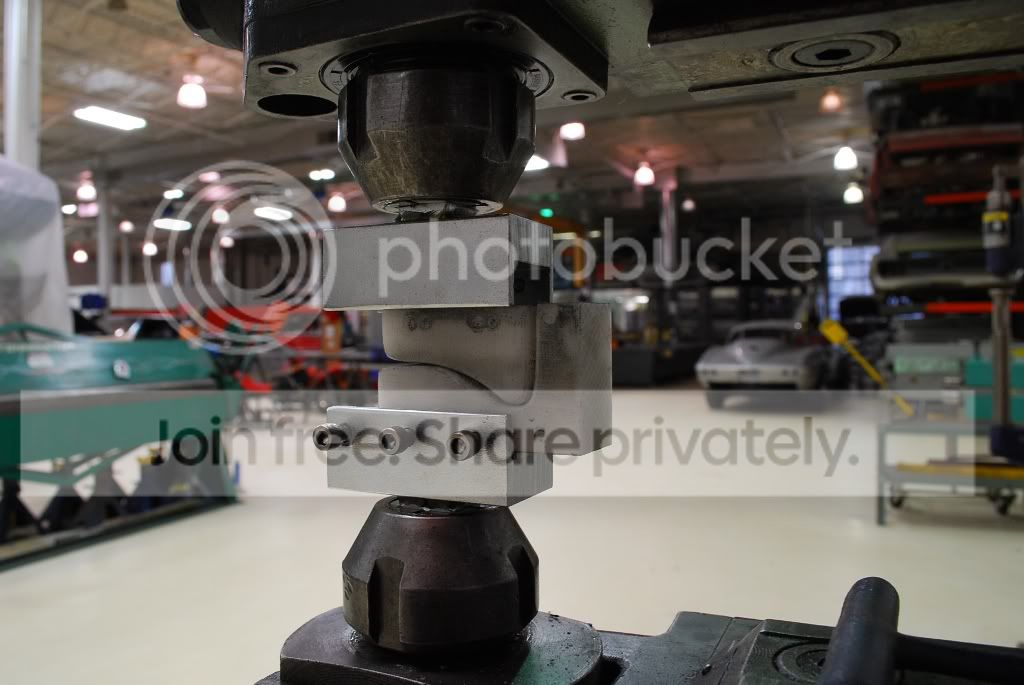

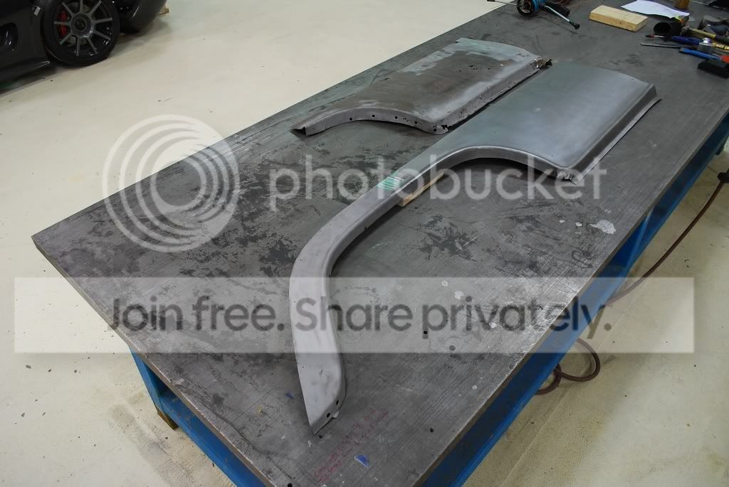

We are just about finished with the passenger side quarter panel as well. Here are a few shots along the way showing the progress.
We started by making a set of dies for the Pullmax to duplicate the lower bead in the suburban body line.
http://i563.photobucket.com/albums/s...ture221714.jpg
http://i563.photobucket.com/albums/s...ture221717.jpg
We then created the main panel section to replace the rotted out areas. here is it test fit over the existing rust.
http://i563.photobucket.com/albums/s...ture221530.jpg
A rear section was then shapped to form the leading edge of the wheel opening.
http://i563.photobucket.com/albums/s...ture221547.jpg
Once the fitment was finalized, the two new panels were welded togetehr to create a single panel.
http://i563.photobucket.com/albums/s...ture221600.jpg

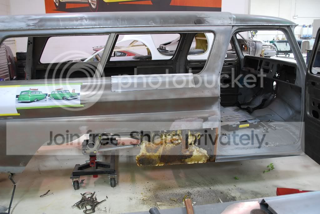

Roadster Shop 02-10-2012 03:06 PM

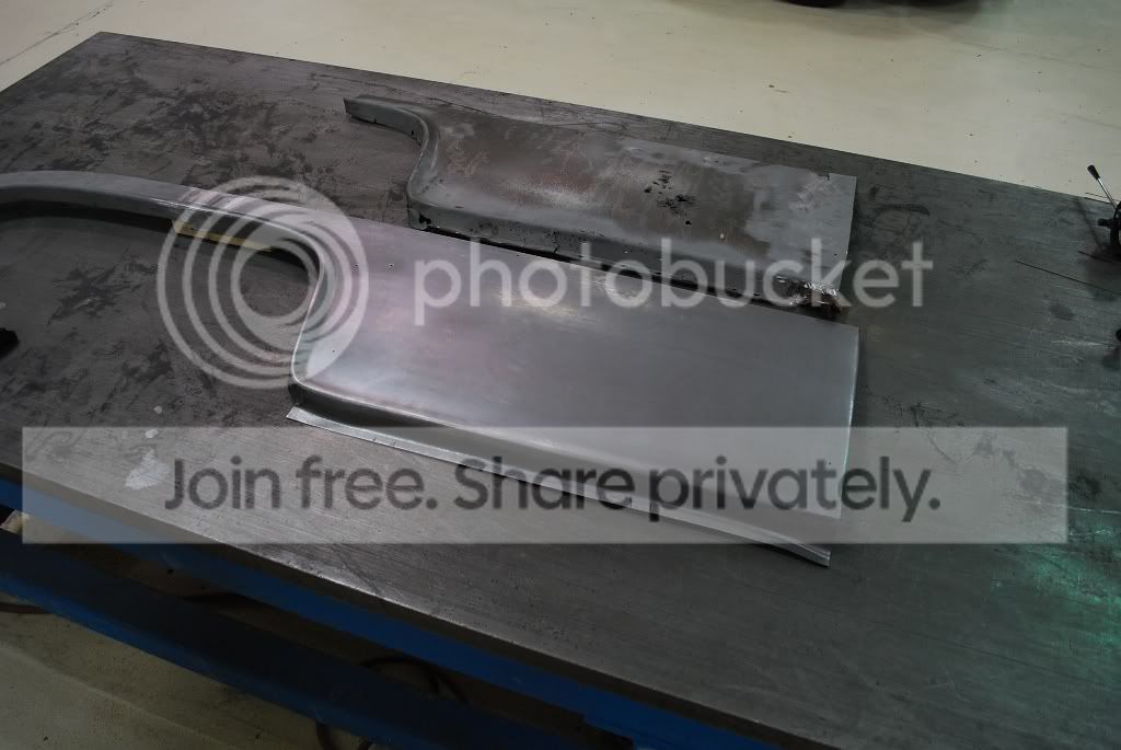

The rotted out section was then cut off the truck to reveal a nice foam inner quarter. I think this thing would have easily float with all the foam that we found inside!
http://i563.photobucket.com/albums/s...ture221672.jpg
The original panel next to the new panel. The new panel has the rear section of the original wheel opening attached to it. The center wheel opening portion of the new panel was lengthened to accommodate for the stretch in the wheel opening that we did on the other side of the truck.
http://i563.photobucket.com/albums/s...ture221682.jpg
http://i563.photobucket.com/albums/s...ture221685.jpg
The new panel being welded in place. We should have it all metal finished out early Monday.
http://i563.photobucket.com/albums/s...ture221700.jpg

Musclerodz 02-10-2012 07:23 PM
What plastic is that dye made from? Delrin or something harder?
This was made out of Delrin since it will only be used for 1 or 2 panels.

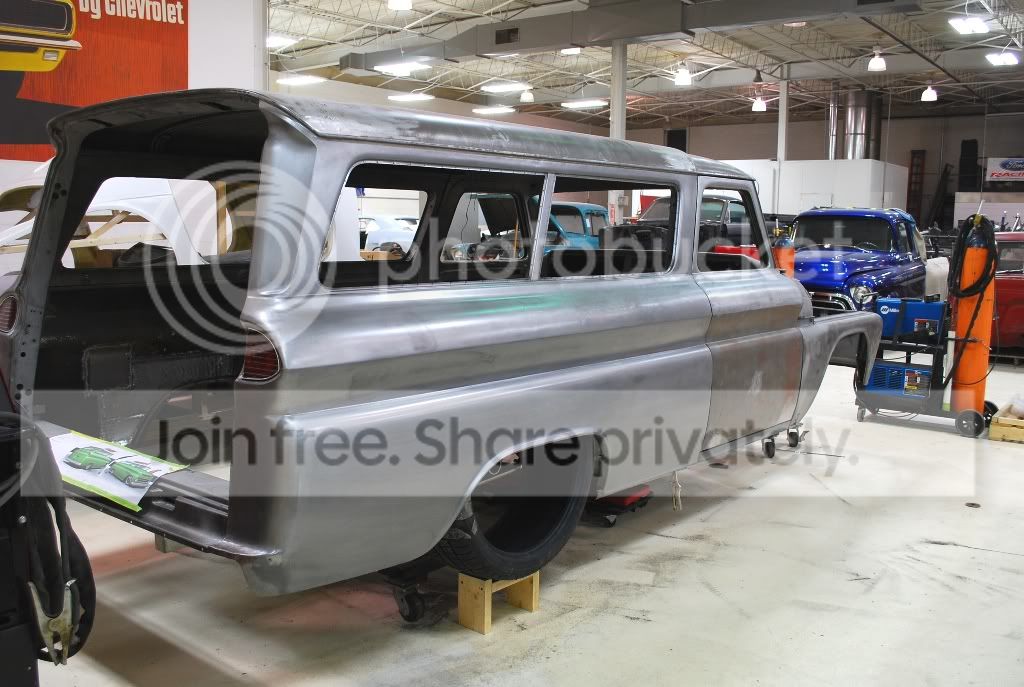

Roadster Shop 02-15-2012 05:43 PM

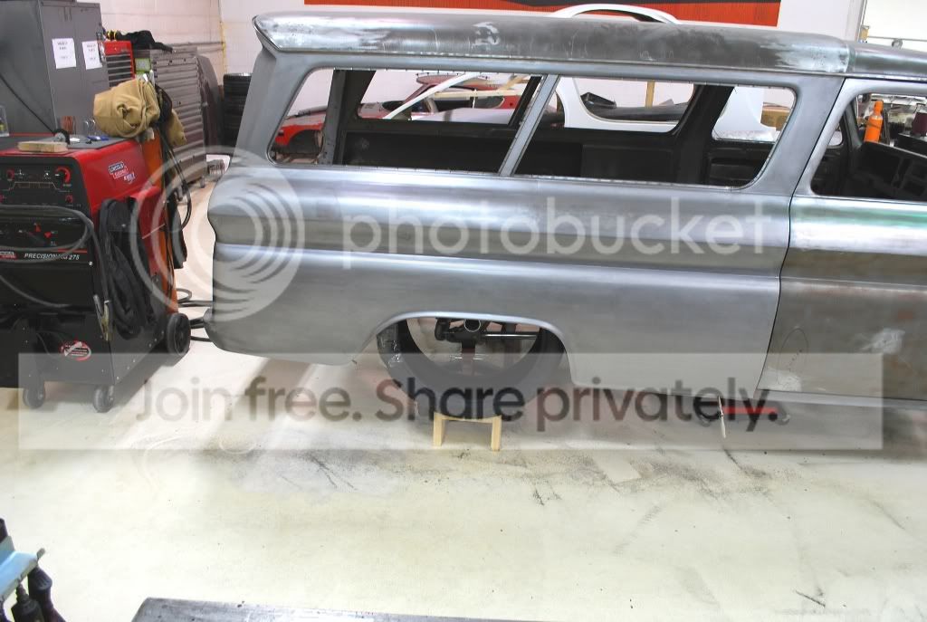

Further metal work.
http://i563.photobucket.com/albums/s...ture221815.jpg
http://i563.photobucket.com/albums/s...ture221859.jpg
Quarter panel completed:
http://i563.photobucket.com/albums/s...ture221872.jpg
http://i563.photobucket.com/albums/s...ture221875.jpg

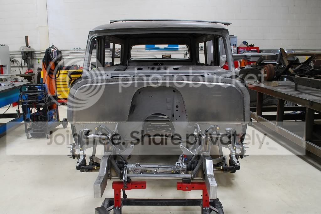

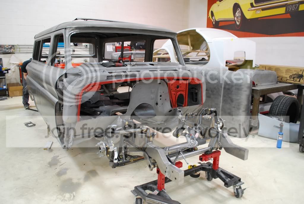

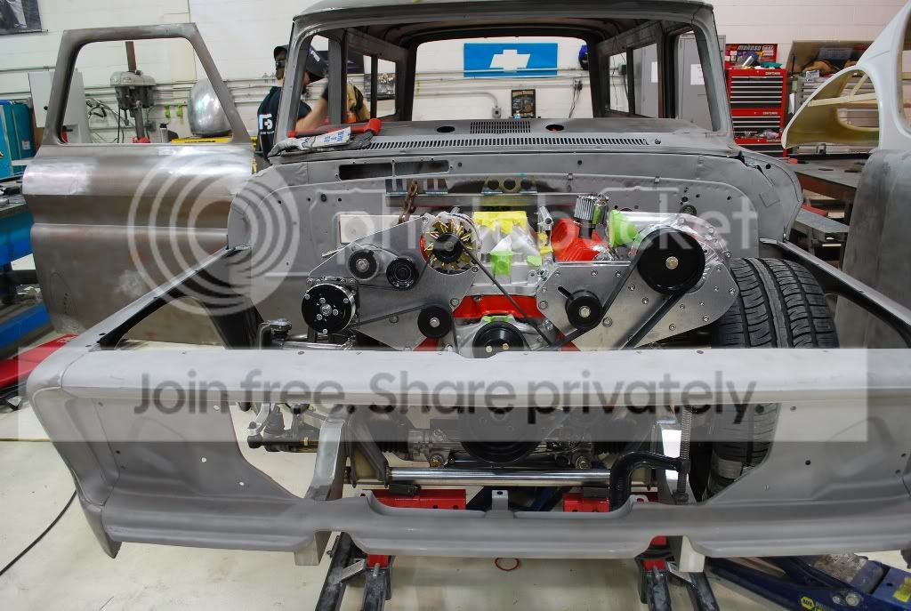

Also dropped the motor in, fabbed motor mounts, and began cutting out the floor for for trans clearance.
http://i563.photobucket.com/albums/s...ture221855.jpg
http://i563.photobucket.com/albums/s...ture221876.jpg

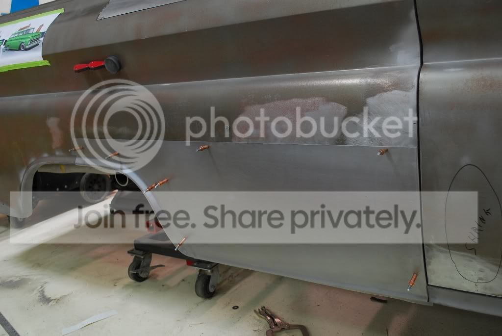

Roadster Shop 02-25-2012 09:20 AM

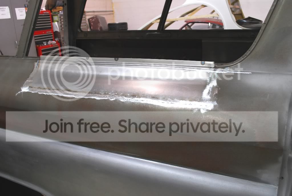

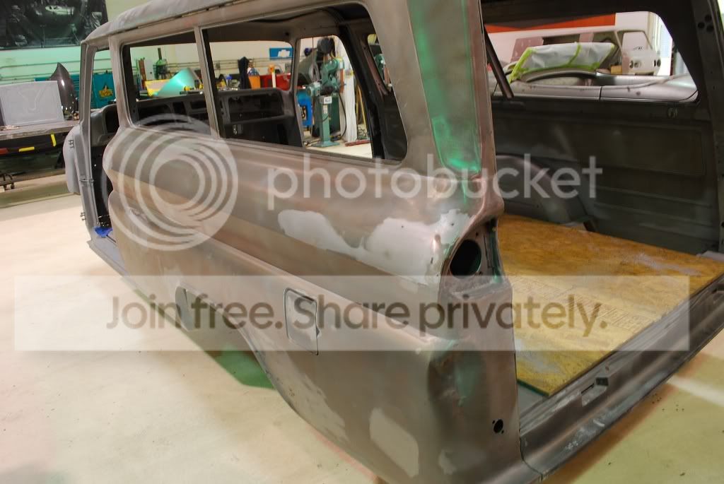

More progress on the truck this week. We finished the passenger side door metal work, installed the new inner and outer rocker and patched a few small holes in the floor. Then began on the firewall by cutting out the original sides and fabbing new flat sections.
http://i563.photobucket.com/albums/s...ture221922.jpg
http://i563.photobucket.com/albums/s...ture221924.jpg
http://i563.photobucket.com/albums/s...ture221935.jpg
http://i563.photobucket.com/albums/s...ture221957.jpg
The center recess was then smoothed and holes were filled. The firewall was final welded and metal finished. I'll try to get a few pics of that next week when we can open the hood again.

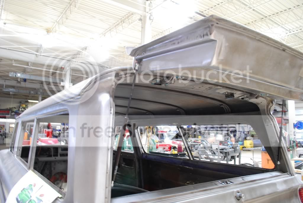

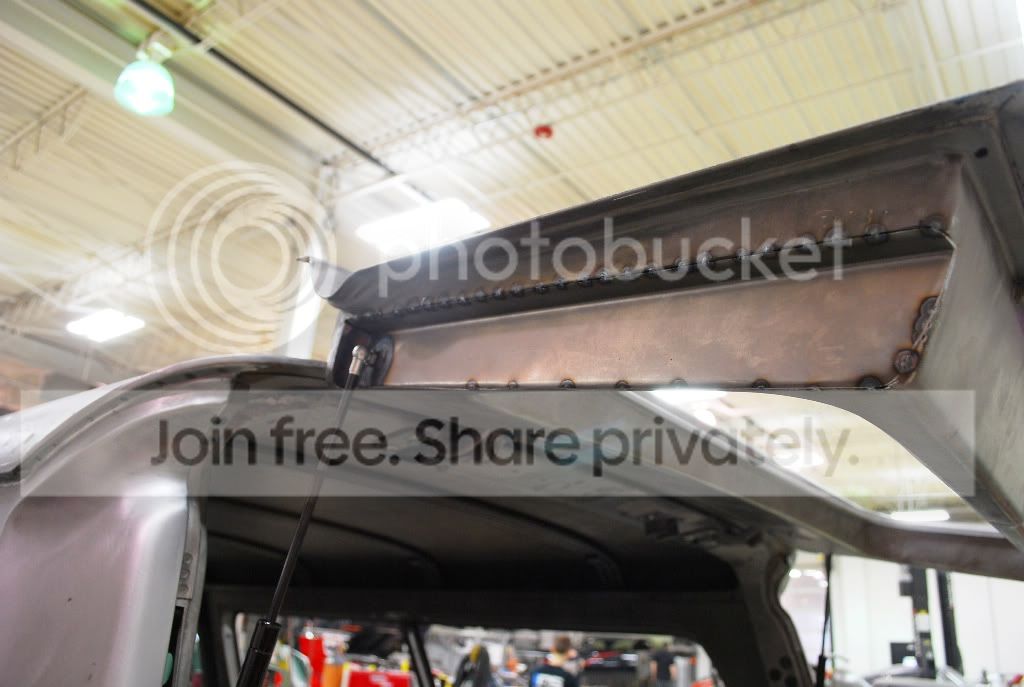

On the rear of the truck, we have the upper and lower tail gate fitted. On the upper portion we removed the stock supports that are pretty weak and rattle around. We pocked the tailgate hatch and installed gas support shocks.
http://i563.photobucket.com/albums/s...ture222032.jpg
http://i563.photobucket.com/albums/s...ture222070.jpg

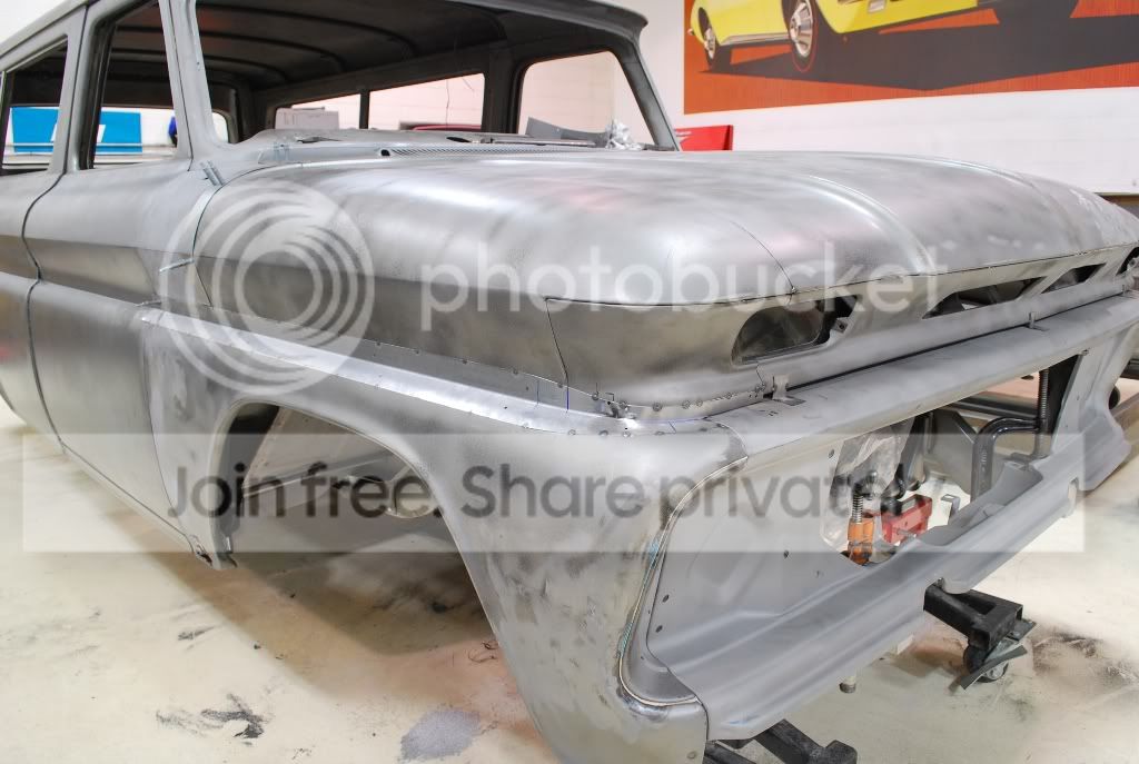

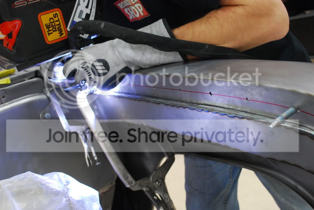

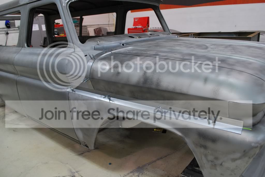

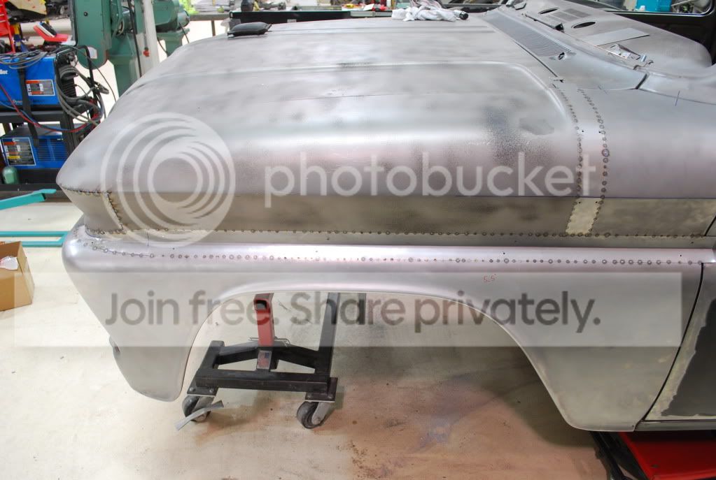

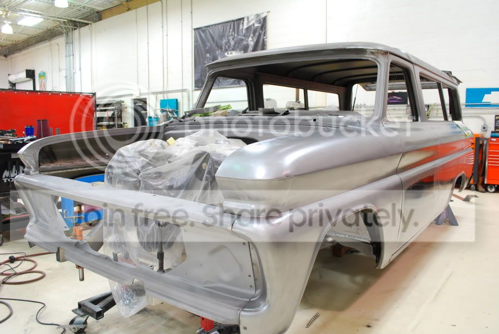

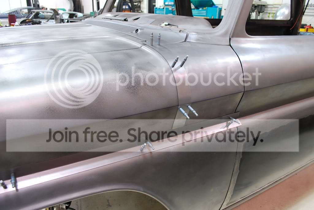

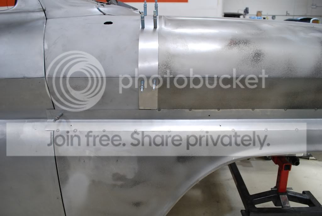

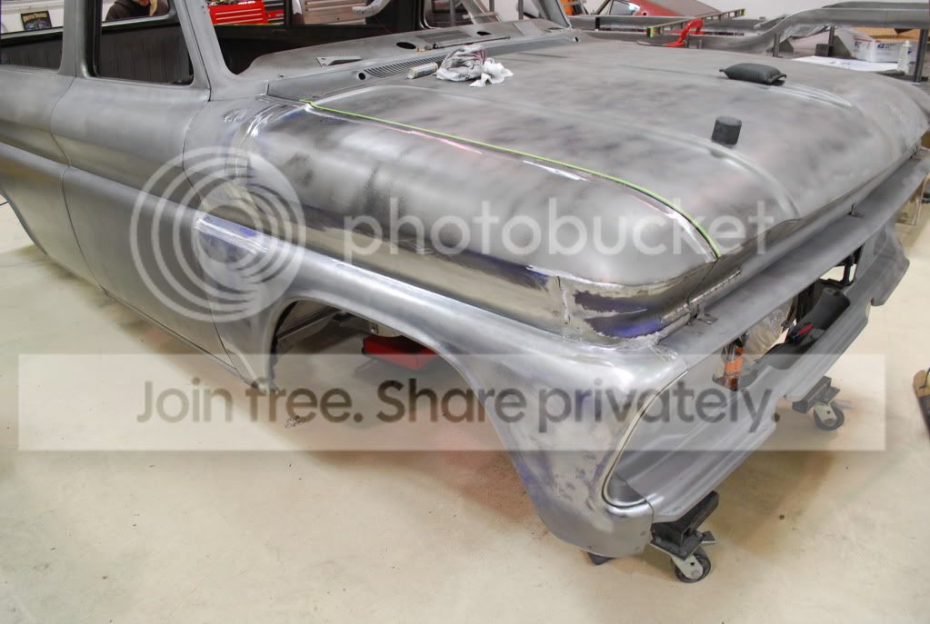

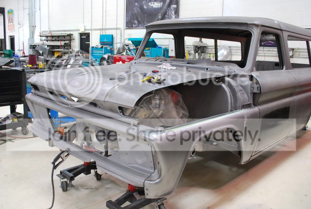

The front of these trucks cause a lot of issues when sitting them low and running taller tires. The hood makes up the top of the fender on these trucks and there is a thick flange where the hood meets the lower fender section. This flange leaves no room for tire clearance unless the tires are sucked way in. We decided to split the hood and make the fender more like any other vehicle where it goes all the way up to the top of the door. This will also get rid of a lot of the unnecessary gaps in the front end of this truck.
Started out by fabbing filler strips to eliminate the gaps and weld the fender to the hood as well as the cowl side to both the hood and fender.
http://i563.photobucket.com/albums/s...ture222045.jpg
http://i563.photobucket.com/albums/s...ture222048.jpg
The hood and fender were then cut along the filler strip and the material between was removed. The filler strip was then tacked into place making the fender, and hood one piece.
http://i563.photobucket.com/albums/s...ture222061.jpg
The side portion of the hood was then cut away from the center so that it could form the top of the fender.
http://i563.photobucket.com/albums/s...re222062-1.jpg
Still have to finish the cowl to fender and cowl to hood filler on Monday. For now the filler strip is held in place. The goal is to make this look like the truck came from the factory this way.
http://i563.photobucket.com/albums/s...ture222069.jpg

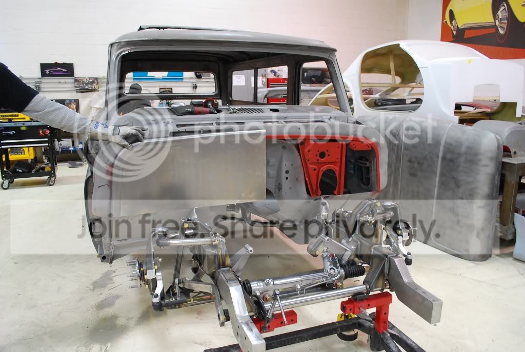

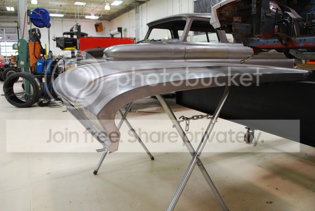

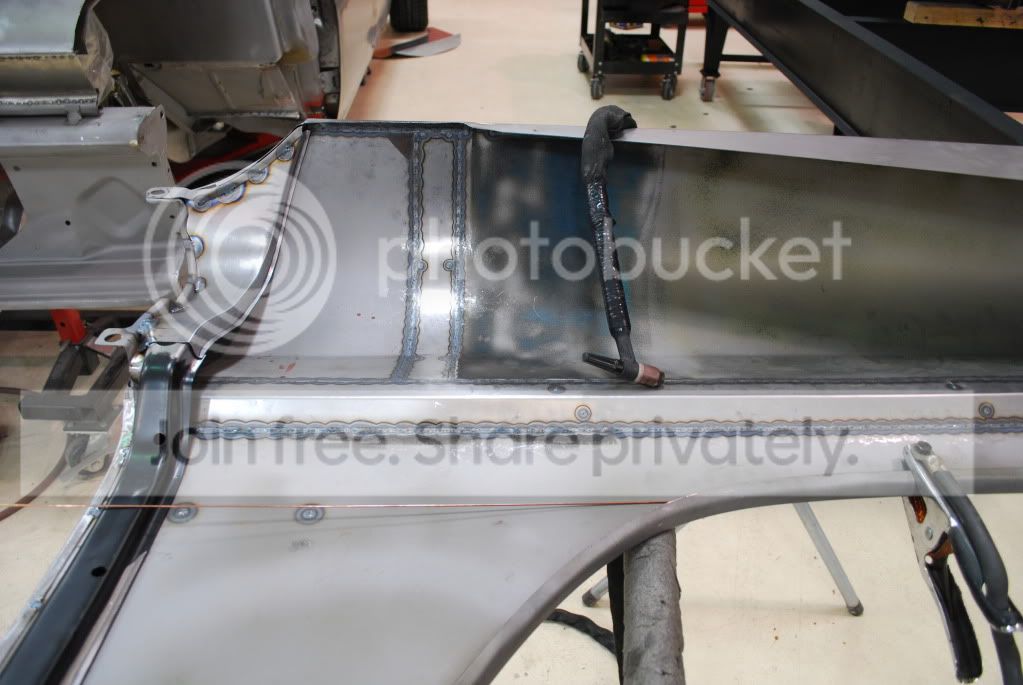

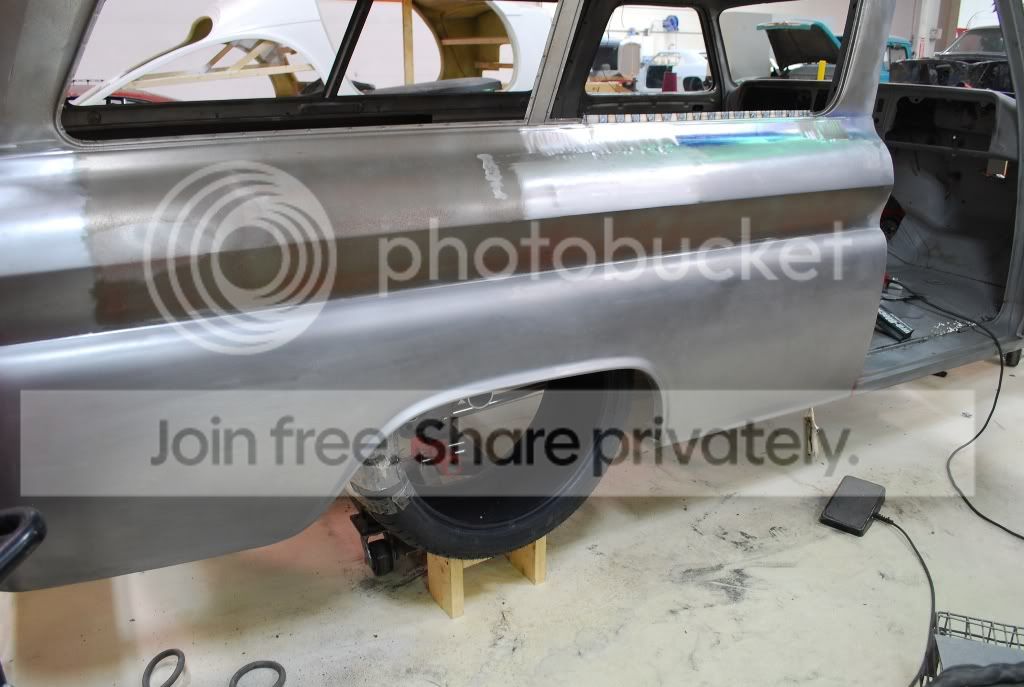

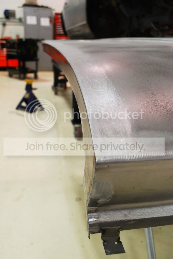

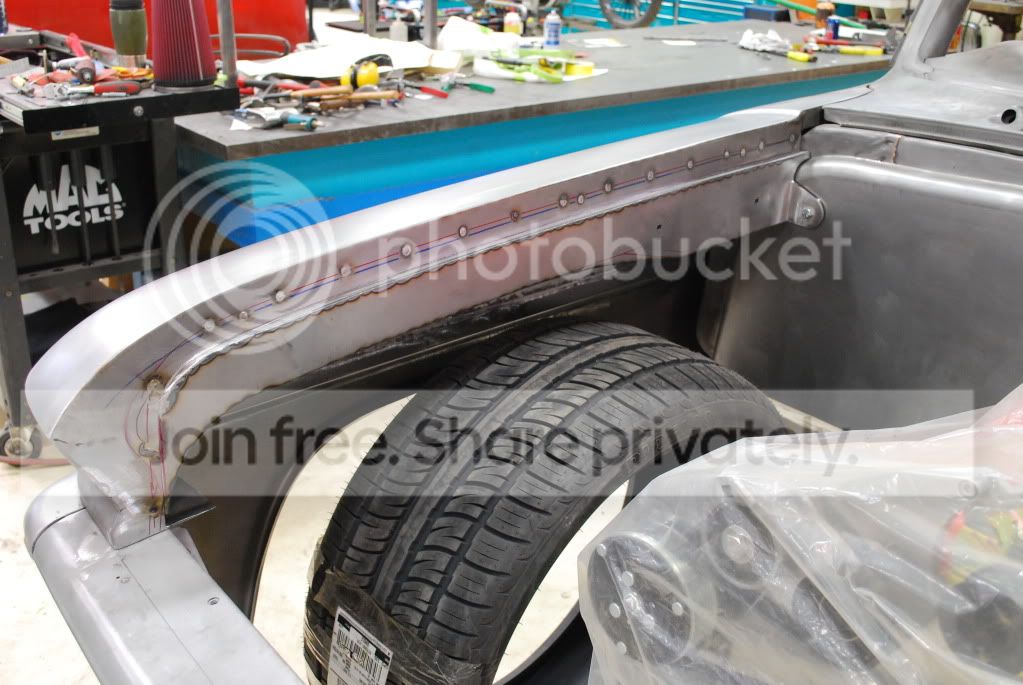

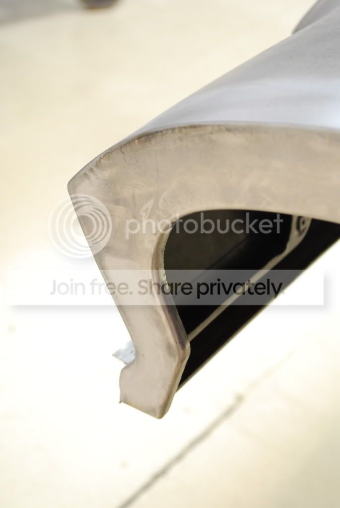

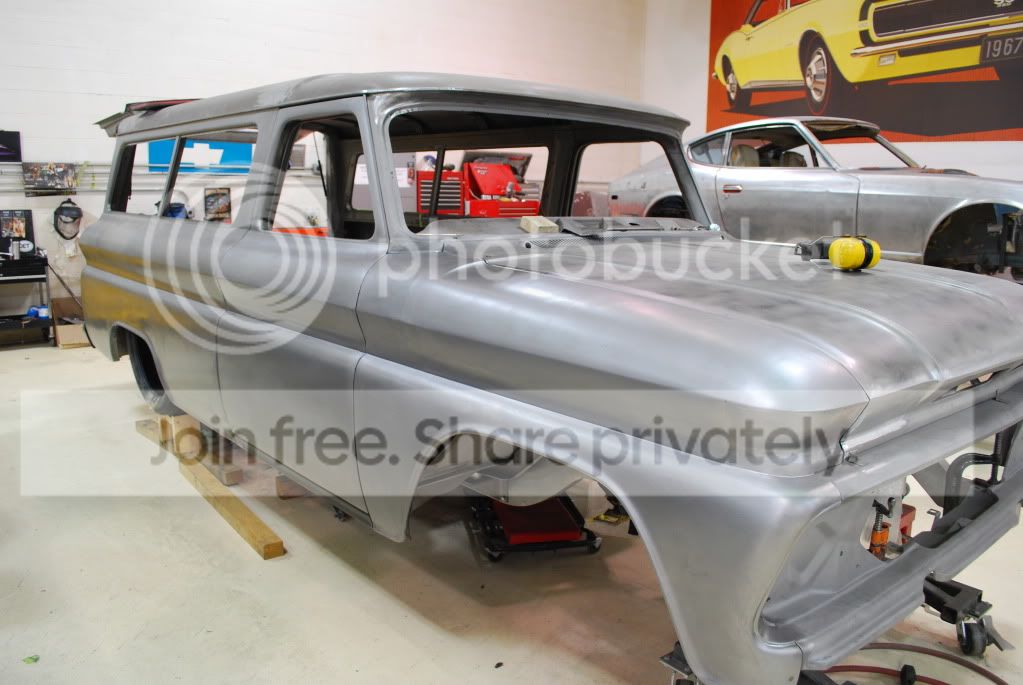

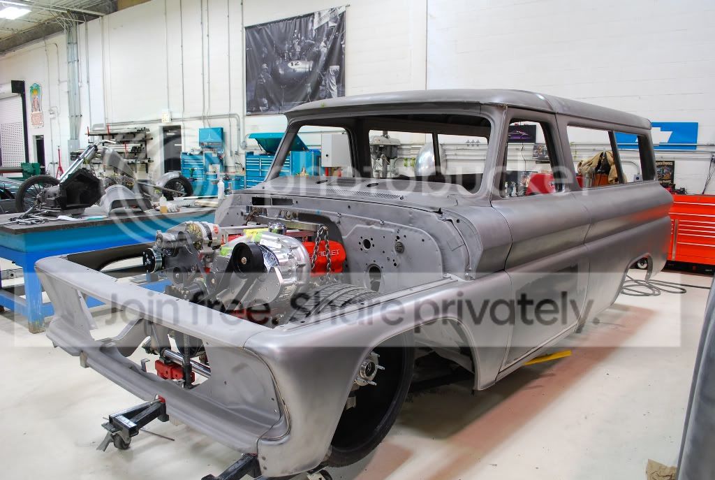

RS-Chris 03-14-2012 02:48 PM

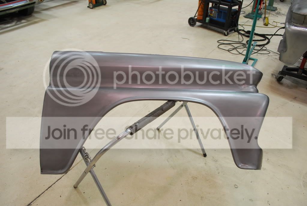

A few more updates on the Suburban:
This shot gives you an idea how much added height we will get above the wheel opening by integrating the old hood side into the fender:
http://i563.photobucket.com/albums/s...ture222072.jpg
Integrating blend pieces -
http://i563.photobucket.com/albums/s...ture222085.jpg
http://i563.photobucket.com/albums/s...ture222080.jpg
http://i563.photobucket.com/albums/s...ture222165.jpg
http://i563.photobucket.com/albums/s...ture222110.jpg
http://i563.photobucket.com/albums/s...ture222109.jpg
http://i563.photobucket.com/albums/s...ture222159.jpg
http://i563.photobucket.com/albums/s...ture222288.jpg

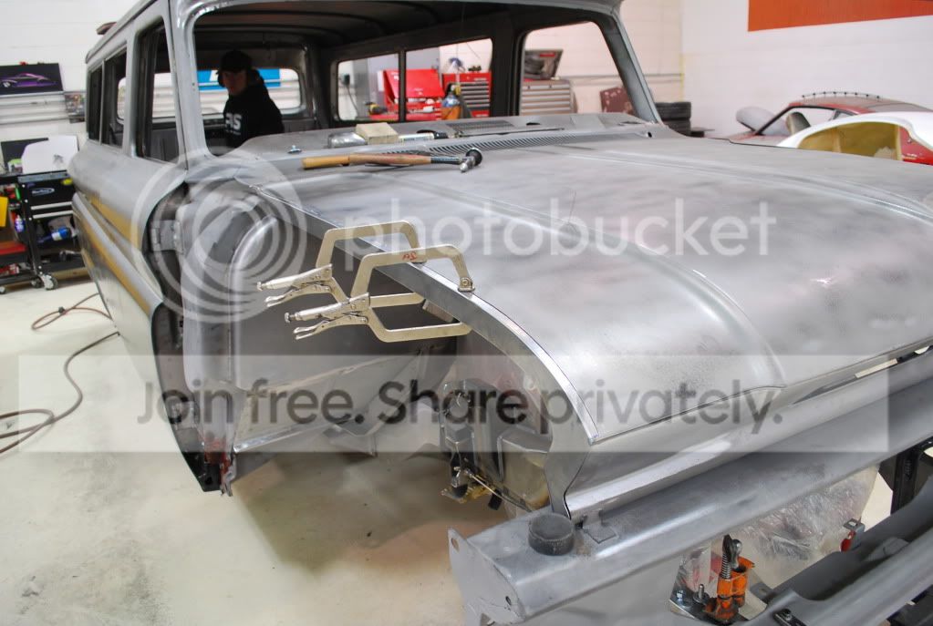

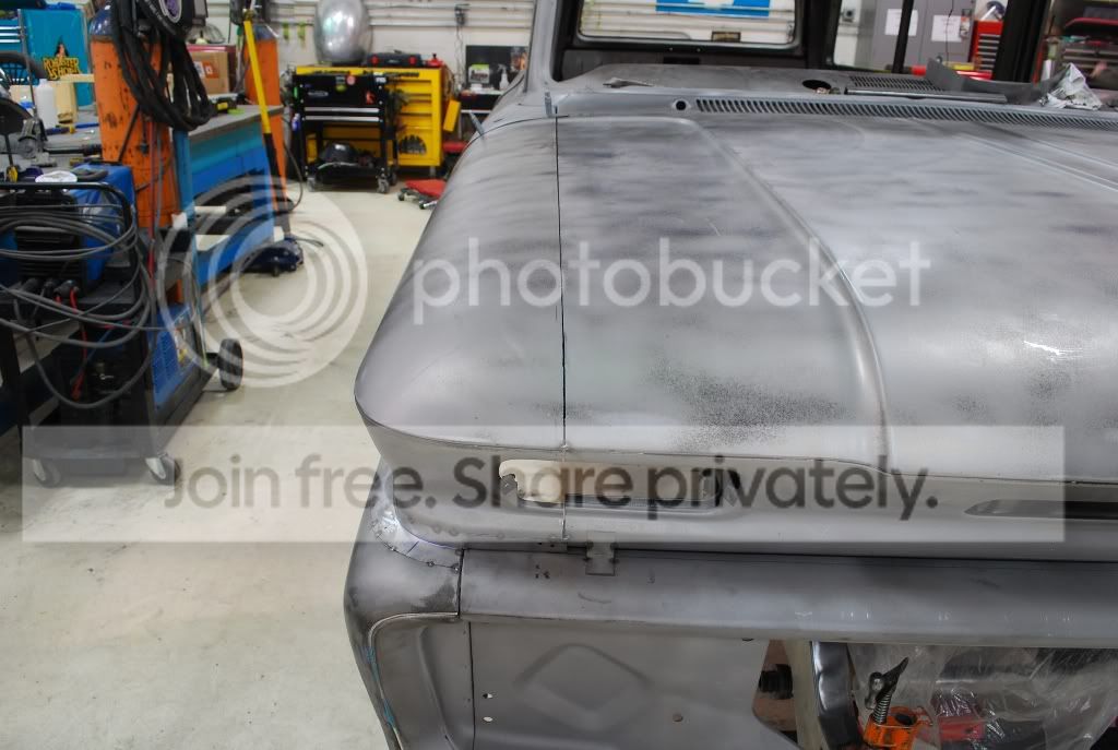

RS-Chris 03-14-2012 02:49 PM
The open hood sides are capped and the structure is modified to work with the new edge.
http://i563.photobucket.com/albums/s...ture222104.jpg
http://i563.photobucket.com/albums/s...n/DSC_0026.jpg
http://i563.photobucket.com/albums/s...n/DSC_0025.jpg
http://i563.photobucket.com/albums/s...re222290-1.jpg

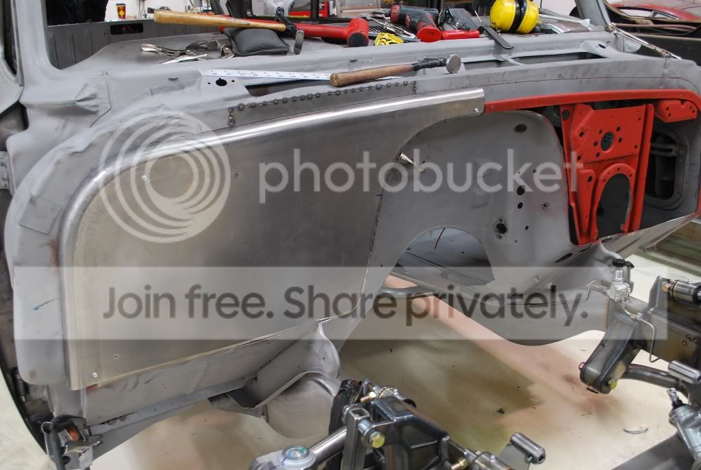

With the hood set, work begins on the fender inners, adding a structural profile for strength and a more 'finished' factory look.
http://i563.photobucket.com/albums/s...n/DSC_0022.jpg
http://i563.photobucket.com/albums/s...n/DSC_0024.jpg
