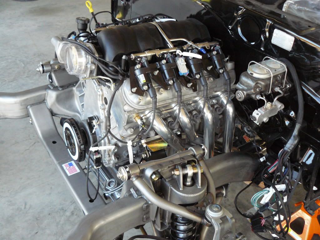

Thanks Jeremy went with Hookers in DSE sub with 1.5" setback motor mounts,works great.http://i1192.photobucket.com/albums/...9/P1000640.jpghttp://i1192.photobucket.com/albums/...9/P1000574.jpgthis is on the last car I had I also used the Hookers on stock sub with 1.5" setback motor mounts and they work great and F body oil pan clears.http://i1192.photobucket.com/albums/...bbed69/030.jpg
randy 05-01-2013 01:11 PM
what crossmember did you use on the dse subframe?
tubbed69 05-01-2013 01:51 PM
I used the crossmember from Keisler Engineering,ran the TKO 600 in the last 3 cars I built and bought entire kit from them,very nice product,crossmember is cut out nicely for exhaust.I dont know if this pic will help,if not let me know I can get better pics for you.http://i1192.photobucket.com/albums/...9/P1000639.jpg
