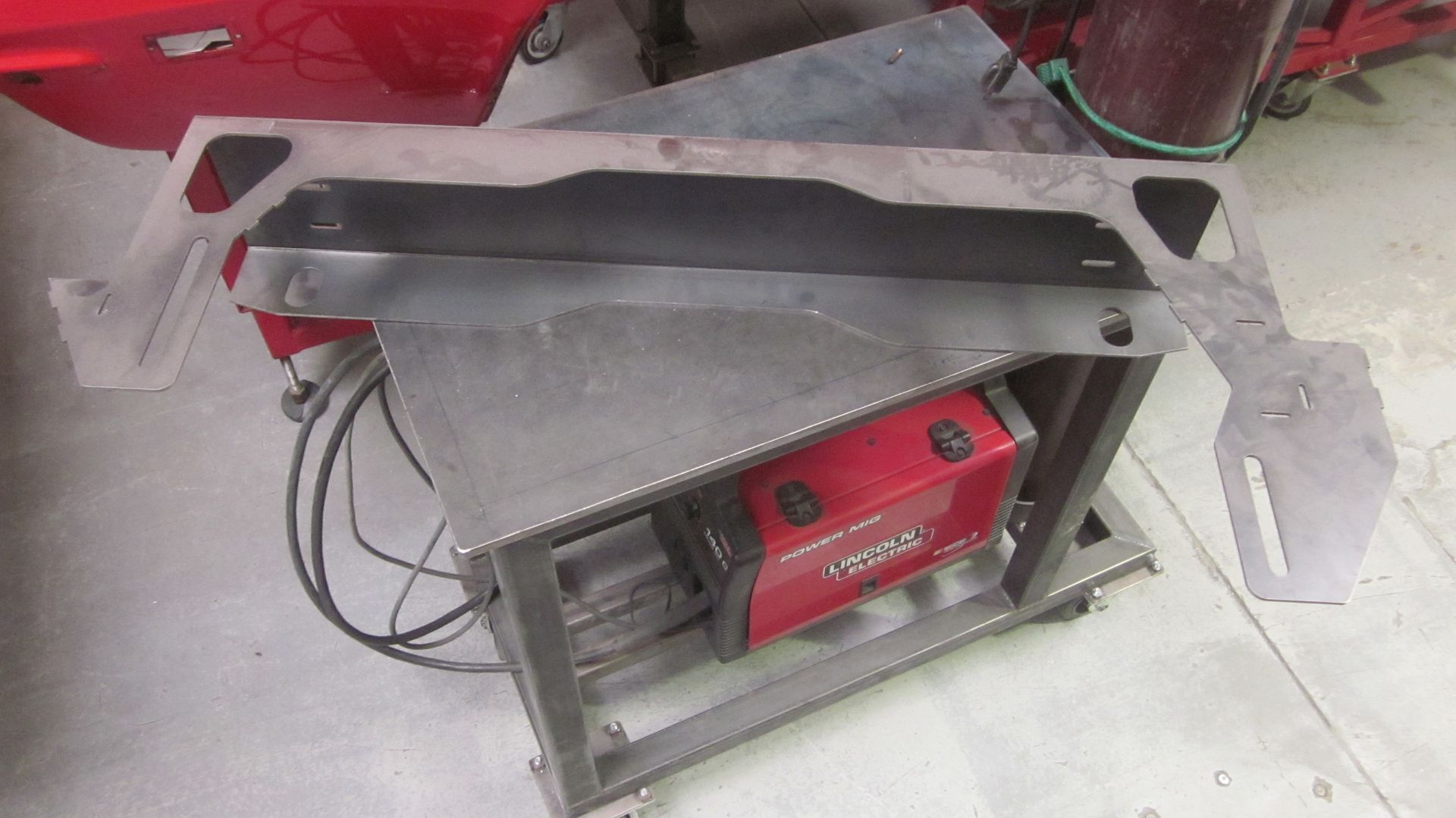

Small update... I did not like the first set of frame rails we did .. we decided to re-do them to match what we already had designed for the Mustang rear 3-link clip.. plus we have sub-frame connectors...
http://i1015.photobucket.com/albums/...n/IMG_2576.jpg
http://i1015.photobucket.com/albums/...n/IMG_2575.jpg
http://i1015.photobucket.com/albums/...n/IMG_2580.jpg

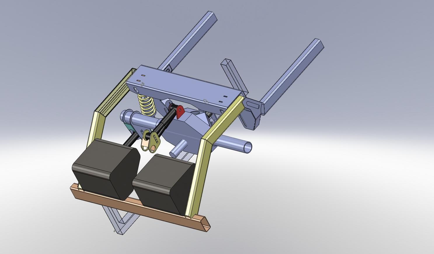

This is what I am thinking about for my gas tank.. dual cells in front of the axle.. down side it will only hold 10 gallons of fuel..
Carl C from Vaporworks will pay us a visit this week to discuss my idea...

syborg tt 08-28-2012 12:27 PM
Chris I love the dual tank idea. I have alway's hated the time bomb in the back of these old cars.
Lotus has a similar set up and I had considered using it on the 70 but I didn't want to sacrfice the rear seat. If you cut in the rear seat area you might be able to get a few more gallons. heck if your running a LS and get two 6 gallon tanks you would still get close to 200 miles out of the tanks which is simlar to my Wonderful 5.3 Tahoe.

OLDFLM 08-28-2012 01:43 PM
What about a tank that would go over the hump in the back seat? That should get you a couple of more gallons... or just go bigger and make the back seat a "shelf"... just thinking out loud.
Cris@JCG 08-28-2012 07:57 PM
Purpose for putting the gas tank in front of the axle is to distribute the weight towards the center of the car.. & maintain the center of gravity in the middle.. Plus I don't want all that weight swinging back their.. With a LS motor I will get decent gas milage... Just got a new LS3 crate motor!

Autokraft 08-28-2012 08:17 PM
C5 vettes have dual tanls in the same location. Looks great Chris
SLO_Z28 08-29-2012 10:39 PM
^This. Id be willing to bet if you fabbed it right you could even run the C5 pumps. Ill have to run by and talk about it, lord knows ive changed about 500 or more fuel pumps in C5's. This is actually a very cool, and good design for a number of reasons.
Garage Dog 65 08-30-2012 05:34 AM
New Caddy and new Camaro also use the C5/C6 concept with a much better pump/bucket/sump idea. Pontiac G8GT uses same. Vaporworx kit uses the same camaro pump. Carl will hook ya up with the best info.
Jim
Cris@JCG 08-30-2012 06:58 AM
2005 Mustangs have the same concept but it is on one tank.. I had already been talking to Carl about this.. Basically said don't worry about it.. we will get it to work.. I have the whole idea in my head by now got to get fabricating the the tanks... We will build the tank out of aluminum...
Here is one we built for the 70 Mustang..
http://i1015.photobucket.com/albums/...n/IMG_2469.jpg

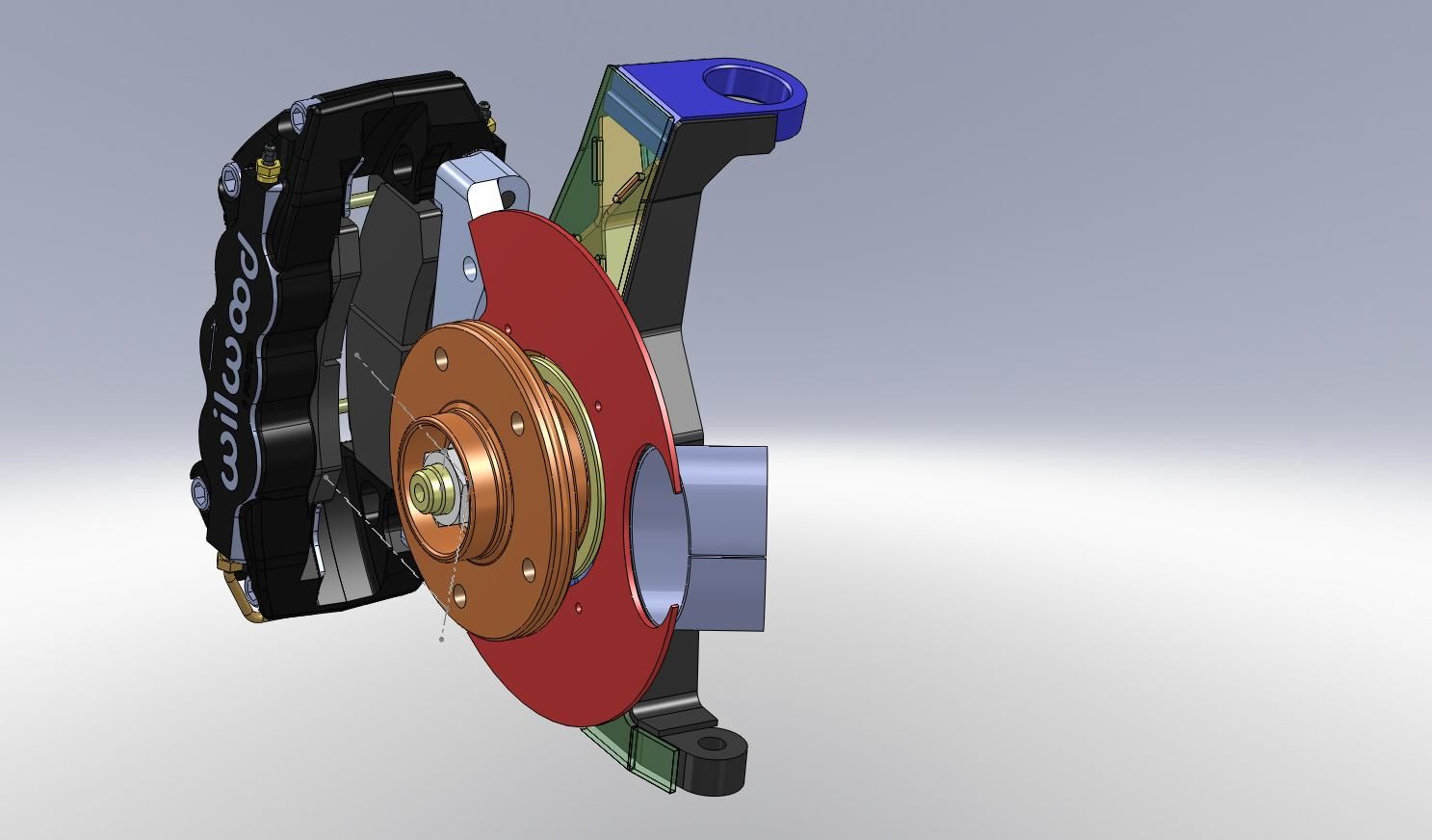

Cris@JCG 10-25-2012 07:04 PM

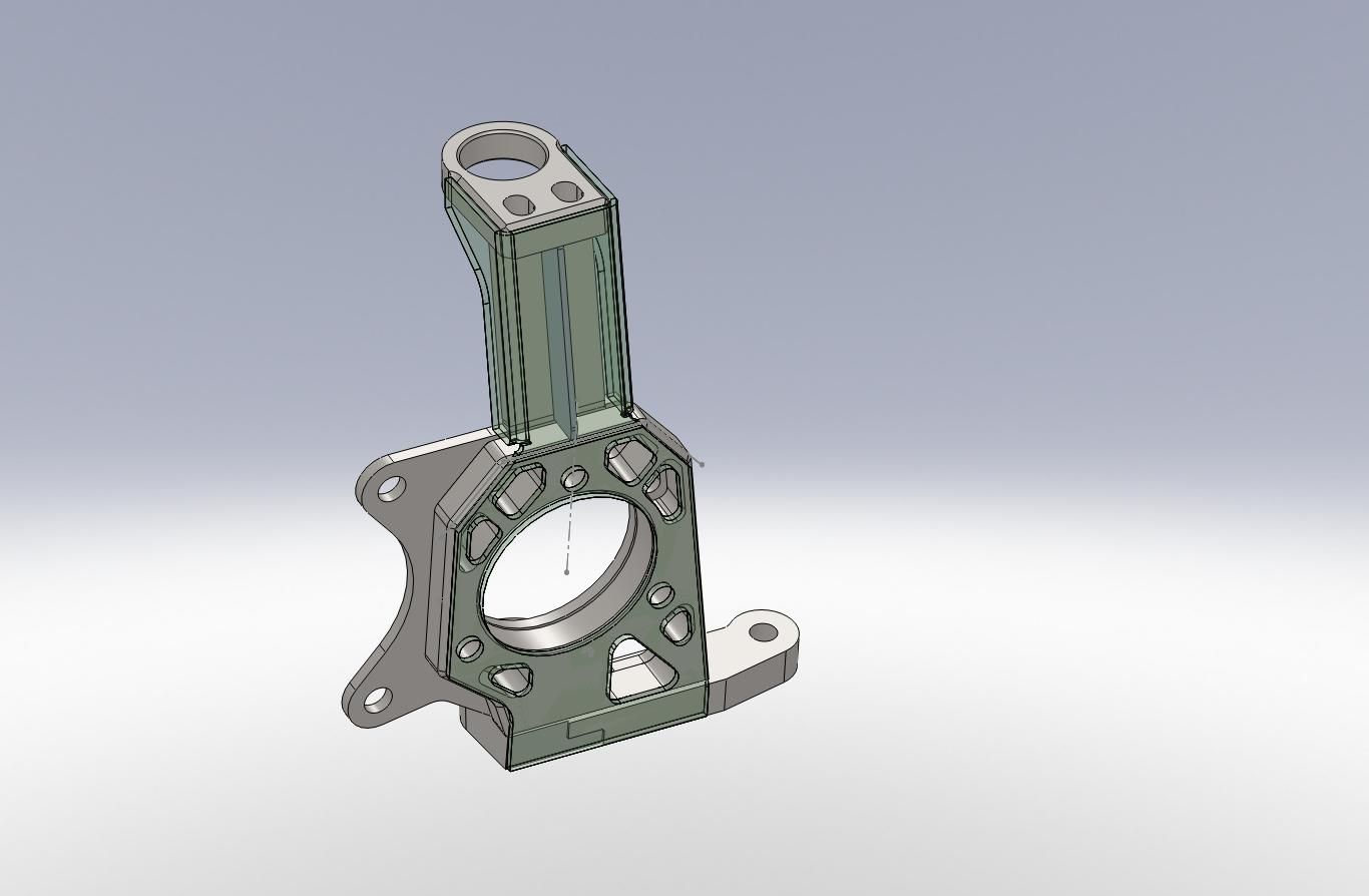

One of the key pcs to my front suspension is the use of the C6 Corvette upright.. So I sat down & did a cost analysis of what all the components were going to cost me to buy & machine.. not cheap.. So we are making our own upright.. steering arm will be built into it, dual taper serviceable hub bearings, our own hub, & provisions for rotor ducting.. Currently my engineer is working doing a FEA & analysis.. Then my machinist will look @ the design for cost & optimization..
http://i1015.photobucket.com/albums/...hine_Assem.jpg
http://i1015.photobucket.com/albums/...ab-Machine.jpg

Another version of our upright with the steering arm built into it.. this what we will building the next few weeks... Plus I got this crazy idea that I will be working on soon for this upright.. all I am saying right now is welded GN snouts!!
http://i1015.photobucket.com/albums/...ne_Assem-4.jpg

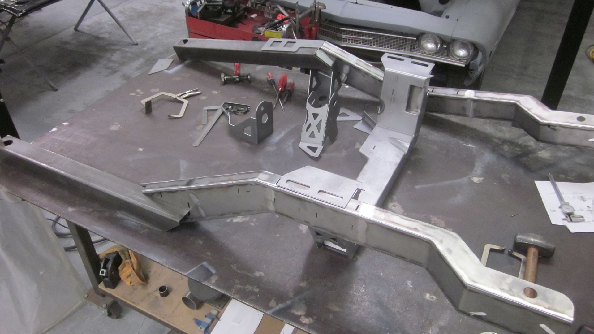

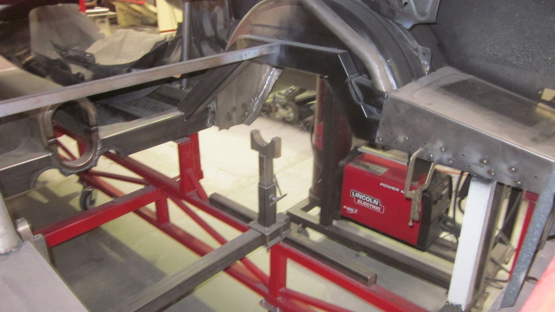

Currently we are building revision 2 on the sub-frame... Got the rear suspension components cut... got some tub & trunk work done...
http://i1015.photobucket.com/albums/...n/IMG_2853.jpg
http://i1015.photobucket.com/albums/...n/IMG_2854.jpg
http://i1015.photobucket.com/albums/...n/IMG_2855.jpg

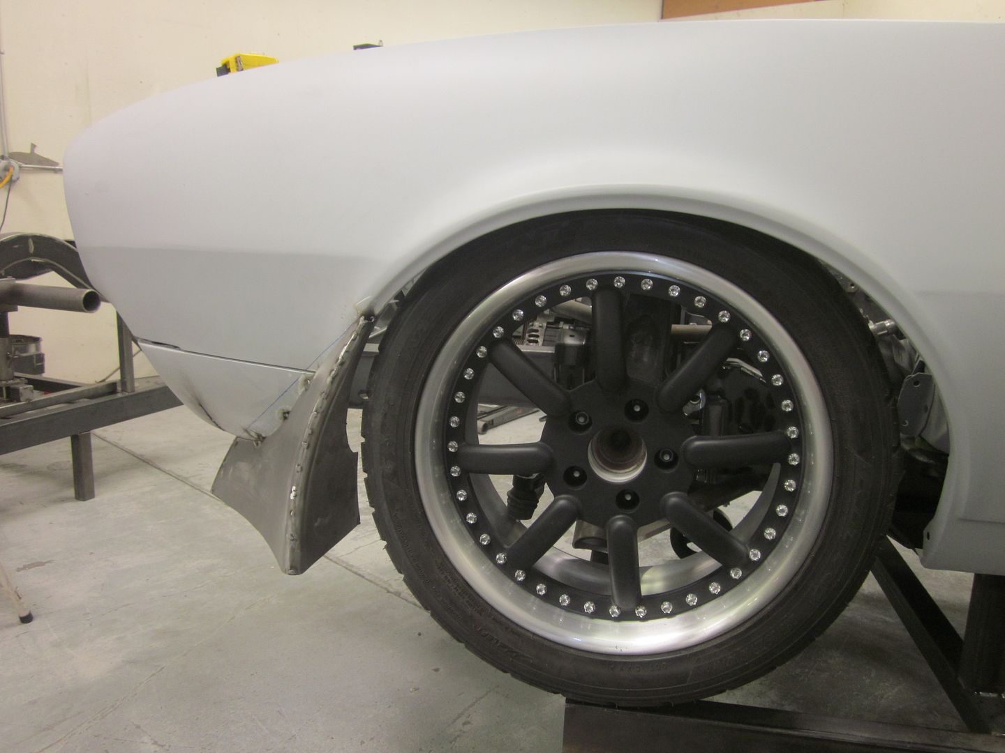

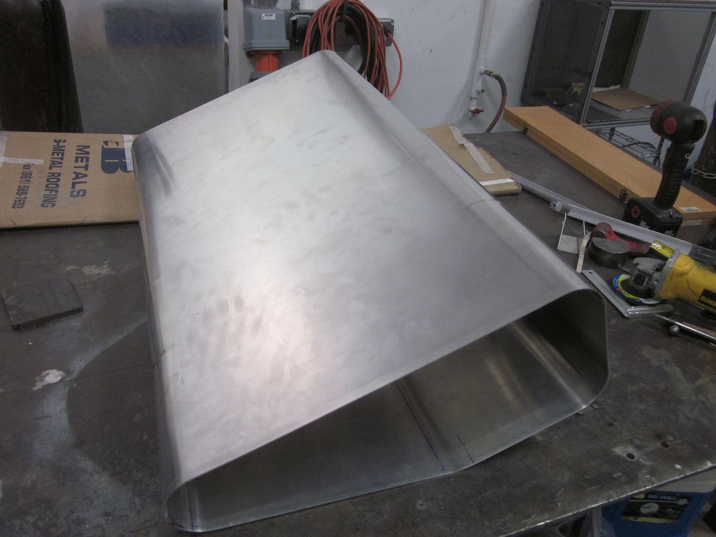

Today's project.. Still have lots more ahead of use but will be worth it in the end.. The fender extensions, spoiler, & splitter will me out of some composite material.. these are just the molds.. Borrowed this 67 for mock up!
http://i1015.photobucket.com/albums/...ps161a42ae.jpg
The challenge is doing the transfer from the extension to the spoiler.. end goal is to just run the spoiler by itself or with the splitter...
http://i1015.photobucket.com/albums/...ps98ca9be5.jpg

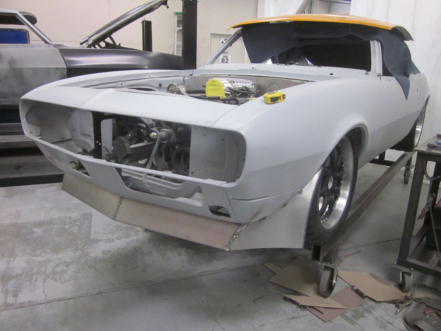

Todays status... My number priority is the function of the spoiler.. We kinda used what they did on a 70 Trans Am... But the goal was to deflect the air away from the tire...
http://i1015.photobucket.com/albums/...n/IMG_3033.jpg
http://i1015.photobucket.com/albums/...n/IMG_3035.jpg

carbuff 01-07-2013 02:36 PM
I'm not sure if I'm aerodynamically knowledgeable enough to crticize, but I'll try anyway... ;)
Aren't you going to be adding drag by flaring the spoiler out away from the car? In other words, wouldn't it be better to have reverse the curve such that it was rounded towards the tire instead of out and away from the car? If seems like if it was a curve towards the tire then it would help direct the air down the side of the car.
By doing it the way in which you have, you will create a turbulent spot behind that spoiler right there at the tire. I don't know if that creates any kind of problem, but at a bare minimum, flowing air right down the side of the tire could only help in at least removing heat from the braking area, right?
Just a thought after looking at the picture... Can you educate me otherwise if I'm completely off base please? :)
Cris@JCG 01-07-2013 03:01 PM
Take a look @ this attached picture... & see if you can envision how it is deflecting & & creating down force.. I will come back later tonight to answer your questions..
http://i1015.photobucket.com/albums/...rvette_z06.jpg
syborg tt 01-07-2013 03:41 PM
I learned alot for Troy when they took Blowfish to the Wind Tunel and what they thought would work didn't and what they ended up with was about a 1/16 of what they started with. In the end the only way anyone will know if a front air dam, spoiler or rocker skirts work is to get the car in a wind tunnel. Which is very very expensive.
In the case of the Blow Fish - less was better.
However on a Side Note: I really like the look and can't wait to see it in Carbon Fiber.
dontlifttoshift 01-07-2013 03:51 PM
My understanding was that the air around the tire was so turbulent that it was worth the drag penalty to direct the air around the tire. This was touched on in the reinventing OLC thread a little. Everything you said makes perfect sense, though.
