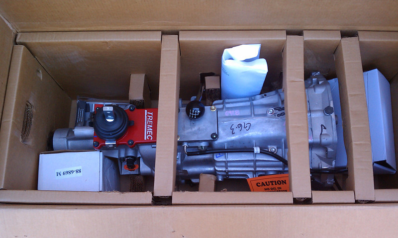

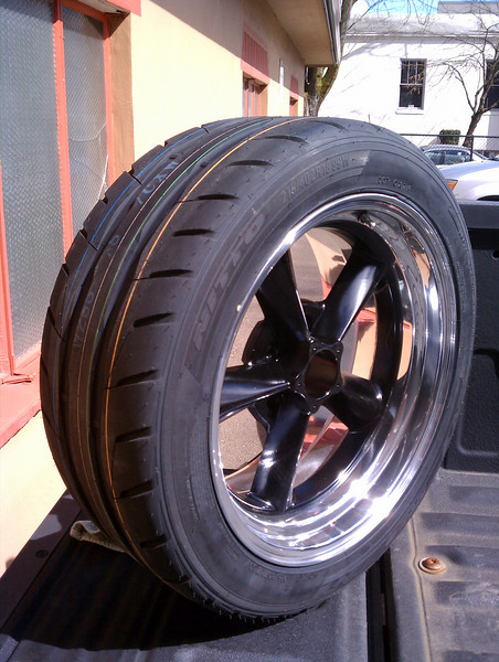

So I've added the go-fast wheels and tires, Ricky Bobby alignment, T56 transmission, and racey spoiler so the car is feeling much improved and being driven a bit more aggressively…………..
