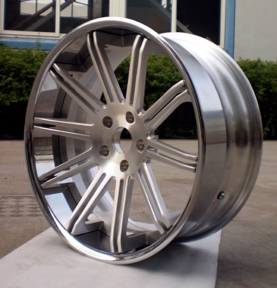

The wheels are rotiform blq
8x18 front and 10x18 rear
Pic of wheels here http://m.pinterest.com/pin/121597258659255149/

Rybar 12-07-2012 03:34 PM
Originally Posted by Amituk (Post 450564)
Thanks man.
On my iPhone so can't inline post
http://media-cache-ec5.pinterest.com...rMrjYZBp_f.jpg
Thoose look pretty sweet, seems like your putting alot of work into this car and only a 10" wide rear wheel? Might as well mini-tub while your there. :unibrow:

InfernalVortex 12-10-2012 05:07 AM
Those are more of those cookie cutter "made in the usa" wheels that are actually made in China and assembled here. Theres a bazillion Miami and California wheel importers making wheels like that and none are JWL or TUV approved. Be careful with those and inspect them for cracks regularly if you use them.
Some of the companies known to be a part of this are iForged, ADV.1, Cor, rotiform, Strasse Forged, 360 Forged, Sevas, New gen (yes, those too) etc. If you look through all their portfolios you will see the same wheels over and over. Rotiform is actually pretty unique, but you can tell they use the same wheel blanks and construction methods as all the other companies. Kind of a shame because tehyre very nice looking.
This is a COR ("Made in the USA") wheel that failed on a track car:
http://i1123.photobucket.com/albums/...bvRNZD5-XL.jpg
http://importgenius.com/importers/cor-llc
They import "rim components" from China, despite all their Made in the USA chest beating.
Anyway, back to rotiform, just in case you think Im making things up to stir the pot:
http://importgenius.com/importers/rotiform-llc
Shipper:
SHANDONG CHIRON AUTO PART CO.,LTD
HIGH-NEW TECH ZONE,DONGYIN CITY,SHA DONGYING,,CN 0086531-67808999
Consignee:
ROTIFORM,LLC
6382 INDUSTRY,WAY WESTMINSTER,CA926 WESTMINSTER,CA,92683,US 714372-362
Port of Loading
Ching Tao
Port of Discharge
Long Beach, California
Declaration of Goods
ALLOY WHEELS
Anyway, Im not saying they're bad wheels, but Im saying they're not tested to any kind of standard at all. Just keep an eye on them if you use them for any kind of track use, and dont count on any of those companies taking care of you if something happens. Cor changed their warranty after their infamous failure at a track day (on street tires).
http://jalopnik.com/cor-wheels/
Some very shifty things going on.
Heres some ADV.1 wheels with some really questionable standards:
http://www.m3post.com/forums/showthread.php?t=717258
Look through all those companies' wheels and you'll start noticing all the similarities. They all come from the same Chinese plant... the same 2 or 3 assembly methods, and looks like most come from the same 2 or 3 blank designs iwth the same "concave"ness to them.
http://rotiform.com/images/products/...ave_blq_19.jpg
http://i232.photobucket.com/albums/e...crapwheel1.jpg
http://i232.photobucket.com/albums/e...crapwheel4.jpg
http://www.adv1wheels.com/adv1wheels...on/ADV10DC.php

Thanks for the heads up. I didnt know this was the case! I will certainly raise it with rotiform.
Amituk 12-10-2012 07:44 AM
I spoke to Rotiform and this was their response.
"Not sure where that poster got his info but its incorrect. Our forged wheels are 100% USA made. Our blanks come from Alcoa. I cant speak for any of the other companies he mentions but you can rest assured you have the highest quality wheels and they exceed VIA, JWL and TUV specifications. You have nothing to worry about :)"
syborg tt 12-10-2012 08:16 AM

InfernalVortex 12-10-2012 10:12 AM
Not the first itme I've heard the "Oh they certainly exceed [whatever] certification!" line. If they are not JWL or TUV certified then its just lipservice. Many legitimate wheels are. BBS, HRE, Volk, etc. It's not hard to submit wheels for testing, although it costs a bit of money. Not super uncommon for a custom wheel company though, as they have to get wheels of every variety and size tested, so if you're selling custom wheels you can easily have 50-100 combinations that would have to be tested. But many custom wheel companies DO go through that kind of trouble, and its good peace of mind to me. HRE is JWL/TUV certified. CCW is not, so it just depends, no one is going to say CCW is second rate.
http://rotiform.com/contact_us.htm
The address in Westminster, CA is also correct here. 6382 Industrial Way.
This is the real clincher to me that made me suspicious. The trend I see is most of these companies taking advantage of "made in the USA" standards which basically mean if you bolt it together here, you can say it. Most of these places will only show pictures of their warehouses full of wheel parts, and pictures of them assembling wheels. You rarely ever see any of them actually machining their own wheels. HRE for example goes through a lot of trouble to show pictures (and videos) of their machining processes.
Rotiform's wheels are unique amongst these other companies, despite similarities in general shape, so I can beleive they actually do machine their own centers, but why there are import records showing parts from China is a mystery to me. maybe it's just centercaps or something? Or maybe its their 1 piece wheels?
Regardless, in their particular case, Im tempted to believe them. But it's a serious issue these days. You have to be real careful, because as the Cor fiasco (along with the Sevas debacle) shows, these boutique wheel companies can get people into trouble from time to time.
Anyway, just keep an eye on em, Im sure they'll be fine. The Cor wheels that failed visibly looked fairly weak.
As a little aside,
HRE http://importgenius.com/importers/hr...ormance-wheels
Their parts come from England and germany
BBS http://importgenius.com/suppliers/bbs-washi-wheels-gmbh
England
So not everyone imports from China... You can play around with that site and find a lot of interesting things about different companies.
Amituk 12-10-2012 10:17 AM
Yeah I also believe it is the case with rotiform as I was able to order the wheels to my spec and had to wait for them to be machined.
Maybe some of their cheaper wheels are from china?
Either way defo a good heads up and something for people to think about.
It's all to easy to take these things for granted.
Amit
