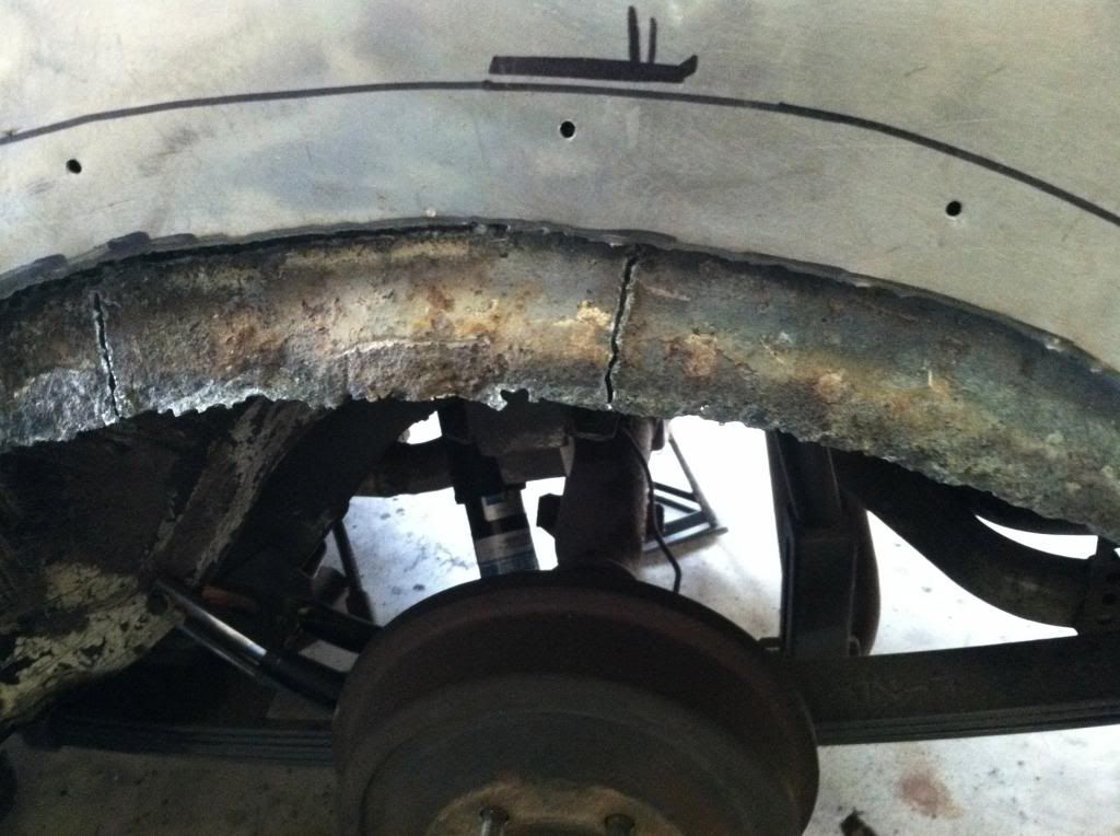

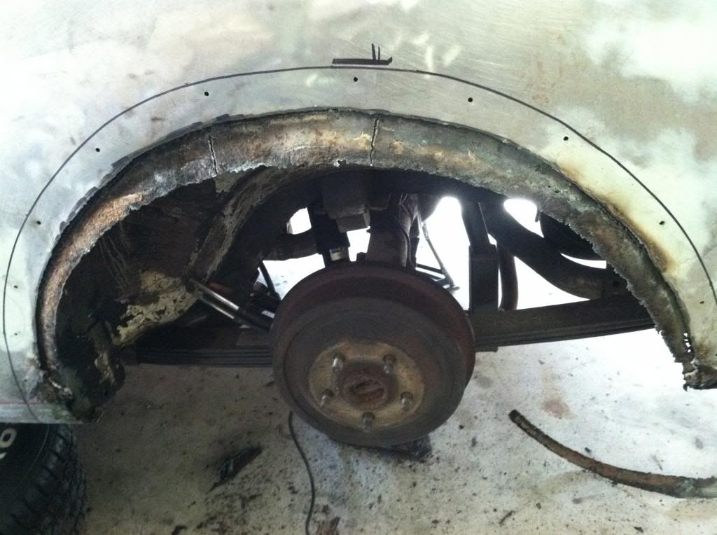

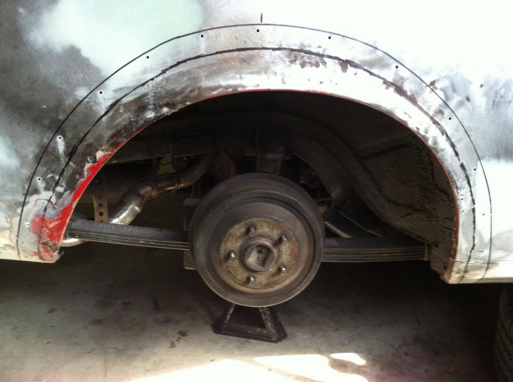

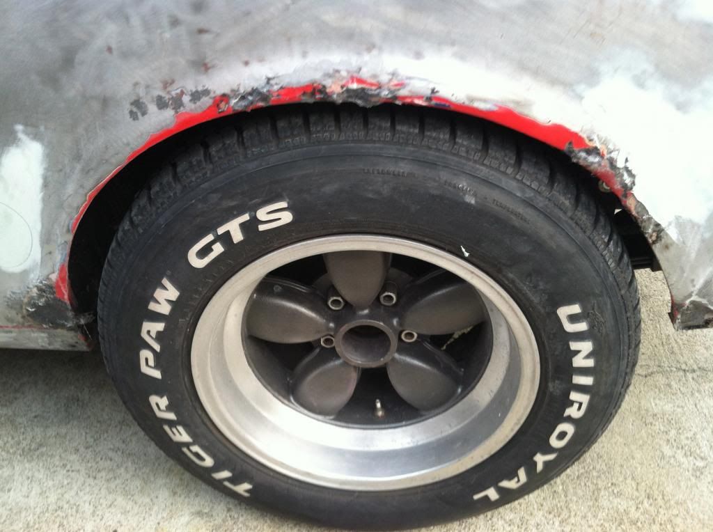

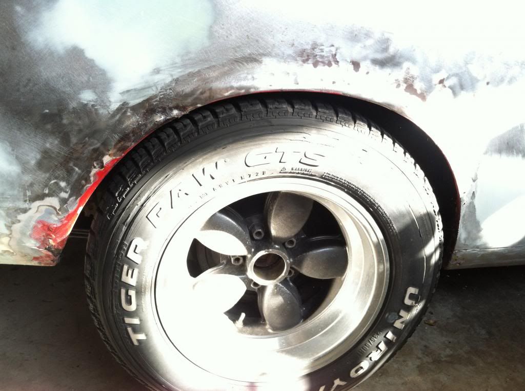

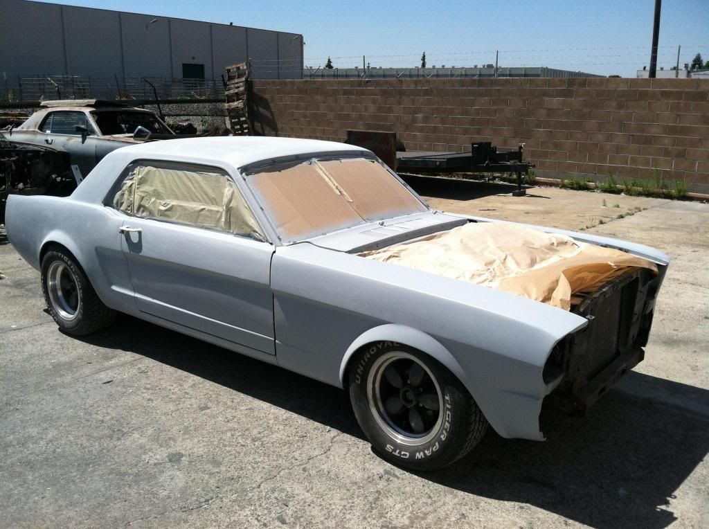

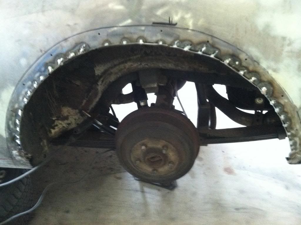

Stewbear42 03-19-2013 09:47 PM

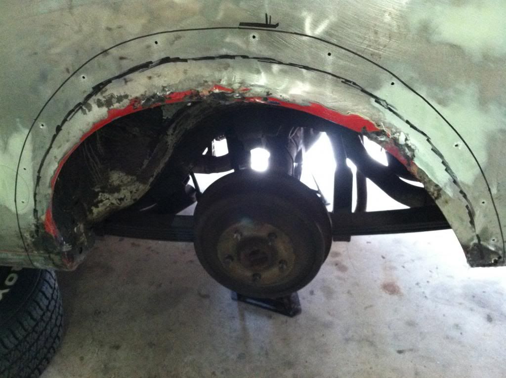

The rusted rear wheel wells.
http://i1264.photobucket.com/albums/...psa0655ff1.jpg

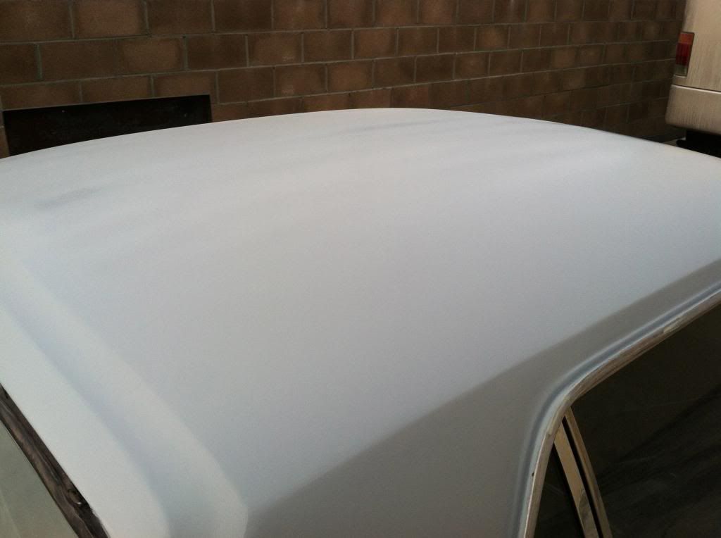

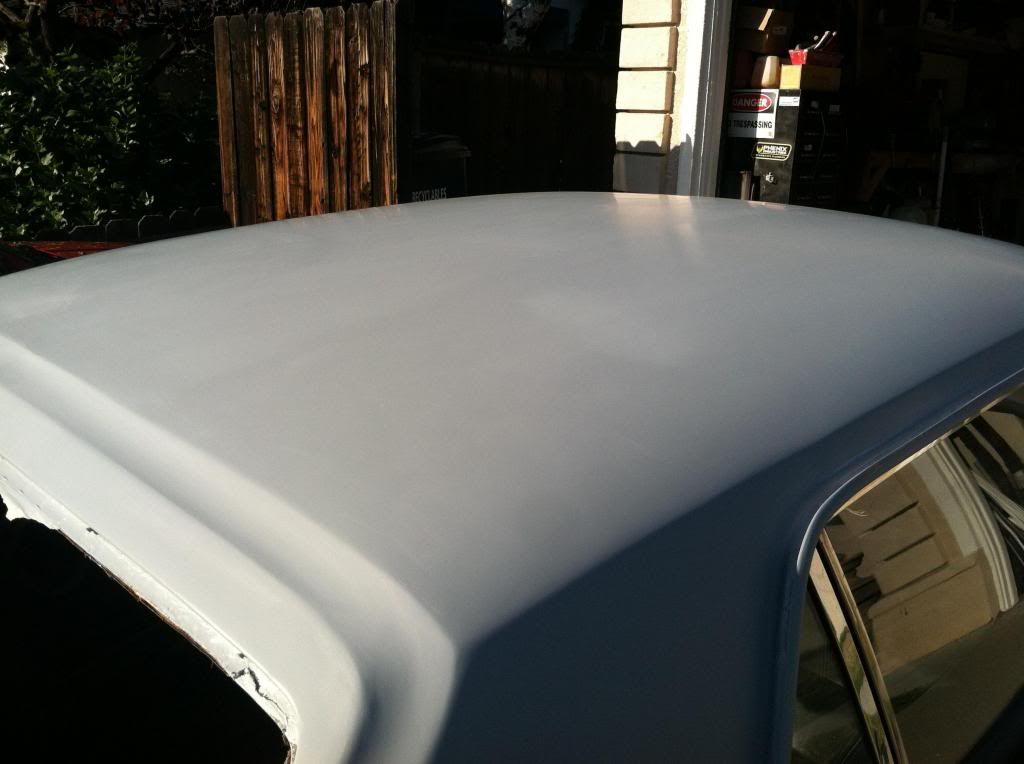

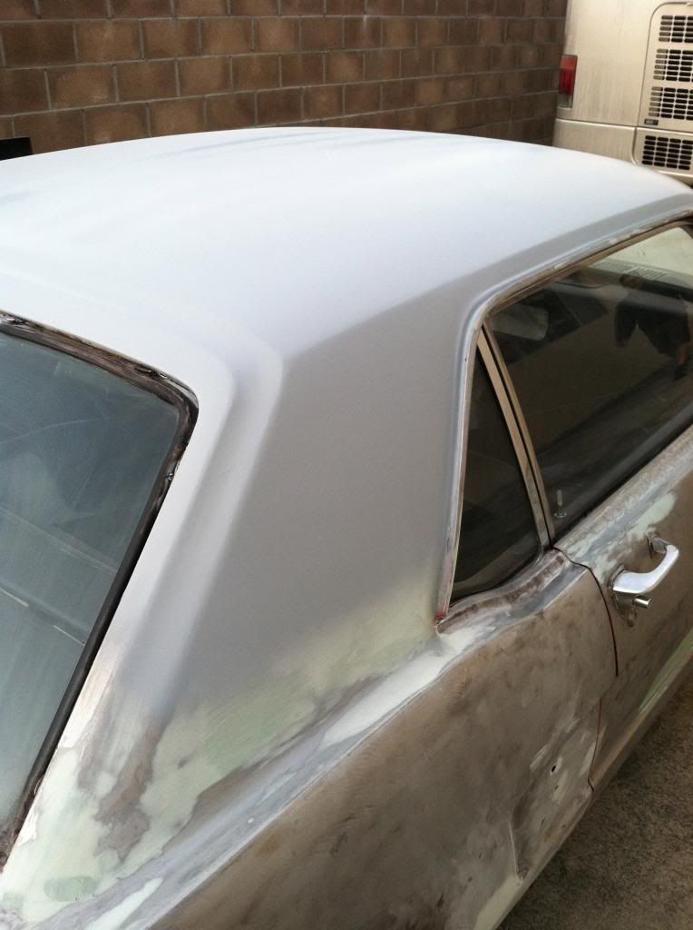

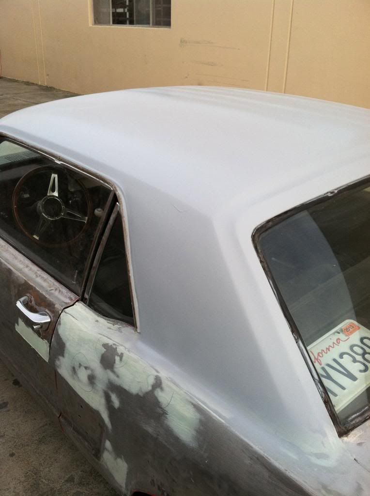

This past weekends progress on the roof.
http://i1264.photobucket.com/albums/...psca93d5f1.jpg
http://i1264.photobucket.com/albums/...ps63d01435.jpg
http://i1264.photobucket.com/albums/...ps797acad0.jpg

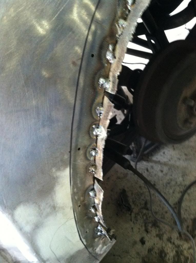

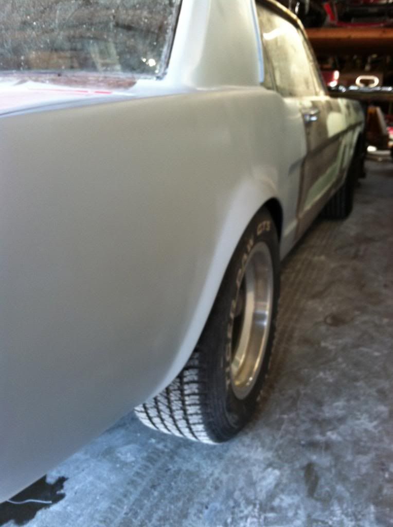

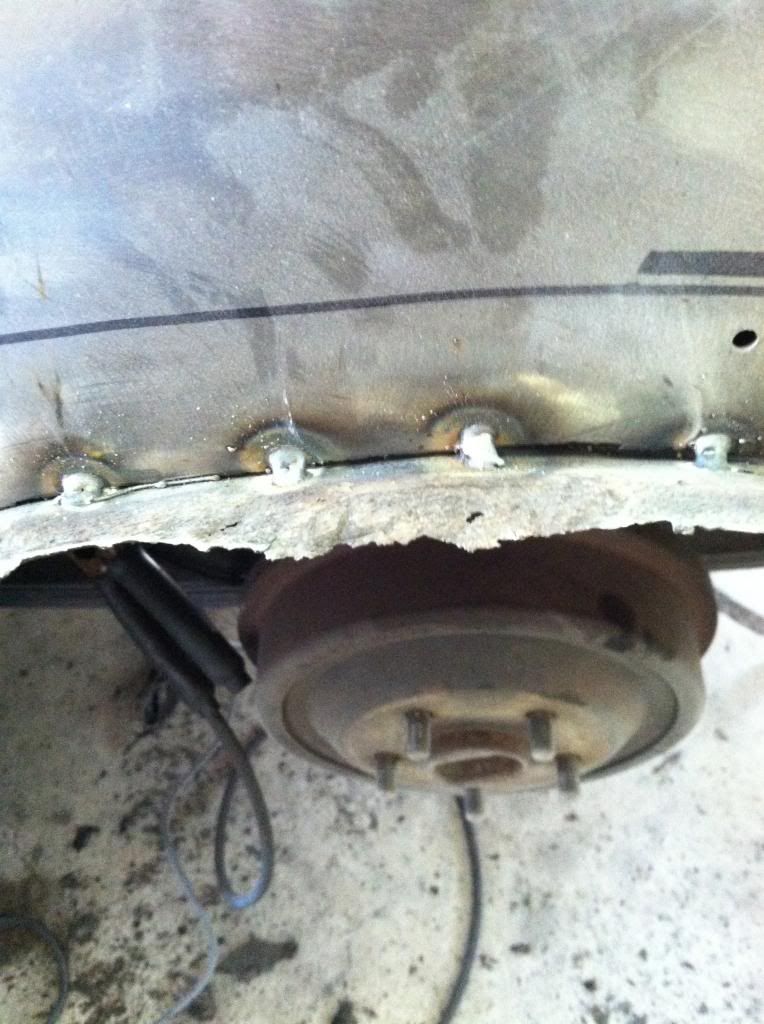

Stewbear42 04-03-2013 07:59 PM

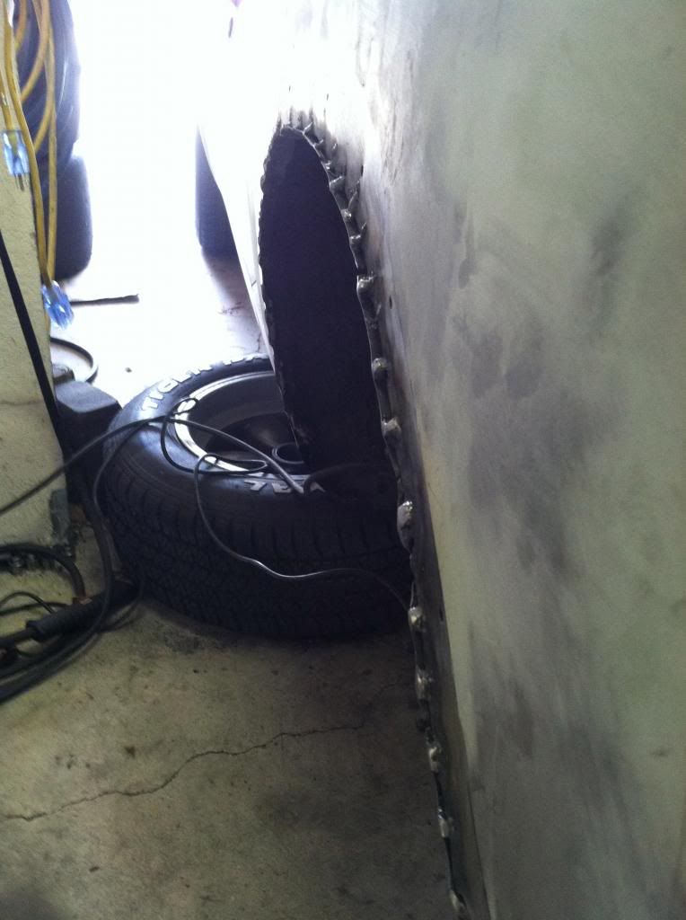

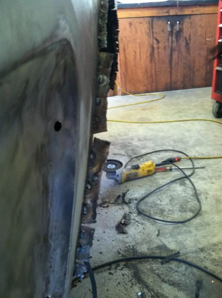

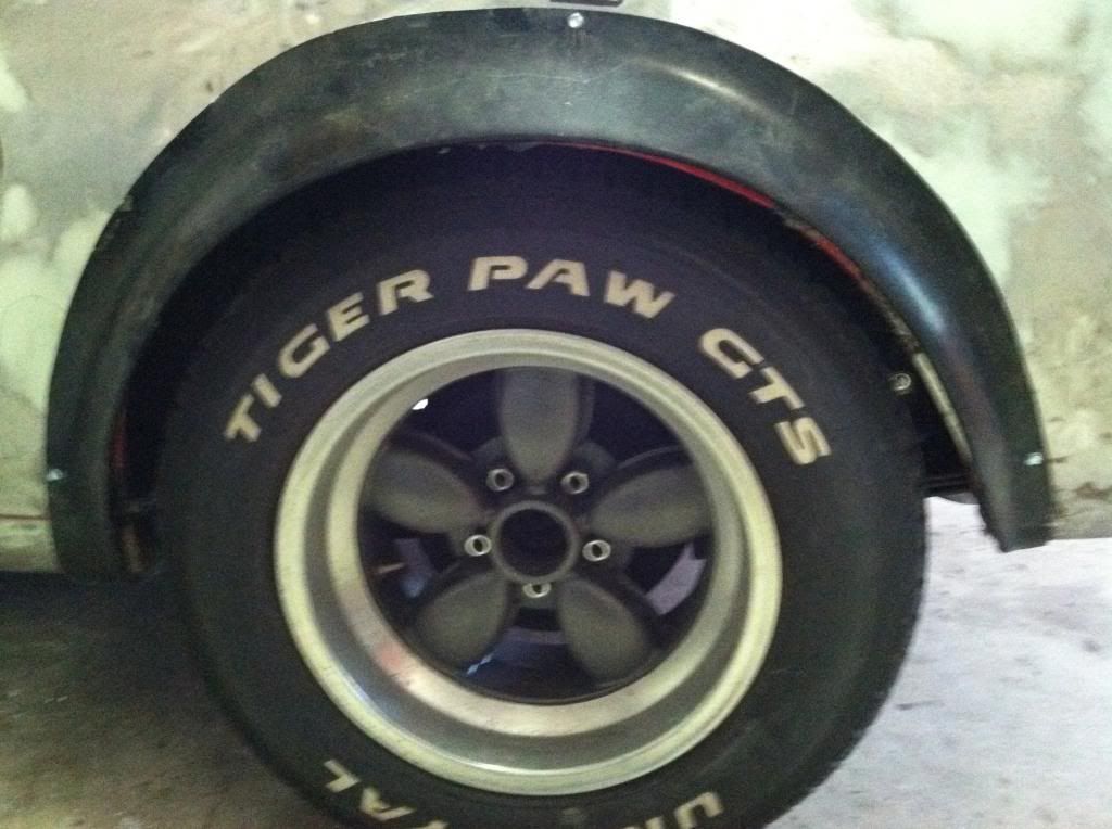

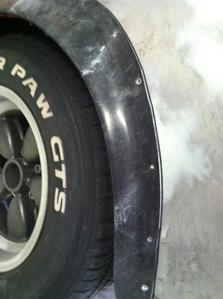

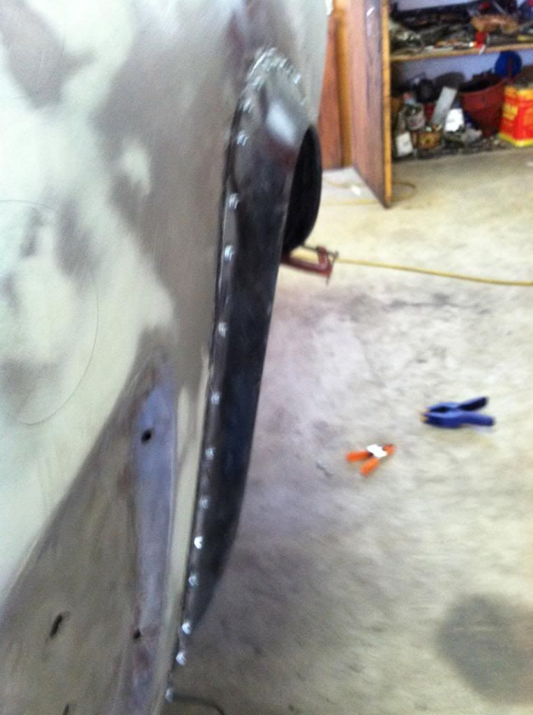

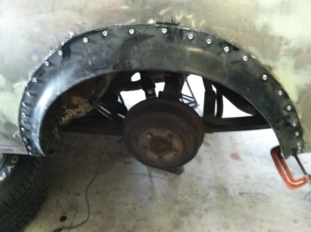

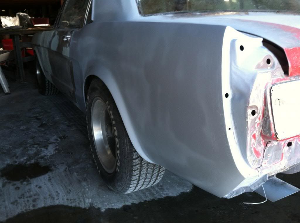

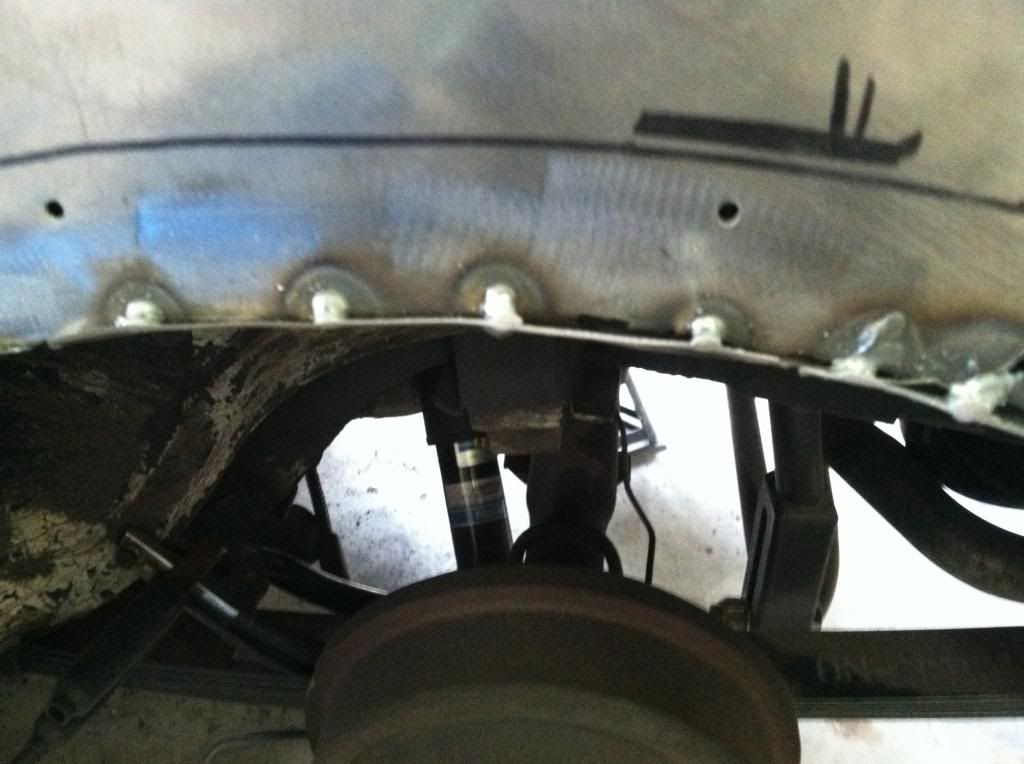

Flared the back of the car this past weekend.
http://i1264.photobucket.com/albums/...psd5e87ec3.jpg
I screwed in a couple sheet metal screws to do all of the adjustment.
http://i1264.photobucket.com/albums/...psfe4d15a0.jpg
http://i1264.photobucket.com/albums/...pse8663503.jpg
http://i1264.photobucket.com/albums/...psfb4acf92.jpg
Next I screwed in all the sheet metal screws so they would be easier to drill once I put the flares on for good.
http://i1264.photobucket.com/albums/...ps7d9043ea.jpg
http://i1264.photobucket.com/albums/...ps1187f5bd.jpg
http://i1264.photobucket.com/albums/...ps12def8a7.jpg
Next was marking off where i needed to do the cutting.
http://i1264.photobucket.com/albums/...ps729dcf35.jpg
http://i1264.photobucket.com/albums/...psf9882dec.jpg
Stewbear42 04-03-2013 08:01 PM
After the cuts were made.
http://i1264.photobucket.com/albums/...ps5b3c2118.jpg
http://i1264.photobucket.com/albums/...ps04457b3b.jpg

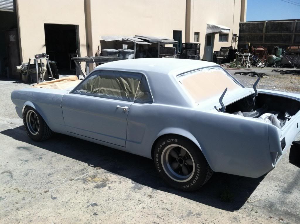

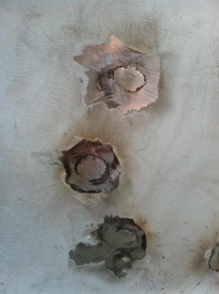

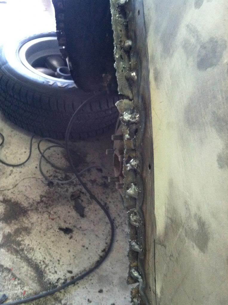

Next I spot welded the inner wheel well to the outer sheet metal.
http://i1264.photobucket.com/albums/...ps0661fa4a.jpg
http://i1264.photobucket.com/albums/...ps5b2c75cb.jpg

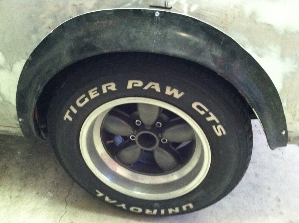

Stewbear42 04-03-2013 08:02 PM

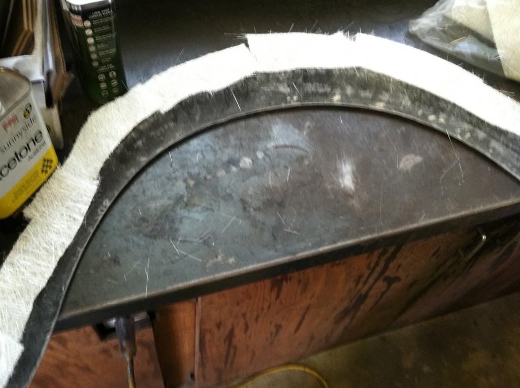

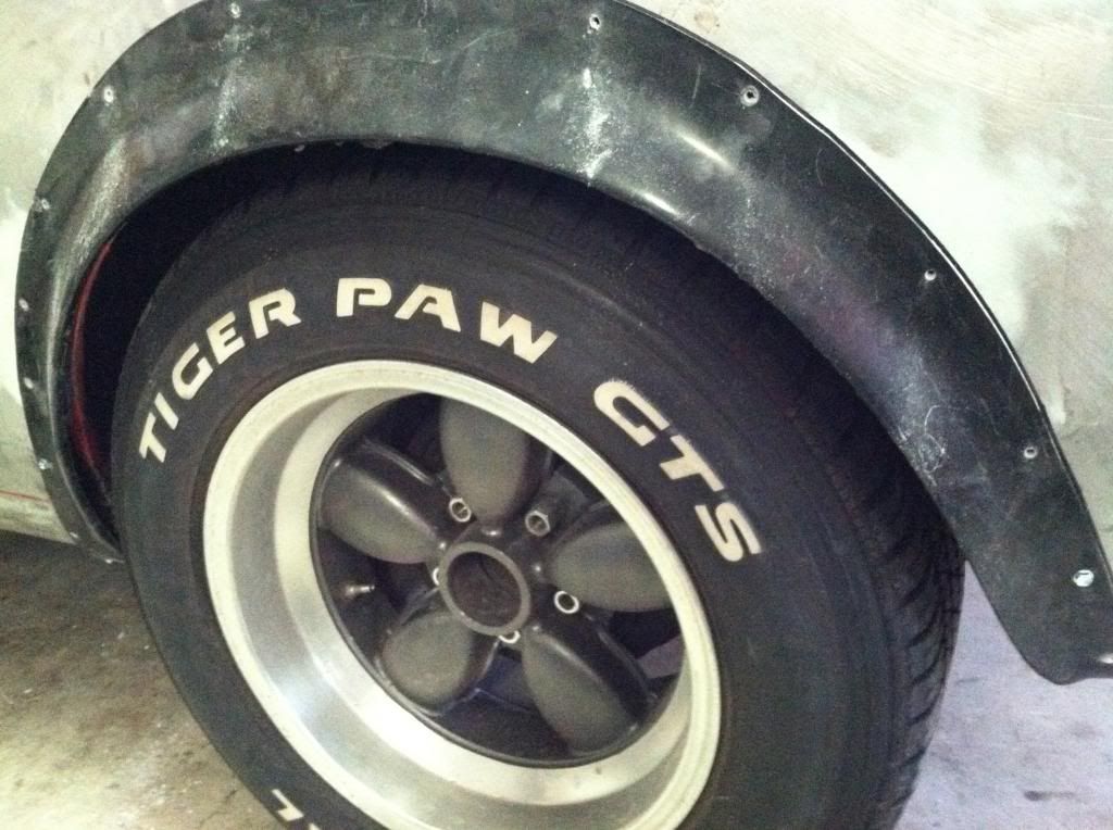

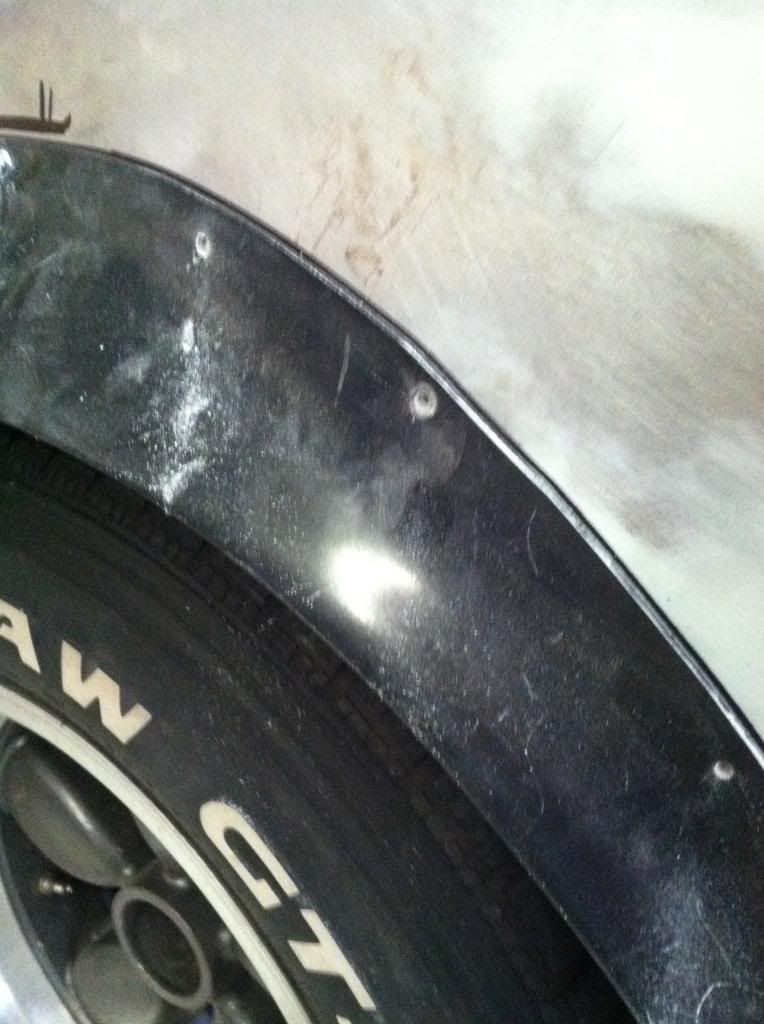

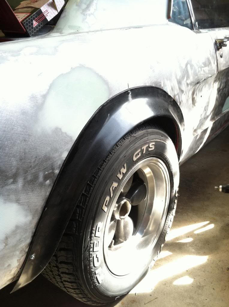

I then started to put the flare on and started grinding the inner down till the flare fit.
http://i1264.photobucket.com/albums/...ps90ac4019.jpg
http://i1264.photobucket.com/albums/...ps9210721e.jpg
http://i1264.photobucket.com/albums/...psc6facbe8.jpg
http://i1264.photobucket.com/albums/...ps57fd0764.jpg
http://i1264.photobucket.com/albums/...ps75ffd3a7.jpg
Stewbear42 04-03-2013 08:03 PM
Put small pieces of fiberglass and applied the resin and put them on the car.
http://i1264.photobucket.com/albums/...ps2bfdfe12.jpg
http://i1264.photobucket.com/albums/...psac010b06.jpg
http://i1264.photobucket.com/albums/...ps5a51a288.jpg
http://i1264.photobucket.com/albums/...ps5f79b114.jpg

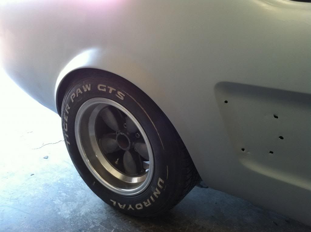

The finished product after blocked and sprayed with primer.
http://i1264.photobucket.com/albums/...ps8db82a7d.jpg
http://i1264.photobucket.com/albums/...ps901dedba.jpg
http://i1264.photobucket.com/albums/...ps4a62ec18.jpg
http://i1264.photobucket.com/albums/...ps1b79906a.jpg

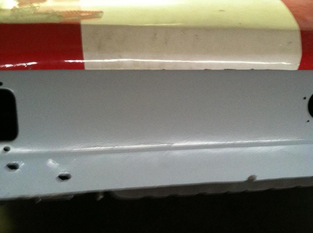

Stewbear42 07-31-2013 01:42 PM
http://i1264.photobucket.com/albums/...psa2df187c.jpg

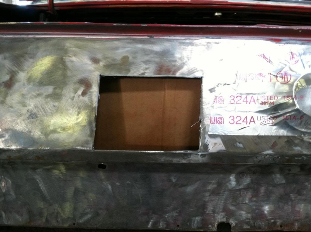

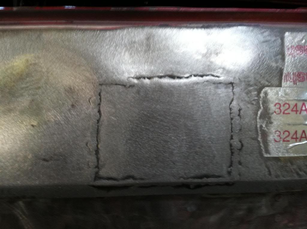

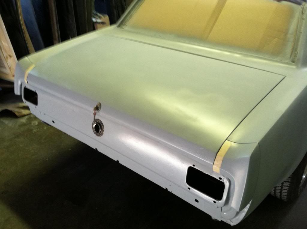

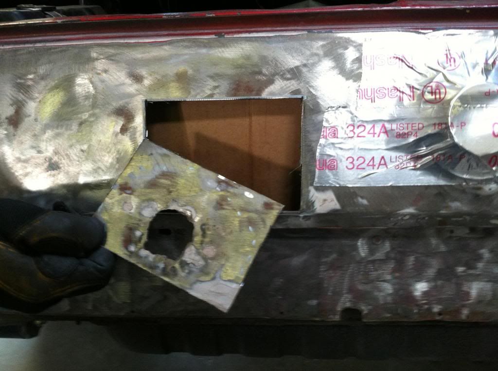

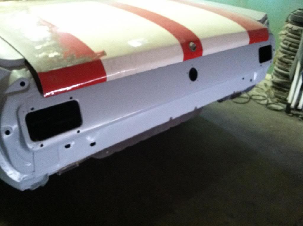

Had to patch a hole in the taillight panel.
http://i1264.photobucket.com/albums/...ps8908293d.jpg
http://i1264.photobucket.com/albums/...ps5ffcda75.jpg
http://i1264.photobucket.com/albums/...psa24d4667.jpg
http://i1264.photobucket.com/albums/...ps8e731b22.jpg
http://i1264.photobucket.com/albums/...psd287e5ac.jpg
http://i1264.photobucket.com/albums/...ps77244e1f.jpg
http://i1264.photobucket.com/albums/...psab935673.jpg

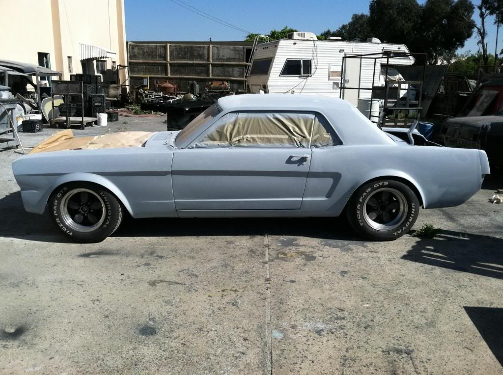

Stewbear42 07-31-2013 01:46 PM

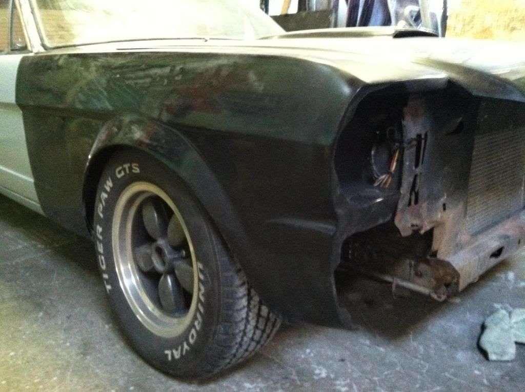

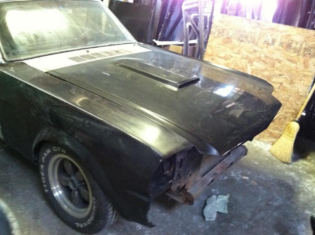

Replaced the front fenders with 1 1/2" fiberglass flared fenders.
http://i1264.photobucket.com/albums/...ps0f13200a.jpg
http://i1264.photobucket.com/albums/...ps2a9513b6.jpg

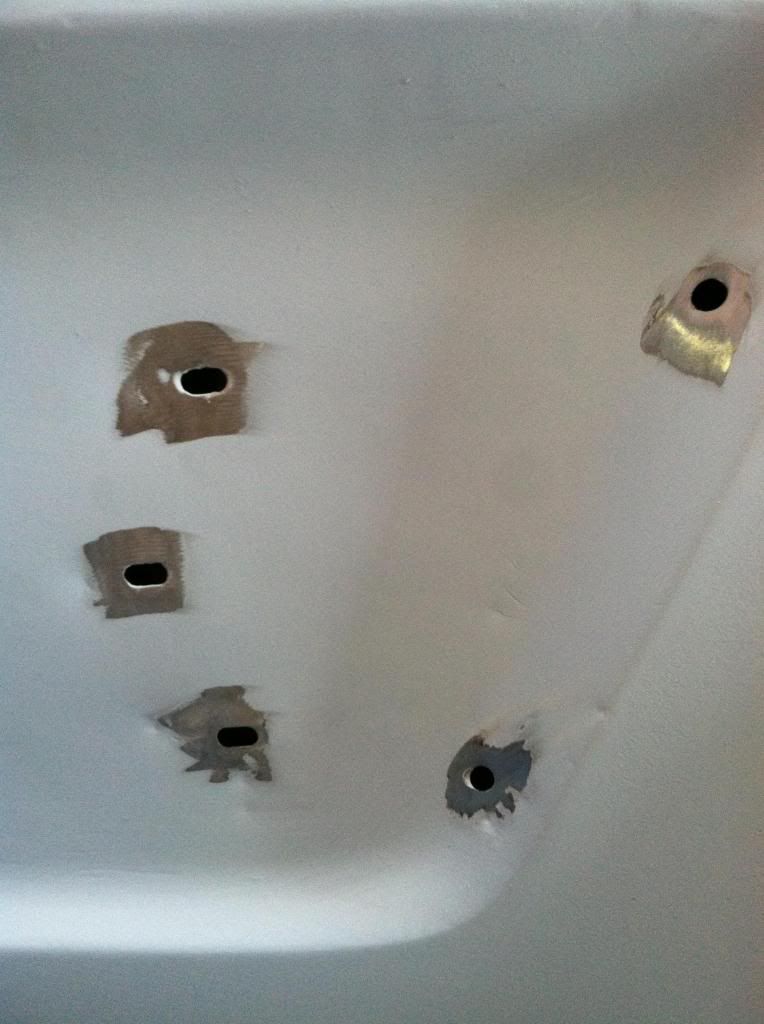

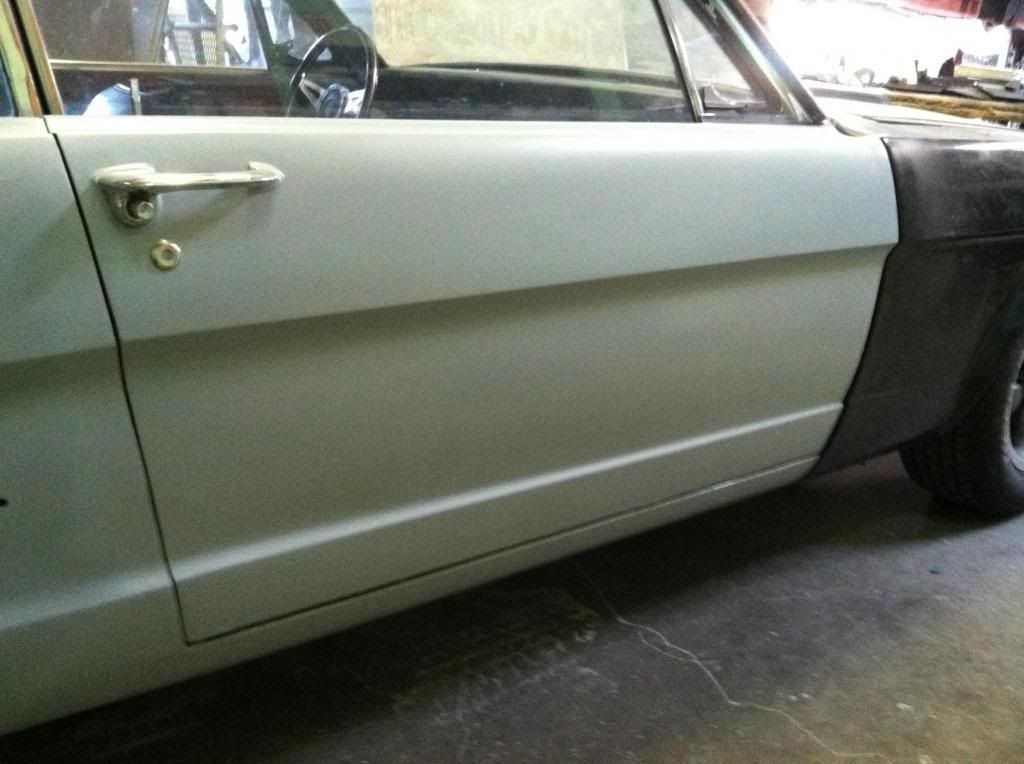

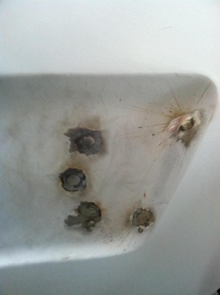

Decided to patch the holes where the side trim or side scoops would have gone.
http://i1264.photobucket.com/albums/...ps0267bb9e.jpg
http://i1264.photobucket.com/albums/...ps818a35a4.jpg
http://i1264.photobucket.com/albums/...ps27e01f58.jpg

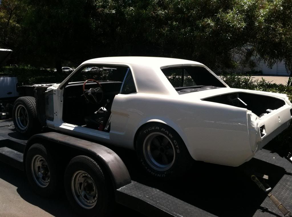

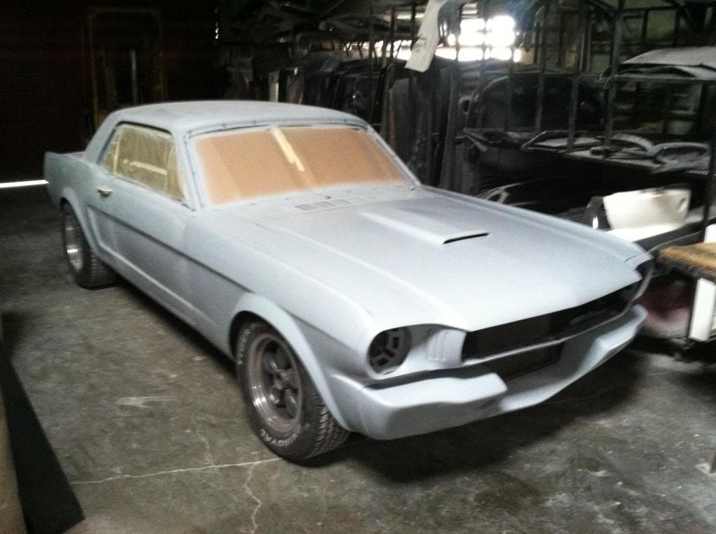

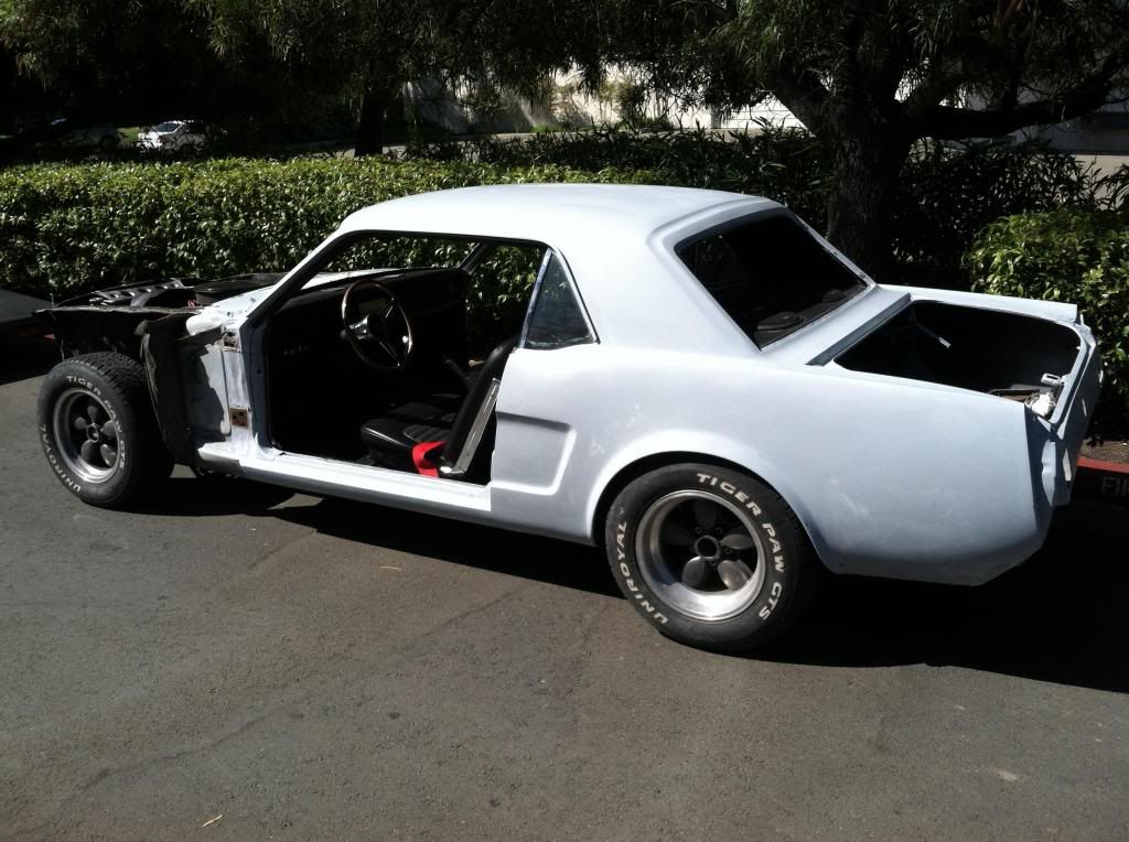

Finished all the wet sanding and body work.
http://i1264.photobucket.com/albums/...ps30916ae0.jpg
http://i1264.photobucket.com/albums/...ps0e92c504.jpg
http://i1264.photobucket.com/albums/...ps00e57aa7.jpg
Fiberglass deck lid installed.
http://i1264.photobucket.com/albums/...ps33ba42a1.jpg
Shot from the front of the car with nose pieces all assembled.
http://i1264.photobucket.com/albums/...ps6c63cb46.jpg
Shot off the roof.
http://i1264.photobucket.com/albums/...ps6af4ff32.jpg

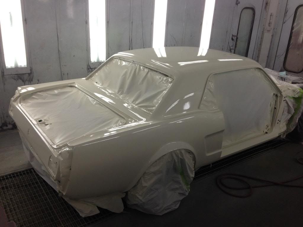

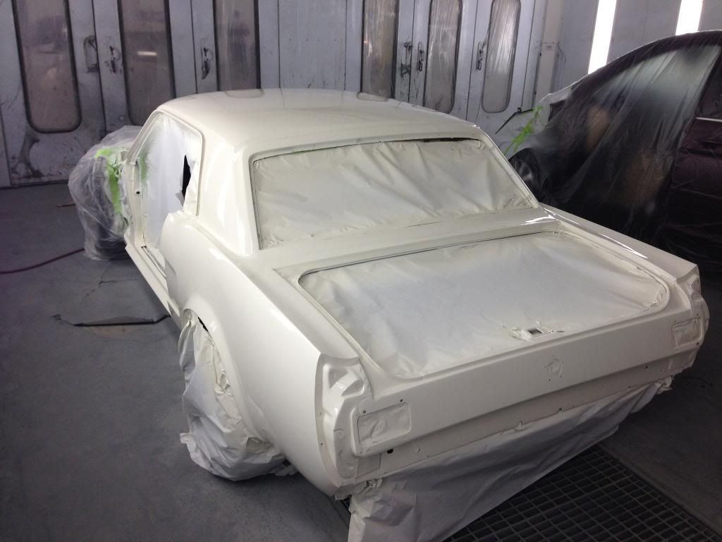

Stewbear42 07-31-2013 01:48 PM
http://i1264.photobucket.com/albums/...ps3eecb988.jpg
Right before car got sprayed.
http://i1264.photobucket.com/albums/...ps8f885136.jpg
http://i1264.photobucket.com/albums/...ps2e5fd4be.jpg
First coat.
http://i1264.photobucket.com/albums/...ps43a7b56e.jpg
Second coat.
http://i1264.photobucket.com/albums/...ps6a383b14.jpg
http://i1264.photobucket.com/albums/...psa9c1e31d.jpg
http://i1264.photobucket.com/albums/...ps9edc18ae.jpg

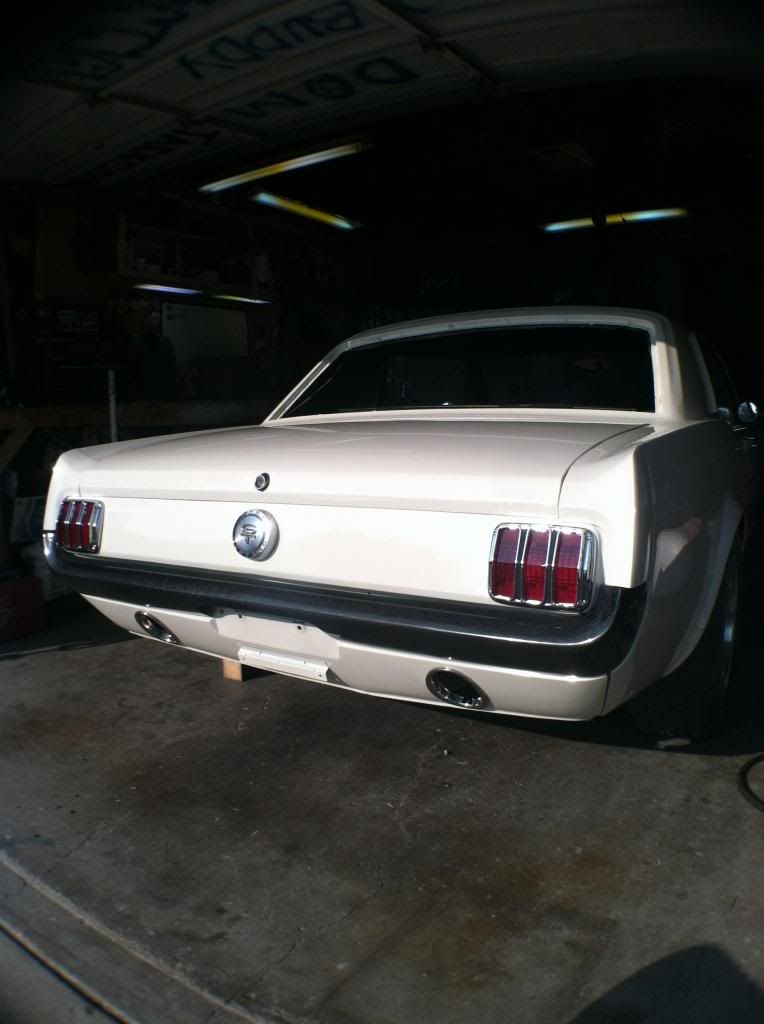

Back of the car all assembled. Thinking of removing the carbonfiber bumper and putting the chrome back on.
http://i1264.photobucket.com/albums/...psfa39cedf.jpg

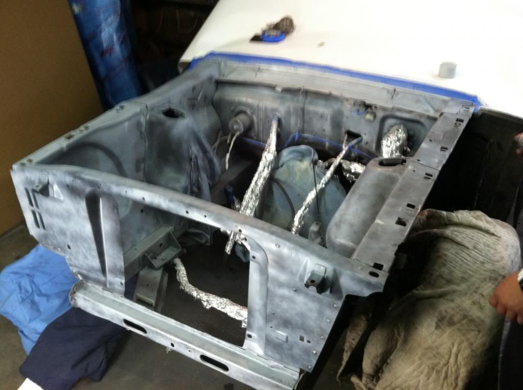

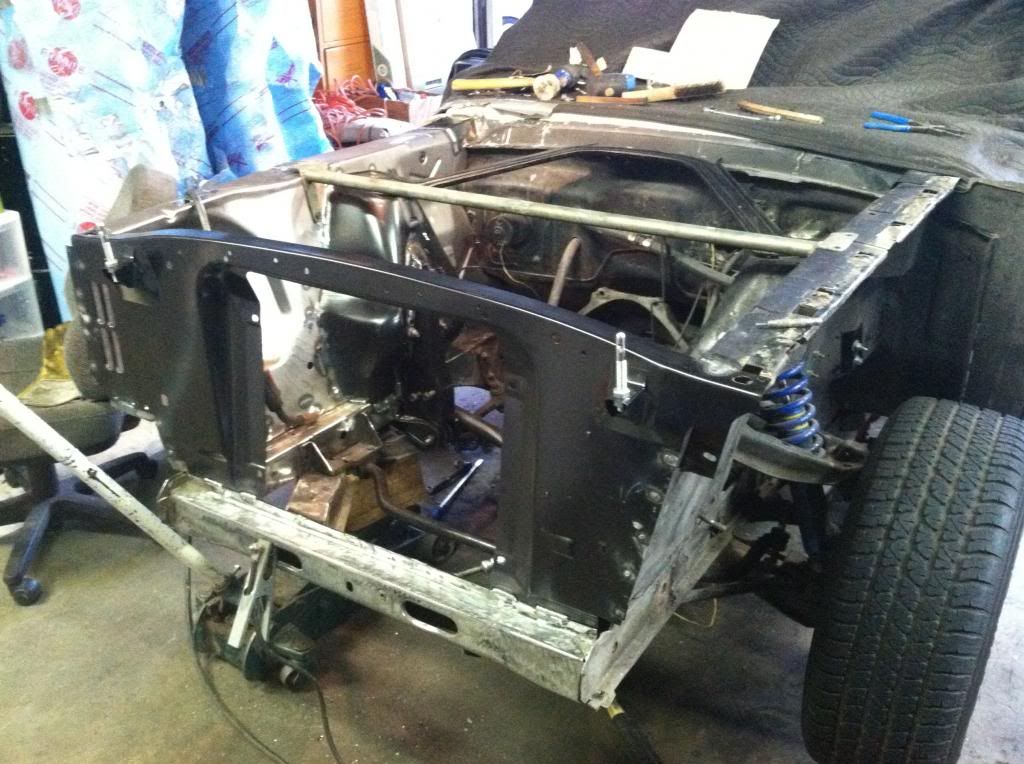

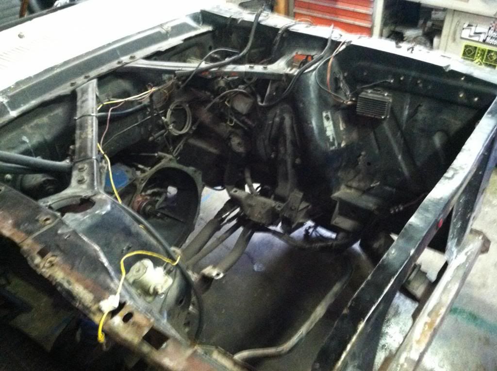

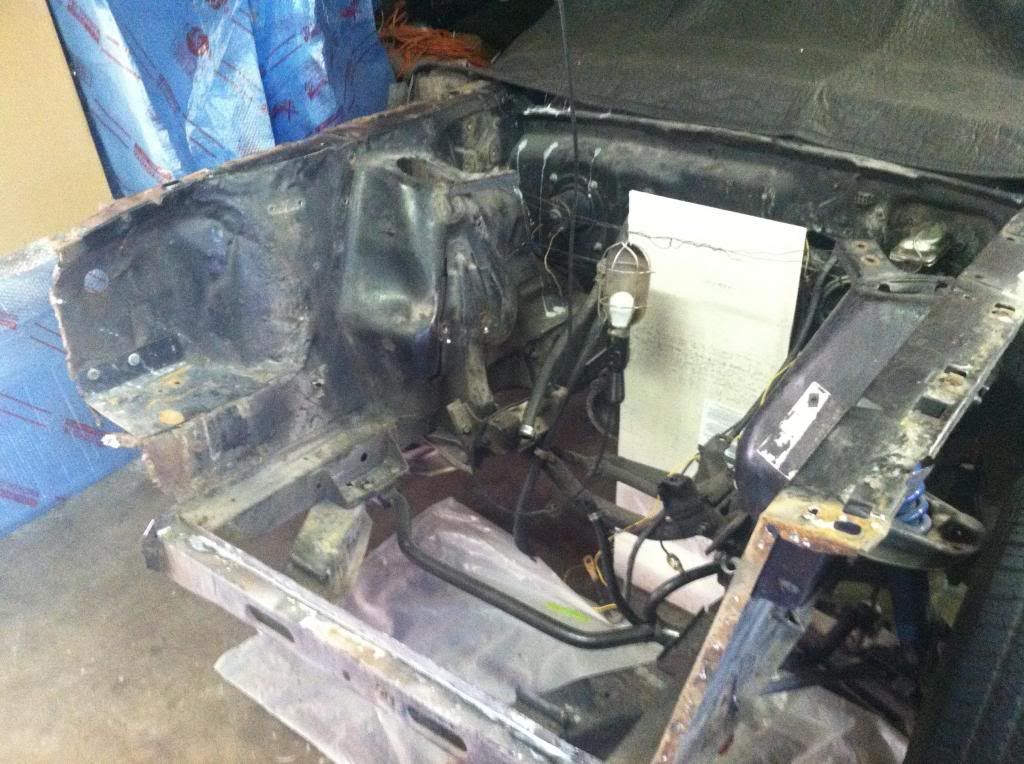

Stewbear42 07-31-2013 01:52 PM

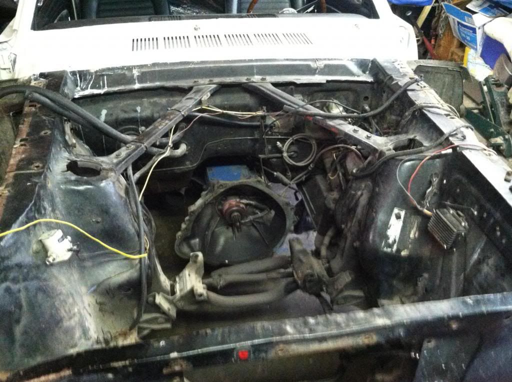

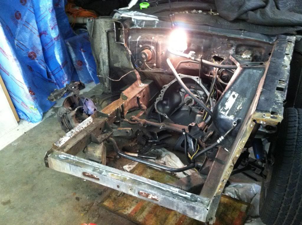

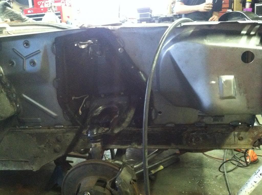

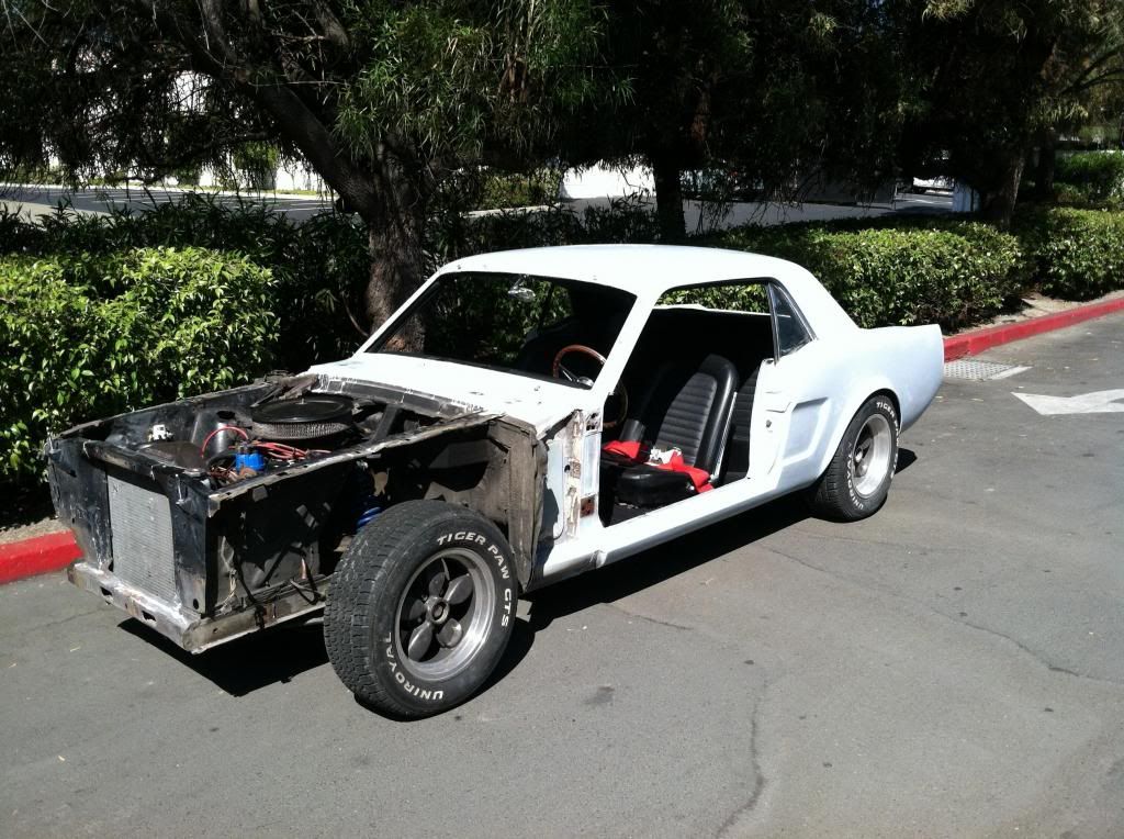

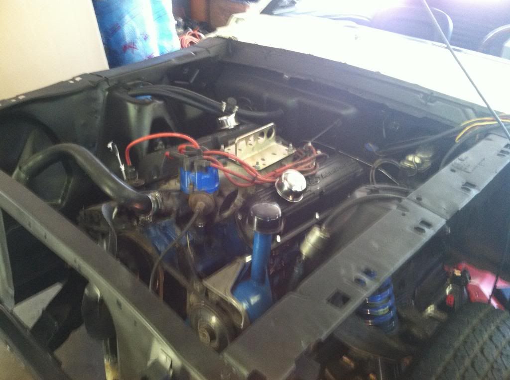

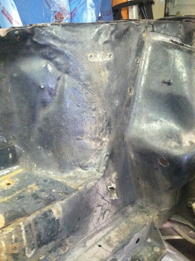

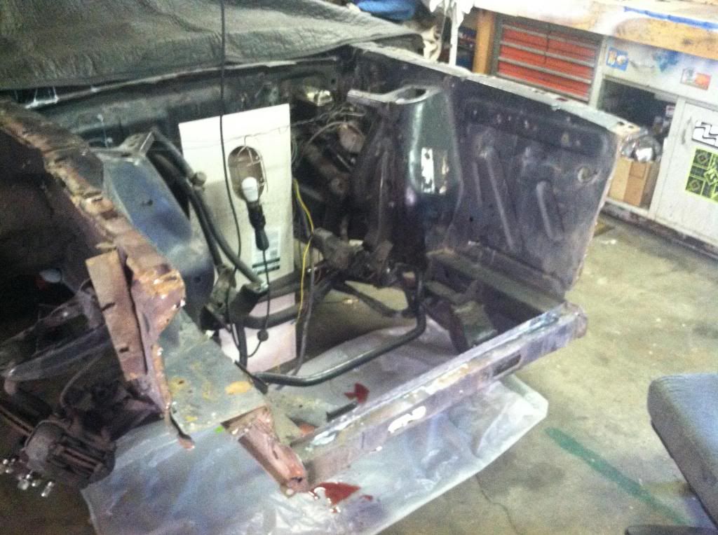

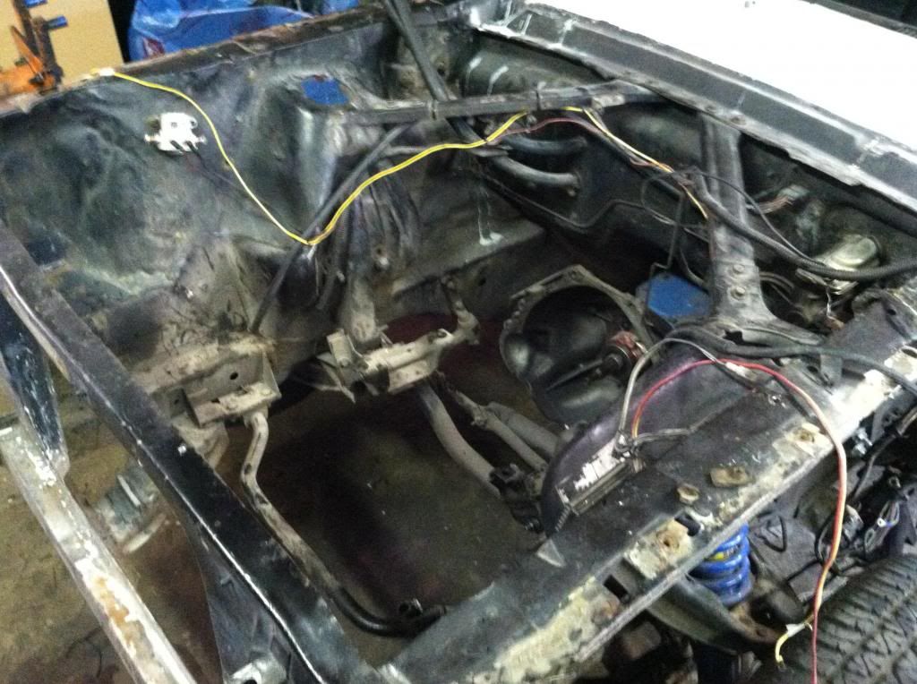

Next step was to pull the engine and clean up the engine bay.
http://i1264.photobucket.com/albums/...ps65262801.jpg
http://i1264.photobucket.com/albums/...ps295ad05b.jpg
http://i1264.photobucket.com/albums/...ps4dd847fd.jpg

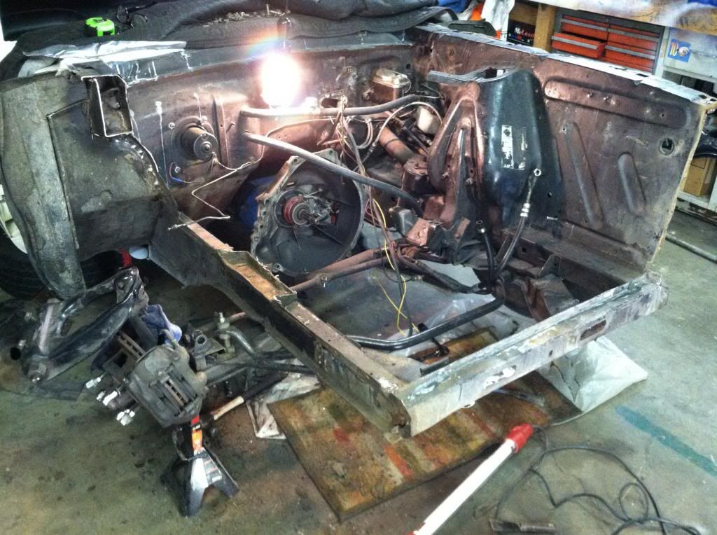

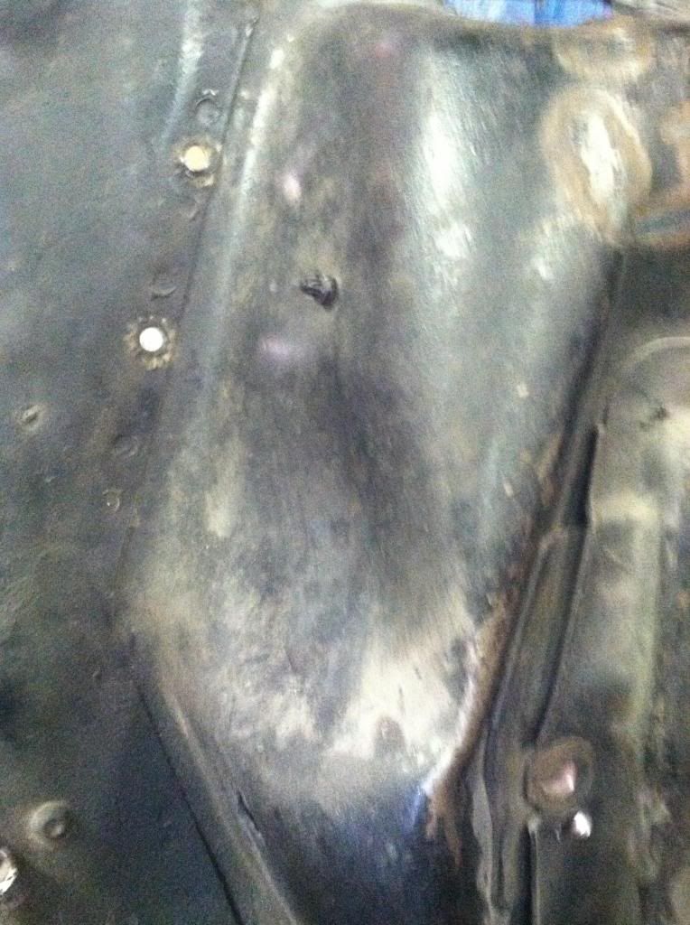

The radiator support was all bent so I removed that and am going to put new one on. Sometime in the cars life the passenger side front apron had been hit so it is all bent and mangled so I am going to replace this metal along with the radiator support.
http://i1264.photobucket.com/albums/...psd3ff4e71.jpg
http://i1264.photobucket.com/albums/...ps52f0a390.jpg
You can see the shock tower has a big dent in it as well so that will be replaced at the same time.
http://i1264.photobucket.com/albums/...ps9fa9c371.jpg
http://i1264.photobucket.com/albums/...psebd36da2.jpg
Front apron removed.
http://i1264.photobucket.com/albums/...ps0ce81ed4.jpg

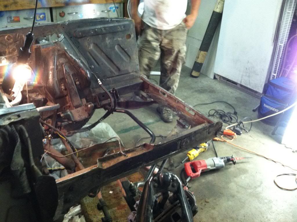

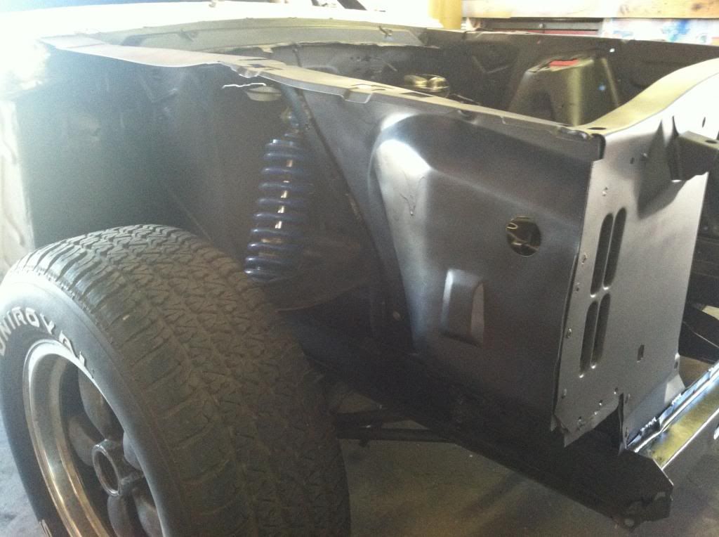

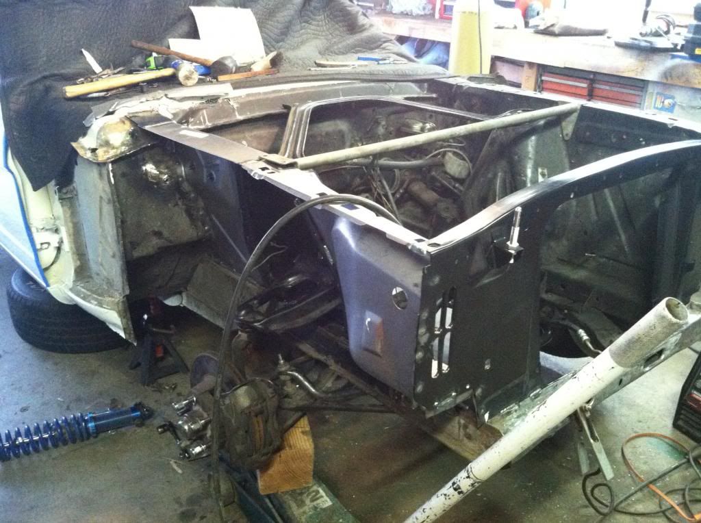

Stewbear42 08-02-2013 01:22 PM
Got the rest of the apron and shock tower out.
http://i1264.photobucket.com/albums/...ps76e5b217.jpg
http://i1264.photobucket.com/albums/...ps5d1b5fff.jpg
http://i1264.photobucket.com/albums/...ps5fe138e7.jpg

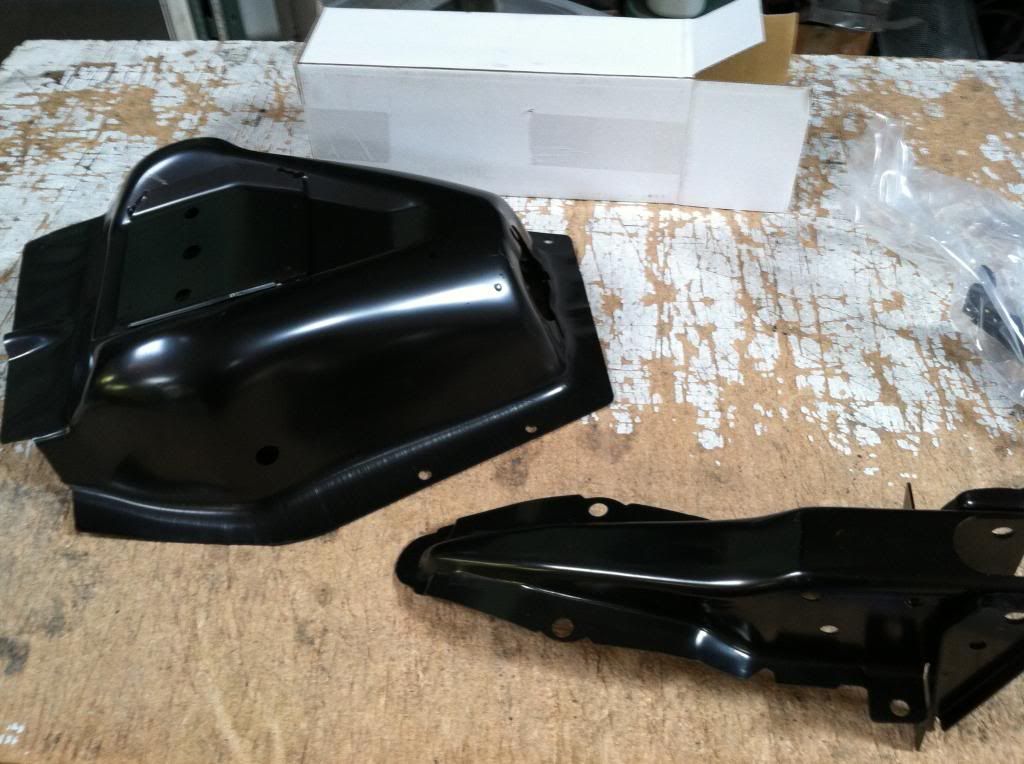

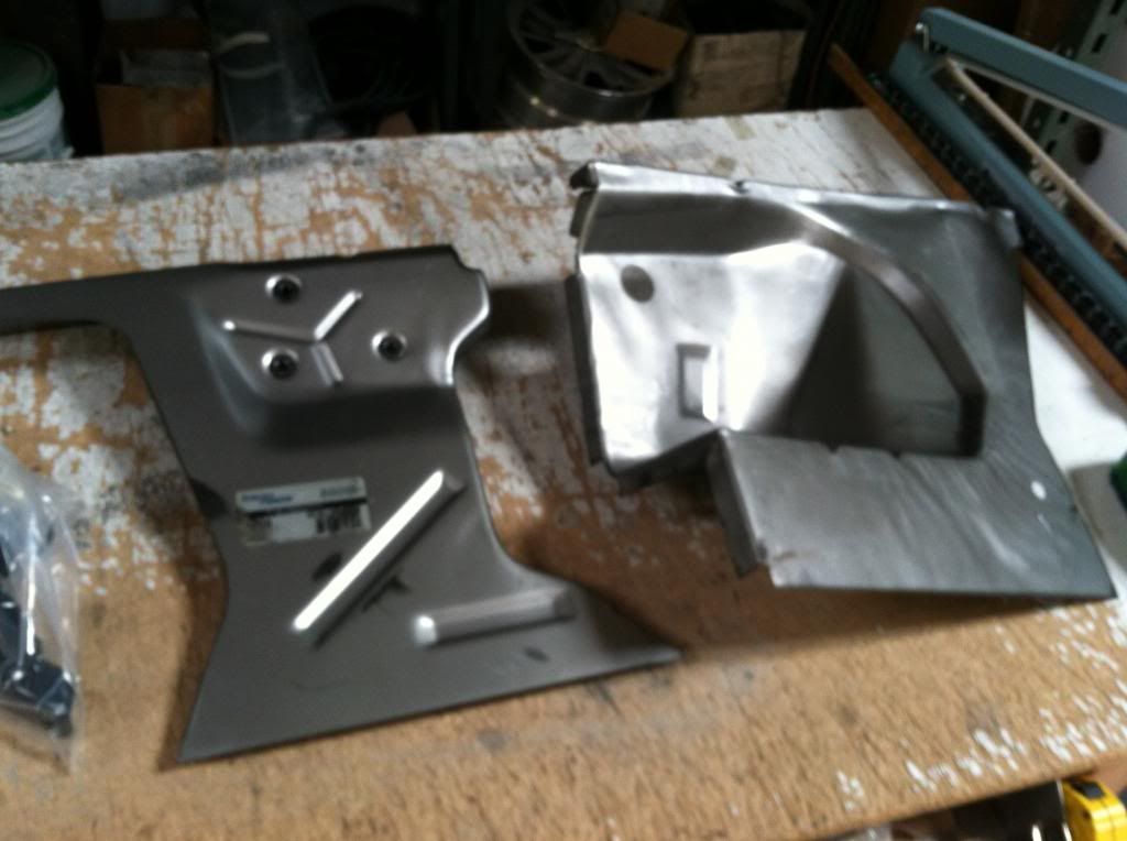

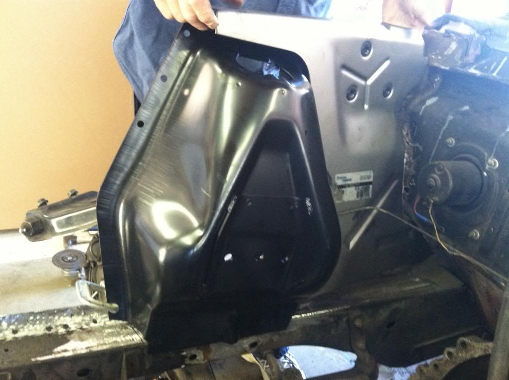

New shock tower and new apron pieces showed up yesterday.
http://i1264.photobucket.com/albums/...ps3c0c5bb4.jpg
http://i1264.photobucket.com/albums/...ps19bc0a7c.jpg

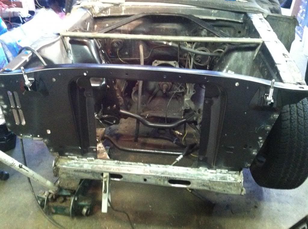

Stewbear42 08-05-2013 04:05 PM

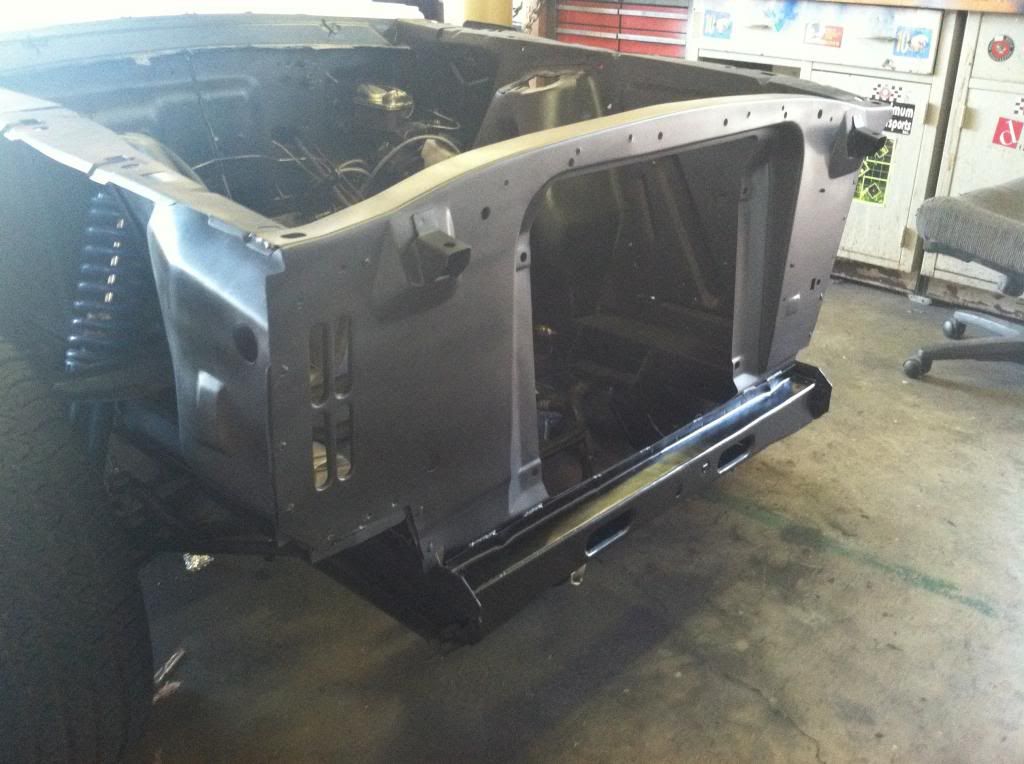

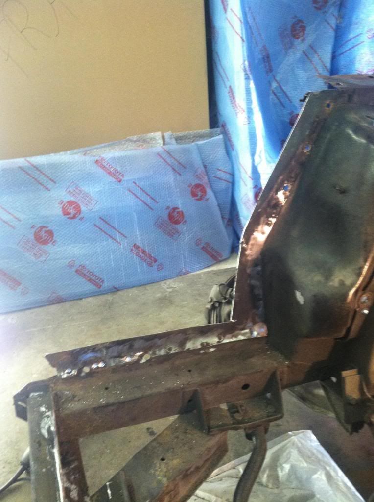

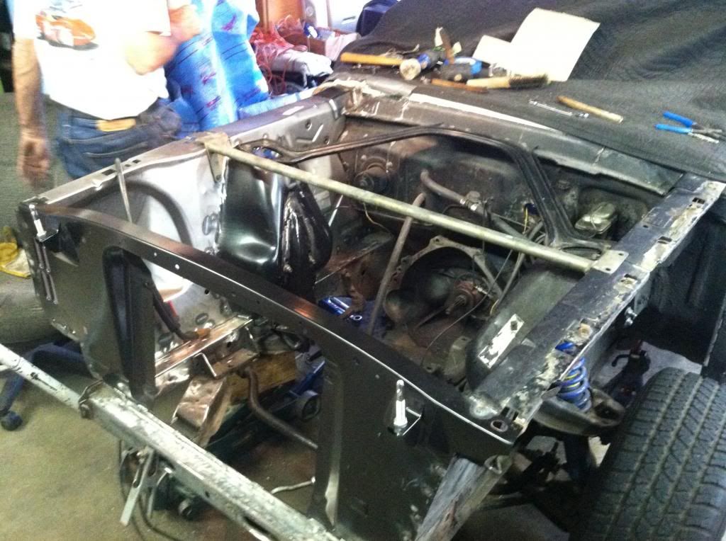

Welded the new apron in this weekend.
http://i1264.photobucket.com/albums/...psab0ba67a.jpg
http://i1264.photobucket.com/albums/...ps457e1c9d.jpg
http://i1264.photobucket.com/albums/...ps1339acba.jpg
http://i1264.photobucket.com/albums/...psf757195b.jpg
http://i1264.photobucket.com/albums/...psdf13cd4f.jpg
http://i1264.photobucket.com/albums/...ps2b5706e3.jpg

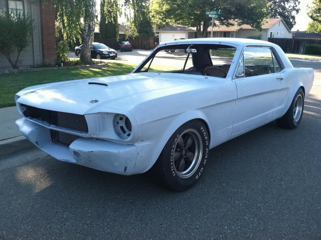

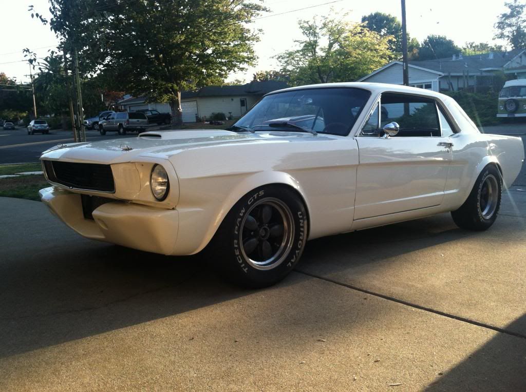

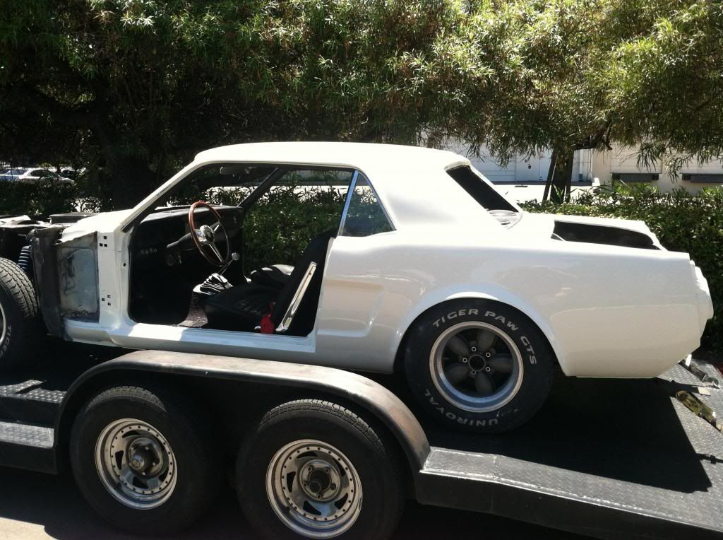

Stewbear42 10-11-2013 01:53 PM

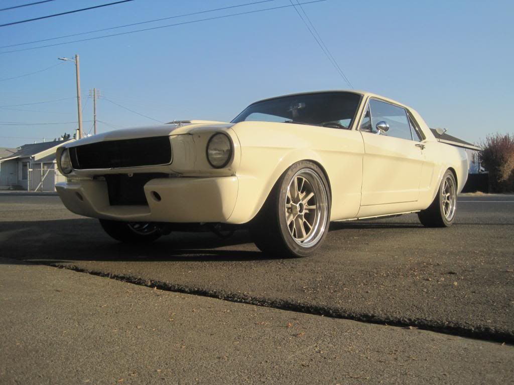

I was going for a retro trans am car look and must say I am more than satisfied with how it turned out.
http://i1264.photobucket.com/albums/...ps1539d8cc.jpg
http://i1264.photobucket.com/albums/...psfdcf0e07.jpg
preston 10-11-2013 02:29 PM
yeah looks good ! Great result for home brewed work. You must have some experience with this stuff though. The rear flares came out especially nice, I wish you had shown a picture of it being bondoed. Maybe I don't have much experience with the stuff but it sure seems like you'd have to feather it out a long ways to cover up the 1/8" thick flare flange.
WSSix 10-11-2013 06:48 PM
I think you nailed the look. Good job! :thumbsup:
Stewbear42 10-11-2013 08:07 PM
Thanks! For the most part all my experience has come from working on my car but I am lucky to have the resources that I have which has forsure helped

Lowered some more and put some new/old set of wheels on.
17 x 9's on the front with 4.75" back space and 17 x 9.5's on the rear with 4.75 back space.

I just read the whole thread again what front suspension are you running?
Mike
The control arms are stock Moog arms with a AFCO coilover shock and a hyperco spring. The shock is mounted on the lower control arm where the strut rod mounts and the upper part of the shock mounts on the inside of the shock tower. I also have delirium strut rod bushings and a 1 1/8 front sway bar.
