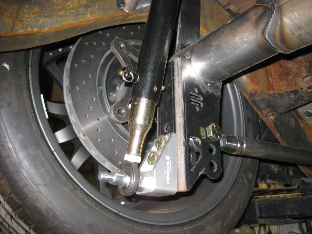

some shots of the RideTech 4-link componet's,http://i1104.photobucket.com/albums/...tanicII014.jpghttp://i1104.photobucket.com/albums/...tanicII008.jpghttp://i1104.photobucket.com/albums/...tanicII011.jpg

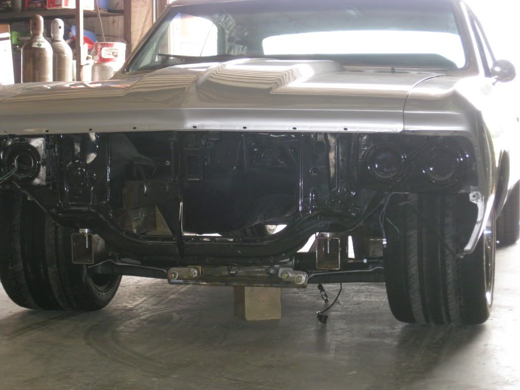

Chassis bracing 2"X.120 wall round tube bent to follow the contour of the floor pan.http://i1104.photobucket.com/albums/...tanicII005.jpgAprox. ride height/before shock mount were built.http://i1104.photobucket.com/albums/...hevelle001.jpg

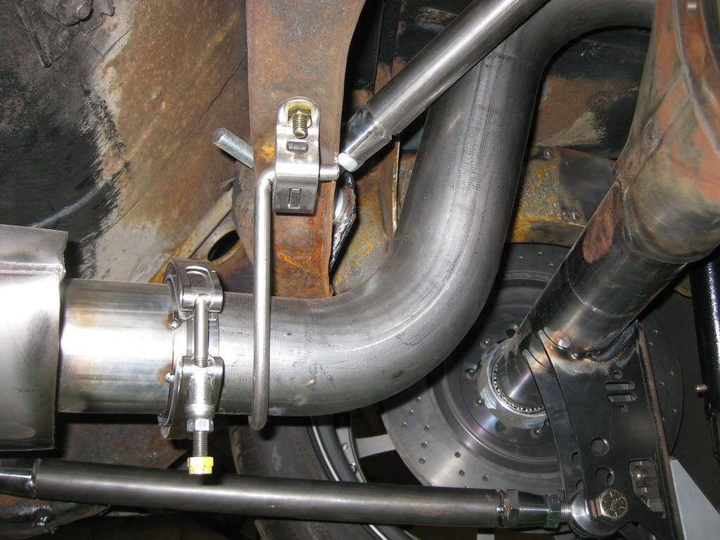

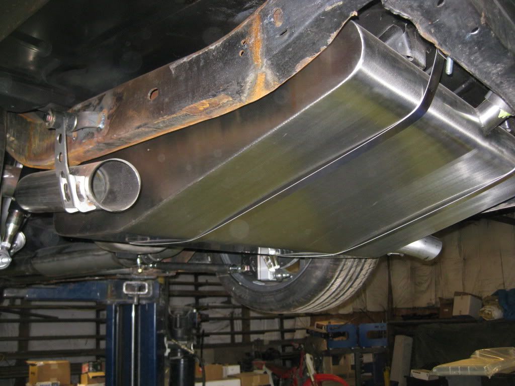

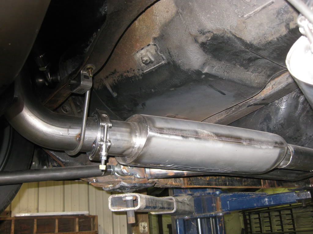

Trying to keep the Exhaust alittle above the lowest part of the frame.http://i1104.photobucket.com/albums/...tanicII015.jpg

Alot of thing's are just tacked welded during the mock up part of the build.Once I am sure everything is going to work togather I will finish welding. Frt. and rear sway bar's showed up today.

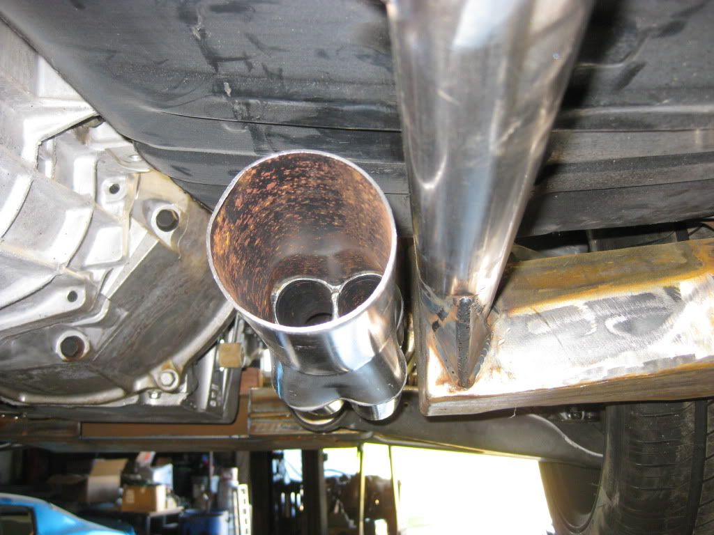

coolwelder62 09-12-2012 08:24 PM

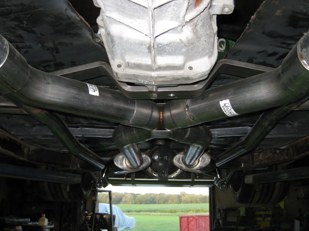

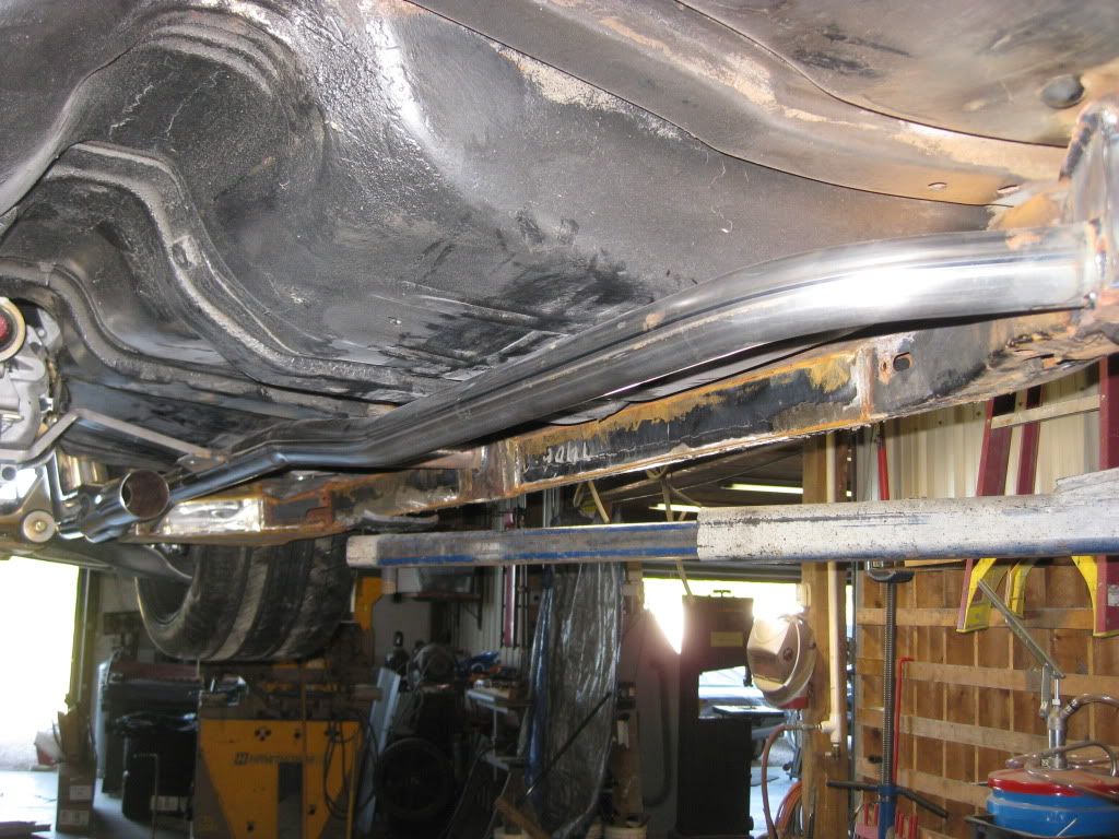

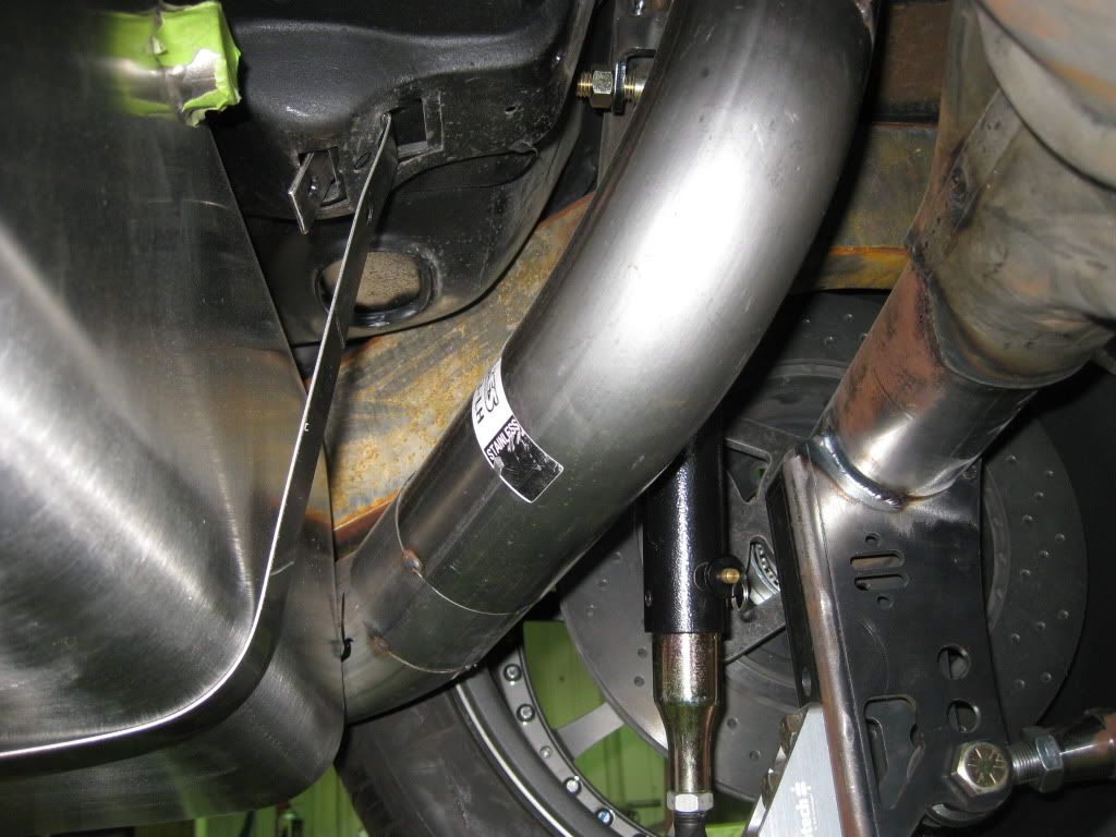

http://i1104.photobucket.com/albums/h324/bmock5/005.jpghttp://i1104.photobucket.com/albums/h324/bmock5/014.jpgGot the Exhaust and Fuel tank fitted up.http://i1104.photobucket.com/albums/h324/bmock5/009.jpghttp://i1104.photobucket.com/albums/h324/bmock5/006.jpghttp://i1104.photobucket.com/albums/h324/bmock5/004.jpghttp://i1104.photobucket.com/albums/h324/bmock5/007.jpg

Nice work on the exhaust!

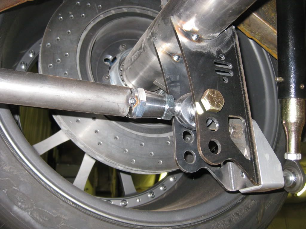

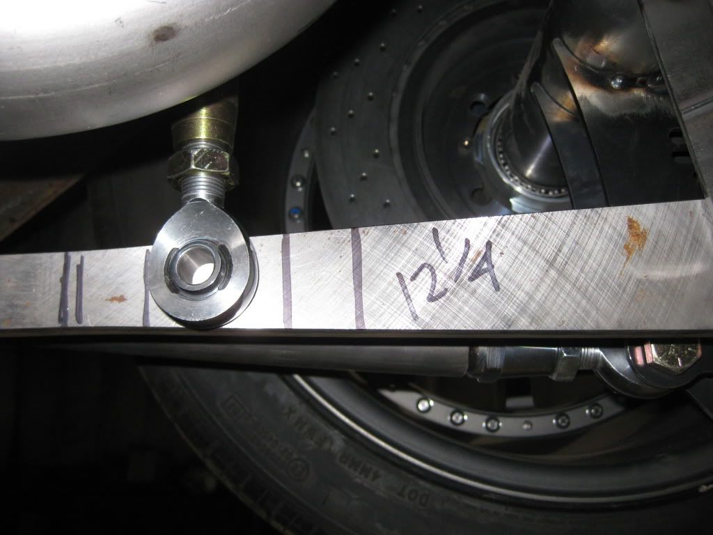

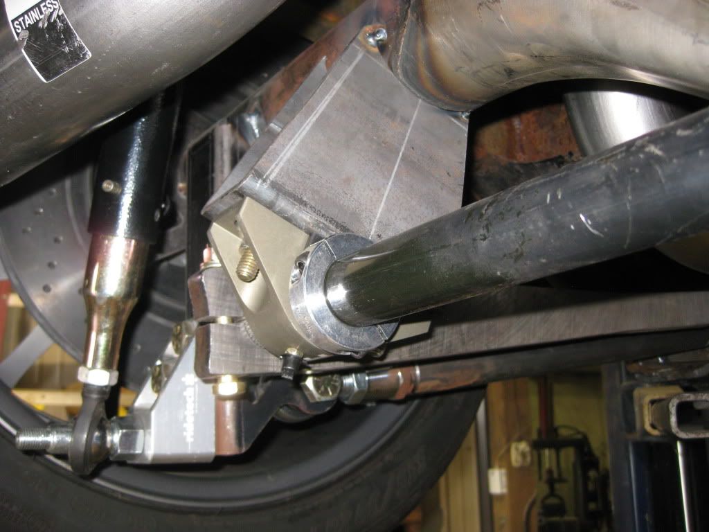

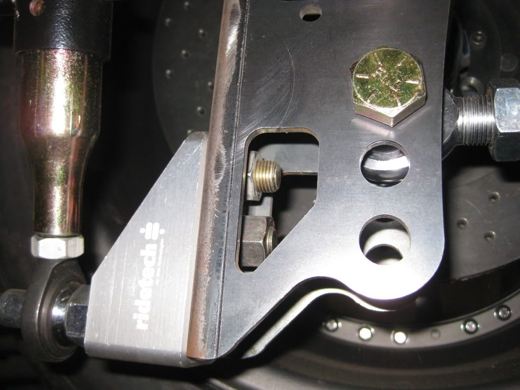

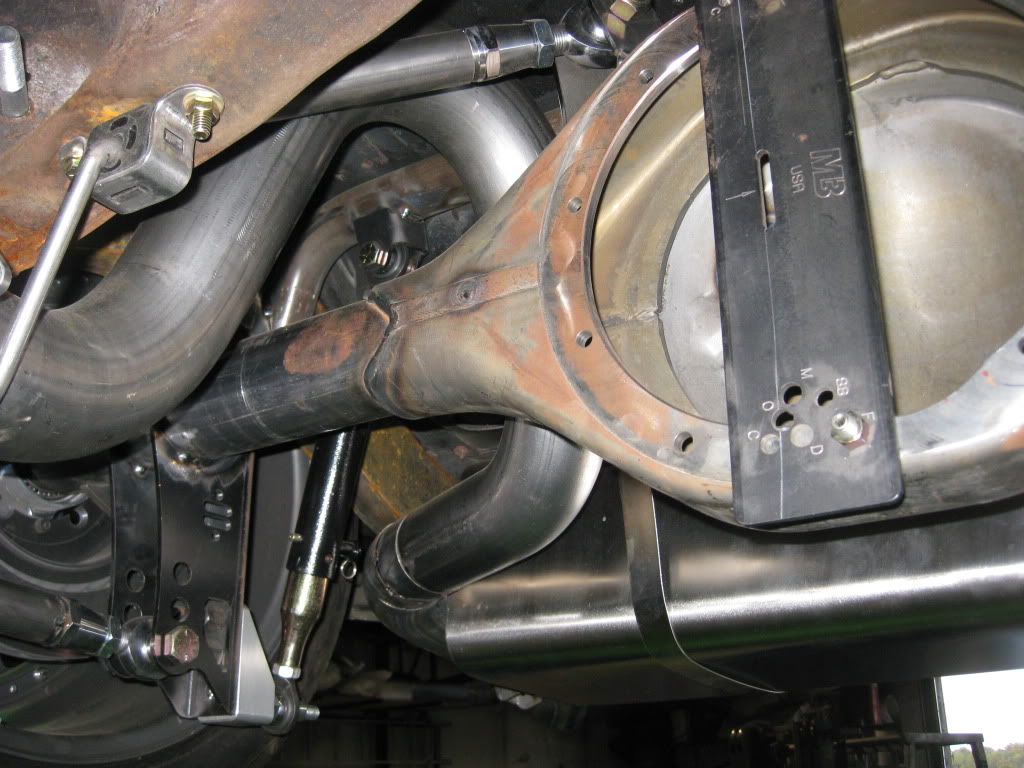

Scott what did you do in the rear? It looks like it is still a tranglated 4 bar. Did you have to move the mounting points in? This thing is killer. Thanks Eric
coolwelder62 09-14-2012 06:18 PM
I used the stock pickup point's on the chassis.The upper's on the moser 9" floater are some I plasma cut,& the housing lower's are from the good folk's @ Ridetech.I used the ridetech lower's because w/the floater & ZO6 caliper's, I had to move them in slightly.So using a rubber or poly bushing would have put the lower's in a bind. So I just Opped to use ridetech's Rod end kit.They may make alittle noise but with the Borla XR1's and Supercharger whine,I May not here them.I will get real good photo's during the reassem.:thumbsup:

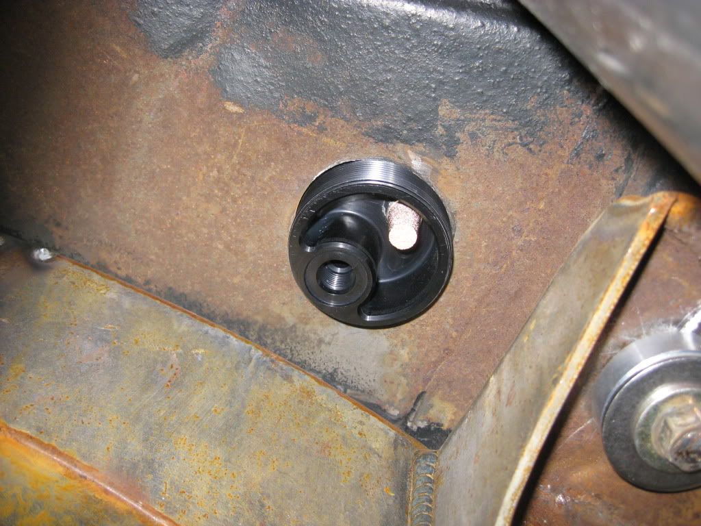

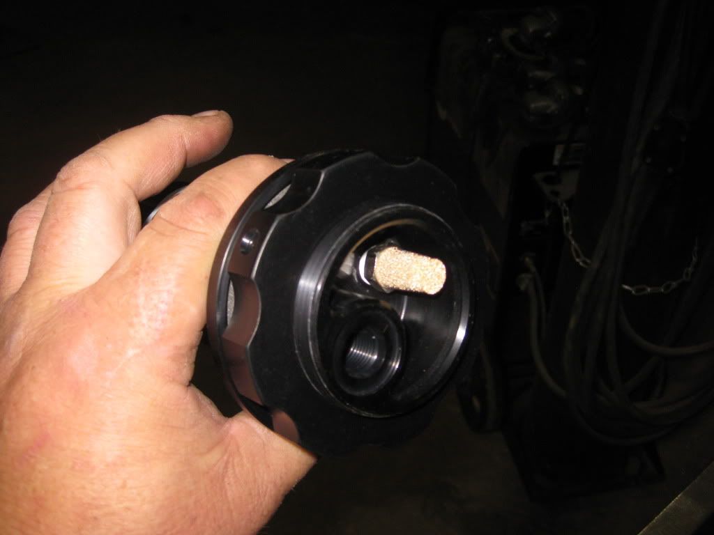

coolwelder62 09-15-2012 10:38 AM

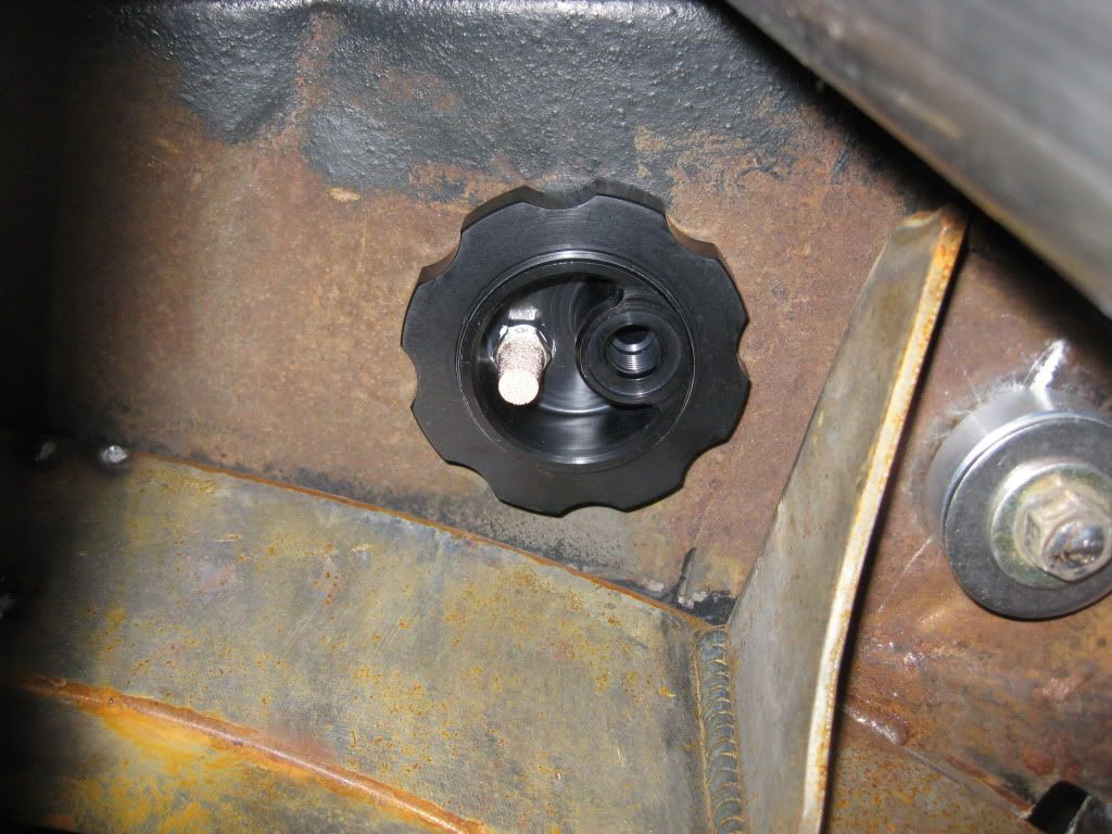

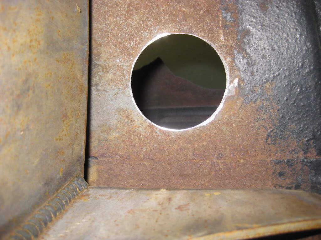

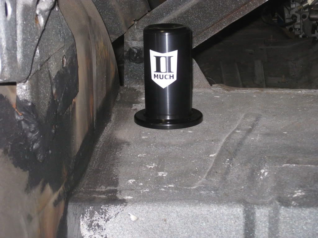

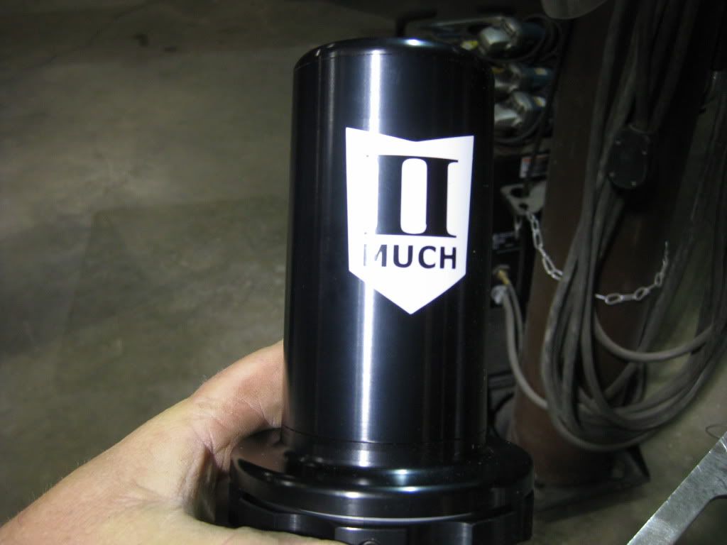

IIMuch fuel vent install
http://i1104.photobucket.com/albums/...lebuild002.jpghttp://i1104.photobucket.com/albums/...lebuild001.jpghttp://i1104.photobucket.com/albums/...lebuild003.jpghttp://i1104.photobucket.com/albums/...lebuild004.jpghttp://i1104.photobucket.com/albums/...lebuild006.jpghttp://i1104.photobucket.com/albums/...lebuild007.jpgIt's a very nice machine pc.A 2.5 in hole is all that's needed to install above the rear end and fuel tank.I have a vent for both the rear end & fuel tank.Thanks John.

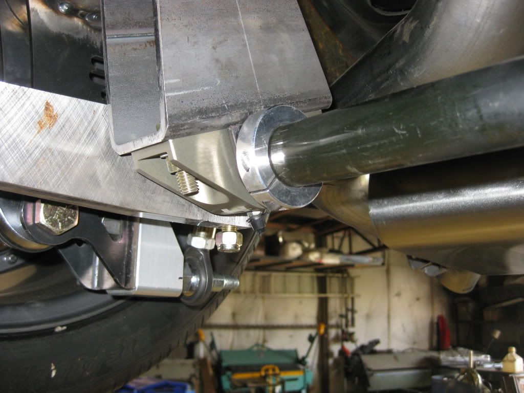

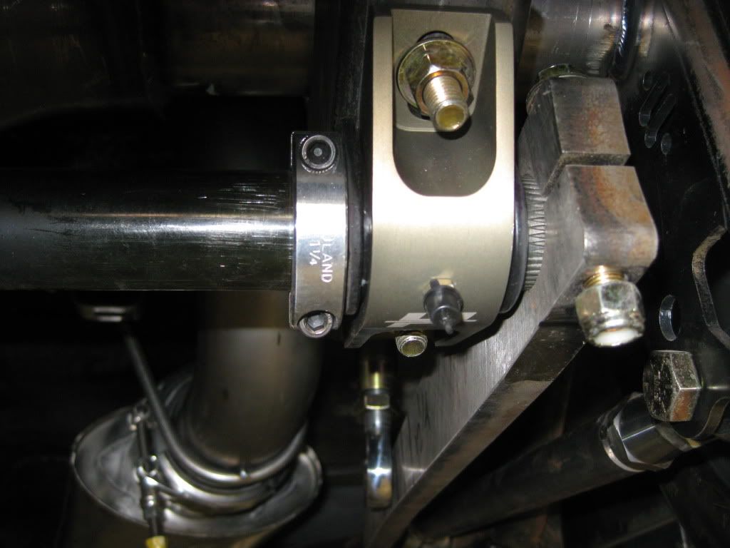

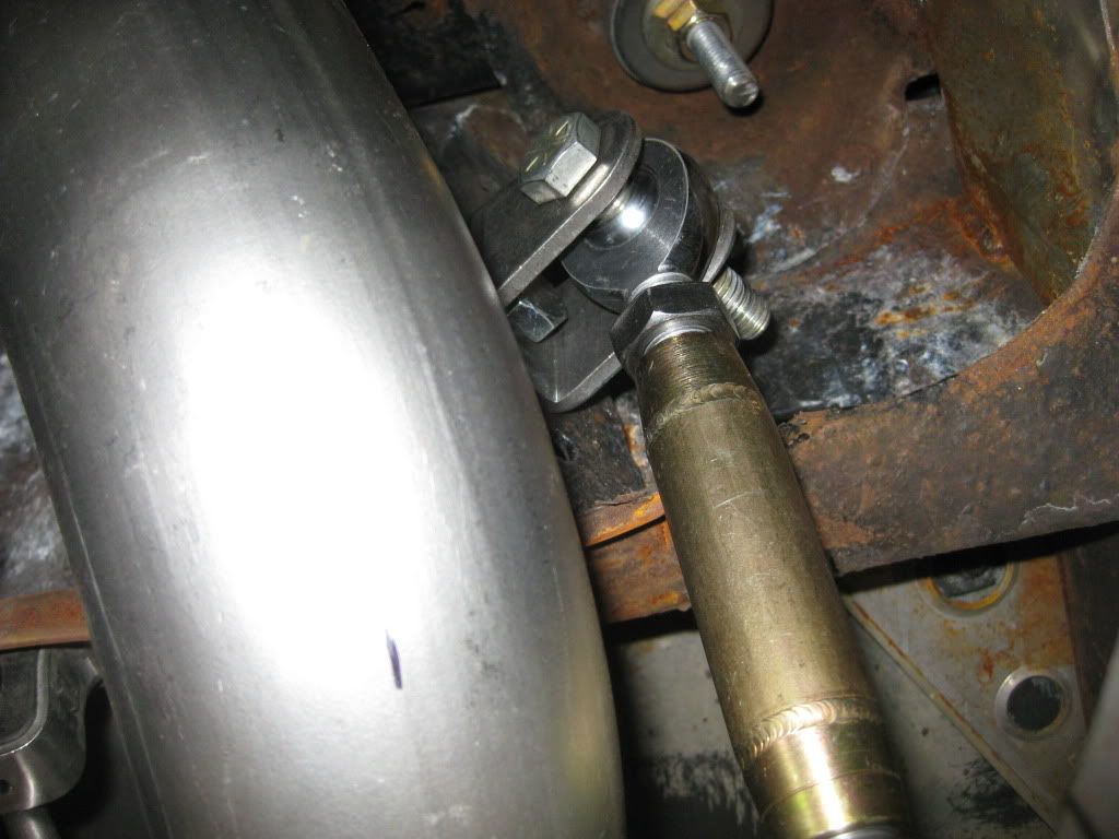

Rear sway bar install
http://i1104.photobucket.com/albums/...lebuild013.jpghttp://i1104.photobucket.com/albums/...lebuild012.jpghttp://i1104.photobucket.com/albums/...lebuild011.jpghttp://i1104.photobucket.com/albums/...lebuild010.jpghttp://i1104.photobucket.com/albums/...lebuild009.jpgI have order some alum. splined arm's for the rear,instead of the steel unit's.I am going to ude them on the frt. bar.I should be able to ajust the rear bar from about 780" lbs. to 321".The splined bar arms will have an ajustment hole .750 apart.
parsonsj 09-15-2012 12:29 PM
You're welcome! I love seeing installation pics. Your diff Vent will be there mid-week. Thanks for posting!
coolwelder62 09-15-2012 02:16 PM
I was going to build my own fuel & diff vent's(Then I saw these).It would have taken me a whole day of cuttin,fabbin,weldin,and probably $120.00 in material's and then $100.00 @ the adodizor.So I think these are a great deal for what you get.Plus they look really cool.:thumbsup: :thumbsup:
