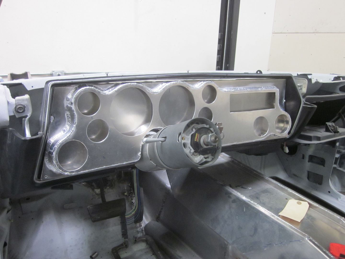

We needed some kind of dash insert to place all the gages & switches.. So we made a pattern out of aluminum to get everything where we wanted it.. then got a mold done to pop some pcs out of fiberglass.. We cut out the dash then we bond it with panel adhesive.. body work.. paint with texture..
http://i1015.photobucket.com/albums/...ps3ee4cd44.jpg
http://i1015.photobucket.com/albums/...ps84176008.jpg

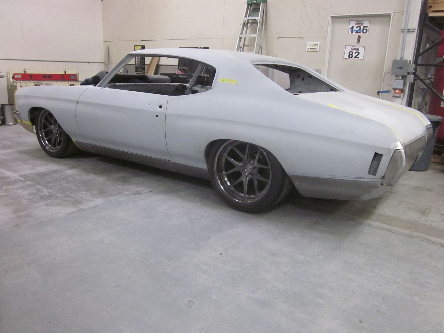

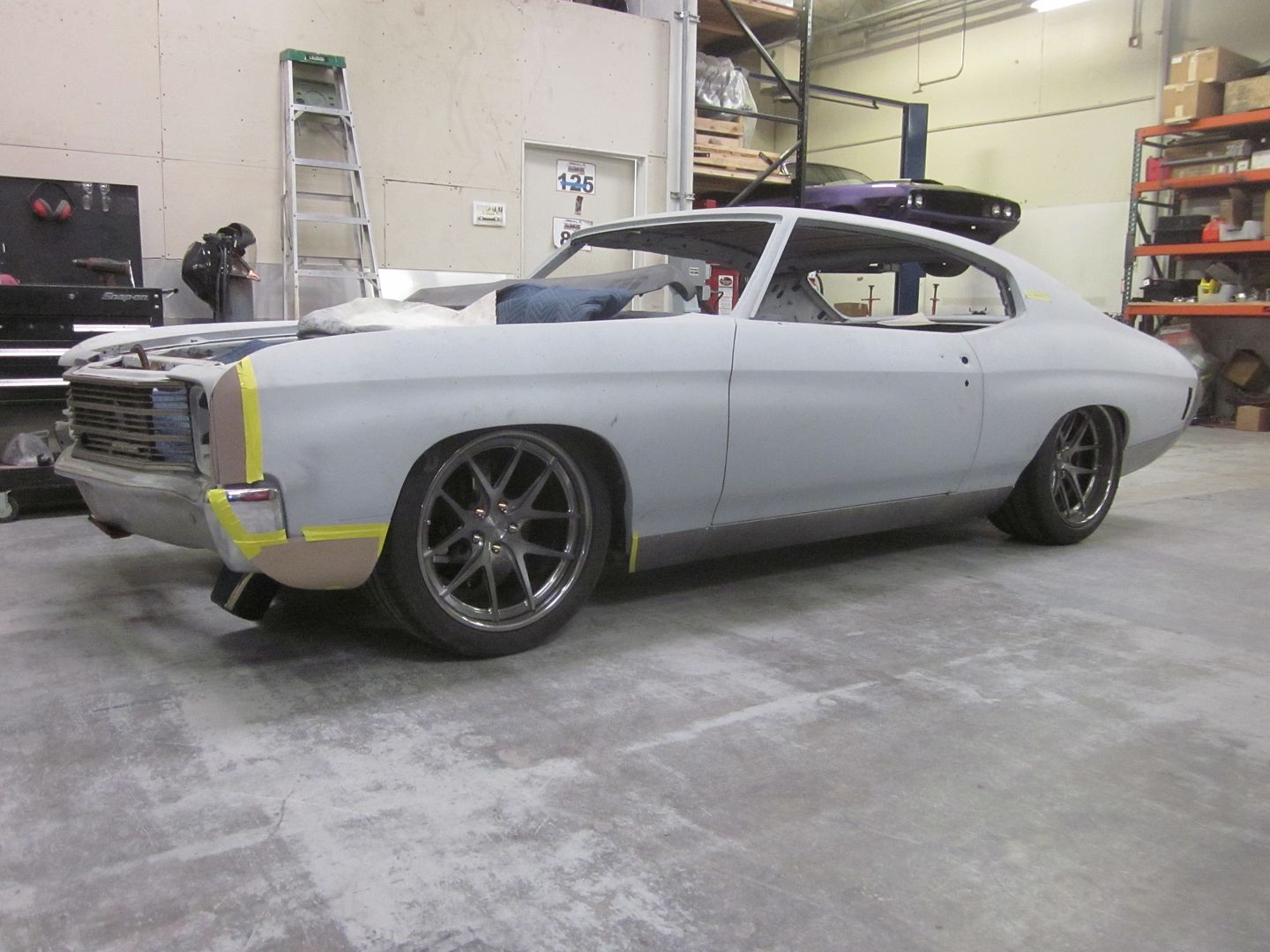

Some shots of the car sitting on the ground! Carter Hickman worked on a rendering for another customer that extended the rockers that made me look @ builds in a different way.. So we implemented it on the this 72.. plus we took on the task of building a rear bumper from scratch..
http://i1015.photobucket.com/albums/...psd522bbc1.jpg
http://i1015.photobucket.com/albums/...psdc6b1214.jpg
