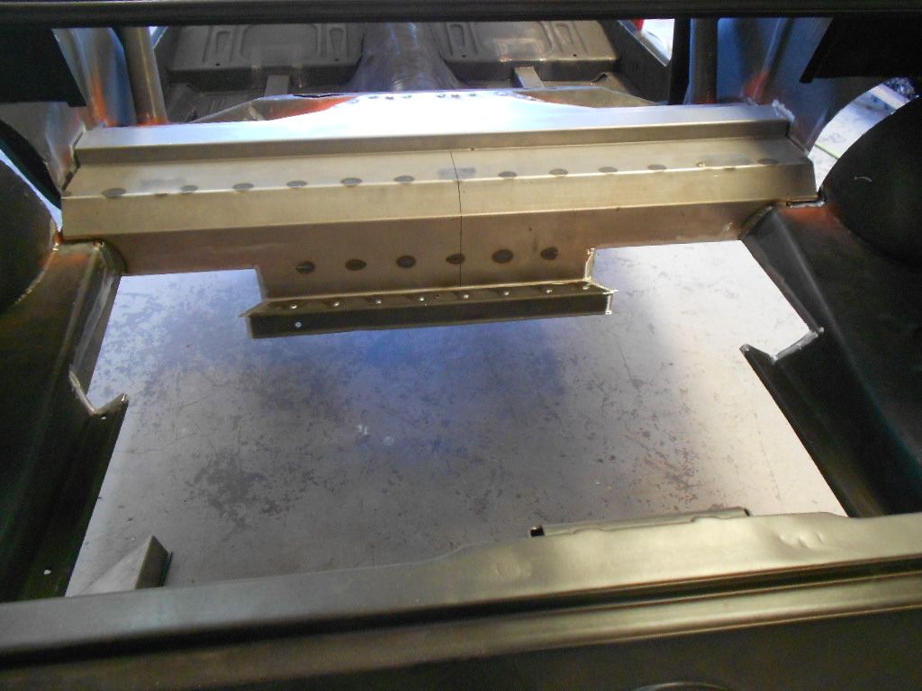

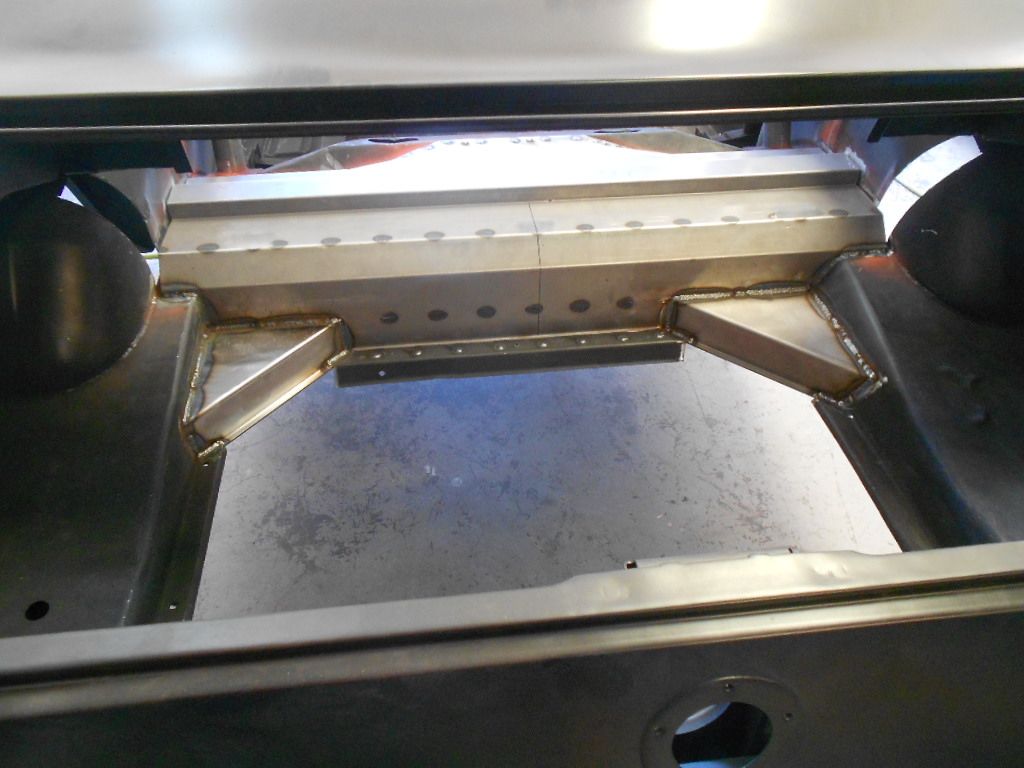

Brian wanted something fun to work on so he started installing the DSE rear suspension. Part of the trunk floor has to be cut out.
http://img.photobucket.com/albums/v3...ps4db80ae6.jpg

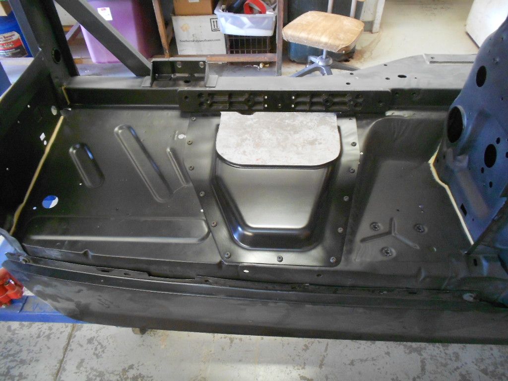

Installing the new DSE floor
http://img.photobucket.com/albums/v3...psb28d2a20.jpg
http://img.photobucket.com/albums/v3...ps604abda3.jpg
http://img.photobucket.com/albums/v3...psde082000.jpg
http://img.photobucket.com/albums/v3...psf8845ad0.jpg

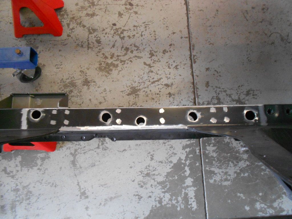

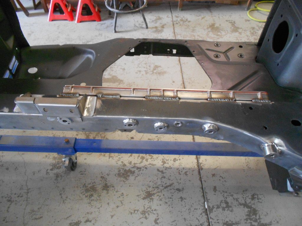

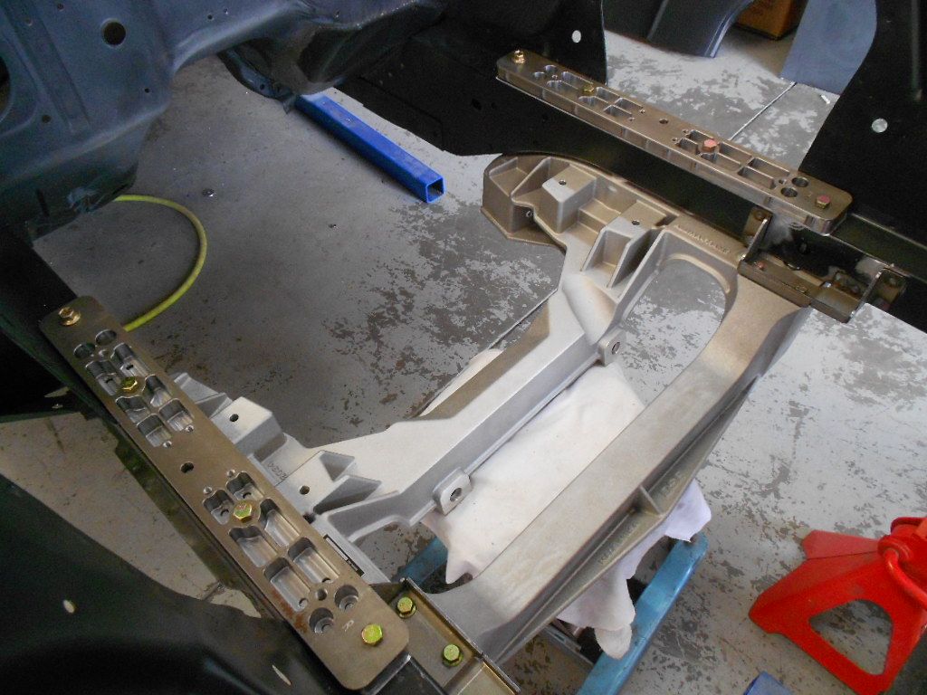

Front cradle bolted in place and new DSE front mounts welded in place of the stock sway bar mount
http://img.photobucket.com/albums/v3...psc3b8964e.jpg

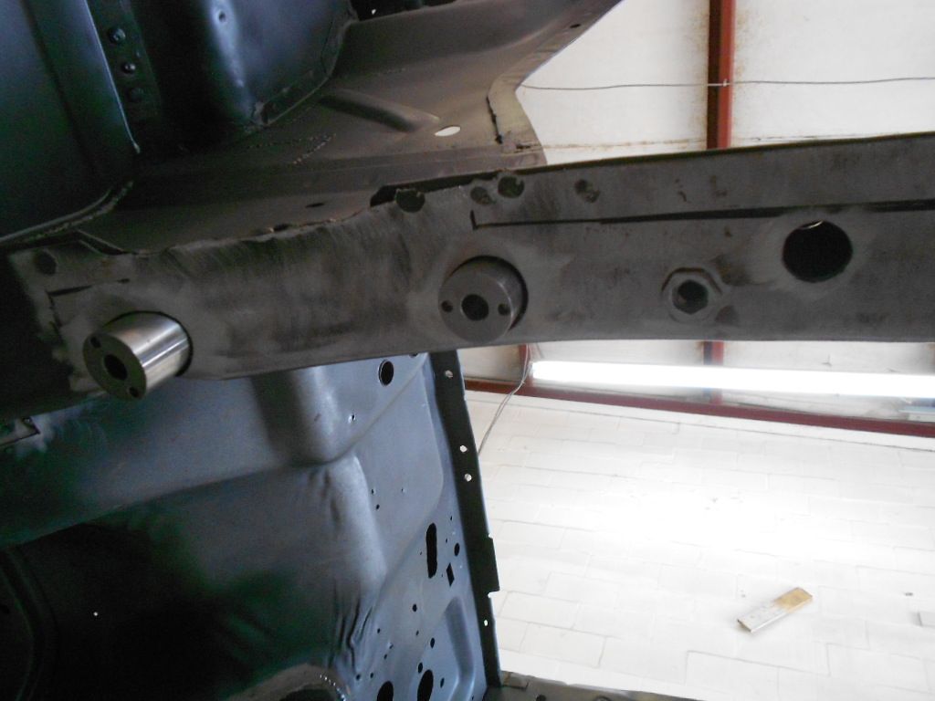

Holes drilled in frame
http://img.photobucket.com/albums/v3...psa1df3bb5.jpg

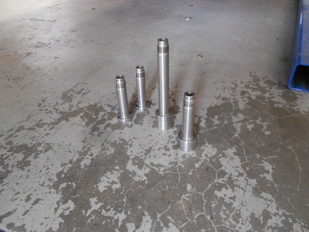

Crush tubes that go in the frame
http://img.photobucket.com/albums/v3...ps3bb3389e.jpg
Crush tubes bolt to the upper mount and will be welded to the frame
http://img.photobucket.com/albums/v3...ps1fdaea7f.jpg
http://img.photobucket.com/albums/v3...ps438e5865.jpg

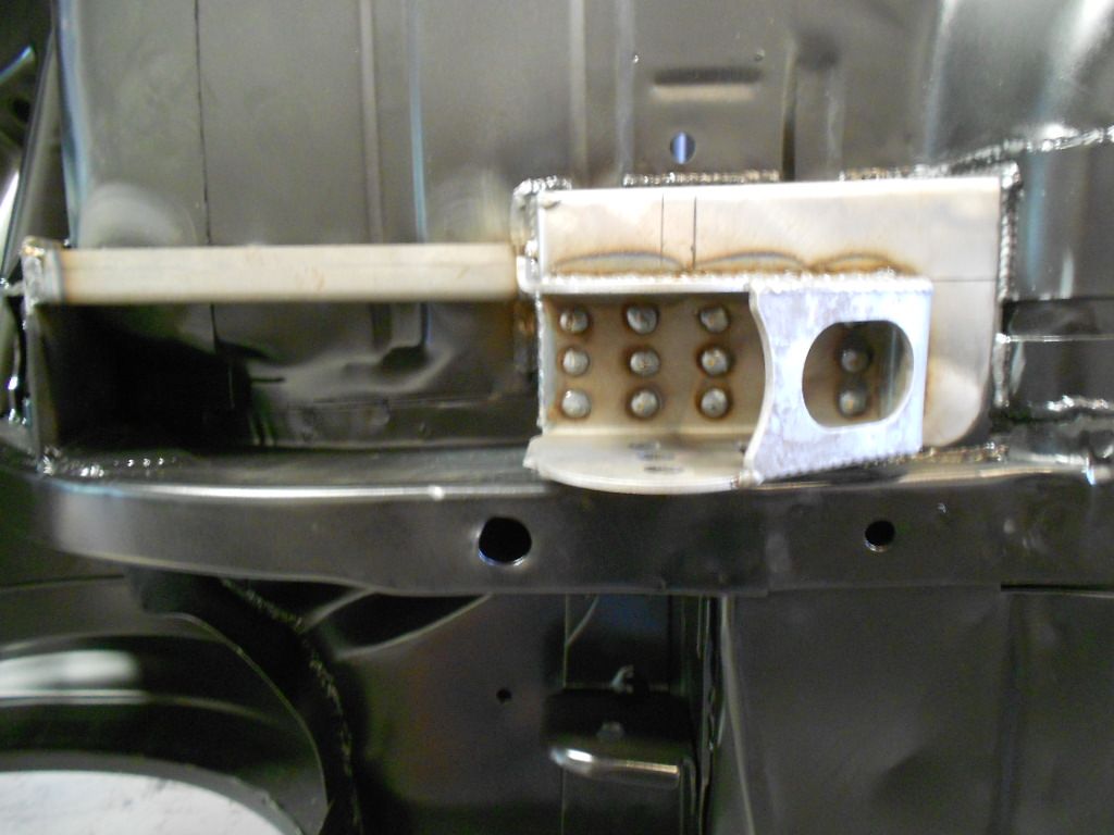

Top bracket plug & tack welded in place
http://img.photobucket.com/albums/v3...psbed2606a.jpg
http://img.photobucket.com/albums/v3...pse3d70f1a.jpg

you guys going to weld the crush sleeves into the frame?

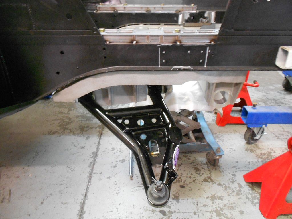

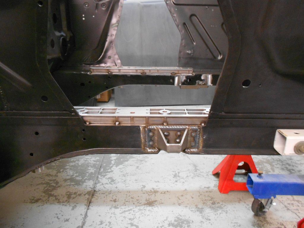

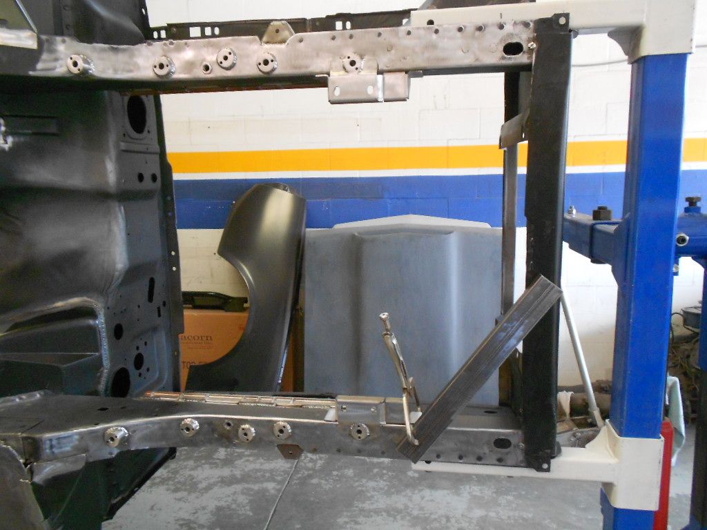

GPR 02-28-2014 07:06 AM
You have to weld a snubber bracket to the frame rail
http://img.photobucket.com/albums/v3...pscad8e77f.jpg
http://img.photobucket.com/albums/v3...psb32fc586.jpg
Crush tubes welded in place
http://img.photobucket.com/albums/v3...ps9352b6ac.jpg
http://img.photobucket.com/albums/v3...ps5e9f7723.jpg

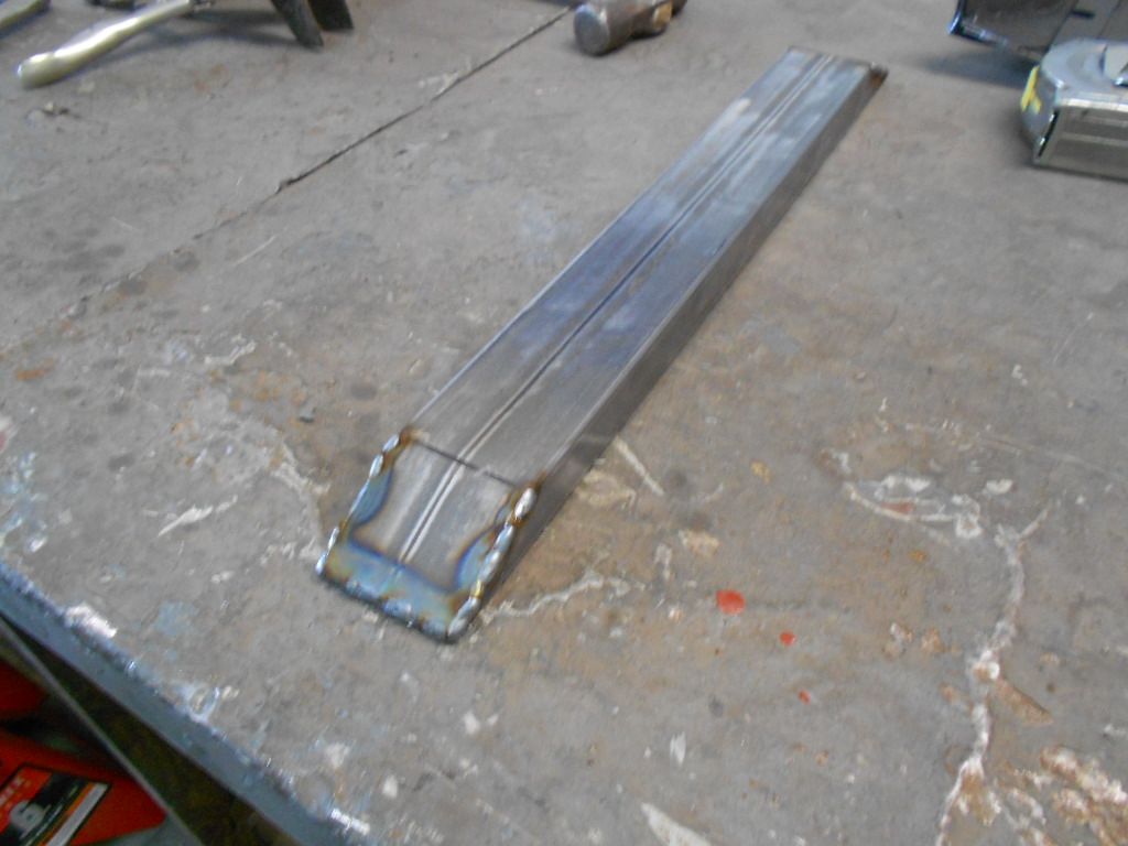

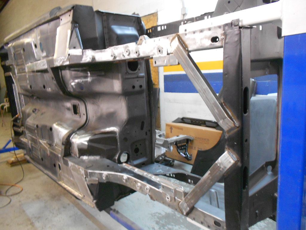

Starting to fabricate a brace. DSE leaves the stock strut rod brackets but I like this better plus it gives you somewhere to place a jack.
http://img.photobucket.com/albums/v3...ps8de92309.jpg
http://img.photobucket.com/albums/v3...ps34e4456e.jpg
http://img.photobucket.com/albums/v3...ps7a4f53f1.jpg
http://img.photobucket.com/albums/v3...ps40ef1a98.jpg
http://img.photobucket.com/albums/v3...ps1d5f4f5e.jpg

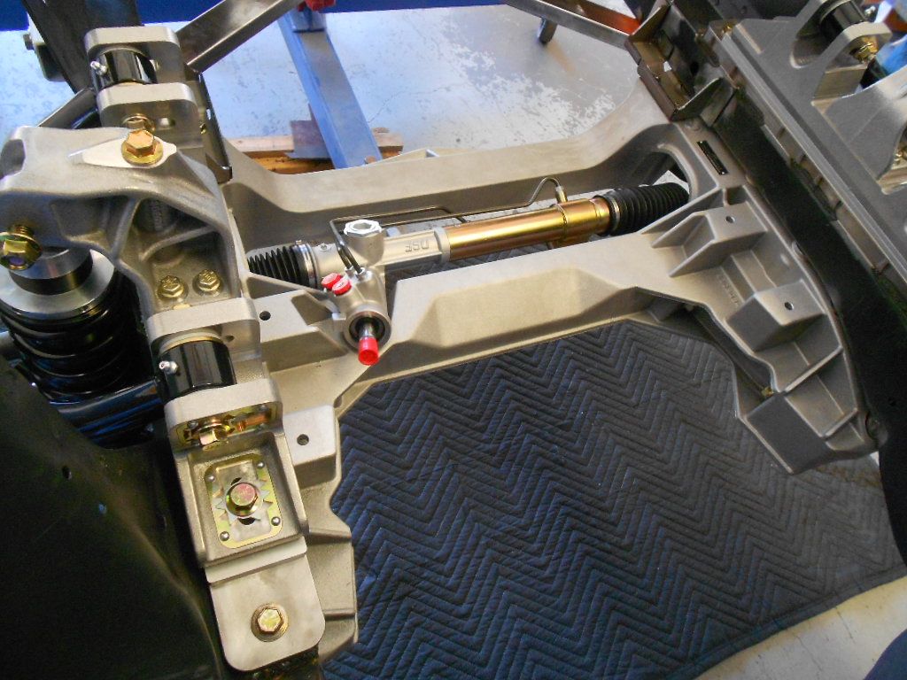

GPR 03-05-2014 06:28 AM

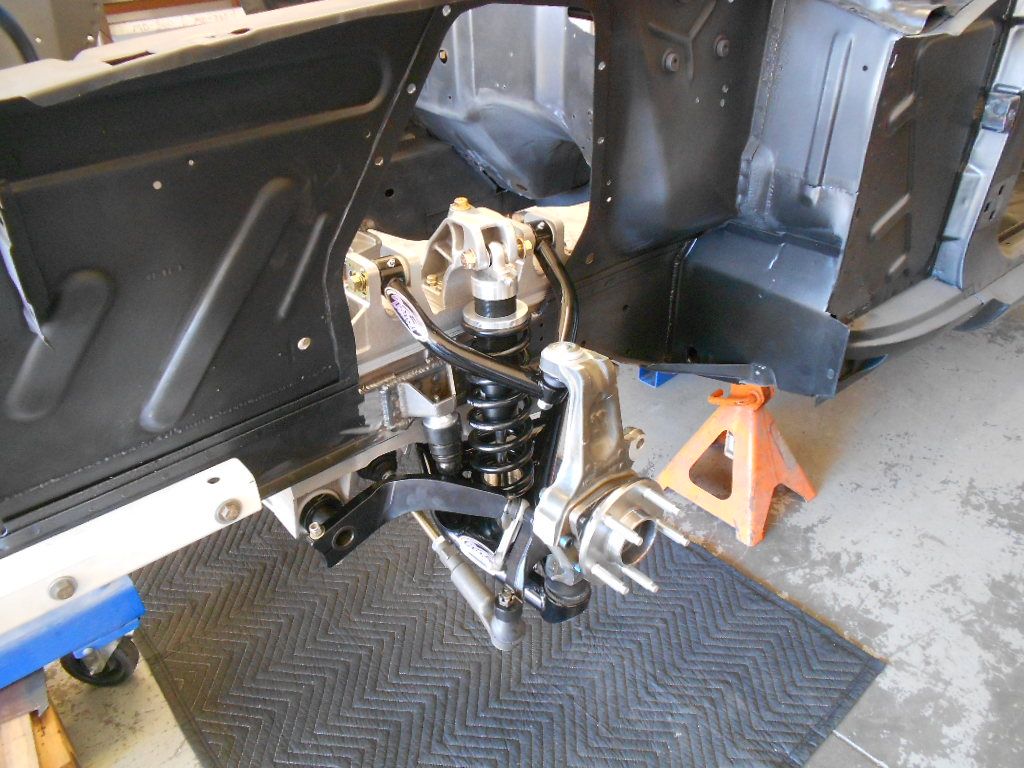

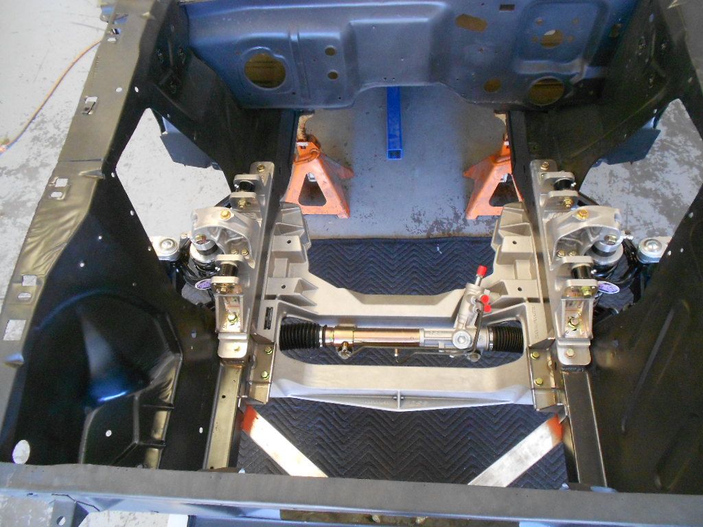

Test fitting the front suspension
http://img.photobucket.com/albums/v3...psc04ff11f.jpg
http://img.photobucket.com/albums/v3...ps3836dcd5.jpg
http://img.photobucket.com/albums/v3...psc13e701b.jpg

Looking good Rusty. Almost like it belongs there from factory. :D
Keep us posted.

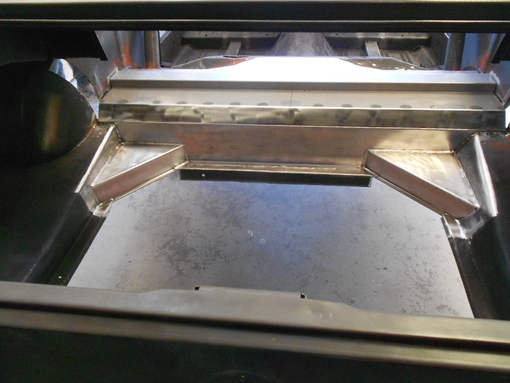

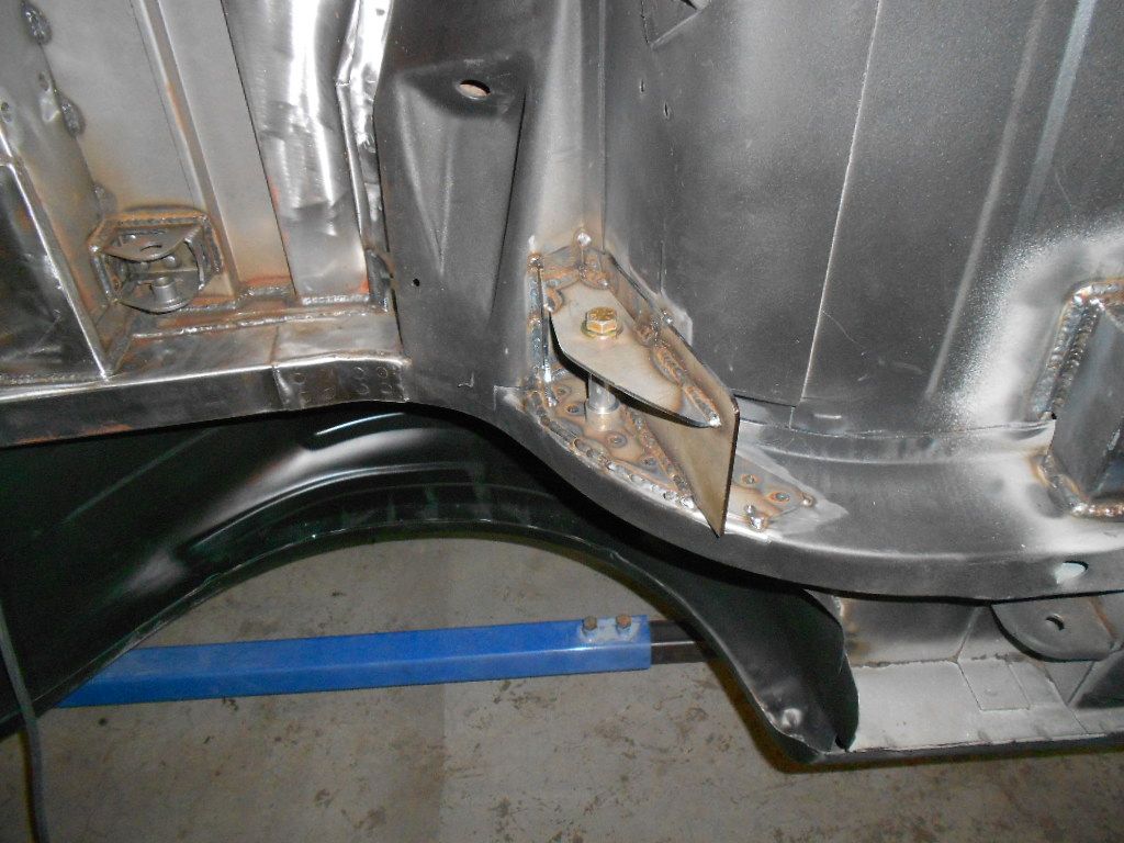

It has been awhile since Brian started installing the DSE rear suspension.
You have to assemble the upper control arm bracket.
http://img.photobucket.com/albums/v3...ps40f84371.jpg
http://img.photobucket.com/albums/v3...ps4172003a.jpg
Shock mounting bracket also welded in place
http://img.photobucket.com/albums/v3...ps756f47be.jpg
http://img.photobucket.com/albums/v3...ps4b04b4c4.jpg

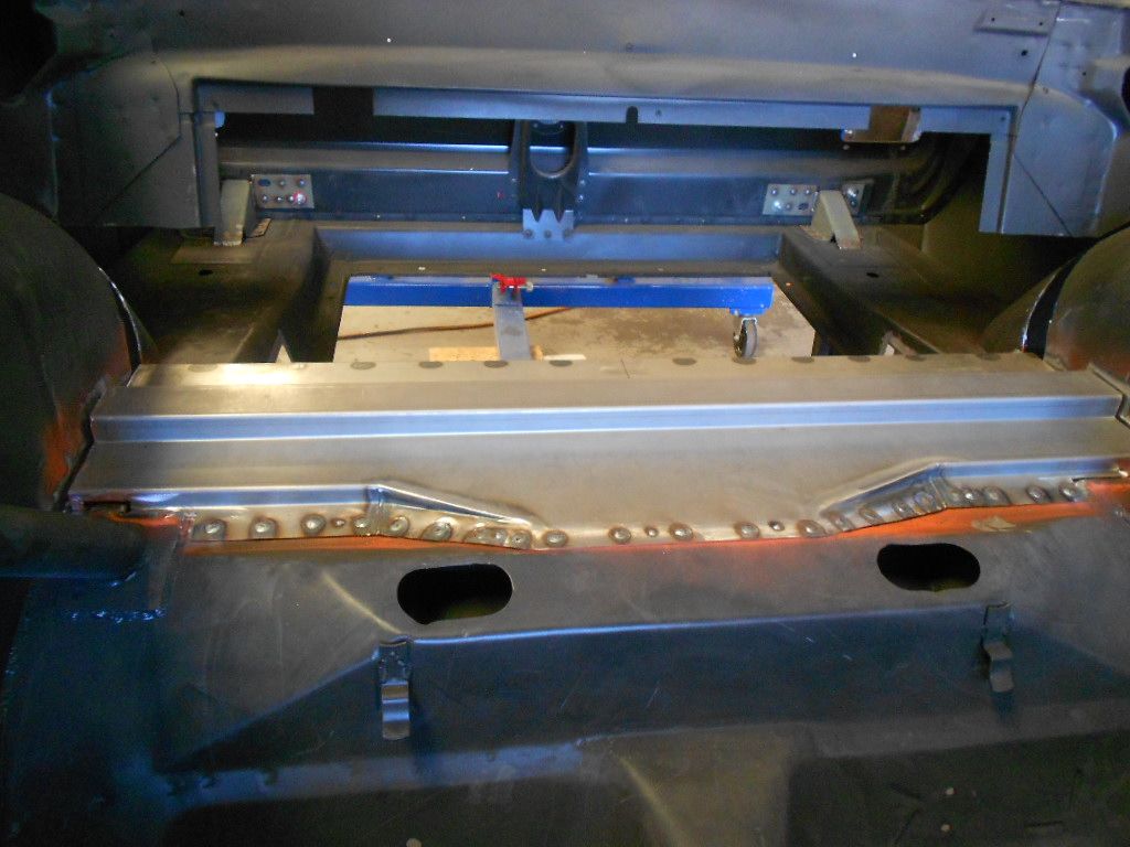

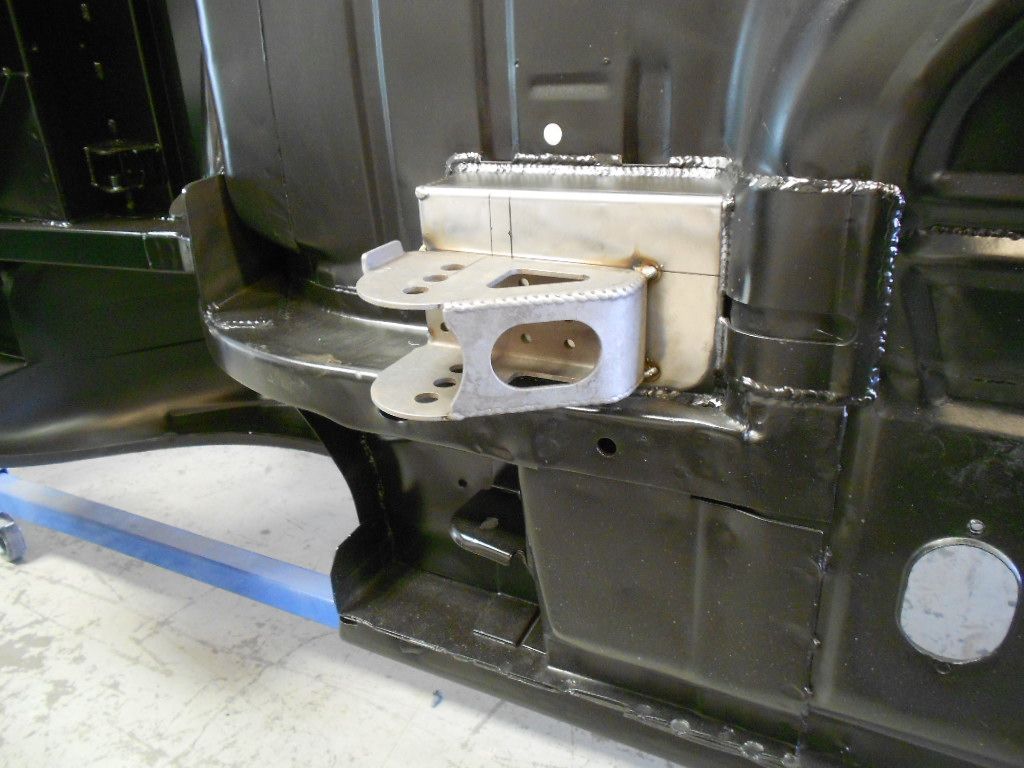

GPR 06-15-2014 11:55 AM

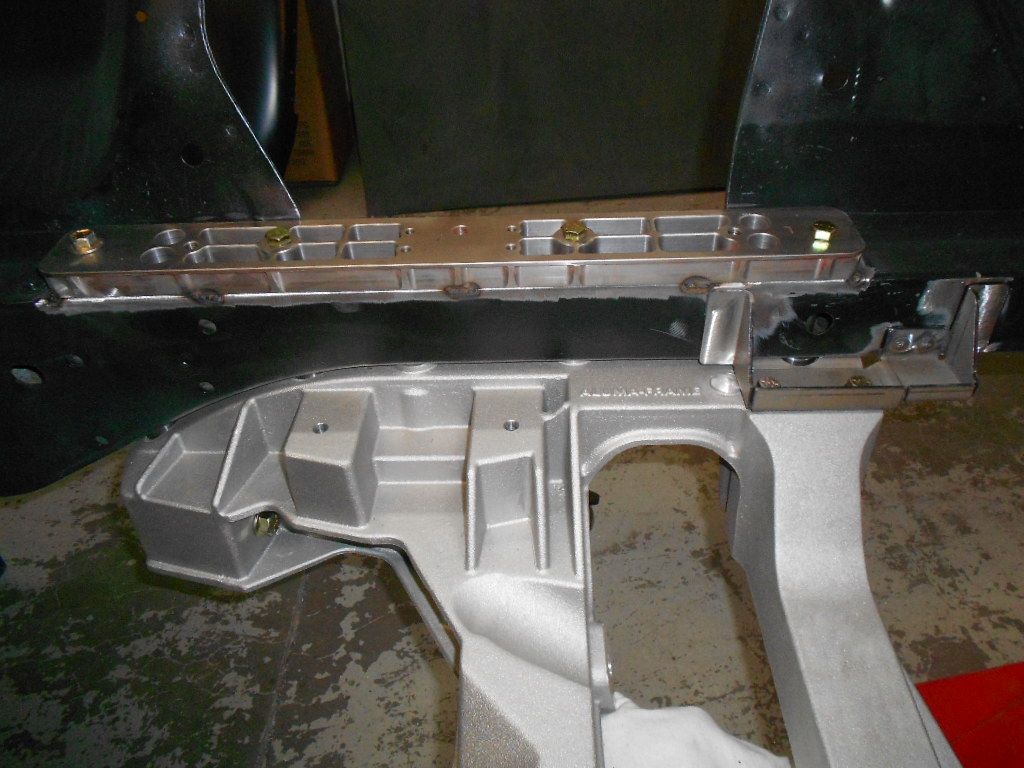

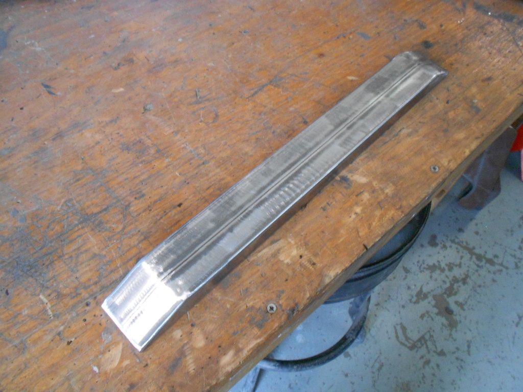

Before Brian started the bottom brackets I sprayed a couple coats of epoxy
http://img.photobucket.com/albums/v3...psd5100da2.jpg
The lower bracket is tack welded to the DSE torque box.
http://img.photobucket.com/albums/v3...ps3b6bdf04.jpg
Welded in place along with another bracket
http://img.photobucket.com/albums/v3...ps4733aa0a.jpg
http://img.photobucket.com/albums/v3...ps8671ef04.jpg
http://img.photobucket.com/albums/v3...psbca116f7.jpg

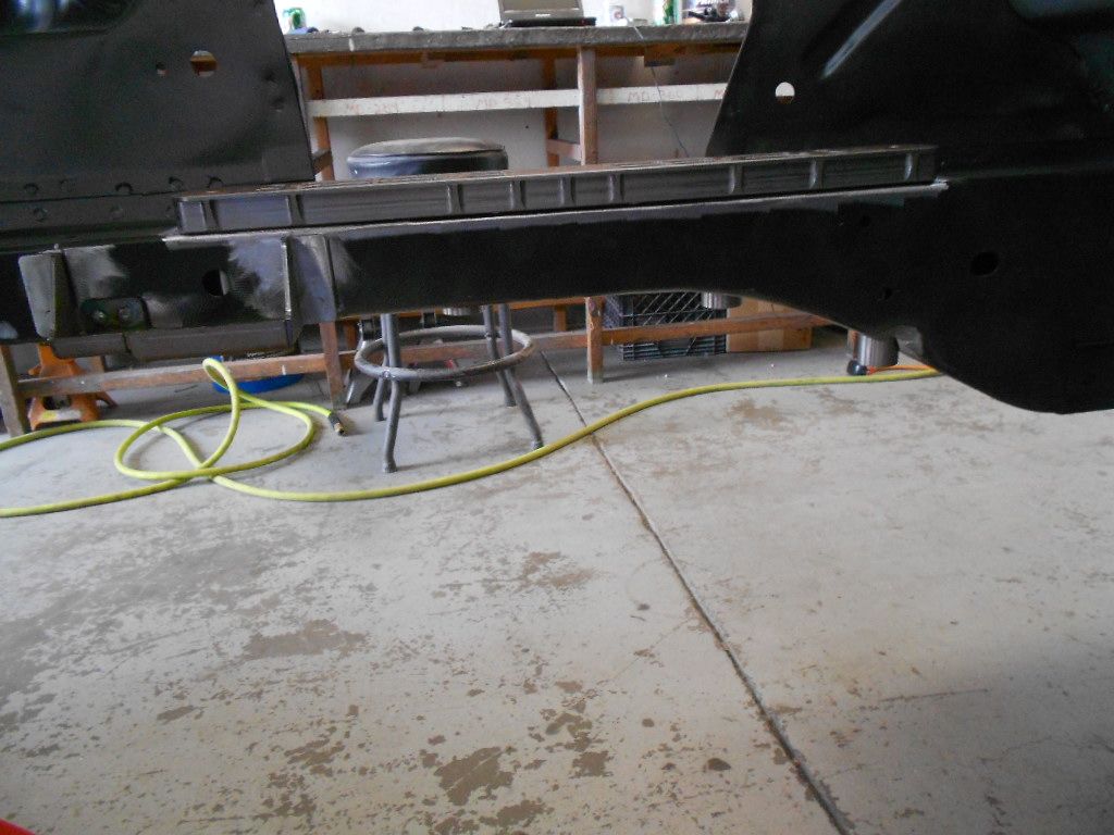

?? How much lower then the frame rails does that bracket hang. It looks to be like 3 or 4" which seems awful low.

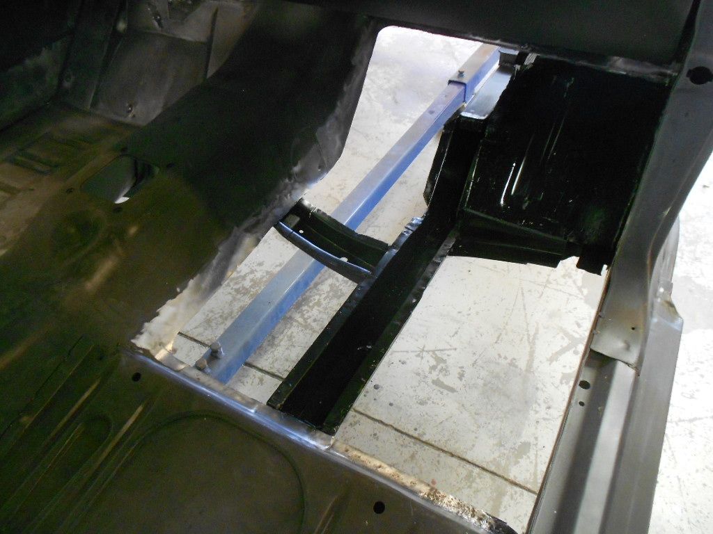

GPR 07-27-2014 09:50 AM

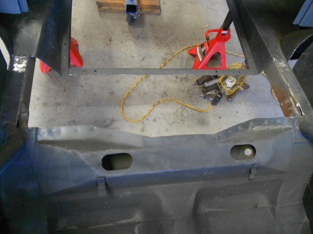

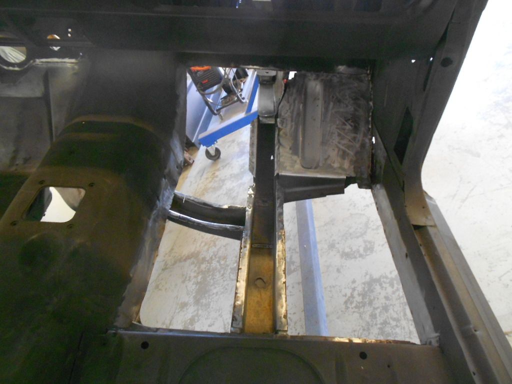

At one time the floor board had been worked on.
http://img.photobucket.com/albums/v3...psdc3cc362.jpg
http://img.photobucket.com/albums/v3...ps2af0609f.jpg
Brian cut out the floor
http://img.photobucket.com/albums/v3...psf7a8a30f.jpg
Cleaned the frame rail and epoxy primed
http://img.photobucket.com/albums/v3...ps7909bb28.jpg
New floor pan
http://img.photobucket.com/albums/v3...ps6c43e89e.jpg
Sanded and ready for SPI black epoxy
http://img.photobucket.com/albums/v3...psf4866ec5.jpg
http://img.photobucket.com/albums/v3...ps9fd27f09.jpg
http://img.photobucket.com/albums/v3...ps29cf99c4.jpg
Sprayed a couple coats of black epoxy
http://img.photobucket.com/albums/v3...ps3b0fe000.jpg
http://img.photobucket.com/albums/v3...ps5b8559ee.jpg

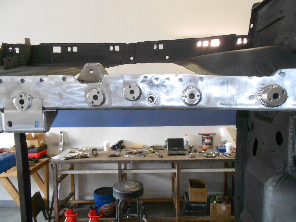

GPR 02-13-2015 01:29 PM

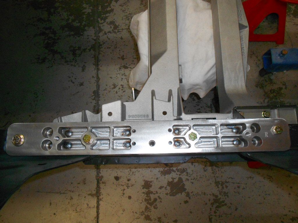

Brian installed the DSE suspension today so we can figure out our wheel and tire combo. This is the first time test fitting the rear suspension. Everything fit perfect and Brian said the hardest thing to install was the rear sway bar.
http://img.photobucket.com/albums/v3...ps1f3ccc4a.jpg
http://img.photobucket.com/albums/v3...ps878bd0f7.jpg
http://img.photobucket.com/albums/v3...psaf514b39.jpg
http://img.photobucket.com/albums/v3...ps1613cbfa.jpg
http://img.photobucket.com/albums/v3...ps498ba6c4.jpg
http://img.photobucket.com/albums/v3...psf76a9bee.jpg

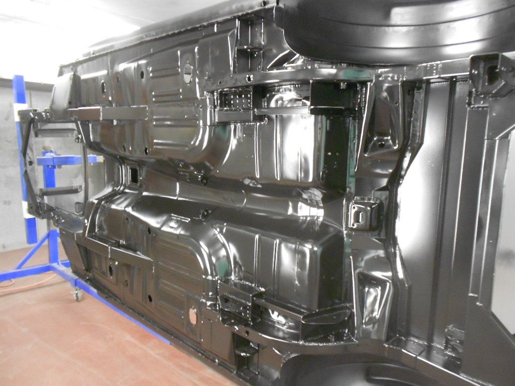

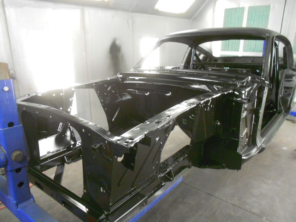

GPR 08-03-2015 02:20 PM
The undercarriage, engine compartment and interior was seam sealed.
http://img.photobucket.com/albums/v3...pszn6ayiol.jpg
http://img.photobucket.com/albums/v3...ps3pwwlcl7.jpg
The extra firewall holes were filled in
http://img.photobucket.com/albums/v3...psa5dosg4c.jpg
Epoxy primed
http://img.photobucket.com/albums/v3...pssgh0u8oy.jpg
http://img.photobucket.com/albums/v3...psdttnixib.jpg
http://img.photobucket.com/albums/v3...ps2x8owlan.jpg

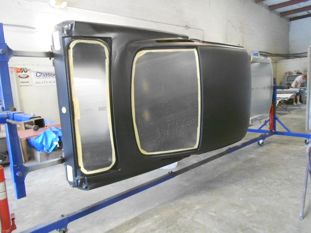

Brian is taping the body so we can spray a couple coats of Slick Sand primer
http://img.photobucket.com/albums/v3...psr8gcsbce.jpg
http://img.photobucket.com/albums/v3...ps16sbwnjt.jpg
http://img.photobucket.com/albums/v3...psui0o9gyb.jpg
