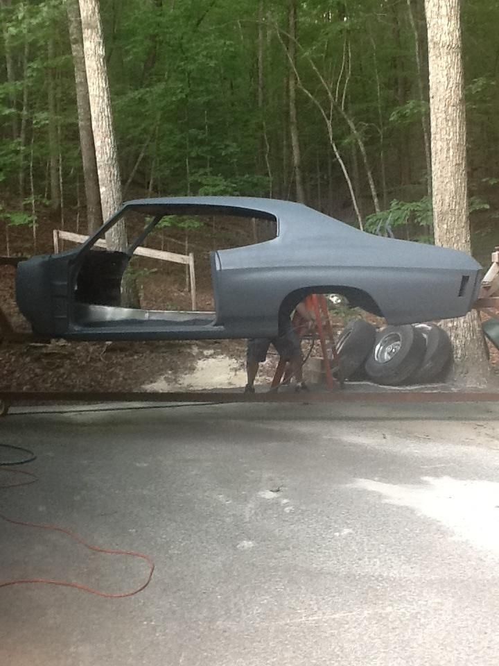

Che70velle 07-21-2013 08:14 PM
Huge milestone for me. Bodywork is done, and car is sealed. This took me a while. I'll be putting the shell on the chassis, which has been done for a while now, and build the entire car. Check gaps, make sure harness works, in case I need to drill and grommet something, etc. I just want to make sure everything is right before we paint. So basically build car, blow it apart, paint, and rebuild car.
The good news is I've already mocked the car up entirely once, body wise, so my gaps are decent. Believe it or not, I'm on the downhill slide. Bodywork absolutely whipped me. I'm too picky.

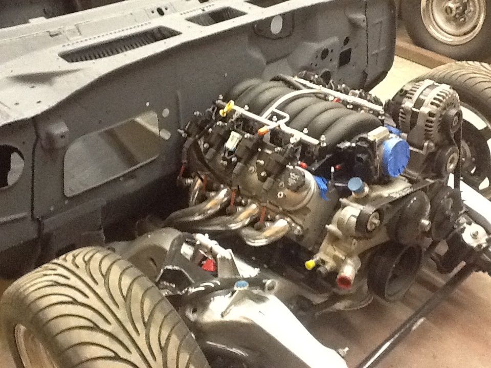

Che70velle 07-26-2013 08:48 PM
More pics
http://i1278.photobucket.com/albums/...psce8ba421.jpg
I'm planning on body working the tunnel and painting it body color. I will break the carpet at the edge of the tunnel, and leave it exposed. I will place heat retardant material under the tunnel to try and manage temps in the cabin.

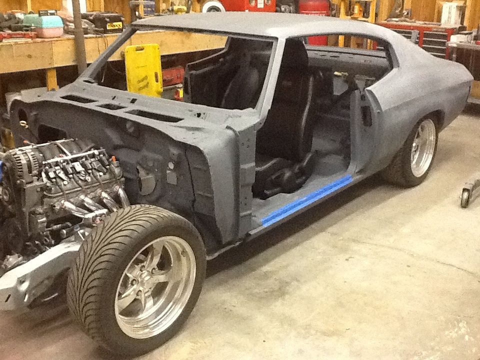

Che70velle 08-18-2013 01:17 PM
I re-introduced the body to my chassis. I think that they were glad to see each other again. I was really happy to remove the body from the rotisserie for the final time. Anyone need a rotisserie?
http://i1278.photobucket.com/albums/...psbef52a99.jpg
Che70velle 08-18-2013 01:19 PM
Another shot...
http://i1278.photobucket.com/albums/...psce373445.jpg
