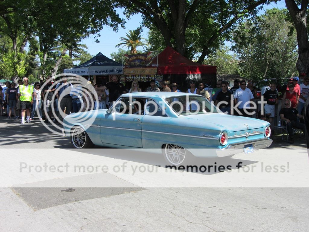

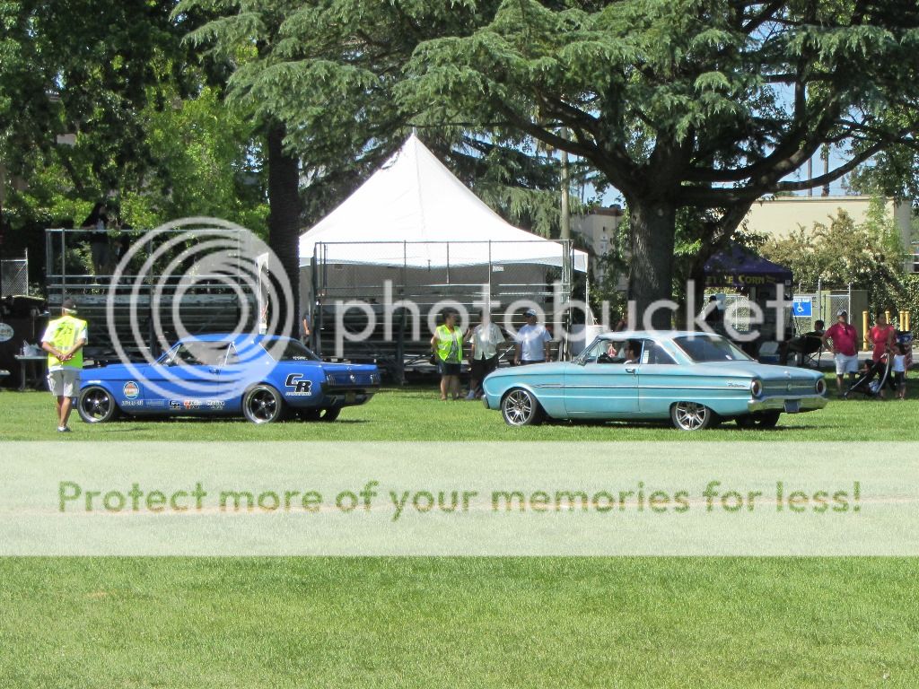

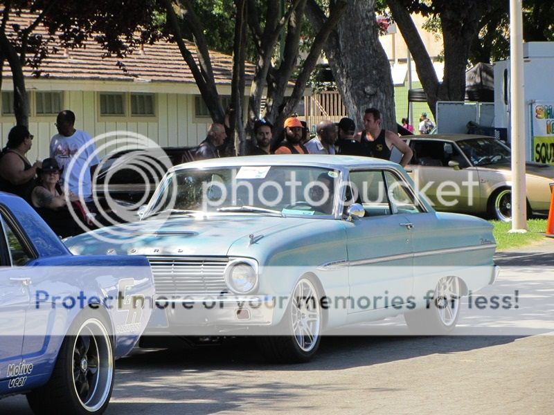

craig510 06-02-2013 06:24 PM
Here are some stills and the video of my fast run. Thanks for all the support guys. Hard work and practice really paid off. I surprised a lot of the pro builders with my plan Jane looking falcon and I surprised myself with how much my driving and car control has improved. The spherical bearings in the strut rods probably make the single biggest difference in the handling of the car. They let you stand on the brakes and turn in at the same time, roll on the throttle and the car rotates exactly where you want it.
http://i885.photobucket.com/albums/a...ps4bc114af.jpg
I didn't think I would get here for a couple of more years.
http://i885.photobucket.com/albums/a...ps32a26630.jpg

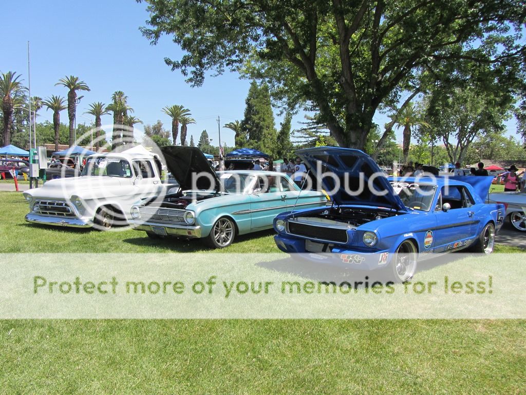

Winners Circle (Not a single street rod (that was legal) entered the Autocross. All they would have had to do was drive around the track and they would have gotten about $1500 worth of goodies).
http://i885.photobucket.com/albums/a...ps5f30662f.jpg
I copied Maier's setup for his car, and it flat works. Look at how similar the cars sit.
http://i885.photobucket.com/albums/a...psc8ac2806.jpg
http://i885.photobucket.com/albums/a...psc073466c.jpg
This was my fastest clean run of the weekend, I ran .091 faster, but tickled a cone and it fell over, I think that one was shot in wide screen, I will upload it later and post the link.
Sorry for the long lead in and exit, I thought it was fun to hear the announcer so I did not cut it down.

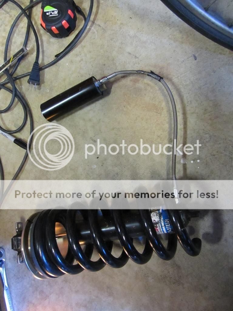

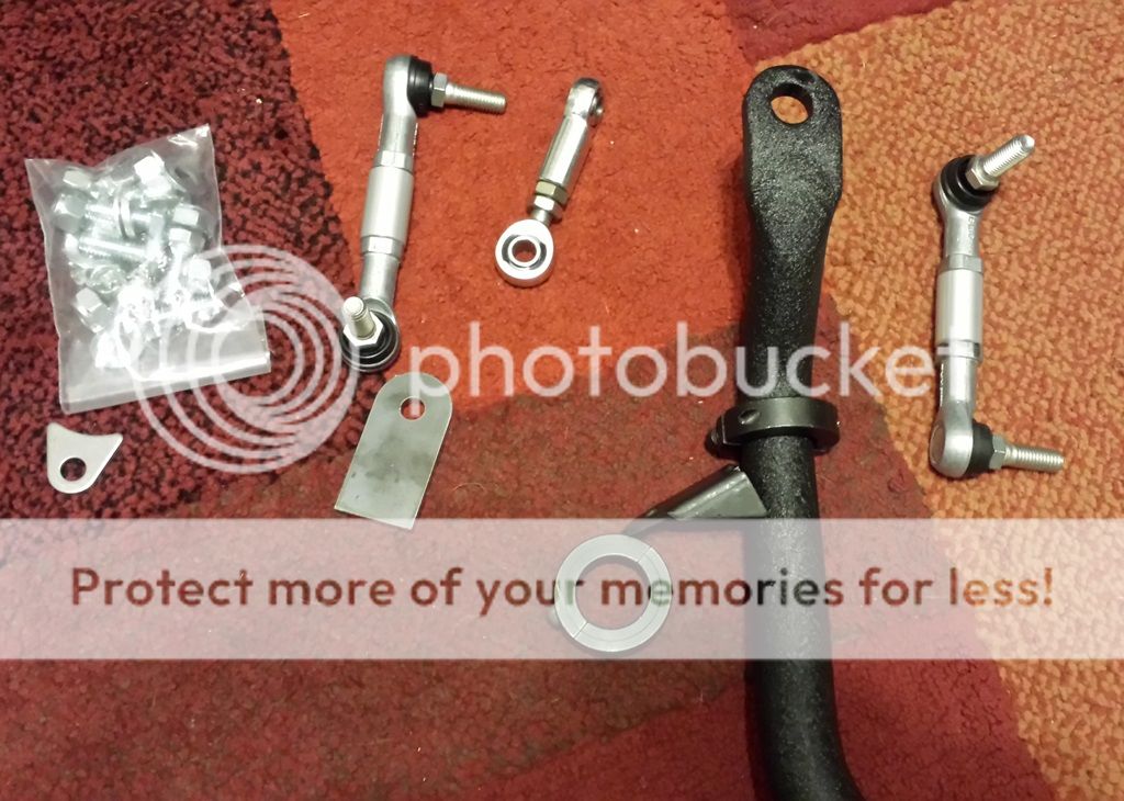

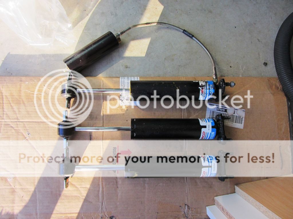

I have some new parts that will be going on in the next couple weeks / months:
+ 1.25" Ridetech hollow swaybar
+ Modified Bilstein shocks with adjustable Penske canisters (On loan from Mike Maier)
+ Optima Battery

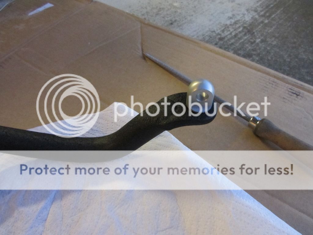

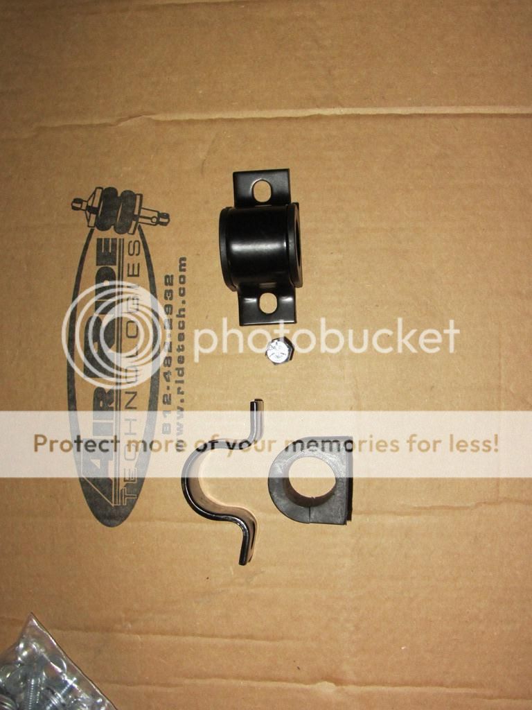

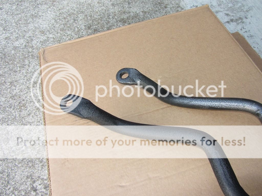

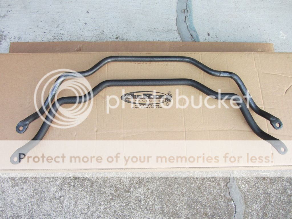

The Ridetech bar was a small diameter than described (basic 1.125" mustang swaybar). The posi links only have a 2500# load rating, but it should be ok, hopefully they get loose or crack before failure. I can always install larger ones or 1/2" heim joints at a later date.
I am going to cut off the end of the swaybar and add some collars to make it adjustable and increase the rate. By mounting the link to the upper arm it looks like I can get at least a .64 motion ratio and about a 440lb/in wheel rate.
If this bar is not stiff enough, I am going to cut up my 1" bar and weld or braze in a 1.375 x .188" wall chromemoly tube to replace the center.
[IMG]http://i885.photobucket.com/albums/a...ps97458869.jpg[/IMG]

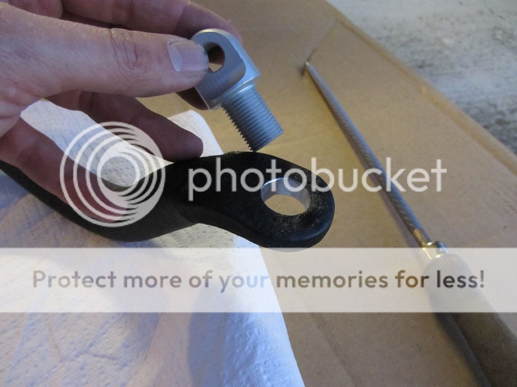

craig510 09-02-2013 09:13 PM
This is a little late in coming, but home ownership and a new puppy have been getting the best of me. Spent 5 hours this weekend breaking up a 7'x7'x5" wire renforced concrete spa pad the hard way with a 10lb sledge. (It is all to make way for my new shed)

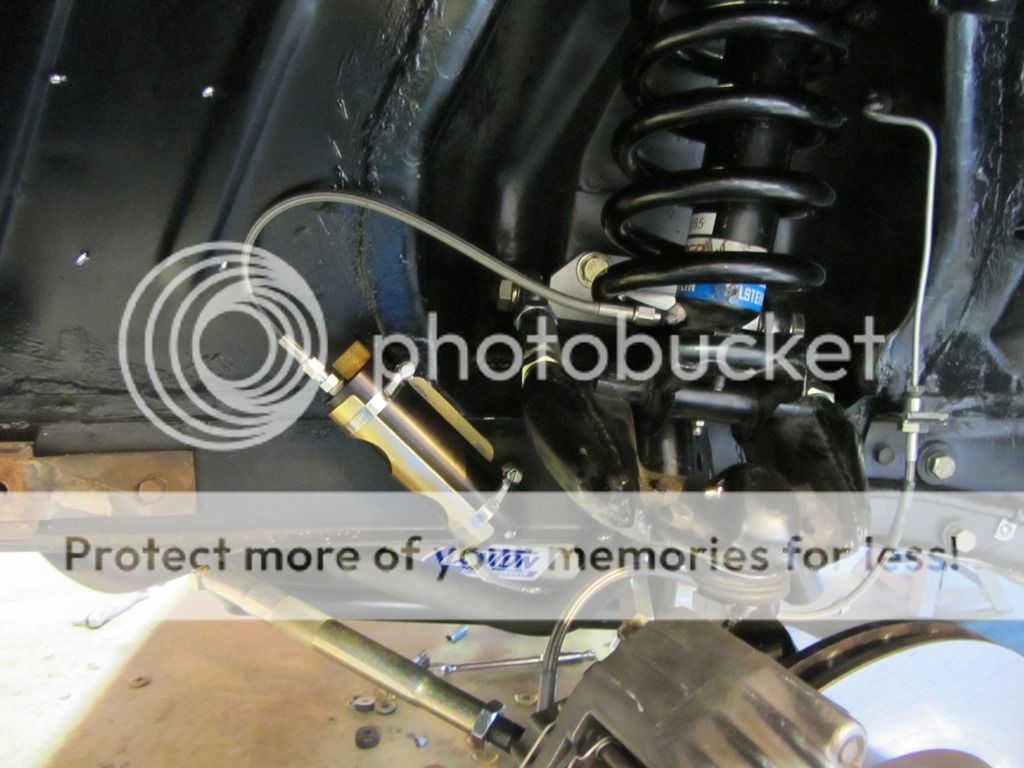

These are from last weekend. Torqued up the wheels at 9:30 PM Saturday night and was at the track 8:00 AM on Sunday, then went to a wedding at 3:00 PM.

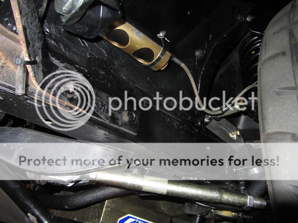

It took a couple tries to find a spot to mount the Mikes special Penske canister shocks.
Even on setting 1, the shocks feel stiffer, but they have a more plush feel. I think that it has to do with the slower ramp up of the nitrogen pressure with the larger remote reservoir. I also mounted my RideTech bar (using my old end links). I must say, I am dissapointed with the Ford "Muscle Bar." It is just a run of the mill 1-1/8" Mustang bar, came with lower quality mounting hardware, and would not fit the "Posi-Link" adapter without quite a bit of filing (which is no fun on spring steel). RideTech makes some excellent product, but this is not one, more of a fair quality product at a premium price.
I played quite a bit with tire pressure, working on getting good front and rear temps. I got my front pretty close, but I still had a hot center on my rears. At least I have a better starting point.
Some good videos showing the wheels. The geometry looks pretty good, but I think I am going to lower my roll center a little more and add some more front bar.
http://i885.photobucket.com/albums/a...ps53287a8d.jpg
RideTech vs Grab a Tracks bar.
http://i885.photobucket.com/albums/a...ps0034629a.jpg
Normal crush bends, and not too round at the bushings.
http://i885.photobucket.com/albums/a...psbf2c3d40.jpg
At least now, I could use the Posi-Links
http://i885.photobucket.com/albums/a...pscfe9a6f3.jpg
http://i885.photobucket.com/albums/a...ps4a2c2471.jpg

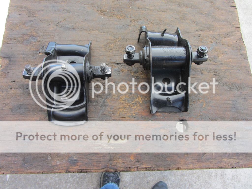

Had to work on the brackets to get them flat and not pinching the bushings.
http://i885.photobucket.com/albums/a...ps2a6e9bd5.jpg
The canister shock had to go in from the bottom, and I had to shorten my adjuster so that the TEE at the top would fit.
http://i885.photobucket.com/albums/a...psfc0ffb1e.jpg
Old vs New style mount, I modified my mount so that it can mount on either side (this let me point both shock canisters forward).
http://i885.photobucket.com/albums/a...pse322b9c7.jpg
This one rubbed the tire at bump and full lock.
http://i885.photobucket.com/albums/a...ps73664c9c.jpg
Finally got it.
http://i885.photobucket.com/albums/a...psaf00b082.jpg
Street vs Race vs Race Special

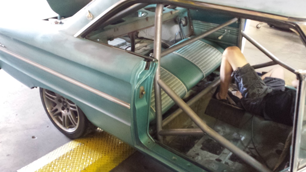

1 Attachment(s)
Attachment 47908
This should stiffen up the chassis quite a bit and allow me to mount some harnesses for track days.
