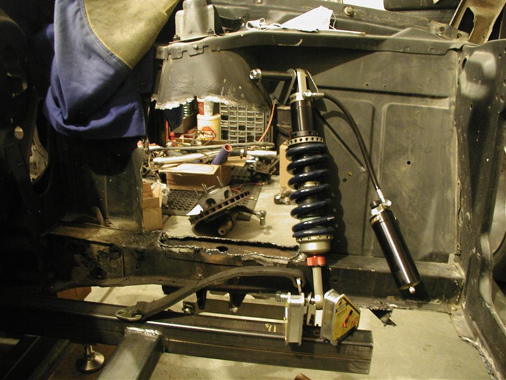

got a little progress today. Had some "surprise" work travel to NorCal right after I got back from DC area, then my mom drove into town last weekend, so it has been hectic again lately, but I did get some progress today - I worked with the machinist at my job to machine up the first of four bearing carriages to make my suspension rocker arms to move the shocks/coils inboard. We had to lathe out the center and then cut an internal groove for the spiral locks and he did an awesome job.
Now I need to see if I can make the pieces for the rocker and weld them on without distorting the hell out of the little housing. He has the bore tight to just over .001" which is way better than I could have done, but leaves me little room for overheating while welding.
It is hard to see but I have two bearings in there so they can react any moment trying to twist the arm and force it to only pivot about the bolt. He is going to make the other three housings tomorrow and then next week I hope to get in there and lathe up some 1/2" spacers for the bolt.
The nice thing will be that I can build a ratio into the rocker arm that matches the ratio at my lower A arm between the shock and wheel center - that will mean I should have a 1:1 wheel rate and therefore a 1:1 motion ratio. That is nice because I was buying really stiff springs for the 914 trying to get a good wheel rate, now whatever I want at the wheel will be exactly what the spring rate is, no motion ratio math to mess with.

Originally Posted by byndbad914 (Post 506500)
I suspect you are asking due to obvious interference with the upper A v. a coil over shock. I am going to use a strut rod that will go to one side of a rocker which will be swage tube, probably 1" in diam so clearance won't be an issue. Once I have the forward down tubes in the car, I will weld up some bracketry to mount the rocker arm I designed. I will then mount the shock vertically, off the frame, up to that rocker arm.
I went back thru as I recalled having a shot with my old Penske shocks laid in the front, here it is. Essentially I will get new Penskes and mount them roughly as shown here
https://lateral-g.net/forums/atta...1&d=1362884016
hmm, not sure why it only links and doesn't just reshow the image... just click on the link then and you see the image.
