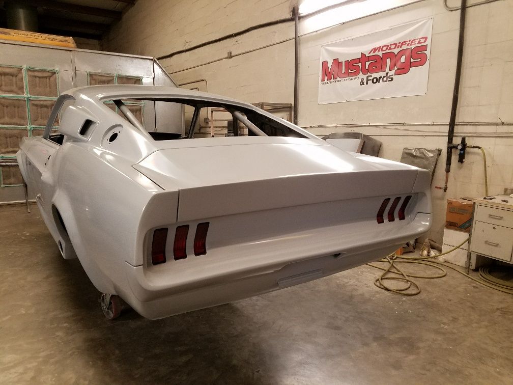

GPR 03-11-2017 10:05 AM
Quarter scoops were bolted and bonded with 3m8115 panel adhesive.
http://img.photobucket.com/albums/v3...psg7uddcqp.jpg
Major bodywork finished on the rear of the body yesterday
http://img.photobucket.com/albums/v3...pstbsvuxvk.jpg
http://img.photobucket.com/albums/v3...ps5xxegoph.jpg
Today I sprayed two coats of SPI epoxy primer
http://img.photobucket.com/albums/v3...pswfjuzjgr.jpg
http://img.photobucket.com/albums/v3...ps6lpets3p.jpg
http://img.photobucket.com/albums/v3...pshc3hulnh.jpg
http://img.photobucket.com/albums/v3...ps1c3ntylc.jpg

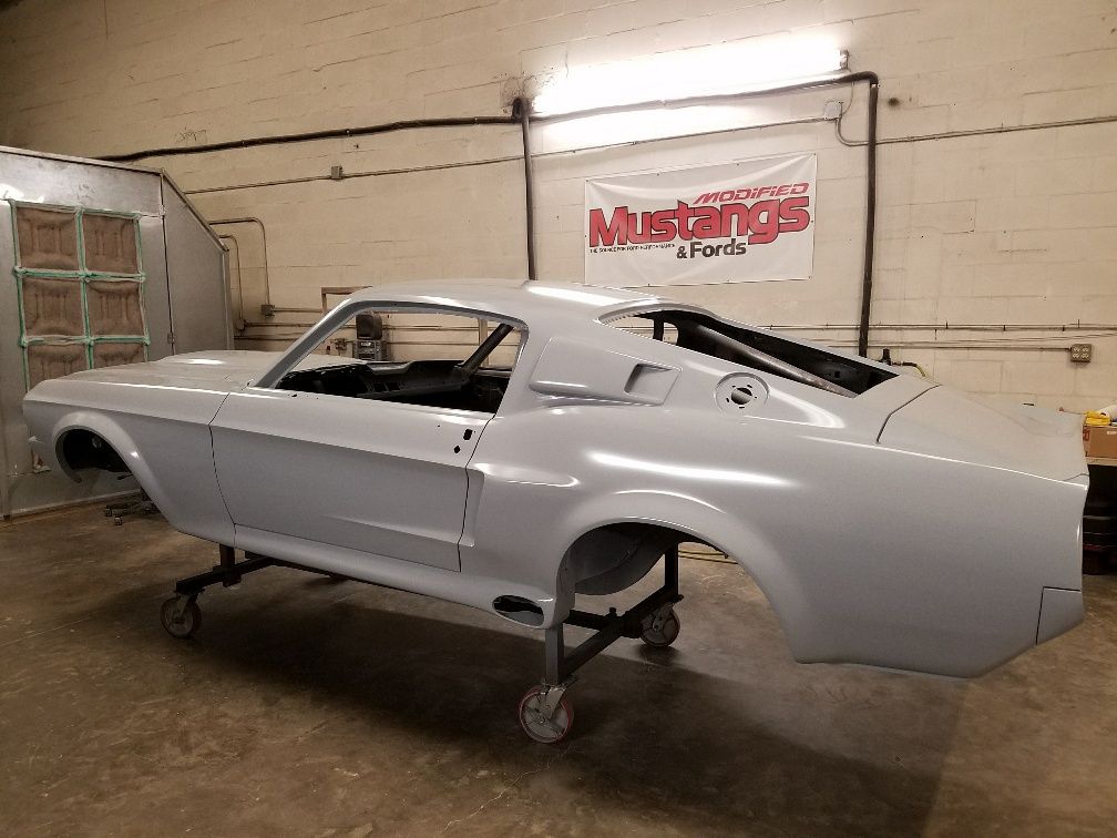

GPR 04-03-2017 06:01 AM
We had to add fiberglass to the side exhaust skirts to give us something to bond to the pinch weld.
http://img.photobucket.com/albums/v3...pshfgeol9p.jpg
http://img.photobucket.com/albums/v3...psglrrfoad.jpg
Bonded to the rockers
http://img.photobucket.com/albums/v3...psf0hflslz.jpg
Started the bodywork
http://img.photobucket.com/albums/v3...pshpbr96e1.jpg
Headlight bucket was bolted, bonded and fiberglassed to the fender
http://img.photobucket.com/albums/v3...psqsuepift.jpg
Front fender flares installed
http://img.photobucket.com/albums/v3...pslpmk966z.jpg
Bodywork getting everything to line up
http://img.photobucket.com/albums/v3...psirftop3b.jpg
http://img.photobucket.com/albums/v3...ps3dpibtlb.jpg
Ready for a couple coats of SPI epoxy primer
http://img.photobucket.com/albums/v3...psw0iunyck.jpg
http://img.photobucket.com/albums/v3...psswxzxeqb.jpg
http://img.photobucket.com/albums/v3...psehio9x0s.jpg
http://img.photobucket.com/albums/v3...pskhq6kv7y.jpg

GPR 02-23-2019 04:52 PM
This project has been on hold for awhile and the customer decided he wants us to make it a roller and he will finish it. The undercarriage still needed some welding and bodywork.
https://img.photobucket.com/albums/v...psgxmdef3e.jpg
http://img.photobucket.com/albums/v3...psppzot404.jpg
The undercarriage was epoxy primed and block sanded again.
http://img.photobucket.com/albums/v3...psrl3a8mki.jpg
I epoxy primed the body.
http://img.photobucket.com/albums/v3...psnrza577h.jpg
http://img.photobucket.com/albums/v3...pskmx8yood.jpg
http://img.photobucket.com/albums/v3...pshockkyxi.jpg
http://img.photobucket.com/albums/v3...psxfv0uxdu.jpg
Starting to assemble
http://img.photobucket.com/albums/v3...ps4cw2n3ha.jpg
http://img.photobucket.com/albums/v3...pstbajct6y.jpg
http://img.photobucket.com/albums/v3...psalgflpcd.jpg
